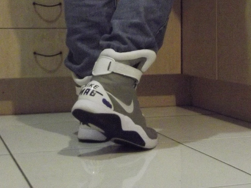

The K-MAGs come in 4 different colourways and I chose white with black soles because it seemed to be the best of the bunch and the most wearable right out of the box.
Painting Them Grey
attachment.php
After some time, I realized white was just wrong, so after finding a spray paint made for upholstery, gave them a paint job and added some white SWOOSHES.

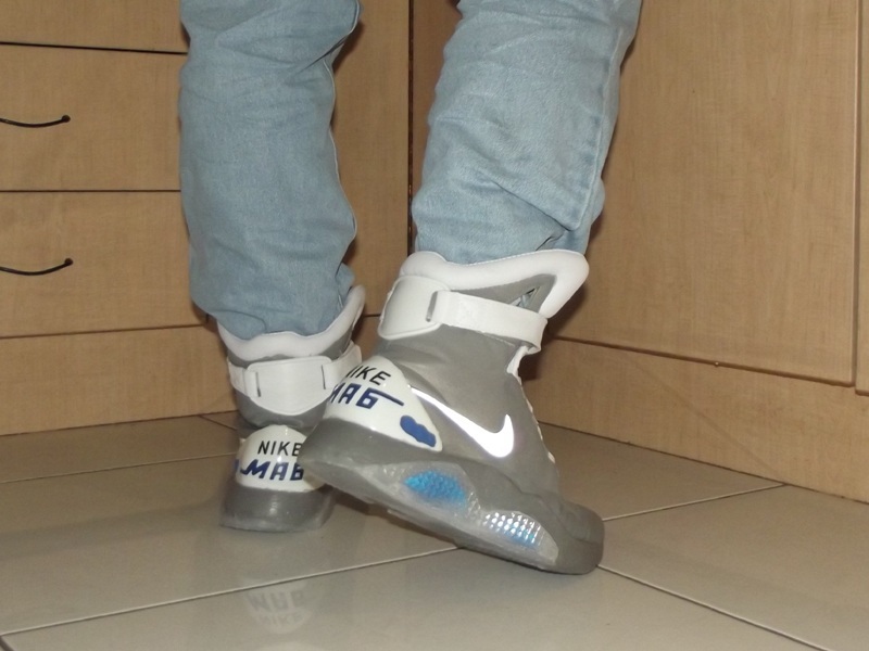

I've always wanted a leather pair of MAGs and these uppers are made from a kangaroo hide I was given. Also shown is the new Ankle Buckle and Heel Cups I made from scratch.
Almost Complete
attachment.php
I am still yet to glue the soles, so this is how the shoes should look when I am wearing them. I am almost hi-top complete :)
