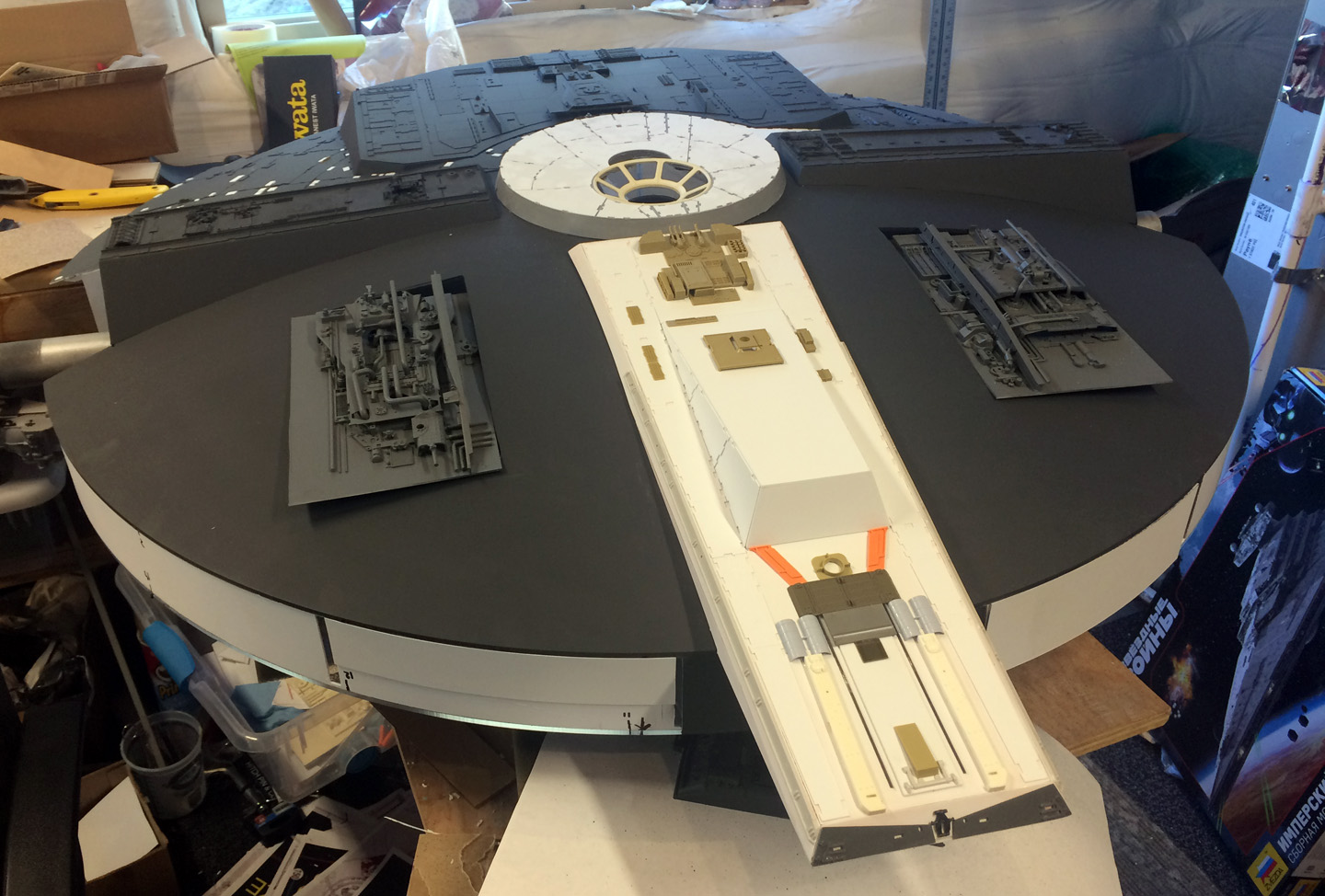

    Quick update here - more later tonight... Got the last part for the lower Jawbox - to be a perfect match to the rear landing gear doors, Steve Neisen printed this plate up for me, like he did for the others last year! It is a PERFECT fit, as well as look and feel. First shot is just laying it down, second is the part bonded down and primered. That jawbox is now pretty much done.
    Next up, got the majority of the "Damage" area on the Starboard hull done. Still need to chop into the jawbox and do some more minor chipping and such. You'll see the crazy mess that was made my grinding away the acrylic hull, then a thin (.005) styrene sheet, heated it up and formed it to the divets. Then the .040 Styrene plating, chopped out to match the original as close as possible. So much fun doing these kinds of detail areas!
    More pics of the progress of the cockpit tube plating wrapping up next!
    Thanks
    Sean

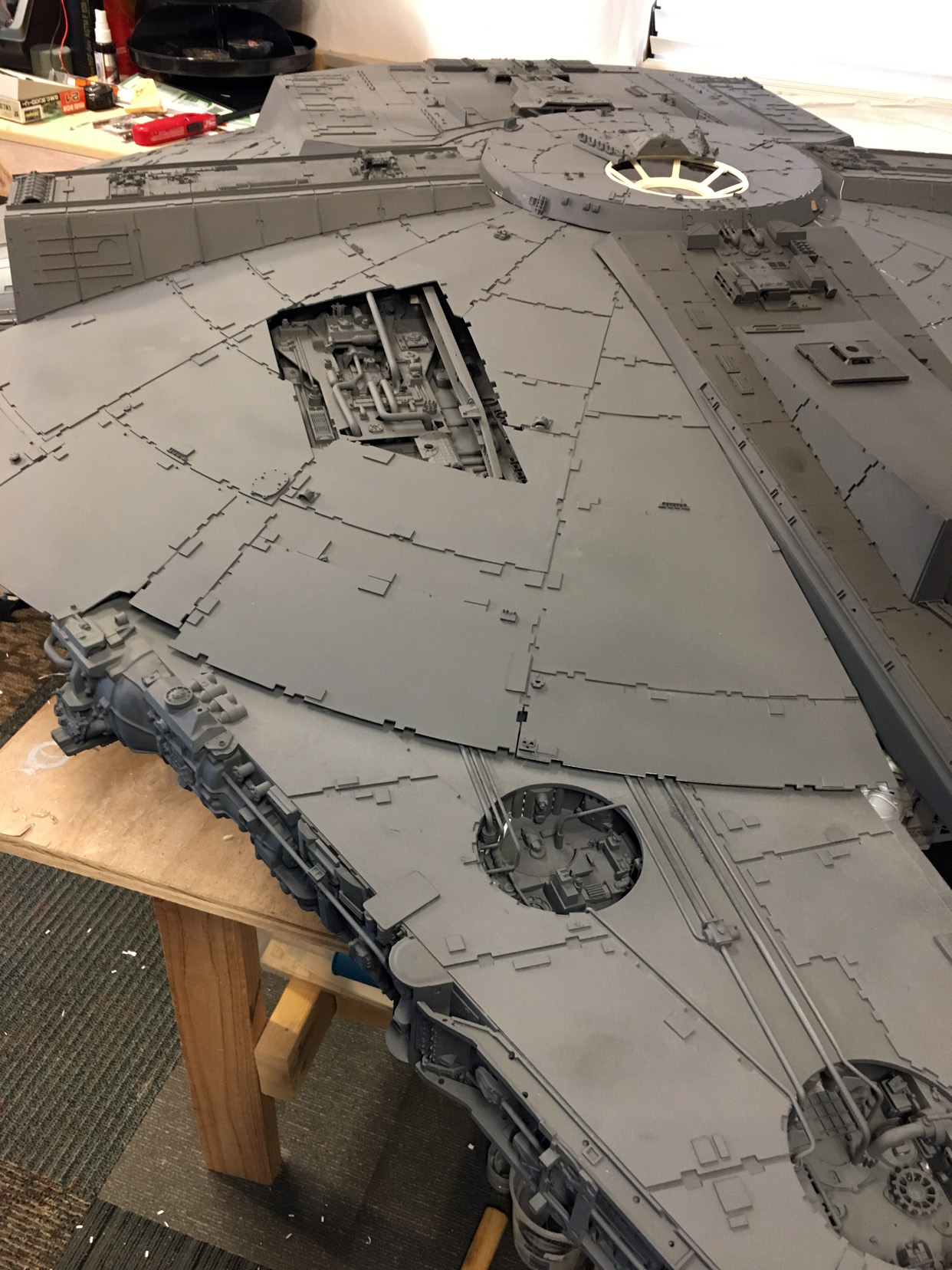

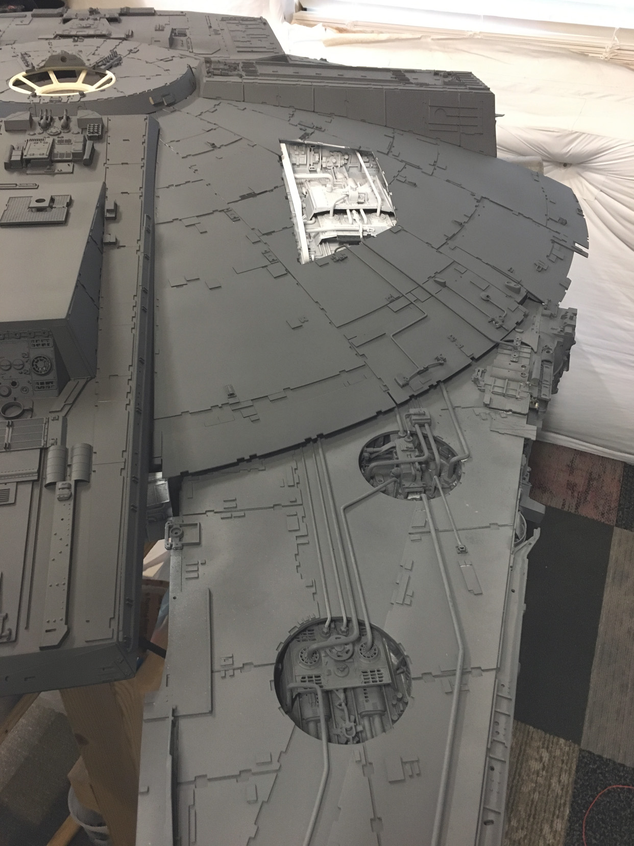

    Ok, so here's getting to where I'm at about now. Finished up 'most' of the Cockpit plating. There are still a number of 'greeblies' that need to go down on the cockpit walkway area. Then I need to start laying down the tons of 'chips' all over the rest of the plating. Once the rest of that all gets done, I'll probably work on putting down the original KoolShade strip over the 9 vent holes (that's gonna be fun...Not). Then, I'll be restarting on finishing up the Top Gun Turret (the primed one is for the bottom), and one of the final decisions is to move forward with the full Studio Set interior. Thanks to Maruska, I pretty much have all the parts/details for that, but it will also slow down completion. I always planned to have the original miniature cockpit interior to swap out with the set. I'll be forced to decide soon. :eek
    So, on to the latest progress...
    Finishing up the Plating between the cockpit and the jawbox.
    Plating all down in this area
    Starting the plating of the Cockpit Tunnel
    Getting plating on the front side of Cockpit tunnel (using greeblie parts as I go along to help 'measure'.
    Most of the Cockpit tunnel plating all down, with about 75% of the greeblies.
    Mocking up cockpit cone and to see how it's all looking.
    One of the First views of it in a nearly completed state of construction - with the top Gun Turret plate (Still needs to be trimmed to contour)
    Thanks again for all the support and encouragement - getting closer to full on primer, then on to painting - ohhh that's gonna be a lot of work!
    -Sean

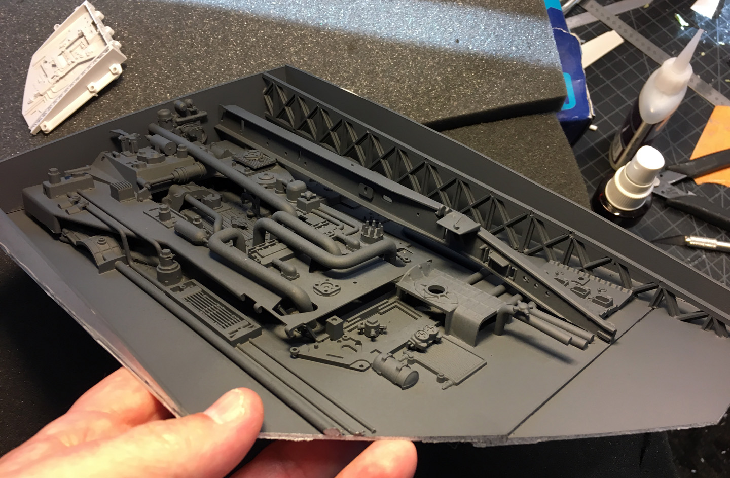

  9. t2sides
    t2sides Sr Member
    Trophy Points:
    1,320
    And I almost forgot, got the majority of this area finished up too.
    Still have a few minor items, but it was nice to see the pipes and parts go down.
    One additional shot of the 'inside' of the cockpit tube plating.

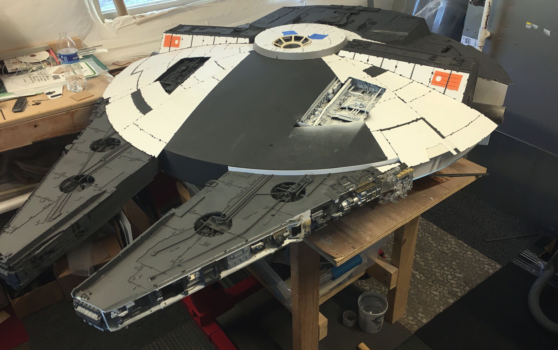

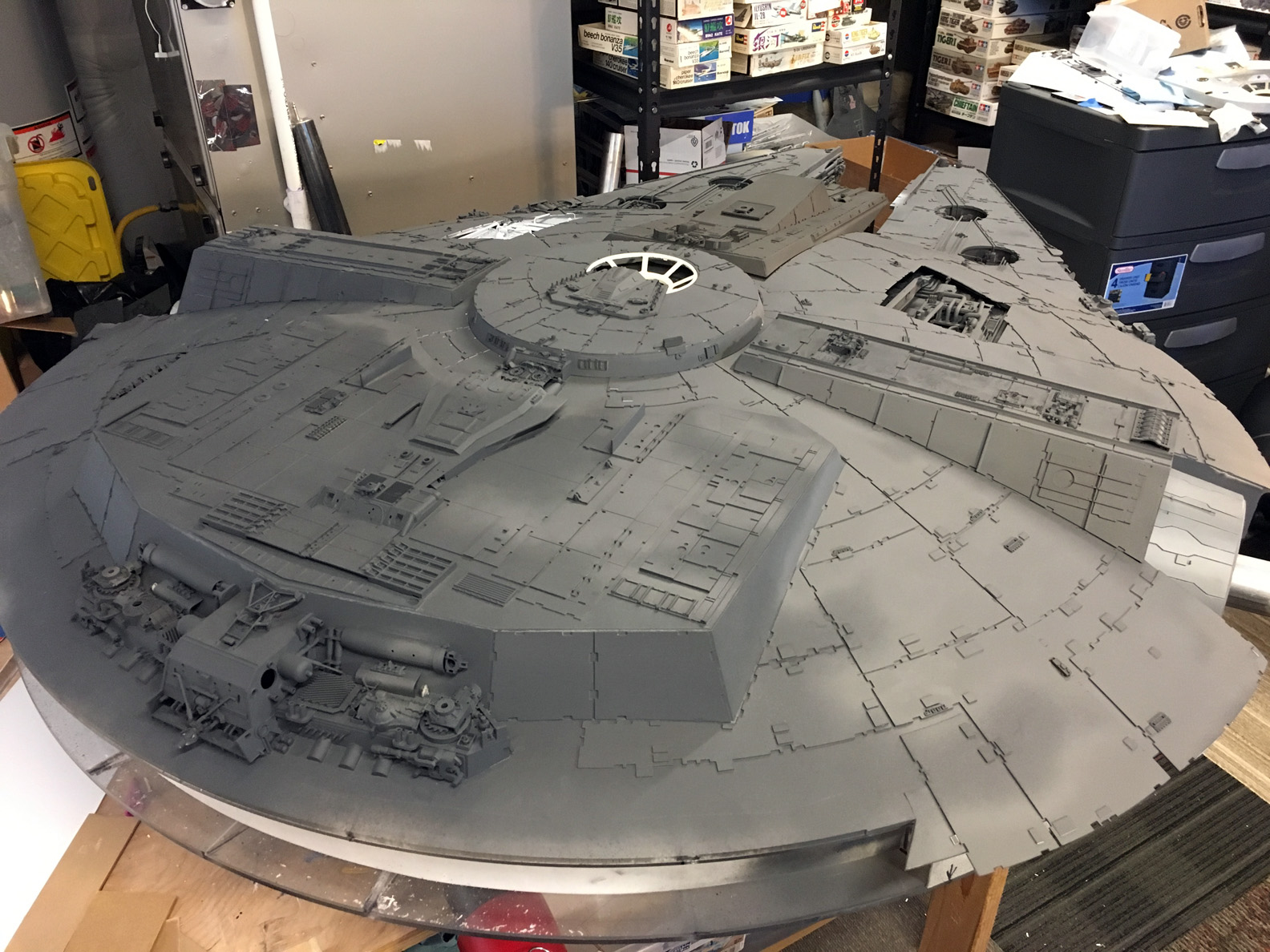

    Here's the latest Update - MAJOR MILESTONE for me reached!! Got the whole ship in primer today!
    So after putting down a number of final details on the main hull and assembly, I got the whole base primer coat down, and started finishing up the top gun turret with it's parts along the side. That should get primer this week. Next will be plating the cockpit cone, adding the t-strips to the window frames, and lastly get going on the Cockpit Interior.
    Here's a bunch of pics....

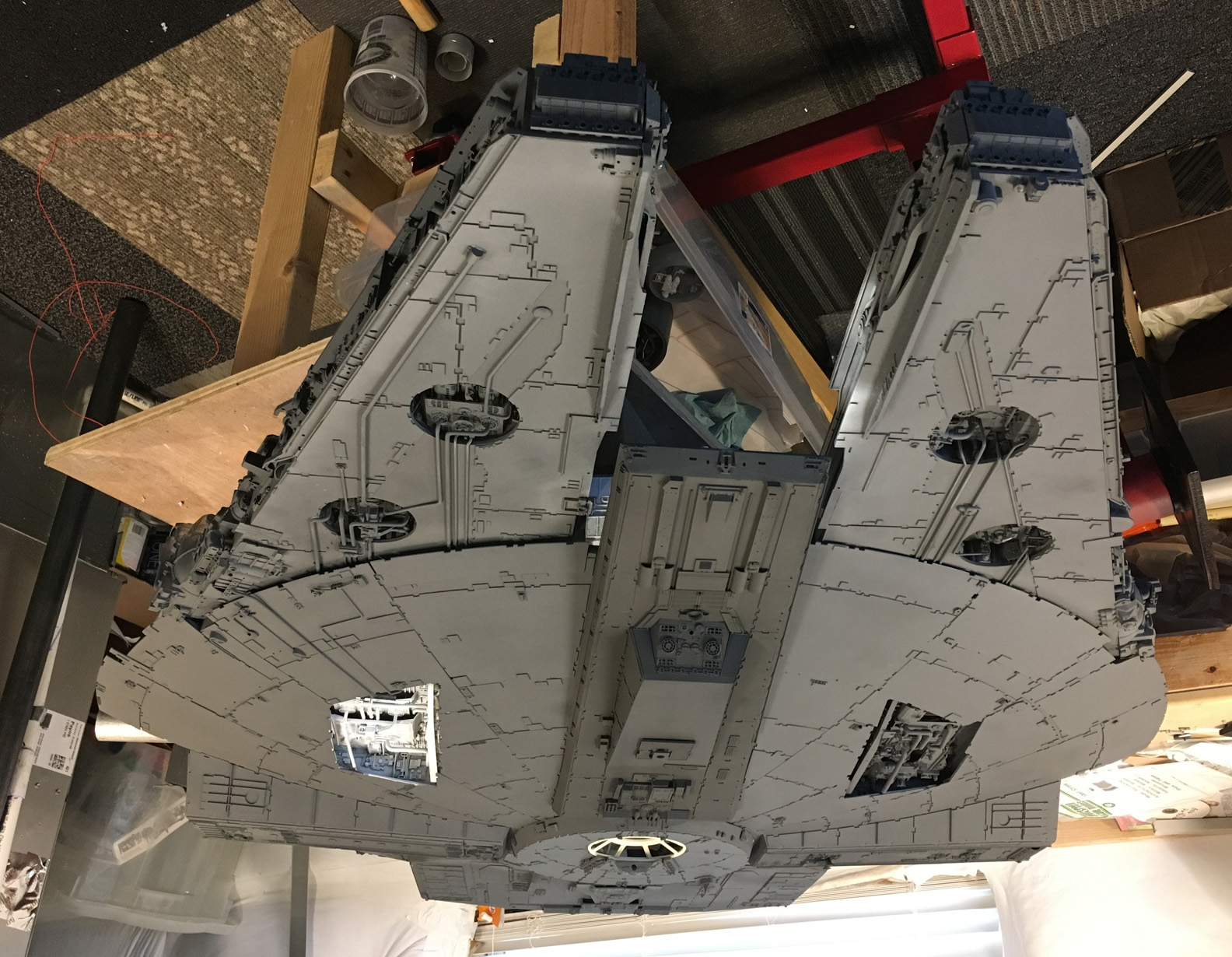

    Quick update - Got the ship flipped back around. Finished up most of the cockpit underside greeblies - waiting on another kit to finish that area up. In the meantime, got the first base coat of primer/paint down. There will be another layer of white to go over this one, this was just an initial light primer coat. I'll probably get the trench walls in soon as well. Also got started on plating of the starboard docking walls and had a bit of fun with the plating deformation (including the cockpit underside). It's pretty cool to see it all now in a single color. The middle jawbox and the turret platform are not yet glued down (I'll test the painting/weathering on them before bonding down.
    Cockpit underside with final gray primer (minus a couple parts)
    White Primer down
    Starting the damaged hull wall behind cockpit, and deformed plating.
    A few more with the detail areas

    What a fantastic build! Your Falcon is really looking good! Amazing build and you're making quick work of it.
    No wonder I'm having trouble finding models, they're all on your shelves. :)
