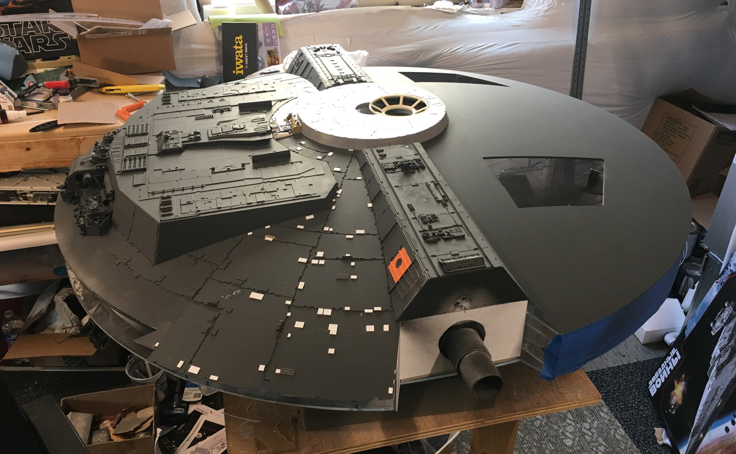

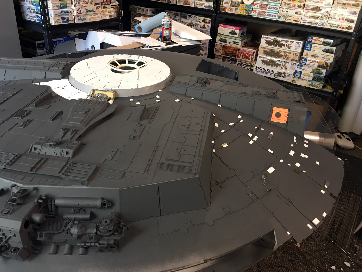

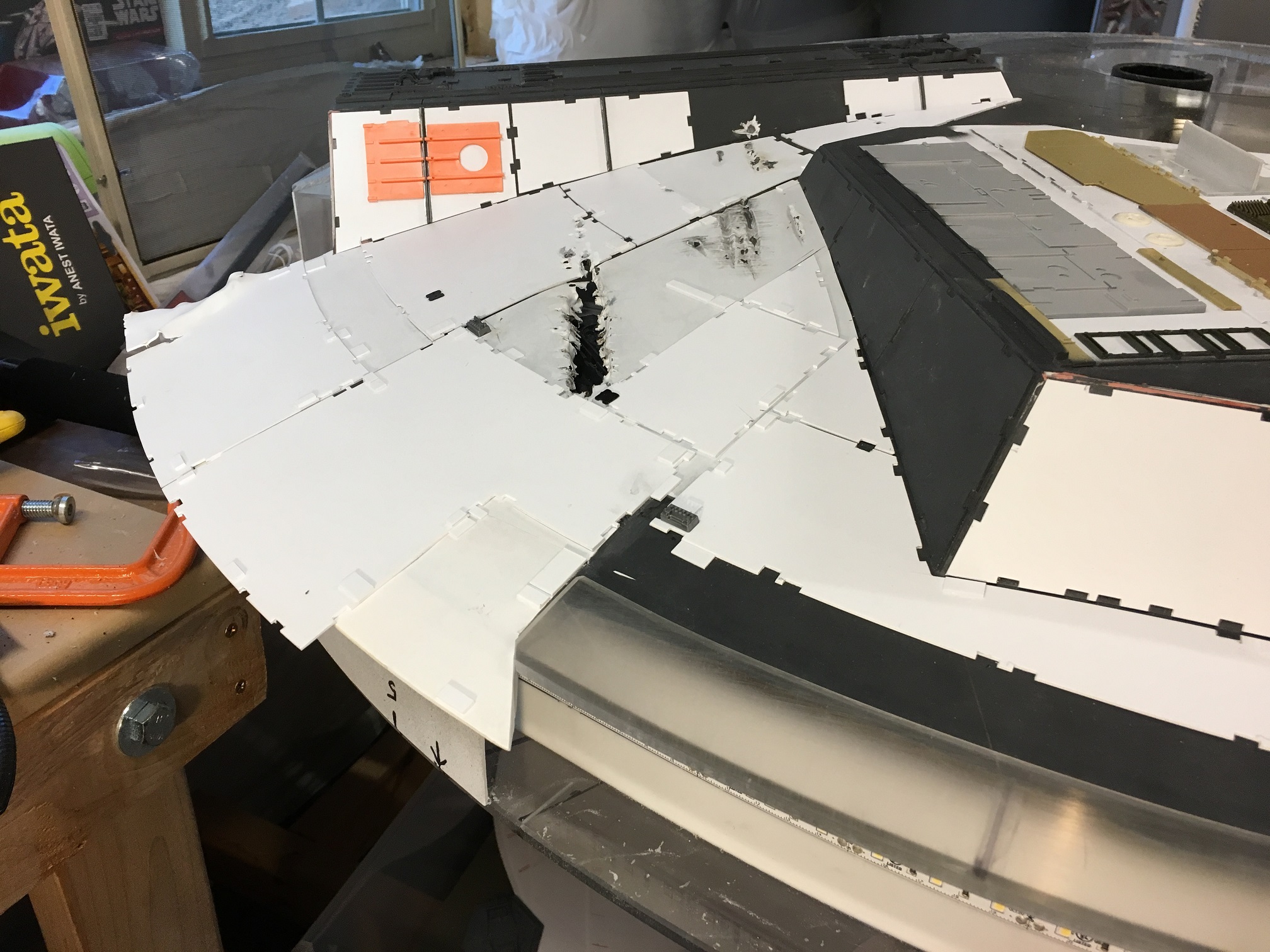

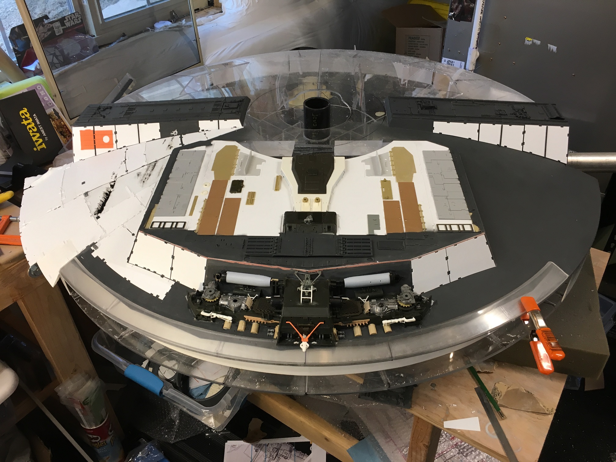

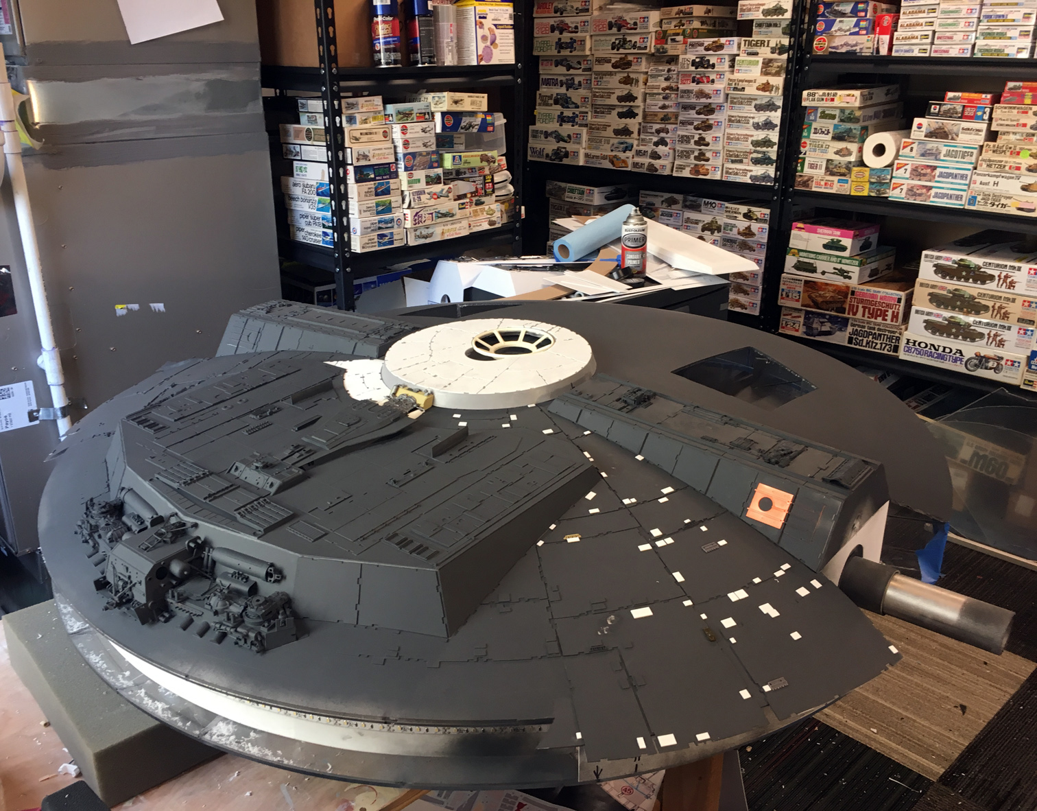

Made a small bit of progress on the weekend, finished up the rear quarter starboard underside plating and added the smaller styrene chips.

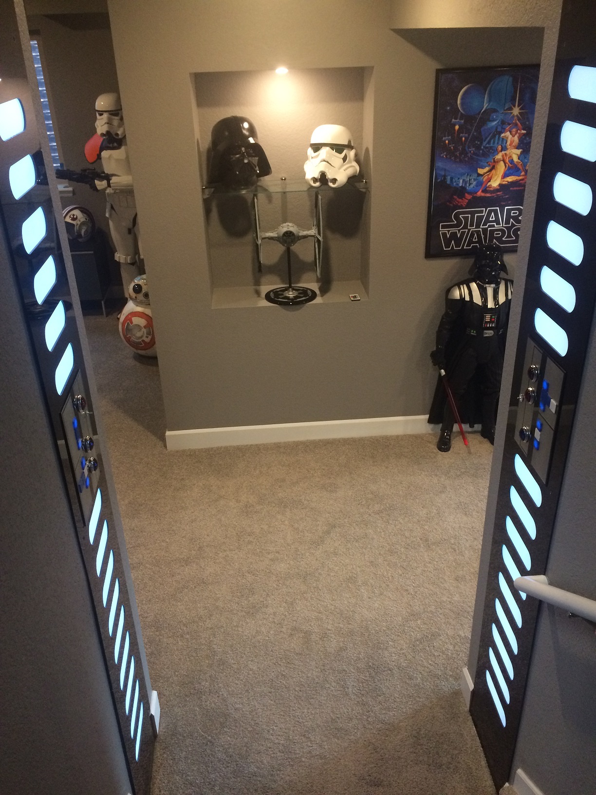

Amazing progress Sean, putting down the big hull panels is a milestone!. I think all the armor plate nibbling is my favorite part to see on yours & to do on mine, kinda therapeutic haha.
And those death star panels in your display room look killer!. One day, thinking next year, I'll come for a visit & jaw drop on your floor haha.

Thanks Stu, yeah, I agree, I LOVE the 'nibbling' part, it never gets tiring. I actually find laying down all the styrene chips to be quite enjoyable as well.

Tracy - Nope, that Comm station is gone! Still have the full size Kirk chair though!

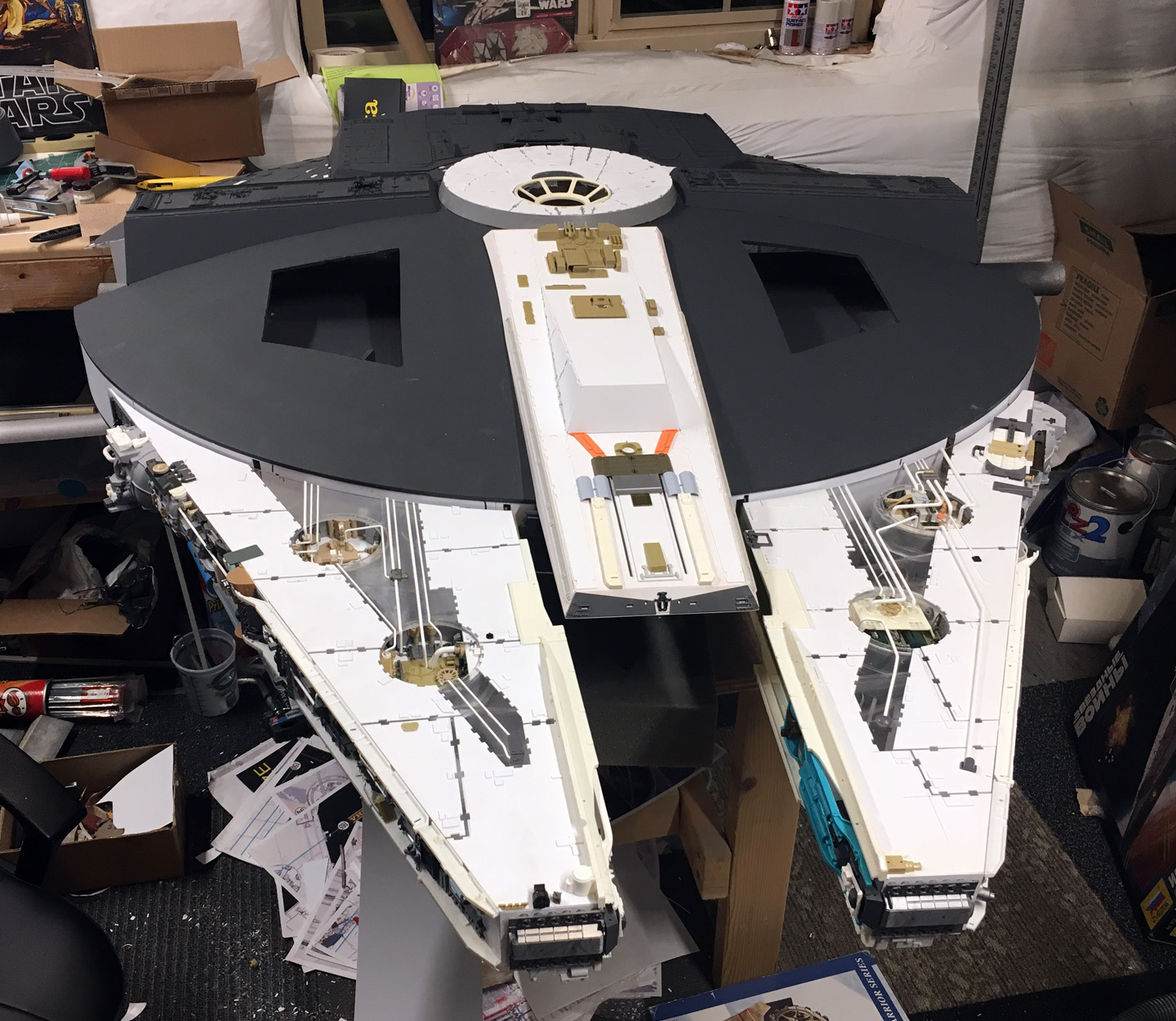

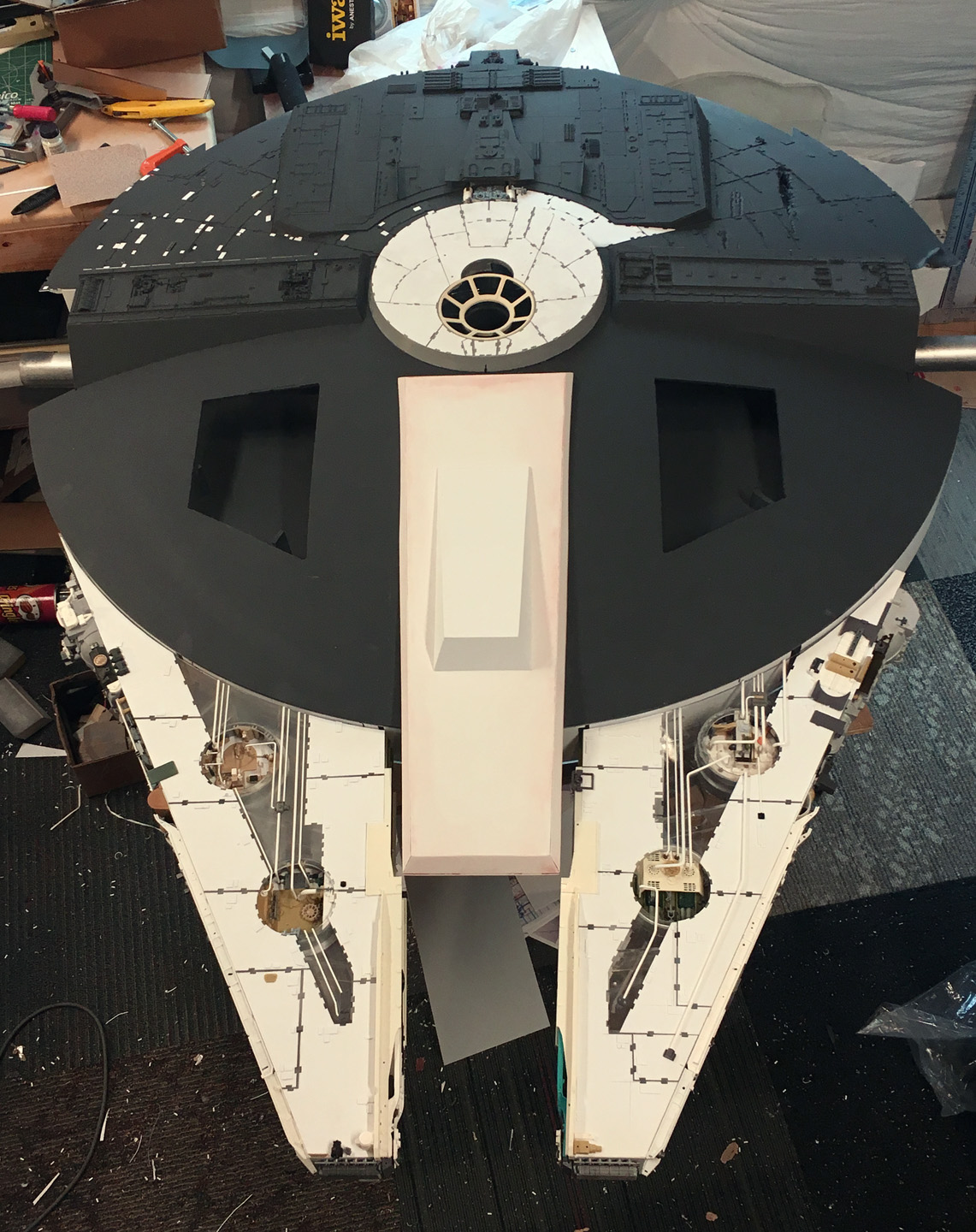

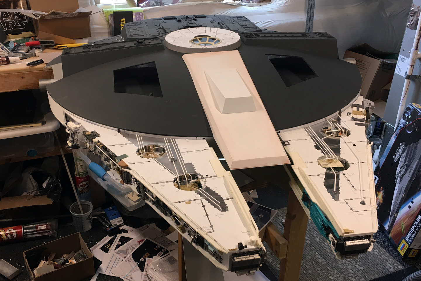

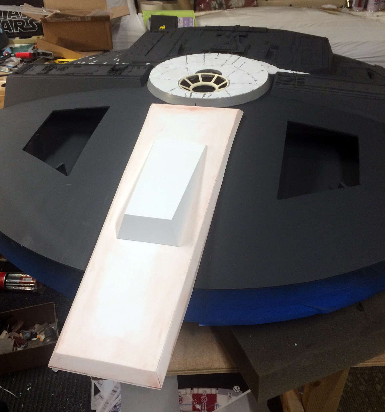

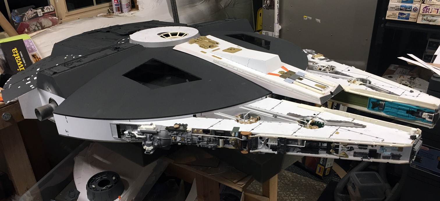

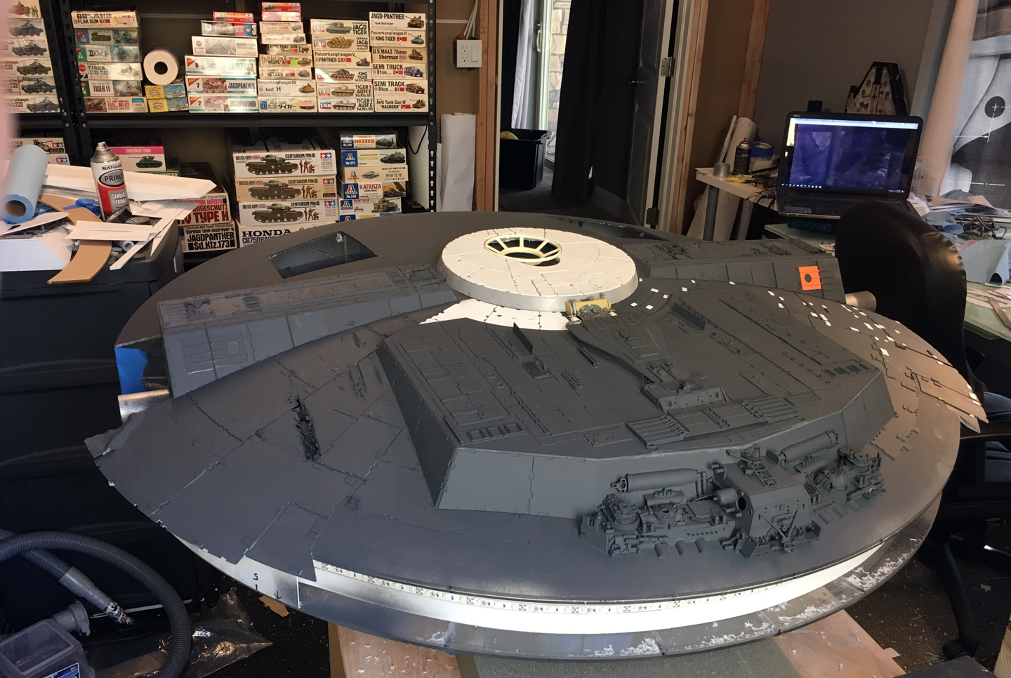

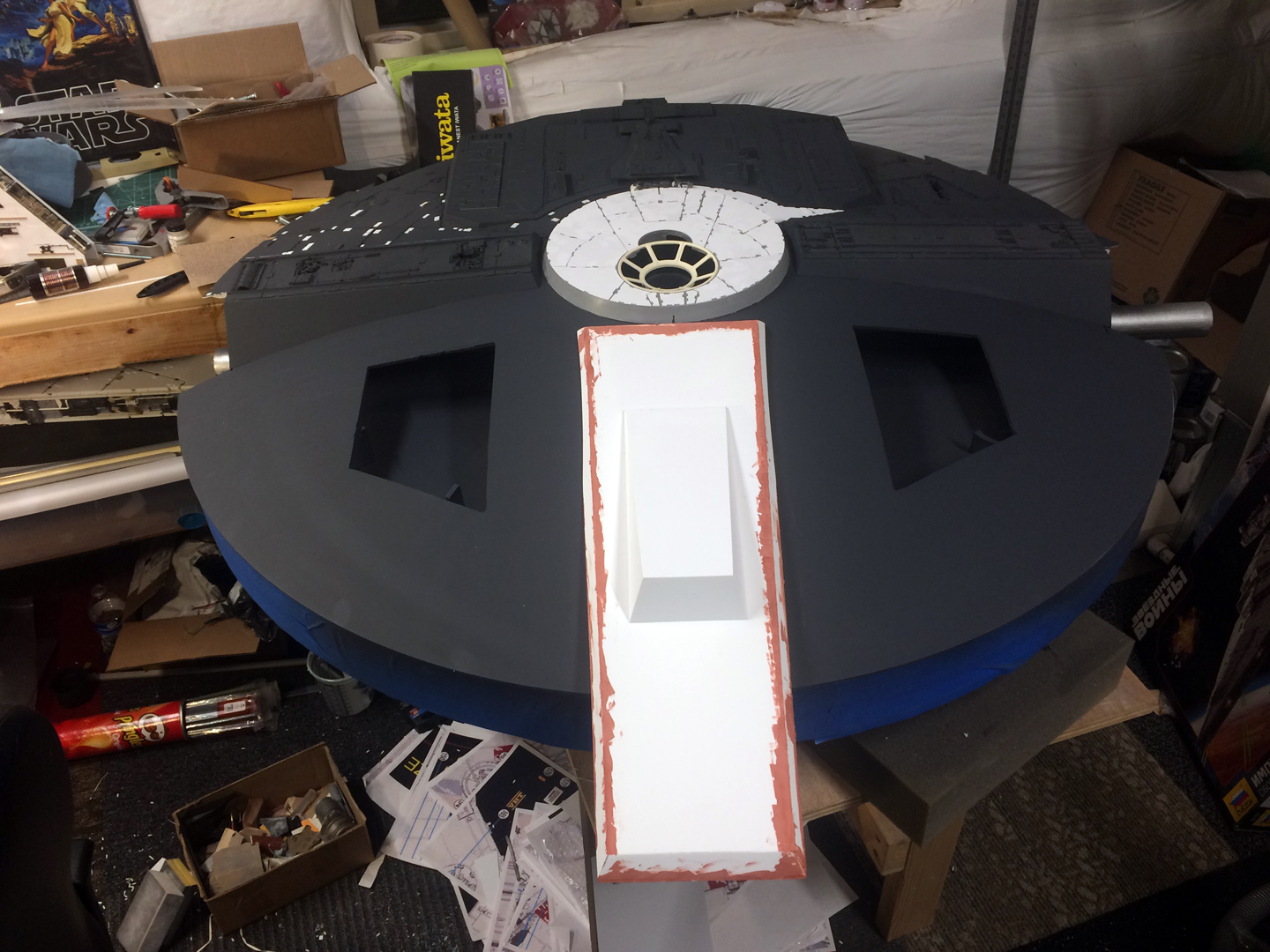

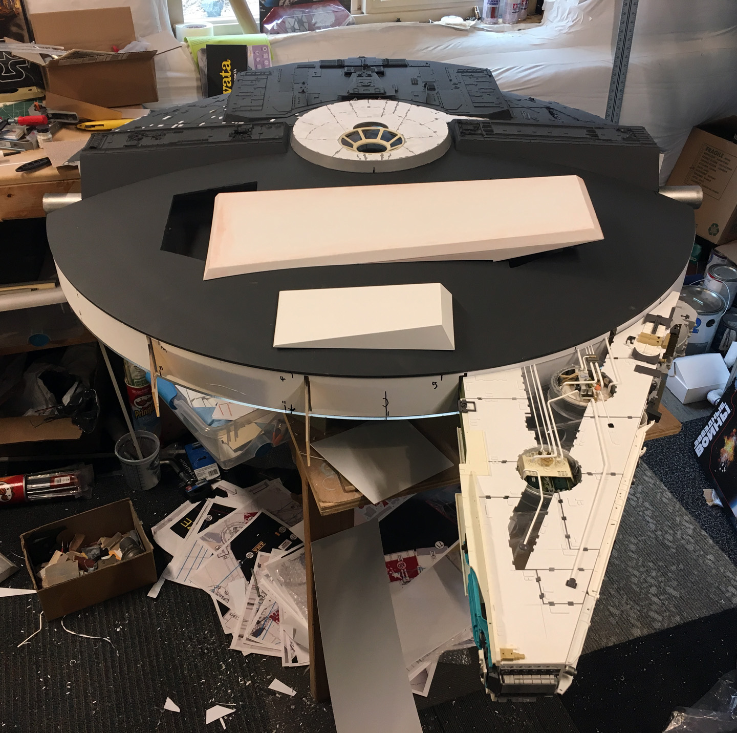

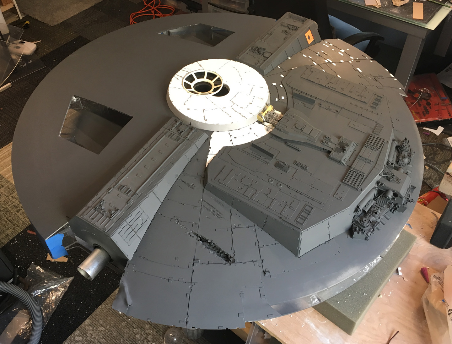

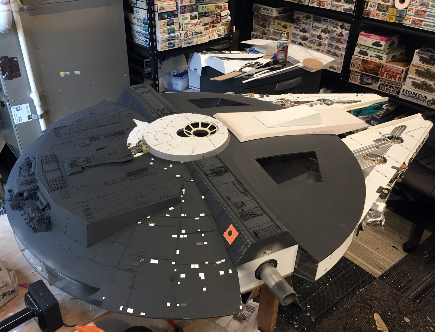

OK on to UPDATE - Finished up plating the back half of the lower hull, then got the whole thing primered, added some 'chips'. Next it was on to building the center lower 'jaw'. That is hand built out of styrene based on the amazing blueprints from Maruska and VFXSup64! It came together pretty quickly, added some putty, sanded, then started adding the plating and greeblies.
Here's the lower plating completed with primer and chips being added
prime7.jpg.

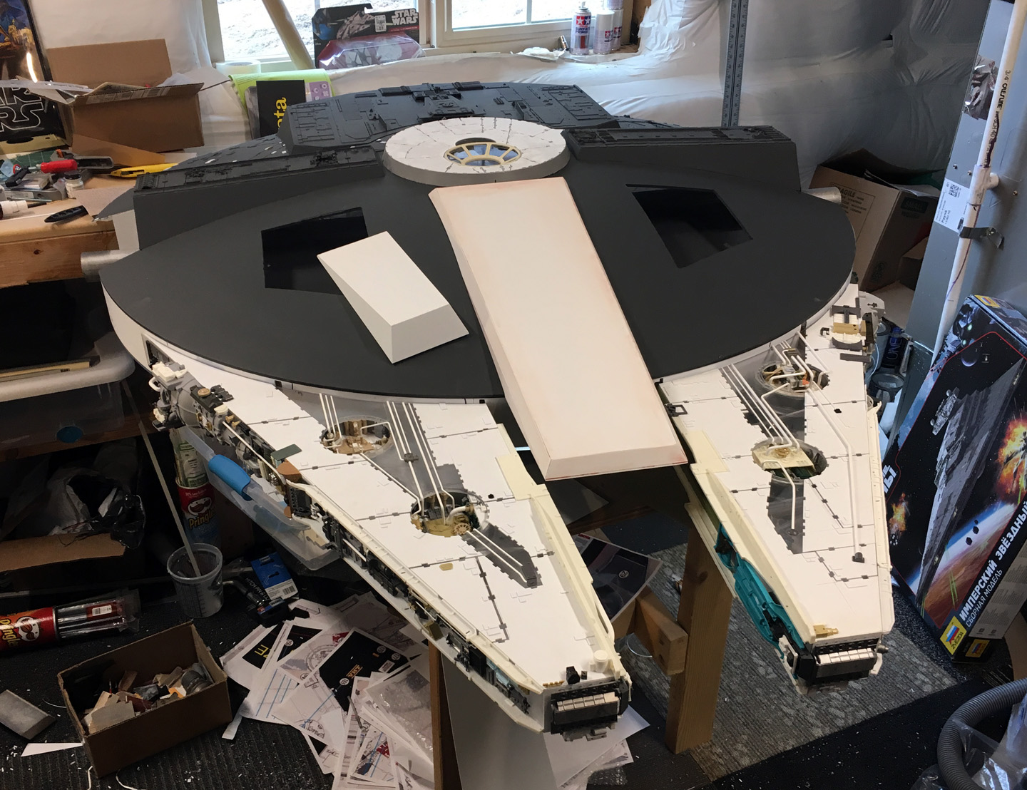

The Construction of the Lower Jawbox and dry fitting to dome and fit checking with Mandibles
Puttying up, then sanded and dry fit
And here's some more placements of Jawbox
And here's the Jawbox with the start of Plating and Greeblies
You don't even know how this build makes my day every time I see an update!

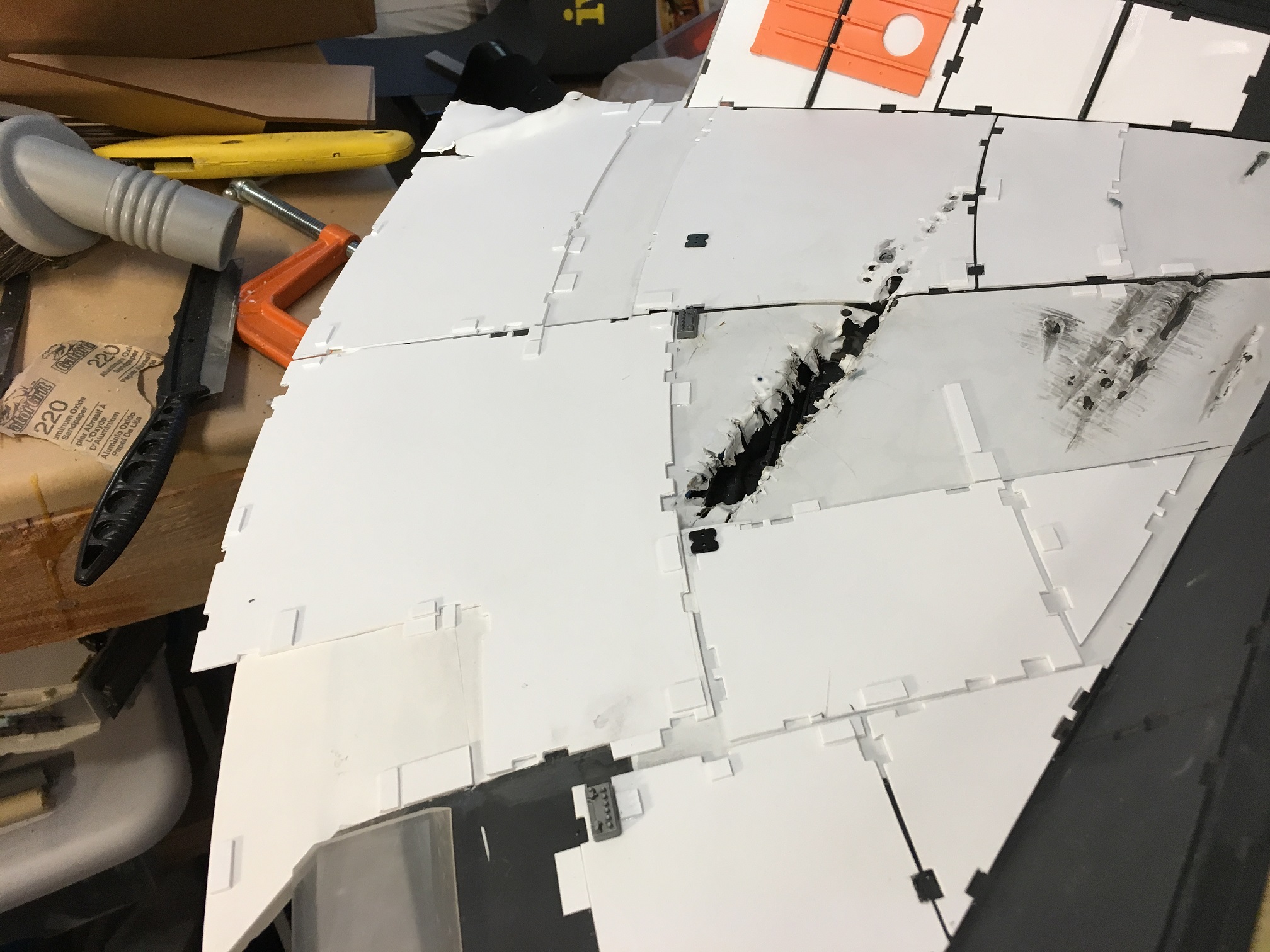

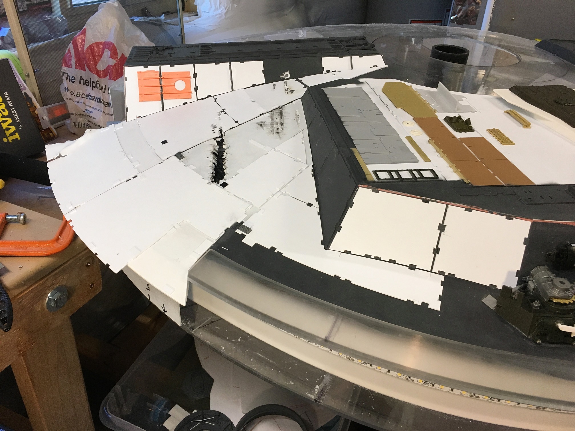

Couple of questions, how did you emulate the hull buckling on some of the armor plating, namely by the starboard docking ring? Also, how much would you say it weighs at this point?
Sent from my SM-G955U using Tapatalk
Really nice! Love the systematic approach to the build. And man she is a lovely array of donat parts isnt she. Keep up the great work!
Apart from the incredible job of getting the right parts, putting everyone of them in their right position on the model; the one pic that made my day is the gash exposing the innards of the Falcon...BRILLIANT:cool:cool!!
THANKS so much fellas!! Always appreciate the kind comments!!
Kokkari - The hull buckling was simply applying a lighter flame about an inch from the styrene to warm it up, then kind of a push/fold/push movement to get the shape, quickly before it re-cooled. The other recesses were pre-dug out of the acrylic, thin sheet styrene over those, heat the styrene and push in to the voids, and rough up a bit with Xacto. I'd say it ways MAYBE 50ish lbs. so far. I'm expecting 75-100 lbs at completion.
joberg - THANKS much on the 'gash'!! Yeah, I'm excited to paint/weather around it to get it shapewise to emulate the original, but it's so cool to see the 8RAD plate in there.

A very small update here - Some more Greeblies added to the Jawbox (I'm waiting on a couple kits to arrive to finish parts). Started test fitting the Sheridan plate on the hull wall, it fits in perfectly between the mandibles, will try to get some pics of that arrangement soon.
