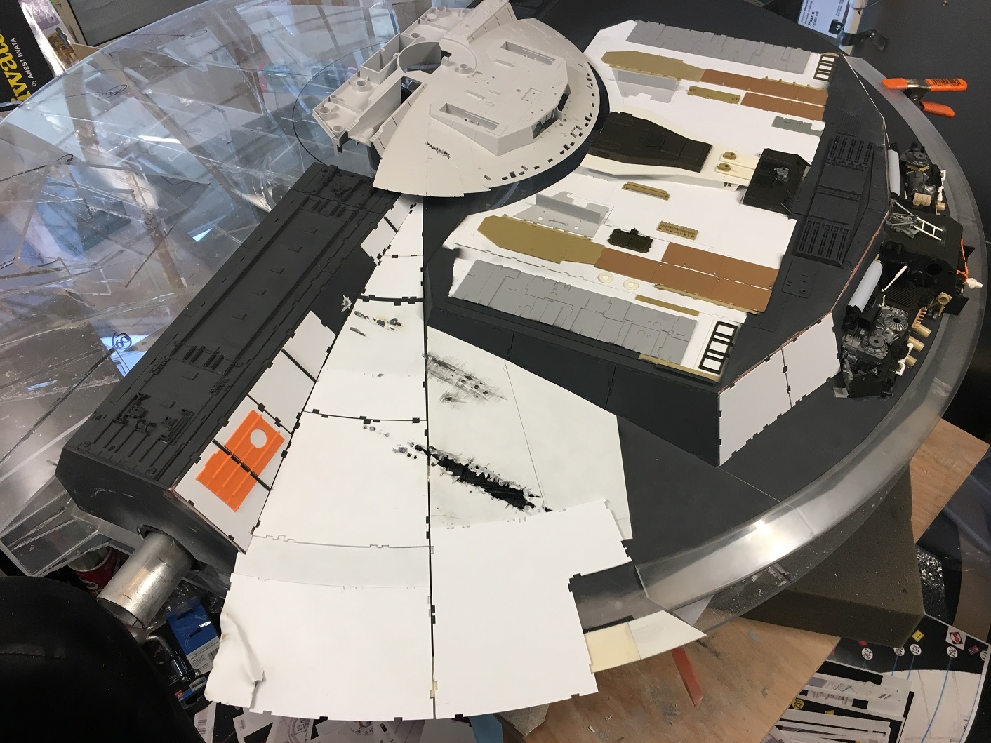

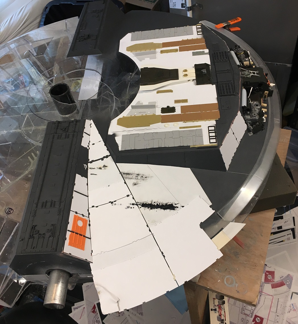

Here's a few progress updates.

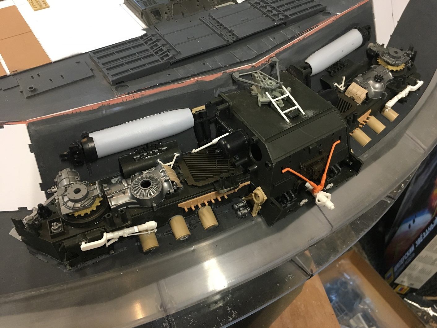

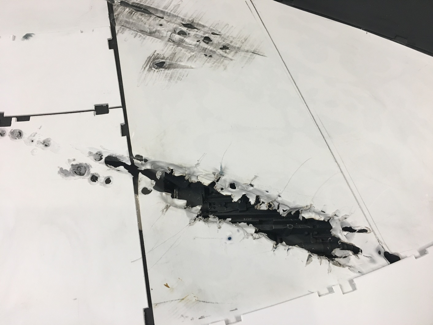

Added most of the parts for the underside engine/landing gear deck. This was a really fun part of the build, finally getting kit parts down onto the actual body. I shot some primer down first (similar to original model) to keep out any potential for light leaks). Still have a few minor greeblies to add, and sand down some of the glue mess (had to move the Centurion deck). Started putting in the Underside Starboard Plating, created the damaged hull areas. I basically cut out a hole, then placed some reinforcement pieces back in, placed thin styrene over it, heated the styrene and cut through and melted the overlap.
Plating started
And in the foreground, begun deforming the plating on the outer rim area.
Here's some more closeups of the damage. For the main damaged hull 'hole', though not a 'perfect' representation, it's close enough, and once the paint/weathering goes down, it should look fairly close. I did make the hole a bit too long and not as 'oval' as I intended, so I may do a bit of tweaking. The most enjoyable part was placing the 8Rad casting under the hull. The Bandai 1/72 Falcon really helped here for orientation - You'll see it in the last photo, it's so Tiny compared to it's original big brother here, but as you know, Bandai really hit it well on accuracy. I also included a pic of the top S/B rear maintenance pit of the Bandai kit to the Studio Scale pit there.
And the 8Rad part inside the damage area.

This is where I'm at now, roughing in the next row of plating.
And Check Out the Bandai Falcon underside to the Studio Scale! Just slightly bigger than the gun turret platform!
