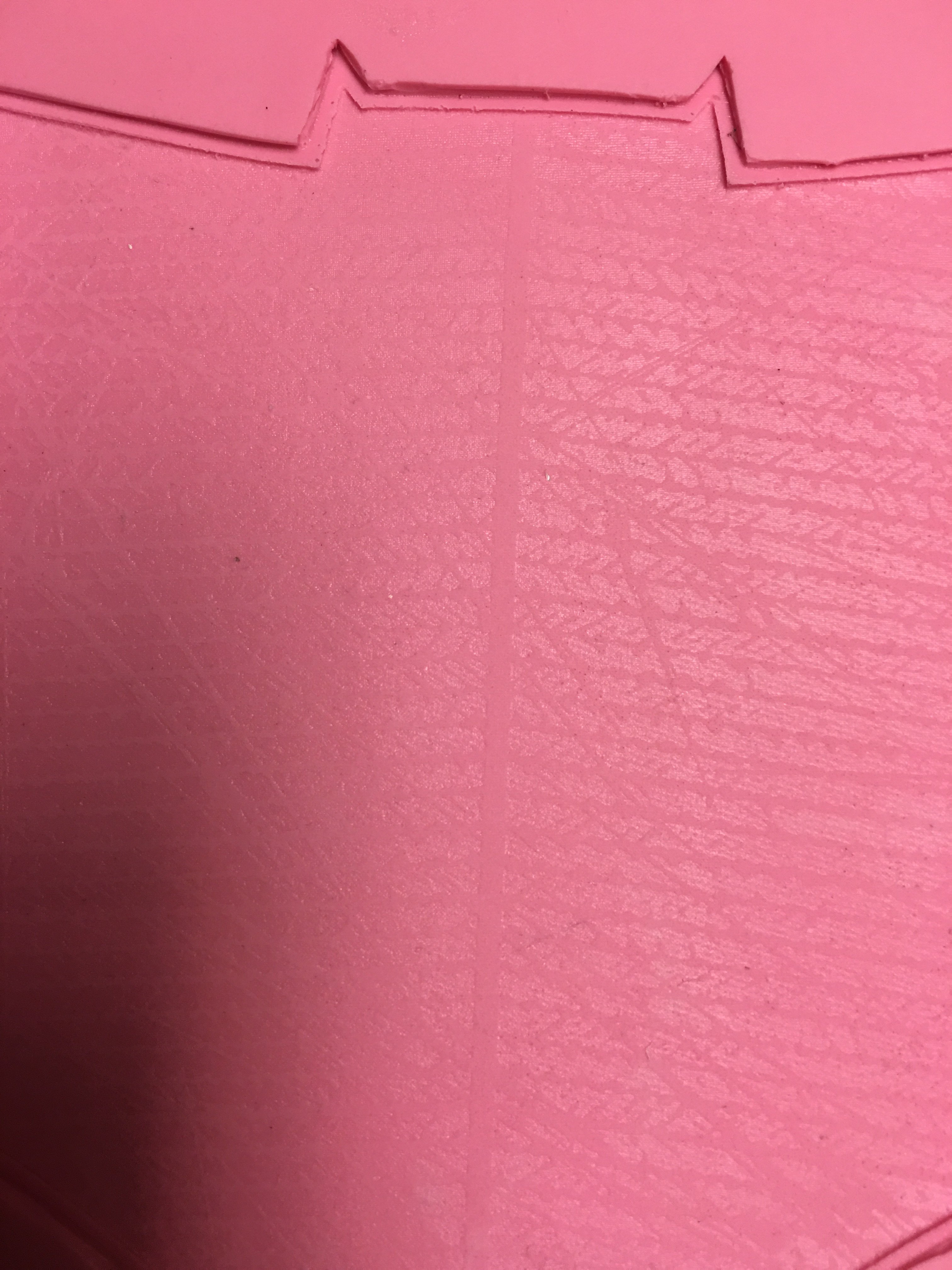

Realized I had some Mold Max and fast cat left over from an older project so I went ahead and made a quick mold.
I'll pull a hard copy out to add the battle damage to some time tomorrow. It just isn't feasible cutting the damage into the urethane casting as its paper thin. There were a few little air bubbles and off cuts on the emblem I recieved so I'll fill those as well.

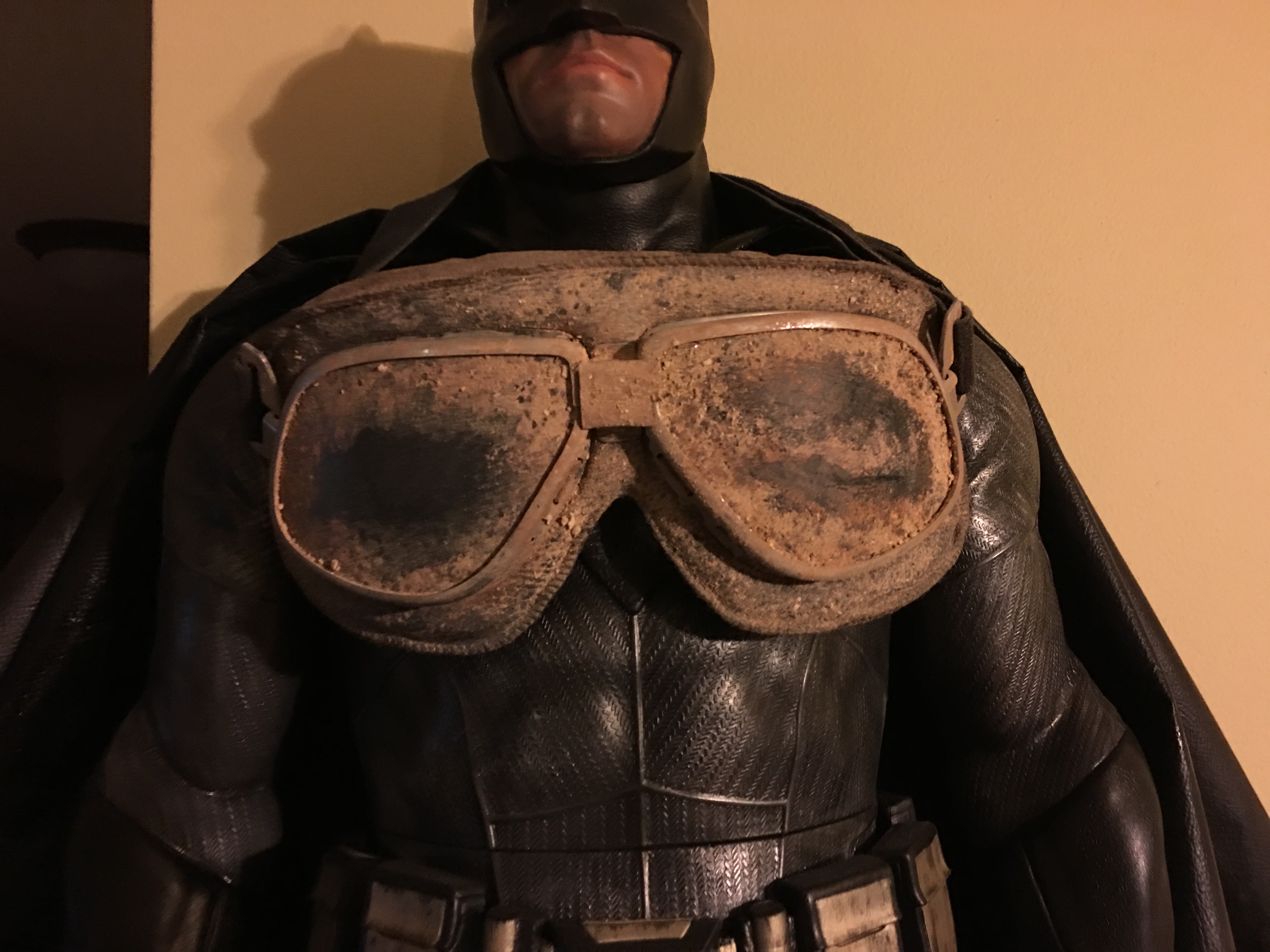

I almost forgot! The finished goggles, as modeled by my 31" Batfleck! Won't need to see through them, so I went all out! I have the backup pair I can always do in the lighter style I originally posted.
This was done exactly the same as posted above, hair spray and a Fullers Earth/Texas Dirt Powder mix. It was sealed in lightly with crystal clear, and then the "clean" areas were carefully wiped out with some alcohol.

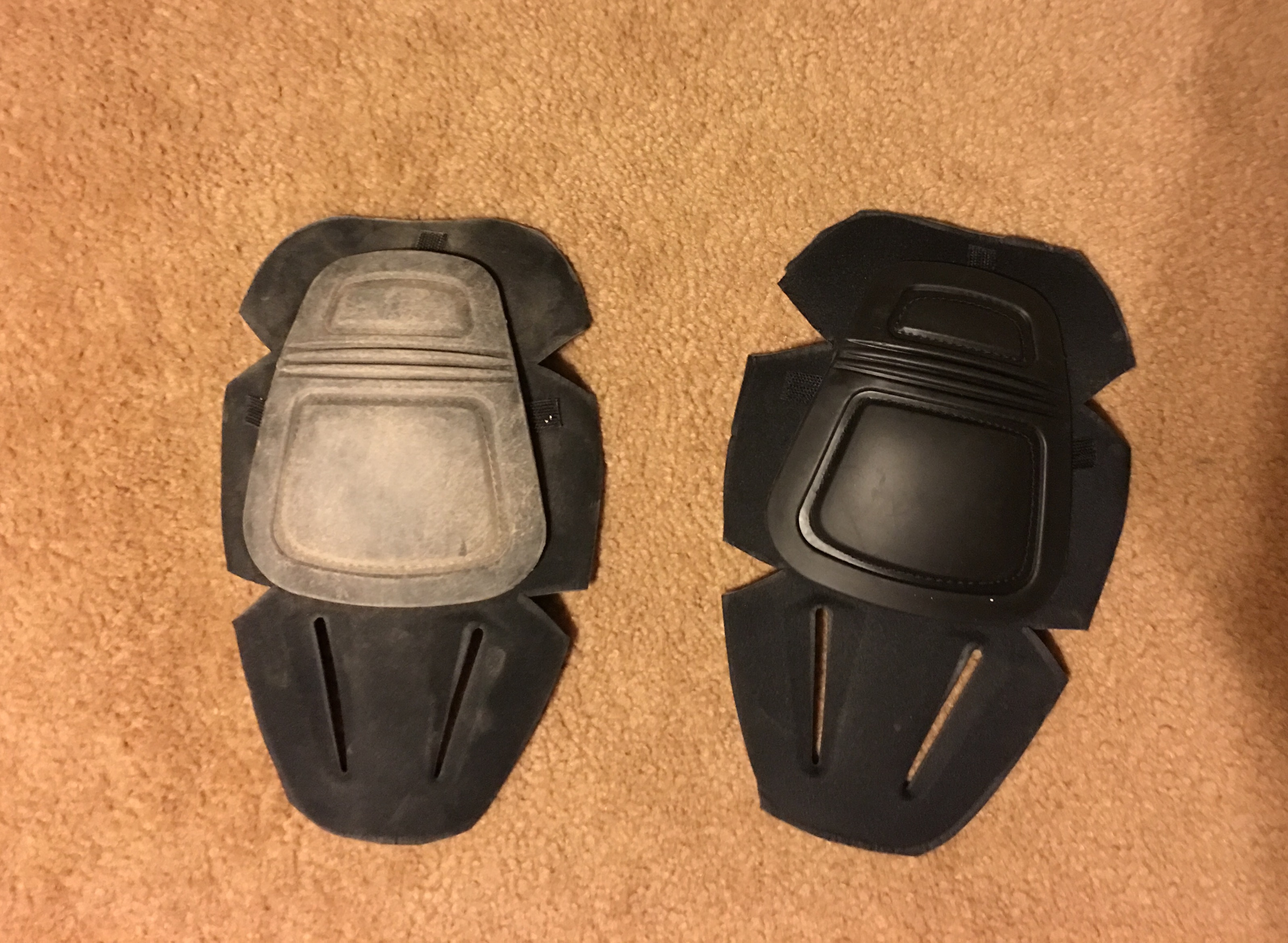

A quick update on the Knee pads. Got the accurate model and color pads, (they are indeed black in the film) and weathered them up. It's actually weathered a little too much in this pic and I've since taken it down a little.
So the left side shows the knee pad after some weathering and the right side is how they come brand new.
What I did, for those curious, was just rub my Fuller's Earth and Texas Dirt powder mix into the surface of the pad, and then lightly sealed it in with Matte Finish. While the Matte Finish was still wet, I scrubbed more of my dust mix into the pads. (Pictured is right after that process) I then went in when everything was dried and lightly removed all the loose powder and got the final look.

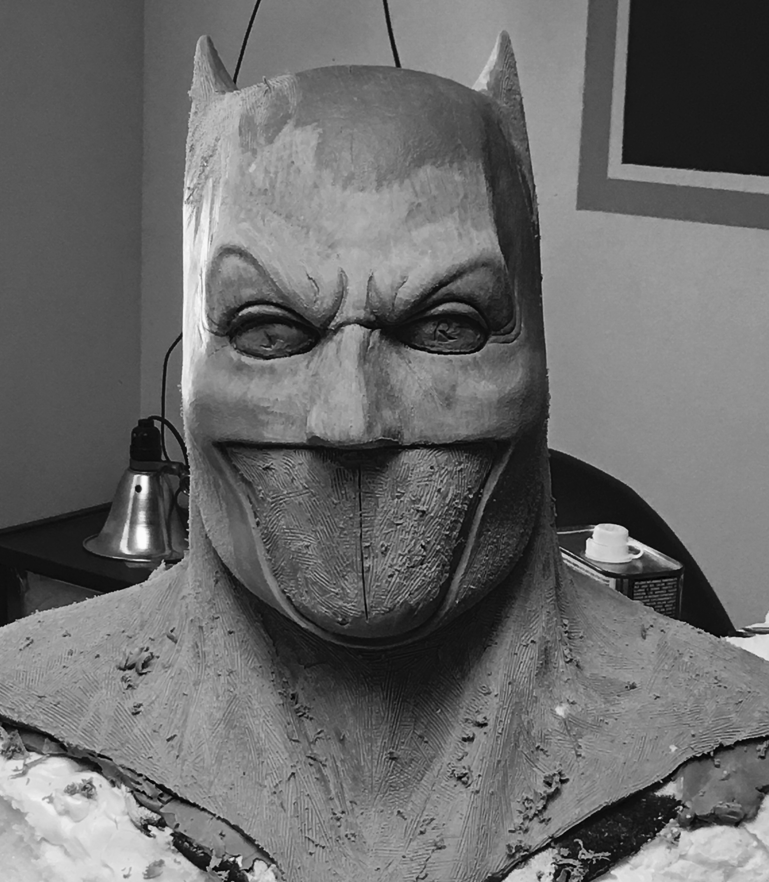

Still pushing some clay on this one.. Definitely feel like I'm getting closer. Texture is not anywhere close to final, I just push it in every so often to check my progress.
I had originally planned on running this out of urethane solely for the color aspect, but I've decided to go with latex. Urethane just doesn't do it for me when it comes to full head cowls. I may in the future make up a core and try running a foam copy, but we'll see.. Way to far down the road to say anything for certain.

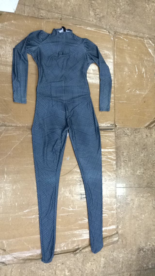

So.. Onto the suit.
I'm hoping it's just the lighting or camera used, but I can't say I'm particularly happy with it.. The color.. The pattern.. It could be better. A lot better. That's absolutely no fault of Zentai-Zentai as they've done awesome work and been great along the way. I shouldn't have rushed to find a pattern.
Once it arrives, I'll do the best I can to modify it to my liking. I plan on just cutting out a "T-Shirt" area if you will, for use on the statue. Once newer, more accurate patterns come out? Upgrades are definitely in the near future.
