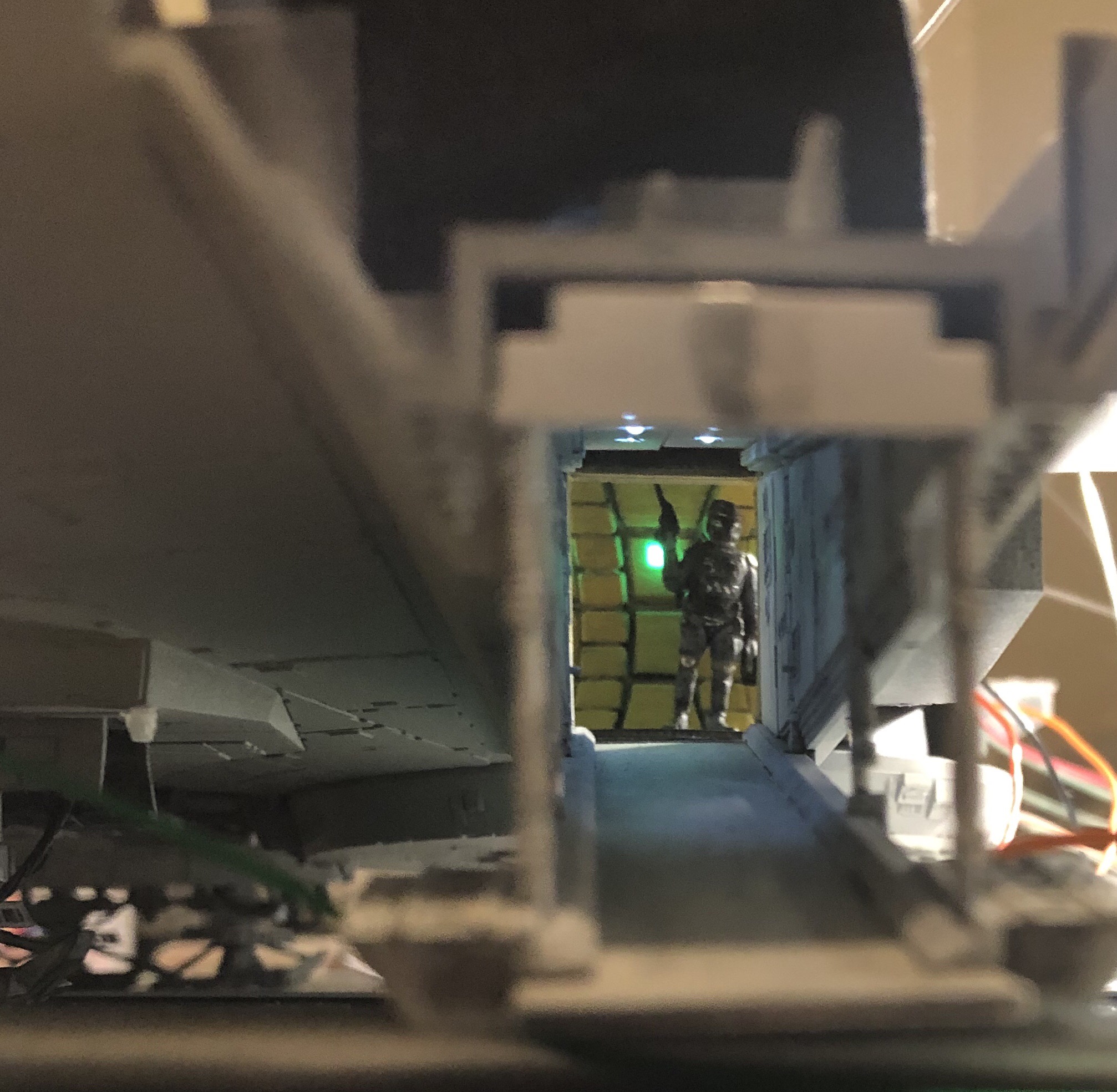

Actually I experimented with some ideas like this back in February. They were kind of difficult to print, owing to the resolution. And dependent on the quality of whatever you put over top. So I sort of put that idea on the back burner for a while.

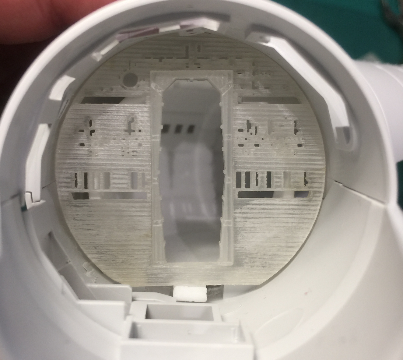

The corridor was a particular pain. I could have released it, and said, "you'll have to figure out a good way to glue it in place yourself", but I wanted something that matched the geometry of the Bandai cockpit floor a bit better.

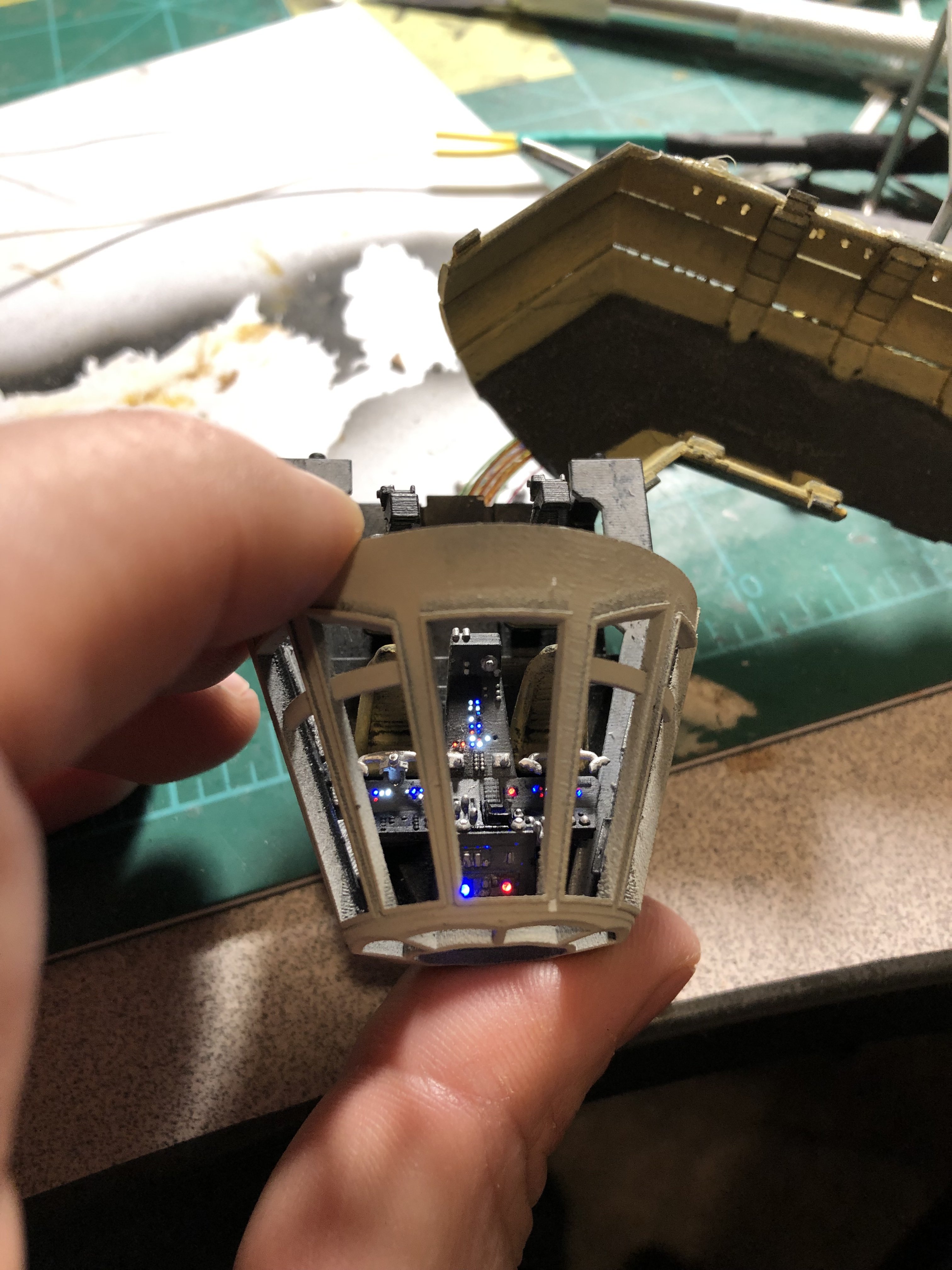

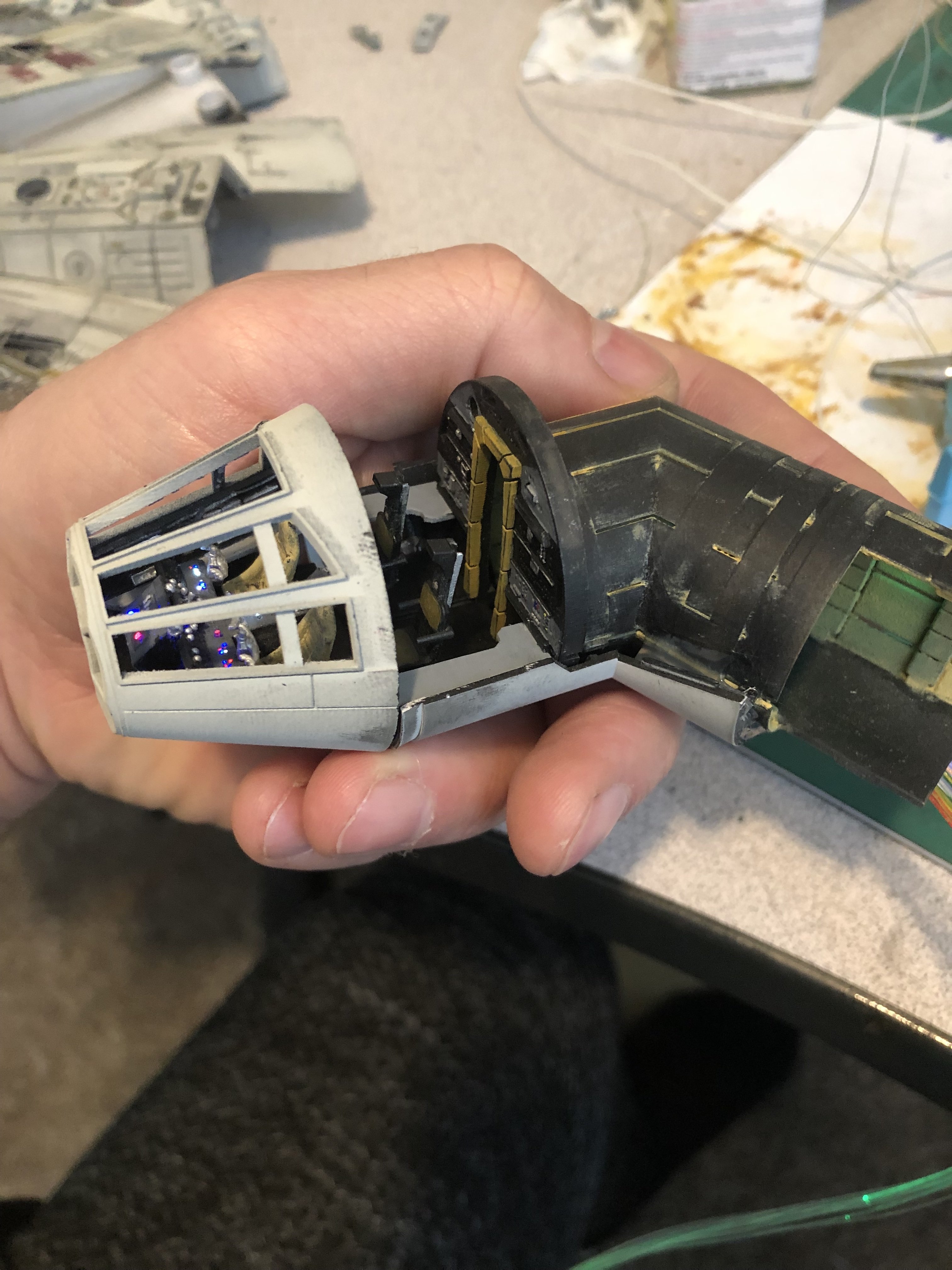

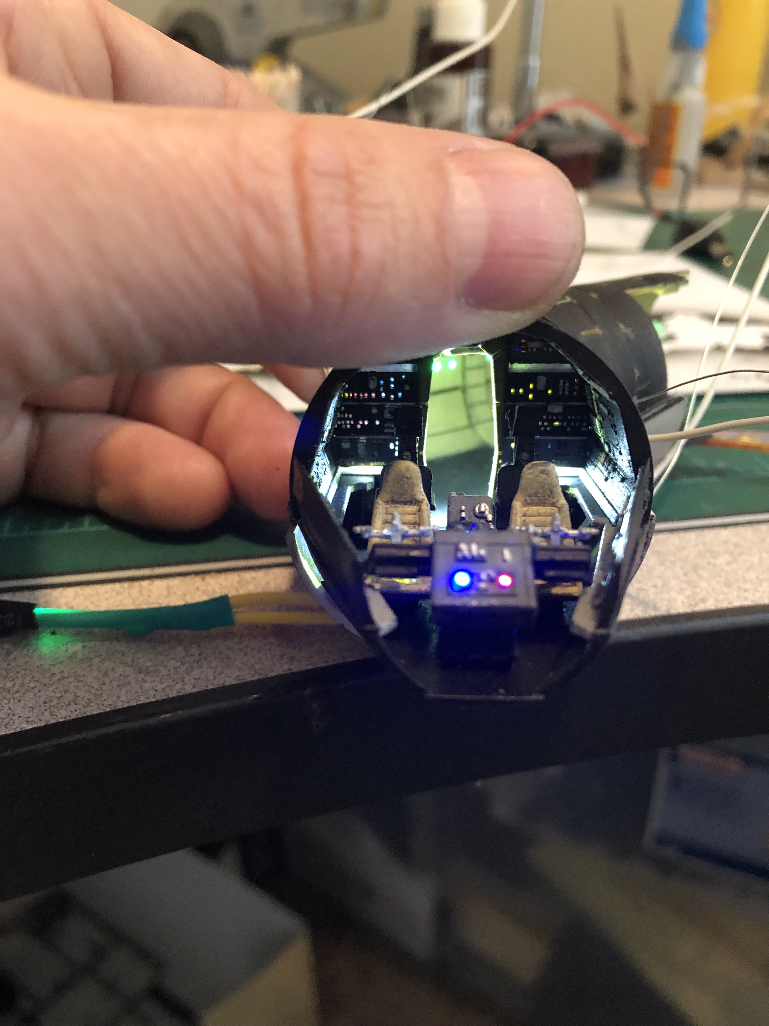

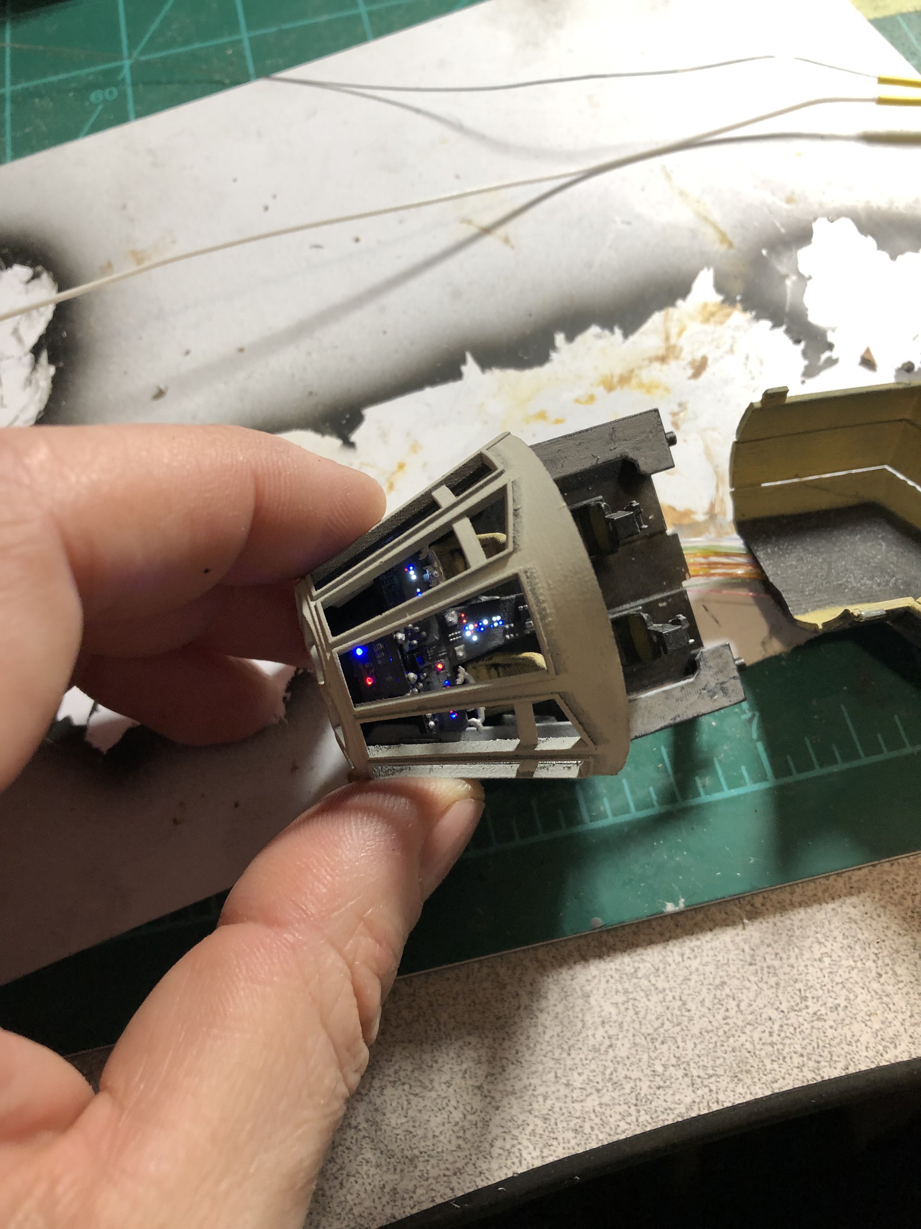

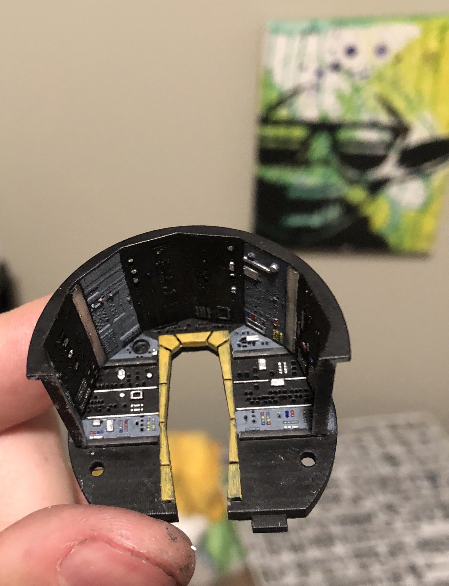

Back to work on the PG Millennium Falcon... I ditched the kit parts for the nose cone and cockpit and will be using 308bits parts. The reasoning is simple... When I went to put in my own custom lighting for the cockpit, the two halves of the cockpit cone would not fit together well enough. And I was not happy with how the interior turned out with my first run. So here's the updated version.
13CBF415-74AF-4C79-9999-9620E59E00A3.jpeg 5F0501FA-CD95-4FD2-B9E8-E9ABD7F770B9.jpeg 98D145DC-9A8D-48D7-BBA1-F9E9BCC17923.jpeg

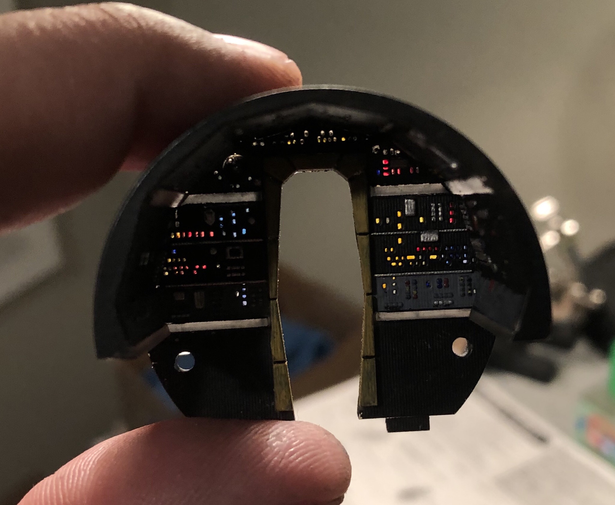

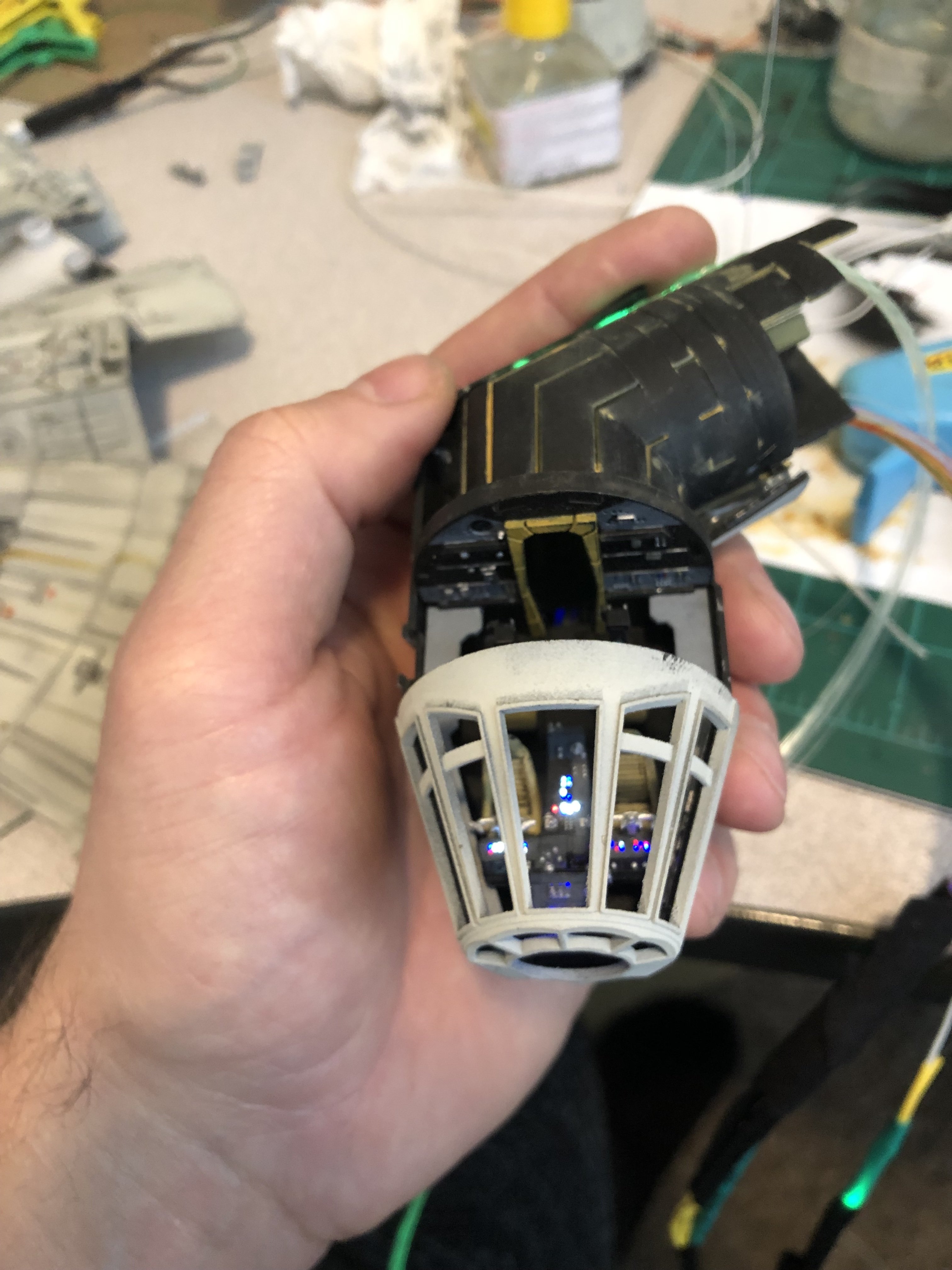

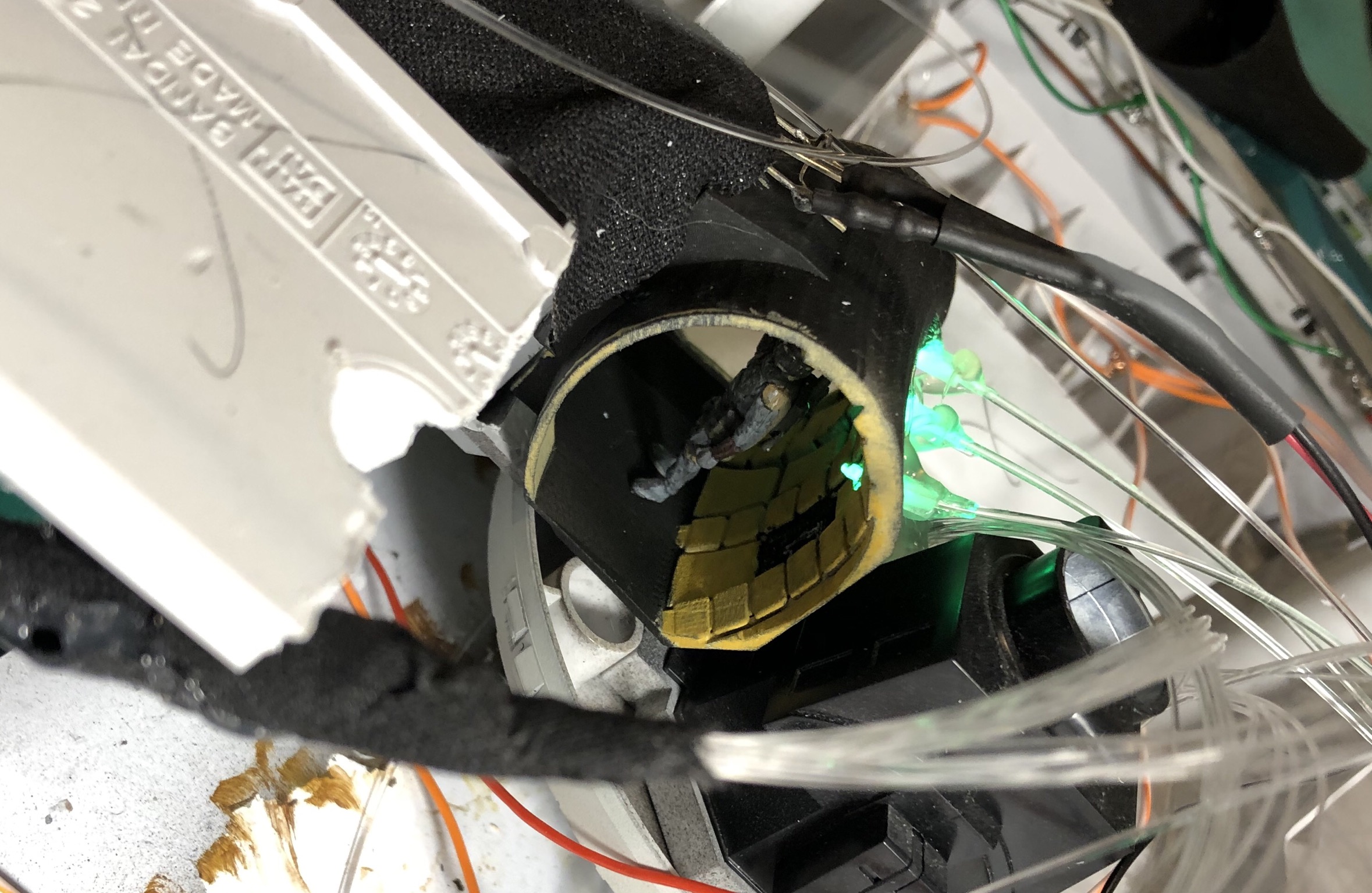

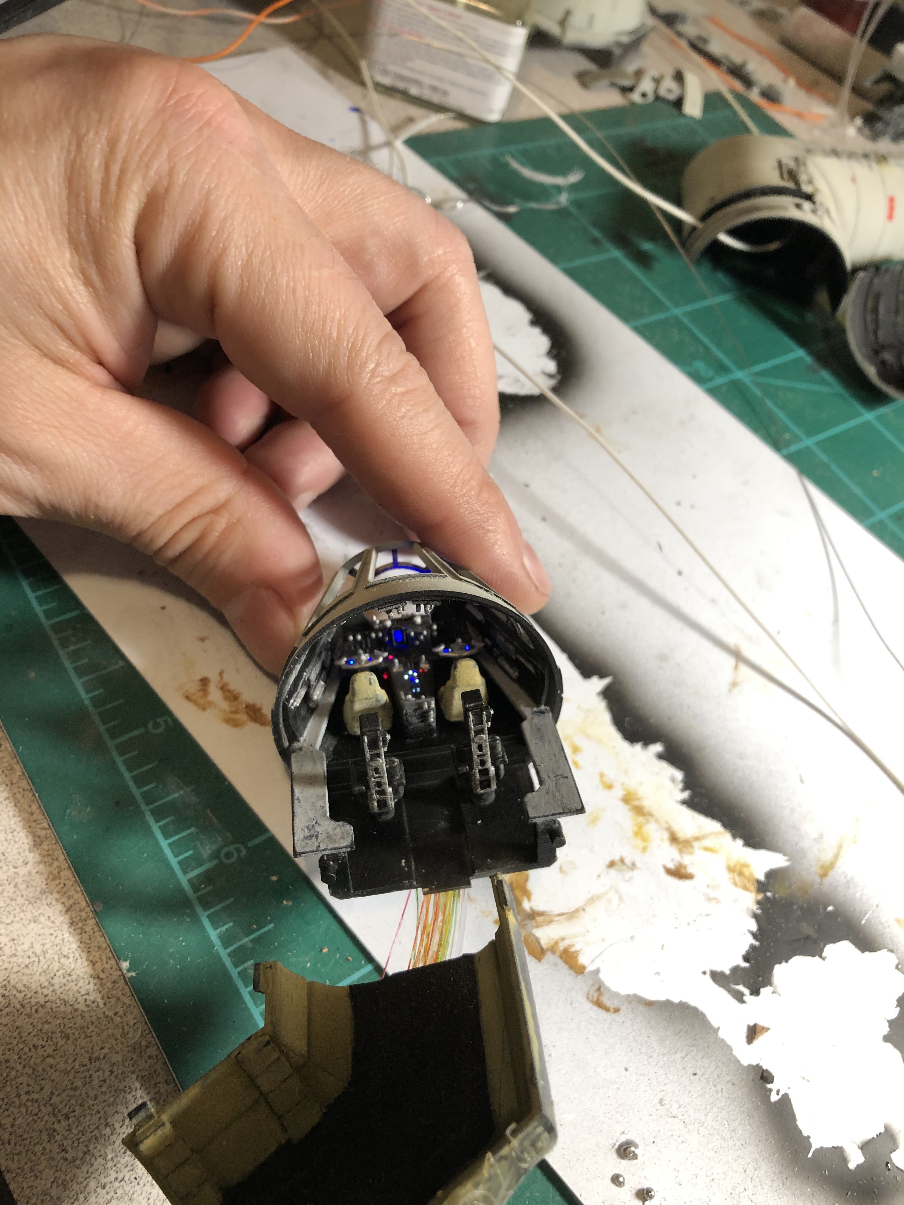

More work on my cockpit... It's always fun working out how to light the interior... I think my solution will work well... Especially with having the corridor behind the cockpit..
B4BBA430-B391-4F7D-9724-6F7F9E80883A.jpeg DBE300BC-0A33-4B6A-ADB7-643739C8535A.jpeg
Pretty neat. I am assuming you used inks for the colors so the stuff remained transparent while regular paint for the walls?
I used Mr. Finisher 1500 as a primer base coat... then oils to add the gray and finer details like silver and colored buttons. On the back side of the cockpit wall, I cut out a piece of clear plastic and used oils, thinned of course, to add color to all the different shaped holes. I'll add some ambient lighting to allow it to come through.

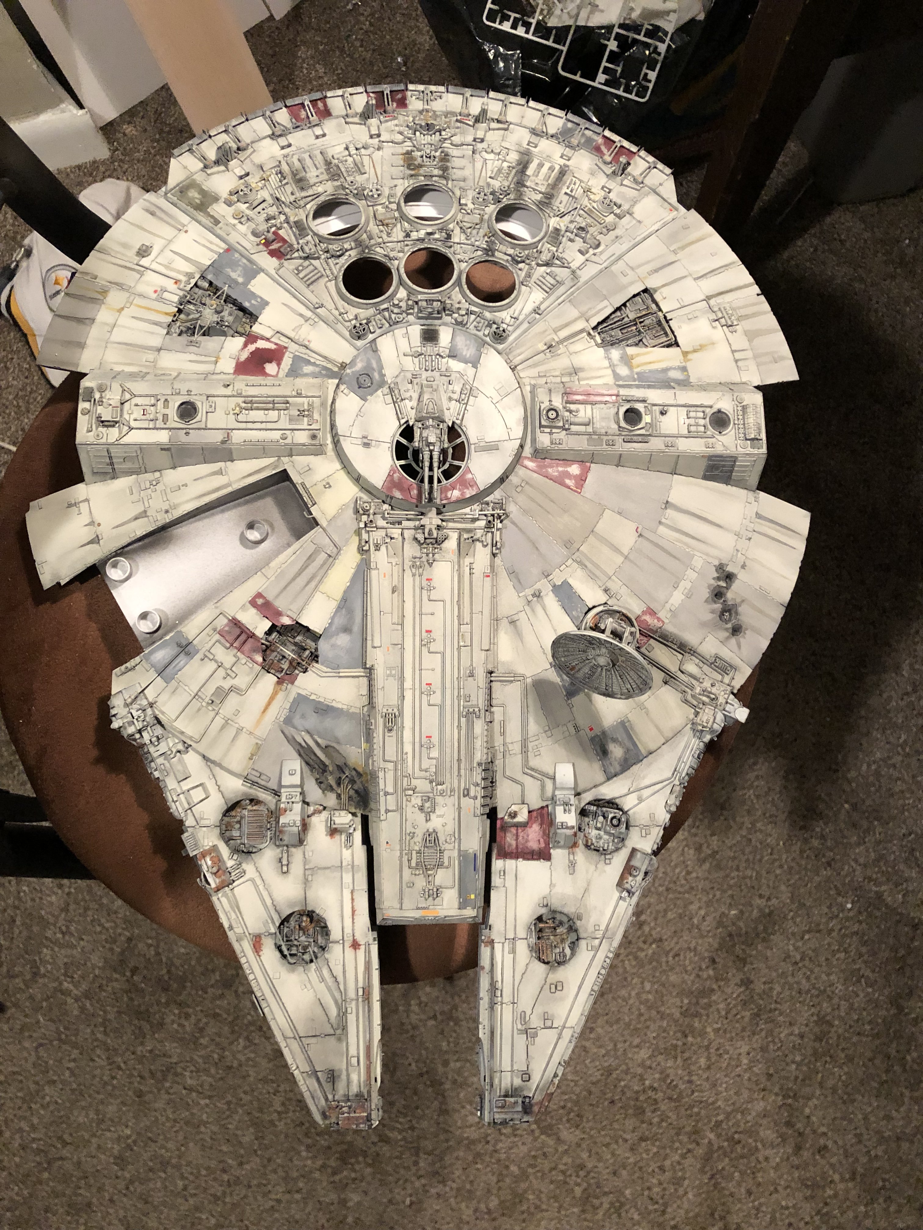

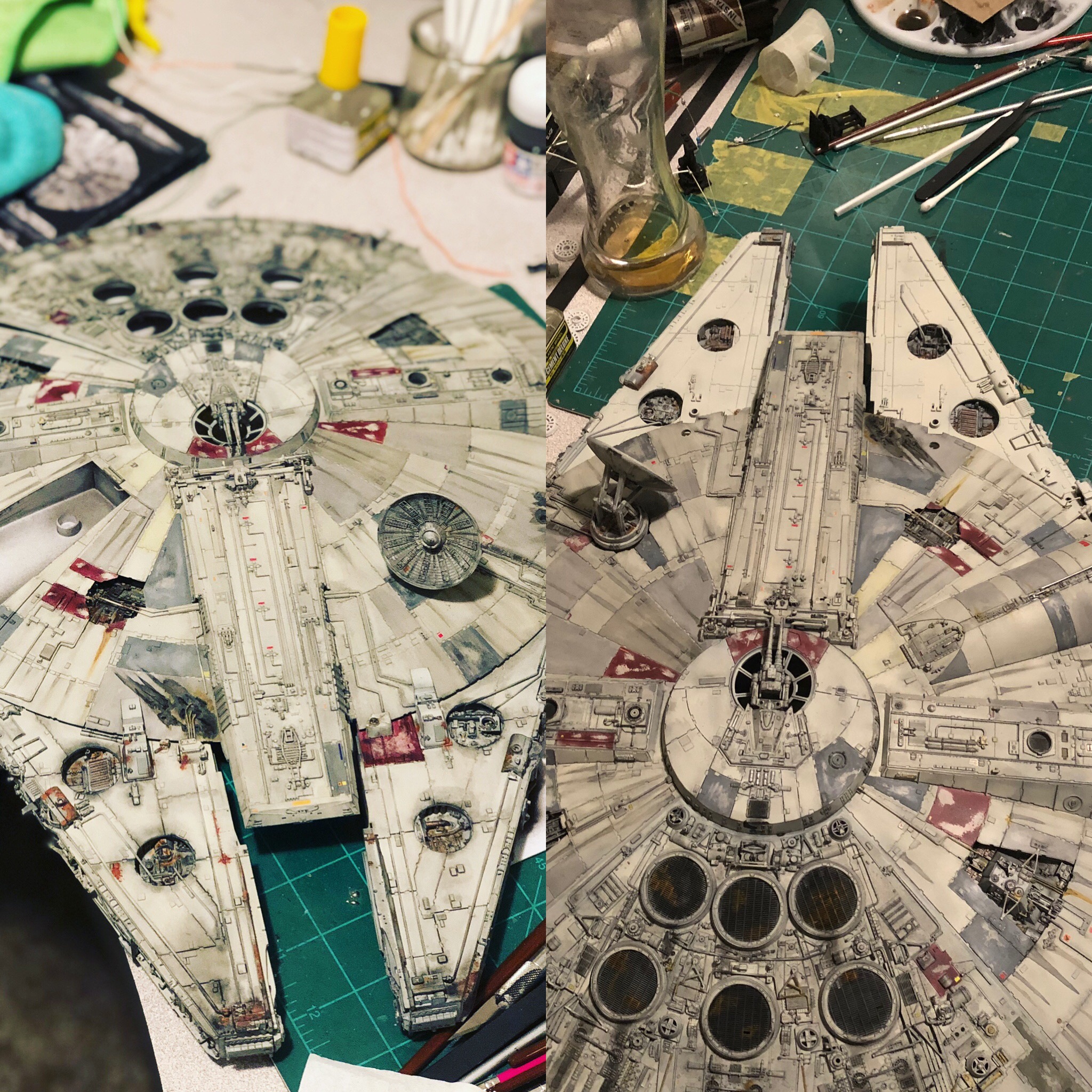

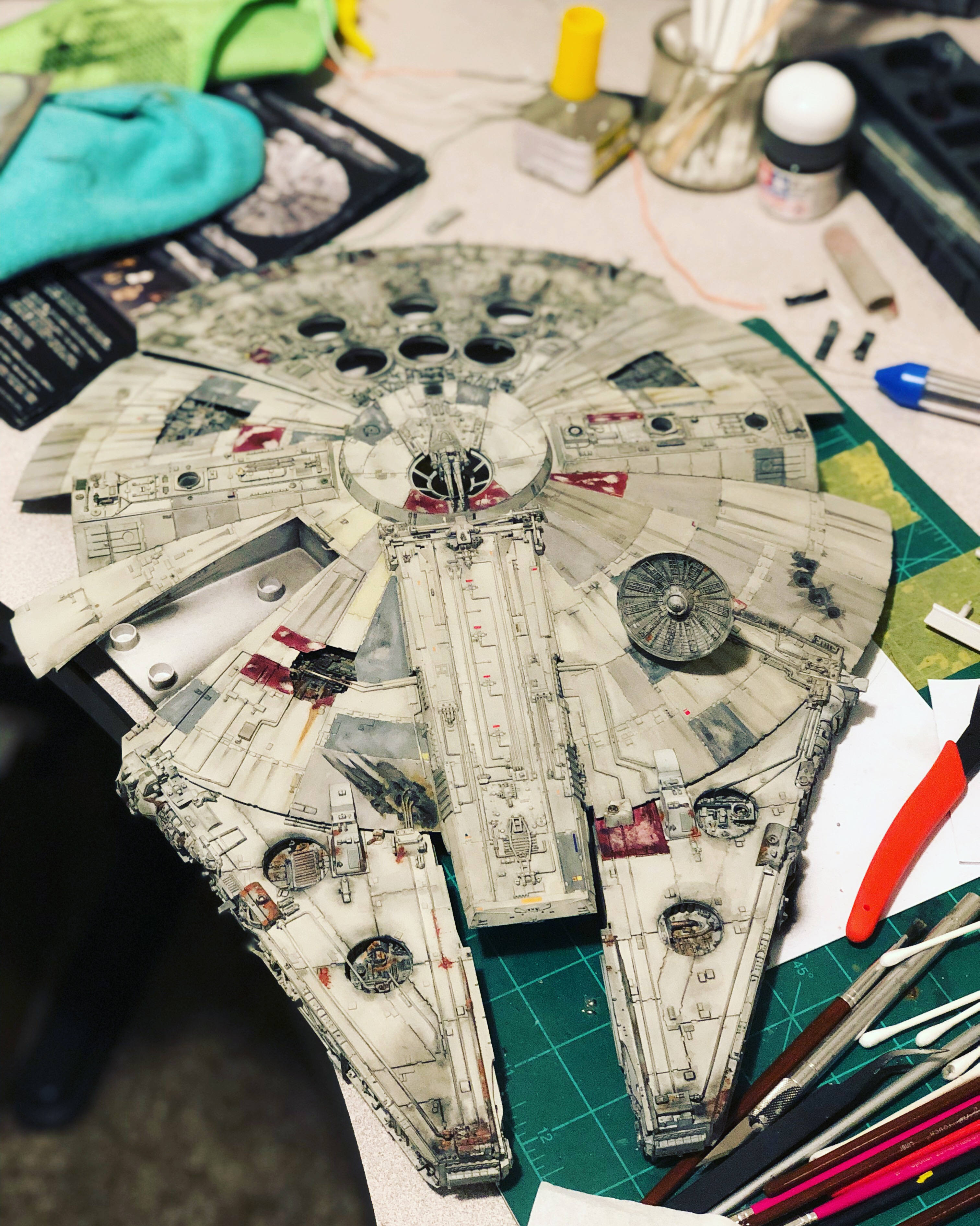

Here's a nice little comparison of the mandibles before and after...
The magic of weathering... The pic on the right shows the upper mandibles with no weathering. I did not add any more color other than using my oils and rub n buff. It's almost magical how transformative paint is... I love this process
Weathering looks perfect!
Thanks! I know this isn't 100% five footer accurate, but that's not what I'm going for with this build. So many wires and fiber, though...holy crap! good thing leds do not require much power...lol

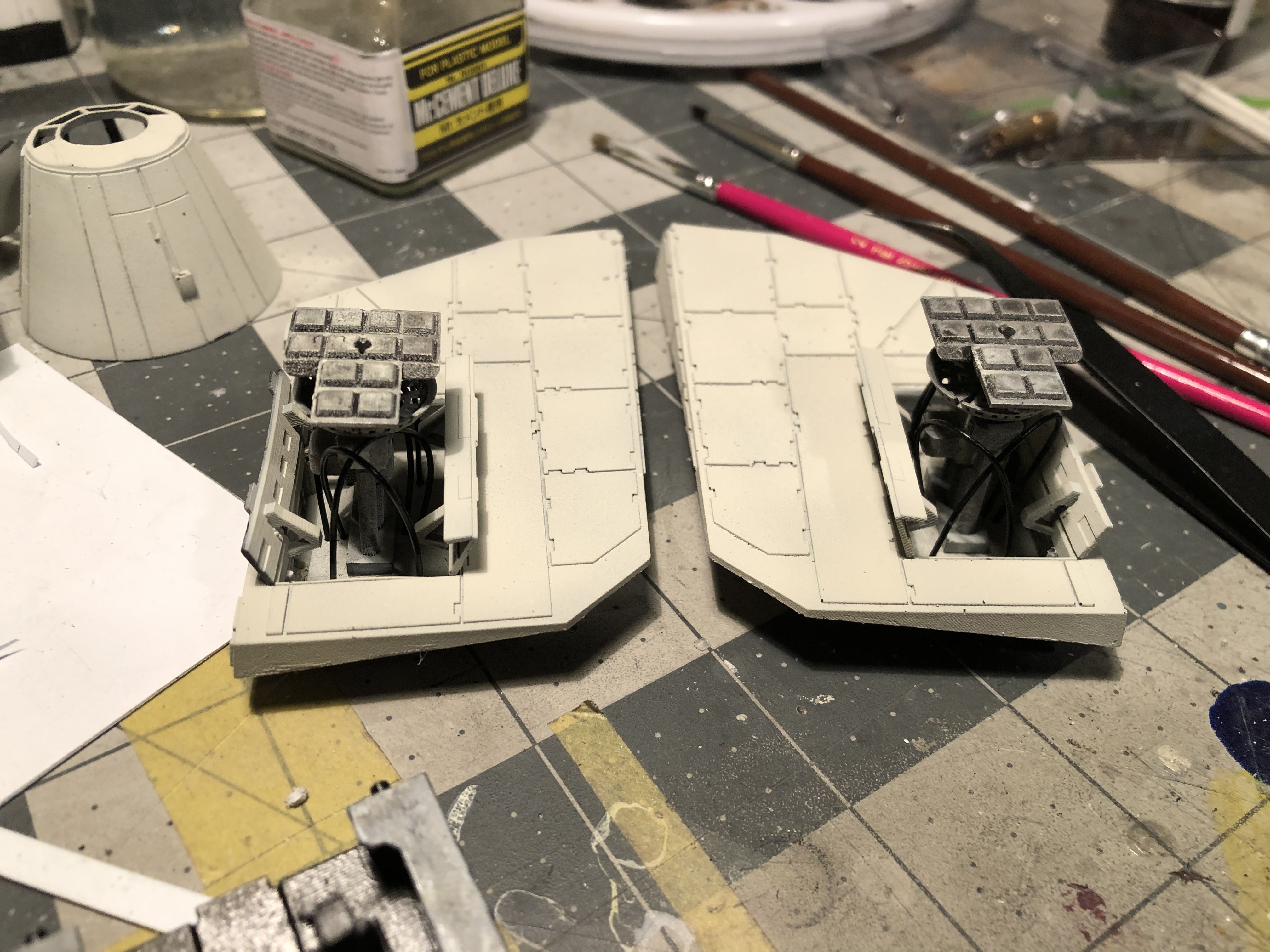

The lower maintenance pits come in today so that will be tackled this week and hopefully, I'll have a finished Falcon by the weekend.
