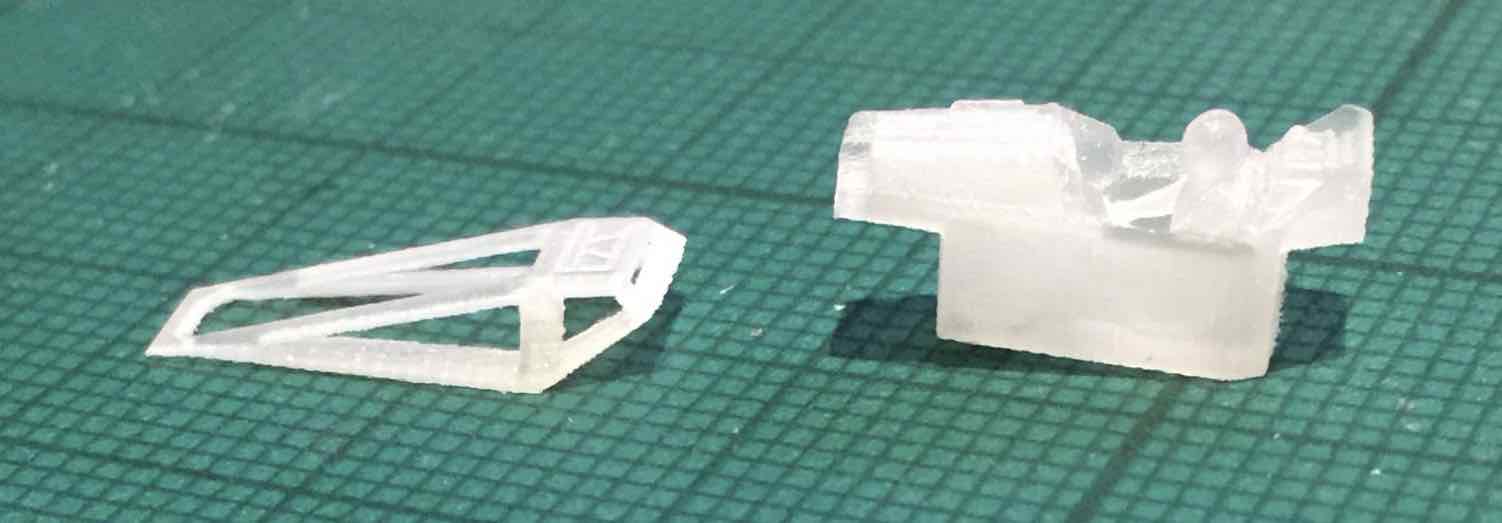

Actually, I planned on doing X-wing and TIE canopies and cockpits next. I went as far as making an X-wing one, but it turned out to be a real problem because the X-wing canopy struts are so thin. Makes it hard to make it actually 3D printable given Shapeways' current technology. I did some test prints but never finished it - the lower angle of the canopy frame is wrong here.
Then, because hardly anyone bought the snowspeeder canopies I dropped the idea. If nobody buys the thing then I never make back my expenses of doing all the test prints!
If it's any help... maybe just the cockpit? We can always trim out the canopy that came with the kit. I'll definitely be picking up at least two of your canopies... Just a matter of when I get to getting them. JPG is putting out a resin kit of the hoth shield generator that I can use for a diorama... a rather extensive diorama is what I have planned... So your snowspeeder canopies will be used for sure.
Well, I could make a cockpit, but the plastic around the existing Bandai X-wing canopy is actually fairly thick. So it'd be really difficult to install an aftermarket cockpit unless you cut out the whole canopy area anyway. As for the snowspeeders - yes, I was a little surprised. Since they're scaled to the Bandai AT-AT I thought there'd be a lot more interest. And some people have done some fantastic work with them, putting them into dioramas. :)

I know what you mean about the X Wing canopy size for printing, I struggled to get one half decent canopy for an E Wing, Then dropped and broke it:lol and that was 1:72 ish scale

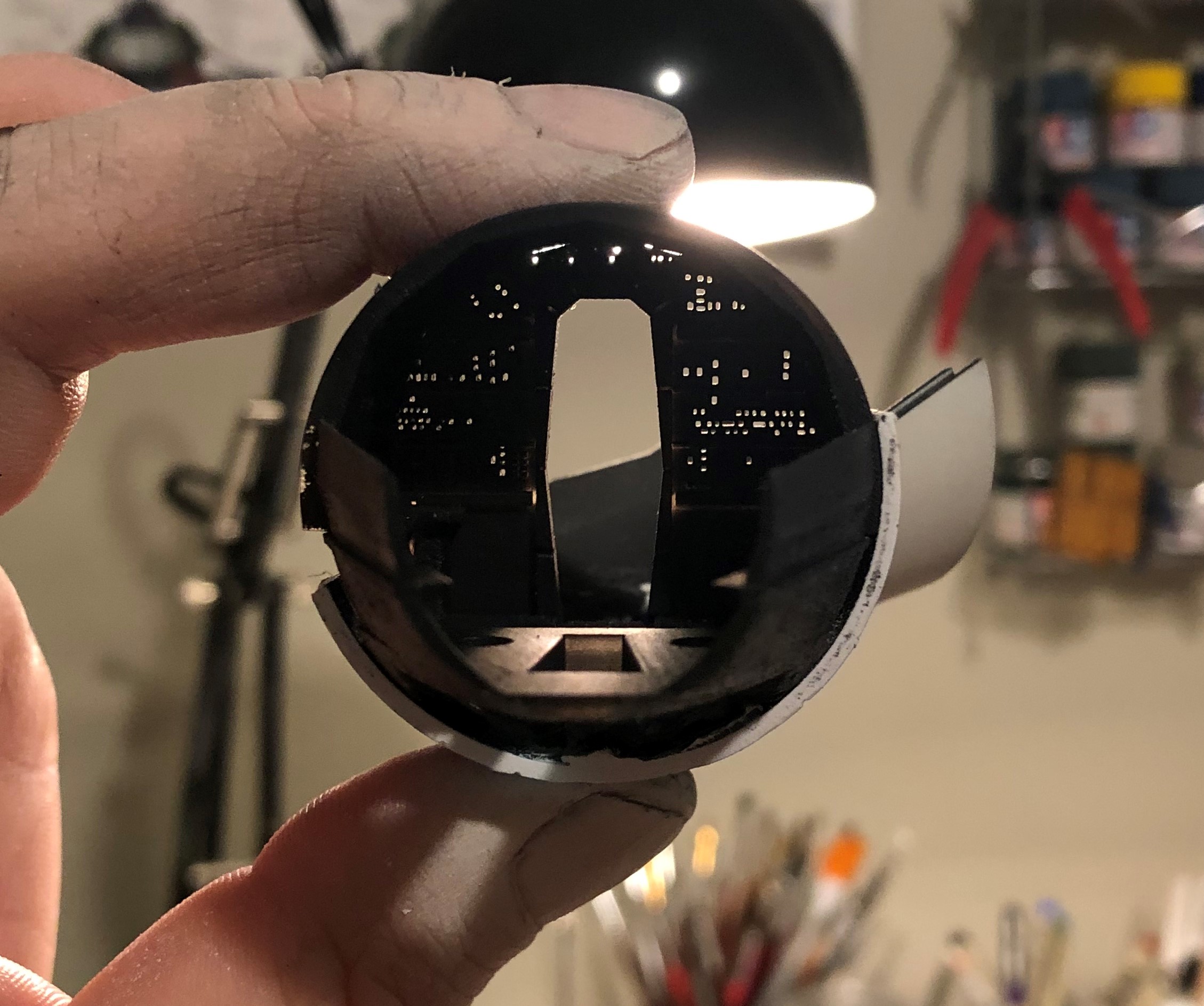

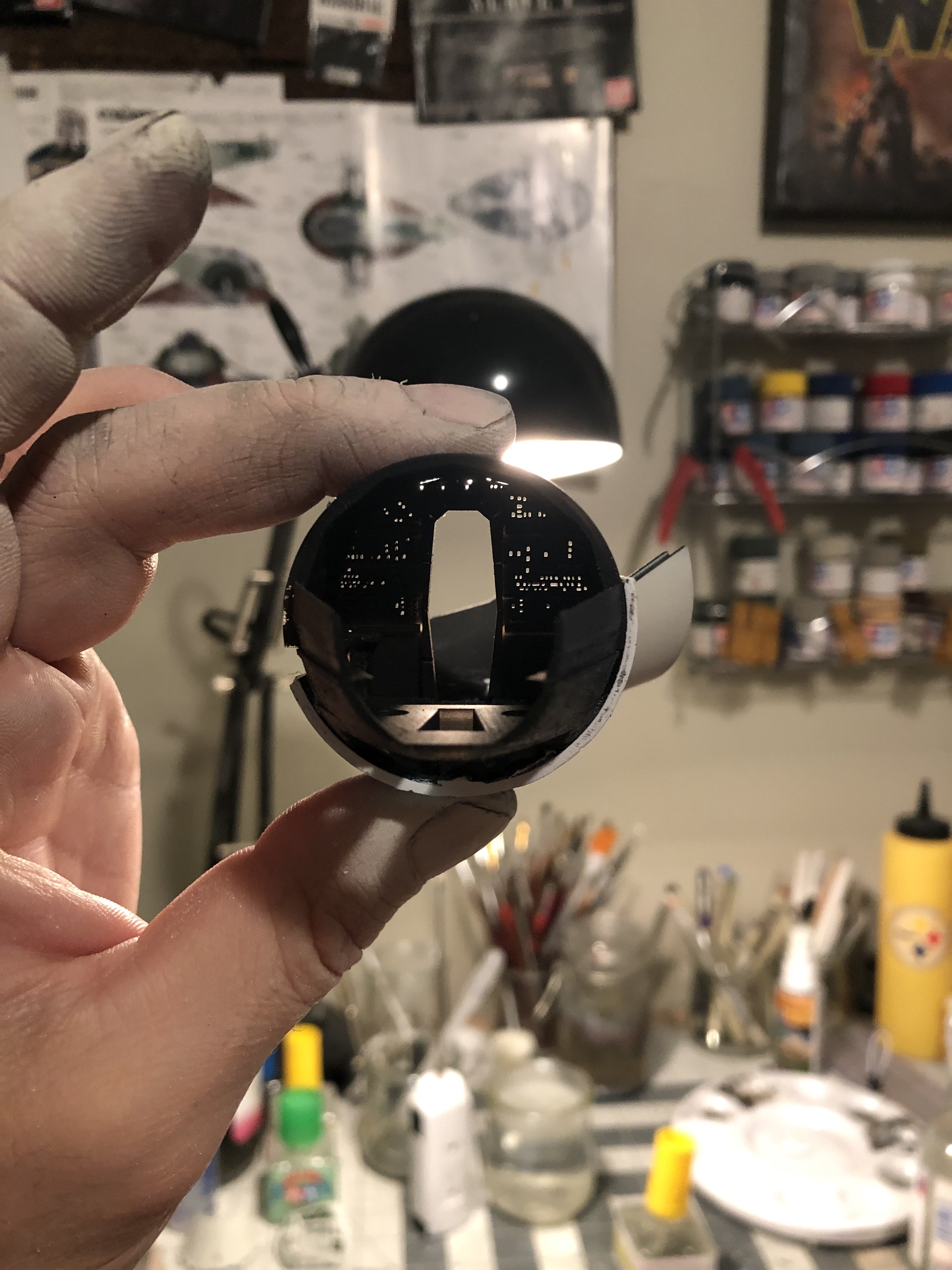

Well... I was unhappy with the stock cockpit cone, back wall, etc... with the extensive removal of all the plastic bits in the cockpit tube, in order to accommodate a hallway and lighting, the two-piece system that Bandai provides was not fitting properly. So, I ordered 308bits full cockpit set including the cone, back wall, sidewalls, console, and seats. I am much, much happier with it! In order to make it removable, I will be using some small magnets to keep it in place. Those pictures will follow once I get the magnets in stock.

The instrument panel sure looks nice. especially having rectangular openings for the lighting to shine through instead of just round ones you get using fiber
It does... so I need to come up with a back panel solution that doesn't require me to pull through round fiber...
Yeah. I'm working on a few ideas for that. Fibre dots, even 0.25mm, are too big and round to look right at 1/72.
Would photocopying the insrument panel and glueing the copy to a standoff panel work? Drill holes in the rear standoff panel for fibreoptics (fiberoptics bigger than the square holes) and butt it up against the hero panel. Or maybe nkg could do a panel with round holes in the back and squared off up front. If you get what I mean
