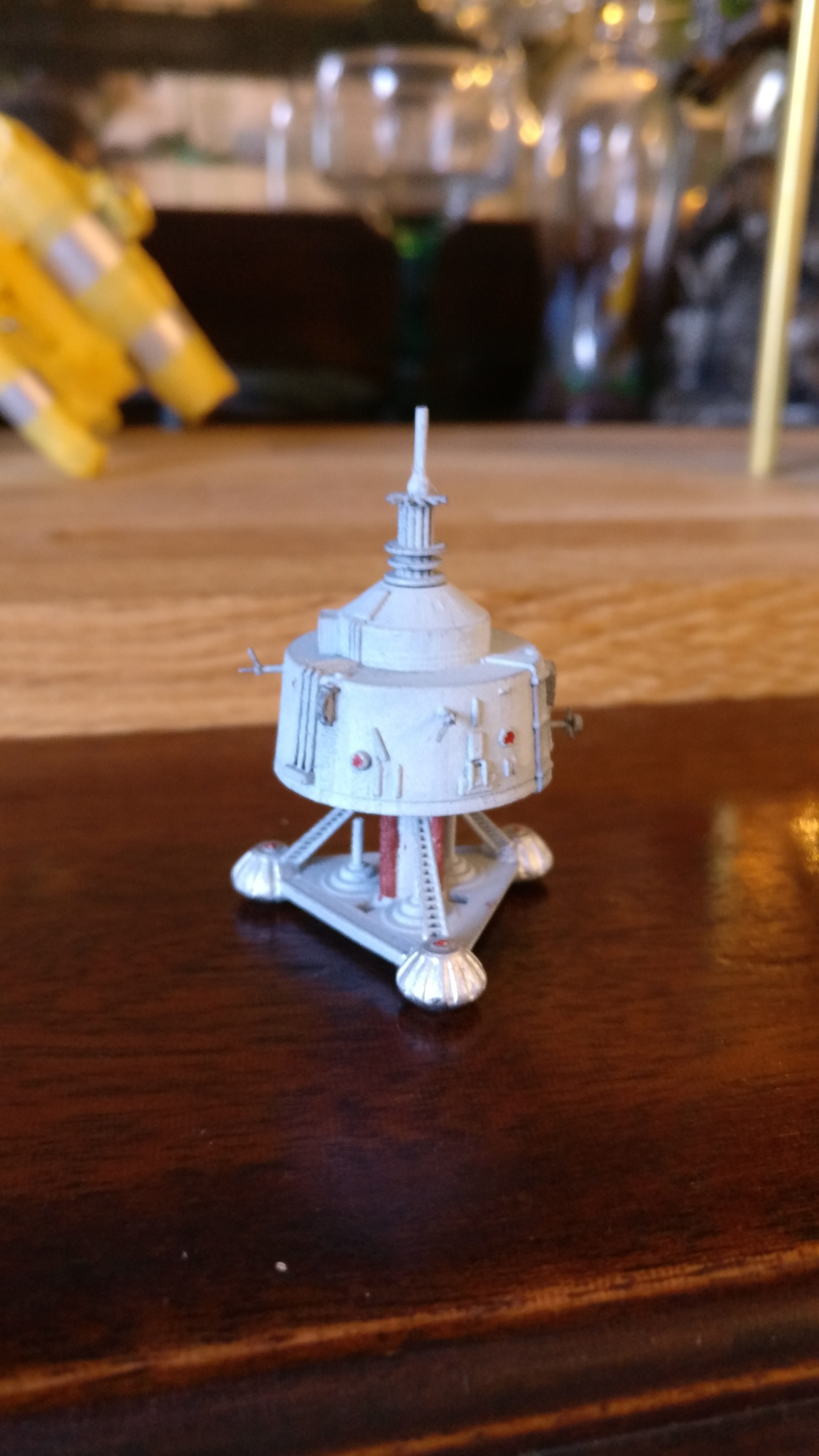

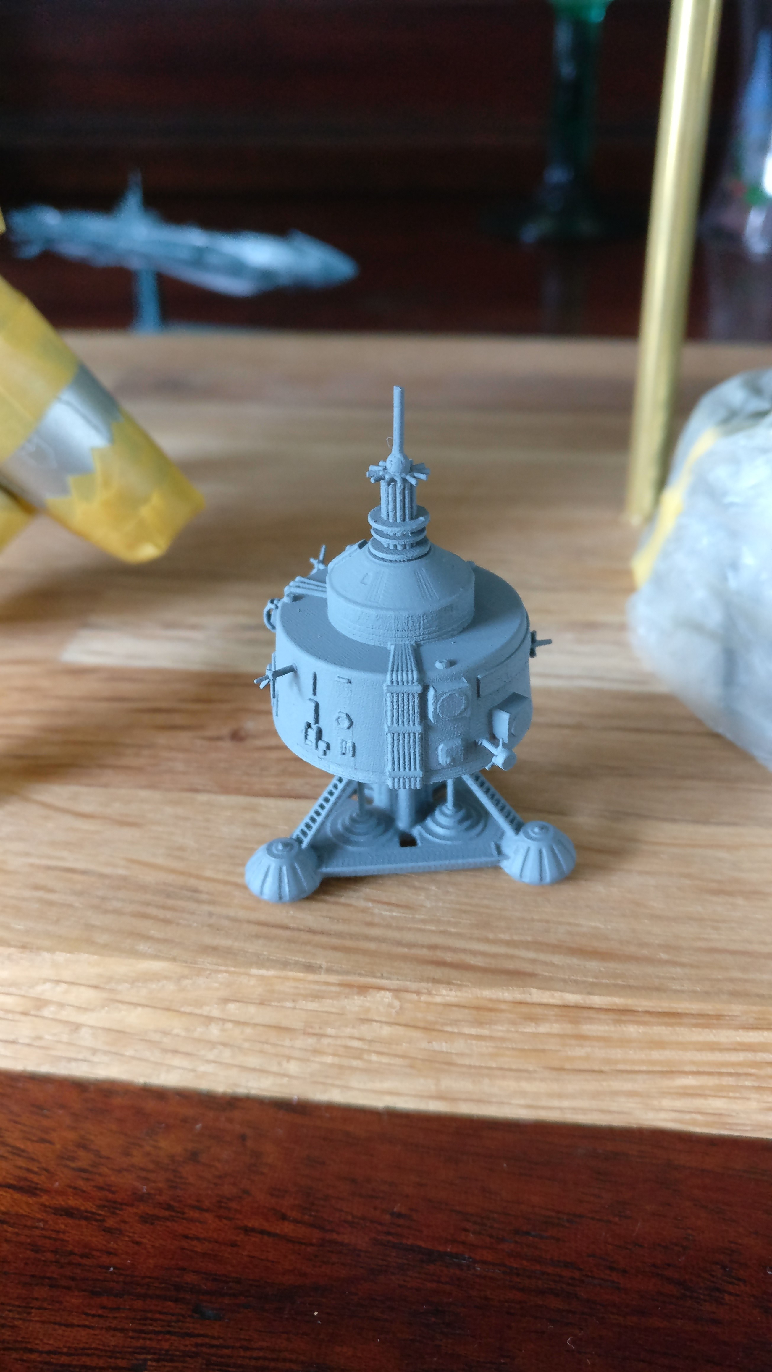

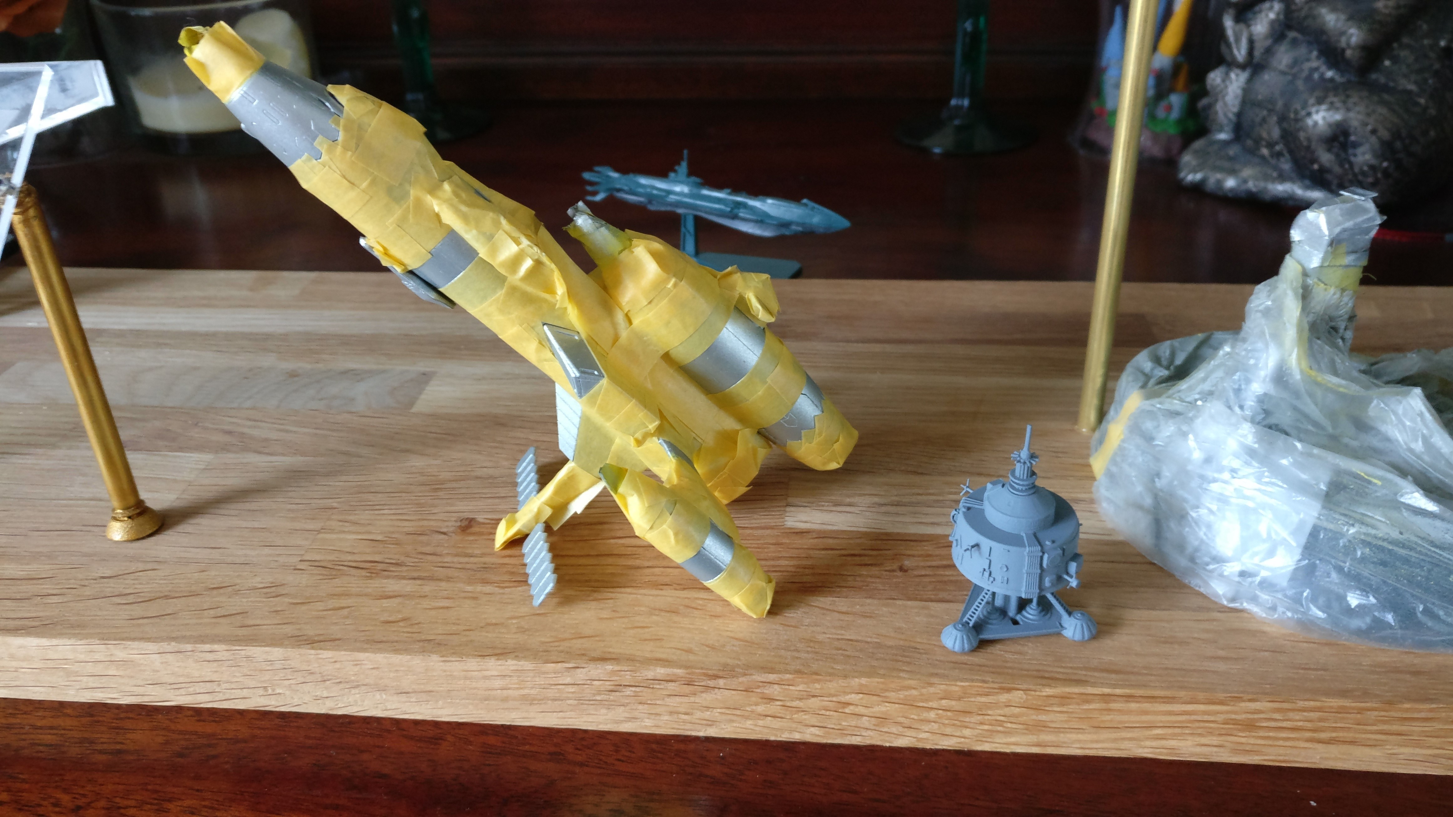

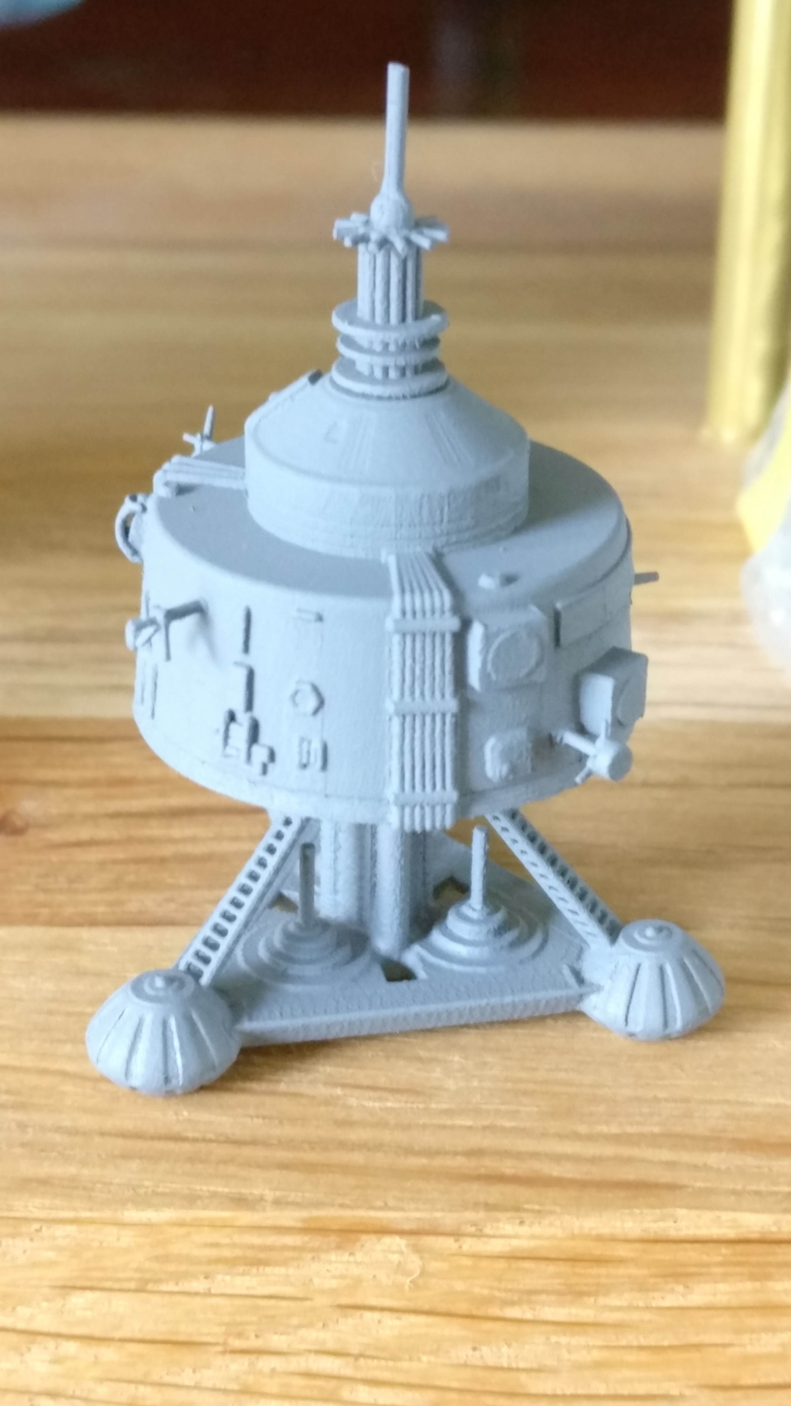

The Palomino has arrived and had a coat of primer. Now waiting on my new airbrush, so I can get on and finish this project.
Also did a bit of masking on another, smaller kit I've been playing with. Non-standard colours for this- I'm not into pink spaceships...
]View attachment 755383View attachment 755384View attachment 755385
First time I've seen her painted up too and she looks even better just in a coat of primer. Can't wait to see how she comes out. My collection doesn't fear the feather duster, but I have lost 9 Vipers, an F302, a Sulaco Dropship and a couple of Delta Flyers to HENRY.

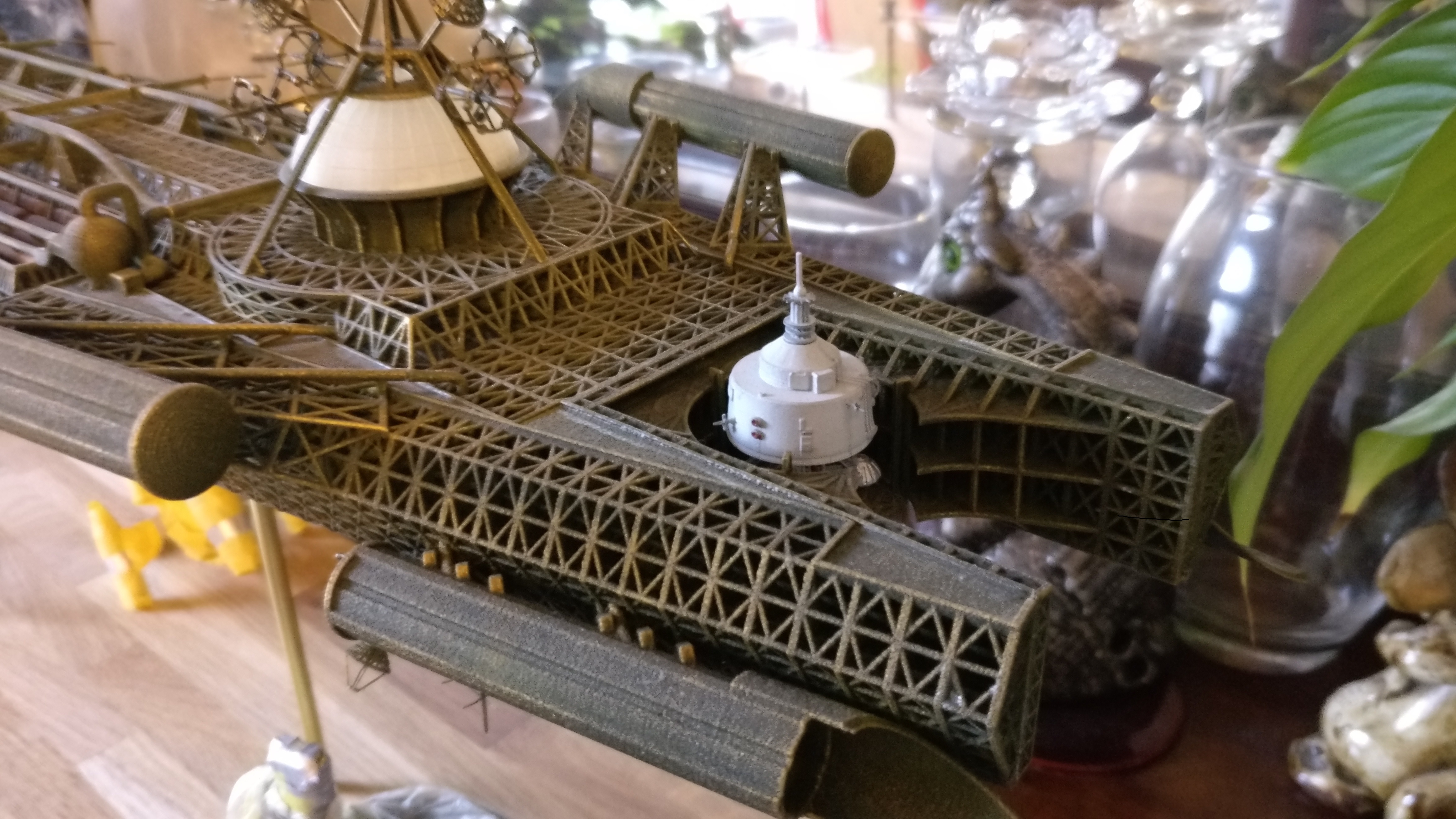

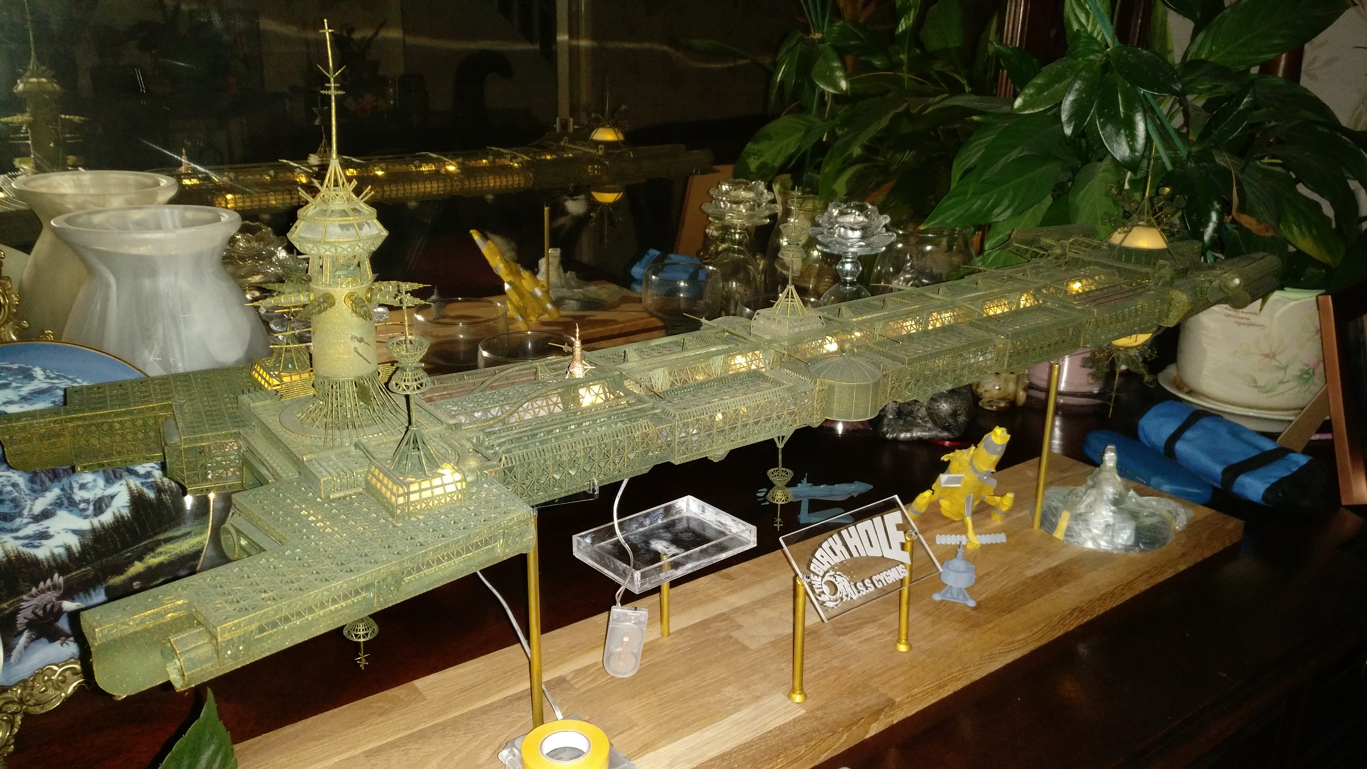

Wow buds,
That night shot is just sheer unadulterated model porn lol. Really liking the stand too and the etched plate, it's an awesome build overall with many other superlatives due and I'm glad I could help you finish her.
Marc

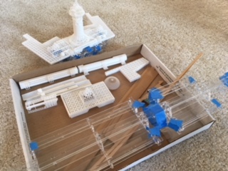

Does anyone have a >complete< and accurate armature template for the 1/700 model?
I have all the parts and no armature to put it together. :/
Unfortunately there is no "complete" armature. You have to figure the bow out yourself. It's relatively straight-forward though- just a box.I planned mine out using some tape to hold the bow together and then shoving a ruler up the inside to take measurements. Put everything down on paper and it makes sense.
I have the laser cutting plans for the stern and main body, if that helps.
Yes, I'm just getting started. I've received my prints from shapeways (stern parts only) and I'm researching the acrylic hull and what all goes into lighting it and how the printed parts fit around it. Also still getting used to understanding the terminology for each of the parts/assemblies.
ive got the hull cut in acrylic already but still need to have the stern cut and then the front once I purchase those parts.
im really excited to get this project underway!
mike
Good luck. Lighting is straight-forward, just run the circuit around the inside of the acrylic frame. Be sure to test the lighting before sealing it all up, also leave some slack where the wires pass through the centre hull, into the bow and stern sections. You'll understand why when you come to assemble it all.
Some parts are no longer available on shapeways-if you need them-ask.
Marc can supply the antenna,probe ship and Palomino.
I've got the top spine stl file etc.
Shapeways won't print this last part, however, but "imaterialise" will.
As for parts fitting, I found starting with the centre hull was easiest. Build your centre section, then fit the painted, printed parts over the top.
You will need to drill the stern, where it connects to the centre hull, as the connection is flimsy and droops.
Before you start adding the command tower and antenna, be sure to have a rudimentary stand made up. These parts are both very delicate and very expensive.
As the model ends up quite weighty, these parts WILL break-be warned!
With some thought you will end up with an absolute cracker of a centrepiece!
I'm always over looking at mine and the wife loves it too!
As before- good luck(post lots of pictures of your progress).:)
