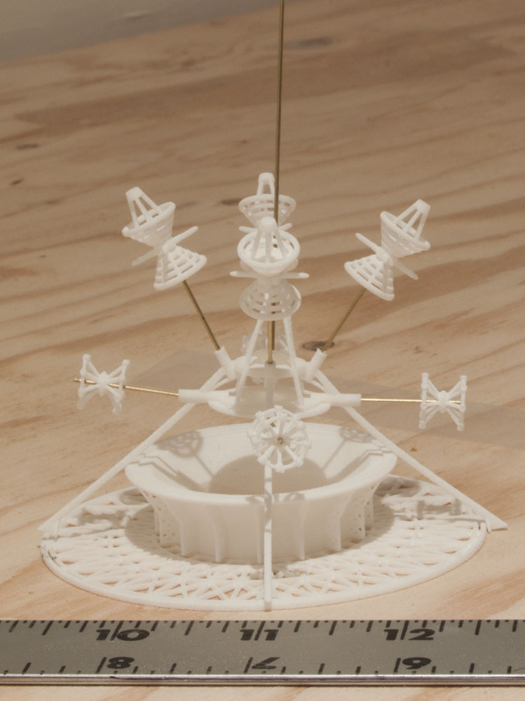

1/700 & 1/350 scale BH Cygnus builds

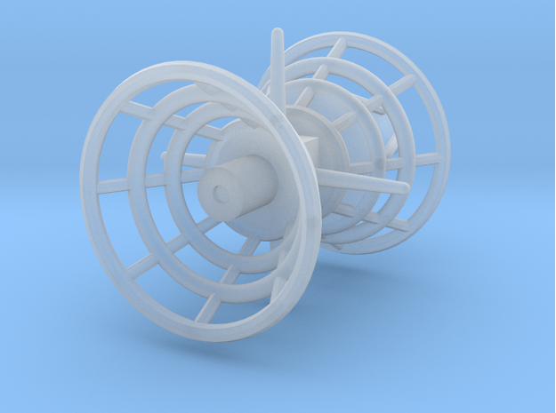

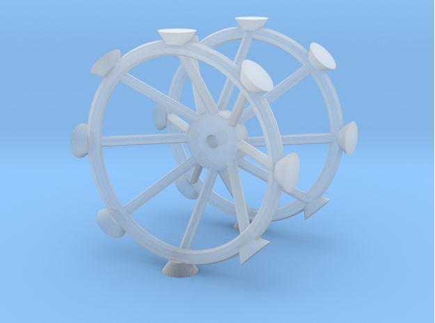

For now, I've just put these up too - the two kinds of observatory antennas. Been promising that for nearly a year. Sorry dudes.

But...AWK...looks like I forgot to mention some stuff:
1) this is all 1/700 stuff for Dave's kit - probably obvious but in case anyone's just skimming this! 1/350 guys, I'll upload more stuff soon as I can
2) for the 1/700 antennas I'm not 100% sure the size is right. Best to order in a cheaper material first off to check that. SORRY
Dave is using proportionally different sizing to mine for the regular antennas. They're a bit bigger, in scale. I've based the lower row off his 'regular' antenna just messed around a bit, and the upper row are based off my 1/350 version, rescaled and reworked. I've scaled them both to match his regular antennas, as best I can - in his build pics it looks like they're all around a thumbnail in length. Hopefully it'll be close enough. If not, this is my fault and I'll buy you a replacement set.
PS meant to add there is data in Dave's spine and fuel module files. It is riddled with errors though and won't open normally. MeshLab is able to work with it, but it could take a while to get anything usable out of these files. Is anyone actually waiting on a 1/700 upper spine at the moment?
Ah crud, SW just rejected the upper row antenna after a manual check. They're doing the lower row ones now, and will probably reject those too. The rejected elements are rods I ported over from Dave's model, unchanged - it's Shapeways which has changed; they've yet again increased the minimum size for wires/rods.
So I'll have to go back over these and reupload, looks like. The fixed versions won't be quite as "fine". Sorry.
