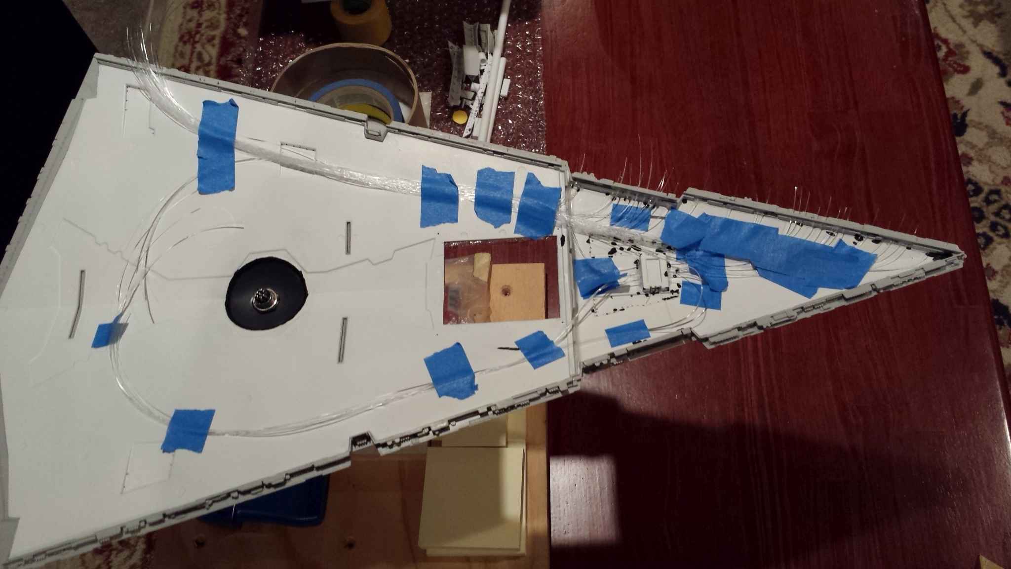

Yeah I was using .5mm
I've been using mostly .5mm and found it easy to bend and work with. I will also be using some .25mm and .75mm
You have to keep track and tape them down before gluing. I tape 5 to 10 down the way I want it and do another 10. Once I'm done an entire section I glue in place. I have been leaving the tape in place because I will go back and neatly bundle all the fibers up in several trunks to connect to the LEDs. I will also wire tie the trunks in several places and glue that down so they will not move. I like everything to be neat even though you will not see most of it when done.
looks neat an organized, as opposed to the mess I made earlier
Thanks!!
I'm trying to keep it that way.......bring all the fiber back in 1 or 2 bundles on each side and 1 in the middle to individual LEDS for the bottom section
For the top section FO I hope to do the same......bring the bundles toward the back and connect to LEDs that are mounted to the underside of the top section so you will not even see the LEDs or the FO.
The only FO bundle that may be an issue to keep neat and out of the way is the one coming from the command tower..........at the most 100 to 125 FO Strands

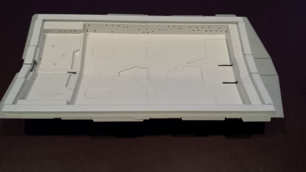

I'm making the large square top panel removable and held in place with friction from the skirt I glued around the underside and neodymium magnets. The tower will be glued to it. The Fiber will be left extra long so the top can be removed without having to disconnect anything.
This whole section will be removable: Where the bottom of the command tower is supposed to be glued down to the hull I will attach a strip of styrene to the outside of each side slightly lower so it overlaps the seam where it would have been glued to the hull. I raised the little edge on the hull where the bottom of the command tower is supposed to get glued to so the strip attached to the outside will over lap that connection point which I will not need to glue. Hard to explain
Skirt around underside with fit tight against the edges of the opening. Magnets will keep down and stop it from loosening.
That is the plan I hope it works out

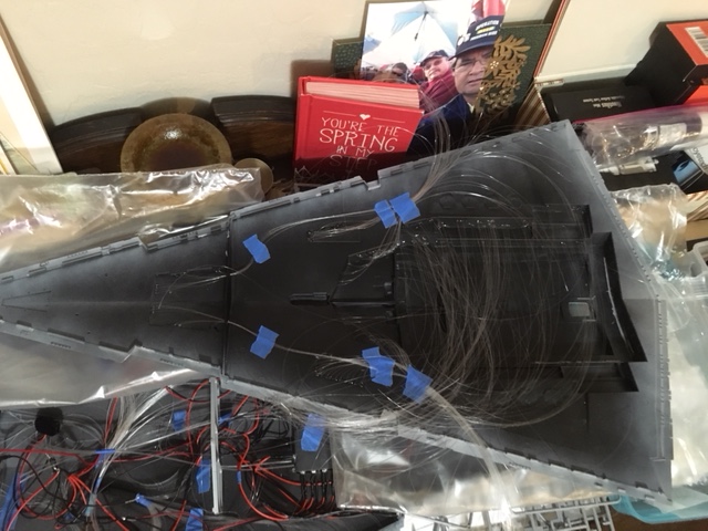

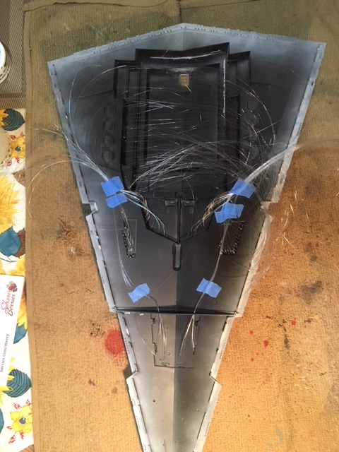

isd upper fo1.jpegisd upper fo2.jpegwell this is all I've managed to get done the past few days. Full front of the upper and down one side complete...except for any of the rear of the super structure. I cut 200 .25mm FO at 12", 20 at 15" and 70 at 10" and used all of it :eek Also did the PE on the command tower...forgot pics though. On advise from Escape, I'm attempting to keep it a bit more organized for the upper than I did the lower. so far so good
That looks great!
Bottom FO completed and I counted 165. For the top it will be approx. 250 and another 85 for the command tower. I've been cutting mine all long about 22" so I have most flexibility as to the placement of LEDs. The .50mm and .25mm are very cheap so I don't mind wasting to have that flexibility. I bought a roll (500ft) of each for a total of $21

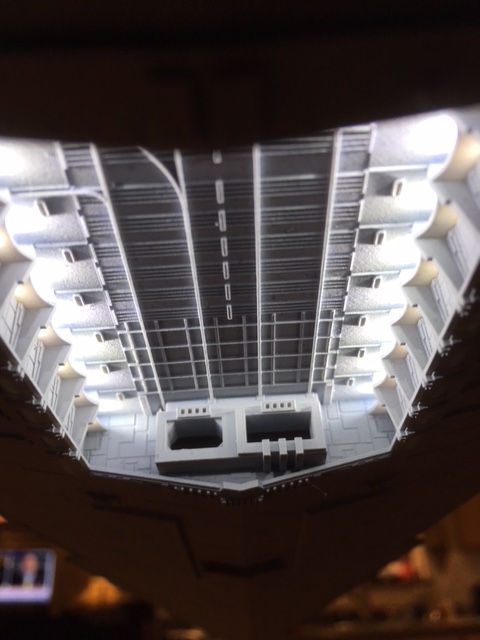

I really like how your hanger bay came out with the lighting......What size LEDs did you use for the hangar bay and what color?
I have the Falcon 3d upgrade (looks like yours too) and the hole size is 2mm and I was thinking of cool white. I'm also leaning on cool white for the interior lighting.
good morning my friend and many thanks! I'm gonna hate when this one is done, too much fun doing it really
I'm right there with you, I don't mind a bit of waste as long as it turns out right :thumbsup I'm following your lead on keeping it tidy. I'm thinking of keeping all the upper hull FO tight and close to the hull, setting the LED's glued to it, wire them all together and only have the two leads with plenty of slack to tie in to the lower near the rear. So I'll have 3 lighting "modules" if you will, to tie together at the end... the upper, lower and engines. I'm hoping to have it so I can hold up the upper hull level and not see anything hanging. glue the upper and lower together and leave my engine panel removable with the battery holder attached to the forward side of the engine panel. As soon as I'm done with the upper, I need to find somewhere to place the remote sensor and in-line power down button switch. they're small so I don't foresee any problems, though I believe I'll need to hide the sensor in the trench somewhere on whatever side I decide to display it, probably the right side.
I used 2mm LED (pretty sure bright white) for the Hangar, took quite a few, then used one at the forward end where those two secondary smaller openings are. then the 4 smaller holes at the rear (2 each side) I stuffed with 1.0mm FO just so I didn't have the dark holes. have you ever tried the Laserbond? It works really good for securing the FO to the hull but you can pop it loose again if you need to, and for gluing the FO to the collector tubes. slight twist, pull out, gently peel the old glue off and can be redone, nothing to destroy taking it apart. In hindsight I think cool white is probably the way to go. Some say that an incandescent look is better matched to studio models to more closely match the movie ships, but I calculate that in a galaxy far, far away...they didn't have that. Yeah, I'm winging it :lol

Your Hanger Bay looks great the way its lit. Under each scallop it looks like light is leaking under each one to show some light wall wash on the bottom section of each one. I think that looks great!!!!
I have the 2mm cool white for the hanger bay 18 in total......I sanded the tips and edges of the LEDs to get a more diffused look.........Good idea to put FO in the unused holes
