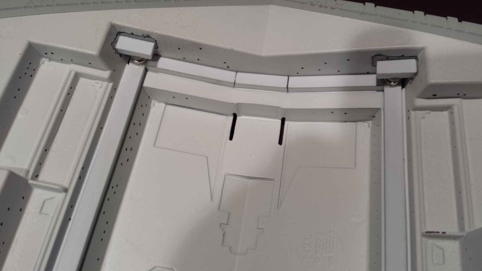

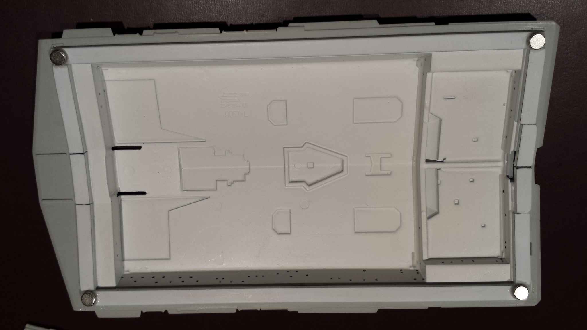

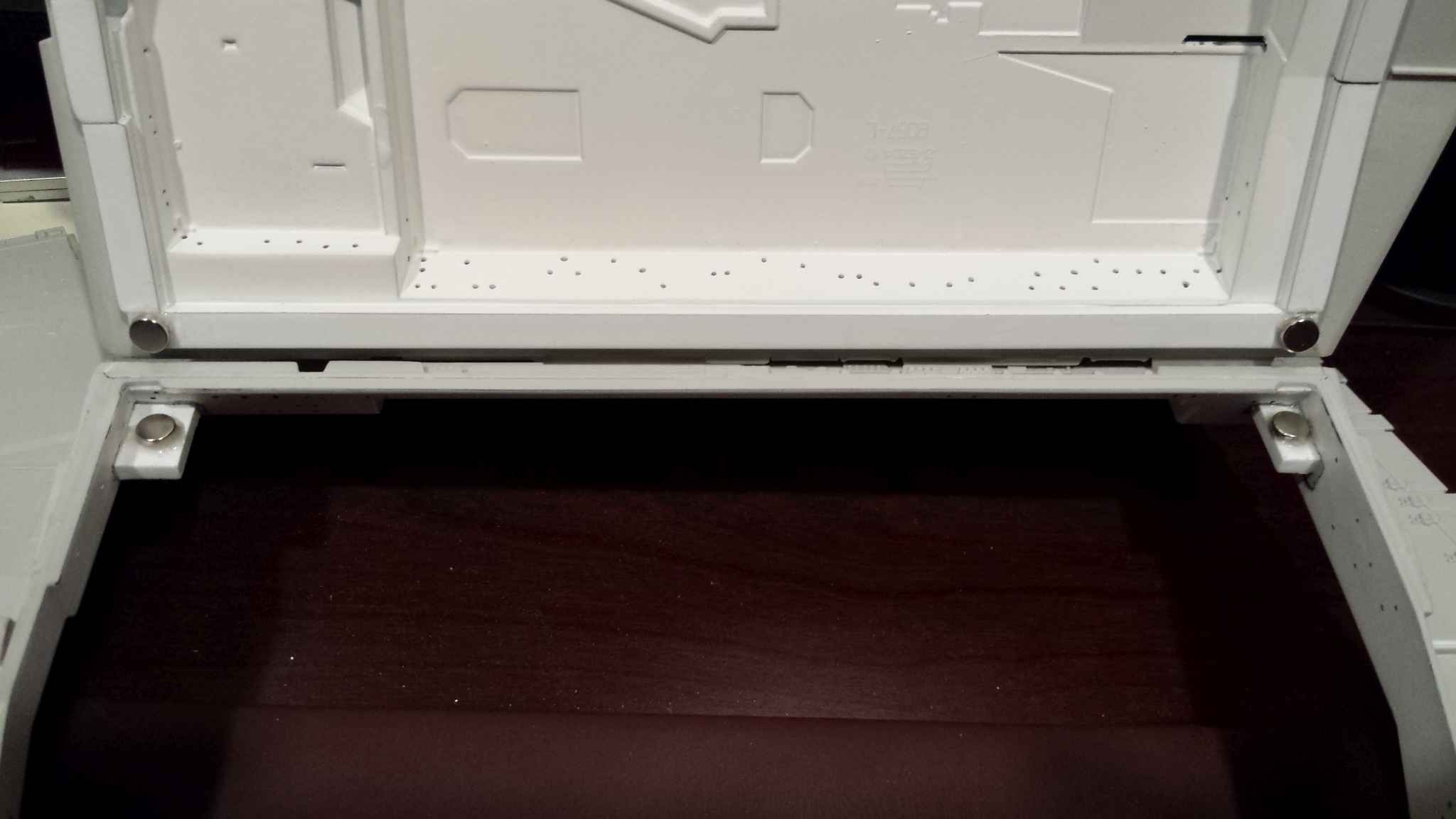

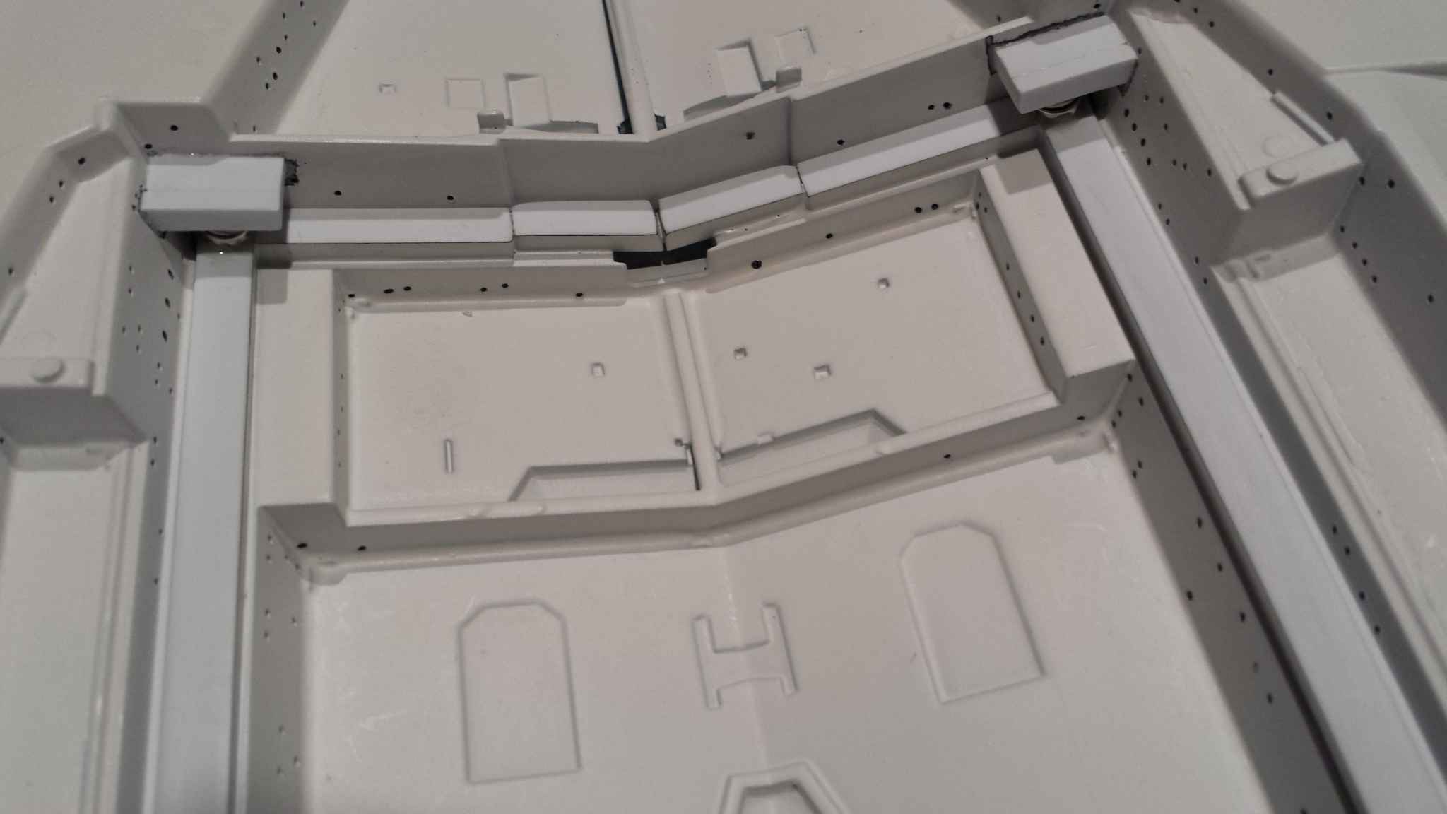

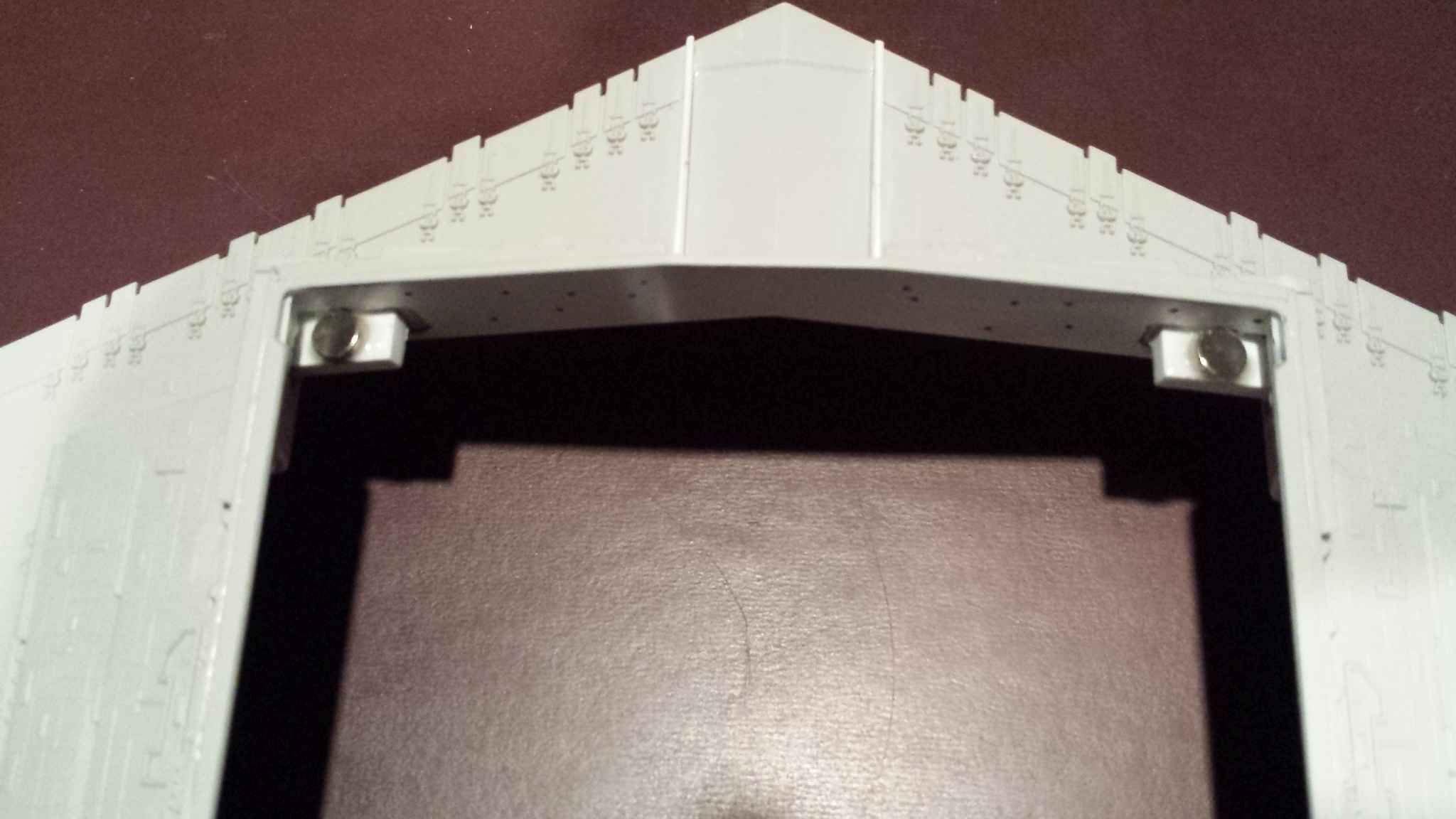

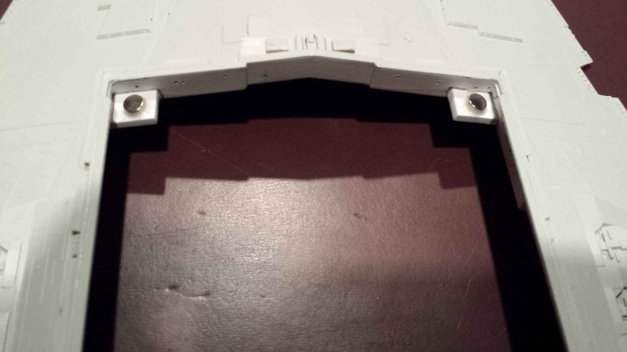

I received neodymium magnets yesterday........I made and glued the brackets for it yesterday. Tonight I will epoxy the magnets to the brackets and see how it goes. They are very tiny 6mm diameter by 2mm thick and they are hard to separate. As long as the magnets don't pull through the epoxy or break the brackets I think it will hold down the top section securely.

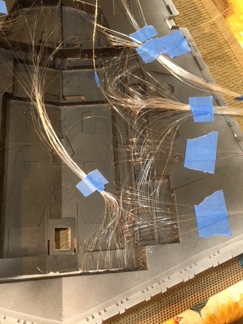

ISD-FO1.jpeghey fellas...I think I'm losing it...this is what I have left for FO. as you can see, I have half of the upper to do yet, and you know I'm done with the lower...I started with a 1000 ft roll of .25mm, cutting very few at 15", maybe 30 of 'em, most of the rest at 10 and 12 inches. What I do is cut a big pile, then bloom the ends and stuff into a large zip bag. I've seen the waste from cutting ends off...maybe 10ft, no we'll be generous, 20ft. The thing is, I have like 30, 10" pieces left?!...I ran out :facepalm do you suppose the FiberOpticStore sent a short roll...or have I over-done this?:confused:wacko
There are so many holes, I'll do a cluster and glue 'em, then a whole section, then when I think I've got a whole area done...I find holes I missed, and even holes I marked and never drilled! :sick

I finished the magnets to hold down the top and it worked perfectly. Hope to have some pictures a little later. Busy at work today
View attachment 778534hey fellas...I think I'm losing it...this is what I have left for FO. as you can see, I have half of the upper to do yet, and you know I'm done with the lower...I started with a 1000 ft roll of .25mm, cutting very few at 15", maybe 30 of 'em, most of the rest at 10 and 12 inches. What I do is cut a big pile, then bloom the ends and stuff into a large zip bag. I've seen the waste from cutting ends off...maybe 10ft, no we'll be generous, 20ft. The thing is, I have like 30, 10" pieces left?!...I ran out :facepalm do you suppose the FiberOpticStore sent a short roll...or have I over-done this?:confused:wacko

Probably, of course there are going to be variations in the bloom size...some come out too small and pull through so I have to hit them again. some come out too big as well and I trim if possible. if I'm lucky they come out just right and a slight steady pull seats it in the hole. Looking closely with 350 reader glasses you can see some are larger than others, but for the most part when you throw light to it, they're pretty much uniform in the light output. I guess a guy could really spend a lot, ALOT of time getting them all the same, but I don't see the need for that. As far as paint, yes I pre-painted the lower with the hangar, belly dome and trench walls secured. the upper had the super structure secured when painted, but I did drill holes before I shot the paint. the engine panel and tower also assembled and drilled before paint, but I did leave the tower face and roof panel loose but painted, washed and fibered up till final assembly. This kit's parts fit so well I didn't worry about the seams where final assembly will be, and using FO, there is little risk of light leak...IMO

however, if there are some that are too big and I can't trim, I just use a pair of tweezers to try to seat it better. while it certainly won't be perfect to extremely close inspection, it's good enough for who it's for :lol:thumbsup

Here are the pictures of the top cover held in place with the magnets. I can turn over and it will not fall off. The magnets hold the top flush to the edge.

Excellent! That is EXACTLY what I intend to do with mine! Thanks for the blueprint!
The magnets hold the top down pretty tight and flush all the way around....... It looks like its glued down!
It clicks in place very nicely and will not separate if turned over!

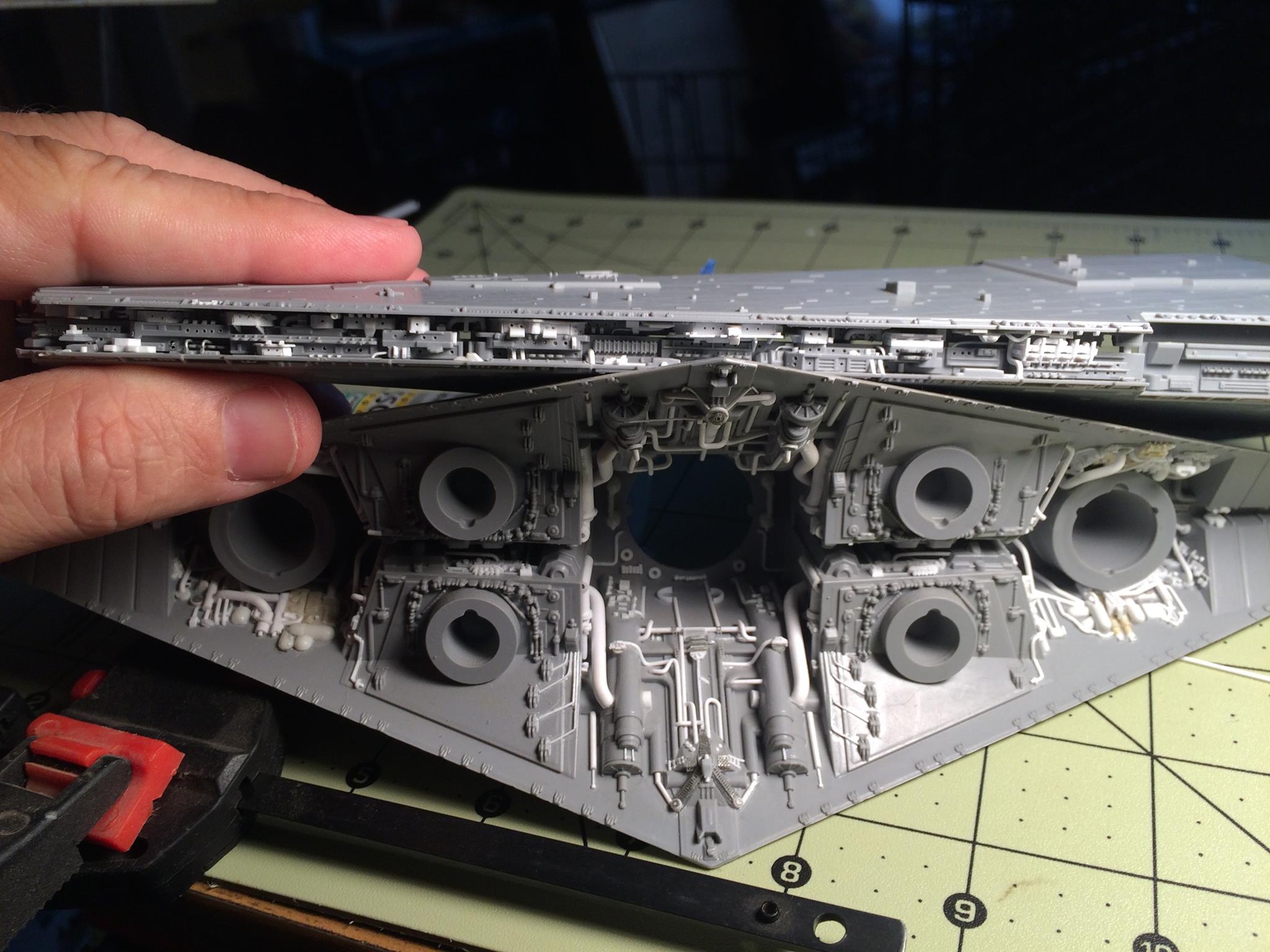

HO-LY COW!! Man that looks incredible!!!:thumbsup Did you scratch all those greebs on the engine panel?! Your trenches are spectacular as well! I'm really impressed with that. Makes me want to strip my engine panel back down and do that to mine...in fact I'm sure of it. I'm going to have to send that pic to my phone for reference. That's seriously top shelf work Invar, well done!!(y)thumbsup:thumbsup
Thanks for the compliment. Yes, all greeblies are scratch built - just me some styrene and a No. 11 Exacto blade. Trying to approximate the 8 foot ILM Avenger in spots, but cannot match it exactly at this scale - and the base parts of the Zvezda do not really allow for an exact duplication. So I have to work with where they have raised areas and approximate where certain notable shapes from the ILM model would fit, but I have to confess that as I am going forward I am referencing the ILM photos less and less and just adding surface detail where I see some space. The 1.5 MM height extension does tend to create a 3 or 4 deck look whereareas the ILM model has battleship superstructure parts that fill the trench structure from top to bottom, and I couldn't really do that with the Zvezda without more surgery than I wanted to do.
