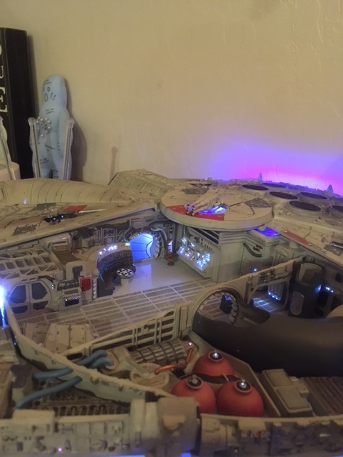

falcon 4 near done.JPGthis dude was quite the FO challenge...I'll never do another Falcon cut-away, too much work particularly correcting the thing to the shorter side walls...then you have to figure out what to shorten in the interior in addition to all this FO work. :wacko
