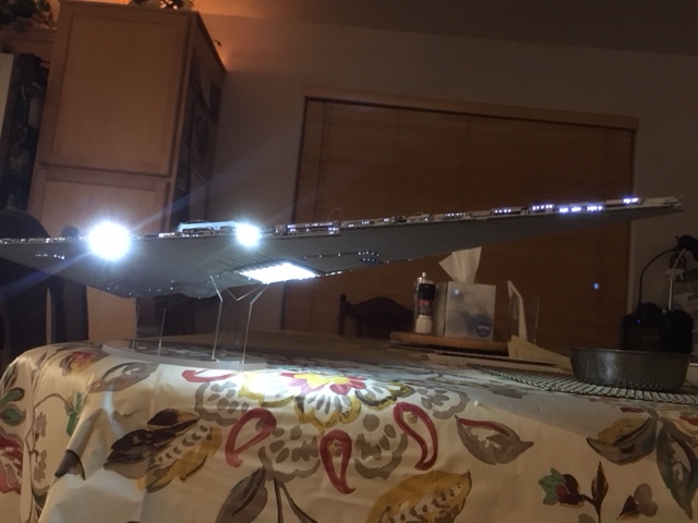

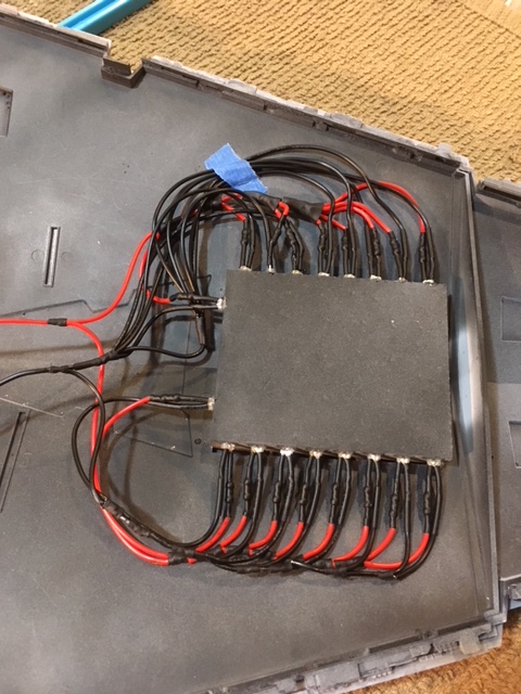

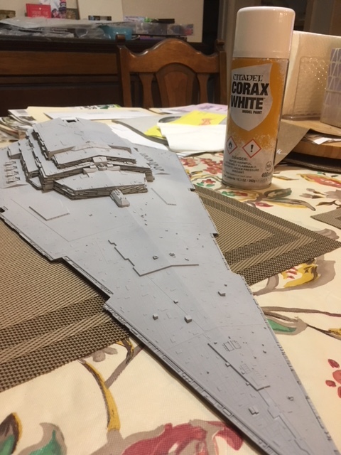

    Ok, well we'll try it this way. First thing...I have zero problem with anyone else building this kit or anything similar, posting what they are doing with it, in fact I welcome it. I want to see what others are doing. I know what I'm doing because I'm doing it, but I want to share and perhaps give others ideas, but more importantly, I'm interested in what others are doing that I haven't thought of.
    I started this Russian Z ISD about a month ago so I'll put up some past pics and try to work my way up to the present. ISD1.jpeg ISD3.jpeg I'm using .25mm FO for this thinking I could do twice as much lighting and figured it would be more to scale than .50mm. I've drilled a lot of holes, nearly 800 I estimate. I installed the upgrade hangar bay from Falcon3D and also have their engine bells. I'm using Citadel white primer for the primary paint and a light spritz of water based black/gray wash, didn't want it too dark and have the panel lines jumping out at me. ISD15.jpeg
    SofaKing01, gedmac66 and 32buds like this.

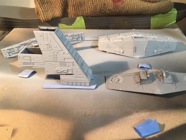

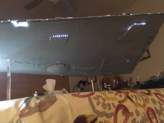

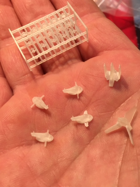

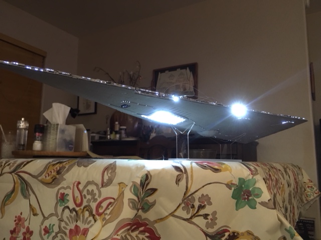

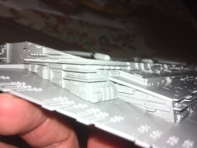

    ISD5.jpeg SD3.jpeg ISD14.jpeg ISD16.jpeg ISD7.jpeg ISD19.jpeg ISD22.jpeg there are 36 FO in the command tower, and 100 in the face panel.
  3. gt350pony66
    gt350pony66 Sr Member
    Trophy Points:
    1,891

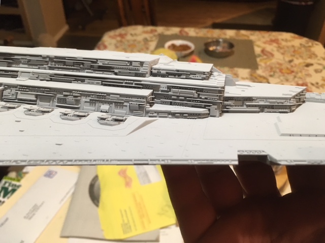

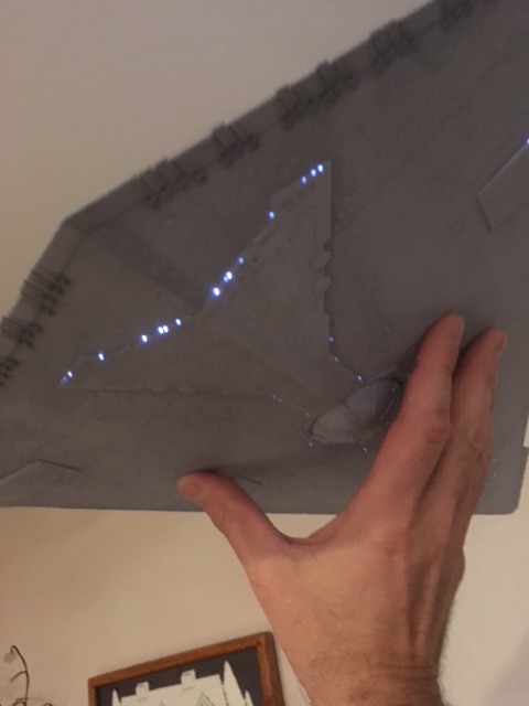

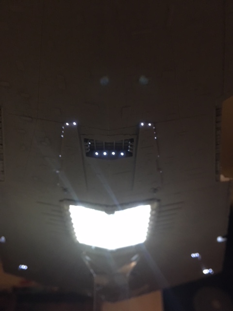

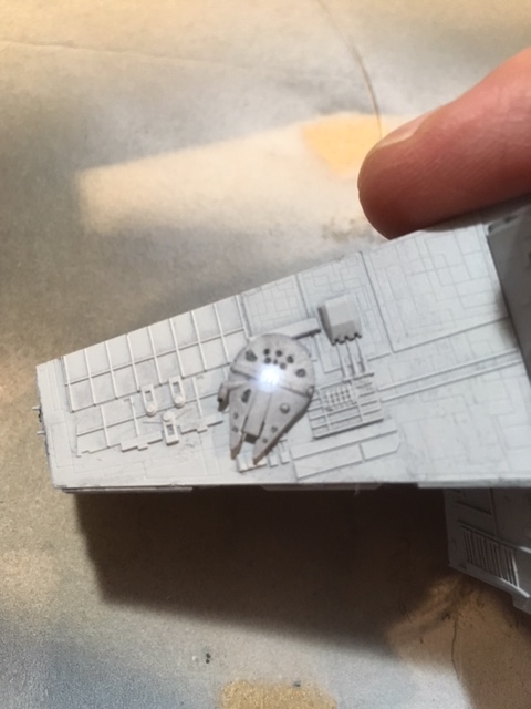

    isd-falcon2.jpeg ISDhangar1.jpeg ISDhangar5.jpeg ISDhangar3.jpeg I used 2mm led's for the hangar which turned out very well, thanks to the suggestion of another member, Guns Akimbo, to which I am grateful for his suggestions of parts to use and procedure.
  4. gt350pony66
    Trophy Points:
    1,891

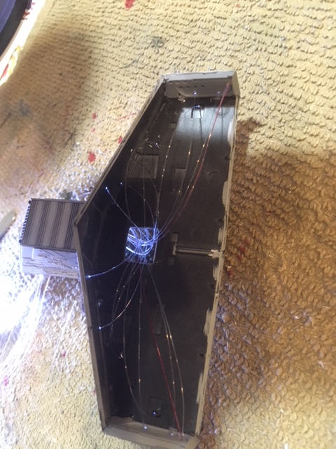

    here is as of last night, the lower hull is essentially done except for the engine panel which I've realized I was out of blue LED's. I tried the flicker blues and have decided against it. So I'll start on the upper next. The tower is ready to go but that will be installed later. I estimate I've got nearly 400 or so FO in the lower hull. I'm satisfied with the results. I also acquired a squadron of 30 tie fighters, a couple of shuttles and what was supposed to be 3 variants of the Slave 1, but there was 4, 3 are in flight and one landed. of course one of those will go in the garbage chute, also a Falcon3D piece, the afore mentioned items are Shapeways. I had intended on using the landed shuttle in the secondary hangar, inside the larger one, but the wings are too tall so I'll have to figure something out. I plan to leave rows of the Ties on the upper sprue rail and hang some on the larger hanger. The tiny Falcon in the above post is also a Shapeways piece. SD21.jpeg SD22.jpeg SD23.jpeg SD24.jpeg SD25.jpeg SD26.jpeg SD27.jpeg the stand is something I found on Ebay, as the ones that come with the kit are insufficient for lighting display ISD stand1.jpg
    sorry for the "post after post" here, I'm playing catch up...
    nkg, Randy13, gedmac66 and 2 others like this.

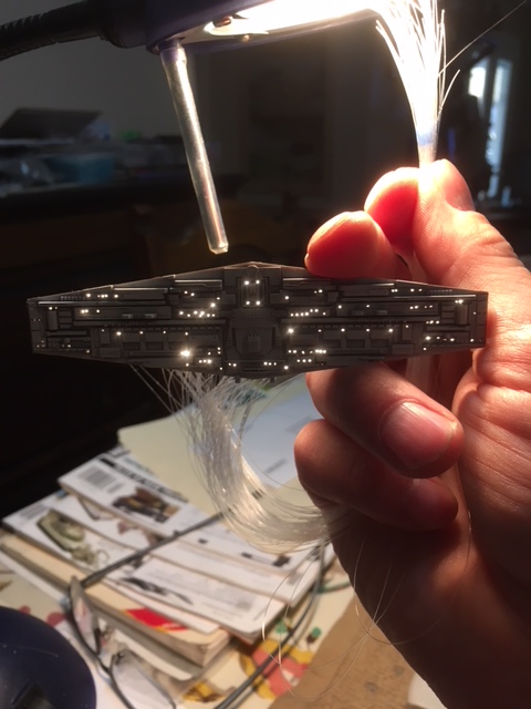

    I guess I should also mention, I'm cutting 12" sections of the FO, and blooming the ends with the soldering iron, string a cluster in place, then secure with Laser Bond...as seen on TV. Some of the tiny areas looked to be prohibitive of the other method of leaving them sticking out, paint, then cut. Harder doing it the way I am, but I'm ok with it.

    I forgot to ask you, did you get any of those tiny Tie Fighters from Shapeways to put in there? I thinks it's like 8 bucks for a rack of 30. I'm going to hang a row or two of 5 in the main hangar, and then place a few in the trench hangars you showed me how to make. :thumbsup

    I agree soundly, .25mm seems more to scale than the .50, though I did use a few .50 in a couple places. I've been using LaserBond, that UV glue, "as seen on TV" I've gone through nearly a whole tube already, and the Walmart and Walgreens around here don't seem to have it anymore :unsure there's another brand they do have in a black tube, and I've used it, it works but I prefer the laserbond because the UV light is blue and you can see exactly where you've glued much easier than the other one.

  42. Escape068
    Escape068 Well-Known Member
    Trophy Points:
    712
    If you just want to turn on/off why don't you power it with a 9 to 12 volt 2 amp DC power supply like this:
    http://hdamodelworx.com/Power-Supplies_c_47.html
    Or a rechargeable 12 volt power pack like this.
    They have different mAh......the higher the longer it will last on its charge
    https://www.ebay.com/itm/DC12V-2800...hash=item41c2e1735c:m:mscYe0UCZyiwADe69TtLgAA
    You need to install a power connector like this:
    http://hdamodelworx.com/DC-Power-55mm-x-21mm-Female-Cable-Plug_p_27.html
    You can also install an on/off switch or several switches to separately turn on/off: main lighting, engines, hangar bay............
    gt350pony66 likes this.

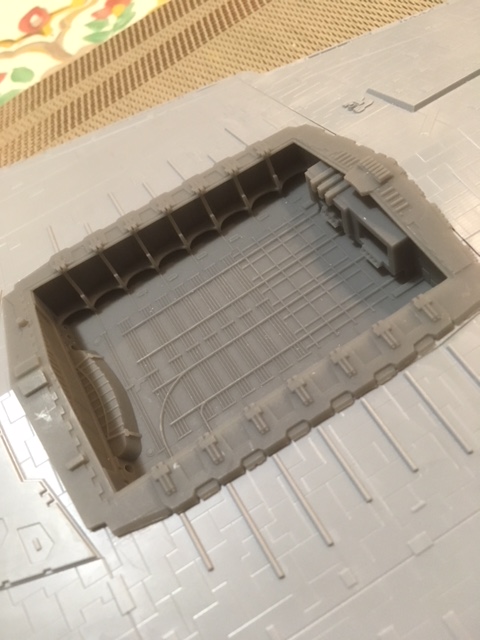

    I was just thinking about the lighting on your trench hangar...maybe a couple of .50mm FO on either side of the fore/aft corridor section where it won't be seen? I think I'm gonna try that myself since I've already got some on that panel that will be cut out for the hangar...
  44. gt350pony66
    Trophy Points:
    1,891
    All good ideas, you seem like you've got way more know-how on the electronic than I do for sure. I've got some remotes and multi sensors from Modeltrainsoftware for this, and there was some inconspicuous in-line power switches with it. they're like a flush mount kinda thing with a shallow push button so the sensors aren't powered all the time looking for a remote signal. I figure I can mount it on the lower and make it look like just another greeblie...I hope. The remotes can operate multiple sensors to control different functions and you can dim or brighten the lighting. I hope it all works out as planned, like I say...I'm still lacking a bit in the electronic know-how :unsure
