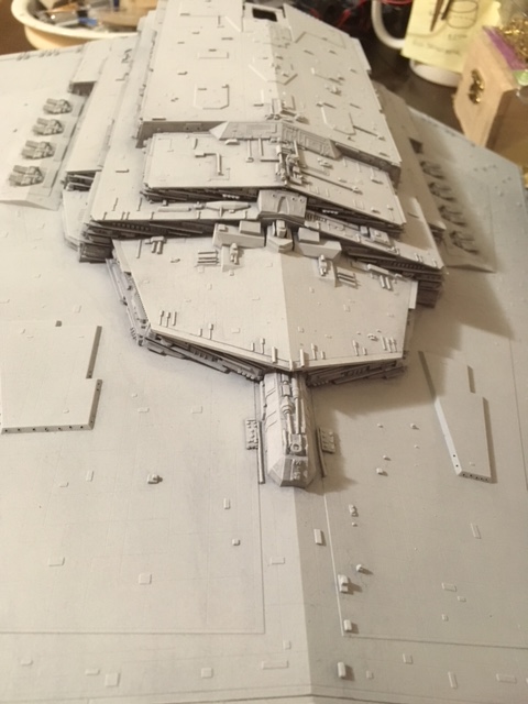

1/2700 Star Destoyer on the kitchen table

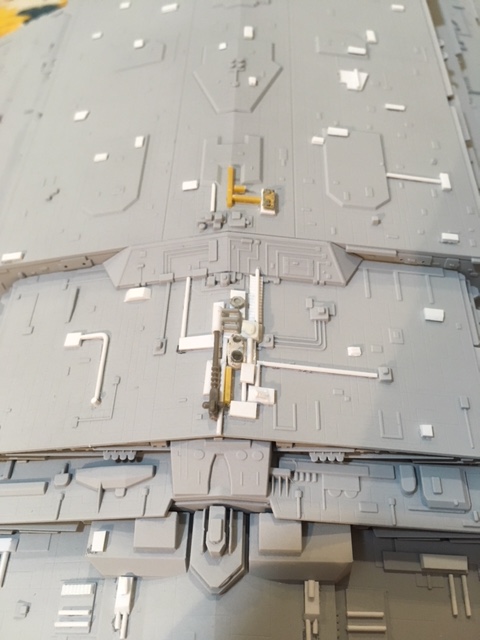

isd nov1.jpegisd nov2.jpegisd nov3.jpegisd nov4.jpegisd nov5.jpegisd nov6.jpegisd nov7.jpegisd nov8.jpeg Over the holiday I attempted to duplicate what Omnius did with his greeblie work on the upper hull. I didn't get exactly what he's got due to what I had to work with, but I think it came out pretty good and was worth the time and effort. I also decided I needed to do the trench hangar for the other side as well, actually was easier and quicker since I had the other one to go off of. lit pics are too bright to see anything so I left the LED's off, though it does look pretty good when lit, just can't get a clear photo. I had a bit of trouble washing the upper, couldn't get it even, so I did a mist of the Citadel white to clean it up, but I think I'm going to have to get the air brush out to get it right.

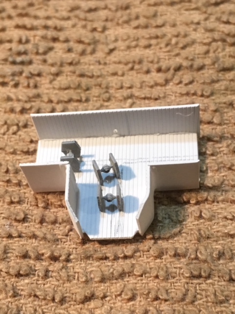

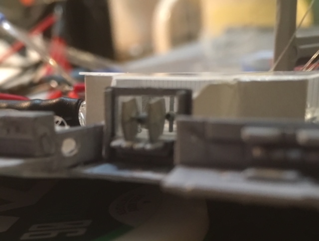

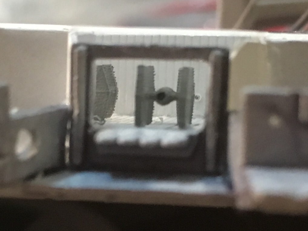

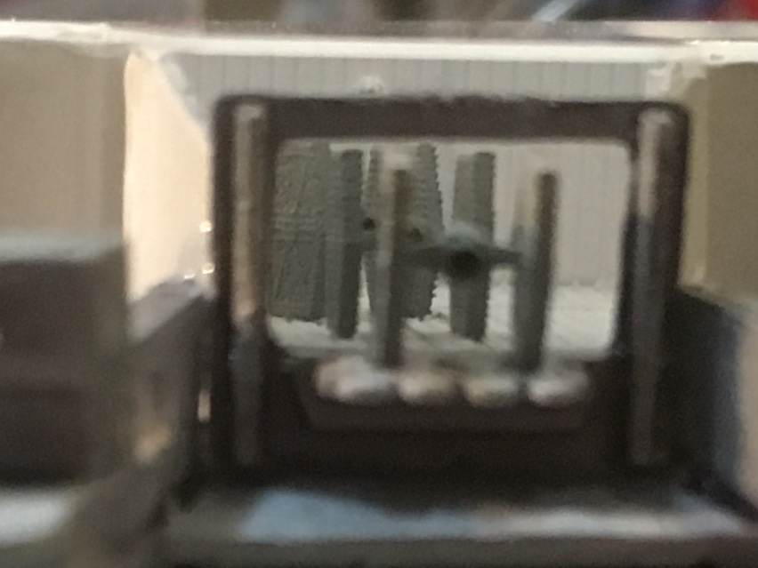

Thanks Blakeh1, it was sort of a last minute rush job on the tie hangars...but it was Escape's idea. In fact, he was kind enough to post pics of his scratched up parts or I'd still be screwing around with them and likely done them goofy. I think his are gonna look better once he gets them squared away. That's why I started this as an open invitation thread. I like seeing what other guys are doing and hearing their ideas. It makes my builds better for sure, and if someone picks up something from me, well that's cool too.
The added details look good. I love the Tie hangar
Better than mine I meant to say, but you probably know what I meant :thumbsup
unfortunately, I'm far enough along that I won't be able to use some of the stuff in the PE set, but a good bit of it will be useful. Many thanks again to Omnius for showing us this item. For myself, I had no idea it even existed. :thumbsup
Lesson learned, if you're embarking on a good build, look around to see if there's PE available

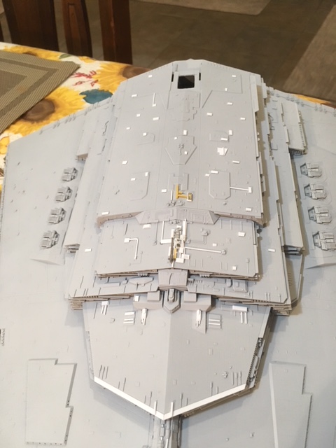

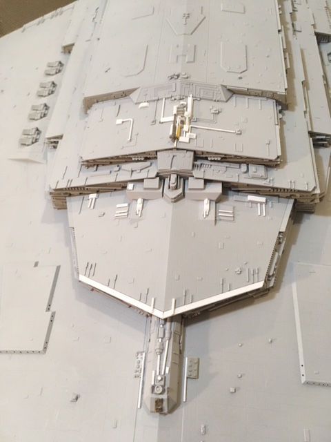

View attachment 776313View attachment 776314View attachment 776315View attachment 776316View attachment 776317View attachment 776318View attachment 776319View attachment 776320 Over the holiday I attempted to duplicate what Omnius did with his greeblie work on the upper hull. I didn't get exactly what he's got due to what I had to work with, but I think it came out pretty good and was worth the time and effort. I also decided I needed to do the trench hangar for the other side as well, actually was easier and quicker since I had the other one to go off of. lit pics are too bright to see anything so I left the LED's off, though it does look pretty good when lit, just can't get a clear photo. I had a bit of trouble washing the upper, couldn't get it even, so I did a mist of the Citadel white to clean it up, but I think I'm going to have to get the air brush out to get it right.
The hangar and all the additions look great!!

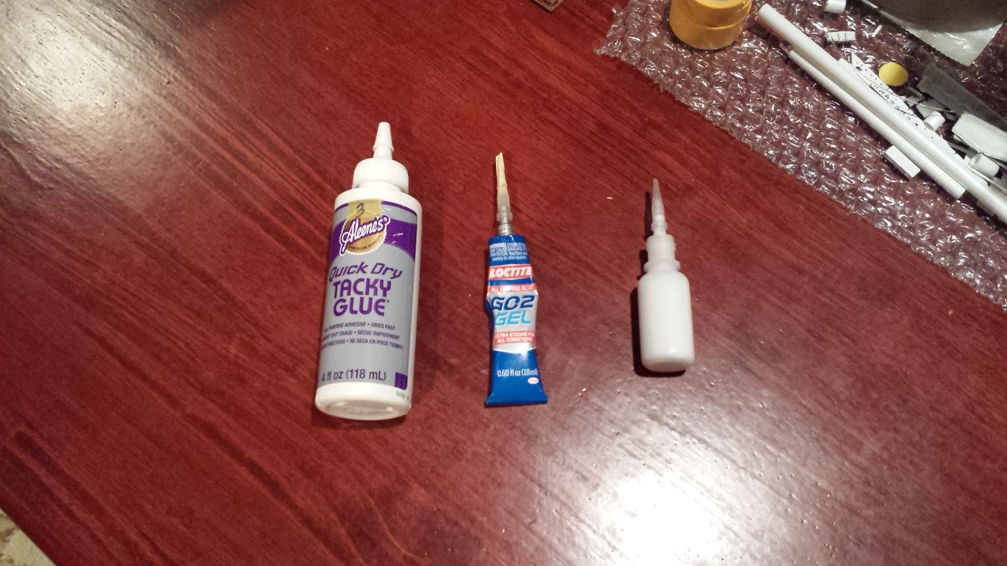

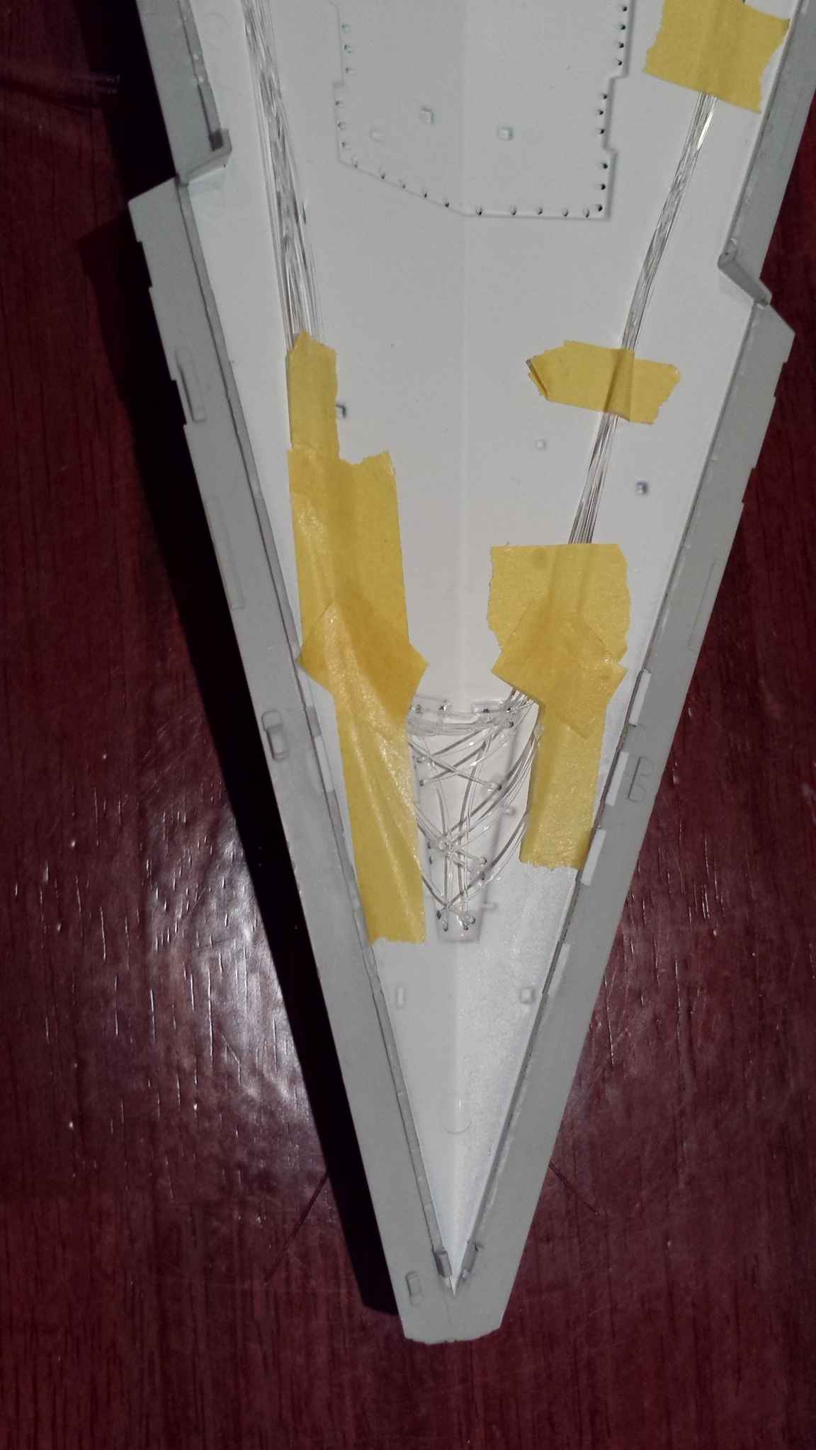

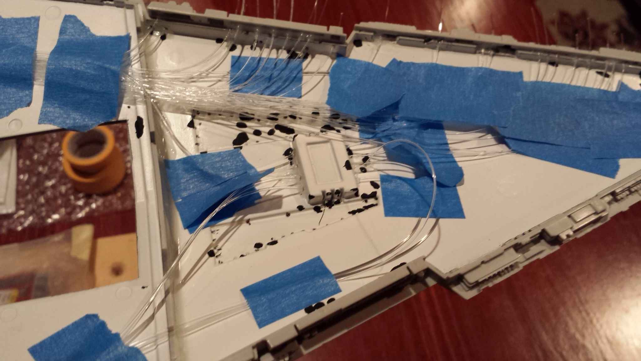

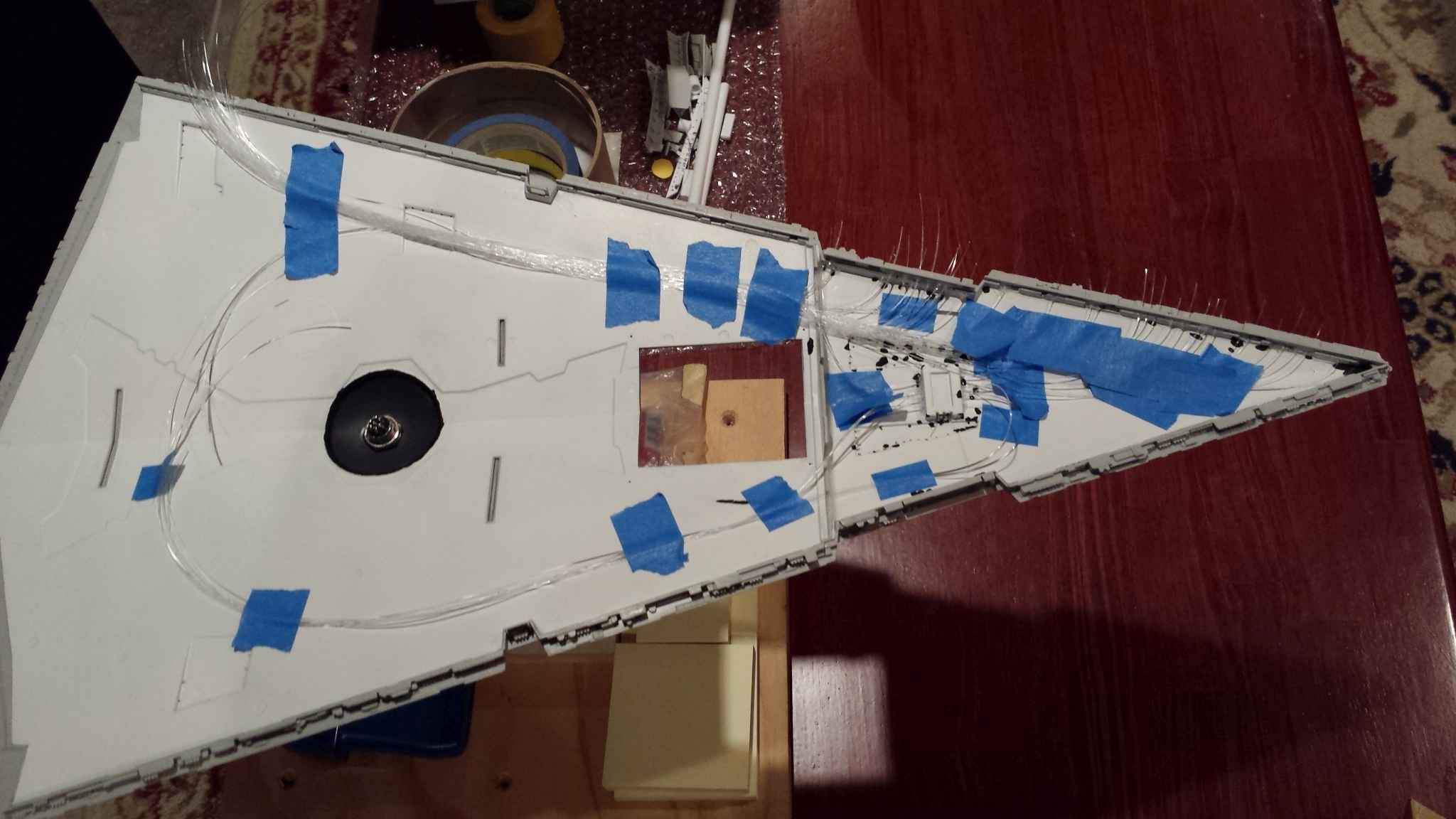

I was away most of last week but did do some work on it yesterday and decided to go FO route. Started to do some of that along with some other stuff. I tested using the Loctite GO2 gel and a few other water based glues and I don't like the Loctite because once you s=get it on your fingers it has that silicone feel which you can easily get on the surfaces of the model. I'm using Aleene's Quick Dry Tacky glue that is just as strong as the Loctite and is water clean up. I put some in a small bottle with a thin tip and it works great. It was very difficult to pull the fiber out of the test piece I did using the Aleene's glue. I let it dry 24 hrs. and it dries clear.
Still deciding on warm white or cool white for interior flickering/non flickering cool white or blue for engines.
Being that I will be able to access interior I may setup so I can change out the LEDs if I don't like what I choose. I purchased 8mm warm white and cool white LEDs so I will be able to fit approx. 196 fibers in one 8mm LED . Hope to use between 5 and 10 LEDs with a couple of small 3mm for the color ones. I also bought a few tools to cut the FO in those hard to reach places. I have another on order that has a really fine curved cutting tip.

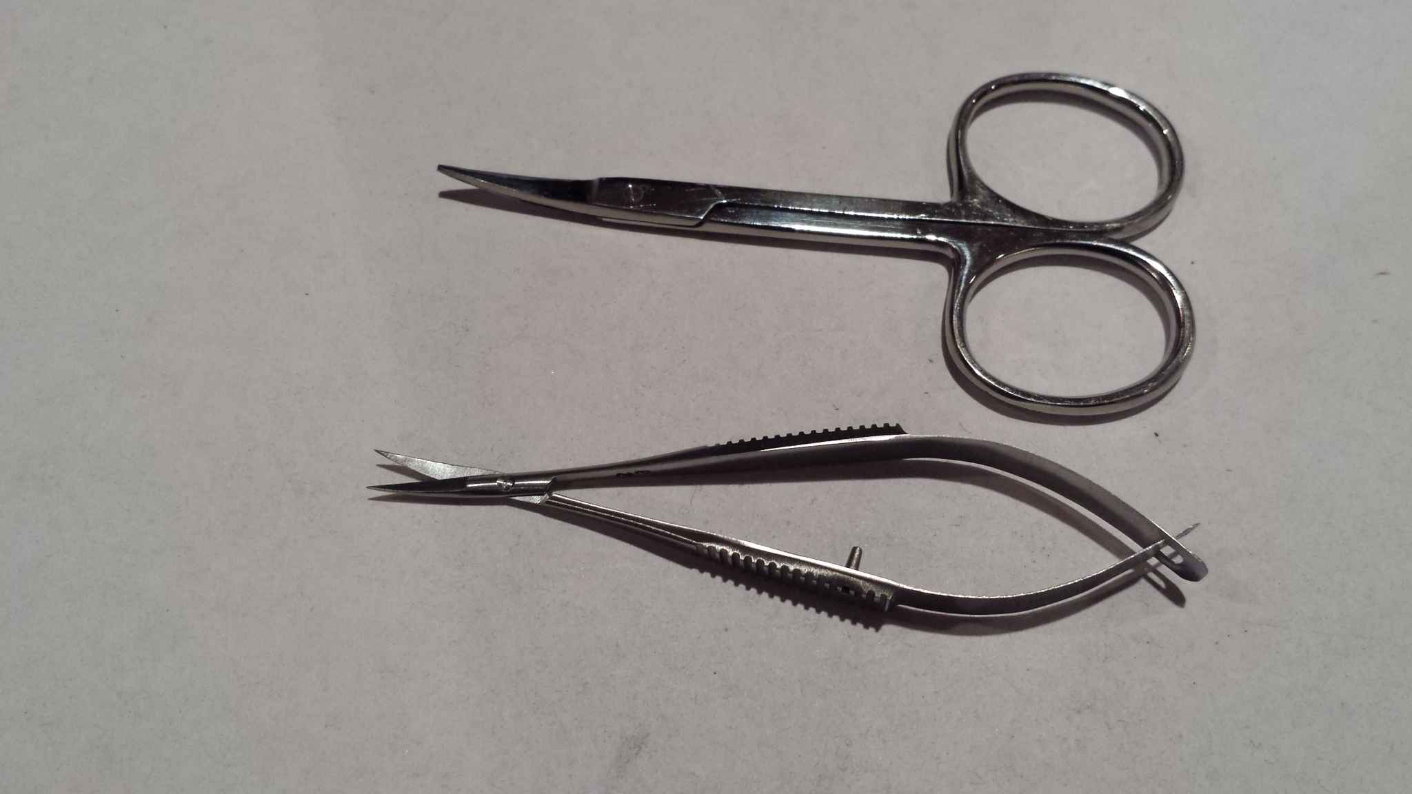

looking good brother! I see you like the same tape that I do :lol So that glue...for the FO, right? I've been using Lazerbond successfully but I can't find it in stores anymore. Go online and it says Walmart still has it, but been to 3 stores...nodda. I guess I gotta order online...what a pain.
I really like those tiny clippers with the cross tail, perfect. I found a set of stuff at Walgreens for doing finger and toe nails for 10 bucks. the tiny side cutters are the bomb, and there was a small short pair of scissors in there too, but I think it's still too big. might take 'em to the bench grinder and gently grind the outsides till there only a little left, then they might fit in the tight spots. 8mm is bigger than I've been using, biggest I have is a 5mm. but when you think about it, particularly with this type of project, those bigger LED's are a great choice, good call dude [:thumbsup I got nothing done last night, had to pack up the 31" Disney Nautilus I finished a month ago to go to Austria. I Ebay-ed it and didn't get what I really wanted for it. Had probably 350 in the whole thing and got 600. Oh well, I didn't lose at least. Then it was my turn to cook dinner. Tonight tho, Finish trimming the contact points of upper and lower so they fit together. still a bit to shave on the upper for the hangars you influenced me to do :thumbsup Then I need to trim the tower for the angle and change where I ran the FO, the tower fits nice and snug, but the FO needs to go to the rear so as not to pinch it all. I added more FO to the tower to be more like Omnius so now I have like 170 or so in the tower and face panel. Did you get a PE set for yours too? Sorry...didn't mean to babble on so much :wackoQUOTE=Escape068;4359717]The hangar and all the additions look great!!

Those small scissors you can get on eBay
https://www.ebay.com/itm/PREMIUM-O-...e=STRK:MEBIDX:IT&_trksid=p2060353.m2749.l2649
And the other ones I have not received yet
https://www.ebay.com/itm/6-Fine-Arr...e=STRK:MEBIDX:IT&_trksid=p2060353.m2749.l2649
