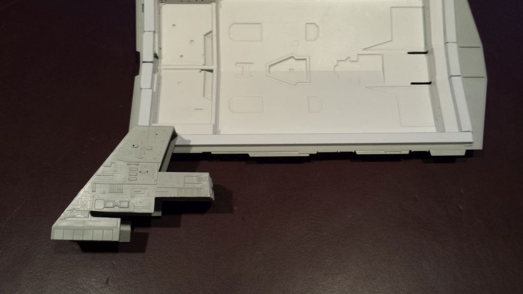

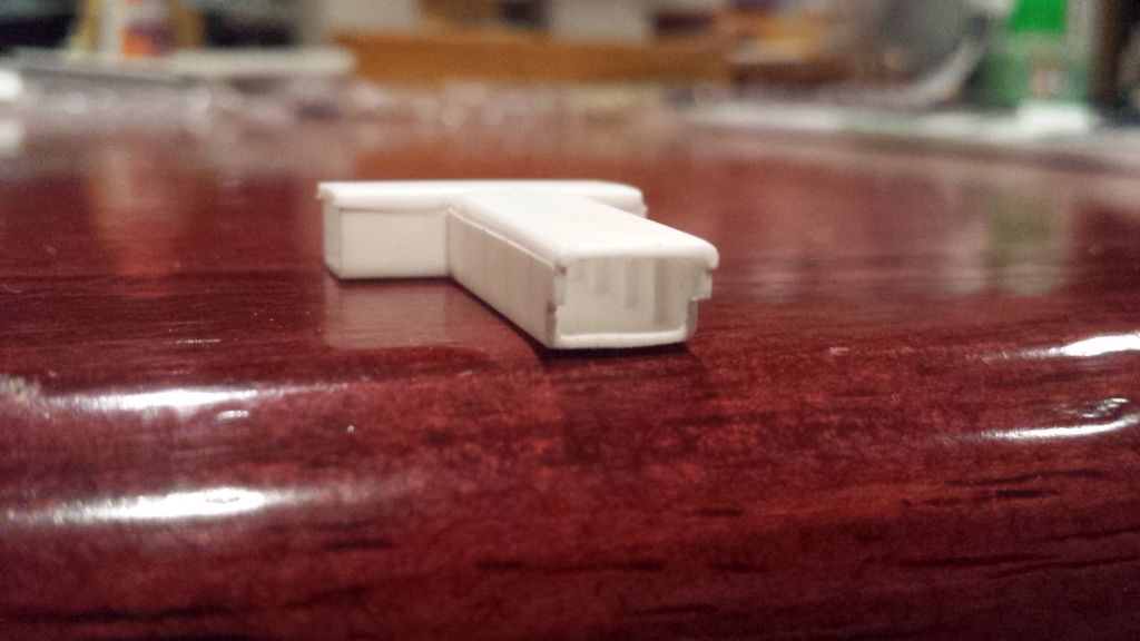

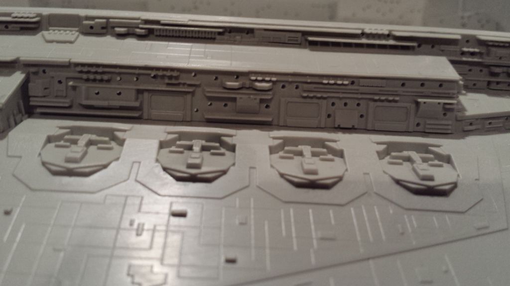

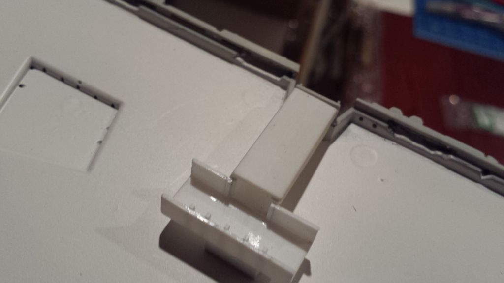

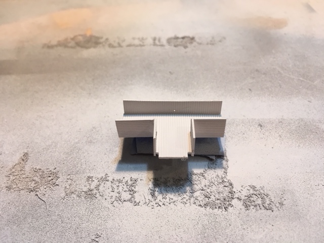

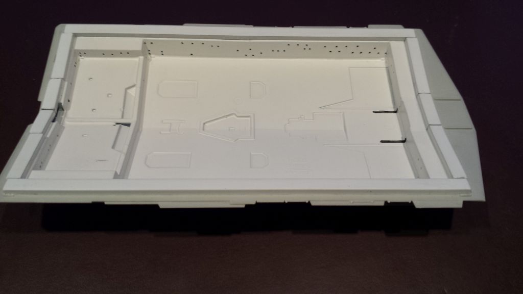

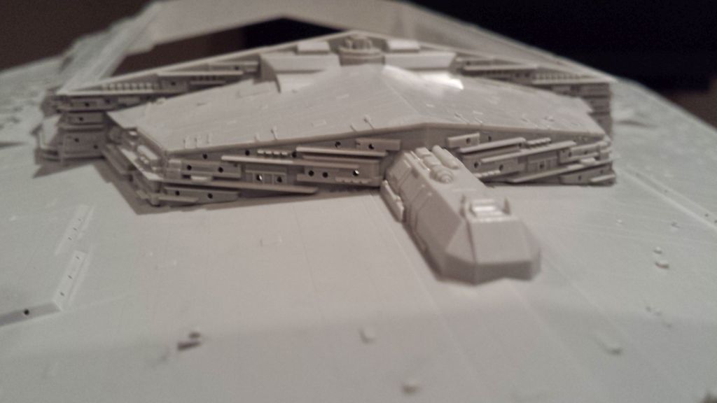

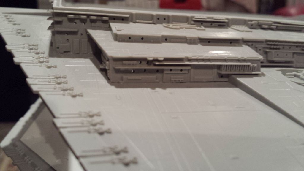

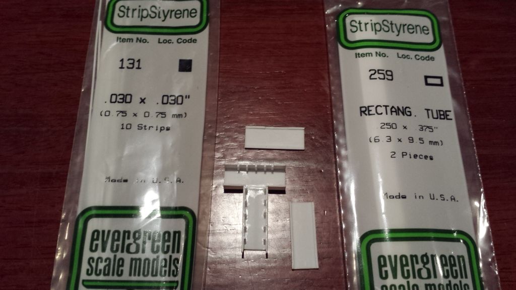

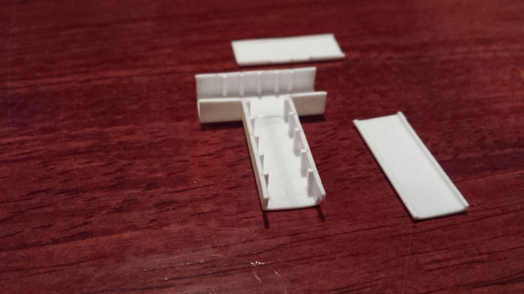

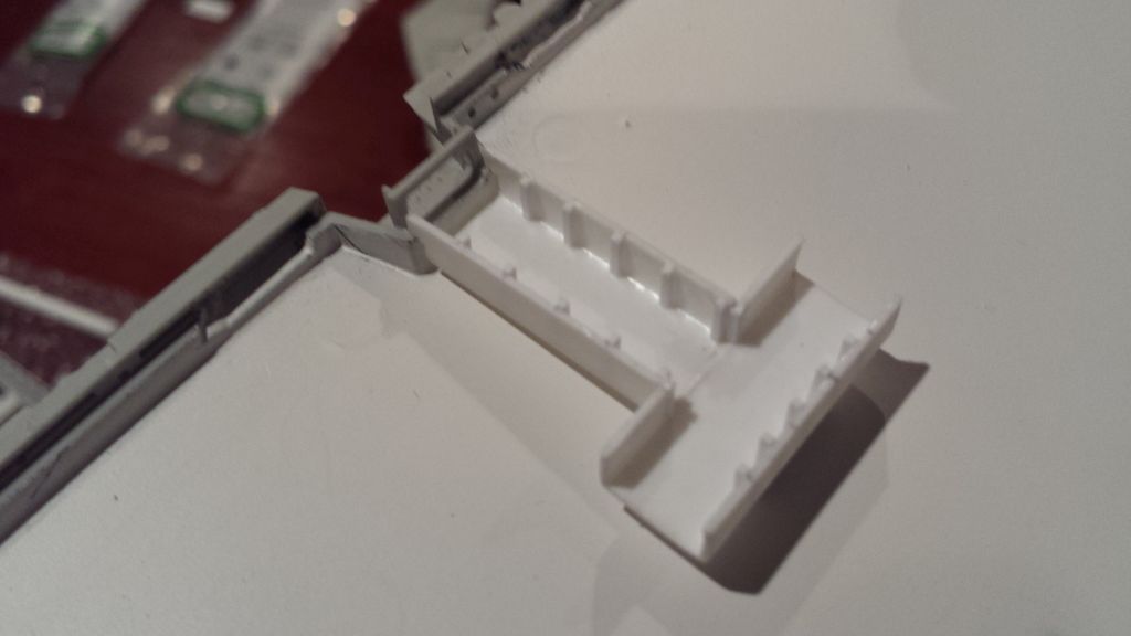

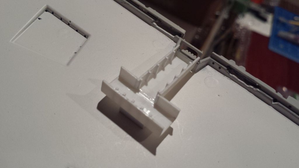

Built and light blocked the trench hanger. It is not glued in yet. It needs to be painted and I want to see how I'm going to light the interior of it.
View attachment 775117 View attachment 775118 View attachment 775119 View attachment 775120
View attachment 775125 View attachment 775126 View attachment 775127

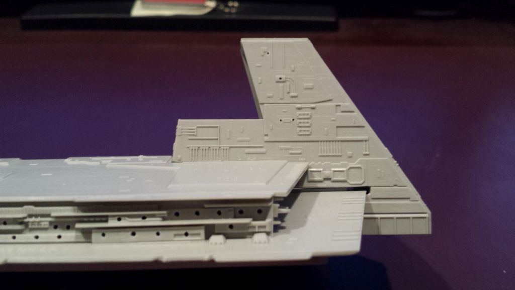

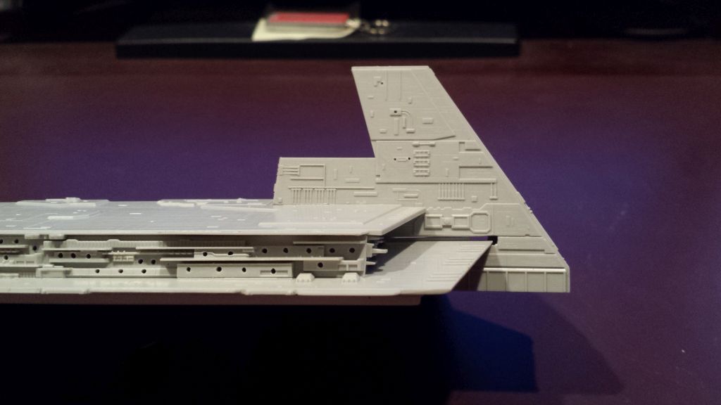

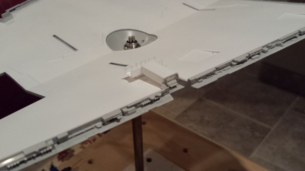

Fixed the angle of the command tower and now lines are parallel to ship....still need to add some small strips to fill the small gaps. It's not glued on yet.
I will be making the top section removable from the ship to get to the electronics. I have glued a small skirt around edge so now it press fits into place and stops 95% of light leak. Some very thin foam will fix the rest. I may also use MicroScale liquid tape to make a stronger but removable connection that can be reattached. The stuff remains sticky and gives a fairly strong temporary bond.

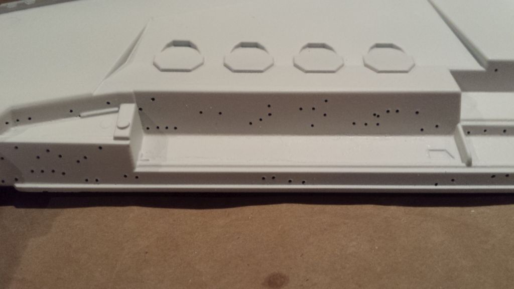

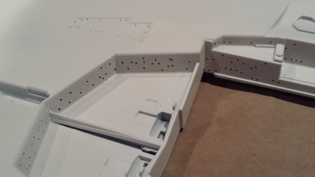

Here are some pictures of the drilled window holes......from inside and some from outside.
View attachment 775136 View attachment 775137 View attachment 775138 View attachment 775139
After the above pictures were taken I drilled more holes so I'm probably 99% done with the drill holes. I have also drilled the locations for the laser turrets in 3 location on each side. I will use .75 mm FO for this connected to 2 green LEDs that will alternate firing 4 double bursts over a 1.5 to 2.5 second span.

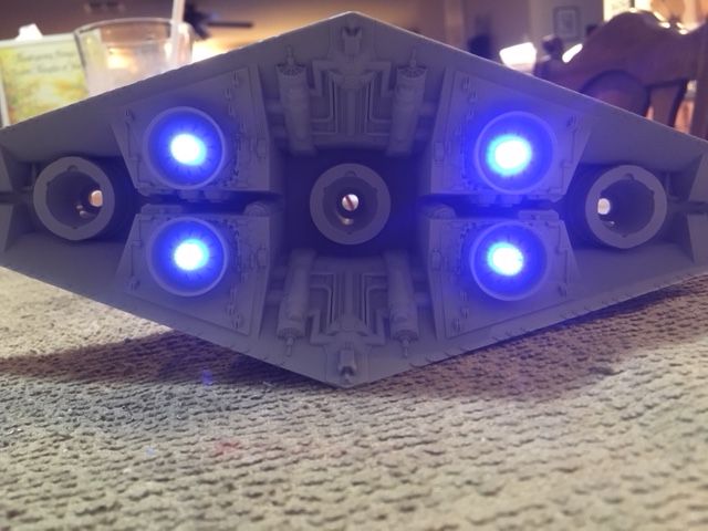

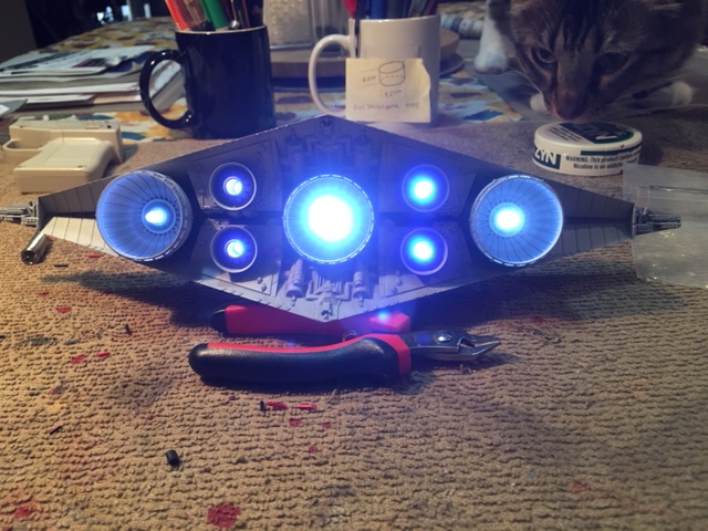

View attachment 775048I had big plans last night, till the extermination guys showed up for the monthly spray treatment, then the wife came home, bla, bla, bla...then before I knew it, it was 8:30...this is as far as I got with engine lighting experiments. these are the 5mm bright whites that I color changed to blue-ish.
Looks better than stock blue LEDs as the inner glow is more white with a blue tint around the edges. I wouldn't go any bluer than that

I agree, thanks for the :thumbsup . I thought I'd wet wipe them once more to tone down the blue just a tad more.

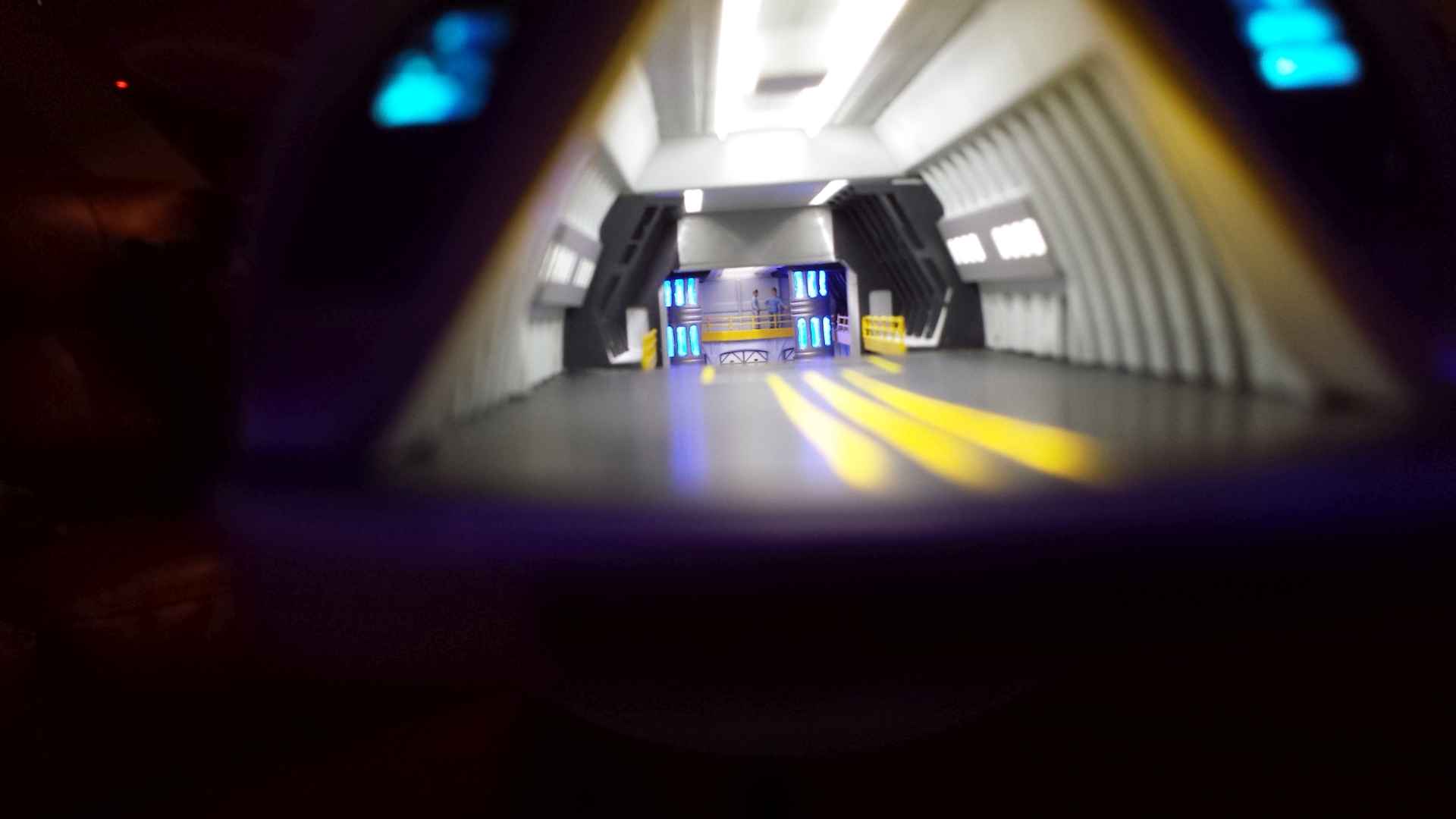

I was also thinking of cutting a slit/groove in the middle of the corridor ceiling and inserting some clear plastic in the groove and let the interior lighting illuminate it. If you are familiar with the Polar lights 1/350 Enterprise Refit kit.......the hangar bay has 2 over head slits with clear plastic and it light up very nicely

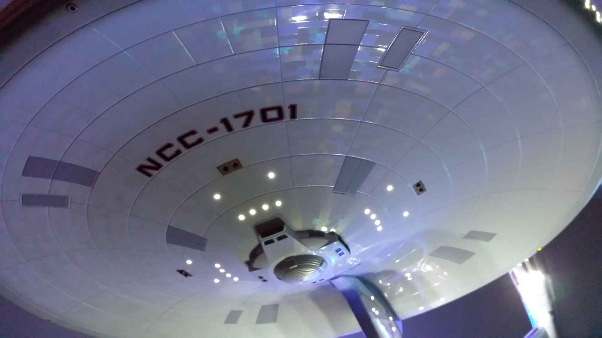

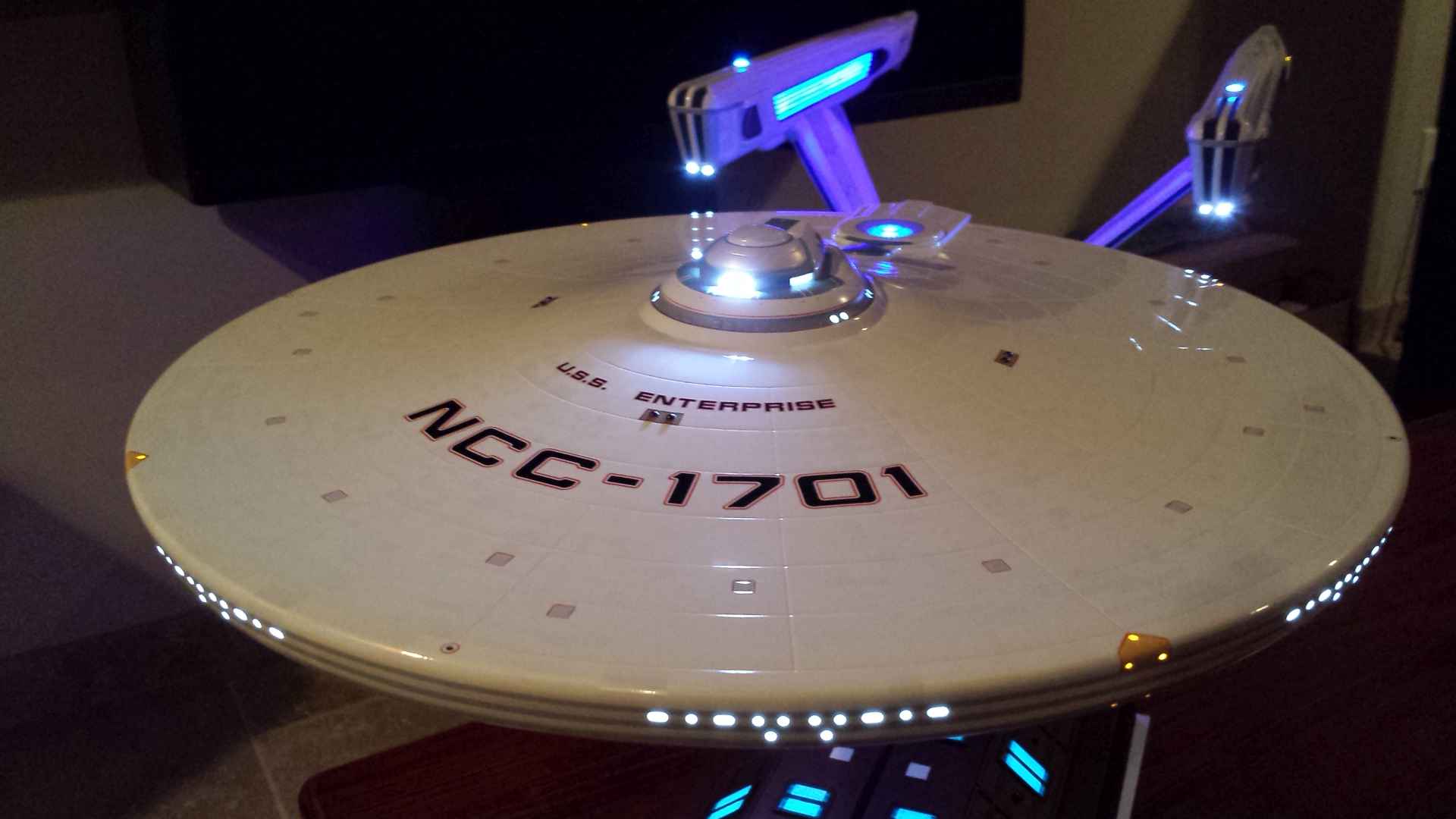

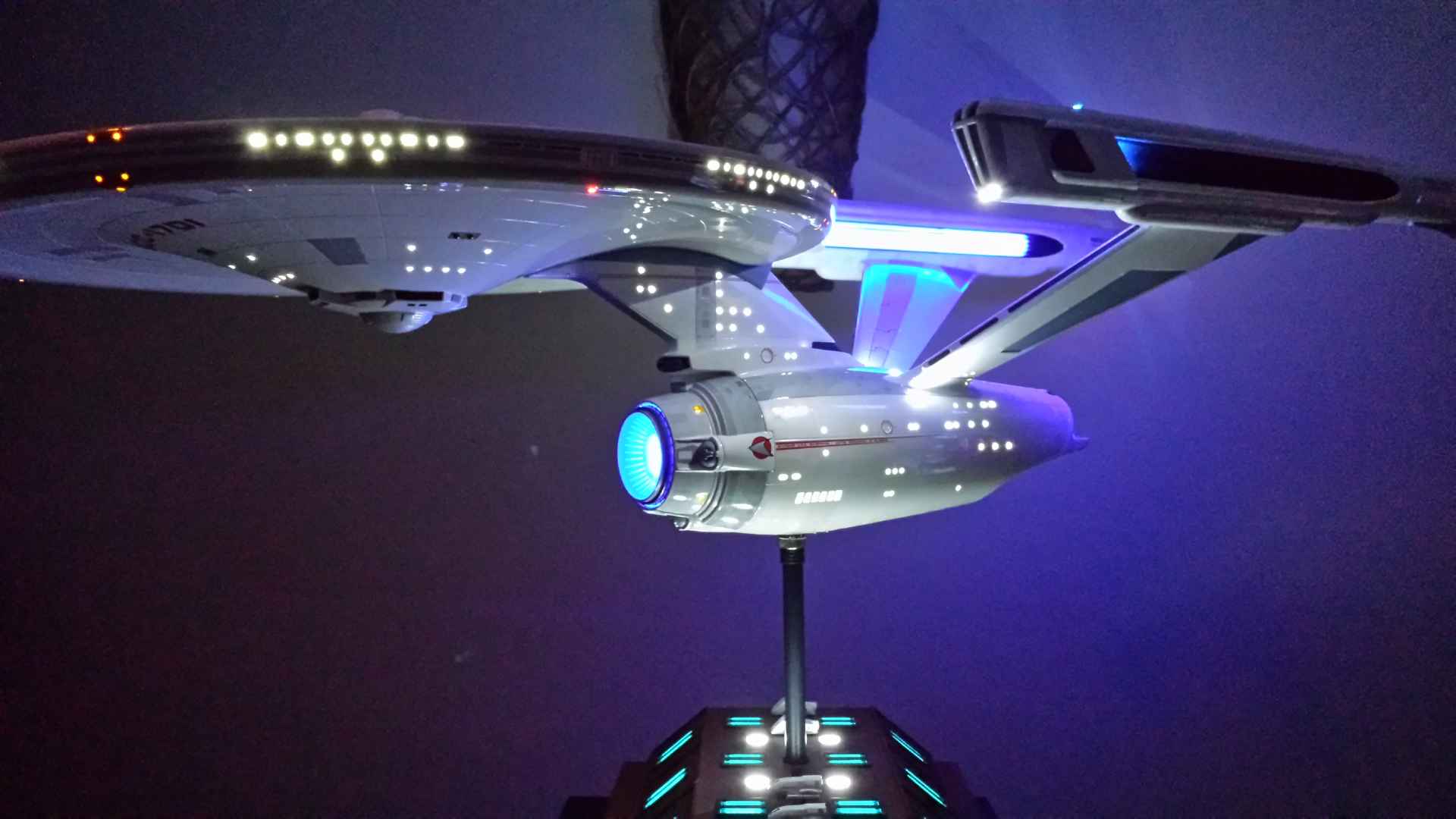

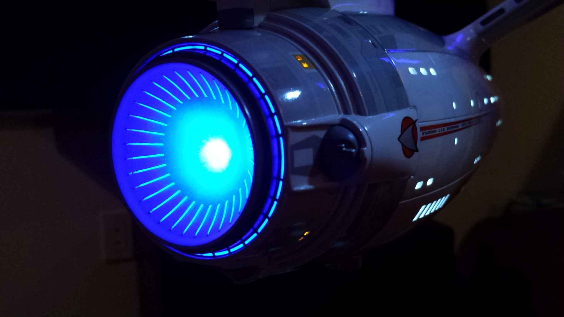

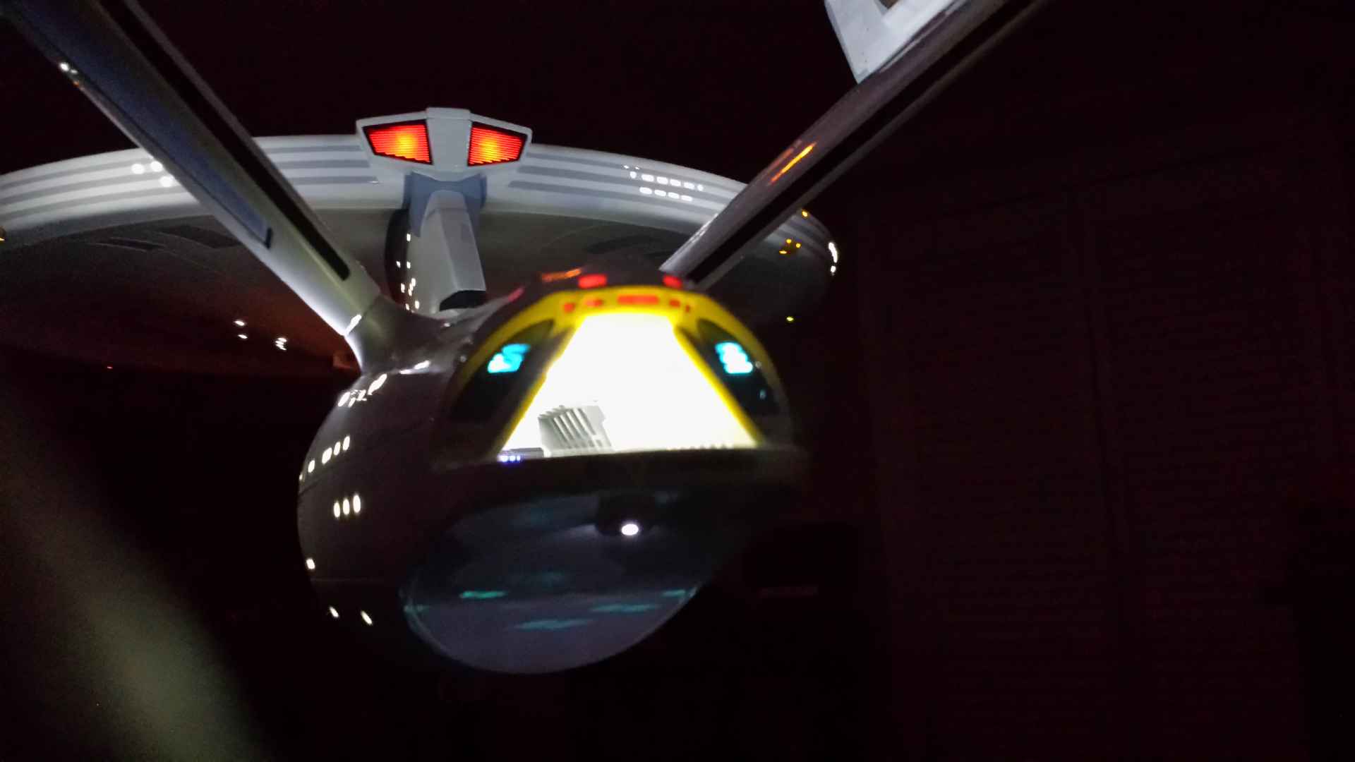

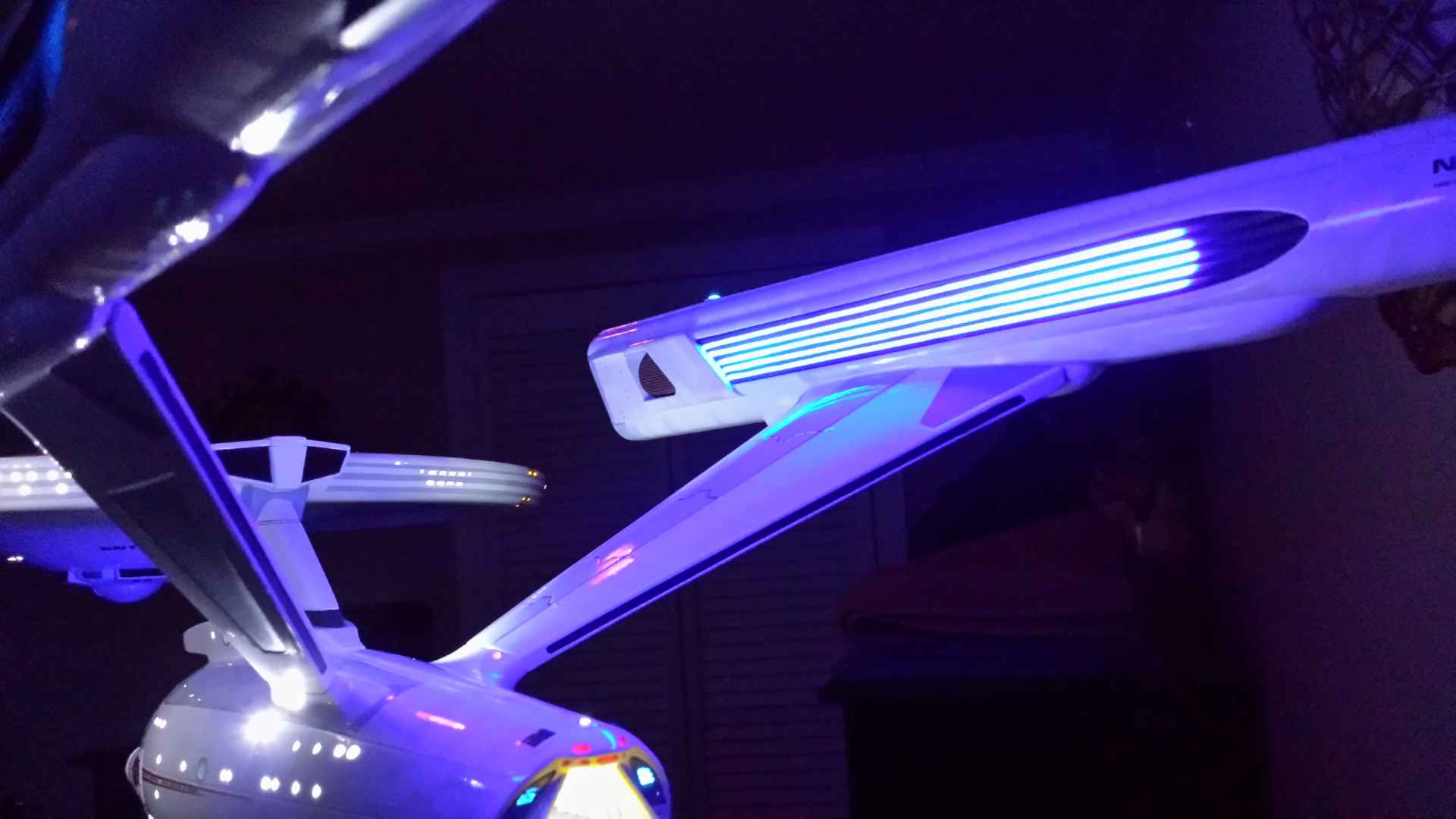

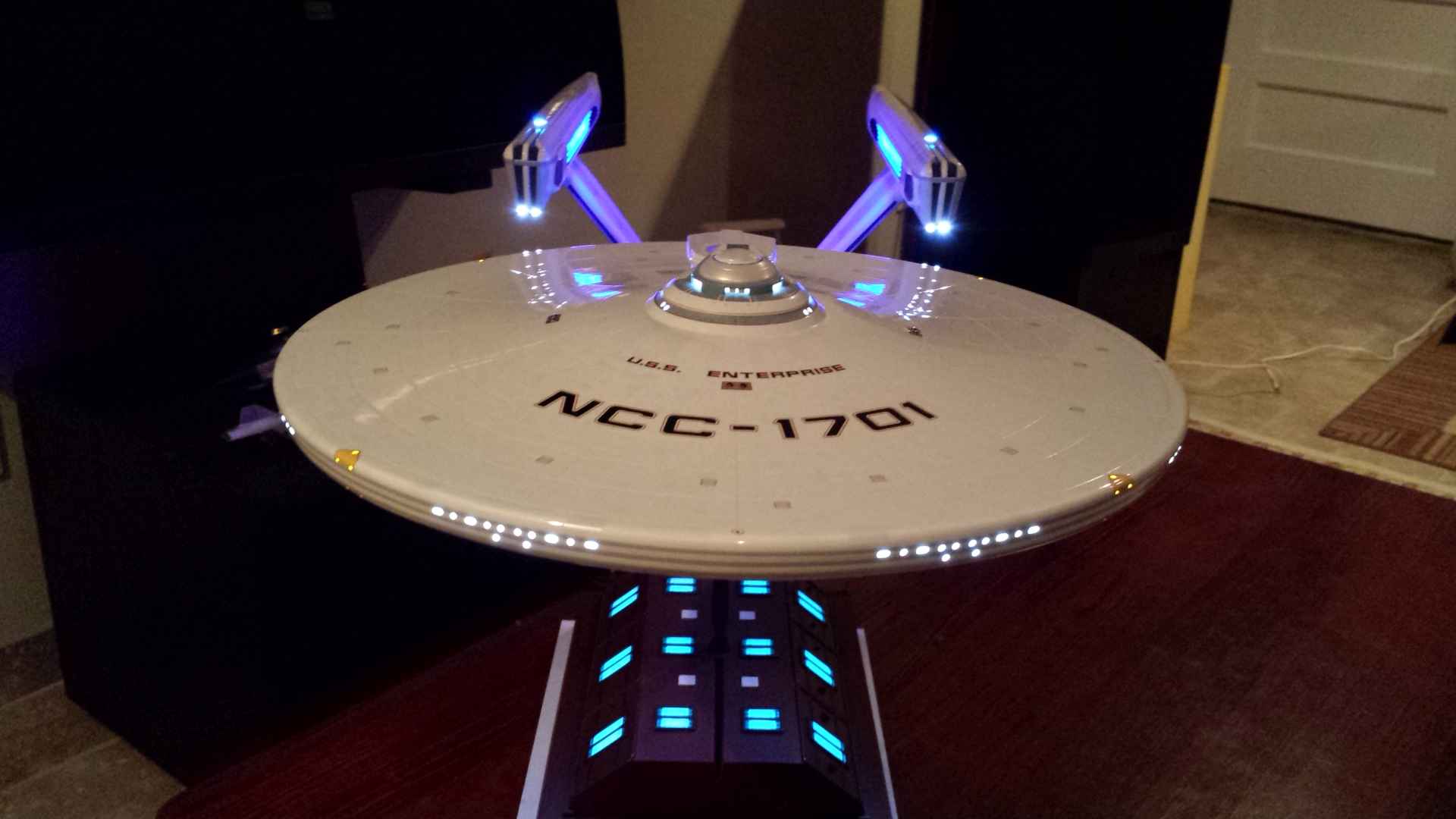

A few pictures of my 1/350 TMP Enterprise Refit build:
20161210_154706smaller.jpg 20170202_221321_LLSsmaller.jpg 20170202_220906_LLSsmaller.jpg 20170202_221521_LLSsmaller.jpg 20170202_222742_LLSsmaller.jpg 20161210_161010smaller.jpg 20161210_160751smaller.jpg 20161210_155501smaller.jpg
I was just thinking about the lighting on your trench hangar...maybe a couple of .50mm FO on either side of the fore/aft corridor section where it won't be seen? I think I'm gonna try that myself since I've already got some on that panel that will be cut out for the hangar...
I think your idea is MUCH better...I'm doing that :thumbsup
And oh my...that 1701 looks amazing! I've been wanting to do that kit too. You nailed the lighting and detail perfectly. I guess now I have another future project to shoot for!
View attachment 775175 View attachment 775176 View attachment 775177 View attachment 775178 View attachment 775179 View attachment 775180 View attachment 775181 View attachment 775182
I just looked at those pics again...my friend, you make what I do look like kiddy play! (y)thumbsup:cheers

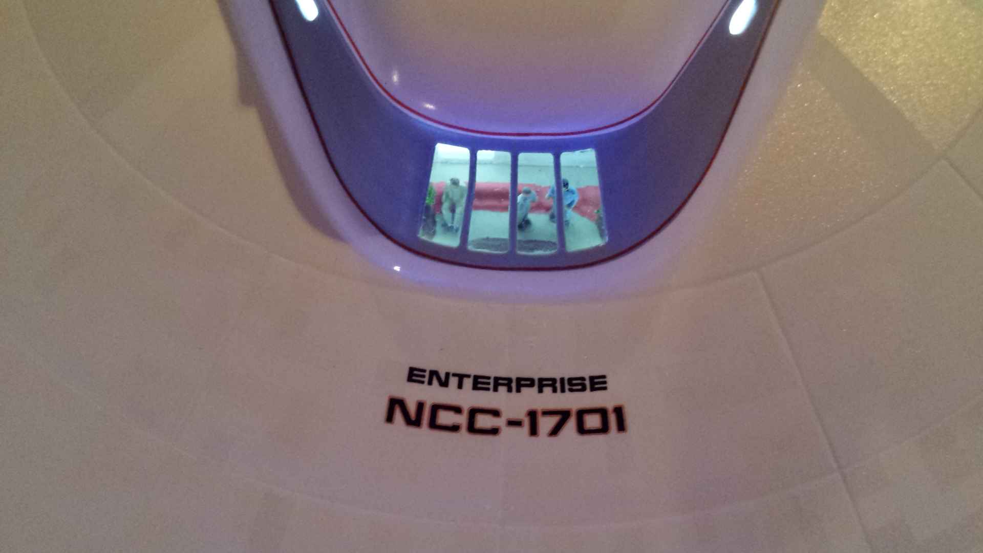

Thanks for the compliments.....90% of the windows on the Enterprise are filled with micro crystal clear. I'm doing a test on a scrap piece of plastic with a few holes with FO next to a few holes filled with micro crystal clear and see if there is any difference but have to wait for the micro crystal clear to dry and turn clear. I will post results tomorrow if I have time or Friday

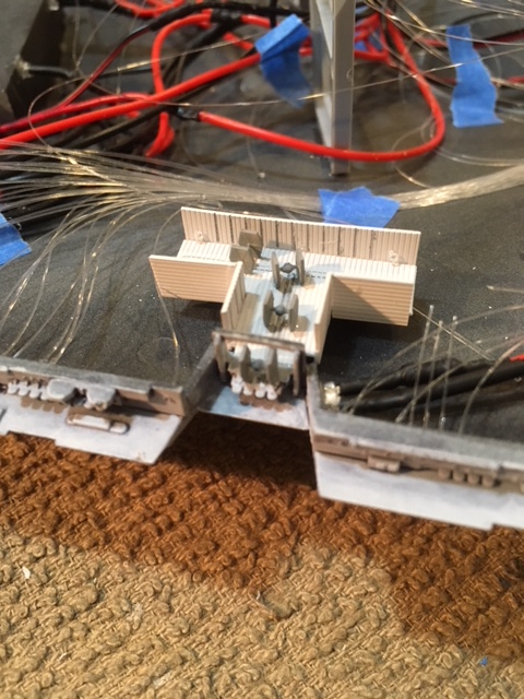

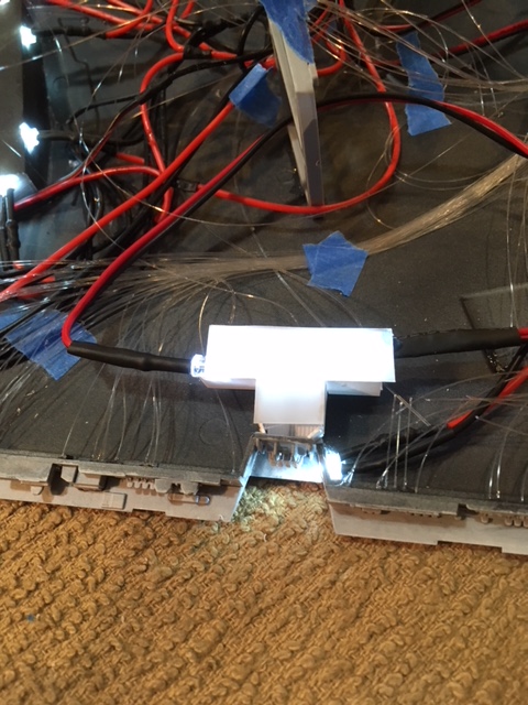

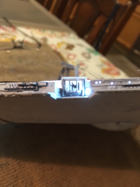

isd thanger1.jpegisd thanger2.jpegisd thanger3.jpegisd thanger4.jpegisd eng pnl.jpegthis is what I came up with for the trench hangar, not exactly what I hoped for, but it's good enough for who it's for, right? I had the Shapeways tie squadron so I stuck a few in there getting ready for launch. I was surprised that I had to put an LED in each end to get it lit good enough. I had some light defusing acrylic that I use on my Falcon engine lighting, thinking that would do it, but no dice. Finished my engine panel this morning. light tinted blue in the 4 small ones, and bright white in the 3 mains. I had to use a method that either Scarecrow or Robiwan had used (can't remember who) and use tubing to run them out further to illuminate the entire bell. Again, good enough for who it's for.
