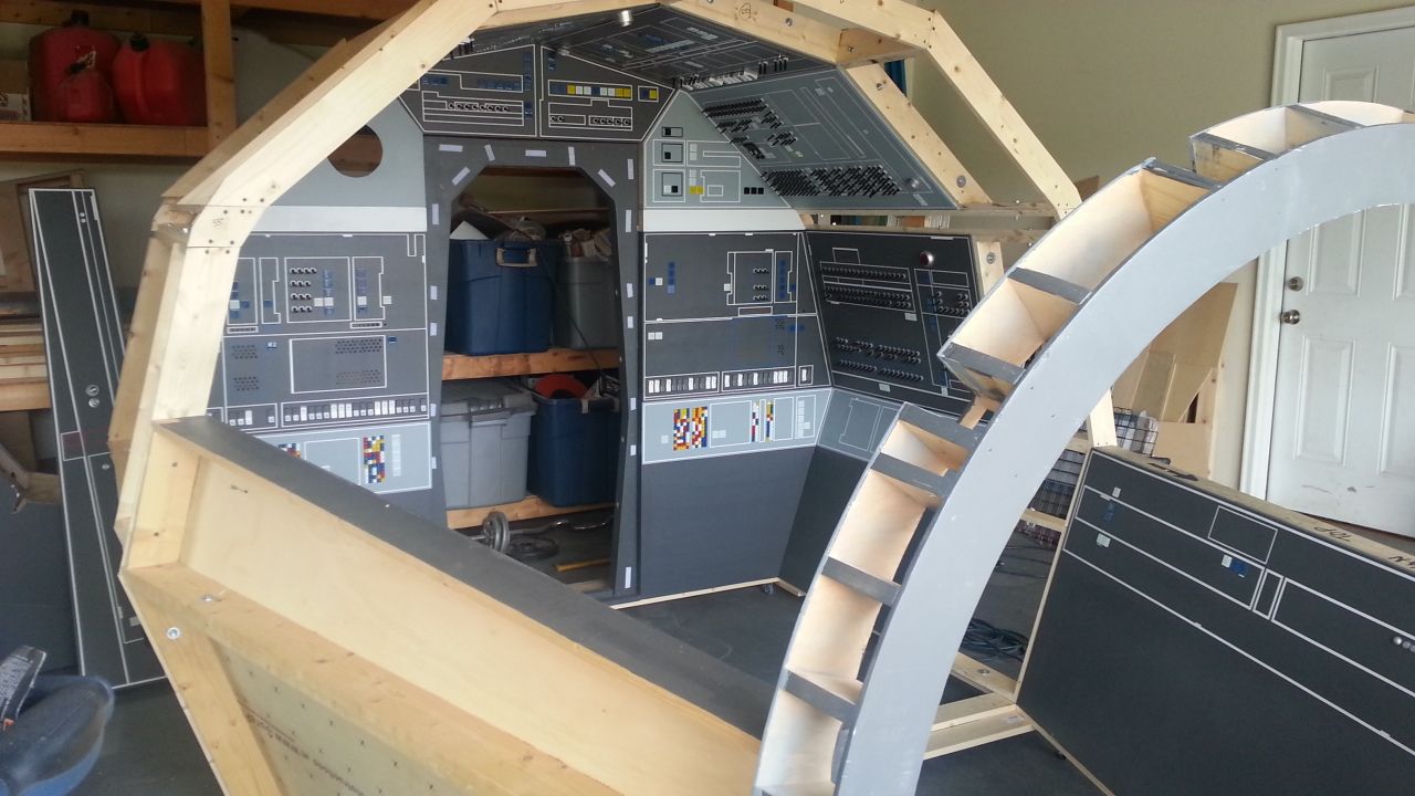

Re: 1:1 Millennium Falcon Console Replica

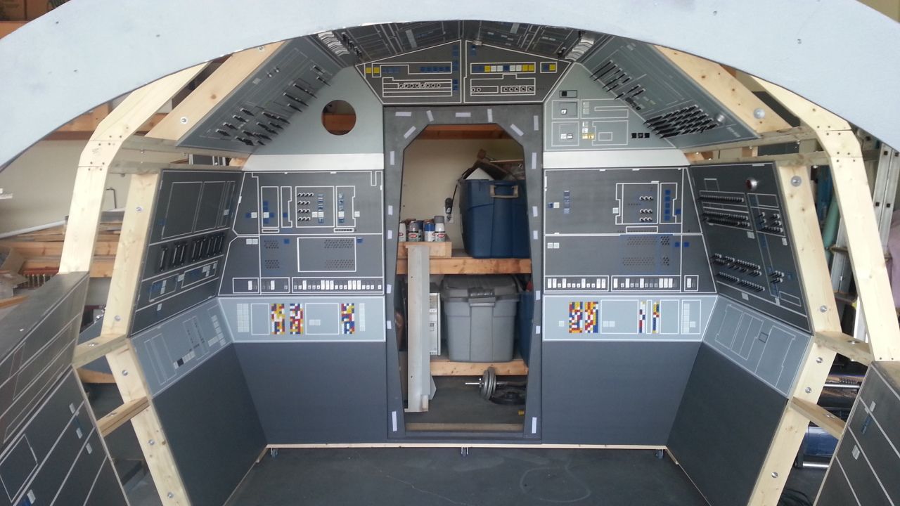

Ooh man the ESB adaptation is good, really really good. :cool

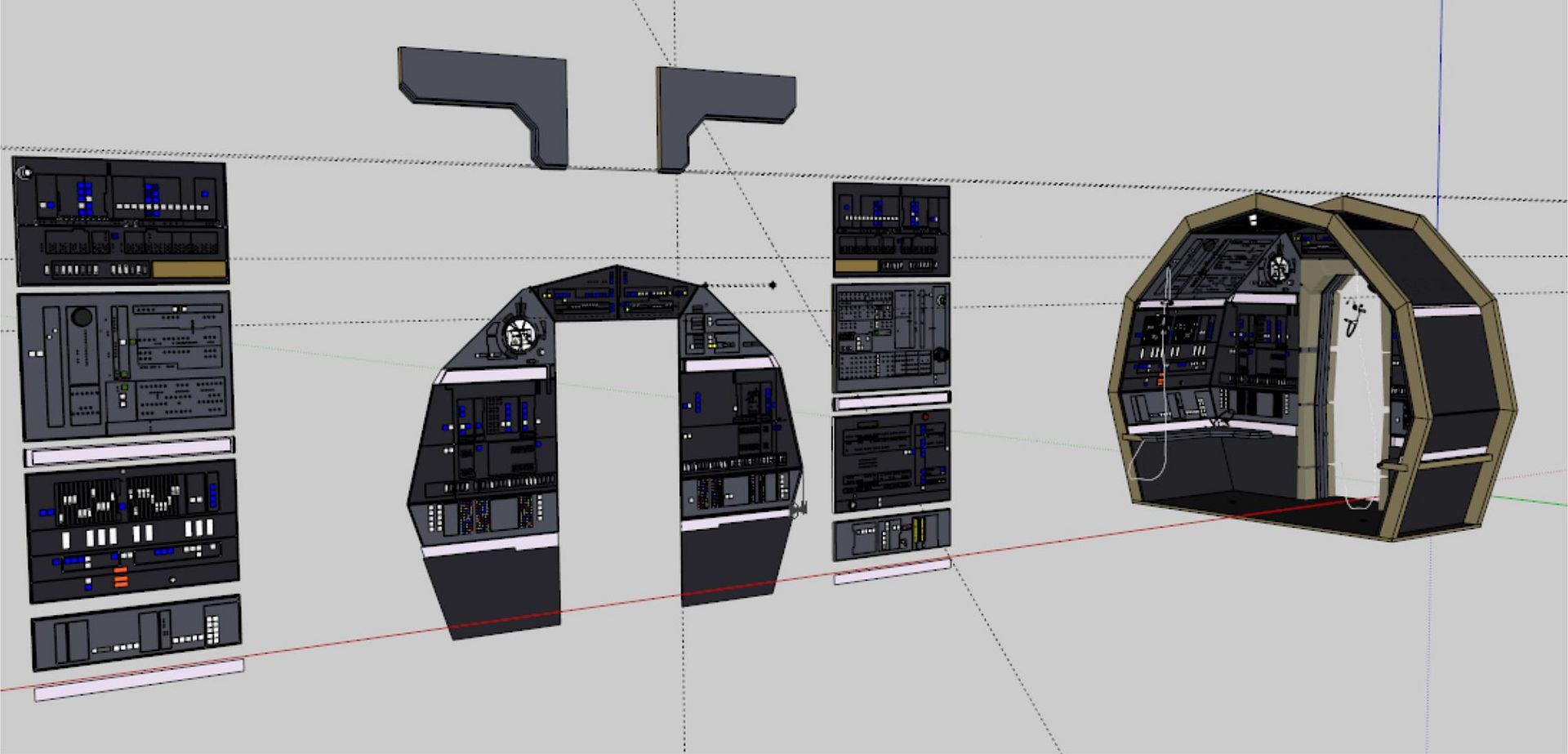

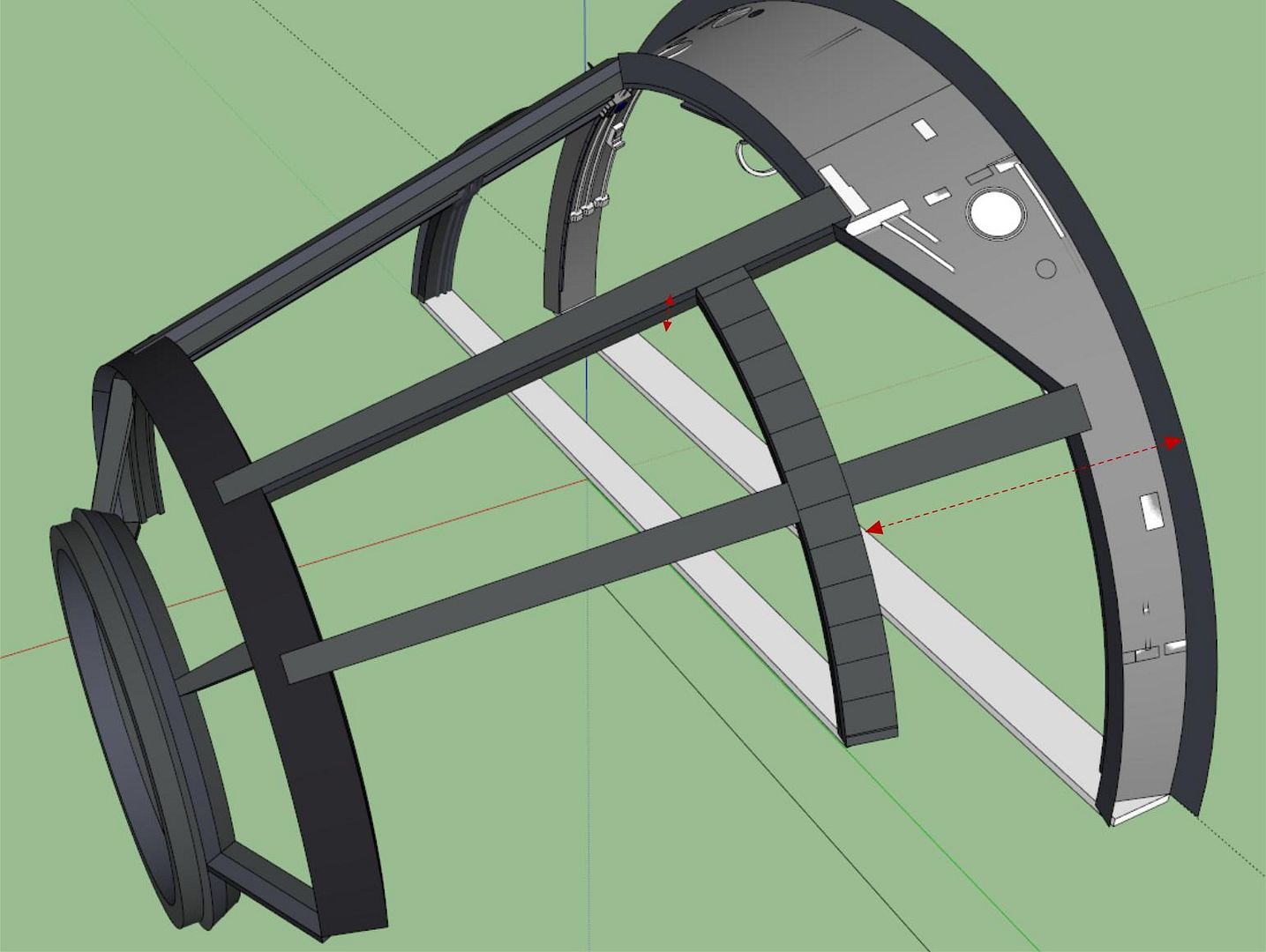

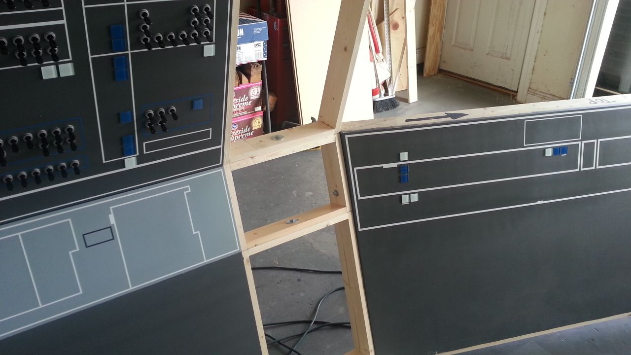

Out of curiosity, while doing all of this amazingness, what are you referencing as you work? I know you've got Stevestarkiller's blueprints and such, I'm not talking about the original plans, but more the medium you've got in the garage. Have you been printing up full size templates, or going back and forth from a smaller scale copy of the plans? Or do you have a laptop right there in the garage covered in sawdust :lol The engineer half of me was wondering how you've tackled translating the prints to reality. :confused
Hi L,
Believe it or not... I'm using ONLY Starkiller's 3D model (minus screen grabs for details/greeblies). I pour over his 3D model taking down ALL the measurements for any particular part/area and then print out on simple 8.5X11 paper... Here are sample images of what Starkiller forwards me...
I've removed all the measurements for obvious reasons - sorry
You can see how there is nothing showing how to mount the beams... That's when I wing it...
It's a VERY long process. I have an entire binder filled with different images from different angles, etc... with every measurement and angle. Even the pin striping is done the same way... Sometimes I have to fill in the blanks and just guess how to mount something (i.e. the canopy beams above)... And, after chatting with Starkiller, he discovered a HUGE discrepancy between the canopy and the outer skin... I might have to rework them...
I hope this helps. :)
Thanks you, Sir! Just wait till the paint and pin stripe. OH... did you ever identify those panels that surround 4 of these extension panels?
Hi L,
http://i778.photobucket.com/albums/...m Falcon Console Build/0001Cc_zps001a462b.jpg
http://i778.photobucket.com/albums/...m Falcon Console Build/0001Cd_zps25a33c4c.jpg
http://i778.photobucket.com/albums/...m Falcon Console Build/0001Ce_zps26a9d29b.jpg
Thanks for the pics! It may be a long process, but it's definitely working (y)thumbsup:thumbsup

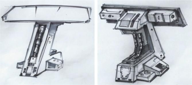

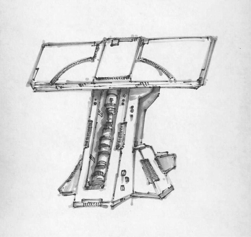

Hi Gang,
I did a VERY quick sketch of the backside of the first display stand and I think I'm going to go with this design. The only question is: Do I weather it the same as I did the quad platform or keep it neat and glossy like the medical stand from ESB?
Front & Back View
Give it a few dings, suggestive of medical carts and drugged patients bumping into it. No heavy weathering, as if it were constantly outside.
Likewise, since this is meant to be Falcon-ish, it could be a cargo manifest terminal or something, so maybe Chewy and Han carelessly kick it when loading cargo. Also, crates might sometimes bump into it.

Hi R4,
I like the idea of it being a cargo terminal. That way I can dirty it and bang it up a little - good call! :)
I did one more... I wasn't sure what to do with the top... it will be covered but I needed something. So I added a few details... I'm not sure whether you're looking at or tubing or a raised panel similar to the MF... :)
I was digging the idea of it being a scaled down version of the Falcon's landing leg just to keep the visual recognition, but then it takes it out of the "in universe" vibe and makes it more of a display piece. So even though you're making something entirely new I'd say it will add more to the realism by being "functional" instead of just "aesthetic".

Hi R,
I really liked the idea of the Landing Gear design as well... and in the end, either design would work. But I'm more excited by this final design. I can already see it finished in my head. And I agree... the Function does beat out the Aesthetic. :)

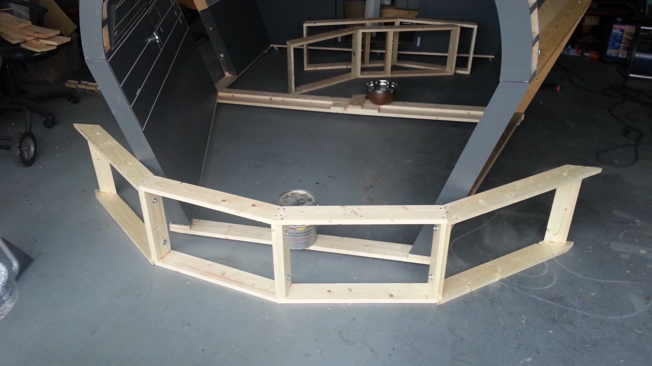

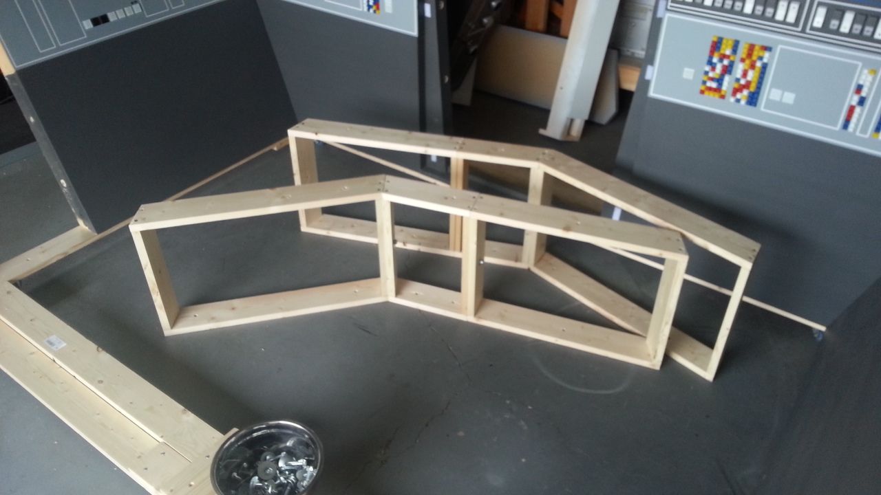

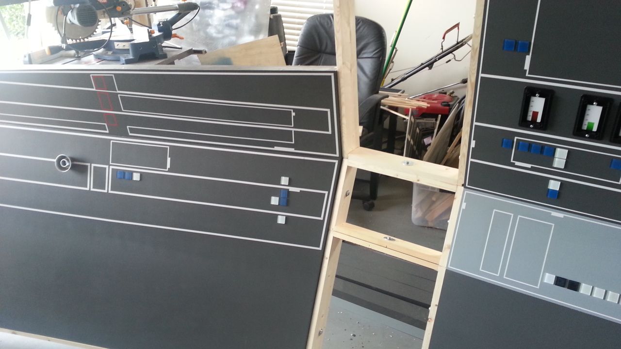

Hi Gang,
Well... the nose has been built and because of the weight of the back frame the nose doesn't exactly align - the light weight temp frame is bowing just a bit - but I'll find a work around... I do have several 2X4s lying around and might use them... it adds weight but they won't flex as much... ugh...
It looks odd with that huge gap...
I actually ran out of bolts and couldn't mount the other upper side nose panel... I'm off to the improvement store and then I take the nose off and the extension frame and then hopefully I can begin to skin...
Here we are...
Stay Tuned!

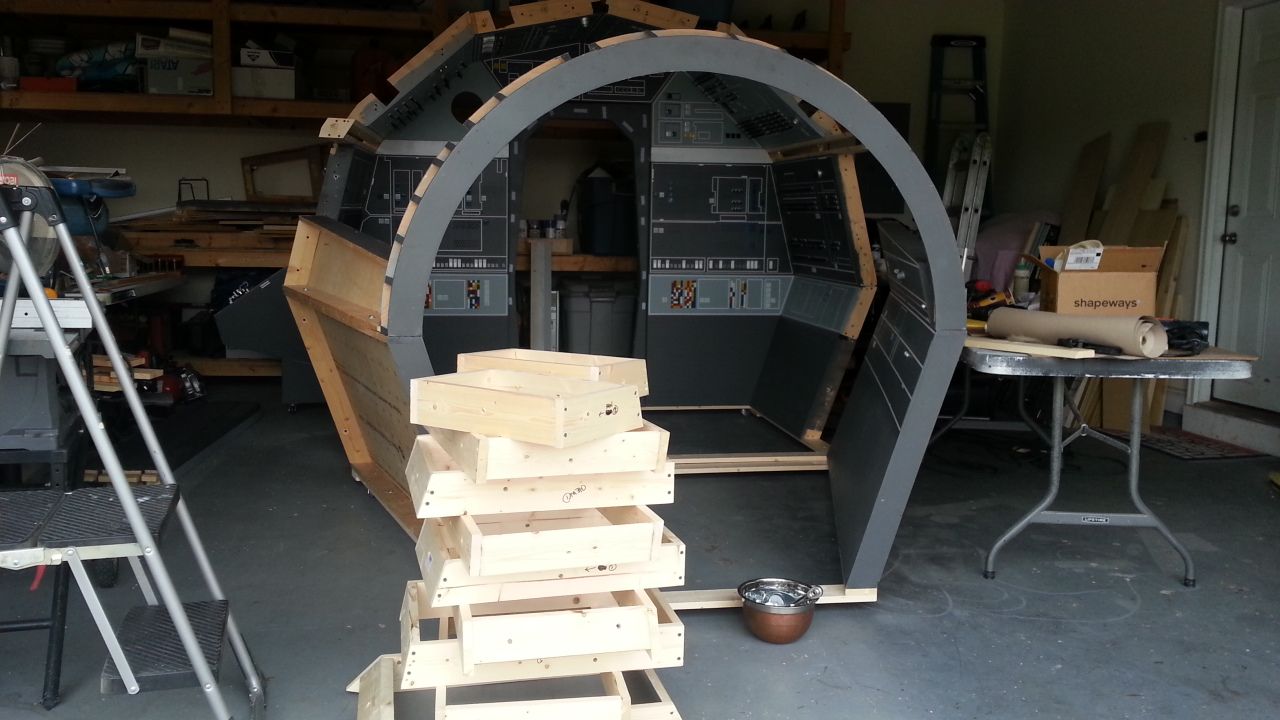

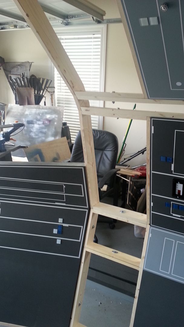

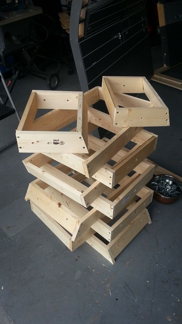

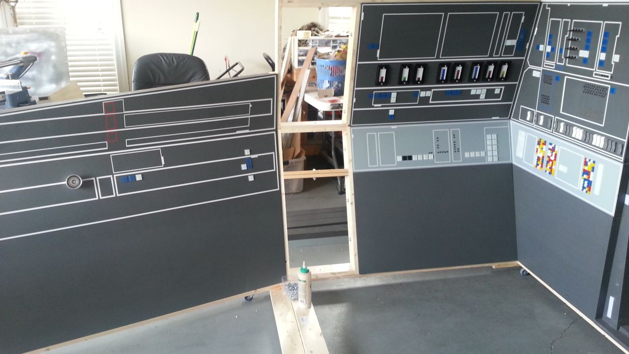

Extension frame is now down and apart... and like clock work... drizzle...
Light bars stay in place until the end
Just a few panels to skin...
