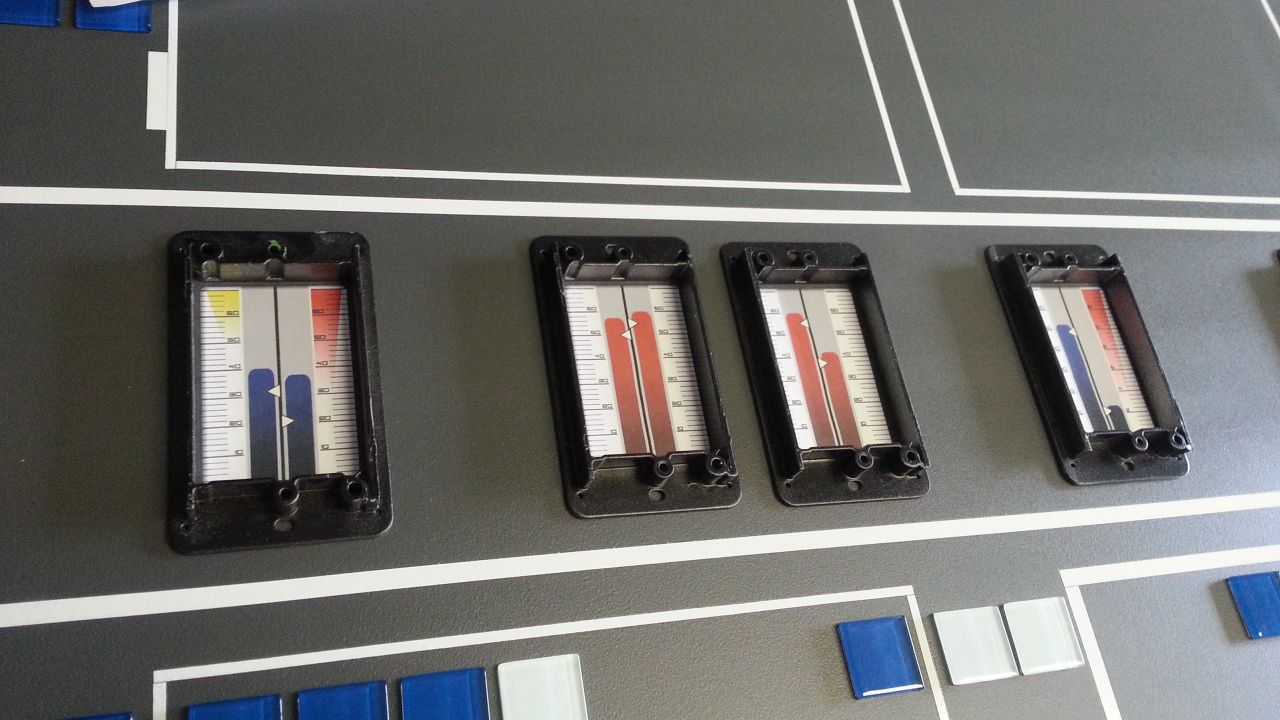

Re: 1:1 Millennium Falcon Console Replica
Hi Gang,

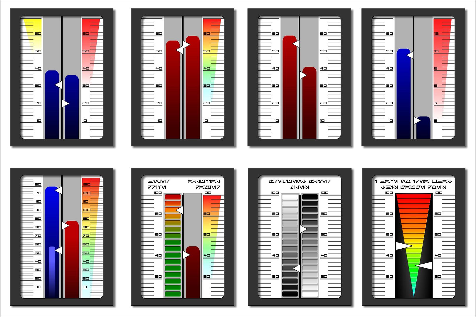

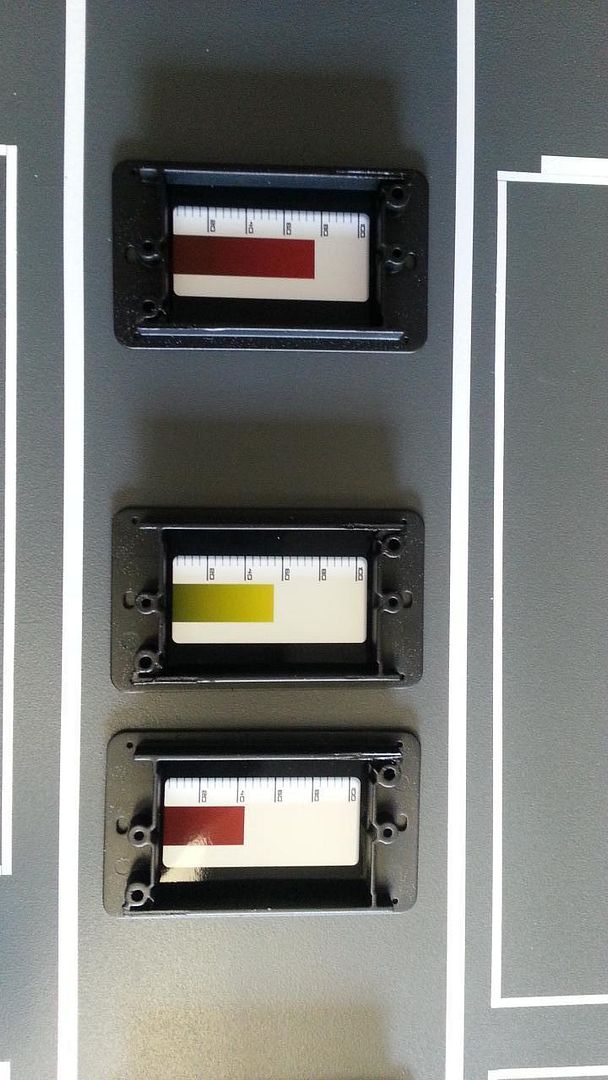

I have been working ALL morning getting this cockpit back together and I've been able to get past the warping issue. I just hope it doesn't rear it ugly head at the Makers Faire! Anywho... I took a break from the heat and designed some vertical gauge faces to fill the plastic "greeblies" I found at the improvement store. These are NOT screen accurate but I think they work just the same. I'm going to print them on nicer photo quality paper before the show.
Mount these in place with hex screws
Slide these prints behind - Yes, this is the SW font :)
LOTS MORE TO FOLLOW!

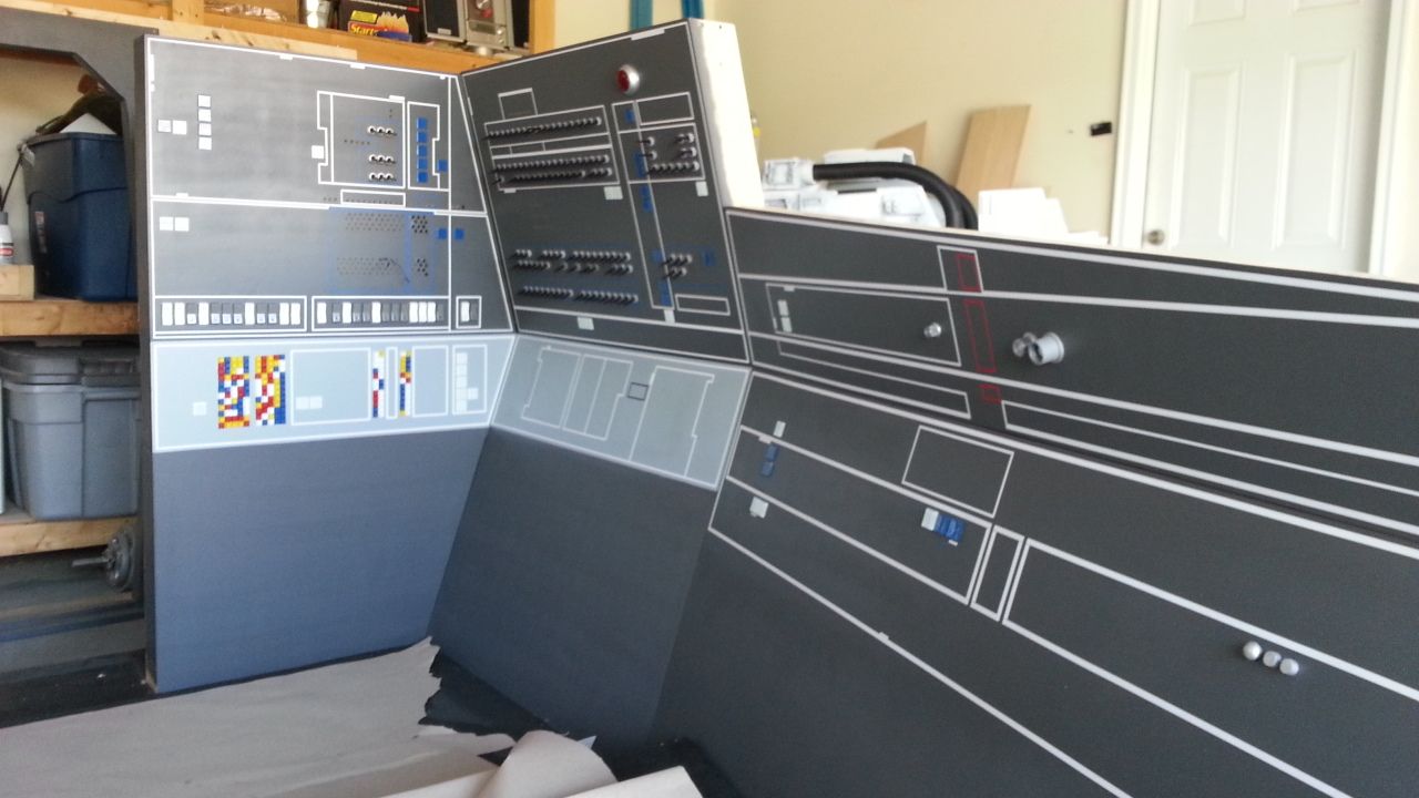

Hi Gang,

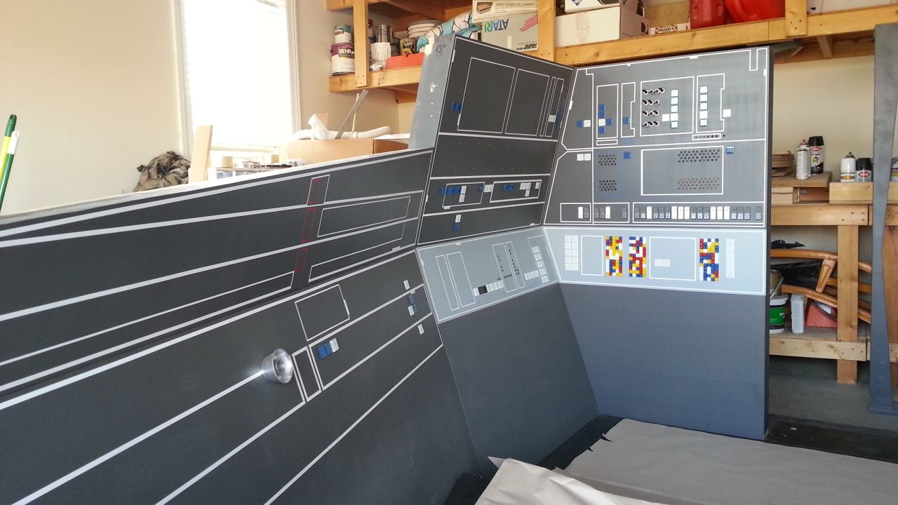

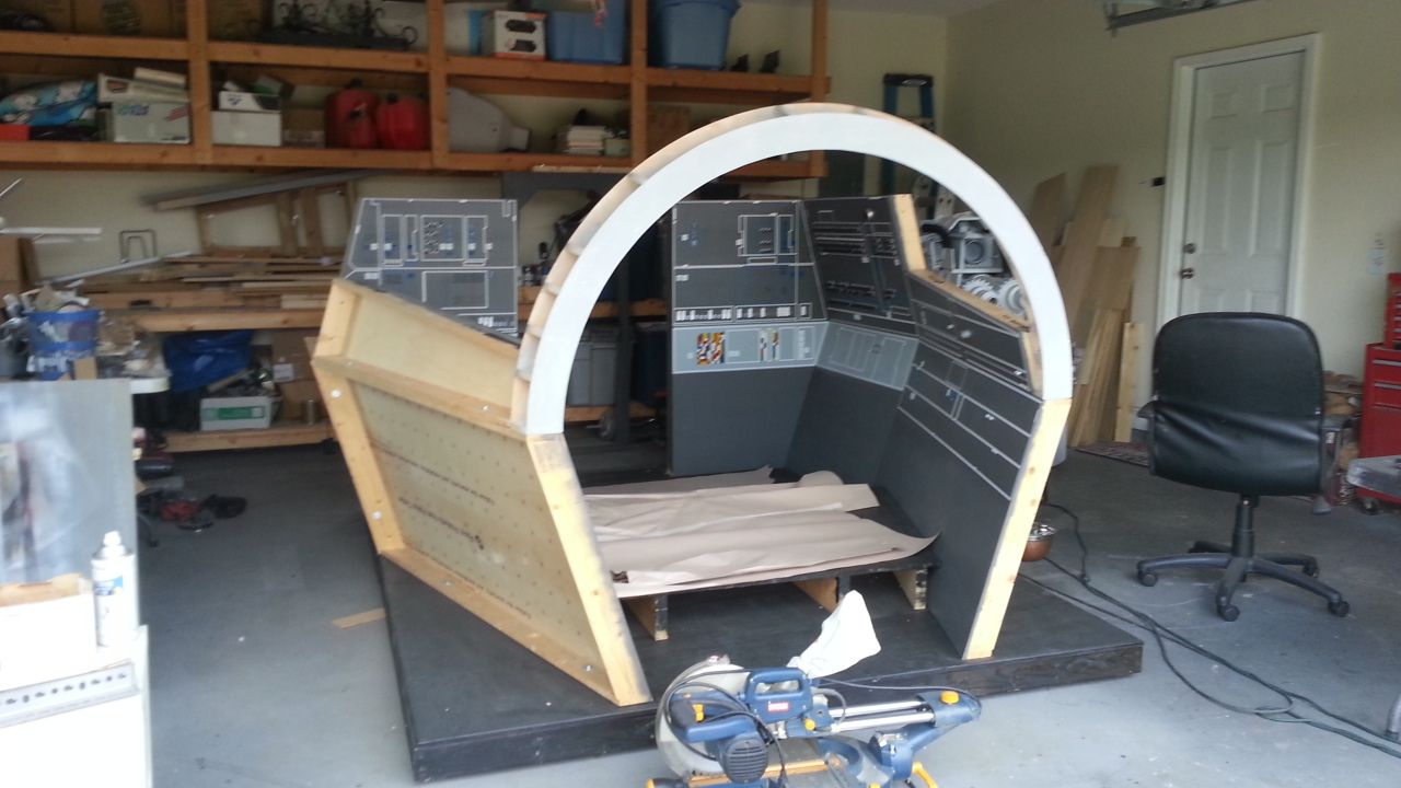

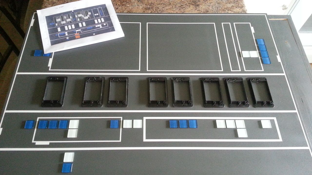

Well... It may not look like much but I have done A TON of work on the cockpit...

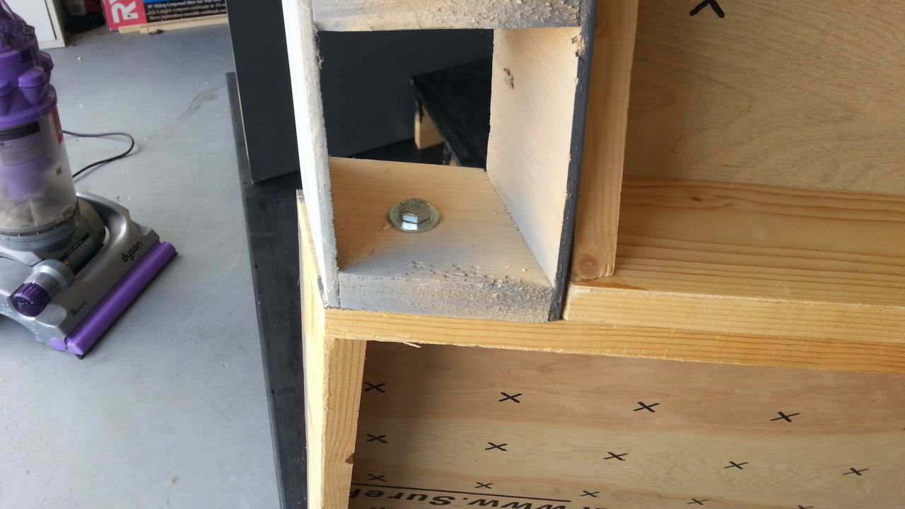

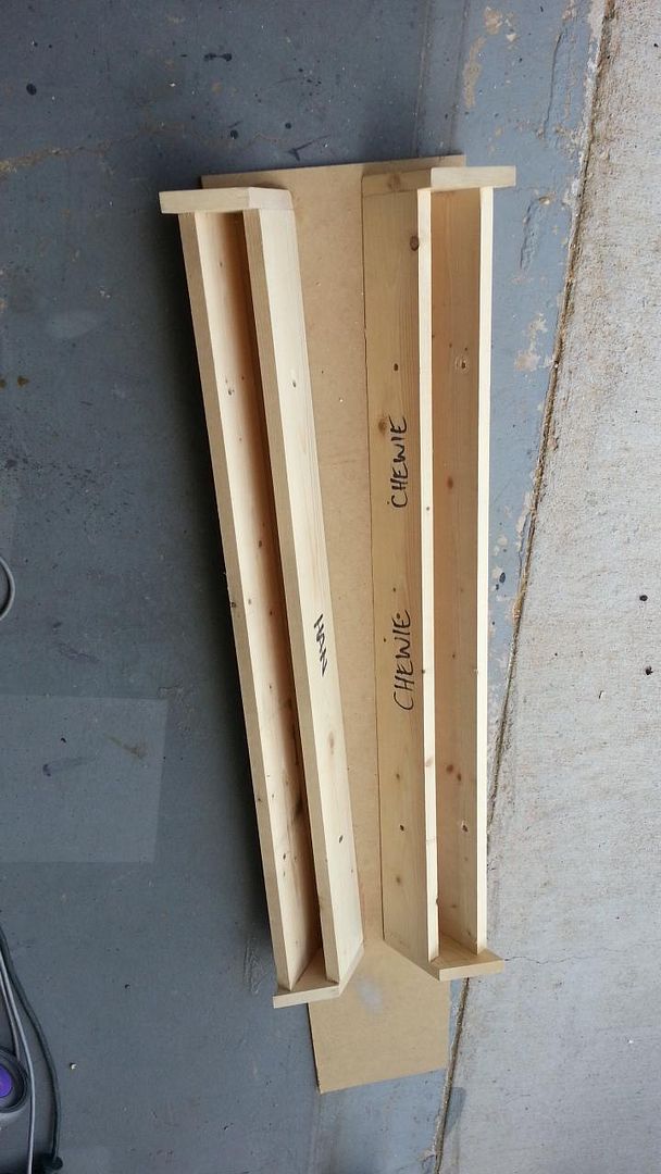

After struggling with the platforms I was able align everything and bolt the problem areas together. I attached the front window arch
Instead of backlighting the barlight I decided to paint them white. There just isn't enough time between now and the show.
a few greeblies plus the barlights. They will be a gloss white
This is where we are... :) Once I get the greeblies situated for the panel behind Chewie, I can bolt the rest of the panels together and begin measuring the canopy arch and horizontal beams!

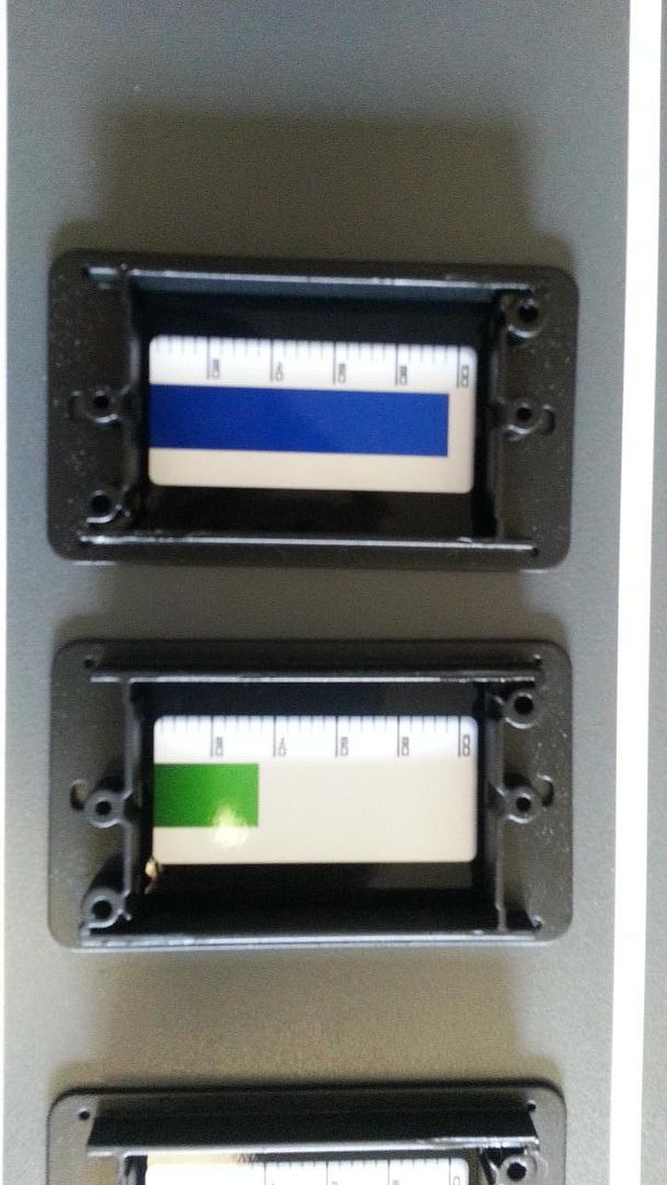

Hi Gang,

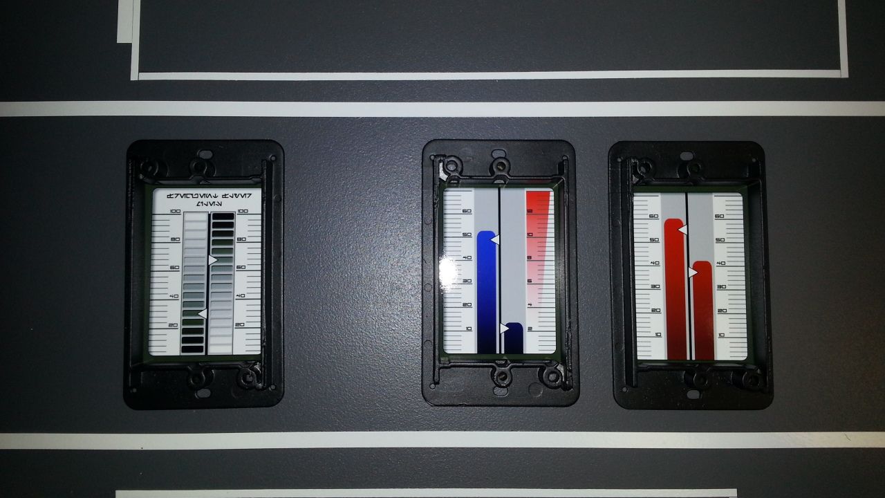

I finished the gauge faces... Feel free to use them :)
Stand By!

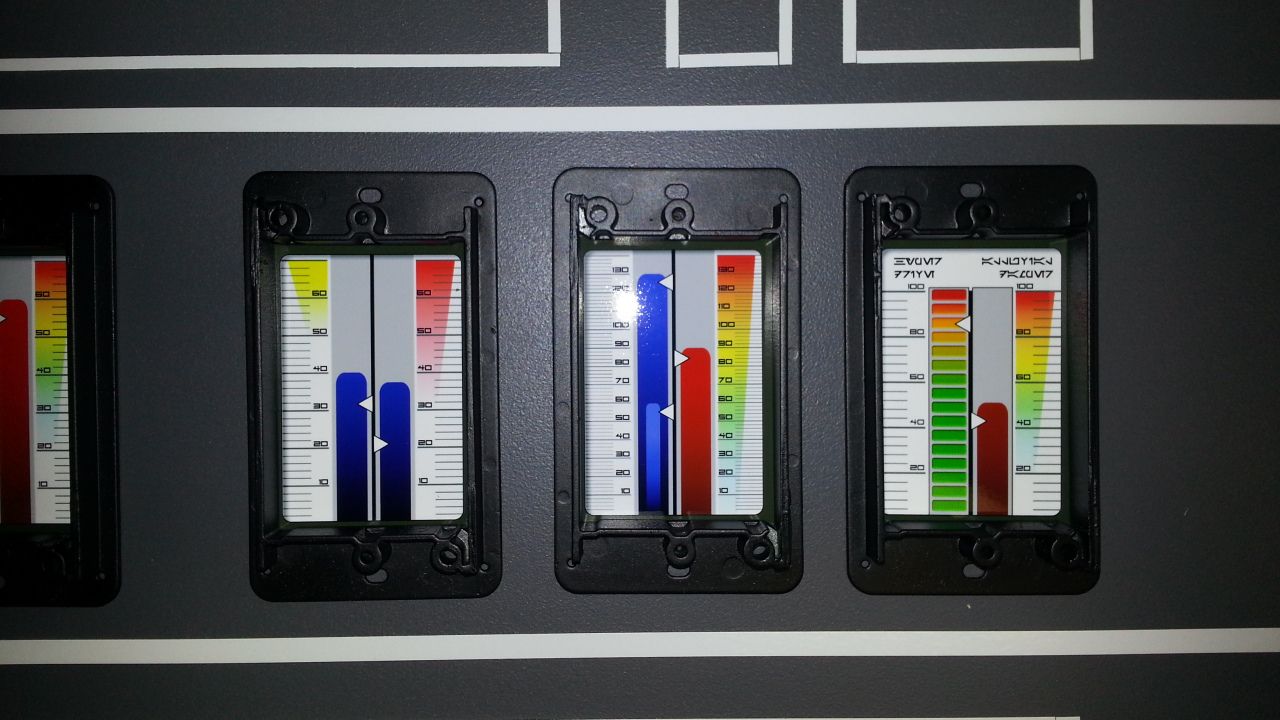

Hi Gang,

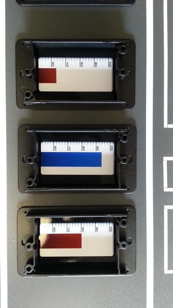

Printed out the gauge faces on high gloss photo paper...
These are not in their final position
I'm happy with it :)
I'm off to the art supply store to pick up some mold making material to create the slider bases and then this panel will be finished!
As always... Stay Tuned!

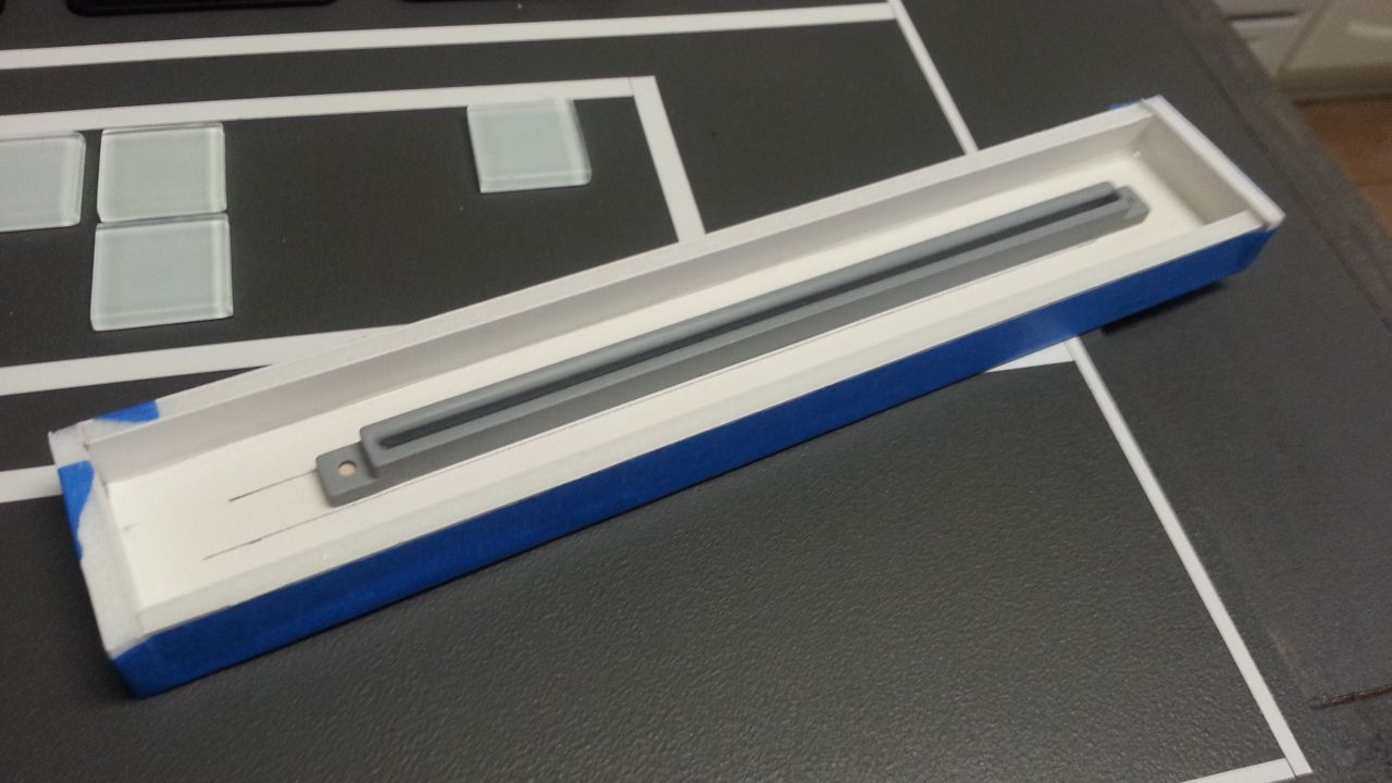

Hi Gang,

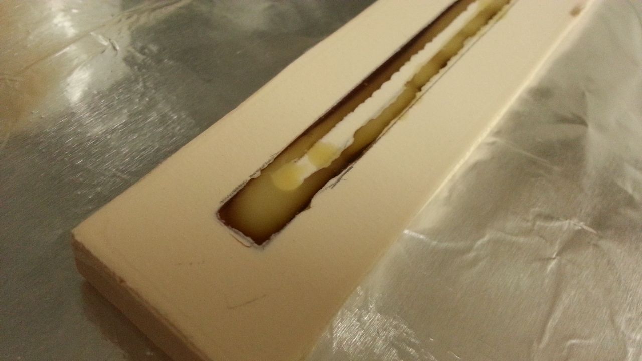

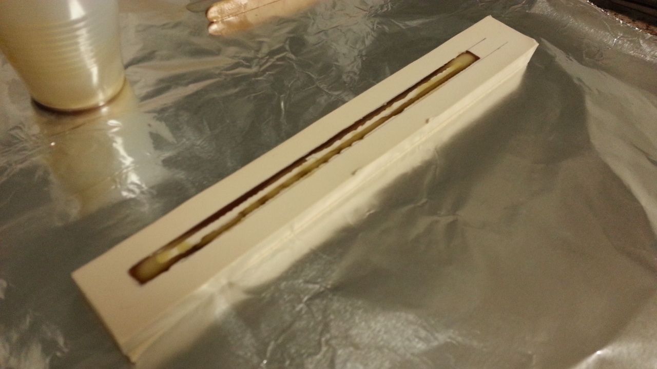

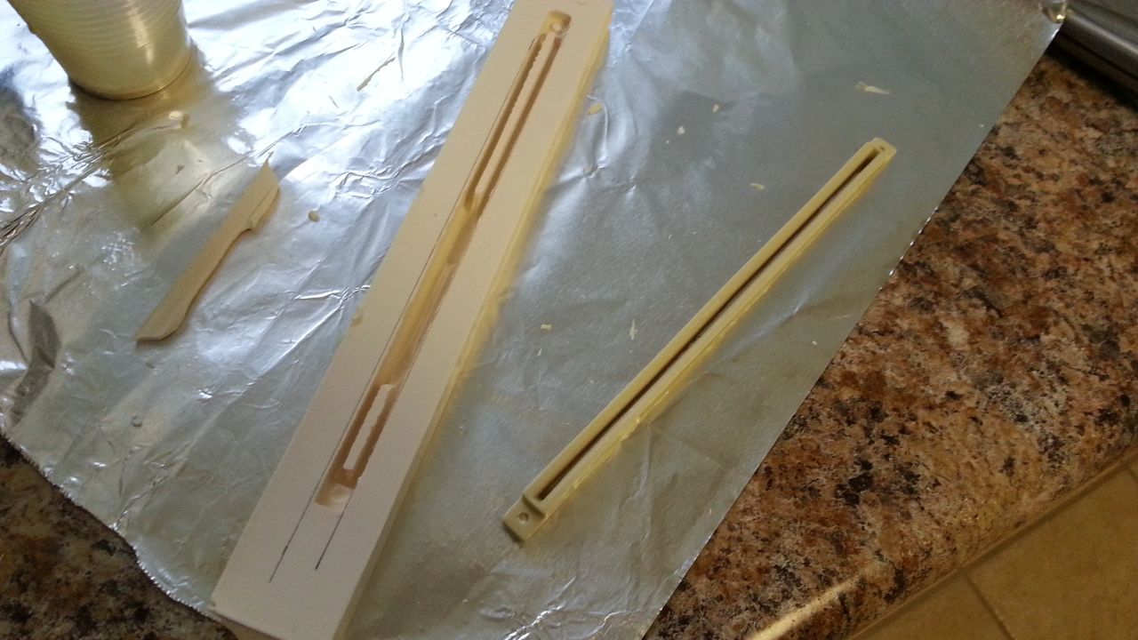

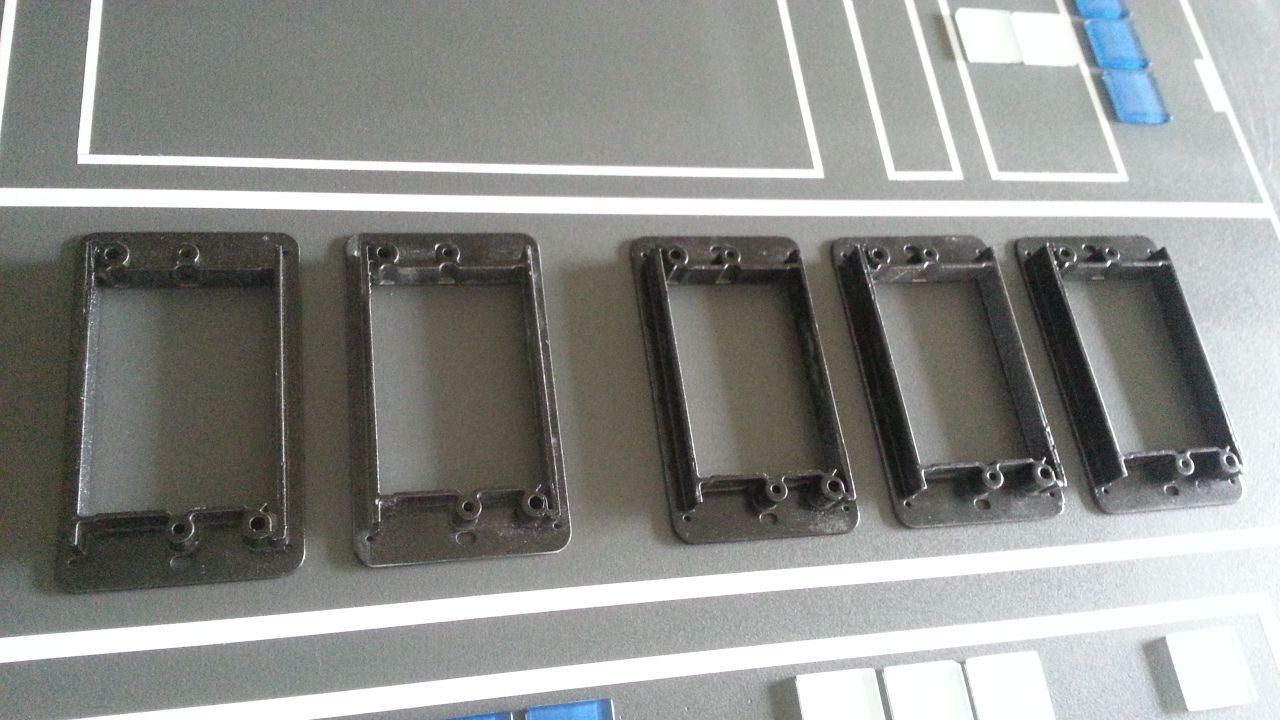

Well... the mold worked but there was a slight problem...
As always I created the box to create the mold
Once the mold cured I heated the mold, prepped it with baby powder and poured the resin
Well... when I pulled the casting from the mold the center tore off the mold
UGH
So now the question is... do I 1) try to make a NEW piece out of balsa wood, make a new mold hoping the solve the problem, 2) try to salvage / modify the original 3D print to make a new mold, 3) go back with the original idea I had or 4) try to modify the original pieces and make a new mold? UGH...
Also... I think the gauges are a bit overkill. The graphic artist in me got a little carried away with the design. I'm going to redesign the vertical gauges and keep them simple.
Stay Tuned!

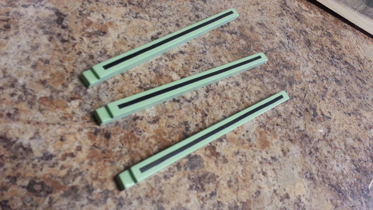

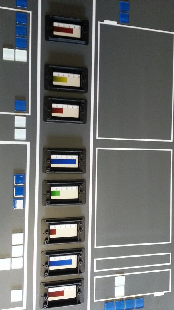

Hi Gang,
Well... the new gauges have been printed. I think these are much better and much more simple.

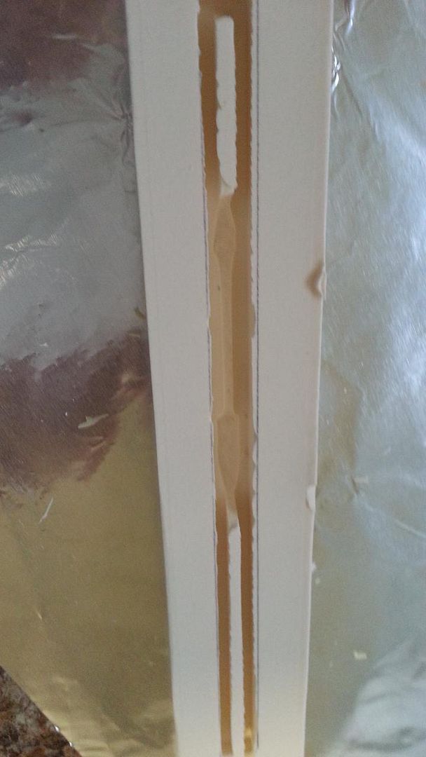

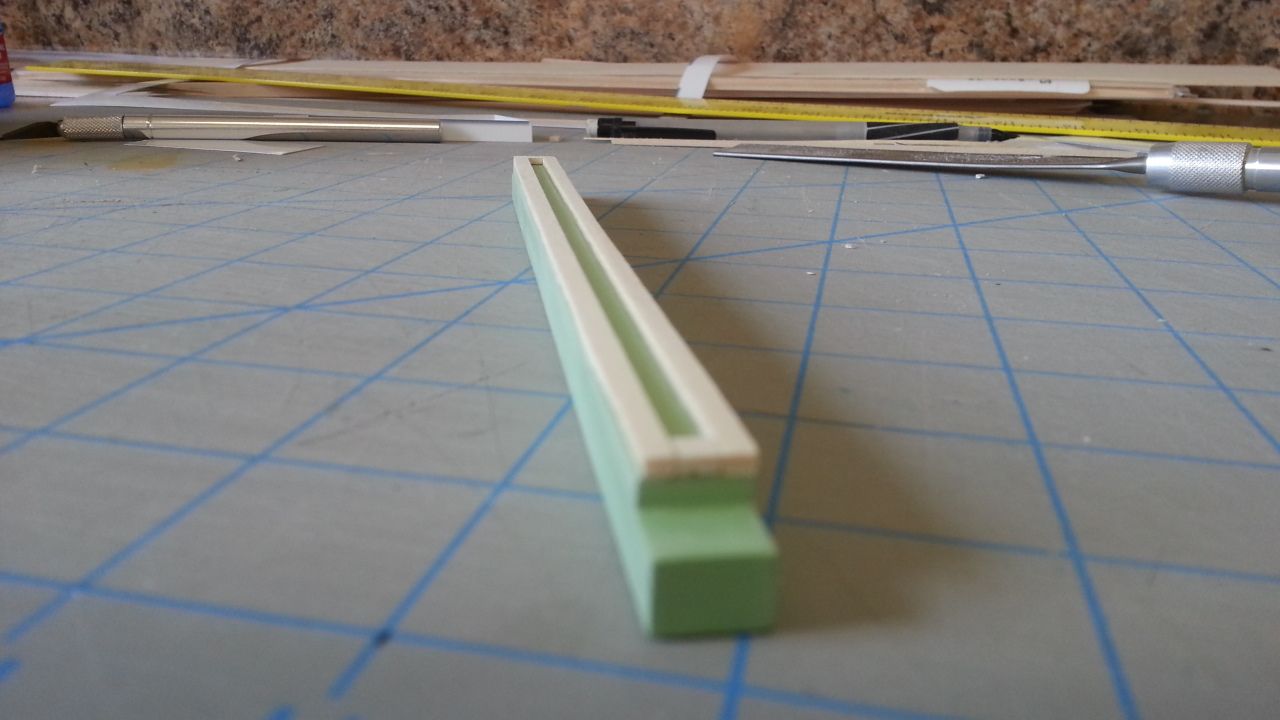

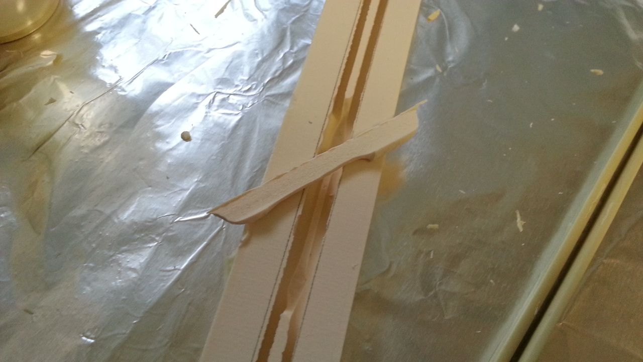

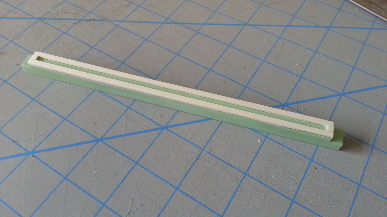

Also, after thinking about the slider base I decided to modify the original version. The bulk of it was already done so I decided to add a simple balsa top giving the appearance of depth...
Gauges - who knows... maybe I'll change them again :)

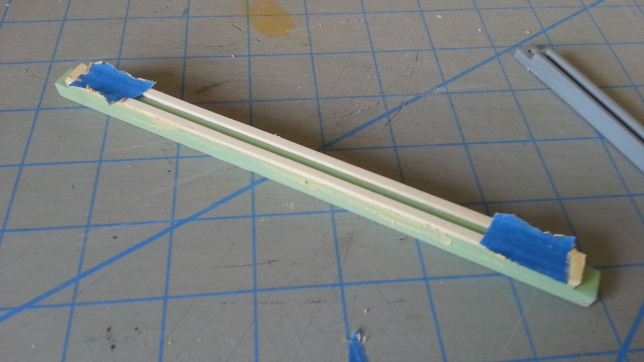

New slider base
As you can see the 3D print has a MUCH lower profile than the one I originally created. This should make it much easier for molding
I've added a little filler and waiting for it to dry - I'll set in the sun to help speed it up!
Stay Tuned!

While I agree that the other gauges might have been a bit much, I did like the Aurebesh. I have to ask though, what exactly IS an Alluvial Damper?
Also, the "I have no idea what this gauge does" made me chuckle.
Have you thought about filling in the printed slider piece so the section that is giving you issues isn't as deep? It might help when removing from your mold. Also, Have you tried using a spray mold release? (I'm not very knowledgeable when it comes to making or using molds. Just throwing some ideas out there)

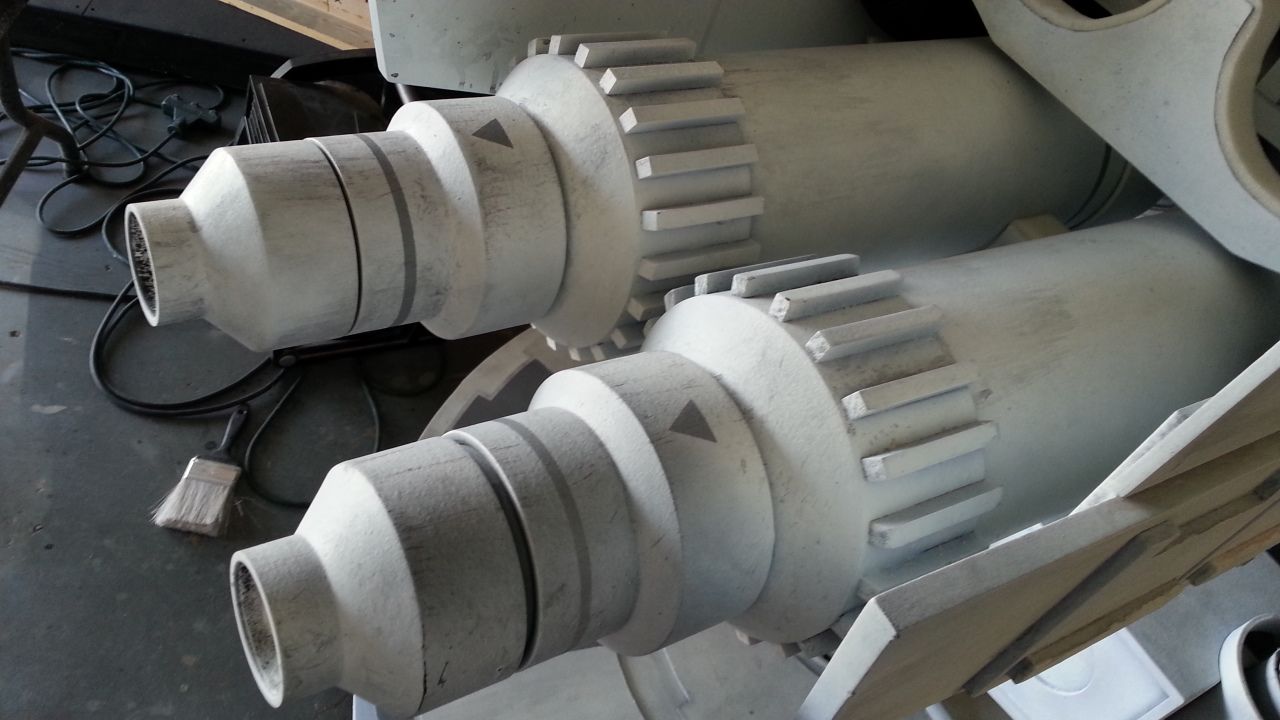

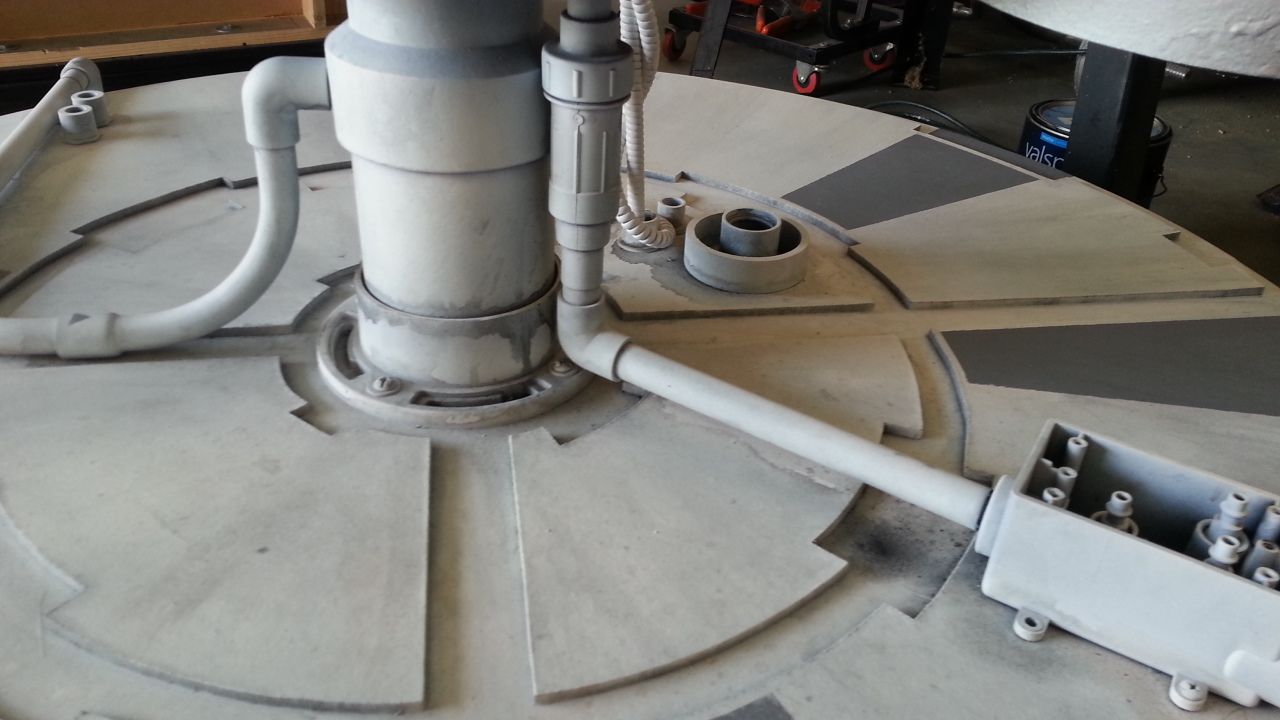

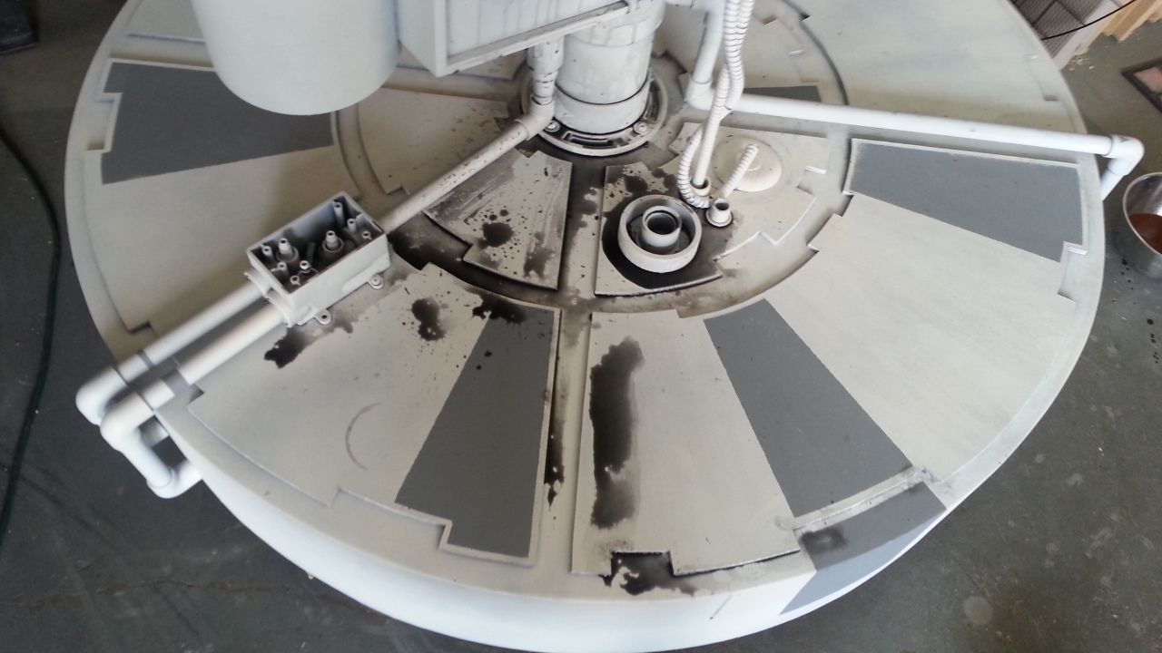

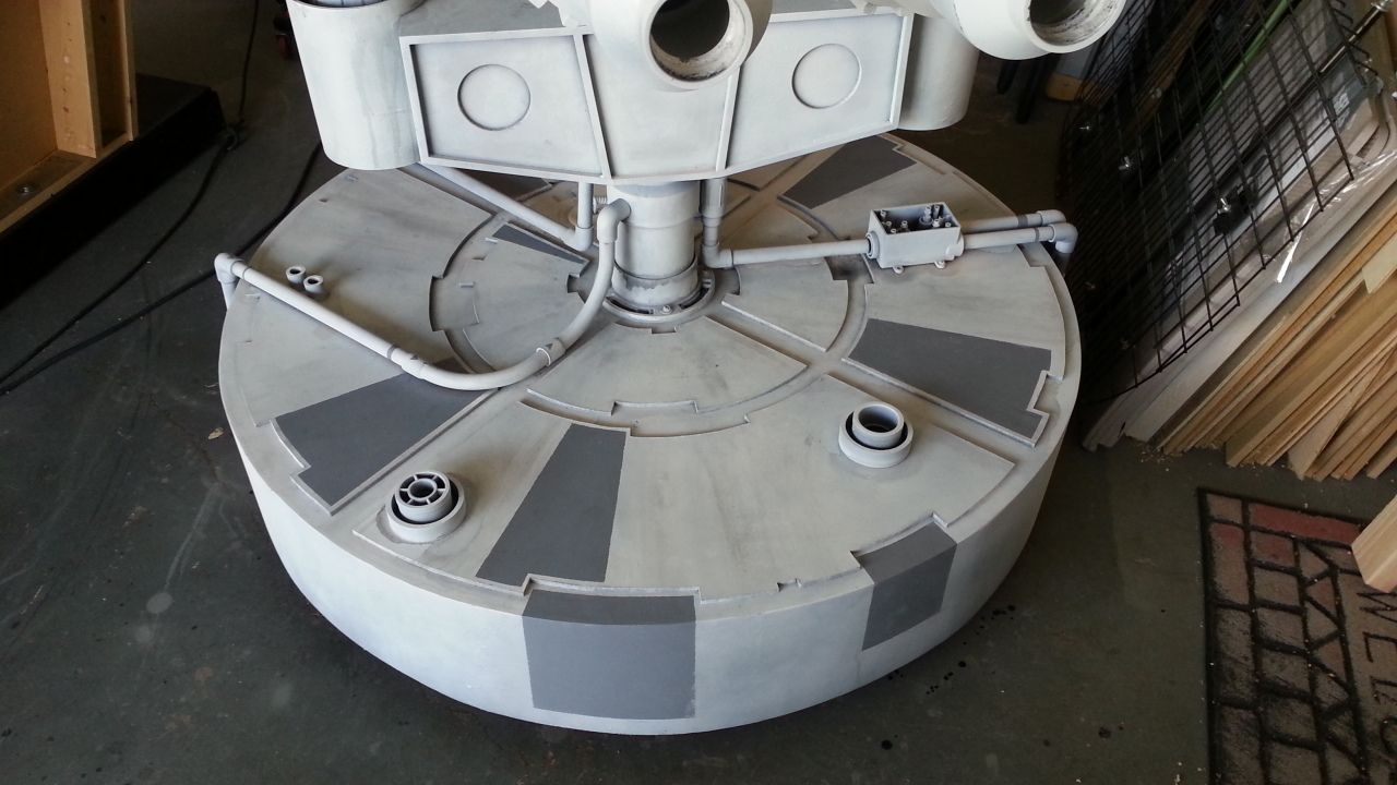

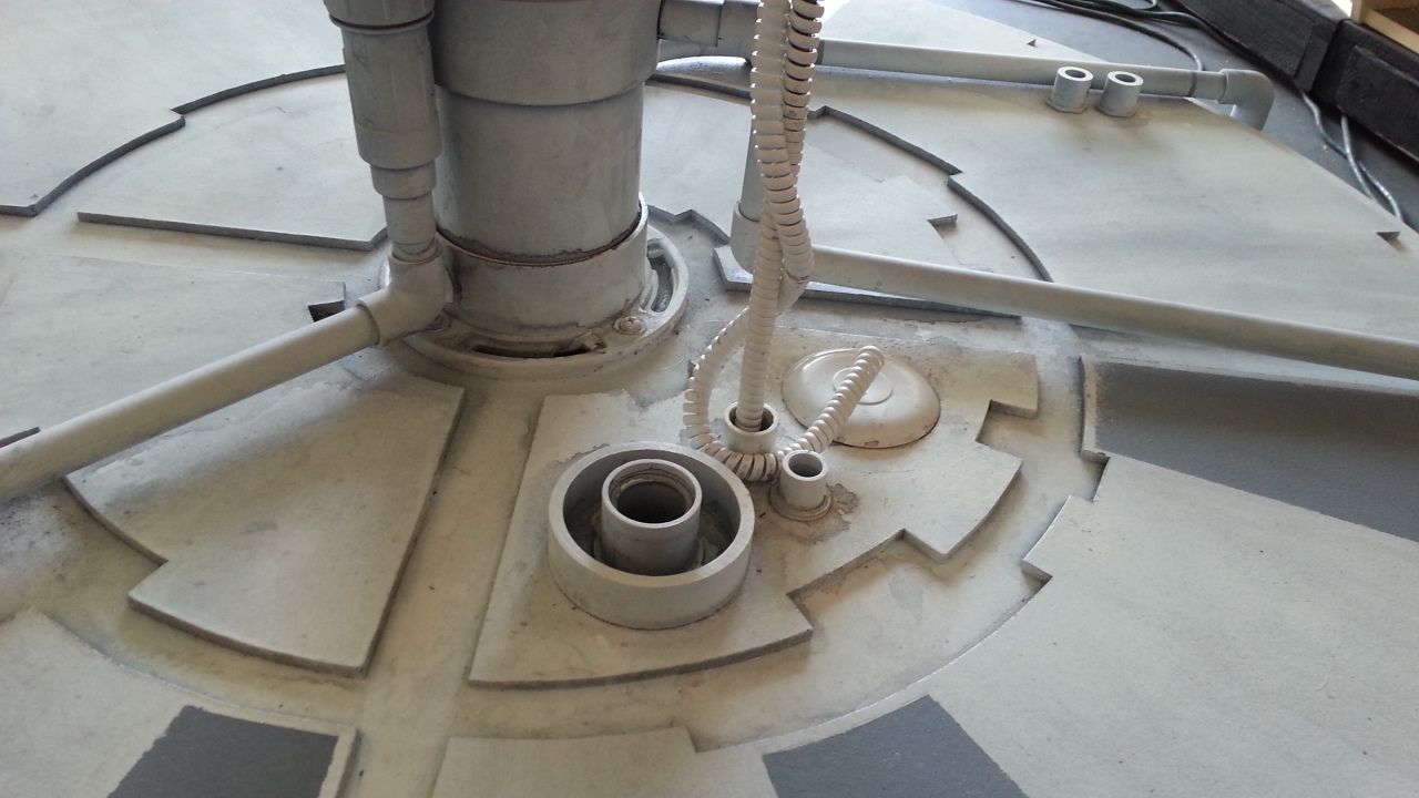

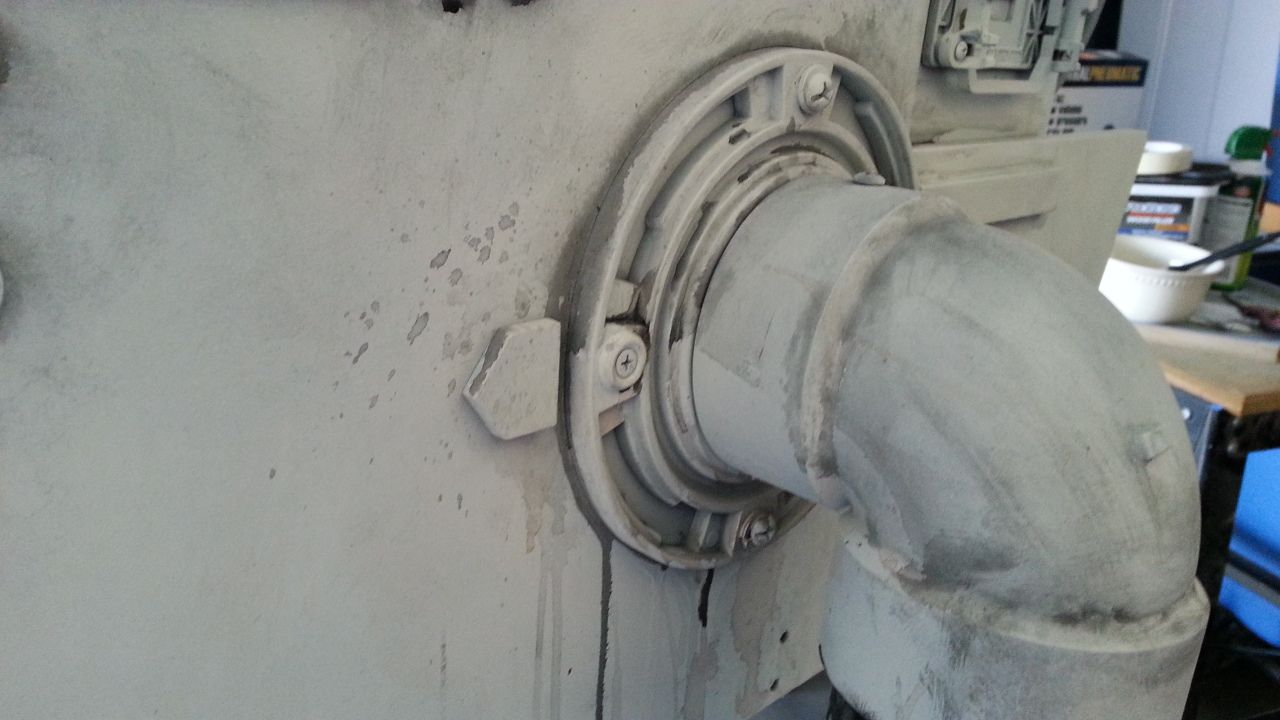

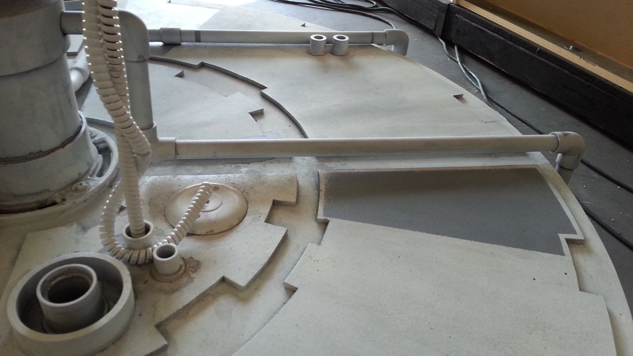

Hi Gang,

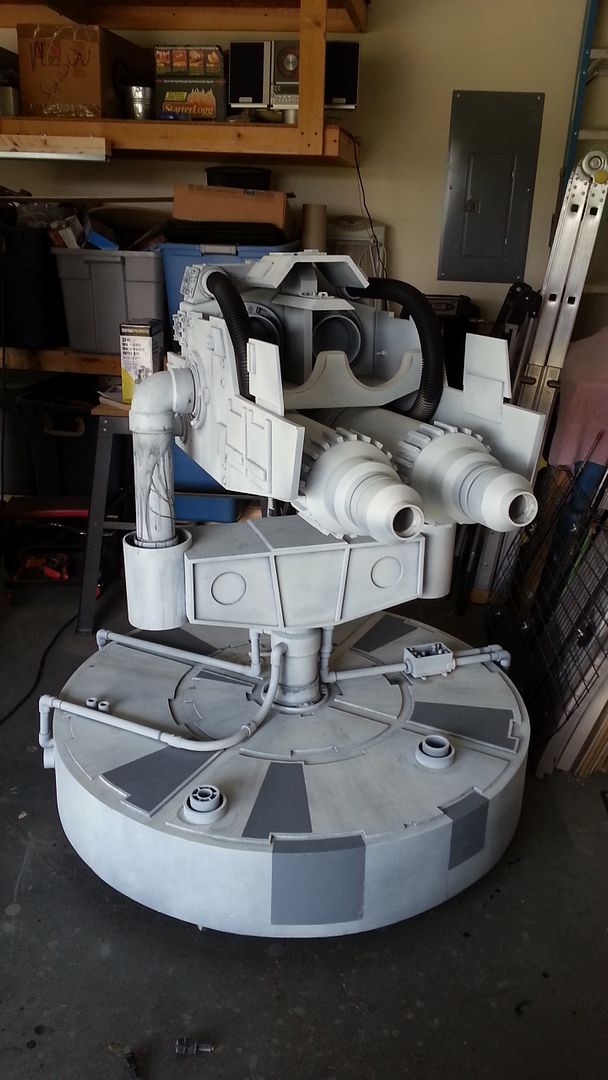

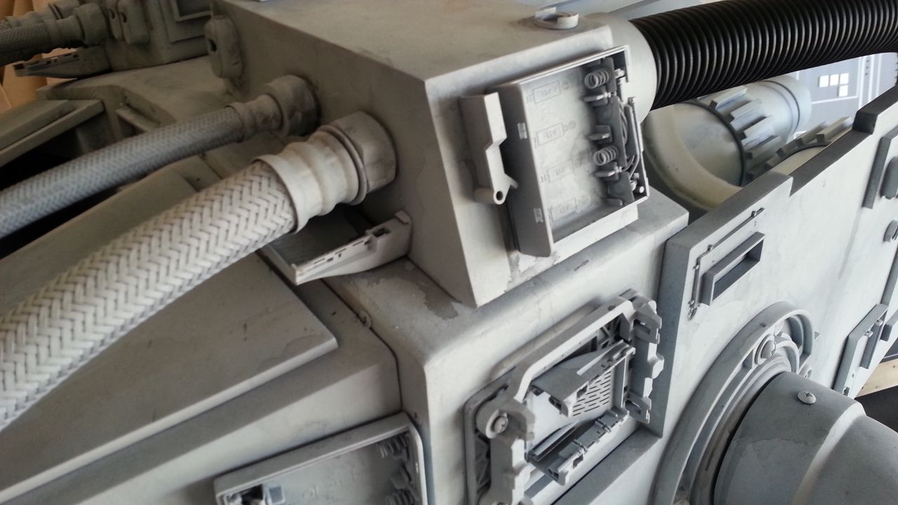

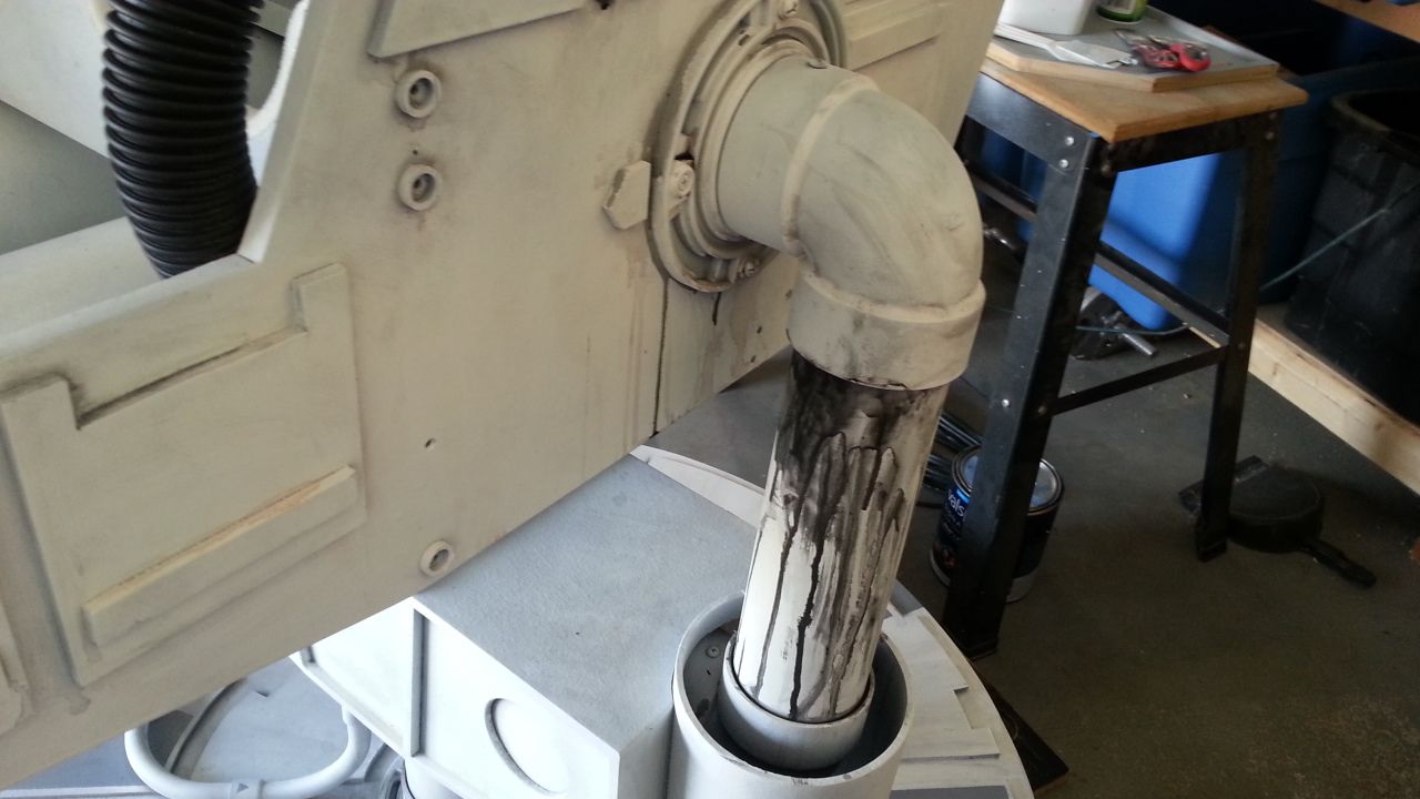

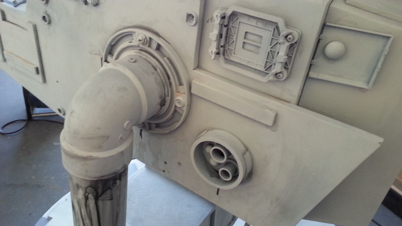

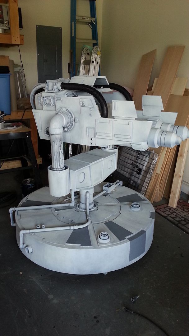

It is REALLY hot today and humid so I decided to jump in and... After watching Adam Savage's quick tutorial on how to weather large objects, I decided to go for it! Thanks, Mr. Savage!!!!

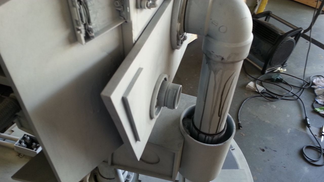

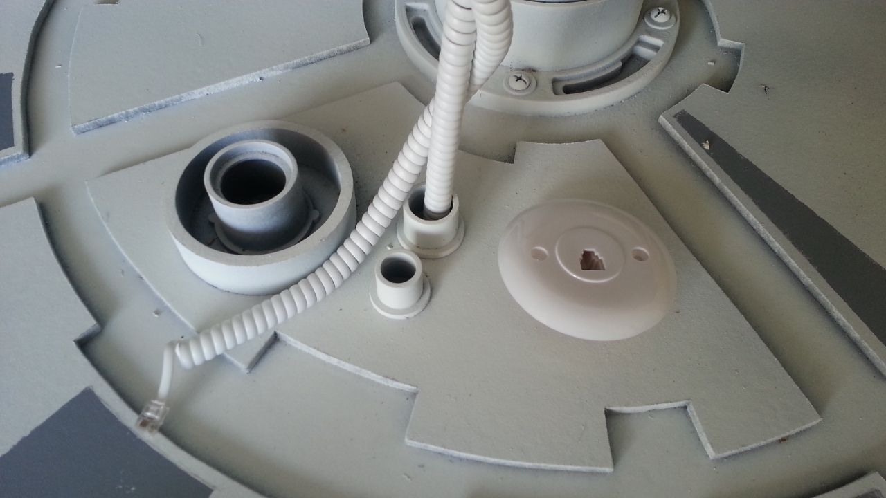

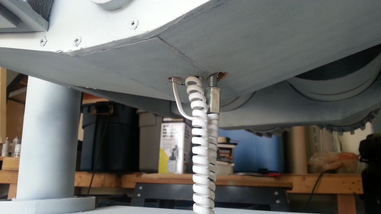

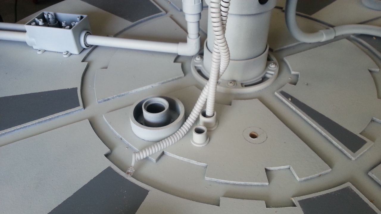

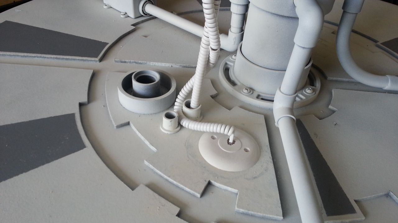

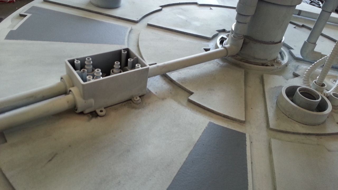

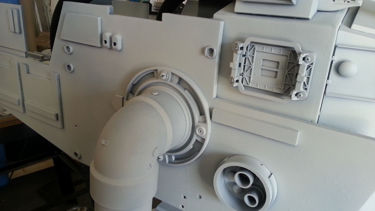

The first thing I did was FINALLY get the connecting rod through the main body of the quad to mount through the platform. This was NOT easy. Luckily I had a drill bit long enough but it was pretty worn out. When I finally drilled through to the other side of the main body... well... let's just say I had to pour some water into the hole (it was smoking pretty badly). The idea is that this will keep the body from tilting forward when the barrels are added and get rid of that ugly vertical support bar.
I then dressed it with two phone cords
And added a phone mounting plate on the platform

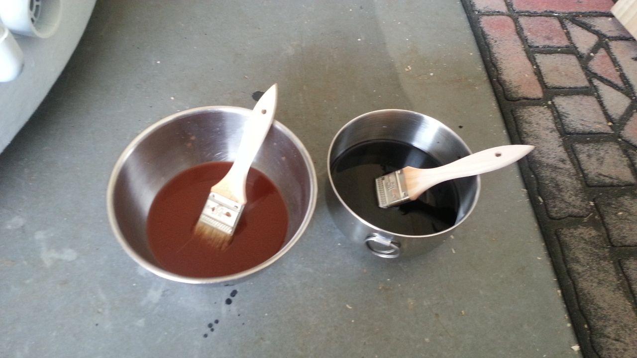

I then picked up some acrylic paints (blacks and two browns) from the art supply store and...
Away I went!

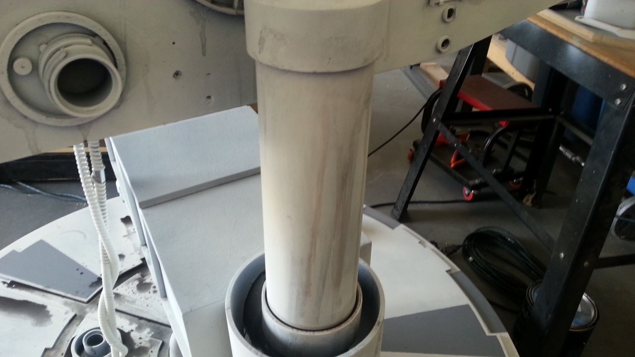

I basically used VERY watered down paint(s) and dropped it in misc areas - focusing on the pipes
I then used a cloth to pick up a majority of the paint which left various highlights... And on and on and on
After a while the cloth became so filthy I was able to use just that cloth for streak marks
Here I applied a thicker black/brown to give the appearance of oil streaks
A little too light - needs more gunk
Close Ups
I'm going to let this dry and then do another layer
Before
After
More to Follow!

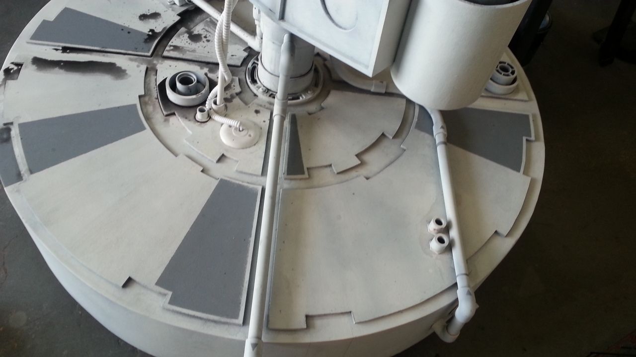

Hi Gang,

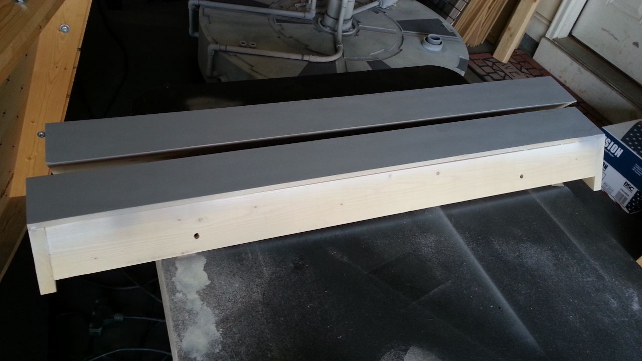

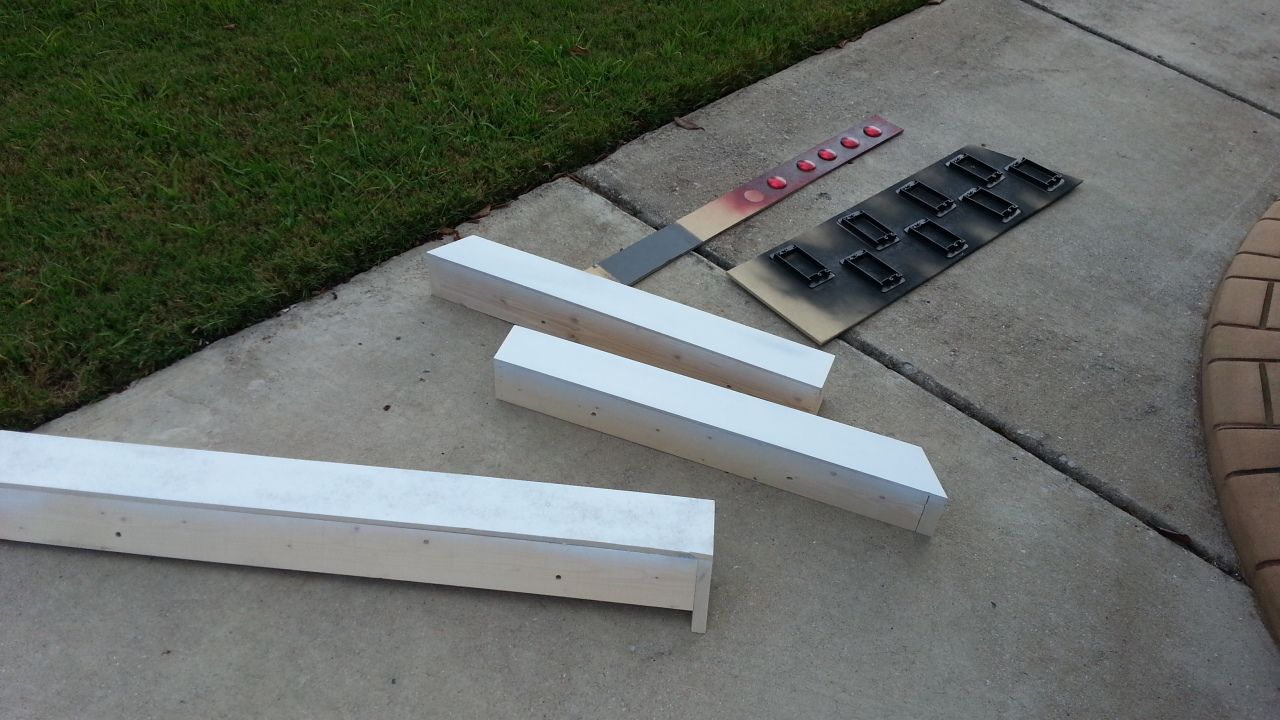

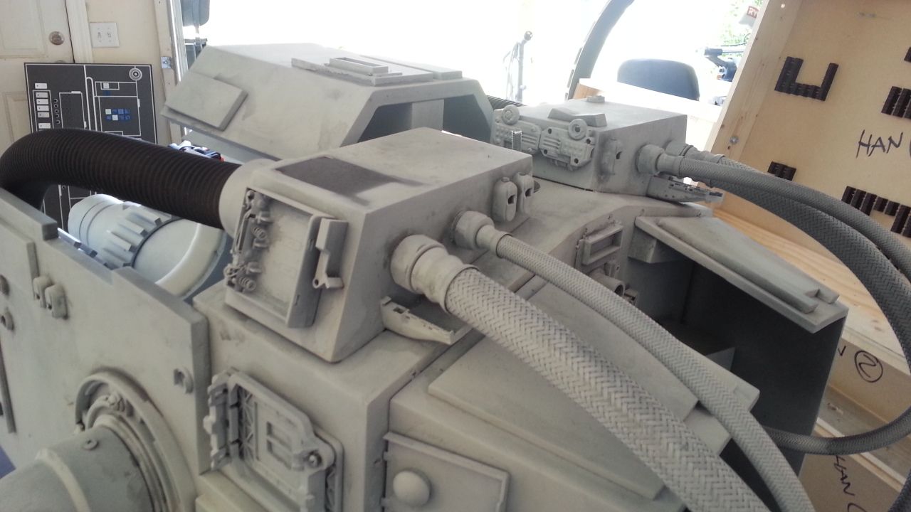

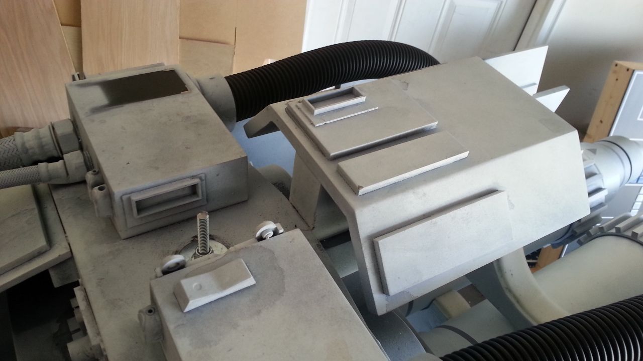

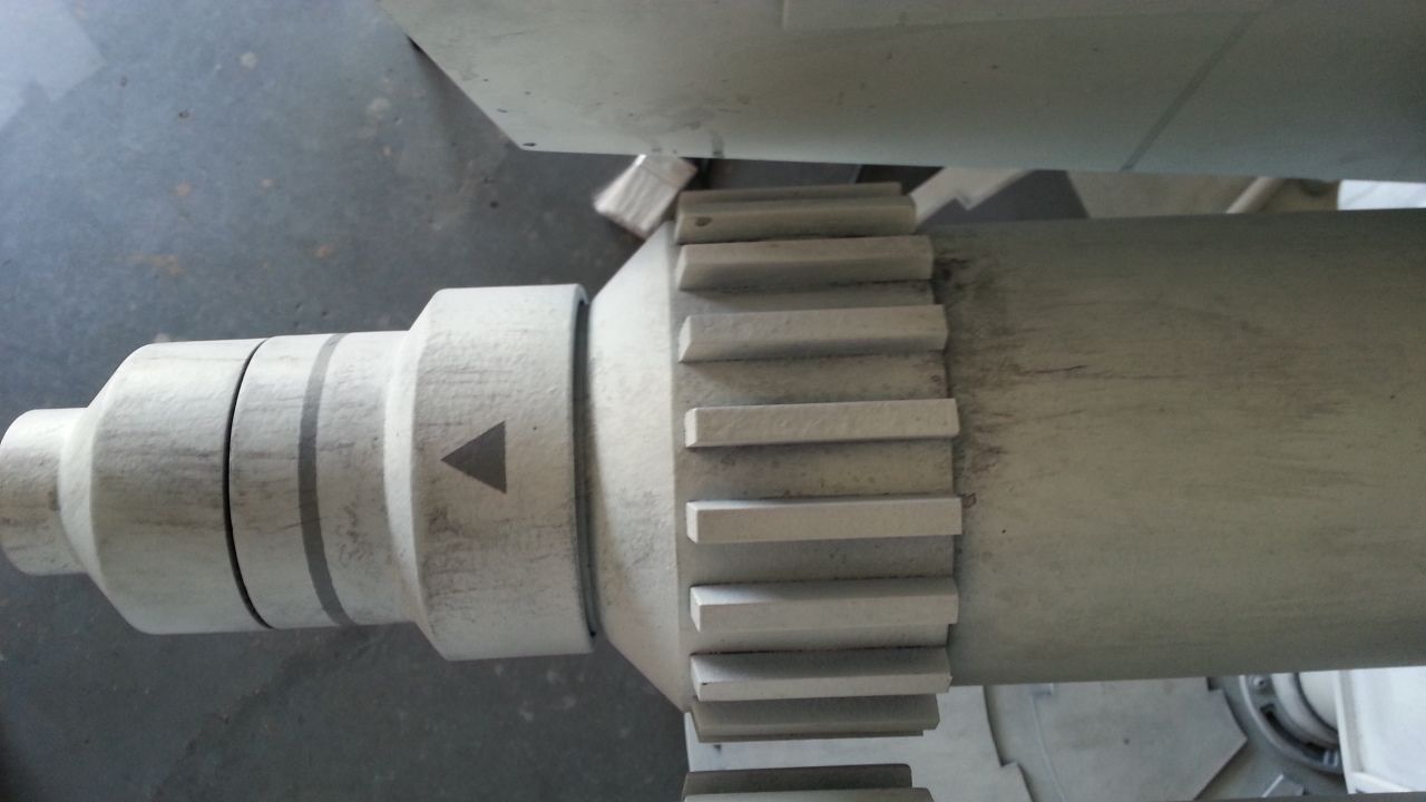

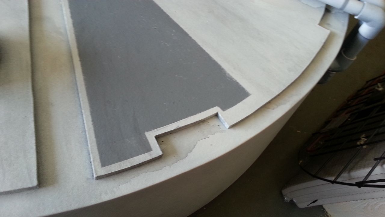

Well... I didn't get to the canopy... ugh... Deciding to paint the lightbars kept me from putting the panels back together. There's still a lot of sanding to do along with prime/paint. But, I did weather the quad and I'm closer to finishing the slider bases. :)
Lightbars getting a coat of primer
I added a little more wear to the barrels
And a few spatters

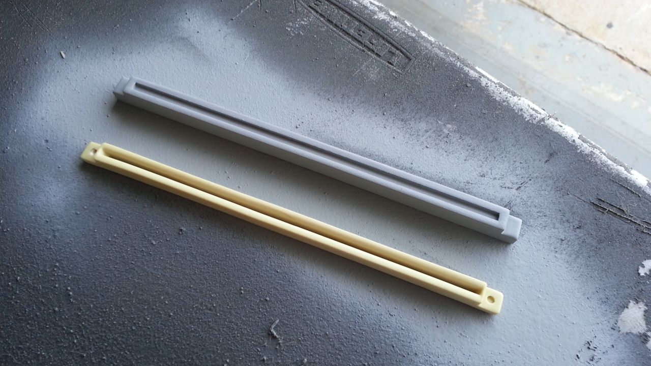

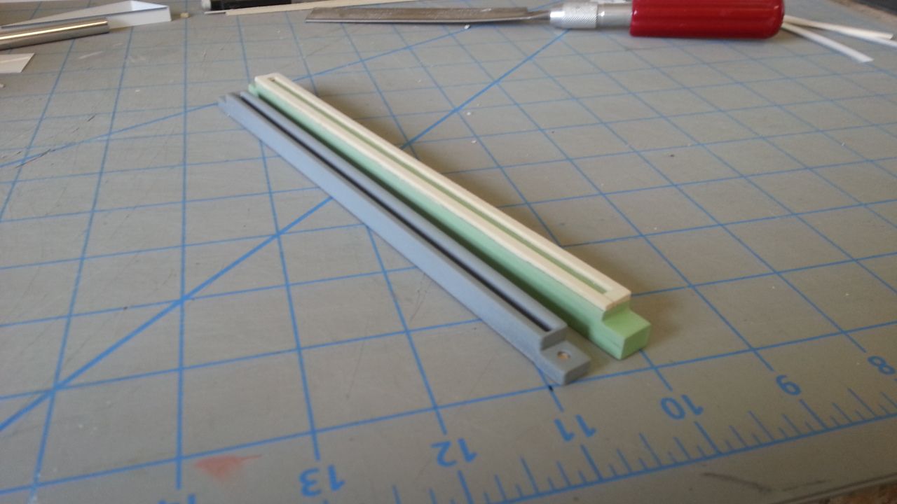

I managed to salvage the cast I made of the slider base. You can see the difference between the casting and the new slider I've created (primed)
This is where we sit...
I'm going to try to make a mold this evening of the slider base - it all depends on the primer/sanding/filling... but now... Football! :)
