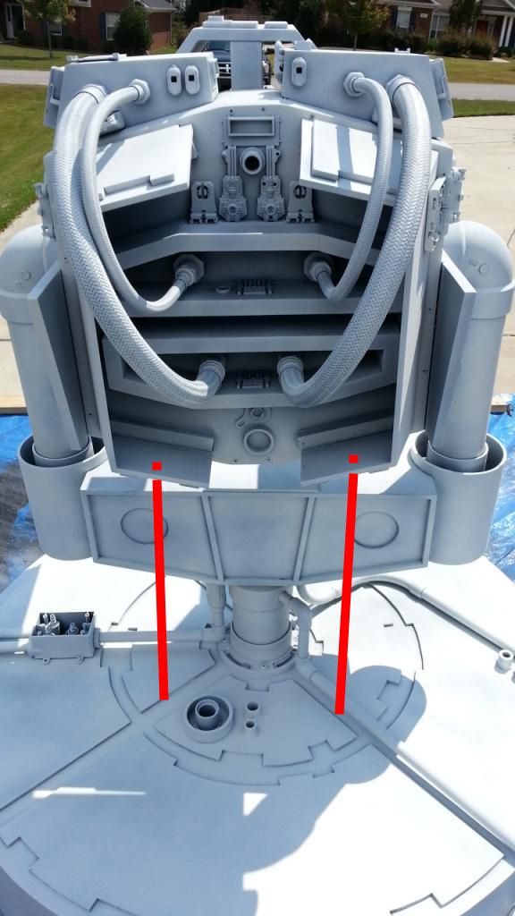

I've seen, in plenty of hardware stores, long, threaded rods. I've seen them as longs as 4', in this one place by me. What you could do, is put one rod under each barrel pair (on the backside of the cannon), and use corrugated, or braided, hose, to hide the rods - functional AND decorative.
The C.o.G. has been a bit of wonderment. How heavy is the back of the cannon, compared to the weight of the barrels, in relation to the pivot point? I suspect the back is heavier, because of all the MDF, compared to the mostly-PVC front end. And once the back end is locked in place with those threaded rods, you shouldn't have any balance issues.
But, if you do find it tipping forward, you could always make a hidden compartment in the base (it is the Millenium Falcon, afterall), where you can add weight plates, in as little as 2.5lb increments).

Re: 1:1 Millennium Falcon Console Replica
-Fred
Hi F,
I'm not quite sure I understand what you're saying - a rod under each barrel? Can you elborate?
I've been looking at pics and if I can find a "bolt / threaded rod" long enough I might be able to secure the body of the quad to the platform through the very top - inbetween the two "hose" boxes on top. But again, the rod would feed straight down.

Hi F,
I love McMaster Carr... McMaster-Carr
Just out of curiosity, is the swivel point just a male-female overlapping PVC pipe connection? If so, I would think you could quite easily drill and install clevis pins on each side. If you wanted to get fancy, scribe and drill multiple holes on the inner PVC to allow multiple position settings if the structure is strong enough.

Hi F,
Here's a rough diagram of what I was talking about. Just imagine that the red lines, are threaded rods, over which, you can run hose, to hide them.
-Fred
Hi L,
Yes, the swivel PVC connection is a simple male - female configuration. The weight of the quad body and barrels makes it difficult to swing the structure around - and it will be sitting in only one position. That same weight is causing a little concern as well... I was just looking at that exact point and thinking how I could make it a little more sturdy.
[url]http://i31.photobucket.com/albums/c362/gigatron_2000/Cannonsupport1.jpg[/URL]
[url]http://i31.photobucket.com/albums/c362/gigatron_2000/cannonsupport2.jpg[/URL]
-Fred
Hey F,
You and I are thinking almost the same thing. My idea was to go through the "main" body. The "fins" you have selected are too fragile to support the weight of the barrels and the body. If I drill the holes through the body and then connect to the platform it should be ok - I hope!
-Fred
Hey Fred,
I just had a thought... instead of a hose covering the threaded rod... I could use an old "phone cord" style cover to give the appearance of flexibility?
