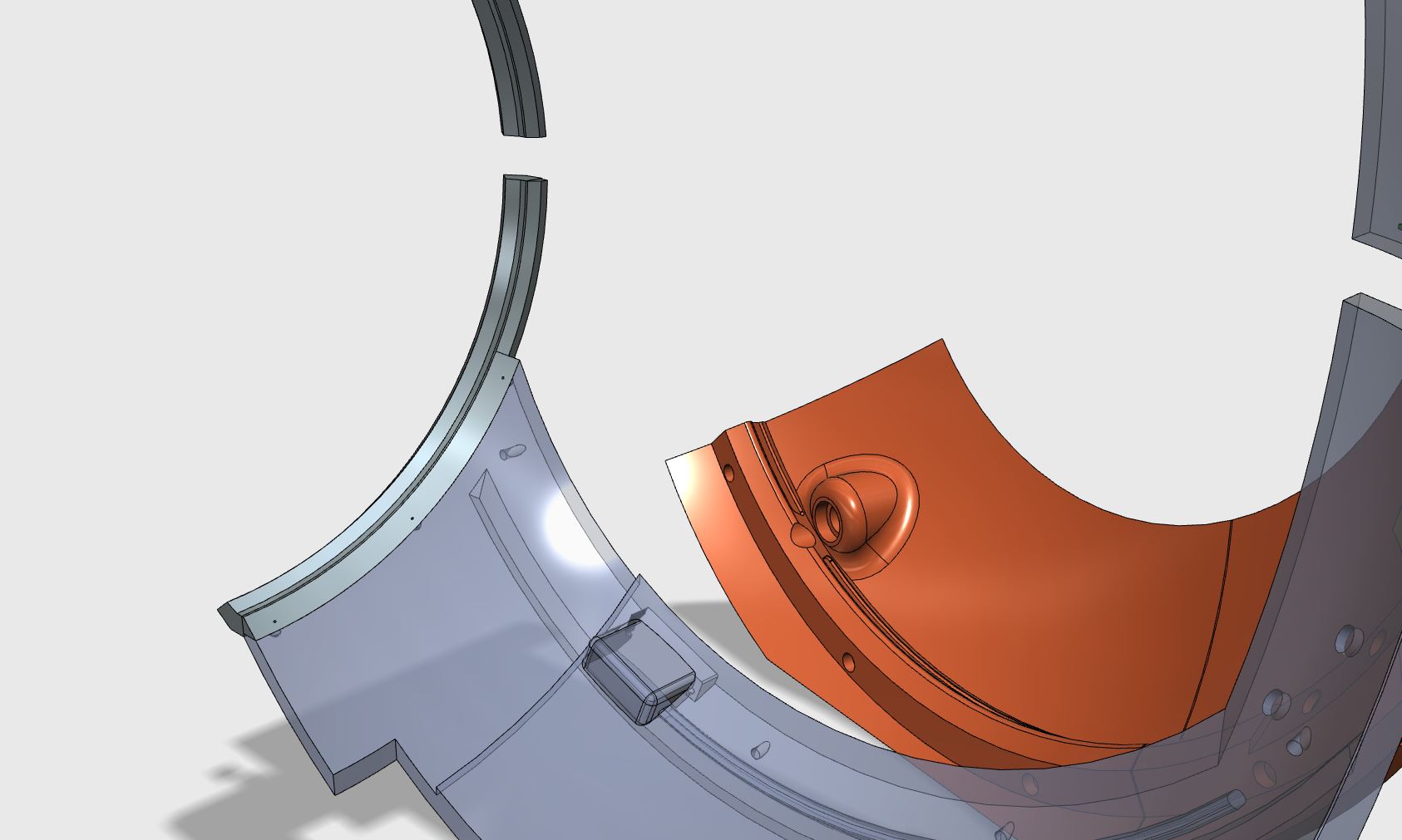

Started drawing some rough sketches on my 3D model and figured out a way to open the panels but there's where the problem occurs.
On the very left image you can hopefully see the basic hinging system on which the panels move. The yellow parts are the hinges which are directly connected to the panels.
The green thing is the servo motor which will have a little arm attached to it pushing/pulling the door. The leverage is quite small but the servo is able to move around 1kg so I should be fine.
On the image in the middle you can see the hole in the orange panel which holds the bearing for the front arm.
You also can see the mounting seat for the servo in the transparent-purple part which I was going to use to tilt the front arms but is now void as the panel opens and closes and the connection between the servo and the arm would need to be variable.
I was thinking about using a fishing line and put the servo somewhere else but I'm really stuck with that now.
I know it's kinda hard to explain and I will try to get a more detailed explanation on today's evening but maybe some of you have an idea which might help me continue with this task.
The image in the right basically shows you how it would look if opened :)
