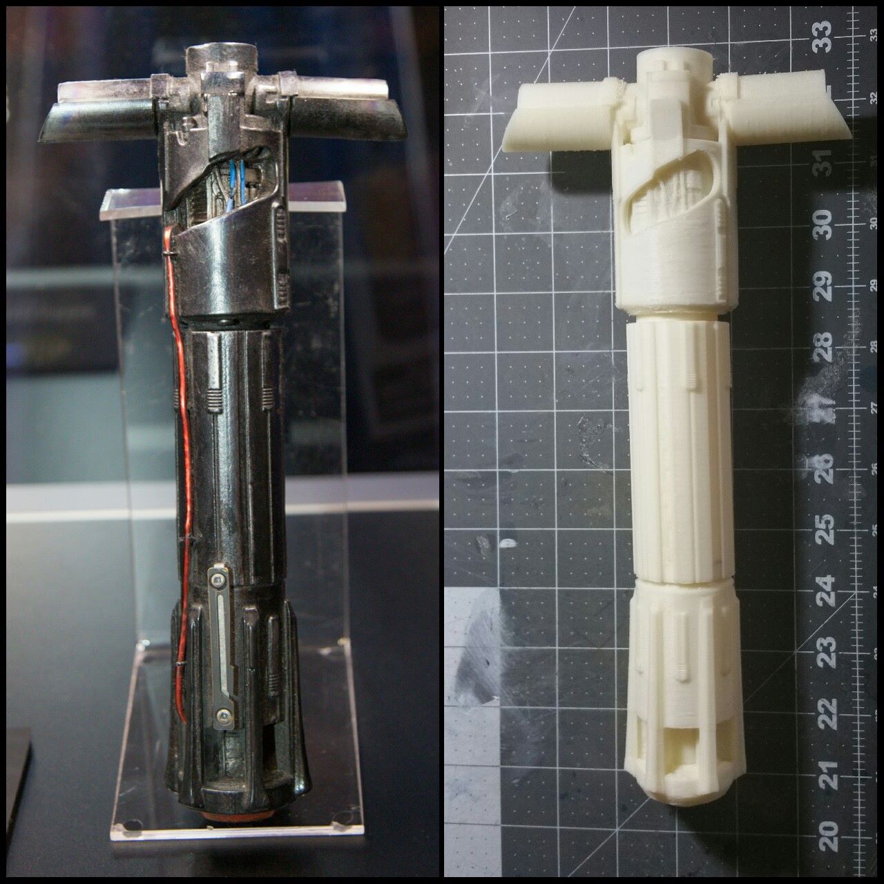

Saber came out too damn big. Take 2 is on the print bed now...
Beautiful job!.. To me your height seems correct. The width seems ever so slightly too wide... The top portion of the saber where the exposed wiring is seems slightly short... Here's a pic for you, I know the photos are not exactly 1 for 1, but it can help in the refinement.... Still, a super good looking saber build so far!

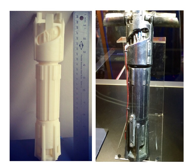

Definitely agree. Here is how it came out... a hair over 12" and around 1.75" in diameter. That is what it took to get an internal diameter of 1.25" and still maintain a durable wall thickness. Since these will be resin and we want them to be able to hold up to light-dueling or performances, structural integrity is a big deal to us. Ultimately, it was easy to tell it was too large (at least for normal-sized hands, Adam Driver is a lanky 6'3" so perhaps in his hands it looks more proportionate.
Sooo... yeah, lol. Maybe the height is fairly close, but the width definitely is off. We are going to try again with it at a "strict" 1.5" diameter, which unfortunately will decrease the internal diameter down to slightly over 1", making electronics still possible... but a tight fit. We're not particularly happy about this, but it is what it is. :(

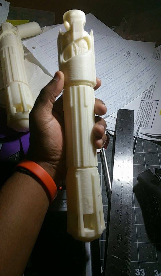

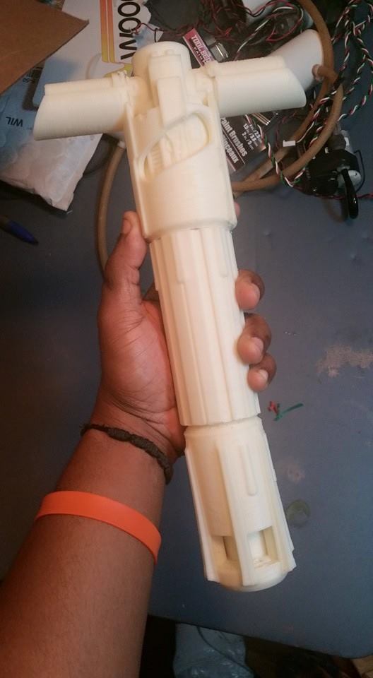

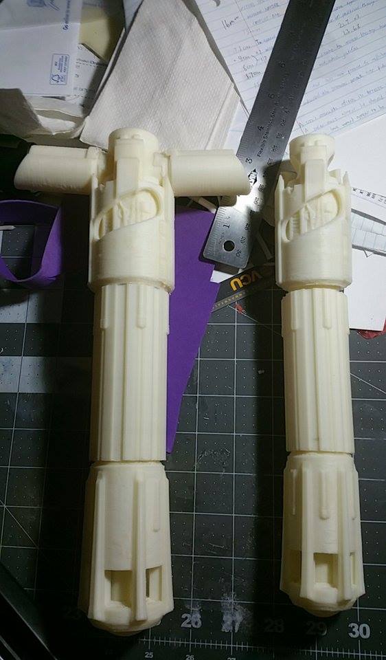

Got a much better sized saber printed out. I am very happy with the diameter (1.5"). Internal diameter is now a hair over 1" and it accepts 1" main blade and .75" side blades. Overall length is 11.5", which isn't nearly as long as it seems and makes it much more comfortable to wield two-handed if desired. It may still look a bit thick but it is the same width as the actual Graflex sabers and very comfy to hold. Here are some pics, including one with it beside it's Big Brother we printed yesterday:

I think the side emitters are just a tad too short, so I'm going to try reprinting them just a bit longer. I also think the bottom end should flare out a little more so I'm going to try reprinting that section a few mm's larger. Hopefully these are the last adjustments necessary and then I can move on to clean-up and post-processing.
