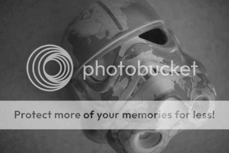

how'd you do the teeth mate? shaped putty?
I ended up chopping mine out so any pointers will be appreciated!
used the milliput to fill in the areas id sawn out (seen in previous photo post), with a bit extra so i could sand it down to shape, did the top lip of the frown one day and sanded it perfect, then yest did the same to the bottom lip, the teeth had to be hand shaped with a file and sandpaper individually and glued them in place. id made them a few days ago.
lots of work but i couldn't figure out any other way of doing it cleanly, spent the last 3 days doing that darn frown.

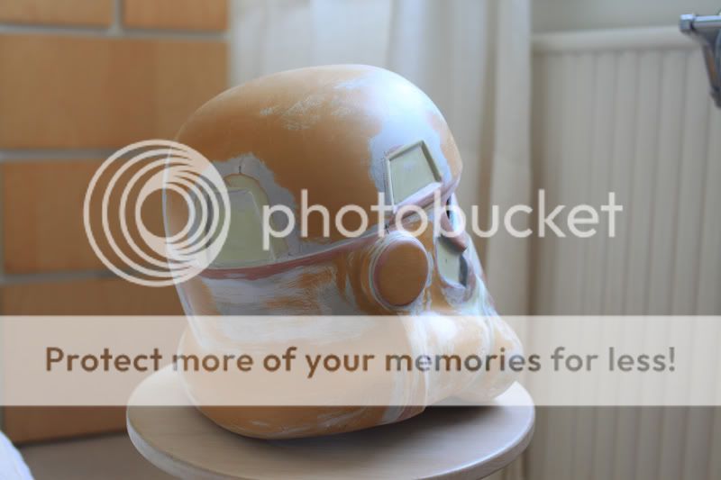

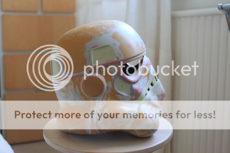

over the past few days i got the indents in place, like the frown i had many attempts at these and many failures, think they have turned out alright now, still need some sanding and filling but on the right track.

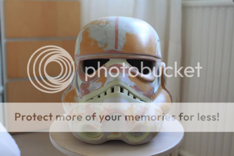

i'm re-priming 2mro to unify it again, just filled in the back of the frown vent and doing the eyes 2night, another good "scrubber" session 2mro morning and prime at tea time.
i'd say its still covered in deep scratches and chips so i imagine it will be at least a week before its mold worthy

i planned to do a 1 piece "rebound 25" silicone mould with a 2 piece "plasti paste" jacket, i'm not 100% sure if the silicone will stretch enough to pull the bucket out the mould at the opening, i've looked into it yet thats way in the future.
best to get the master as perfect as can be and il deal with the next step later.
... but yeah il be interested to see and learn the process too! :lol
without underestimating the skill and art from of mould making il say... its not rocket science so it cant be that hard (famous last words)
even if i fail at the mould stage i believe in my life moto... "you have to be wrong before you can be right." its all learning/experience and thats a good thing.
