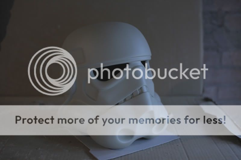

freshly primed and wet sanded, still a fair number of imperfections to fill and smooth out. comments welcome.

always nice to see an update, one (more) quick question, what is wet sanding... and how you going to do the eye lenses out of curiosity?
good luck, not that you seem to really need any considering the quality of your build.

wet sanding is a process of very lightly sanding a coating of paint to make it very smooth and blemish free, i guess its almost like polishing/wearing the paint coating.
for wet sanding you need "wet and dry sandpaper" its a very smooth fine grit paper and is usually black in colour, i used 1000 grit wet and dry sandpaper.
i squeezed a wet sponge over the stormtrooper lid and also dipped the sandpaper in the water, then you just sand as normal.

i plan on filling in the eyes over the next few days, the eye holes are a good way of holding it.

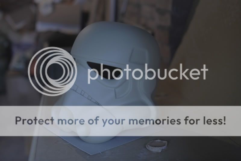

just a quick update on my build.
now sanded and primed, wet sanding and any clean up tomorrow.
still have a few issues that are annoying me but apart from those i think its coming along.

just wet sanded it down again, feeling super sleek! (the lid, not me!) i X marked the spots that need attention, think there are around 80 :eek:(
just added some spot filler and left it out to dry, hopefully il give it another little sand 2night and upload some new photos.
you might have to wait a while before you see any paint on it rosskow, next up will be moulding and casting.
i estimate 2-3 weeks before i see my first cast.
