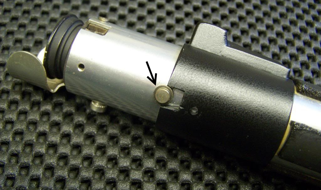

so tonight i organized my new workbench and dug out all my yoda saber stuff I've been hiding. now with the clean cap I'm ready to start moving forward. my praco doesn't have the brass slide rivet on it.
attachment.php
Andy had a extra bosley so i grabbed one from him and it has the brass slide rivet but its on the opposite side of the flash compared to this picture above. (which came out to 1.325") so i was going to transfer the slide rivet form the bolsey to the praco. but now i have begun to worry... i measured the distance of the rivet hole to the top of the bolsey flash after i removed it. BUT i now have some butterflies... is the praco the same measurement from the top? if i drill too high i will have a ugly hole drilled into the praco..
does anyone know the exact measurement of the rivet above? from the top of the flash tube to the rivet (not the top of the wheel)
i also came on here looking for measurements of grip locations and stuff but i can't seem to find them anymore? i know i had saved it on my old PC but that thing is destroyed now:(
any advice for finding the location of where to put the brass slide rivet?
http://www.therpf.com/attachment.php?attachmentid=285780&d=1392314290&thumb=1

When I created my Yoda saber based on my Bosley flash I left the brass rivet on the "incorrect side". This will cause my saber to be mirrored from the real Praco version. I didn't mind this much for my build, as muggles won't know any better...

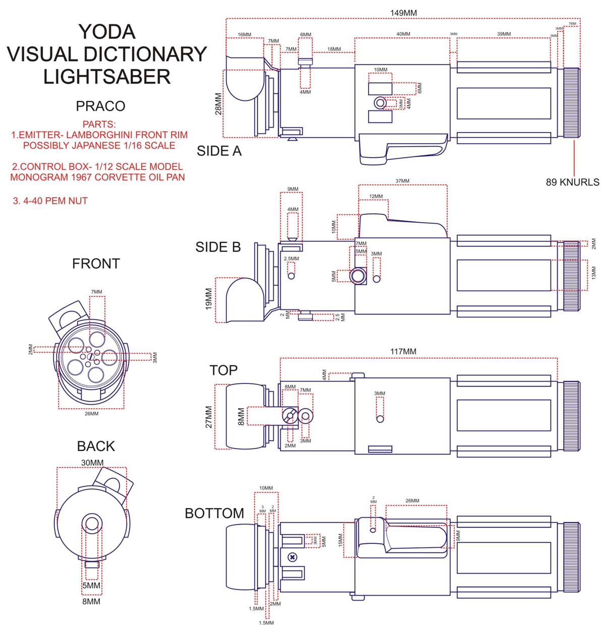

When it came to assembling components and adding the grips, I referenced this below blueprint from the VD as well as pictures of original Praco version people have posted here. Between the two sources I came up with my own representation.
this is exactly what I was talking about!! thank you very much!
I think with all these measurements I can find the right spot to drill now, thank you!!
You're welcome. I don't always trust dimensions on prints like that though. I think Sym-Cha once said it best: "Go with what feels right".

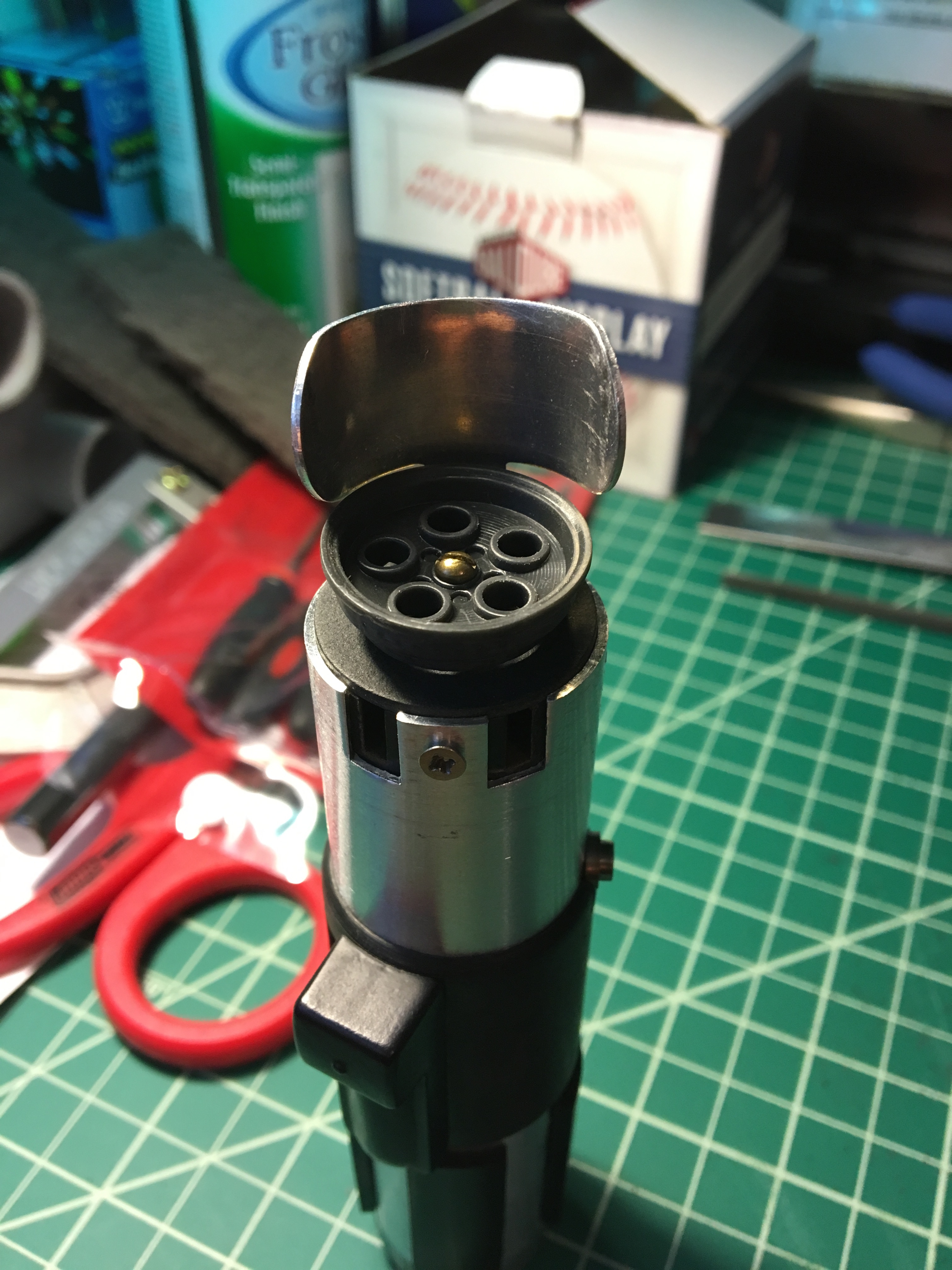

Good news everyone! What do we think of this first attempt? I need to increase the height of the lowest cylinder on the bottom. But besides that, I think it's pretty close.
1. I did not include the valve stem from original. (too small to print correctly, plus this can help identify my version)
2. I designed this version with the hole already there for mounting the emitter. No need to drill thru the complicated hub round on original.
3. Already colored black, just need to slightly clean and spray another layer of black of your choice.
4. I do not have the correct mounting screw right now so it's being barely held by the original Bosley.
Thanks guys. I'm pretty impressed by the quality of this high-definition acrylate. The print lines are very crisp and clean. Looks damn good the way it came, and after a thin layer of paint I'm thinking it will look even better. Overall I think this first attempt turned out pretty great. I will be fine-tuning some areas soon and then I will have an updated one made. If everything turns out good, I'll order a small batch of these to sell here for everyone.

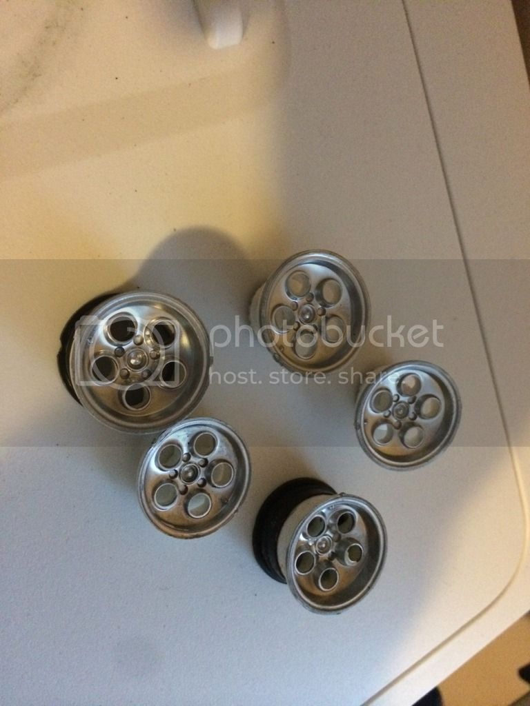

So the original wheel does have the valve stem? I just ordered a model off the Bay for under $30, but the wheels were chromed and the stem kinda threw me a bit. The model number looked correct so here is hoping. Now I need to get ahold of sjanish for the oilpan and maybe grips. Any car parts store would/should have the carb jet right? Dunno what I'll do about the nut yet
Well, my model came in! The only problem is that it was mostly assembled so now I need something to dissolve model glue. The odd part was is that the correct shorter wheels were in the rear with the larger tires and the taller wheels in the front. Another thing I noticed was the spare has a slightly smaller diameter than the correct wheel.
Also, I've only got Bolsey's for this which doesn't bother me at all but I did notice a difference in the top discs.
This one only has one slot for the shroud:
This one has two slots:

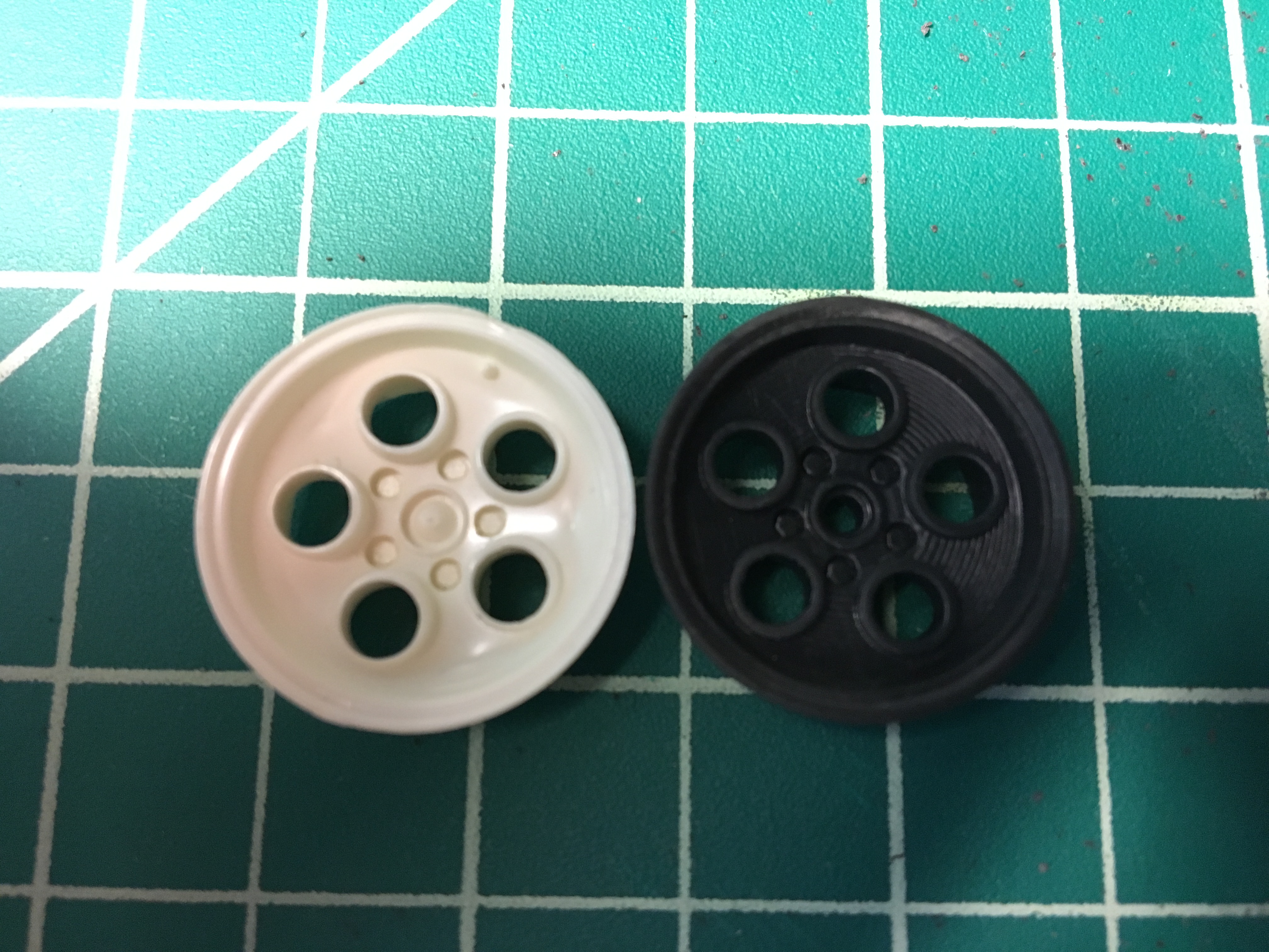

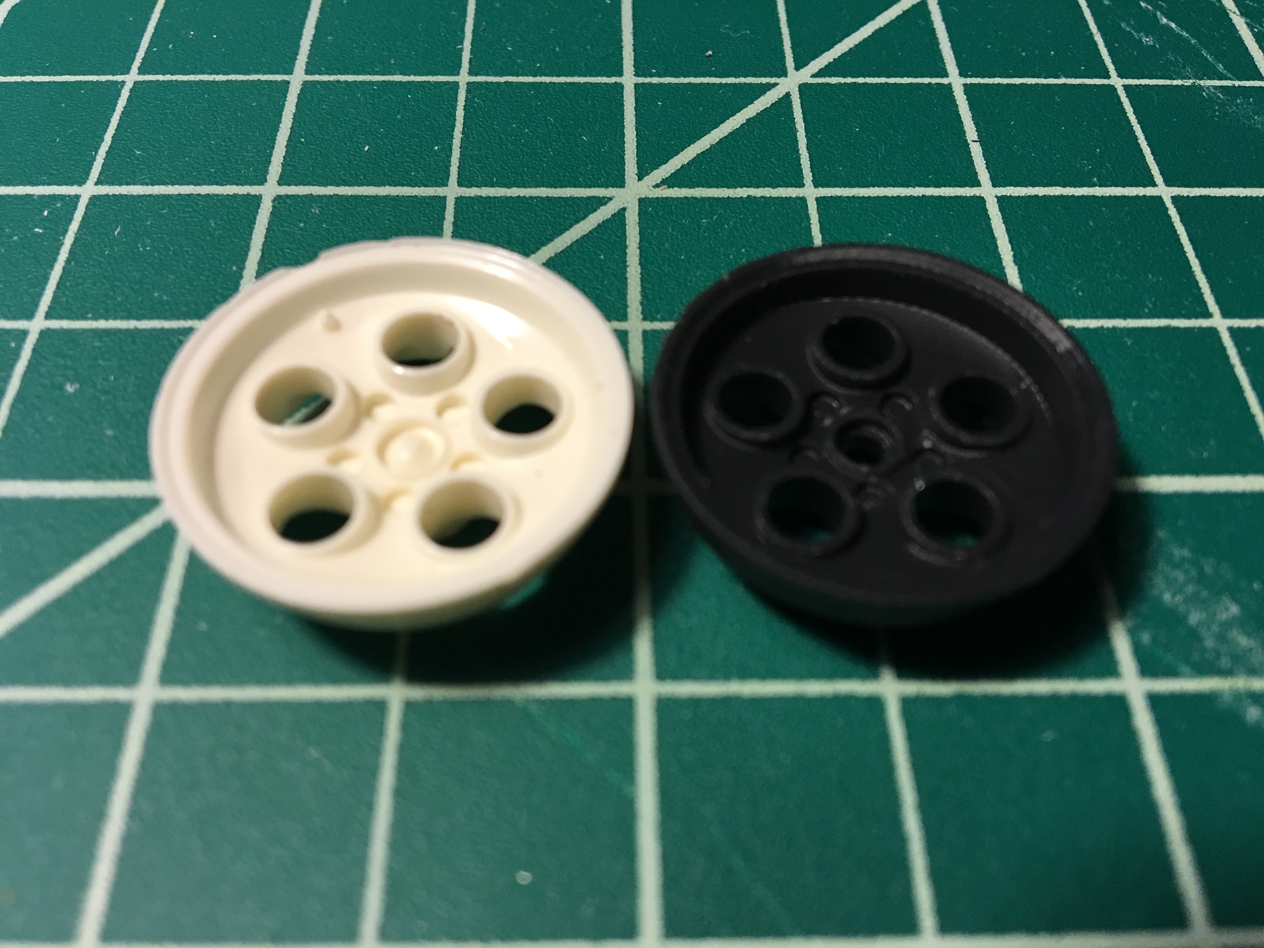

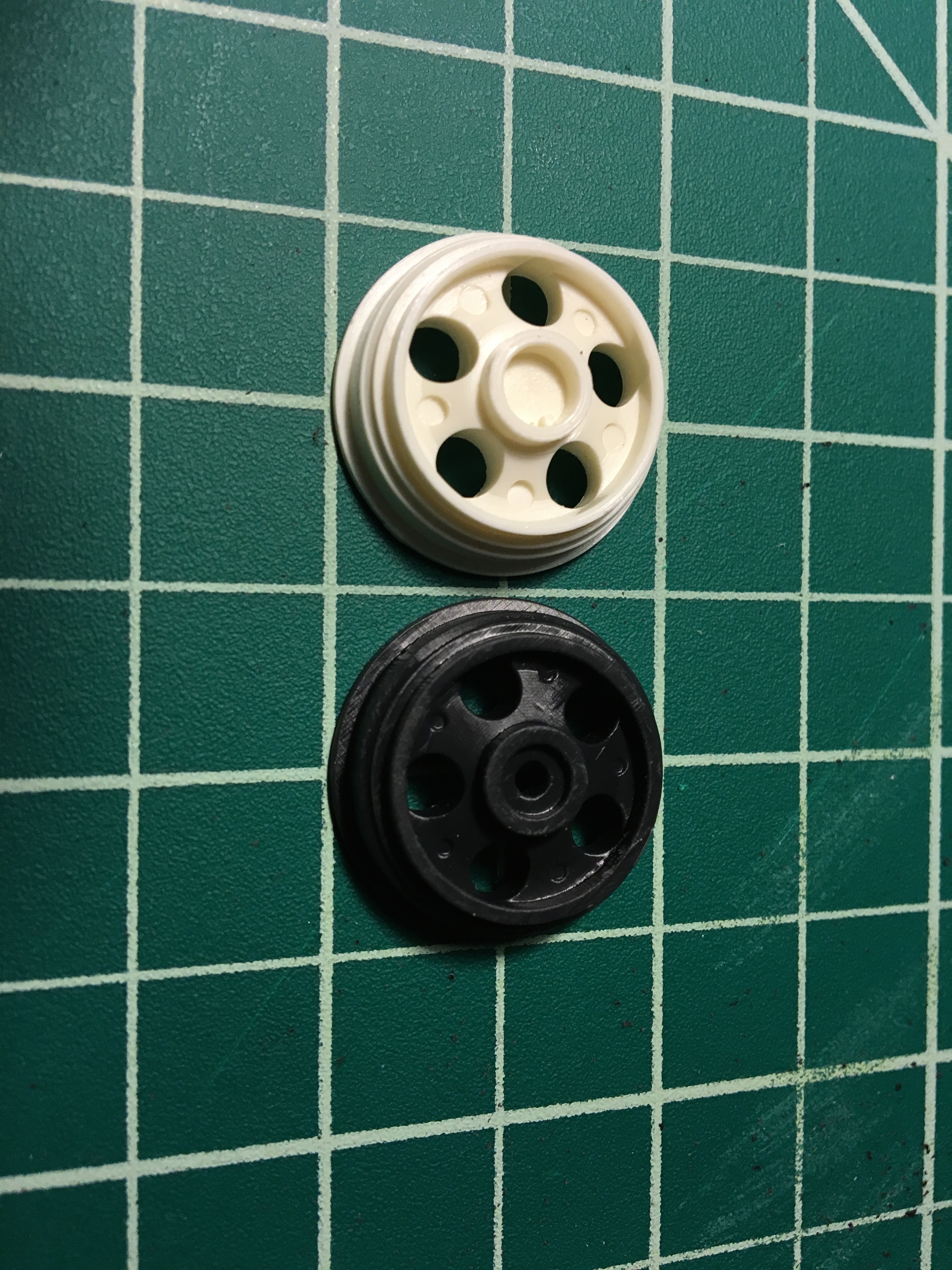

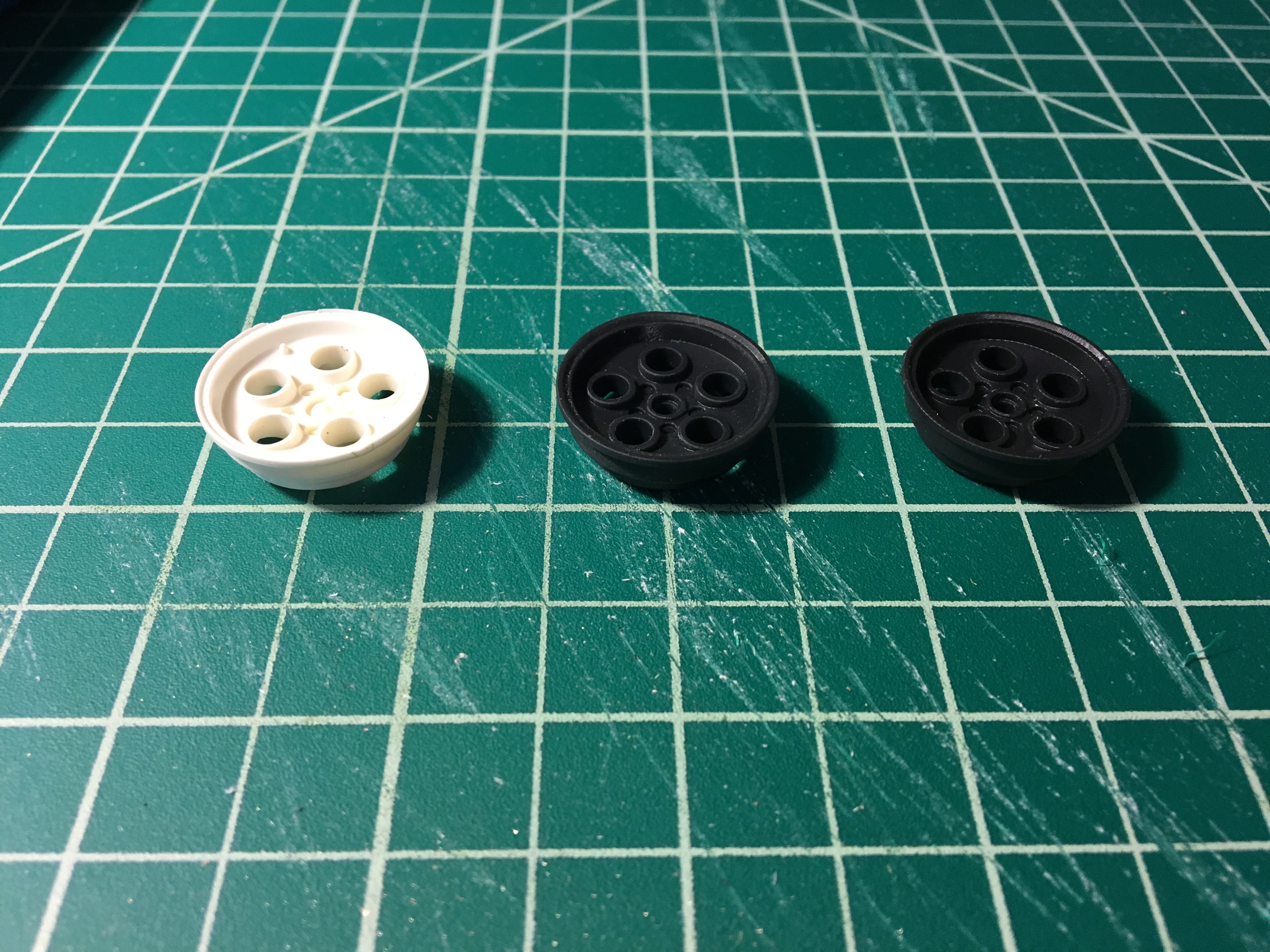

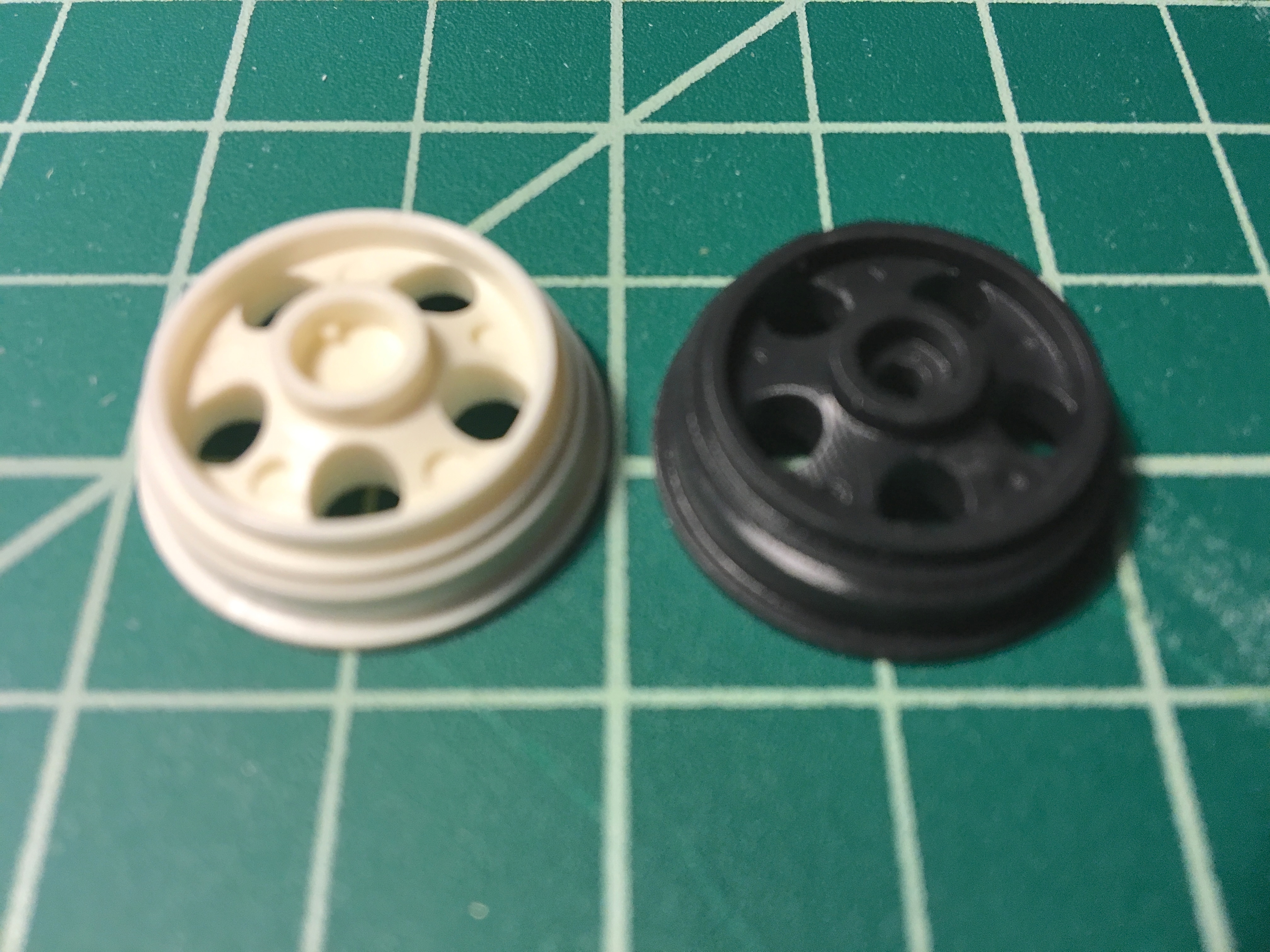

Here are some pics of the actual wheel, the first proto, and the second proto.
What's everyone's thoughts? I think I have a couple minor changes to do still, but I feel it's pretty close. Note some wall thicknesses like the bottom nub are thicker than the actual wheel because the thickness is too small to print properly, even using high definition. One of my updates will be to try to make that bottom nub have a thinner wall, closer to the real one.
After I get a final prototype back that I am happy with I plan on ordering a small batch. Afterwards I'll have to setup my Premium Membership in order to create a Selling Thread.
