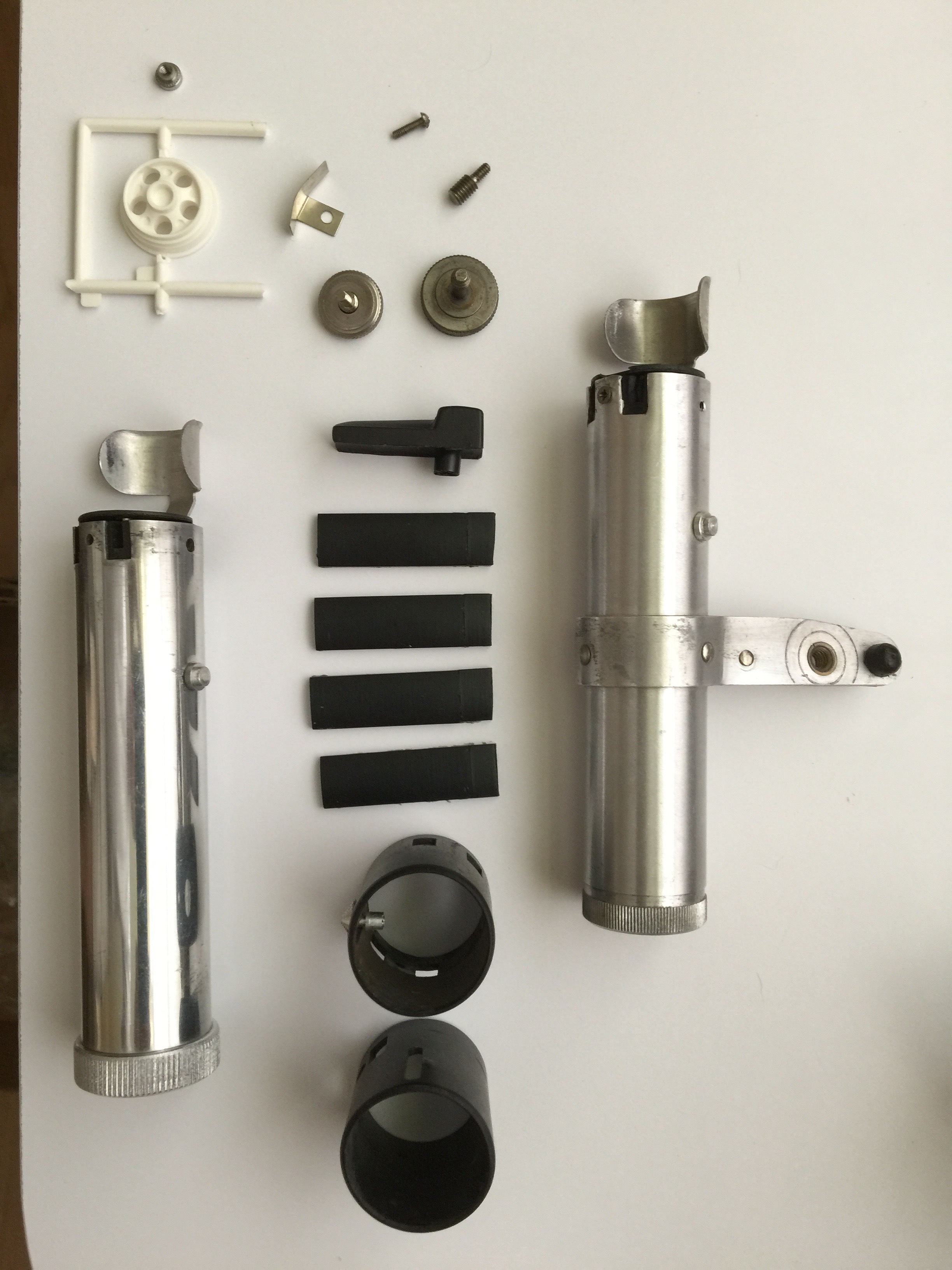

Here's a pic of parts with correct version. Still trying to find the time to build my Bolsey up as I dont have a Praco...

The left is my Bolsey yoda with scratch built control box and grips...
The two other flash's are both praco - one with a black end cap. I'm only going to work with the clean end version (with the reflector) but am keeping the other praco until I know I have all the correct parts in the clean end one (like the brass screw). Didn't want to sell the extra and find out I'm missing pieces.
The grips and oil pan are from the recent run...
And of course that wheel... which I THINK is the right one. If it's not, I've never had a correct one... and all three I've had are wrong.
But I'm pretty positive it's correct.
And then the cases... which I believe are the same one's as ED209's display of the original.

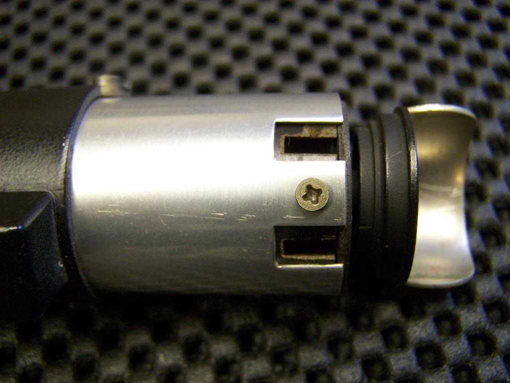

Checked the technical datas on some sides manufacturing/selling 4-40 Pem nuts, the drawing is the standadized size in mm. Btw. anyone here has a idea where to find the PEM nuts in small quantities, prefered here in Germany?
Additional it would be great if someone with a real Praco and a caliper could help with the dimensions of the drilled brass bolt that´s holding the clamp. :)

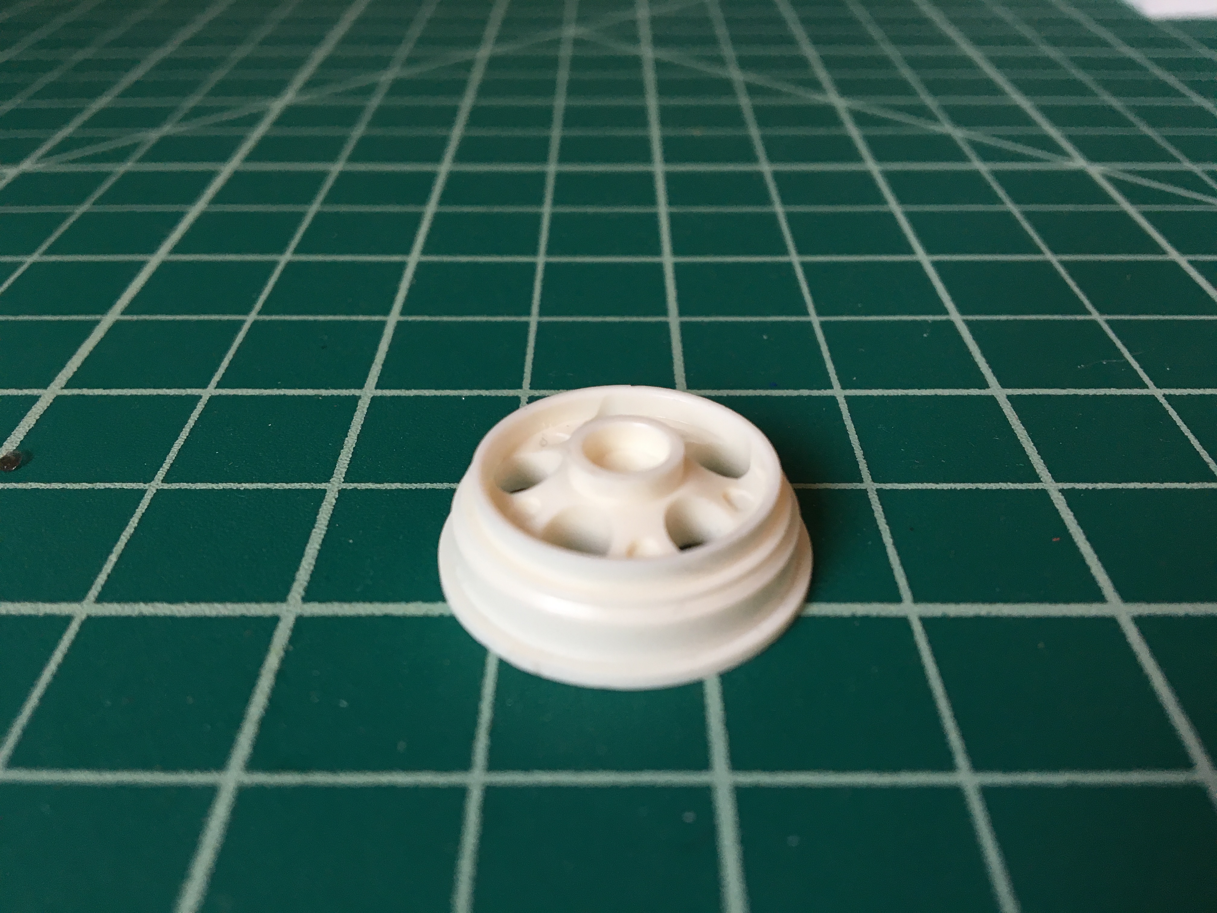

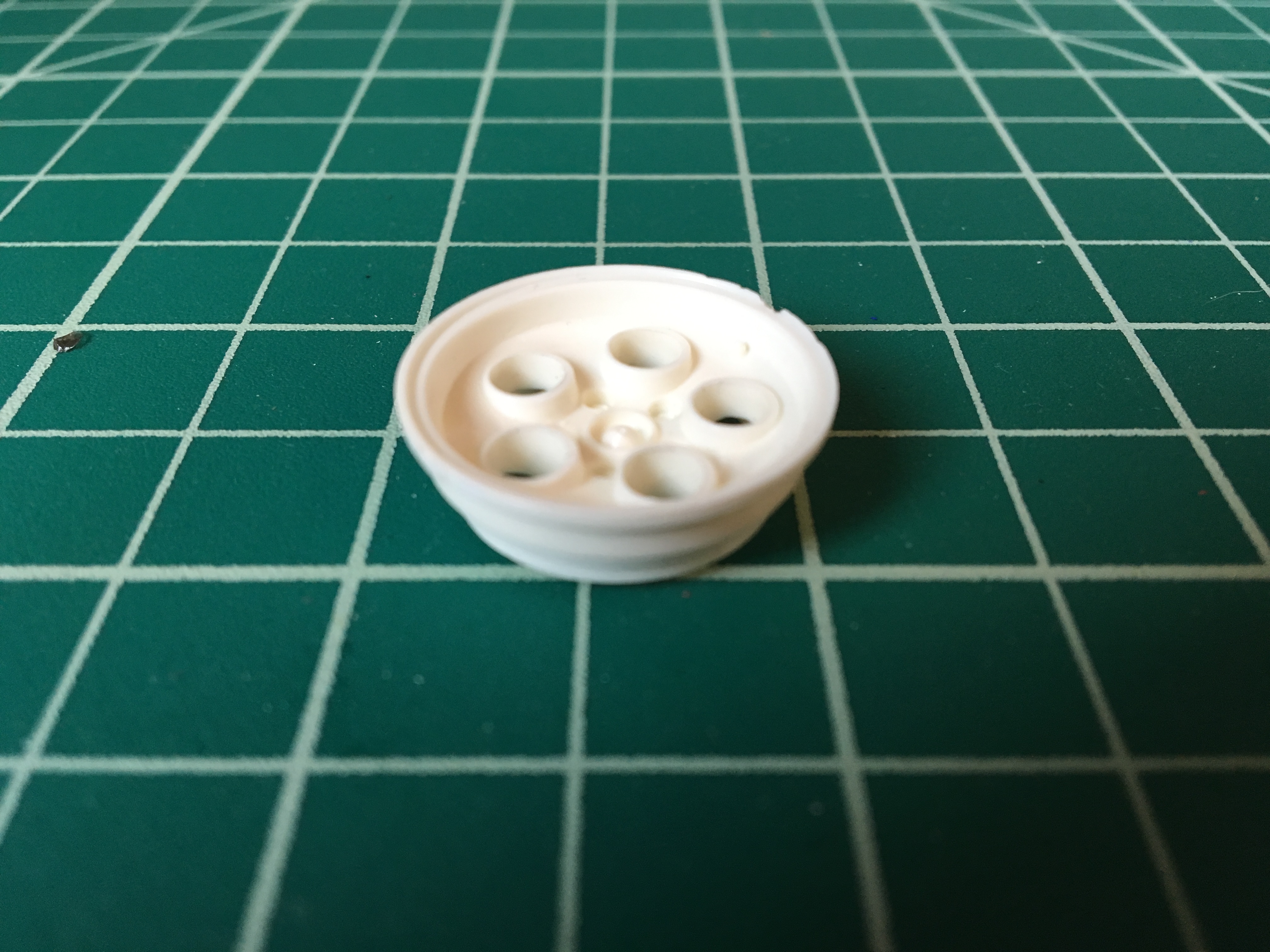

Here are a few shots of the kit wheels (click to enlarge):
The kit has 3 sizes of wheels - 2 Front, 2 Rear, and 1 Spare (labeled F, R, S in the image). The spare is very similar to the front wheel, and has nearly identical thickness, but it's about 1 mm smaller in diameter, with a sharper/narrower outer rim. Without seeing a spare and front wheel side by side you would be hard-pressed to tell the difference :)
