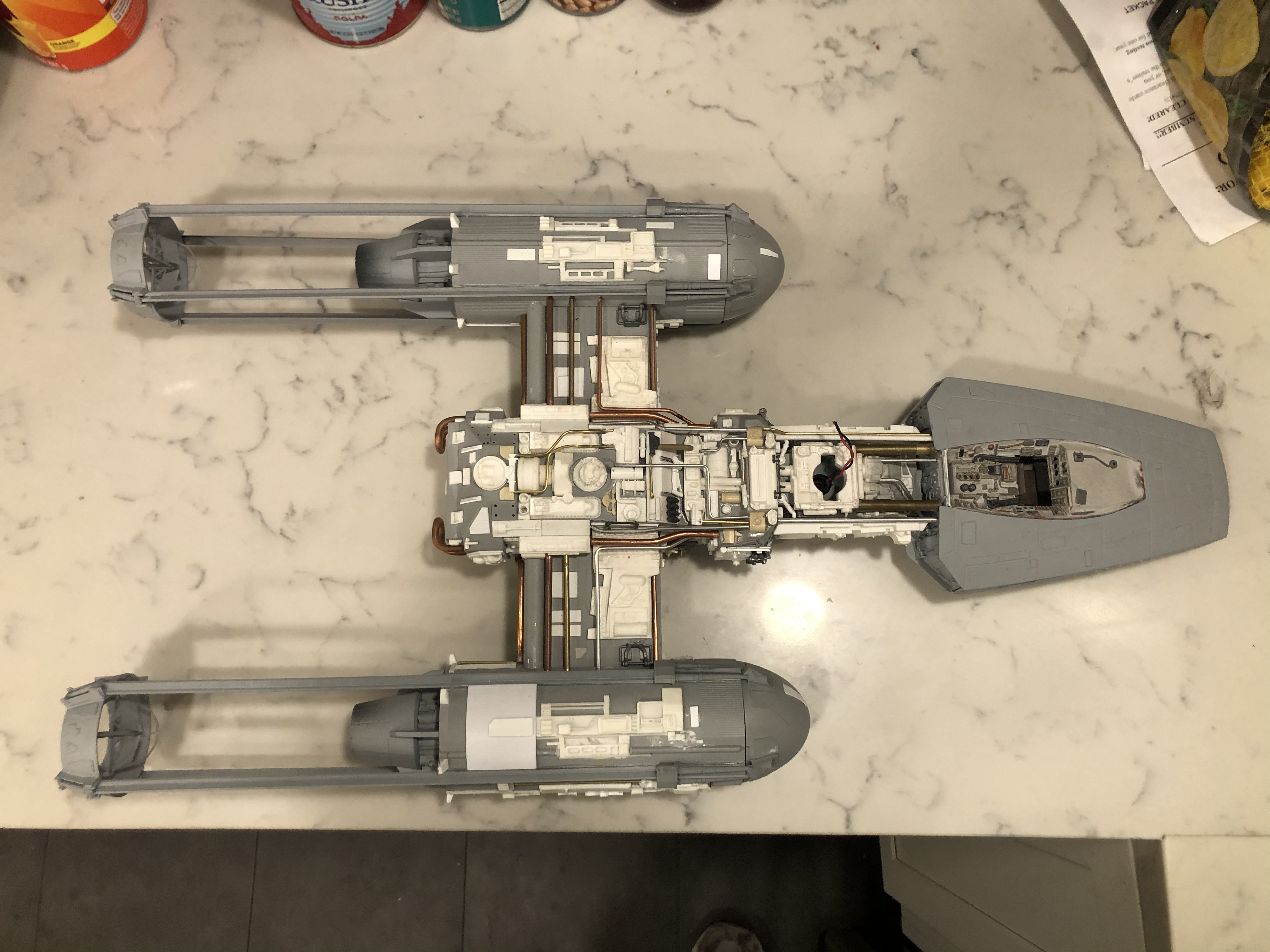

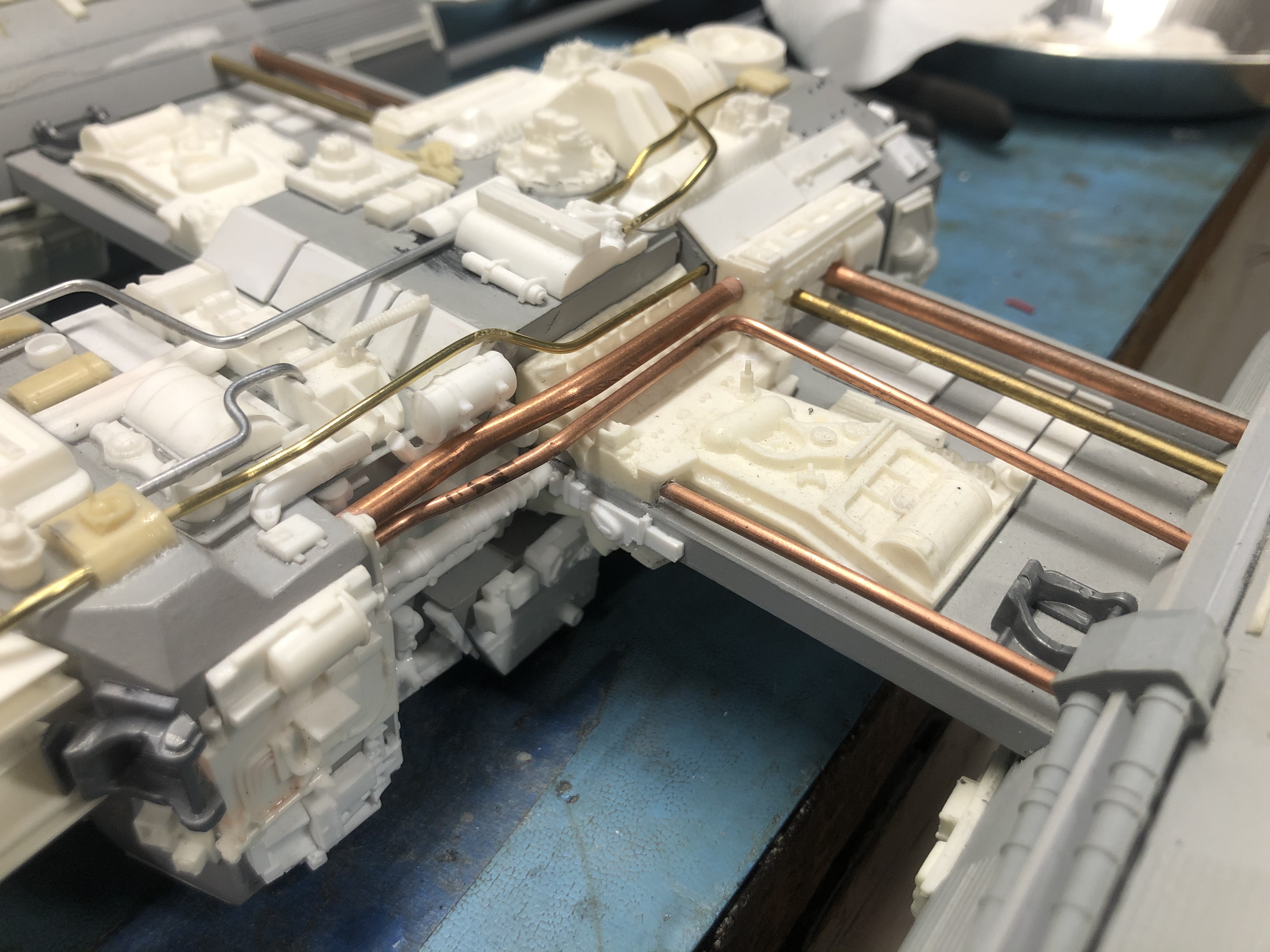

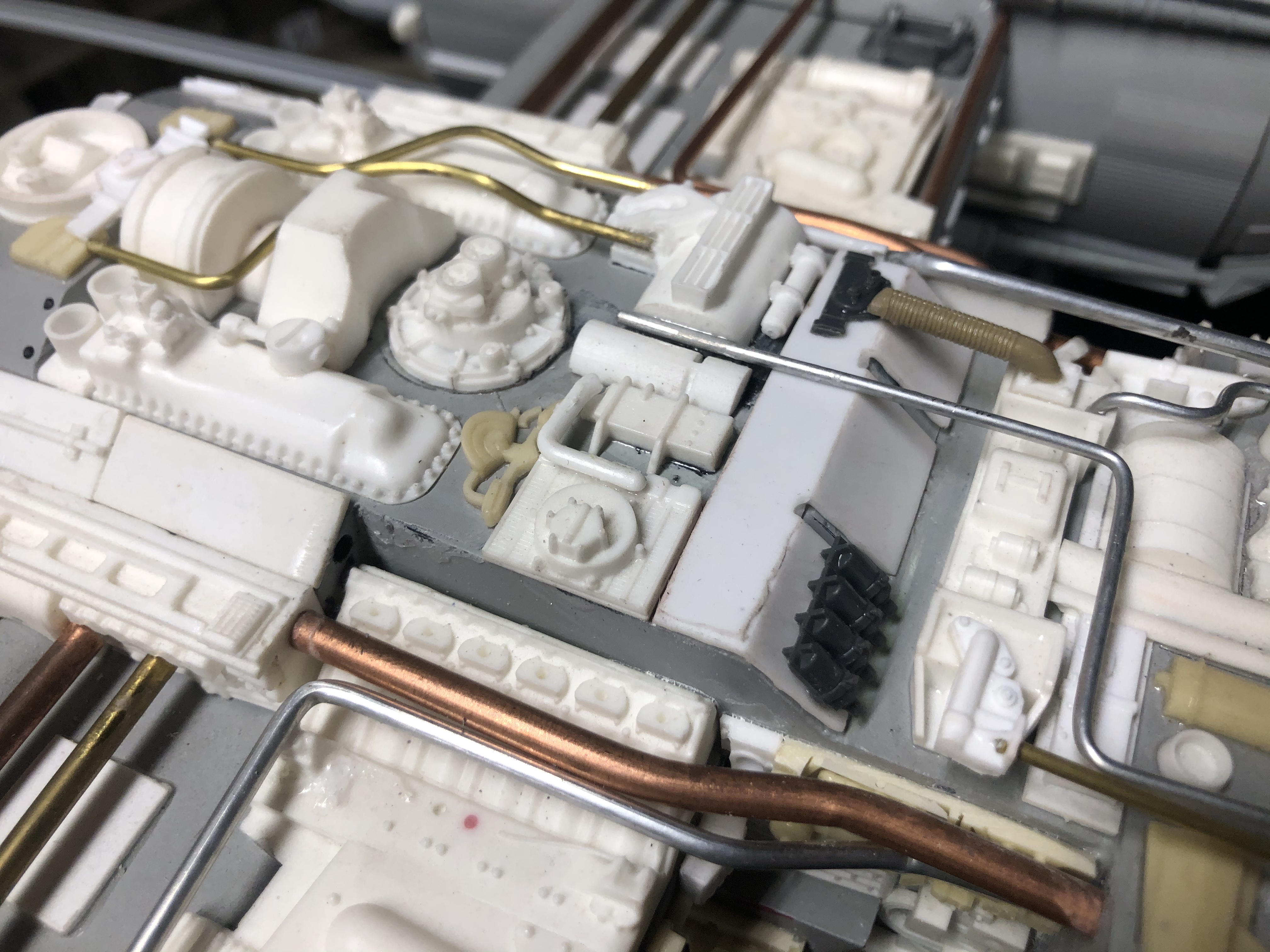

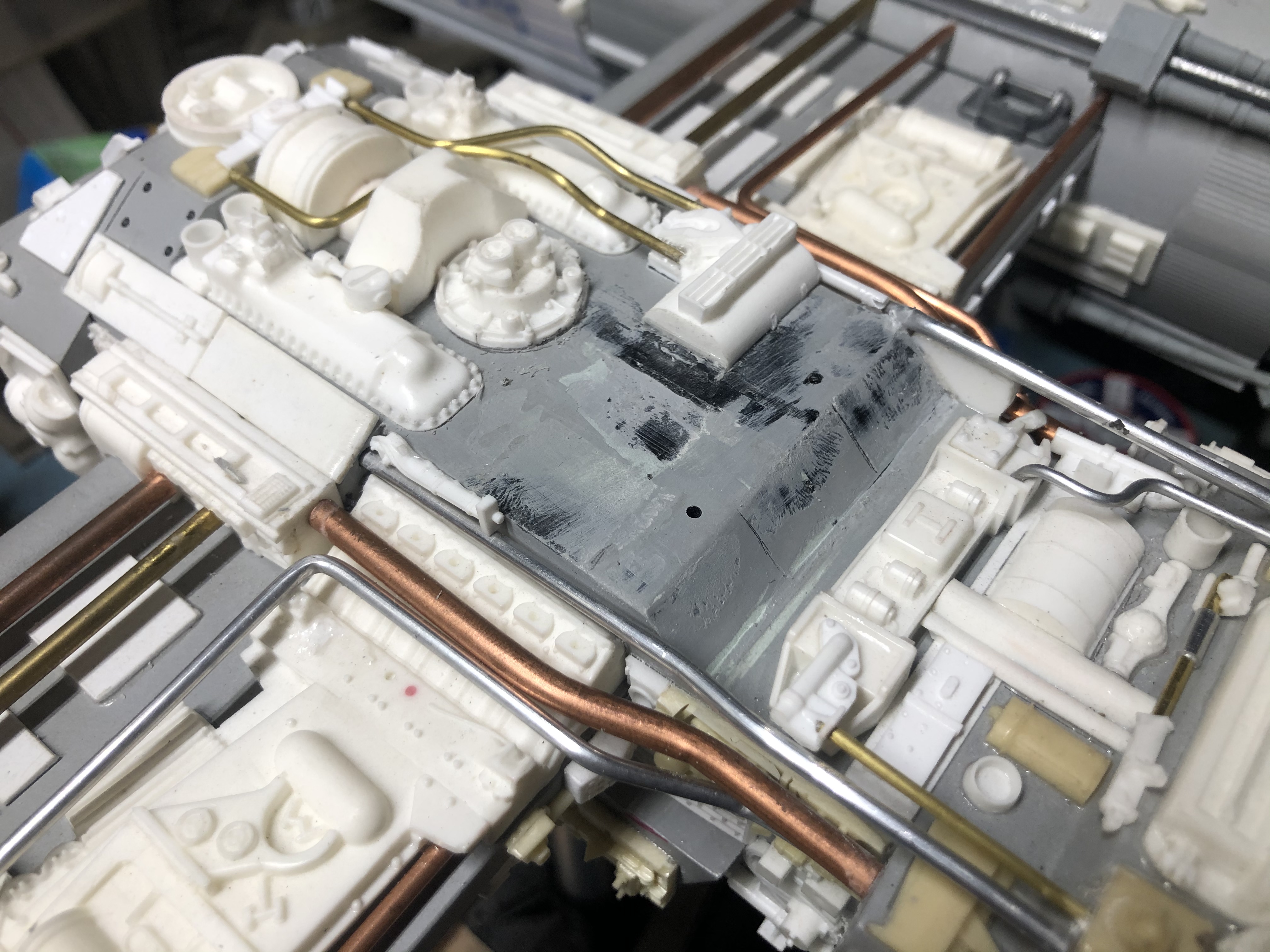

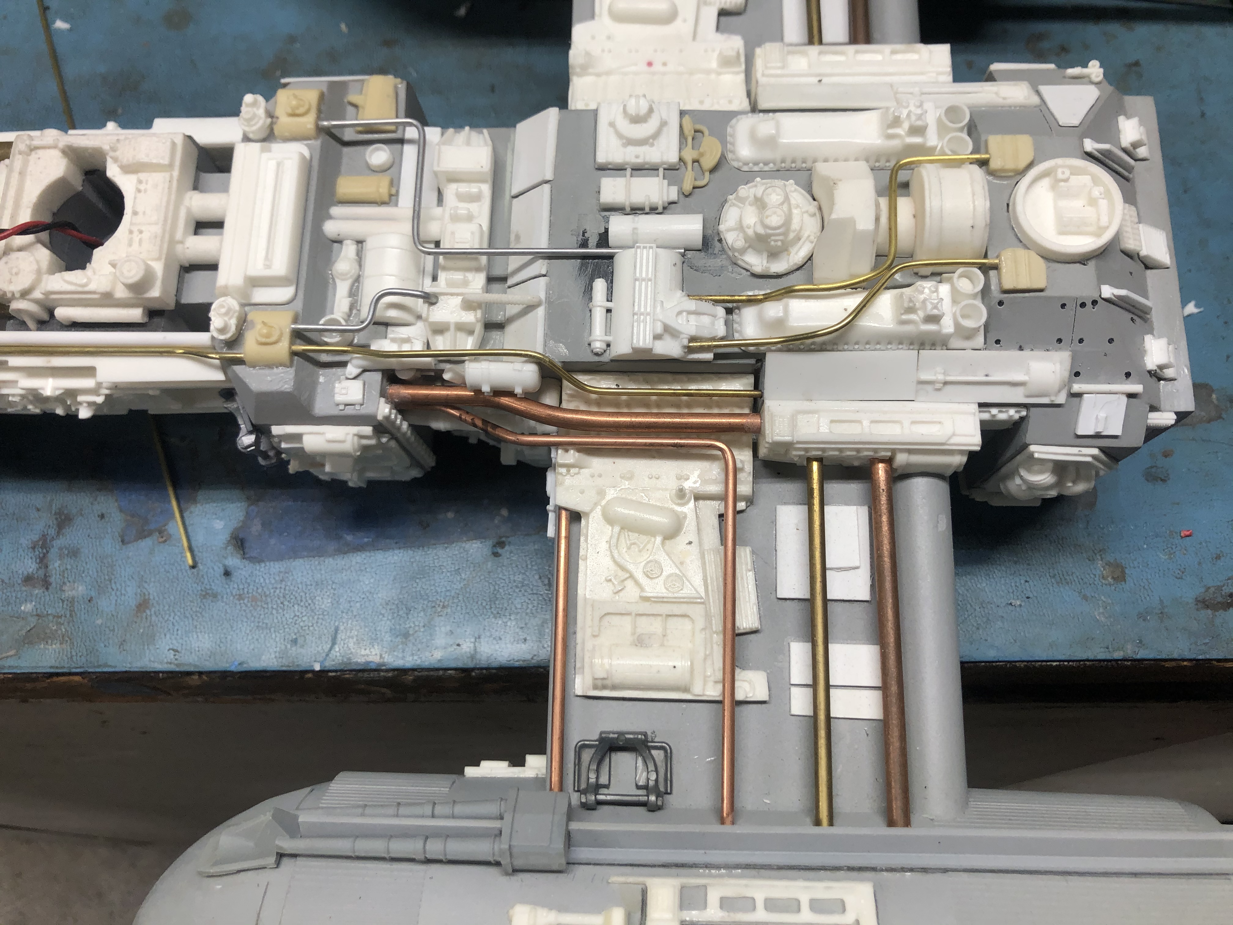

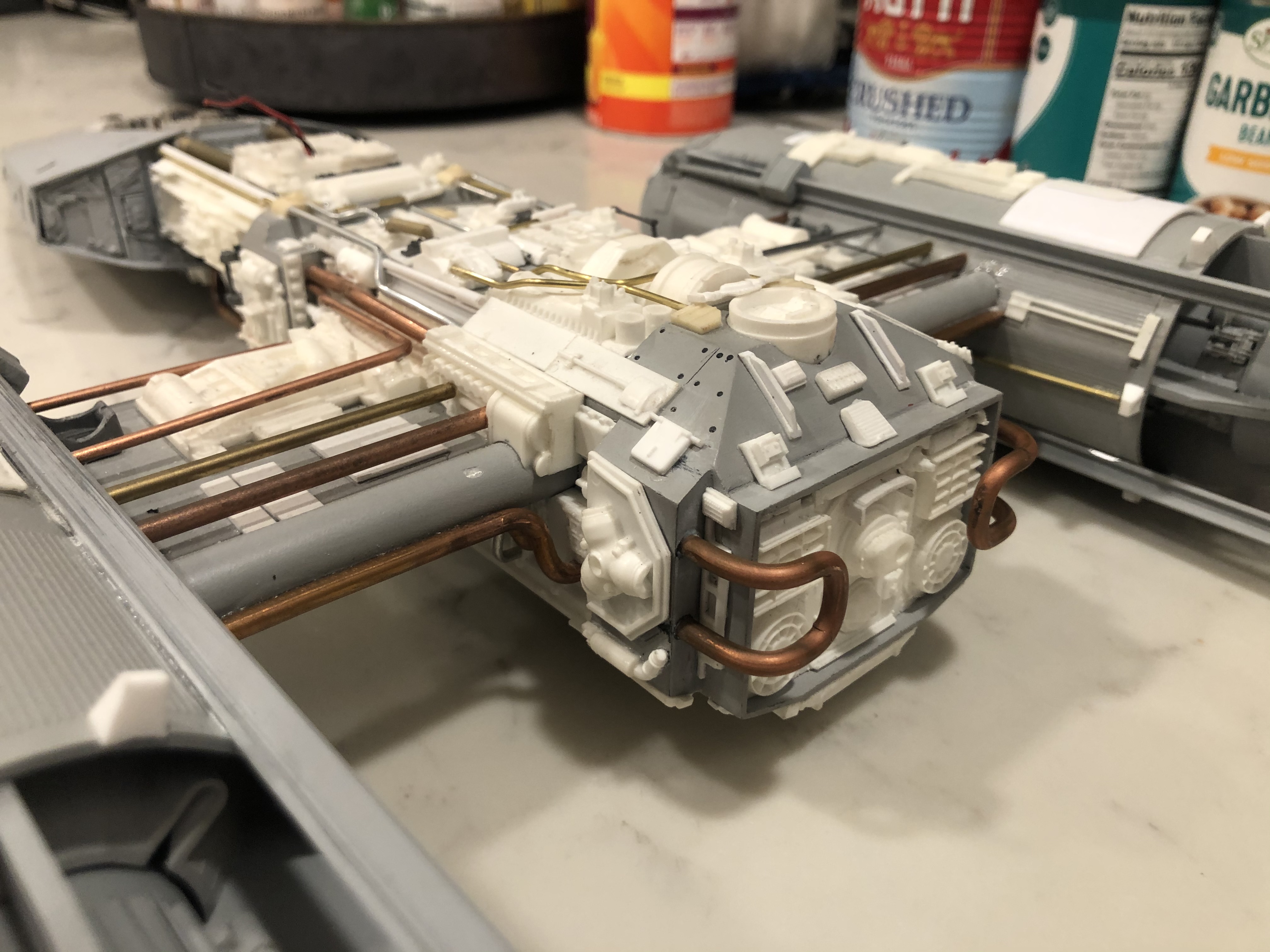

Working on some piping last night.
I reminded myself last night that this is my first SS build and to give myself slack. this not going to be totally accurate and i need to find peace with that.
You have to remember that the rebel fighters were cobbled together from different parts. Whatever they could find. The same way ILM built the models. So unless you were trying to duplicate a particular Y-wing, I wouldn't sweat it. Yours is just one of the Y-wings that we didn't see on screen, ; )
bwayne64
Cobbled together. That is my focus for sure. Thank you for the encouragemeeou're
Cobbled together. That is my focus for sure. Thank you for the encouragement.

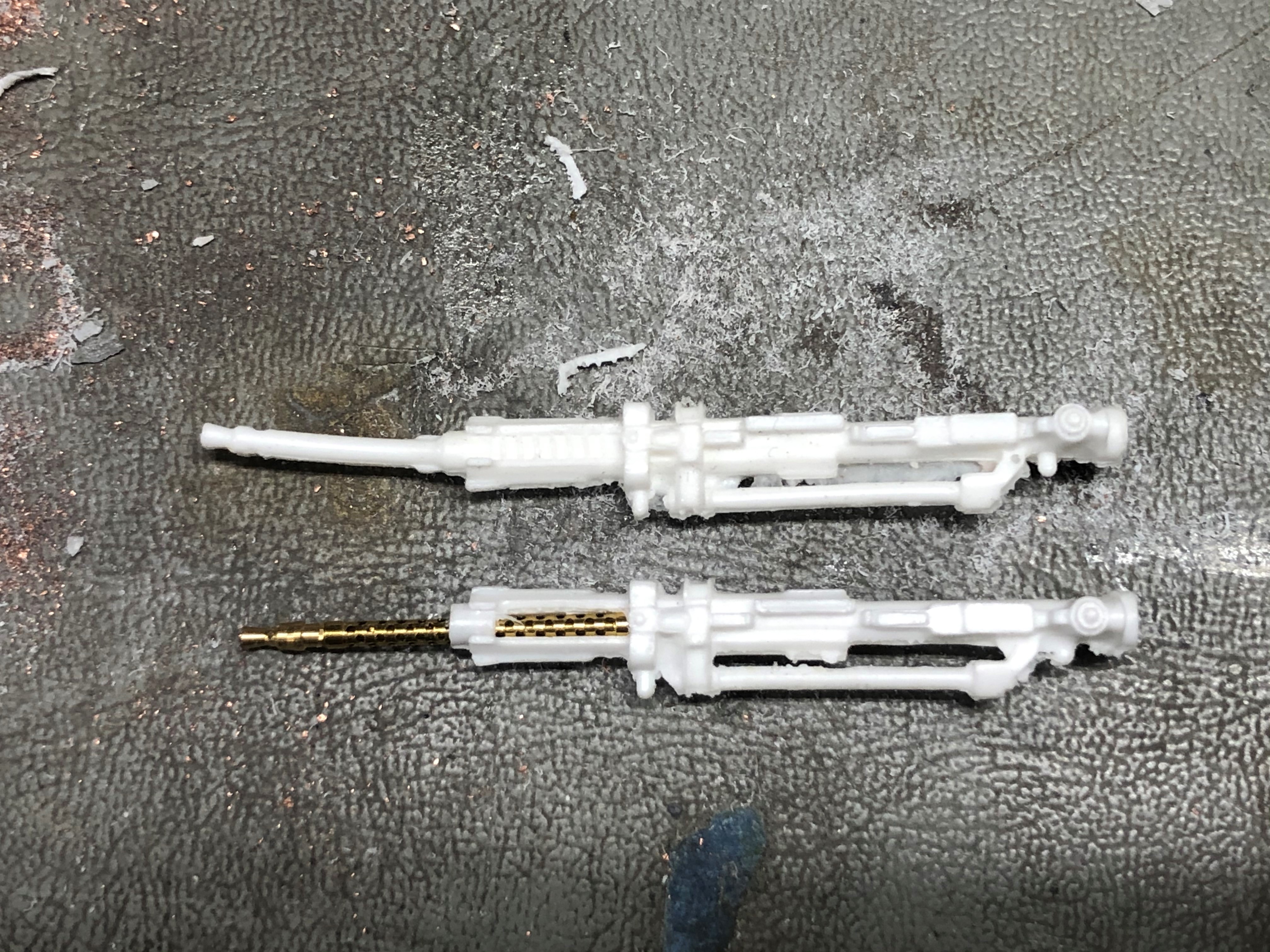

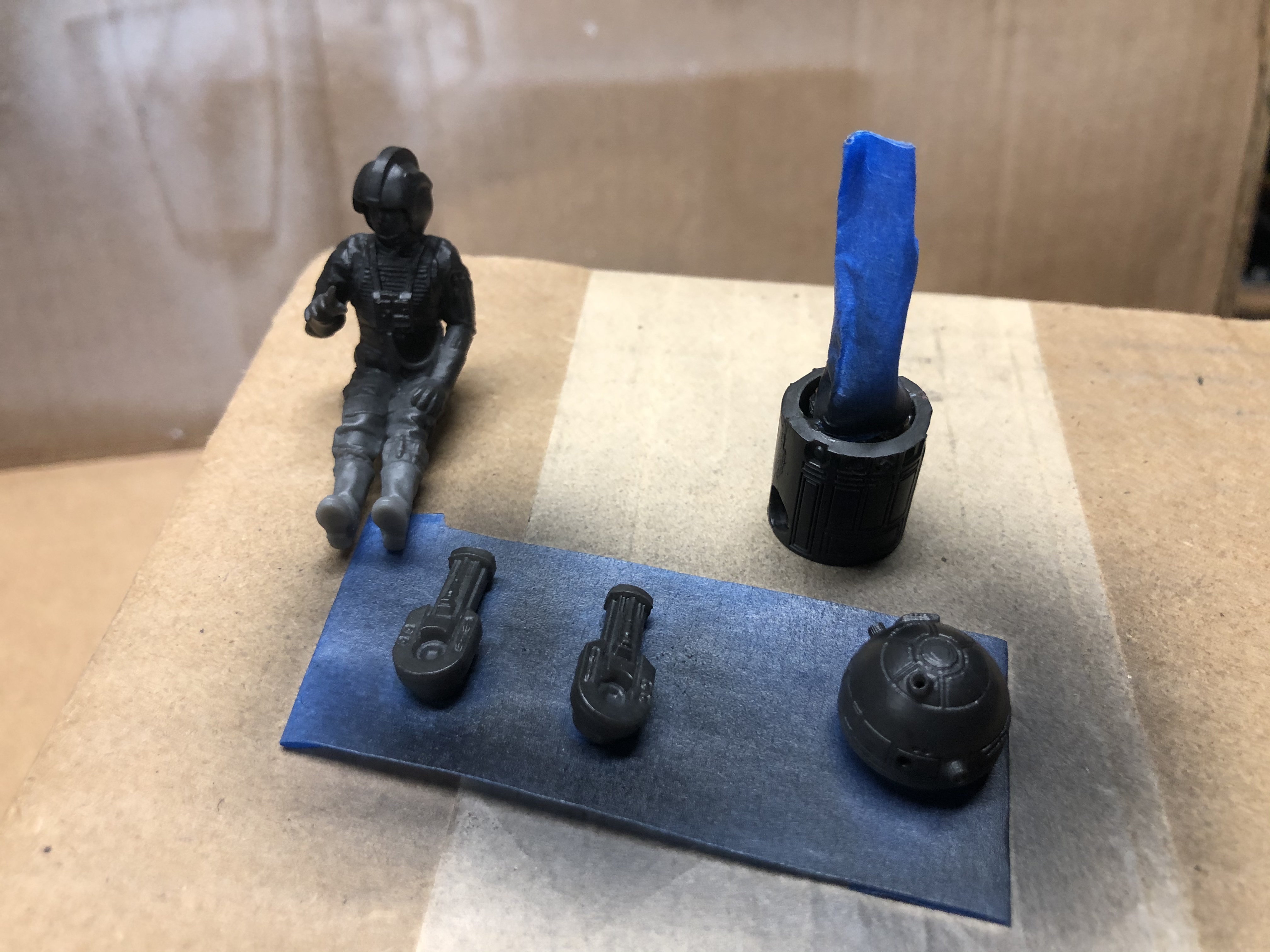

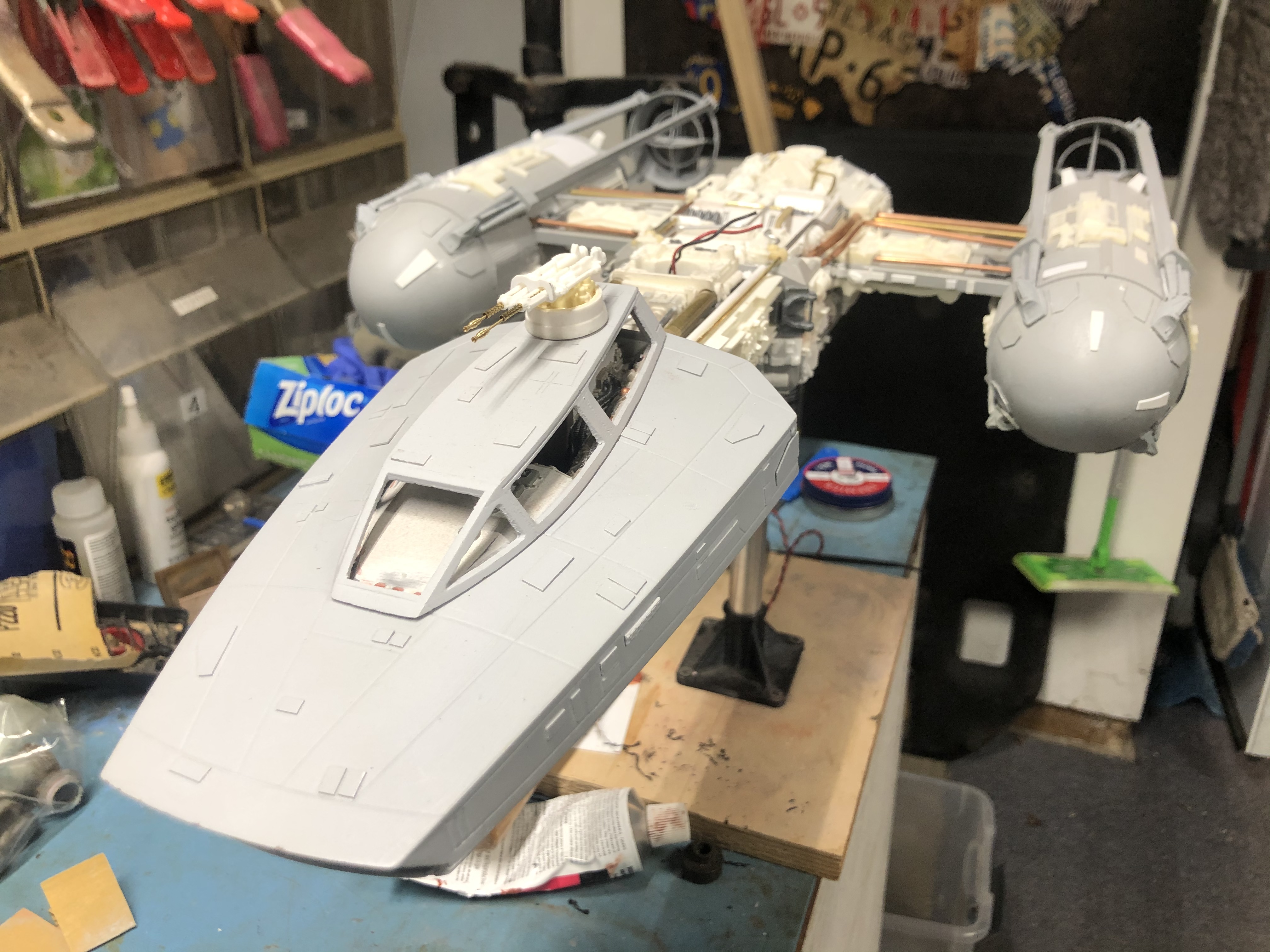

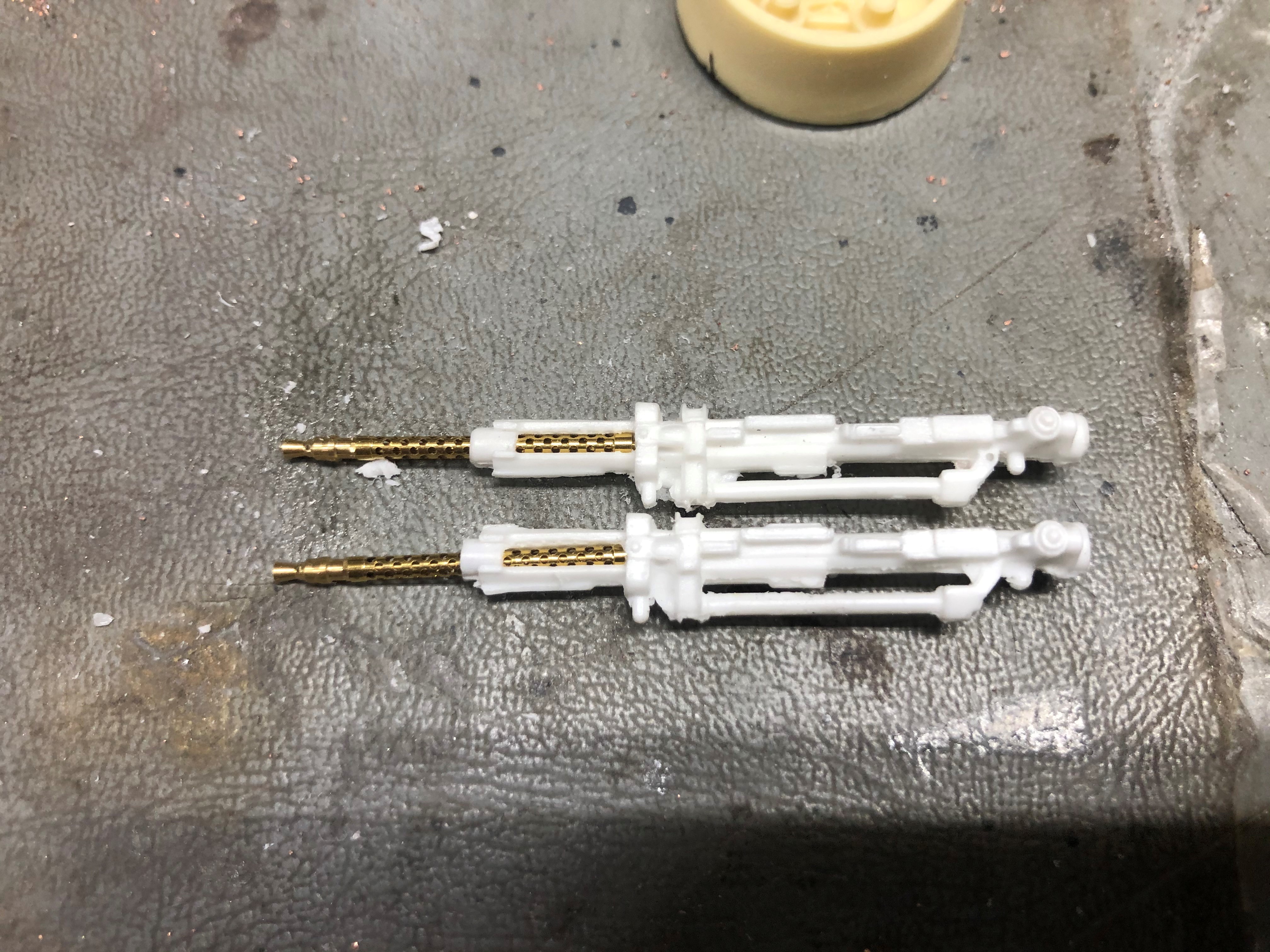

Did some gun pod work last night. Replaced the resin gun barrels with .031" brass ones. (Man i would love to see how those barrels are made. ) Also turned down the gun pod to nest into another cylinder and made the gun saddle plate. (No pictures yet)

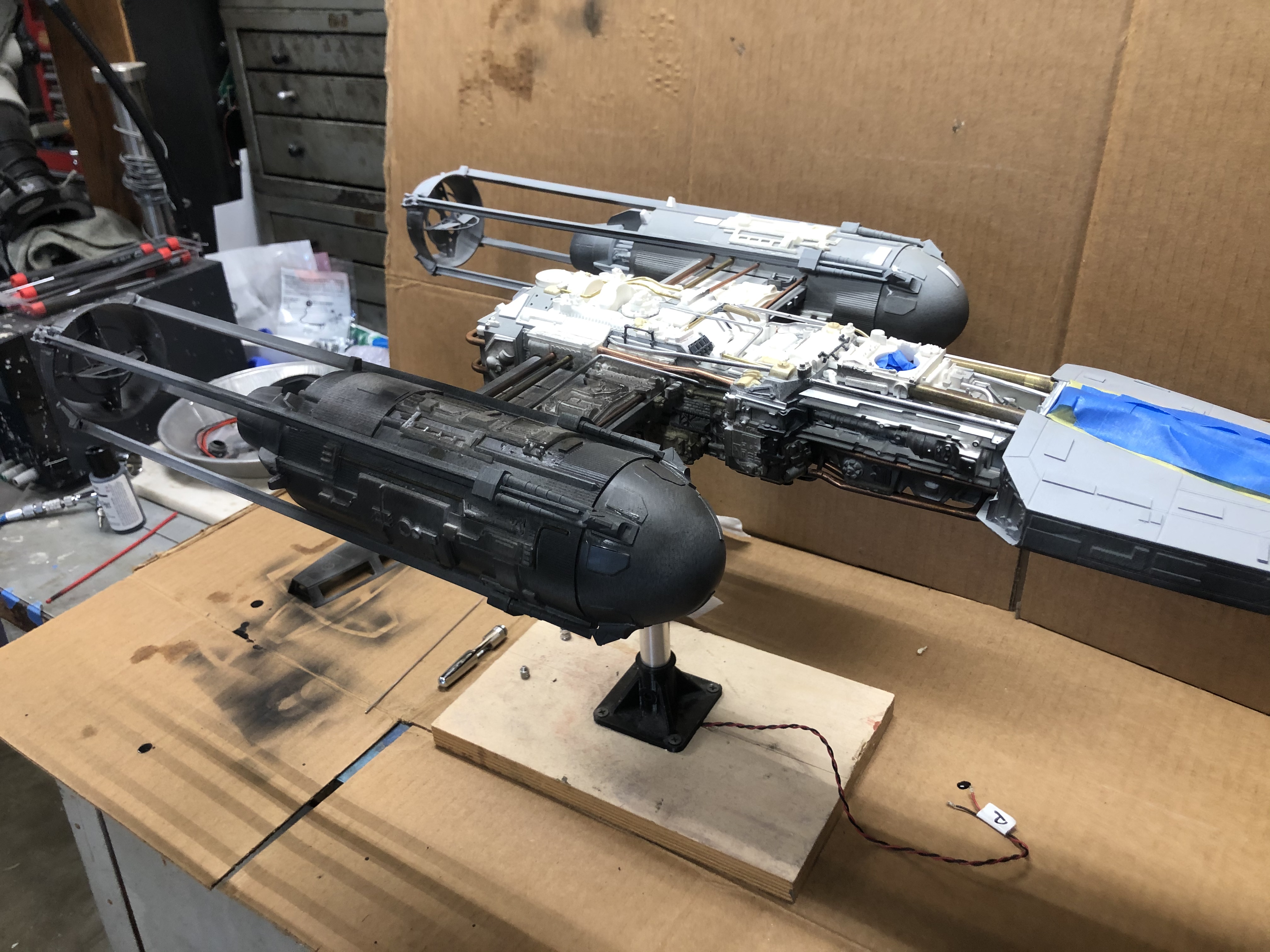

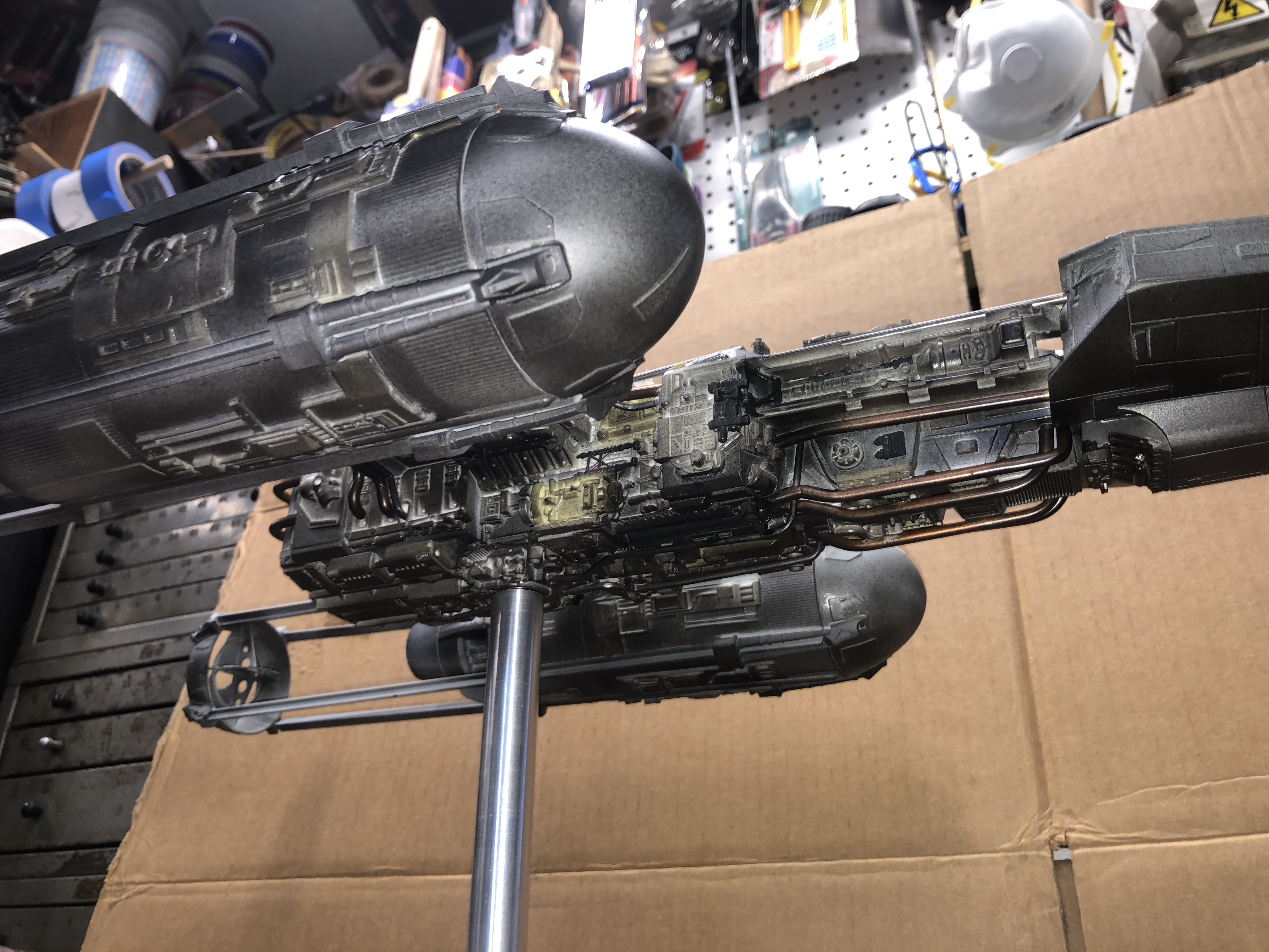

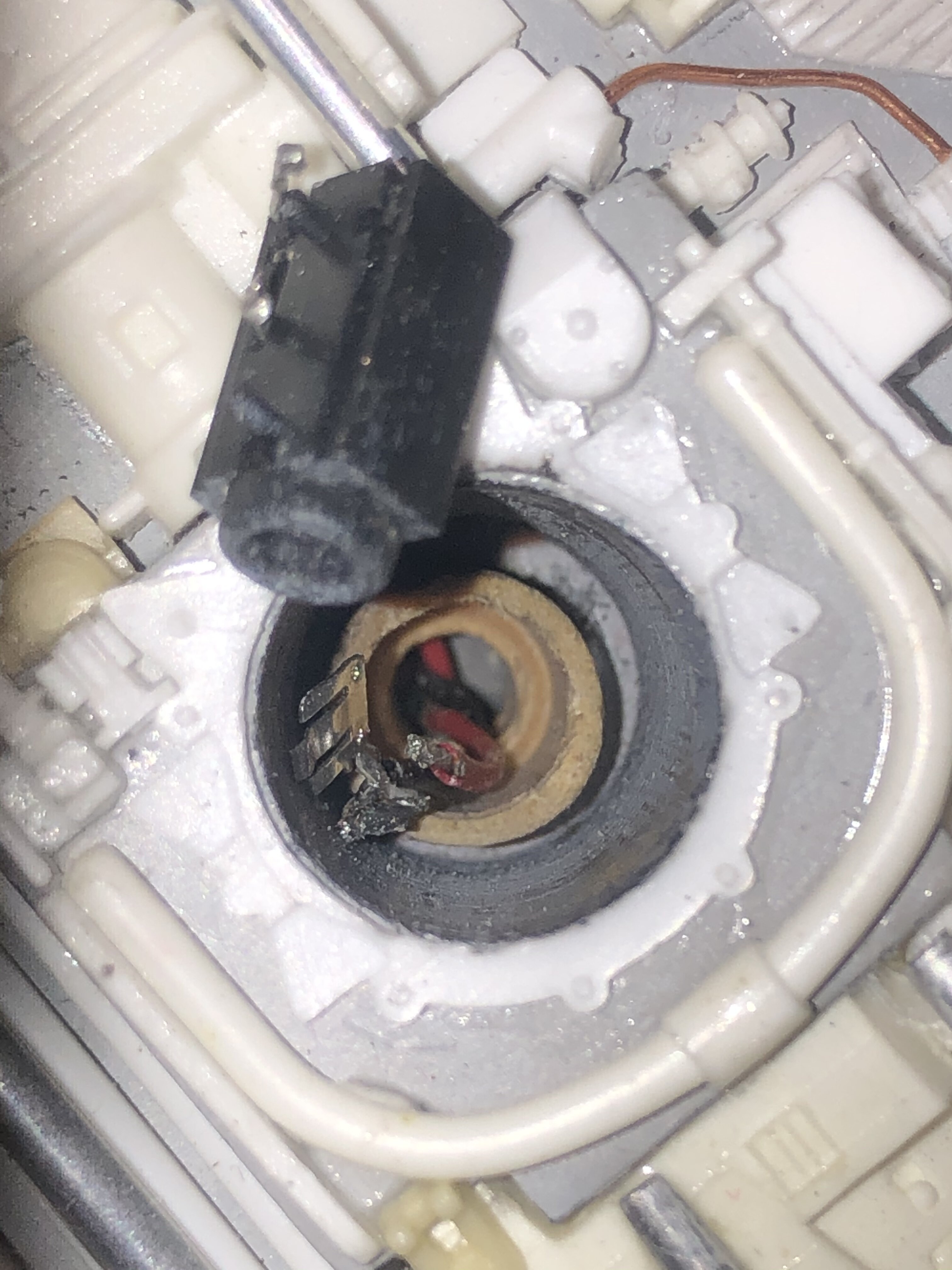

Bad news last night. My internal wiring is damaged. Bummer. Both the 3mm connector broke AND inside I lost continuity. Pretty sure I have to open the back of the ship back up.
What is used typically as a electrical disconnect on the model support shaft?

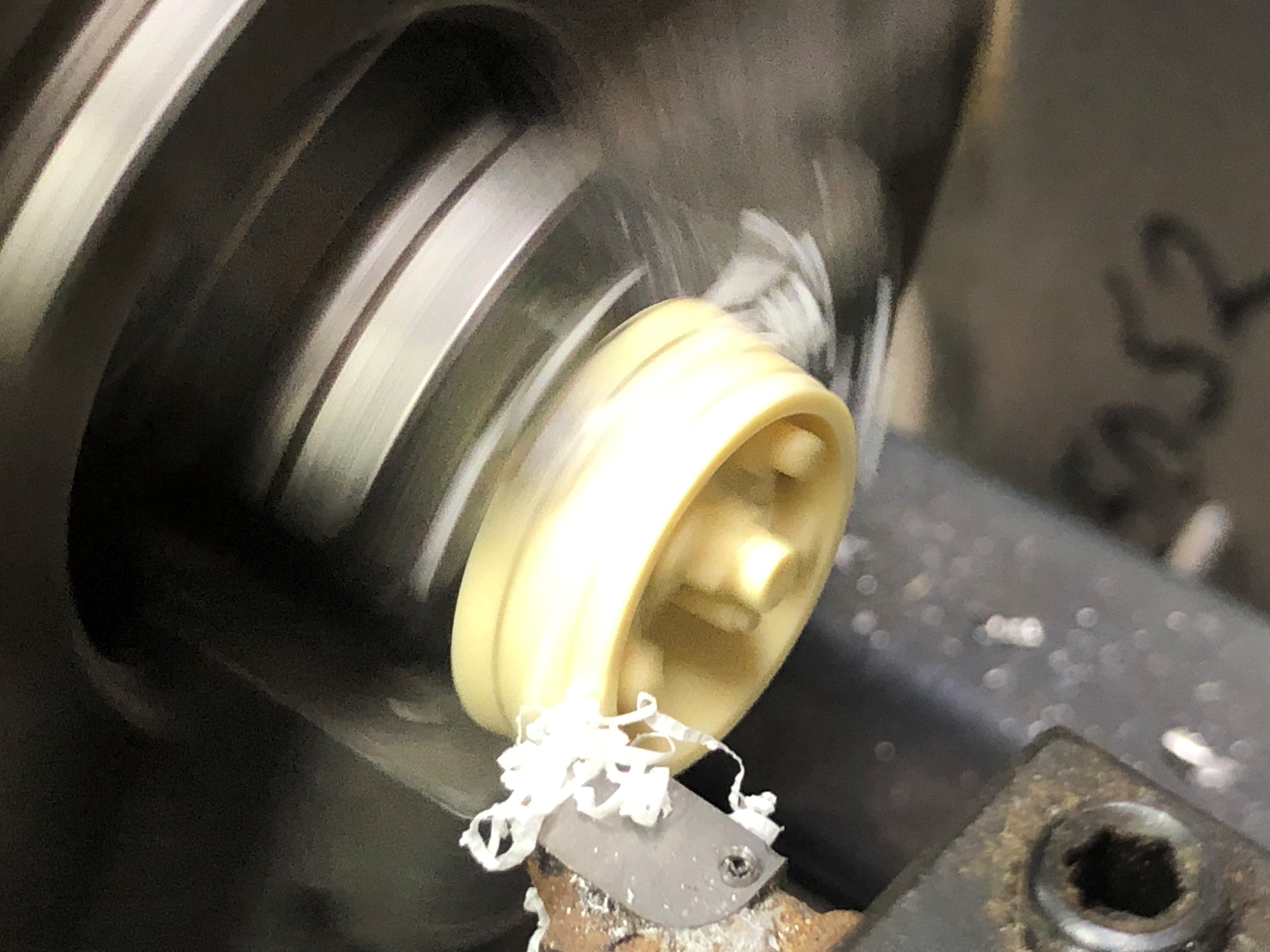

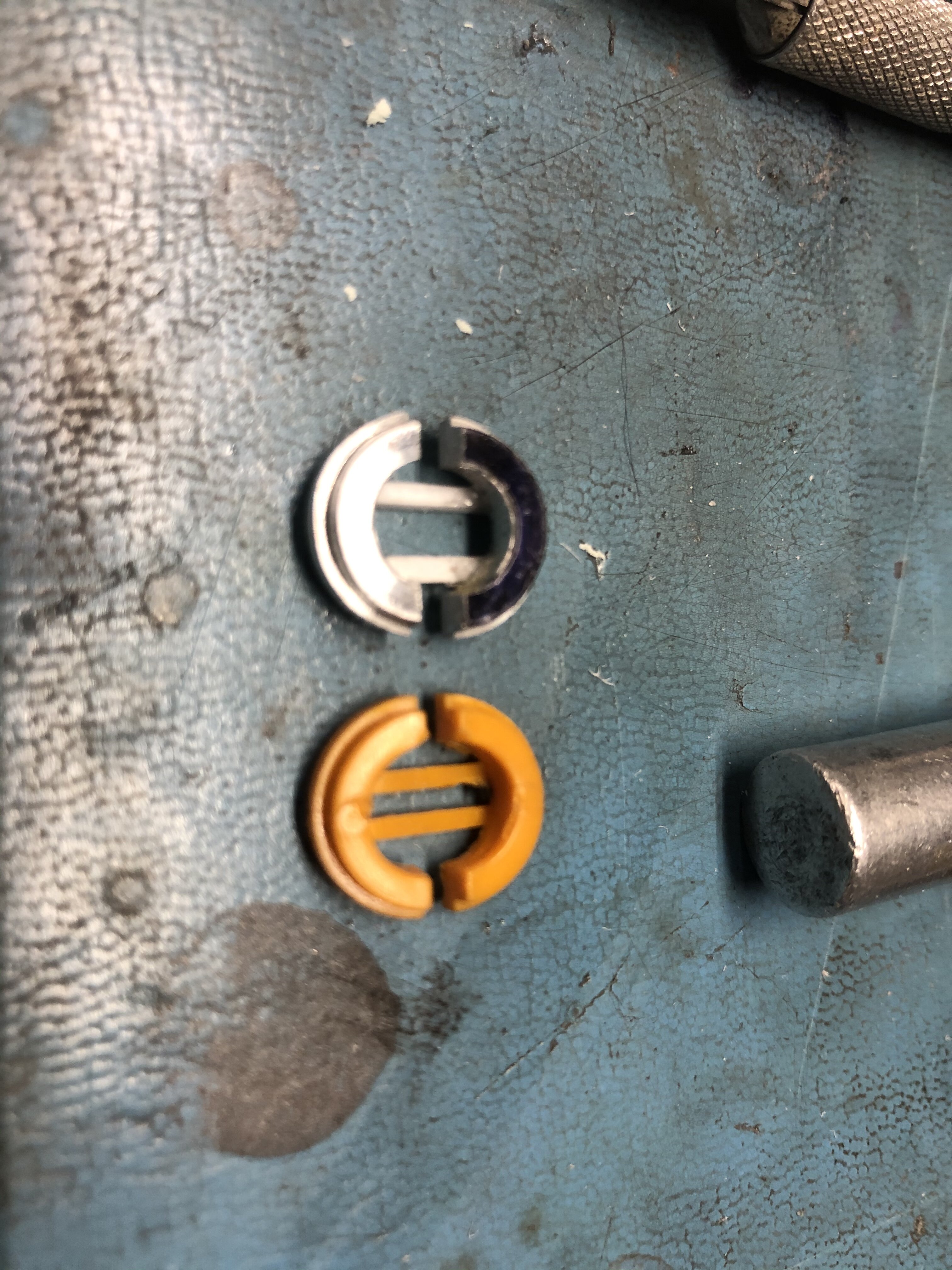

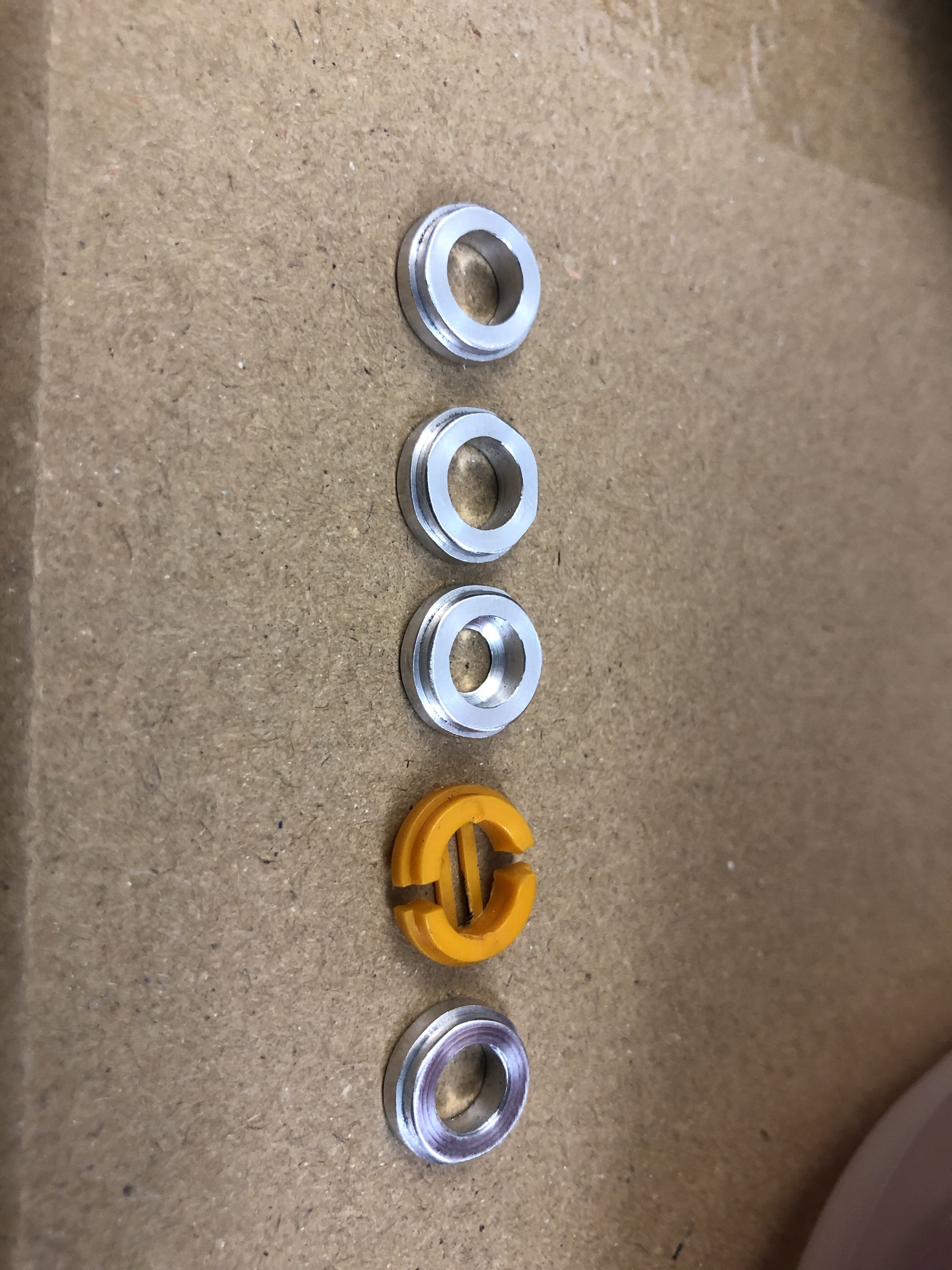

I am making a reproduction of one of the sealab parts in aluminum so that means some fun on the lathe. Will cut it in half and glue some rods under it.

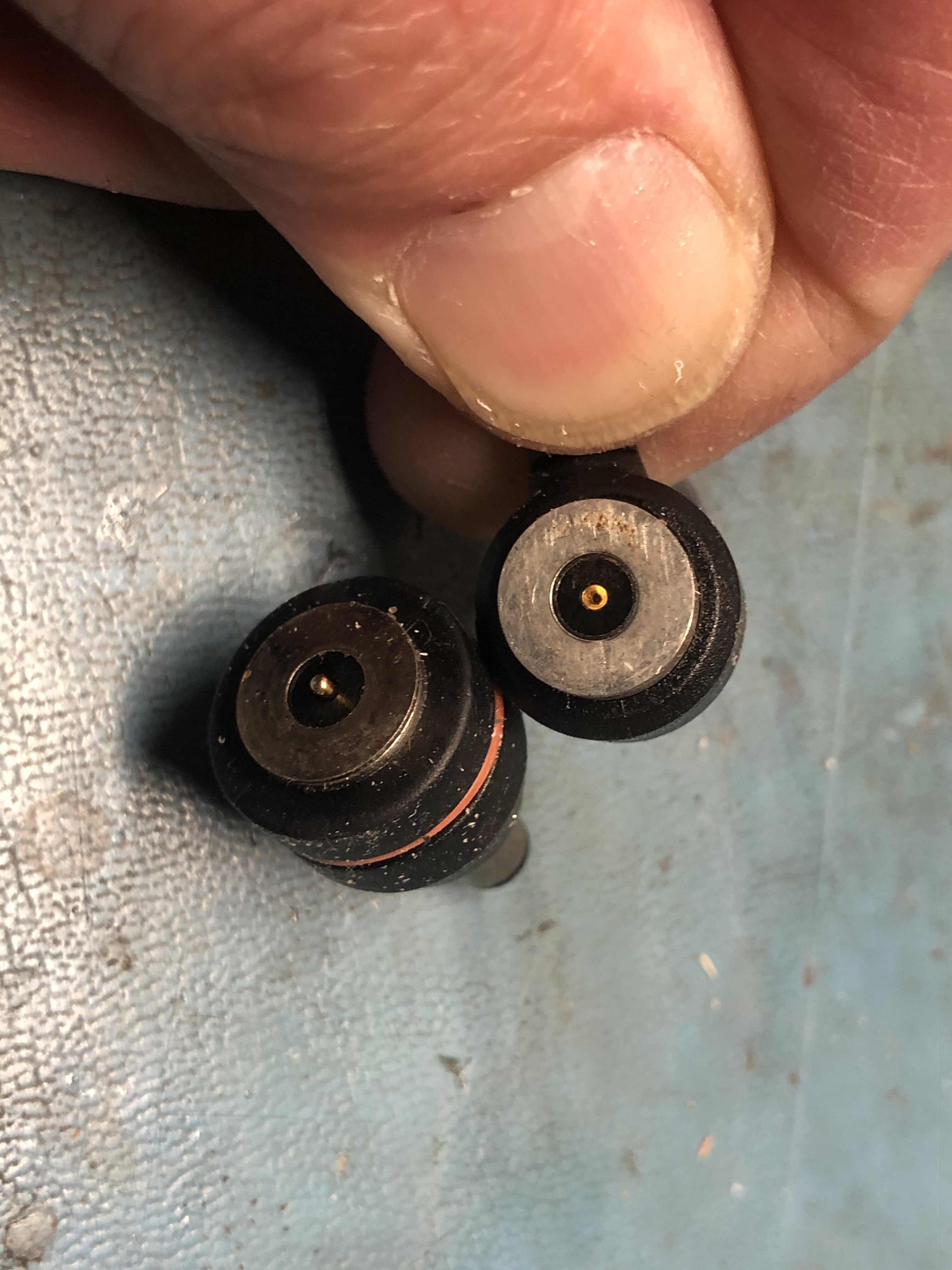

Also found a magnetic 360 degree connector I hope will work for my power input. From a tattoo machine of all things. Coming from China so a few weeks away.

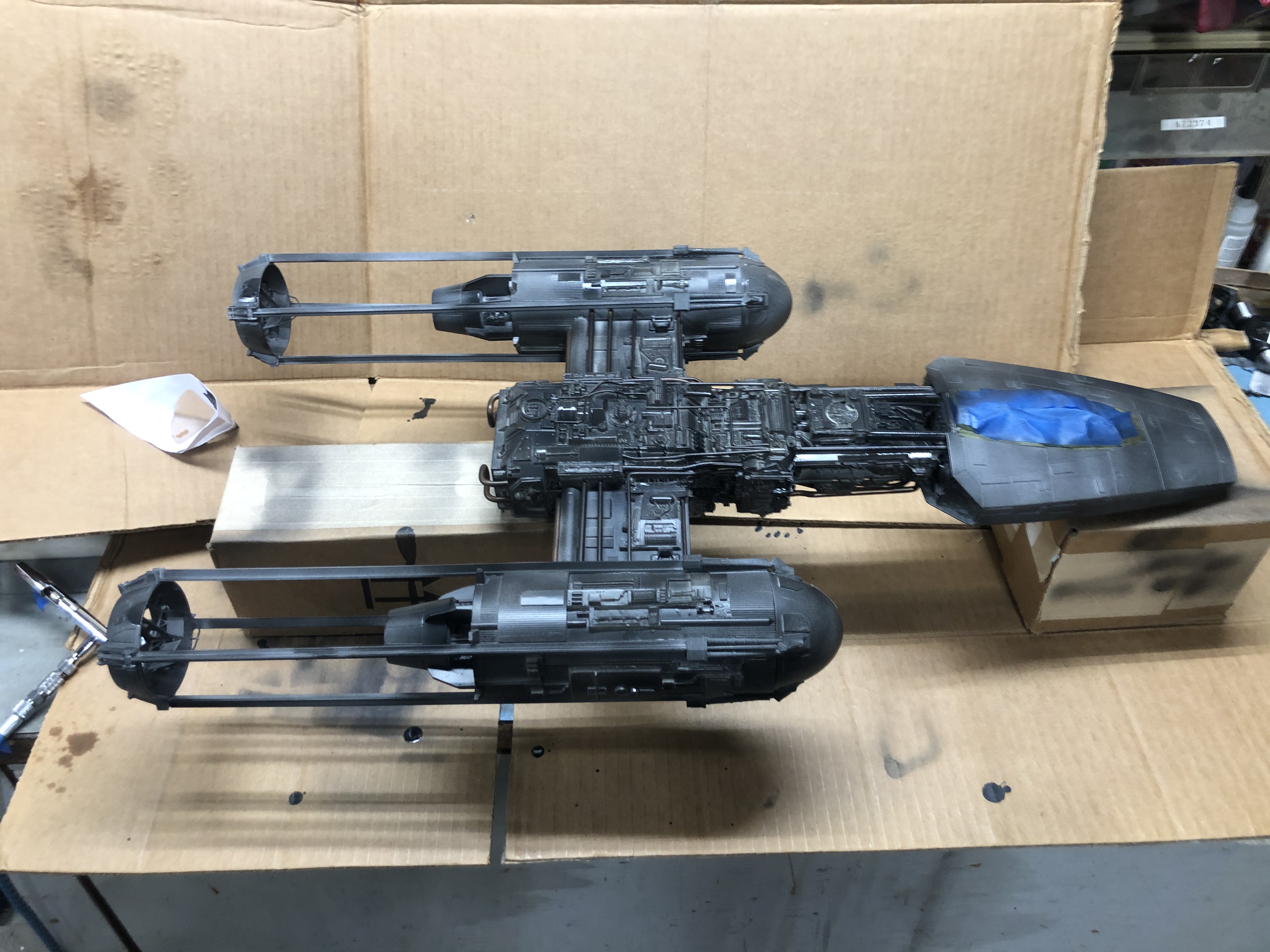

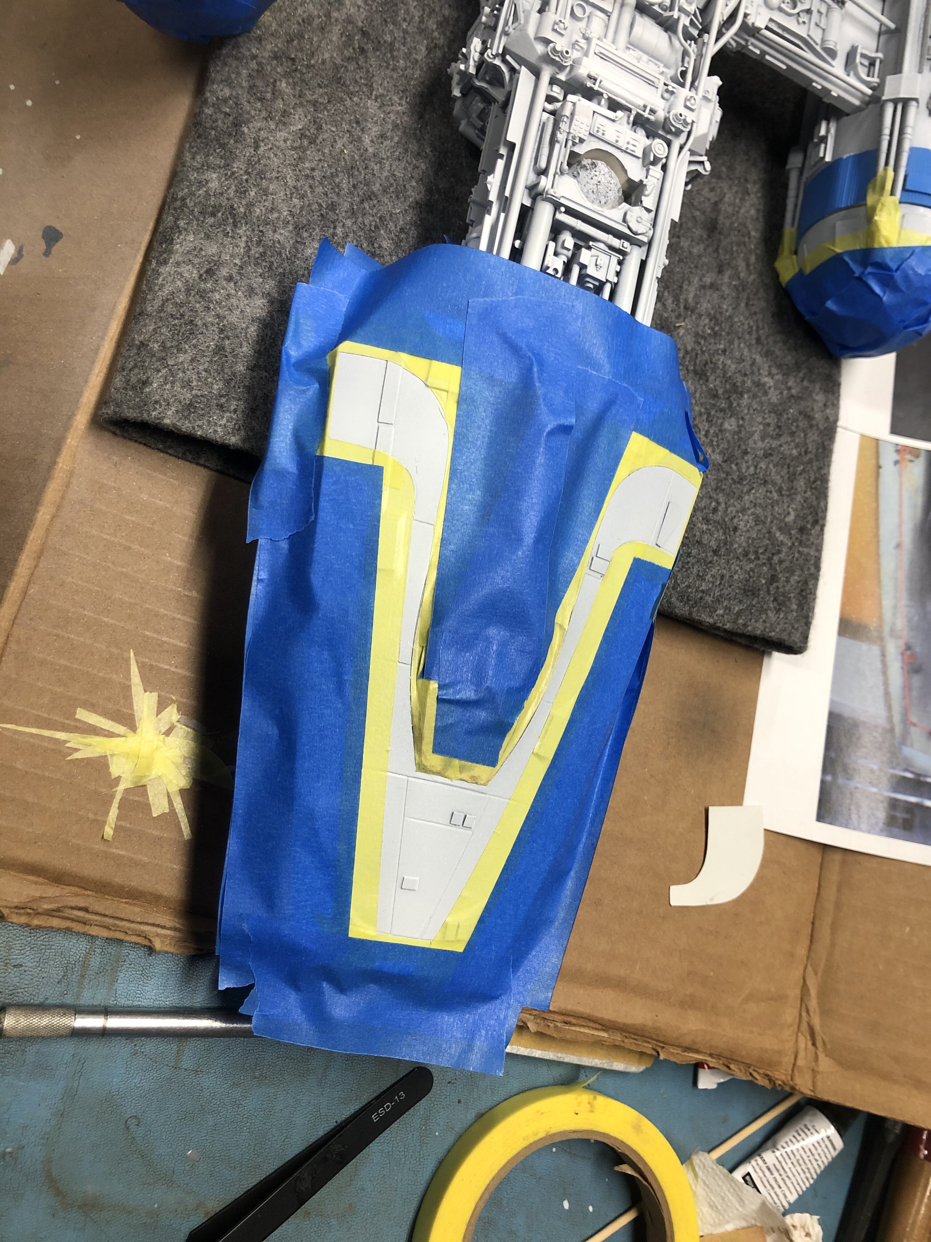

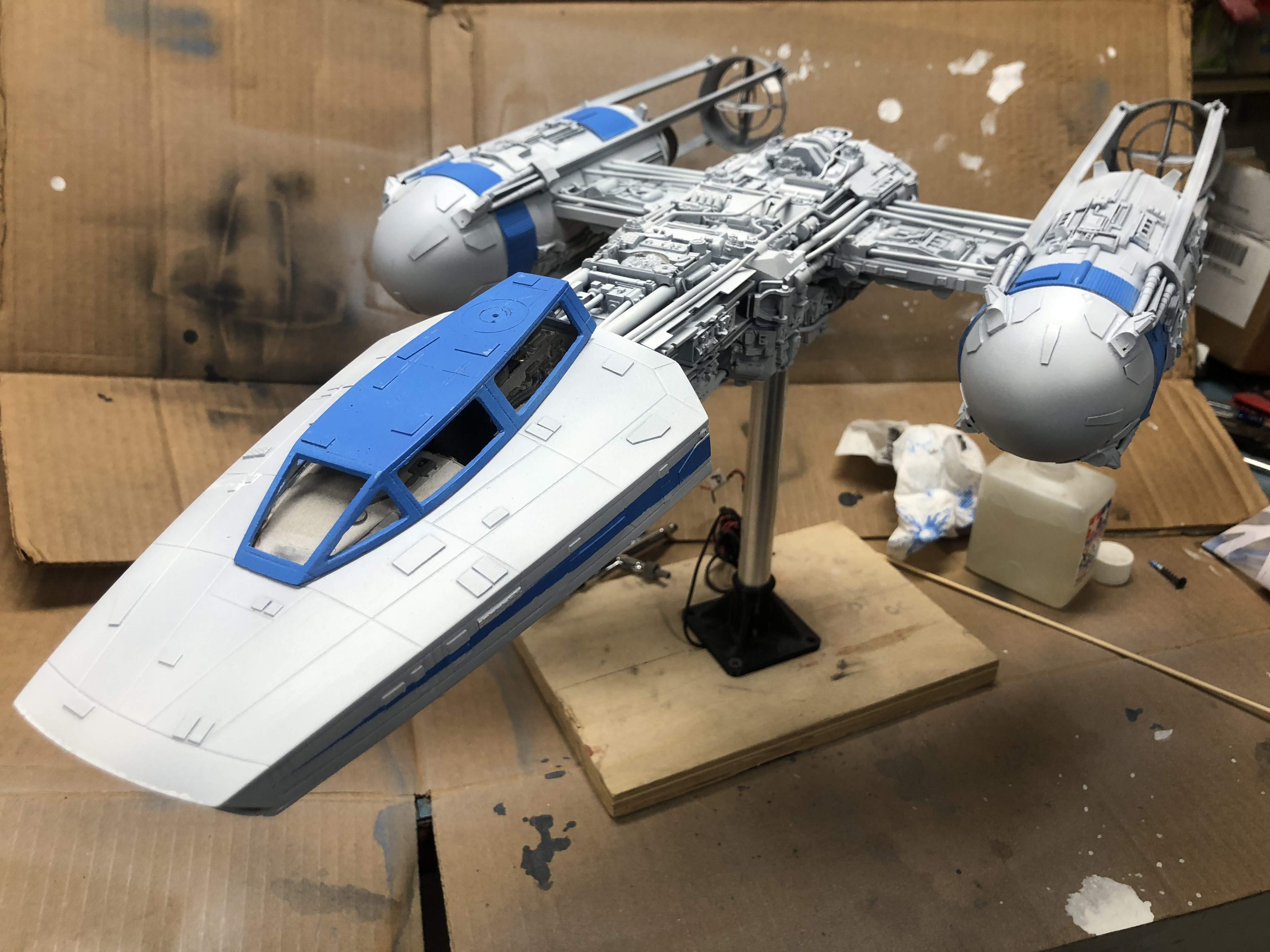

What techniques do you all use for chipping? Are you using paint to fake it or actually chipping the paint layers?
I think my next steps are to:
- Paint the yellow and blue.
- Painting varous parts that are not white.
- Strip the paint from the piping.
- Decals
- Damage application.
Appreciate any guidance on these as this is all new for me. I normally make my paint jobs "new" and this is where i think i will screw things up. I do not want to pay for a paint job though so i am in this to the end...
swgeek
I use chipping fluid to mask my chips, paint base coat, then remove the chipping fluid. For super fine scratches I'll paint them topically.
Bjorn
I can't advise about the best colour choice as I have not researched the Y-Wing in much detail, however have you thought to spray a test panel first to see if you like how the paint goes down.
Really, I just wanted to say, Sensational build, and thank you for sharing your progress!
And best of luck with the painting.
Bjorn
Keiko

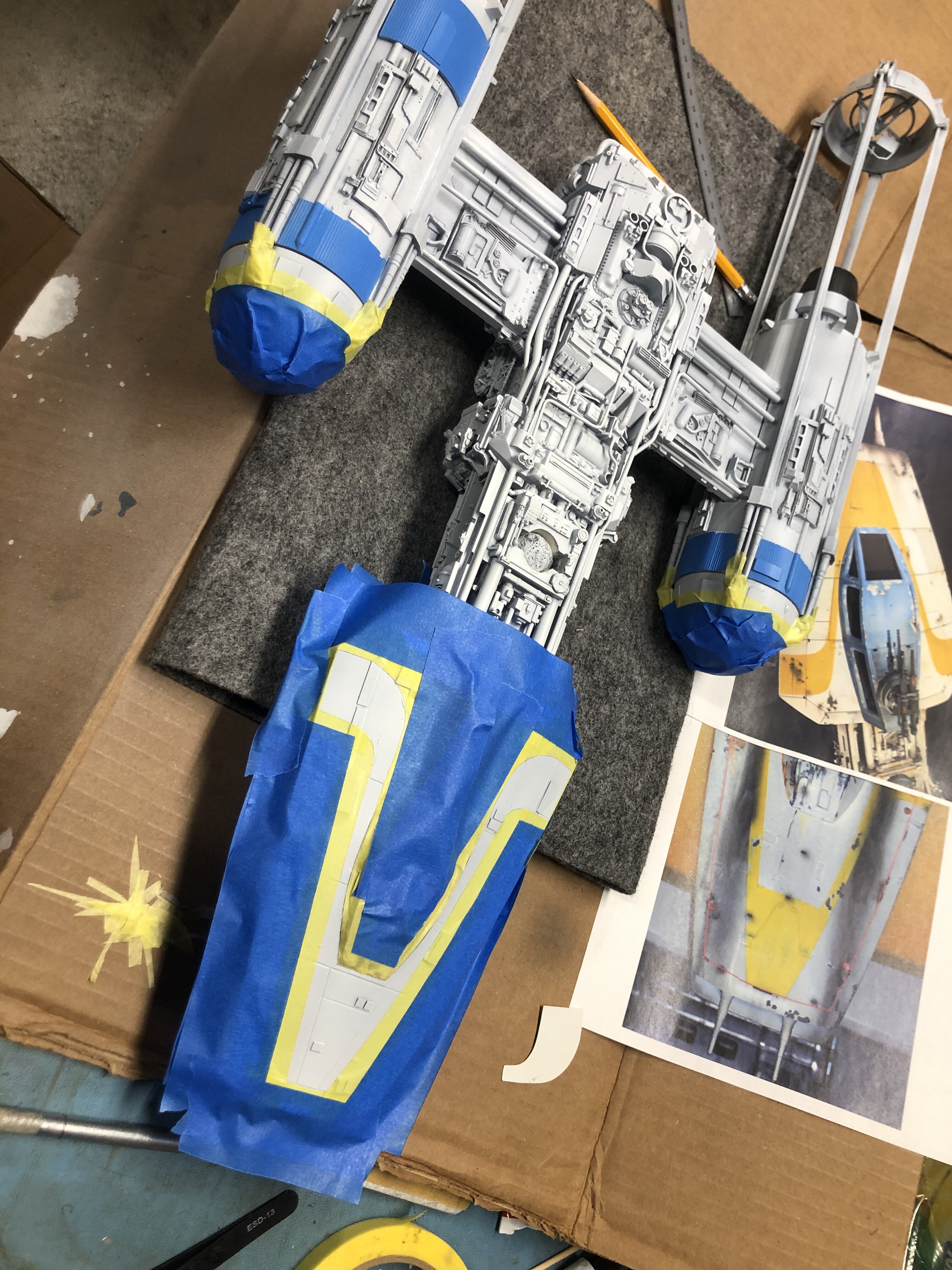

The original colour was (surprise surprise) Reefer Yellow.
It's a fairly basic, pale neutral yellow. I'm just in the process of applying that colour to my own Ywings. It's a little paler than Insignia Yellow. If you're mixing your own, I'd say Insignia Yellow plus 10% white will get you close.
Alternatively, my comparison between Reefer Yellow and the decals of the Bandai kit show that the yellow markings provided are very close and if you try to match that, you'll be there. (Assuming you also have a Bandai kit)
mjhenks
Refer Yellow is what i have so looks like i am good. I will spray a test piece but my comparison is a computer screen and color print of someones picture. Neither of which are accurate i am sure.
Thank you.
