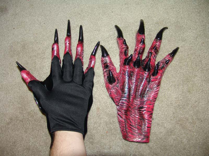

The gloves were generic 'Demon Hands' that I'm going to paint with my skin. I picked them up at spookshop.com during a sale. They can be found cheaper but watch shipping. http://www.halloweencostumes.com/devil-hands.html
They are a lycra glove with a vinyl over glove. I like them because they breath and they're priced right. :)

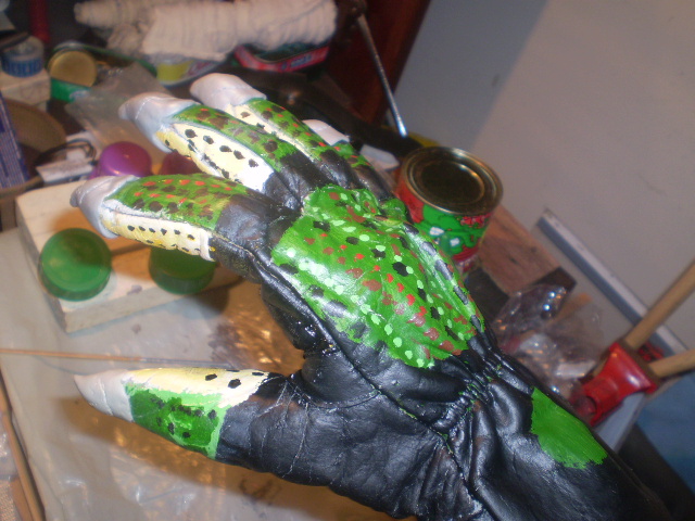

great job man, I would show you my work using leather gloves, which are more comfortable because they do not sweat as much as hands latex. painting is not good but who knows how to do well can get a good job

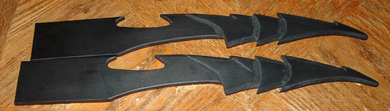

So my helmets progress was slowed and I got sidetracked by blades...
EDIT: This is the scaled up version of my son's proof of concept: http://www.thehunterslair.com/index.php?showtopic=15423
I'm using 1/8"(.125") ABS plastic because I have a whole sheet of this stuff.

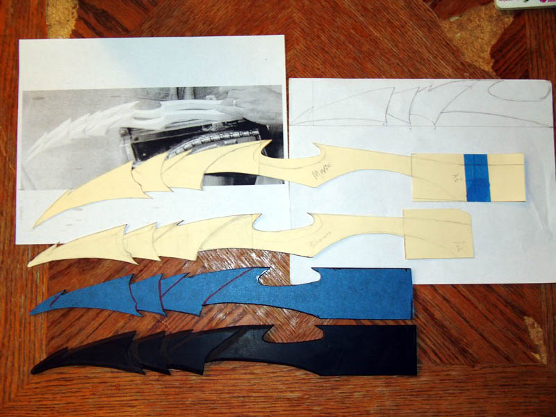

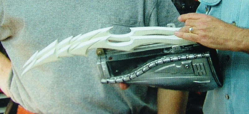

Going off of this reference pic, I drew up my blades.
I made two templates using manila folder. One was made to be like the pic and the other is shorter and straight to facilitate the movement without being so damn long.
I made a plastic template so that I could have a more permanent template. Not that that matters, the folder paper lasts a while if it's not abused.

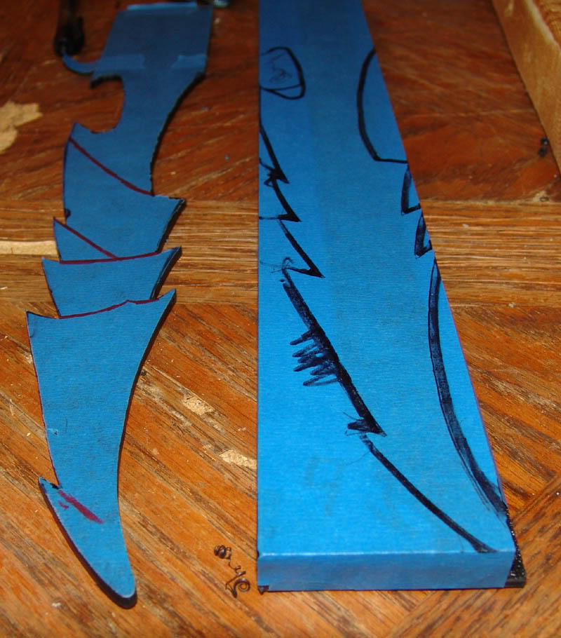

I cut my 15" X 2" stripes and glued them into pairs to double up the thickness to get to 1/4". Then taped them all together and traced out the blades.
I band sawed out the shape then clamped them into the vise and filed them down to match each other.
Once I had them separate I filed and roto-tooled them to detail them to resemble the reference pic. I rounded all of the edges and beveled the edges. Overall I'm not thrilled with the way they came out and I have some touch ups to do before I paint them.
This is the lot of blades.
