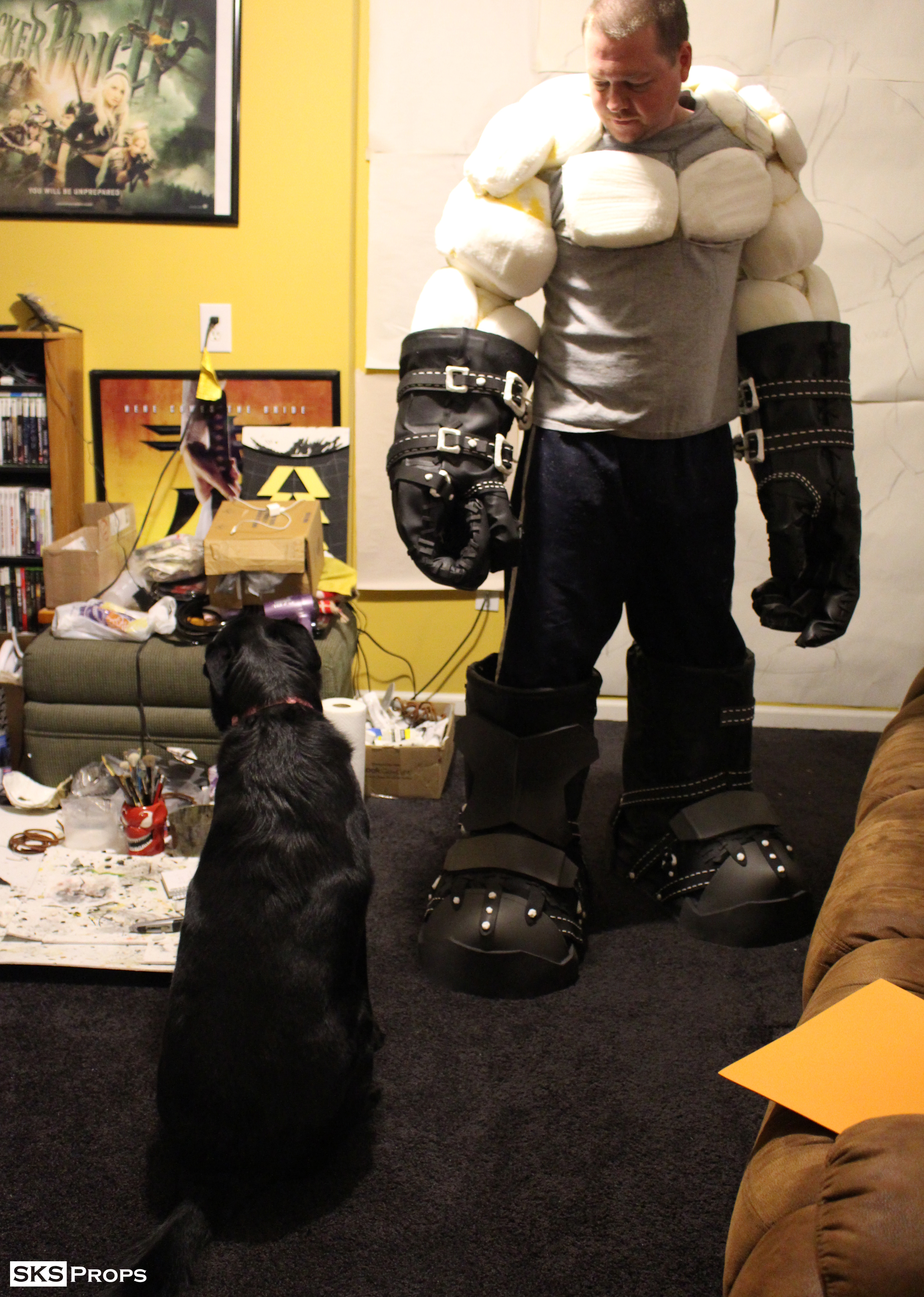

Another shot of the muscle suit still under construction. I am so happy with how the proportions are turning out. I was very worried about the arms, gloves and feet looking way over sized to the point of being goofy(well goofier than they already do with Warcraft proportions). Also I can't stress how big this costume really is until you see it in person. Just to show scale my dog is a 80+ pounds black lab and you can see that carnage coffee cup on the floor. I have started the shoulder pads and I can't wait to show those off later next week after I talk about the muscle suit construction.
Re: World of Warcraft Orc Full Size Cosplay Costume SKS Props - Updated 1/23/2016
With the muscles your hands and feet are looks much more into wow orc proportions.Orcs are not much taller than the other races but they are much more beefy.
