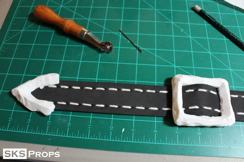

Because this is an all freehand custom build I couldn't just go out and buy buckles and rivets. So I took the extra step and sculpted a bunch of bits and pieces out out of Monster Clay. Overall I really wanted a rough hand forged look. I made box molds out of foam core and used Smooth-On's oomoo silicone. I personally hate this stuff but I had some trial kits left over that needed to be used before they went bad.

For my Warcraft Orc I decided to sew a single stitch on the straps rather than a saddle stitch. From a distance I think they individual stitches will show up better since there will be straps all over this build. Individually cut pieces of craft foam were cut and placed on the boots to look like large stitches this will keep with the stylized over the top feel of Warcraft characters.
