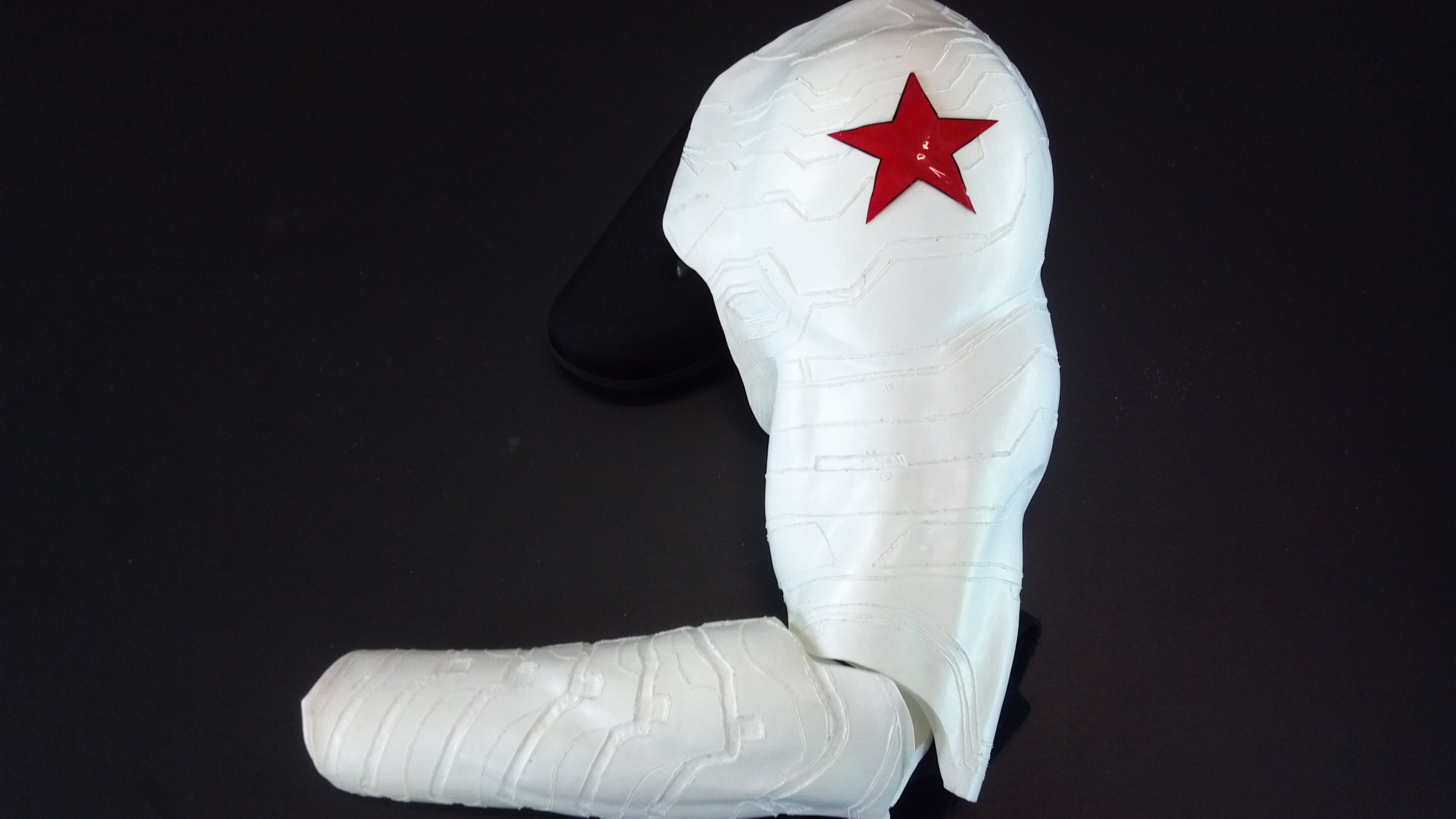

I just pulled the second cast to make one that articulates better and think I will keep with the same paint plan.
I really don't want to take the chance of ruining the mold this soon.

Arm version 2 with some movement.
Will hinge the elbow so it all stays in place ,but this is close.

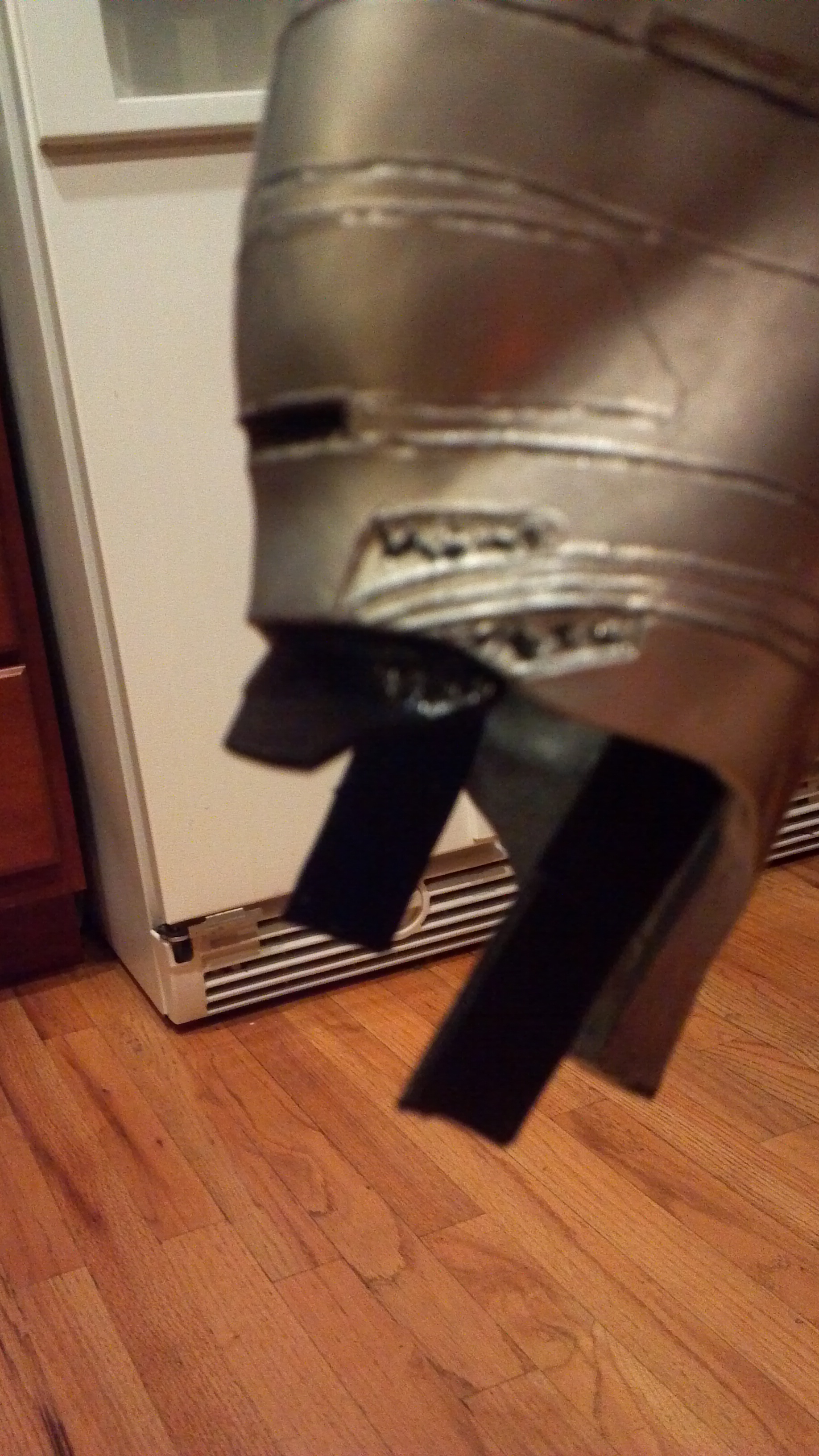

Thank you. it was not an easy undertaking but me and my kids got a little winter soldier obsessed there for a bit. I was going for the look of the illustrated arm so I had that as my anatomy guide . There was a time when this thing sat in a corner as an arm with clay lumped onto it., I didn't know where to begin. then one day I slapped on the tricep muscle and that gave a point of refence that I made everything else around.

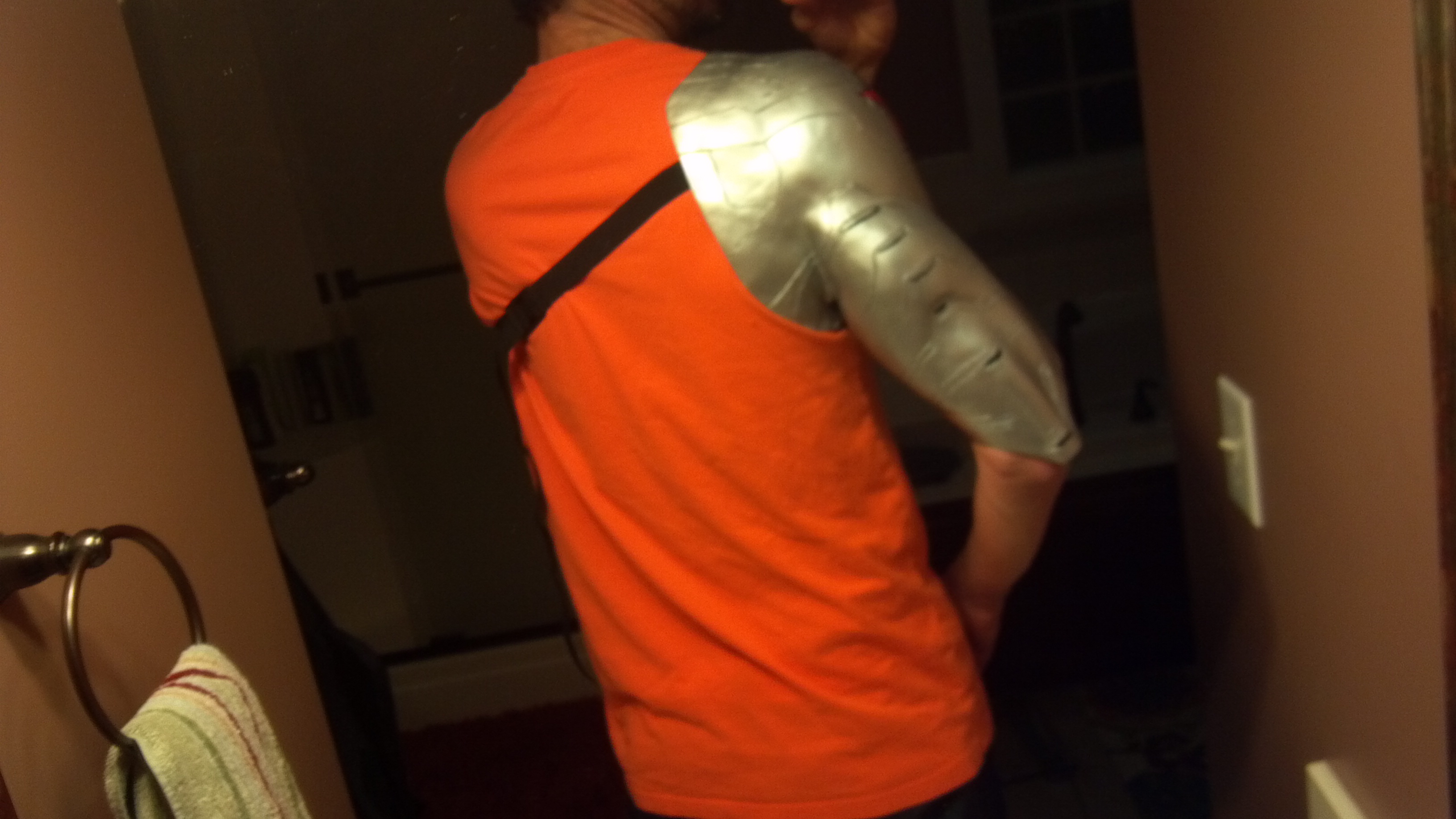

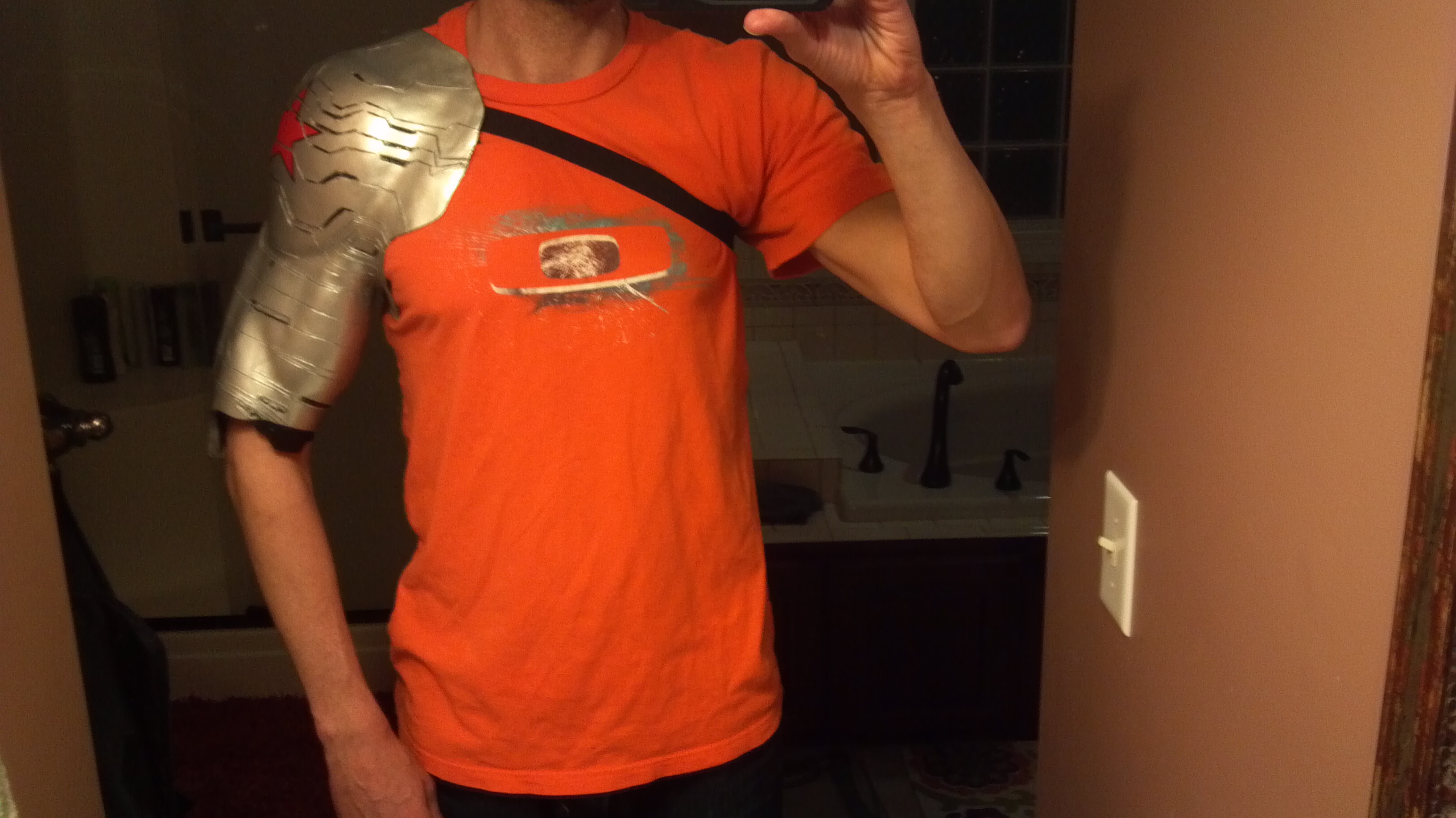

As for the "stick to me" part I learned on this build to keep it simple don't overthink: so it just has a one inch elastic strap that buckles in the back to adjust the tension.
it hooks in the front top, goes under my arm, around my back and to the bottom of the back flange. sticky Velcro on the arm, sewable Velcro on the strap to attach the strap to the arm. keeps it in place perfectly and also has some give when I move.
I hinged the 2 parts with elastic as well at the elbow that use the point at the back of the arm as a hinge .
