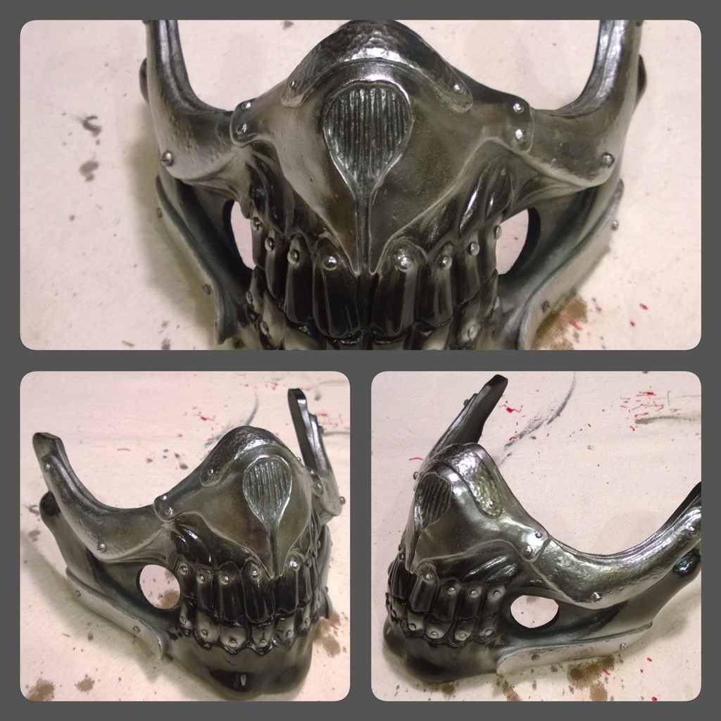

You can pick up a decent starter airbrush from Harbor Freight for pretty cheap, if you want to use the Alclad. Although, that's quite a bit of area to cover with an airbrush. For reference sake, I just put some down on an Immortan Joe mask, and the result is pretty friggin' awesome.

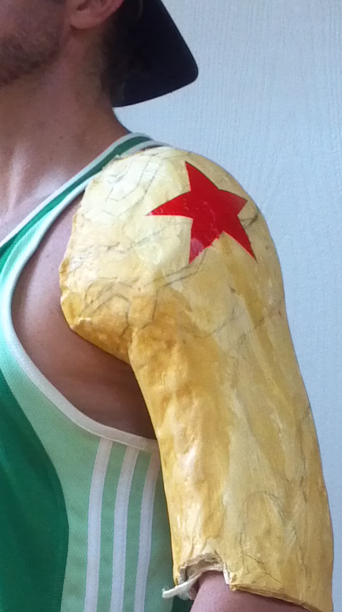

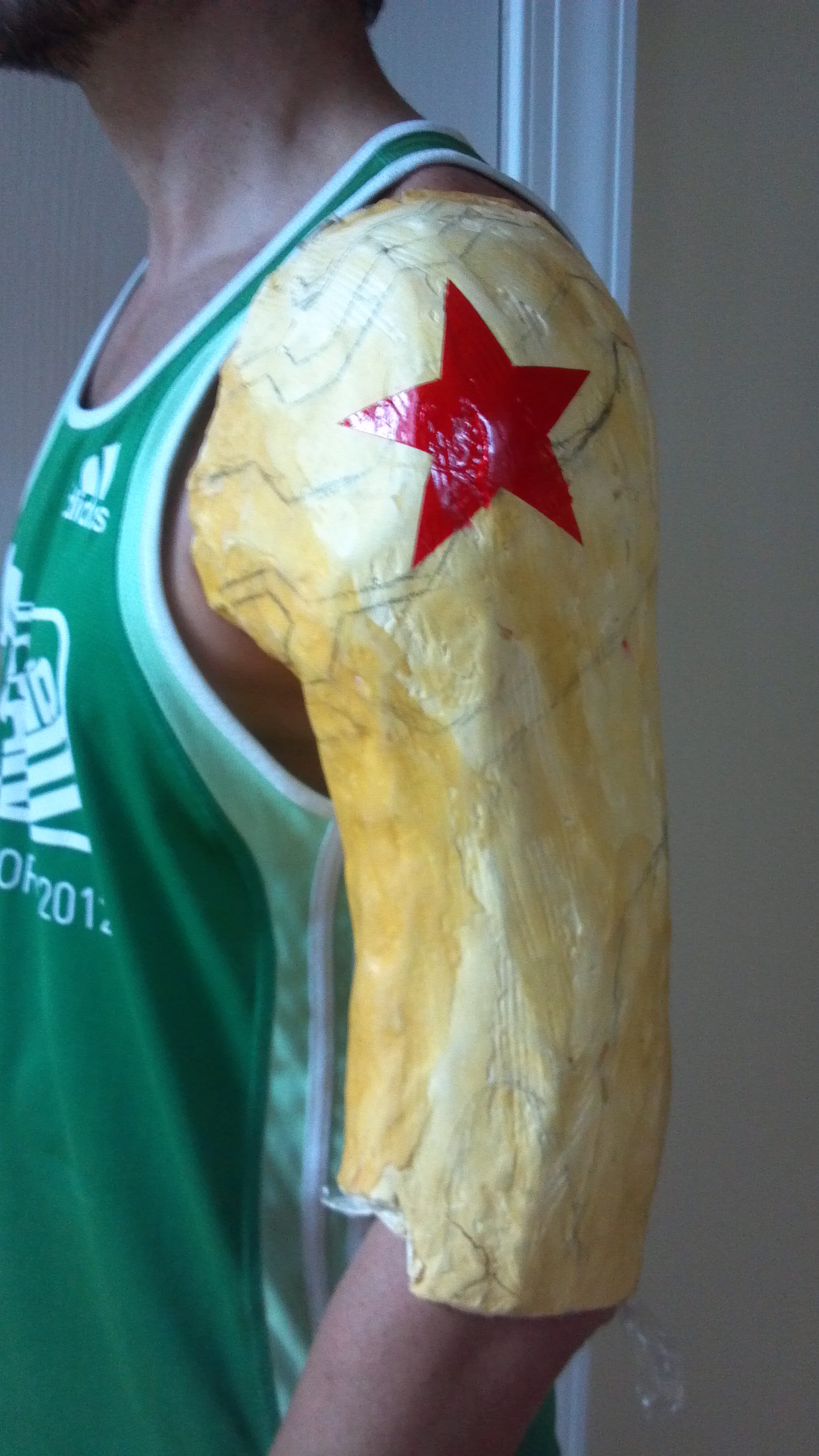

Messing around with taping off the star and its size on an old version of the arm that didn't work out.
This one is at 70% . I think its a tad too big and I have a 65% star printed off that I think will look better.
Does this star look too big, just right?
I think I like the red too.

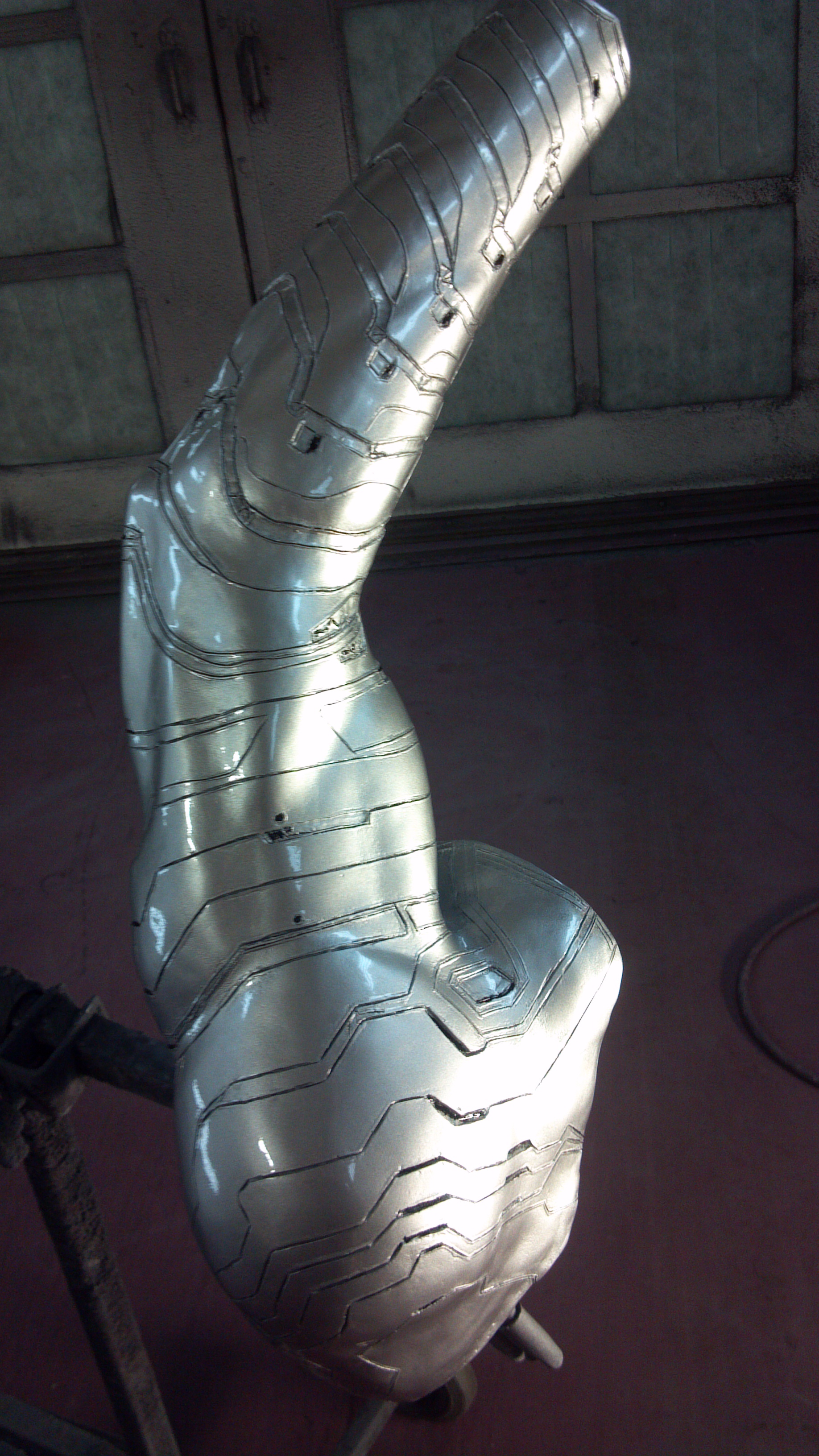

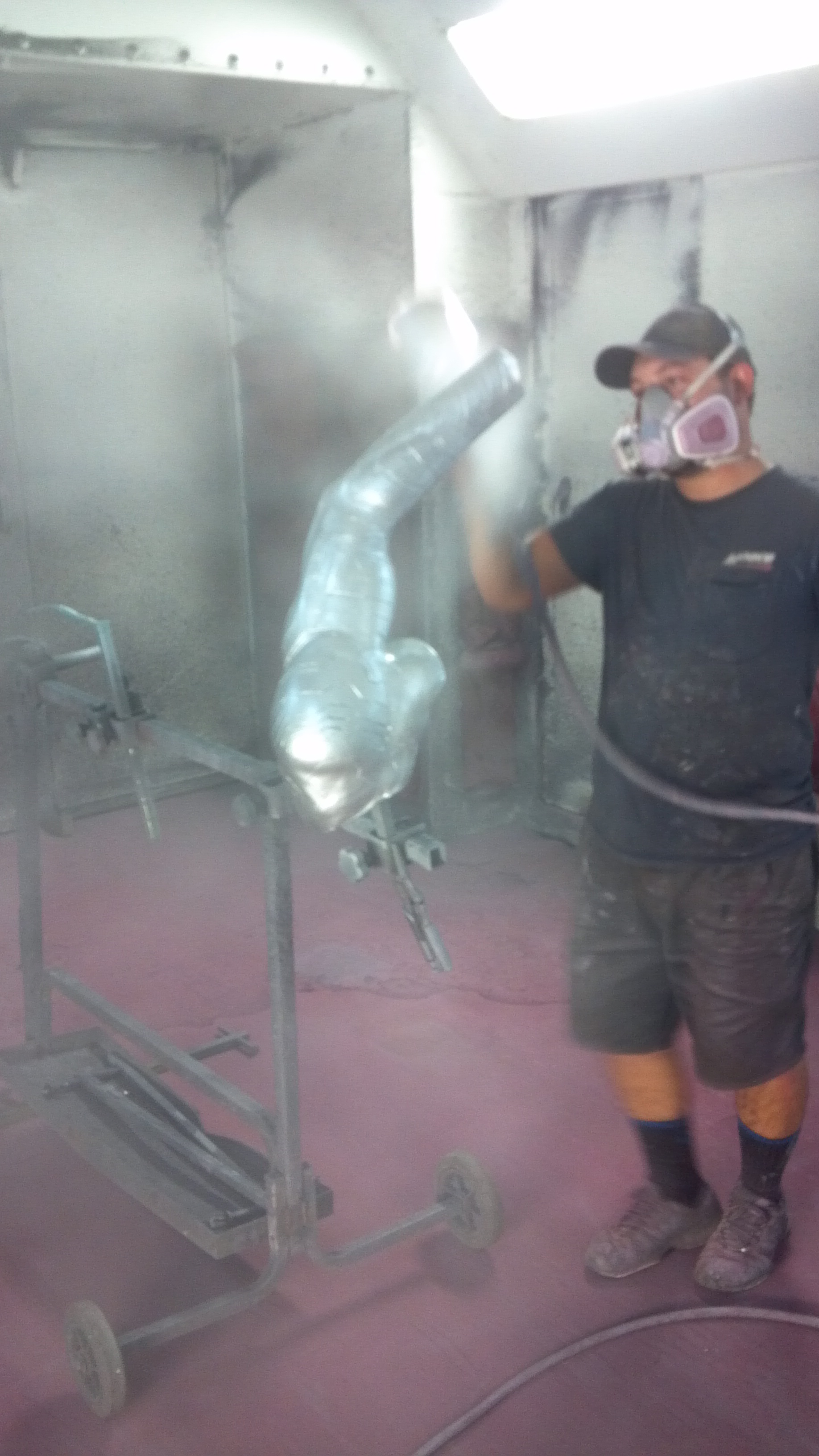

Well I took a trip to the paint booth today.
This is coming out so much better than I hoped.
All the advice and help here and on messaging is much appreciated, this is the best forum I have ever been on.

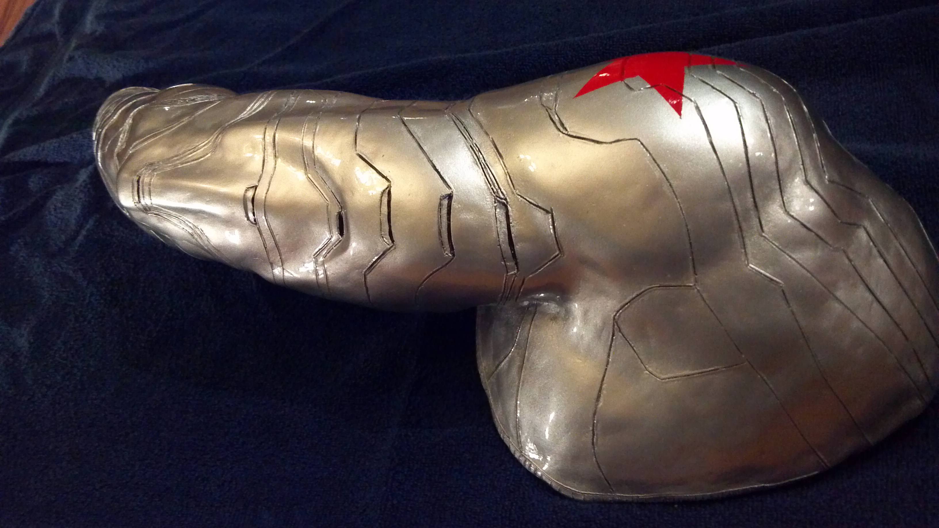

I think the silver metallic with a high gloss clear was the best choice!
Star will be addedon top of clear next week

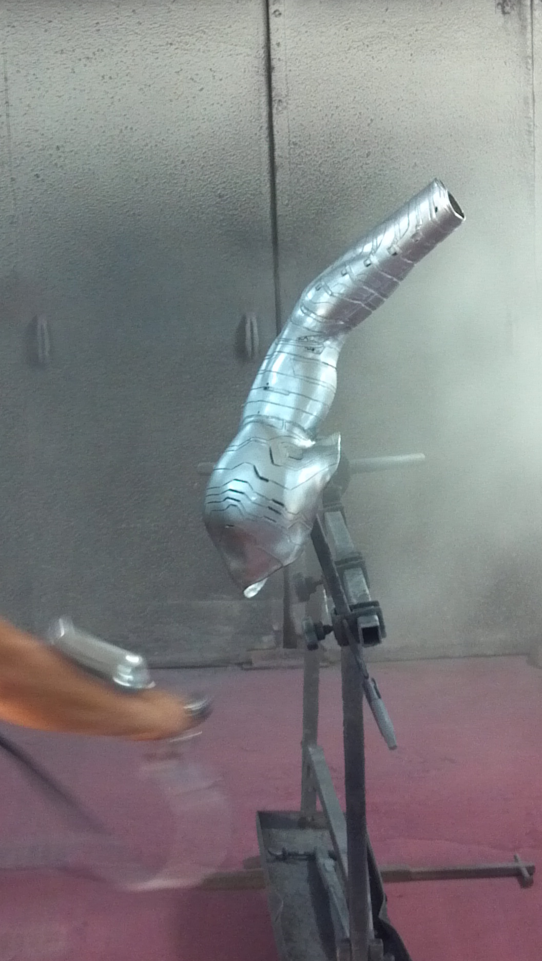

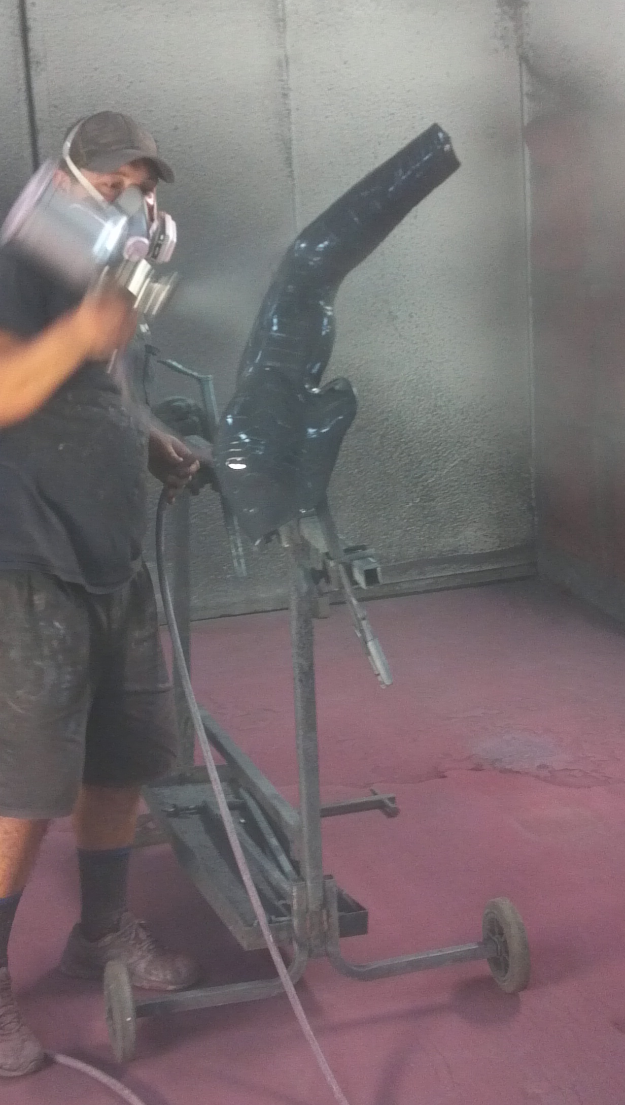

Sealer/Base black:
Silver coats:

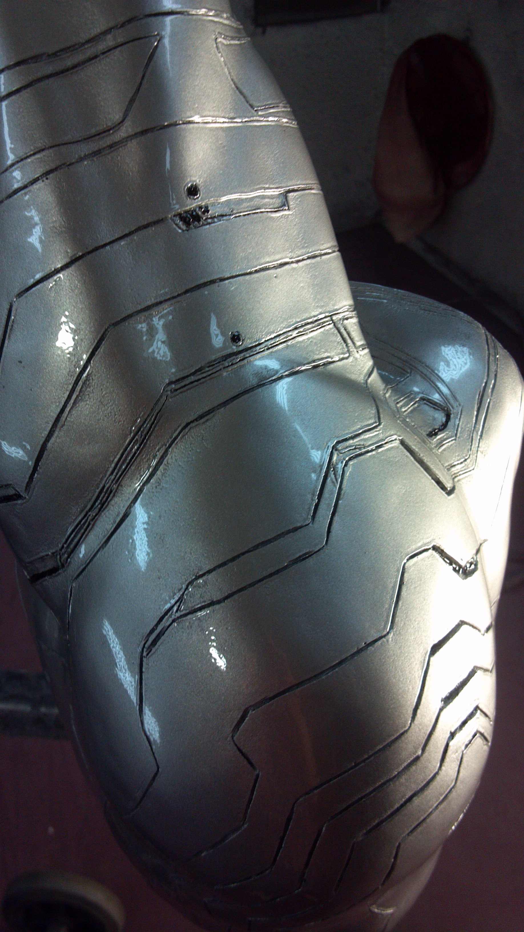

Clear coats:

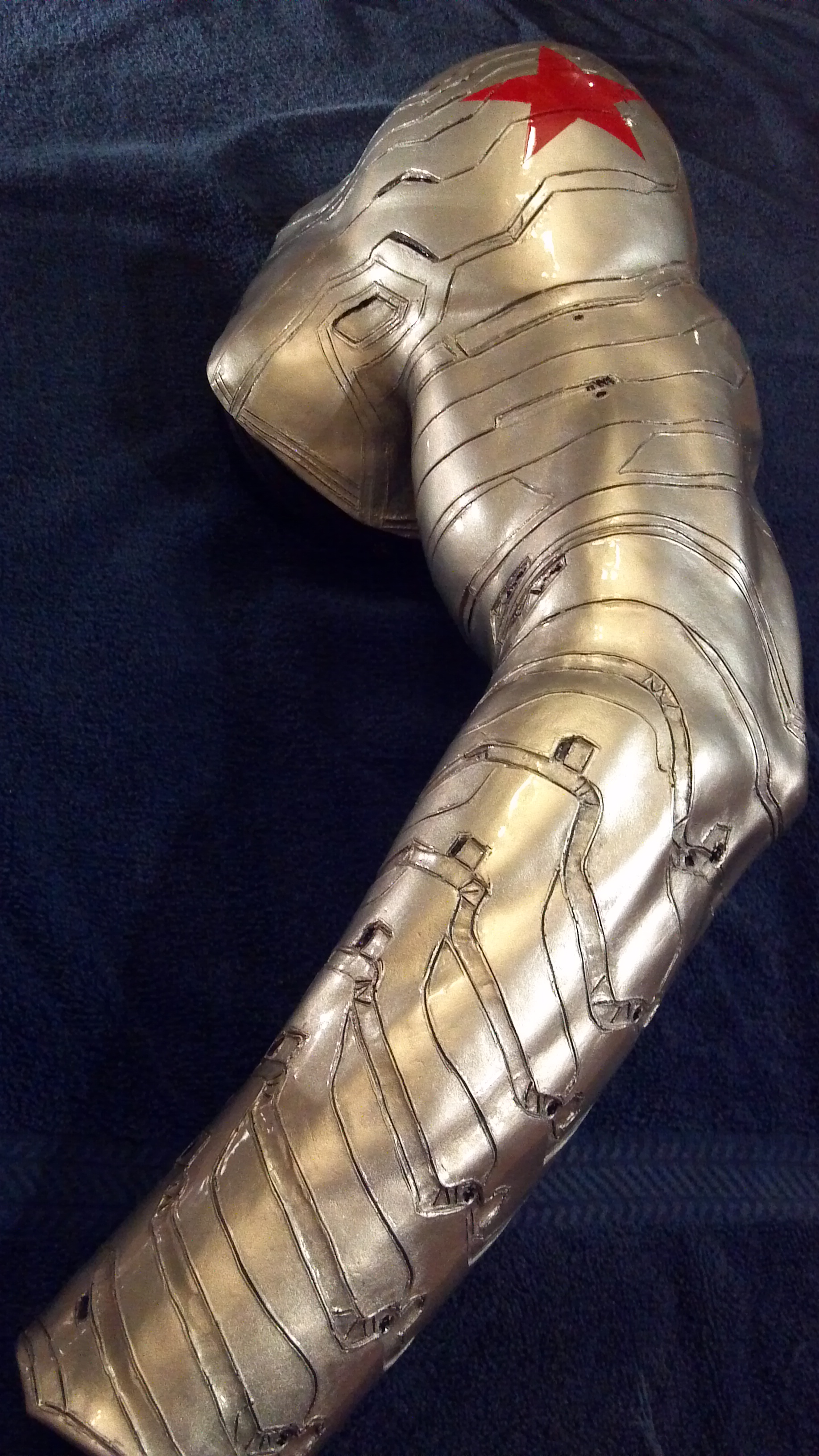

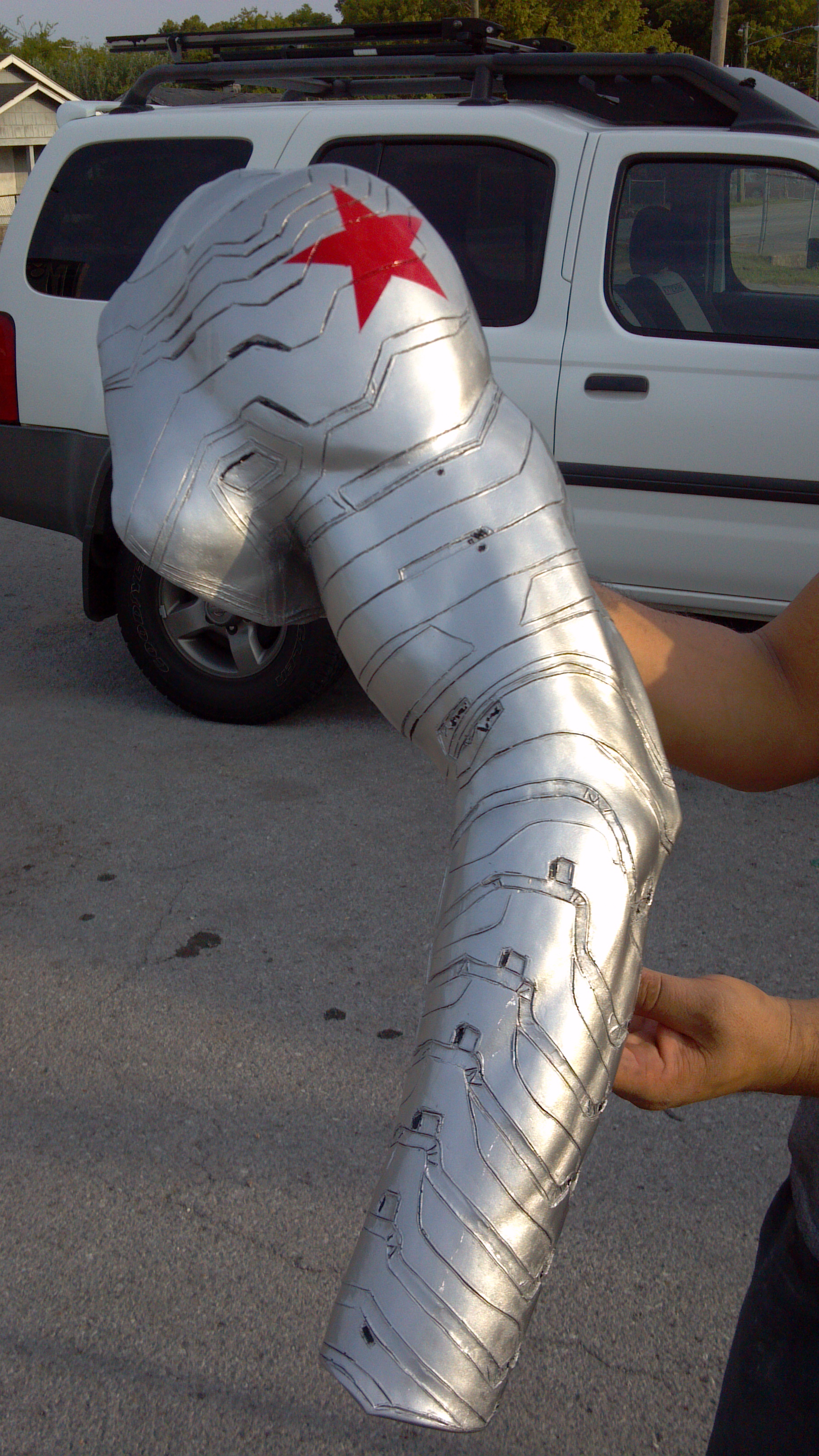

Final minus star:

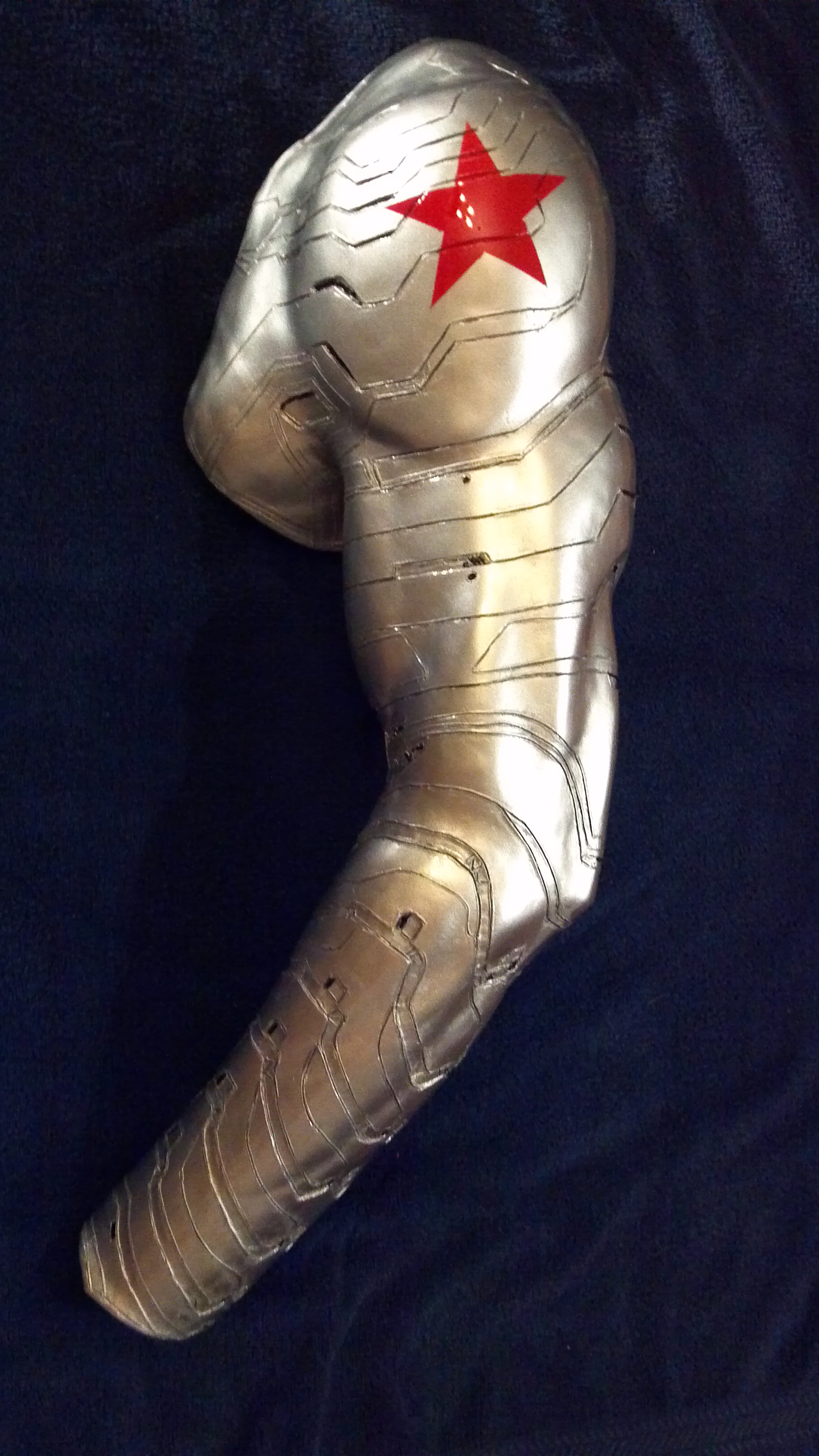

Done (or very very close). The star is on and I am really excited about the way it turned out.

This is the reference I was going for:
2015-07-27_22-10-50_646.jpg2015-07-27_21-34-29_824.jpg2015-07-27_21-38-31_860.jpg2015-07-27_19-07-01_150.jpg

Thanks , I am honestly really, really happy with the way the shiny silver paint with high gloss clear coat came out. Your advice was great and it turned out IMO so good. It is plenty shiny.
I just pulled the second cast to make one that articulates better and think I will keep with the same paint plan.
I really don't want to take the chance of ruining the mold this soon.
