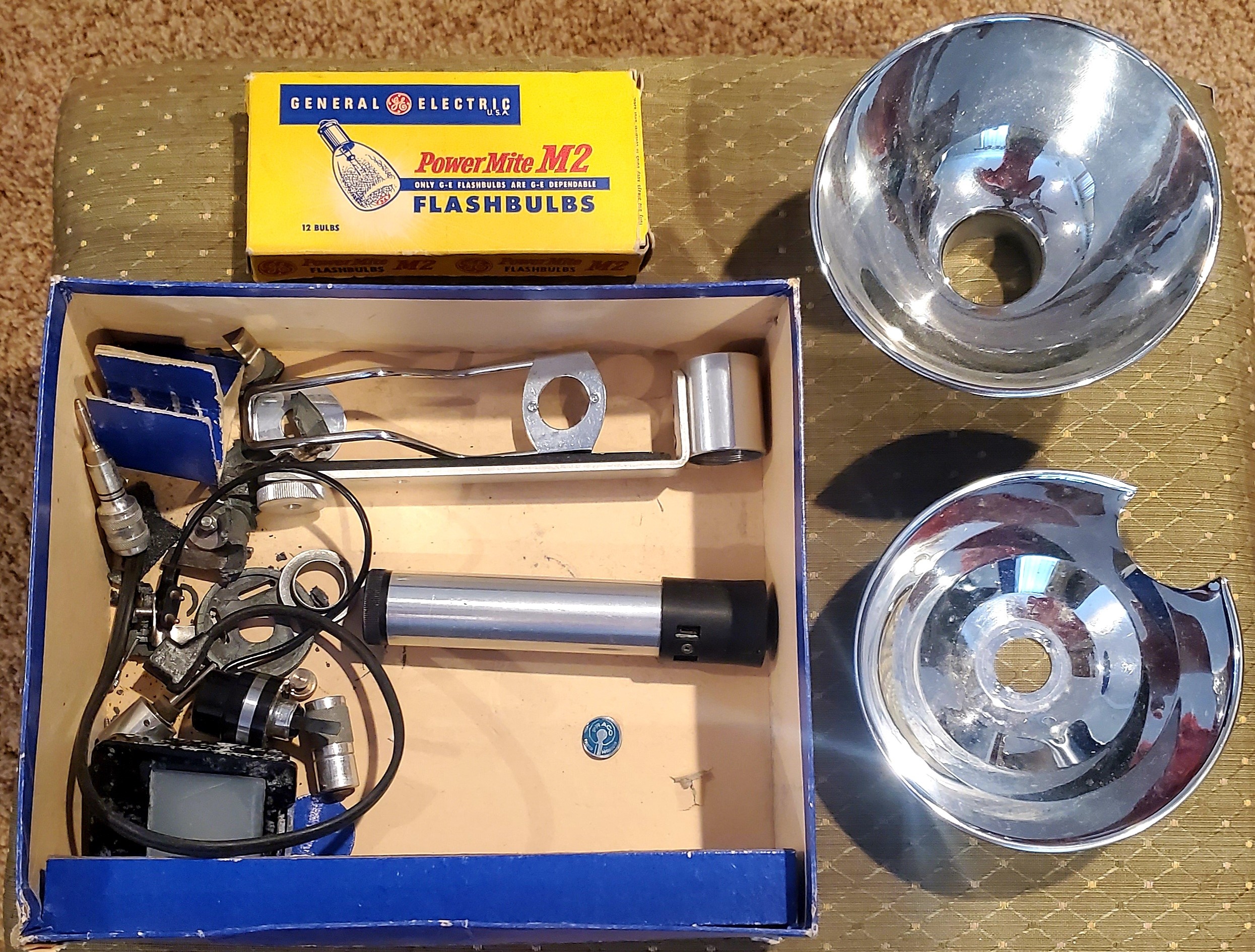

And I'll also take a moment to recognize "the donor:"
Disclaimer: Some donors may be harmed during the making of this replica...

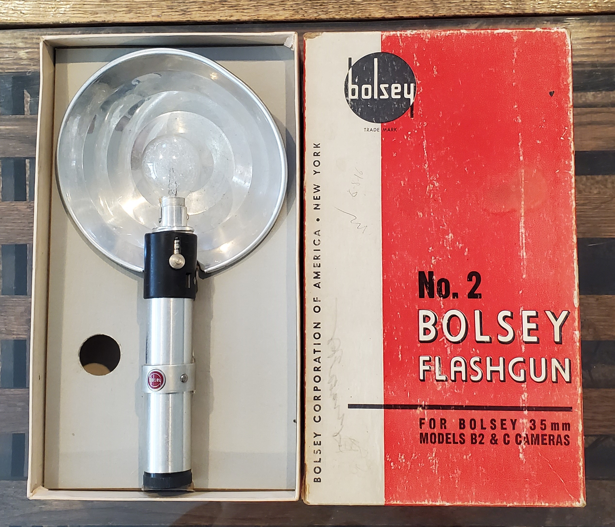

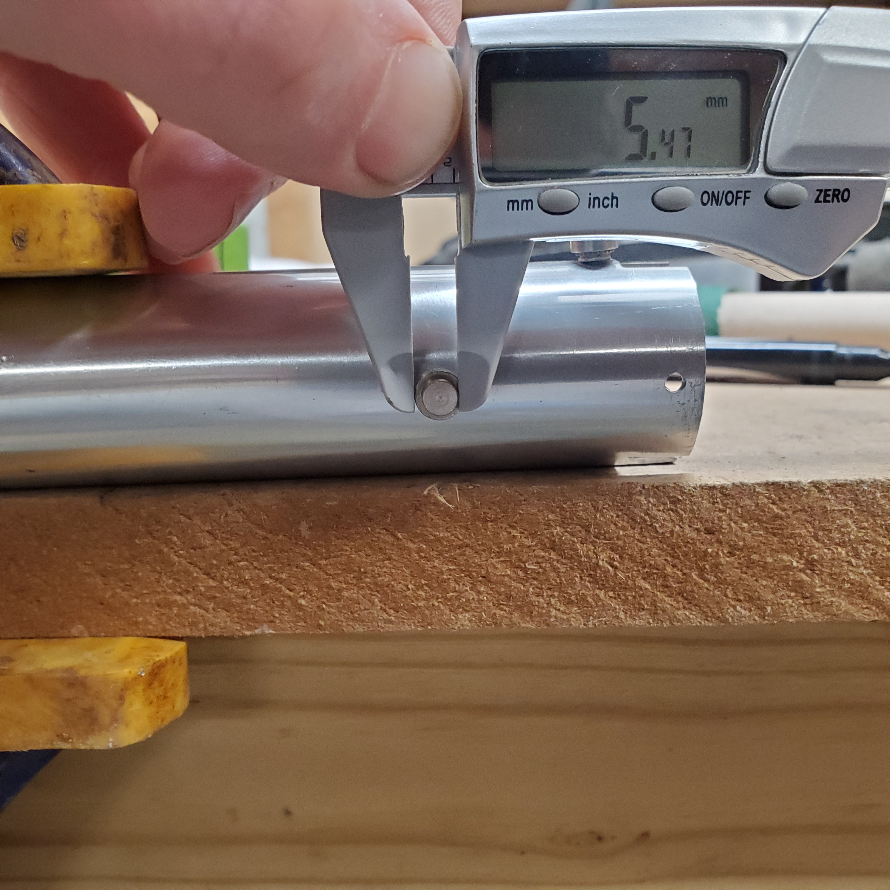

Next, I proceeded with extracting the reflector stud from the Bolsey so that I could transfer it to the Praco. After filing the inside rivet w/ a halfmoon file for a couple of minutes (also a trick picked up from one of the build threads on here) the stud popped loose with ease. I was able to use the measurements from the Bolsey - along with reference images from ed-209's original masterpiece (via page 5 of the VD lightsaber discussion thread as well as the the Visual Dictionary drawing - to layout/drill various holes in the Praco (for the reflector stud, PEM nut stud, etc.). I meant to take lots of pictures of this part but I guess I was so focused on not messing anything up that I forgot to take any others than this one below!

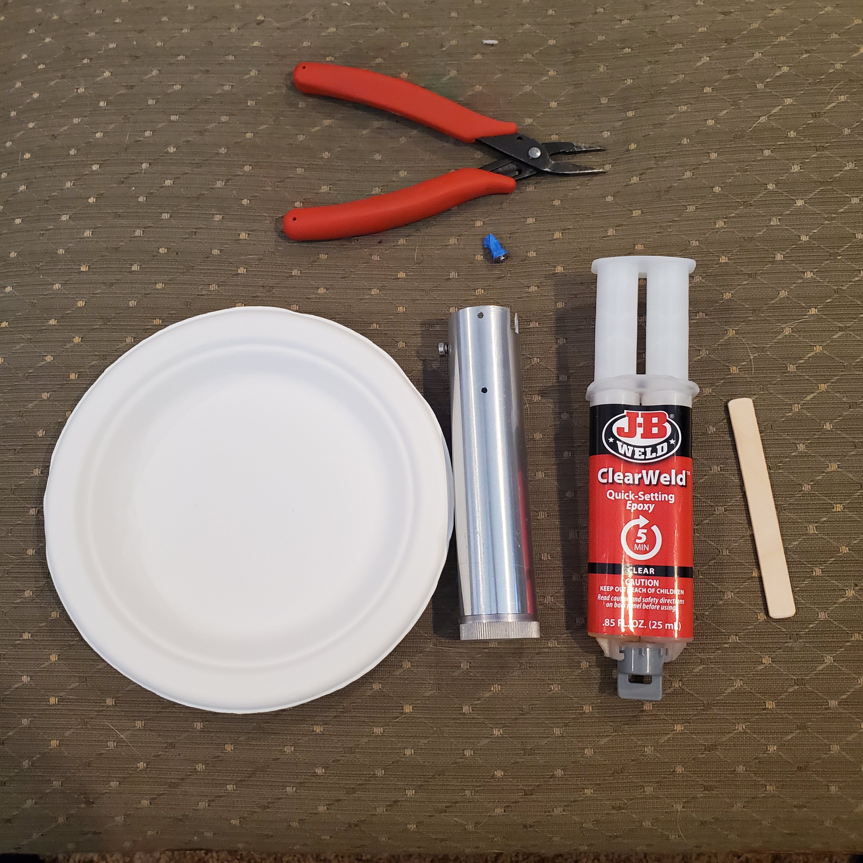

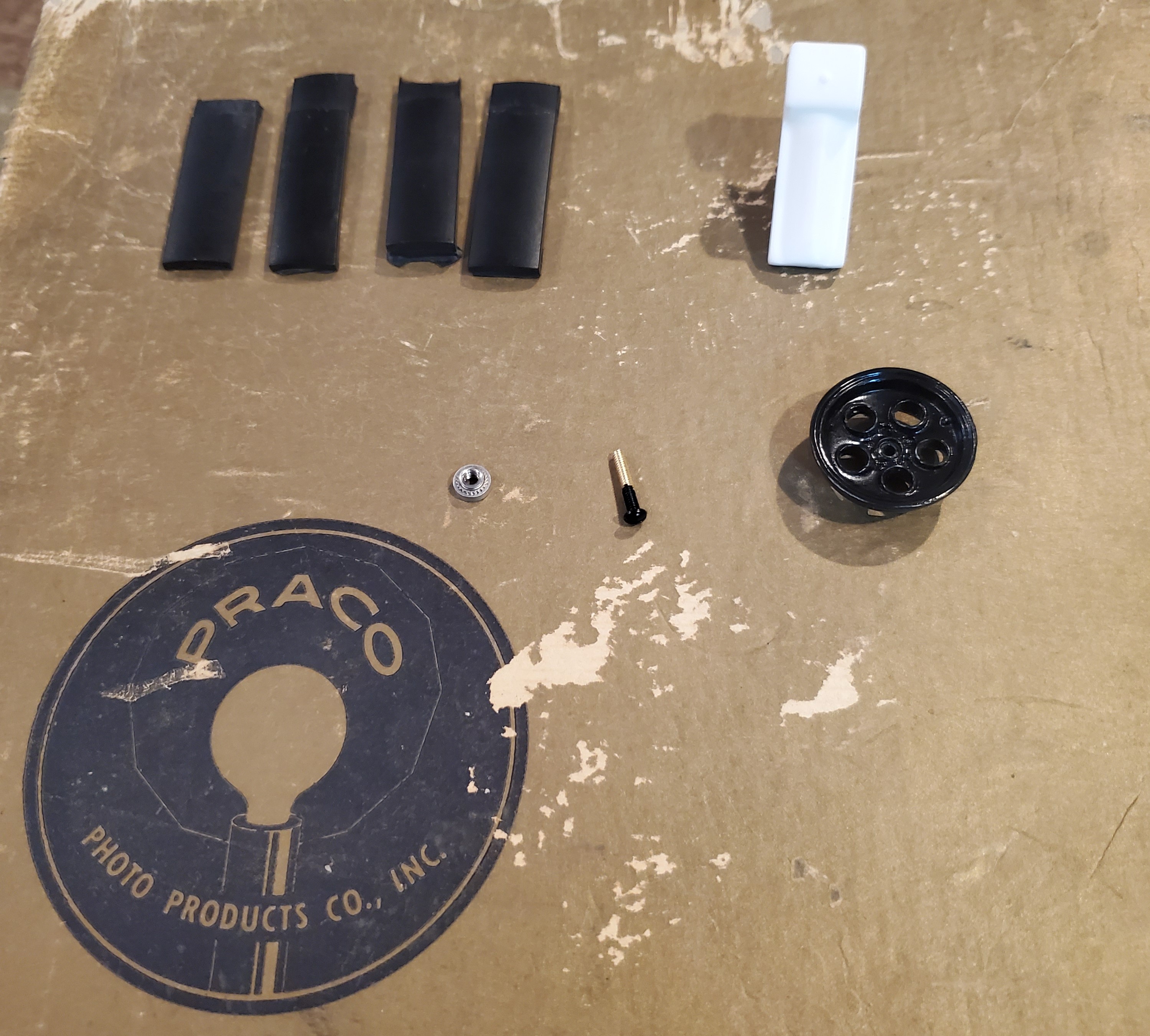

Once my nerves had a day or so to settle down, it was time to mount the PEM nut- & reflector studs. The PEM stud was a little tricky. Mounting it in the factory hole would've positioned the nut a good bit higher than reference images so I had to drill/tap a hole *just below* the factory one. I then cut off a few threads from a 4-40 brass screw I'd picked up from a local hardware store to create my PEM stud. I affixed the stud into the new hole, added a small drop of J-B Weld epoxy to keep it secured and attached my PEM nut to it. I then mounted my reflector stud into the hole I'd drilled previously. Another little dab of epoxy made this part a breeze.

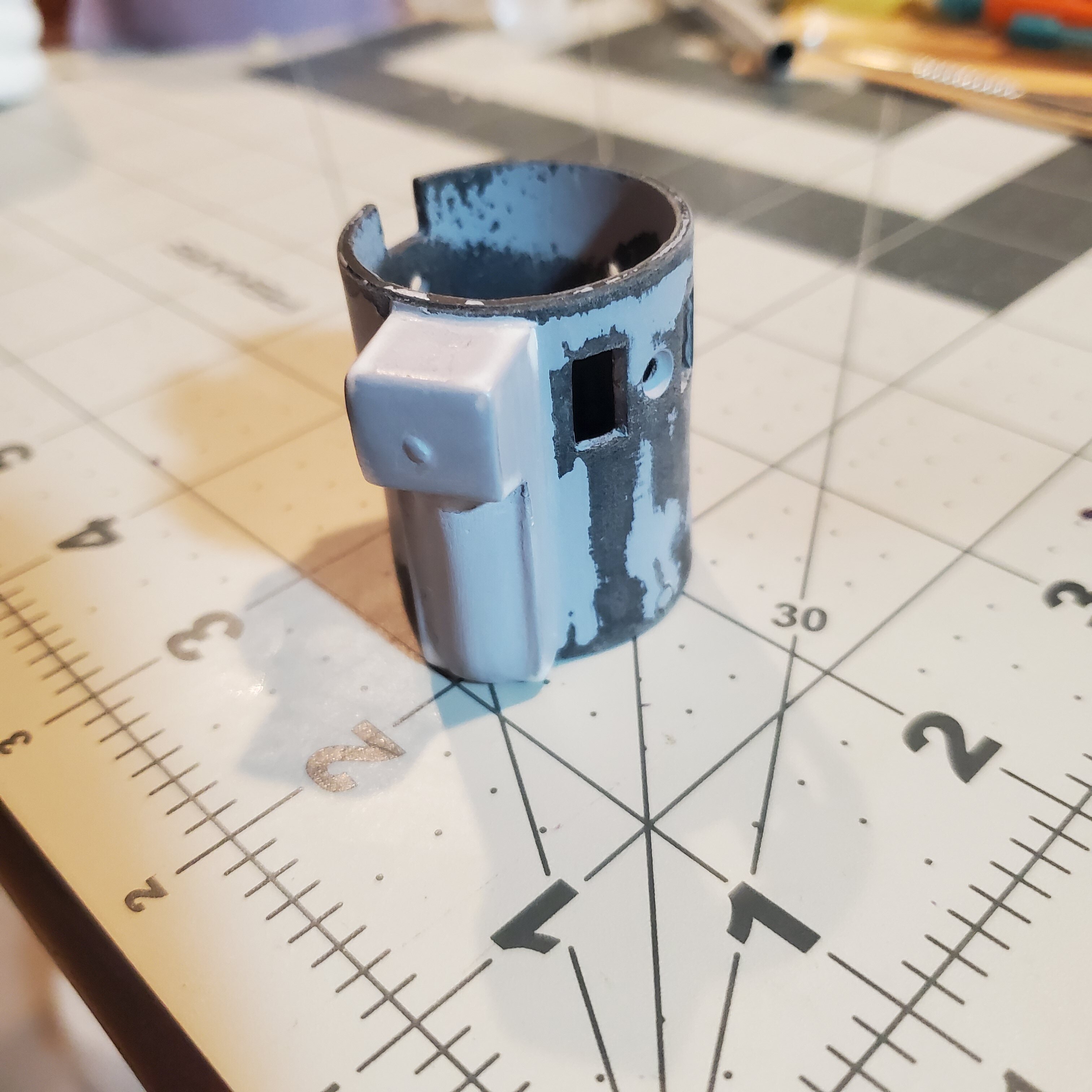

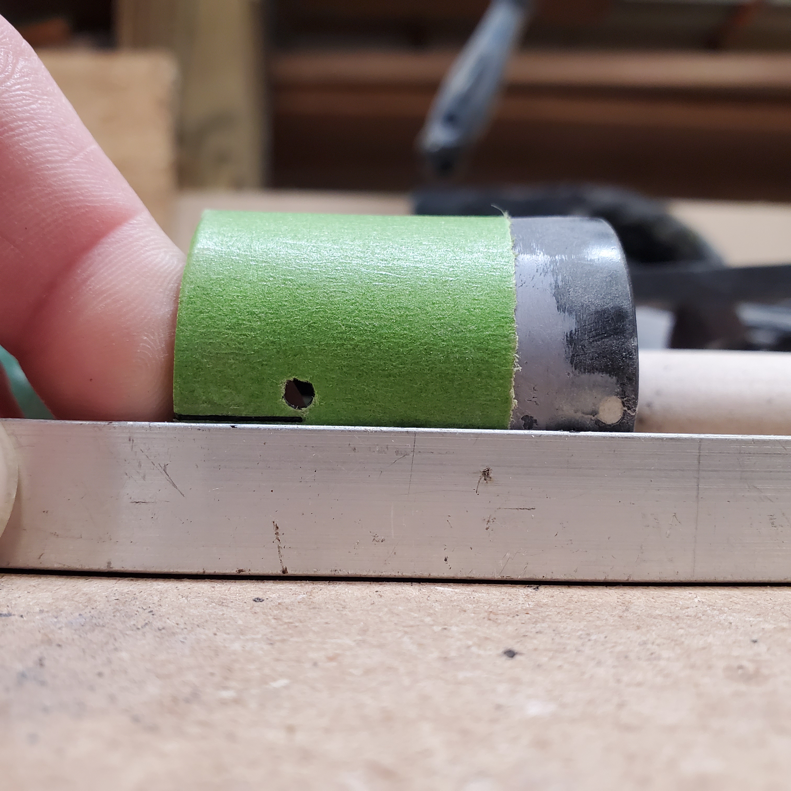

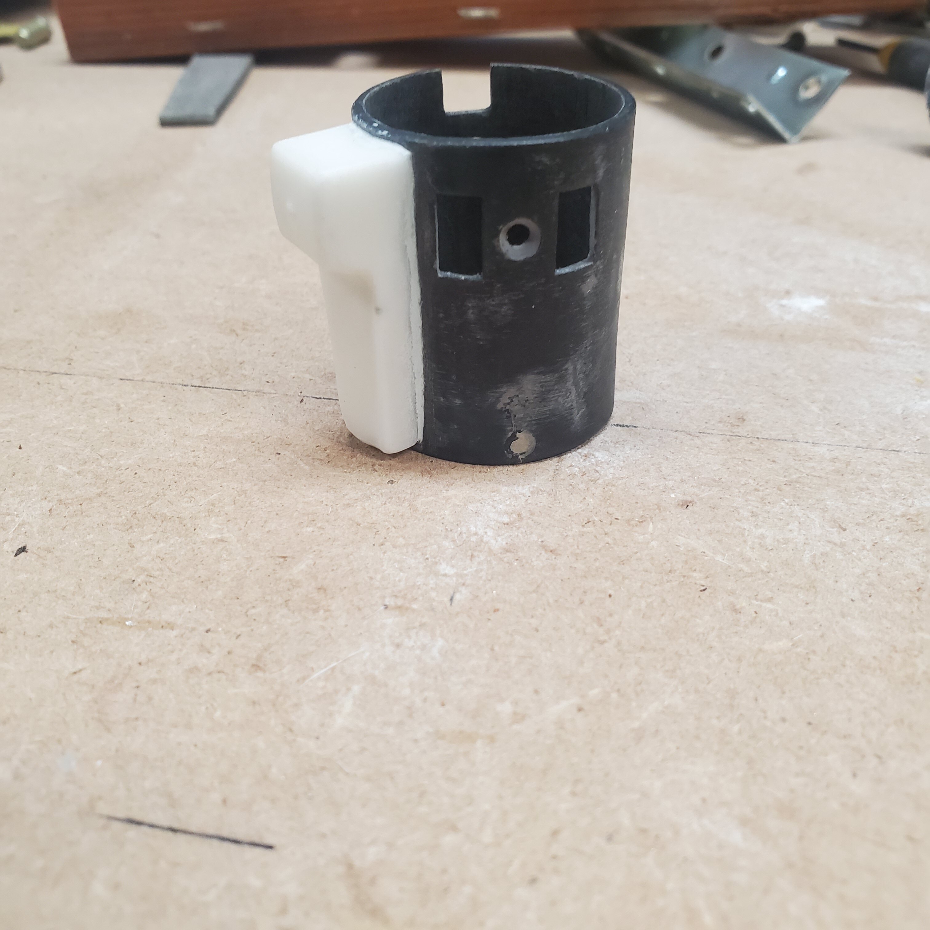

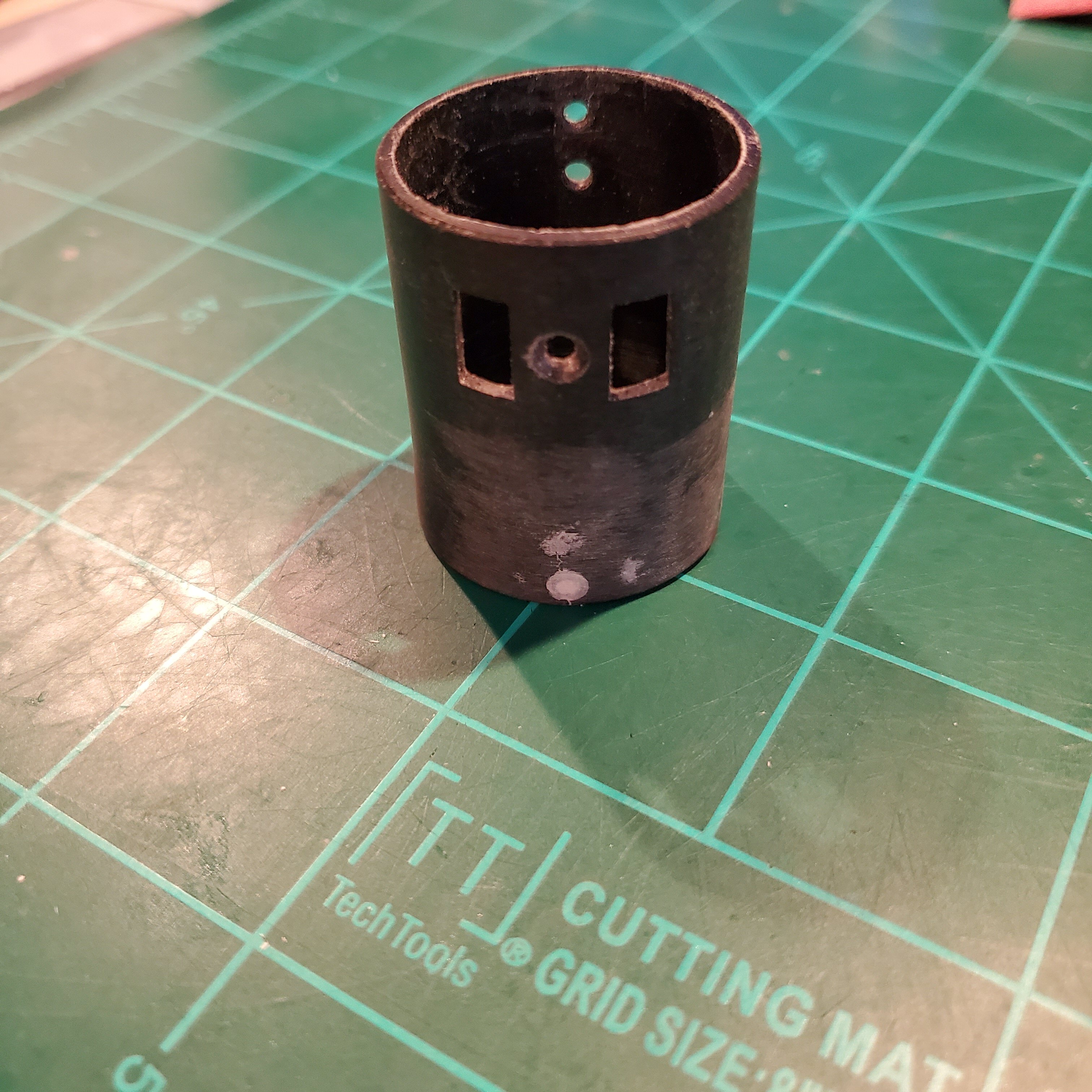

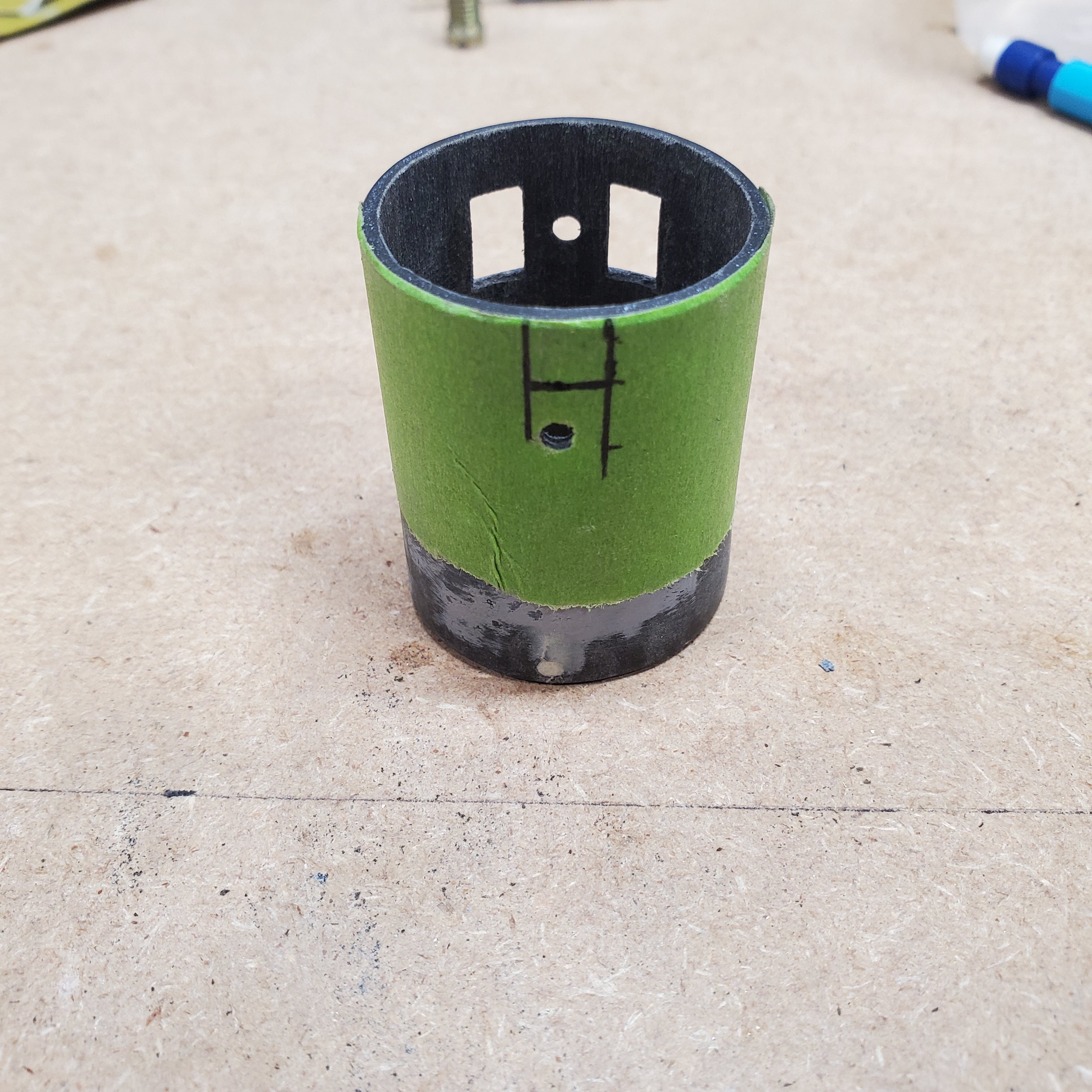

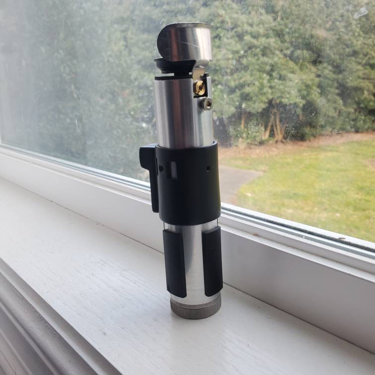

Then, my focus shifted to transforming the flashgun's collar into the lightsaber's center band. I began by puttying-up the extra holes found on the "C" model and then laying out my cut lines. I used a combination of a Dremel cutoff wheel and pin files to get the fit I wanted...
...Which then allowed me to position & mount the oil pan/control box!
As of this moment, the center band is still in primer but we're steadily-and-surely getting there...

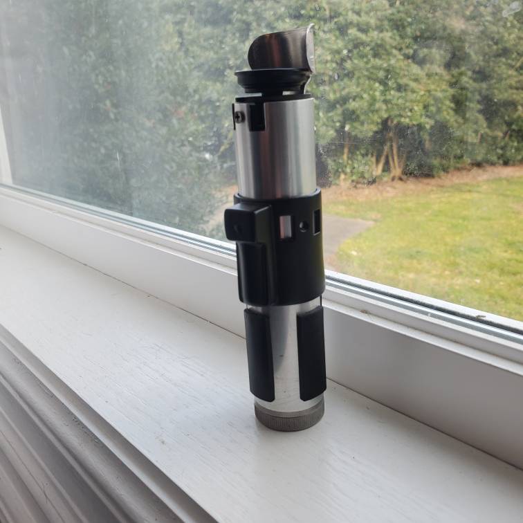

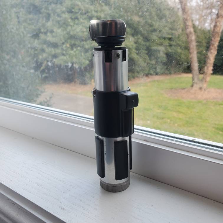

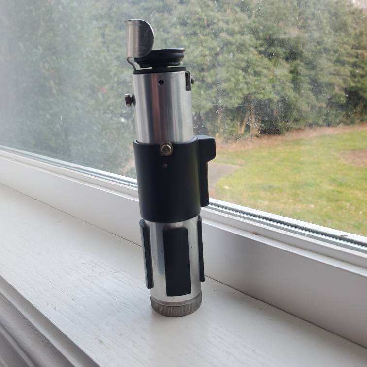

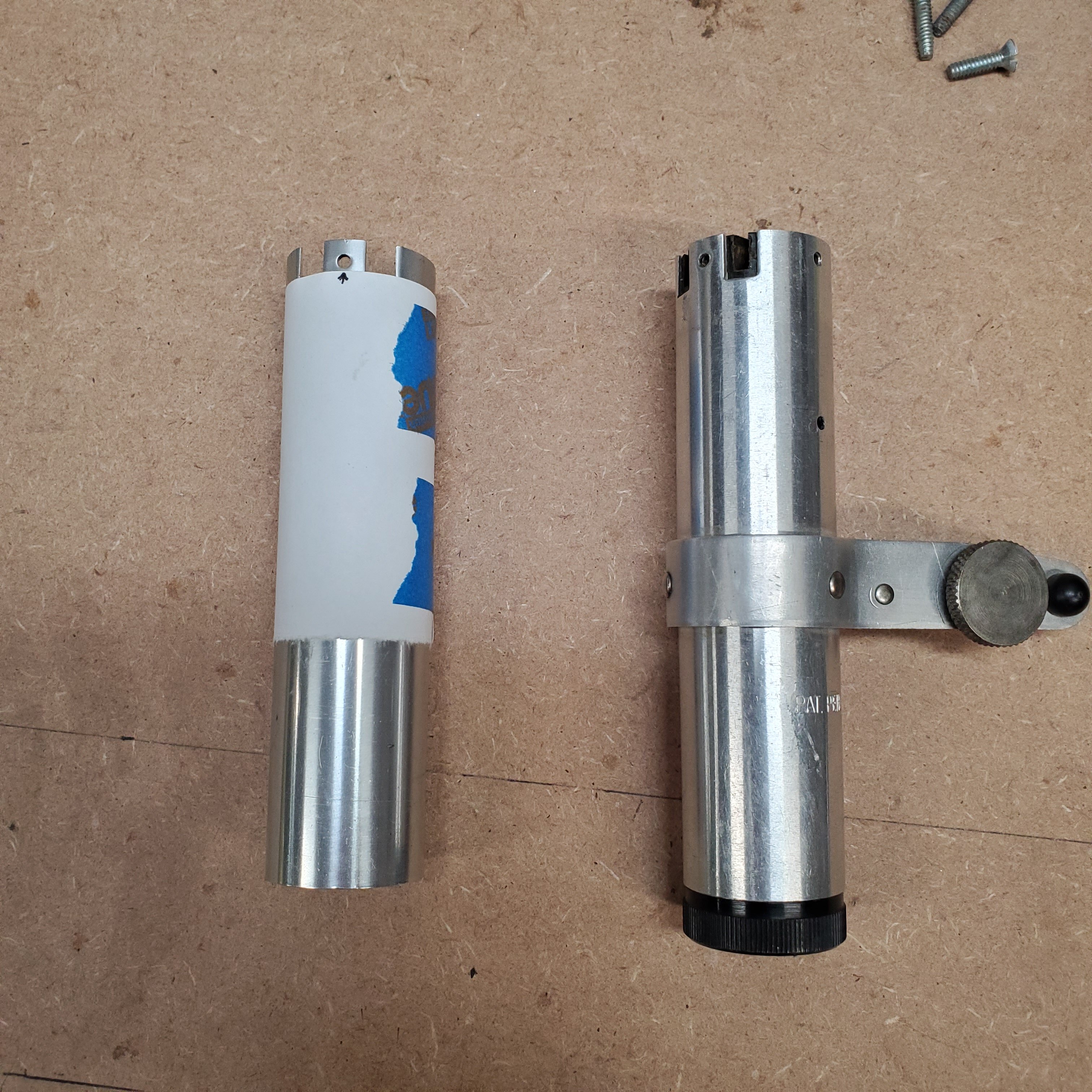

Wow! Thank you so very much, ed-209 . It's an honor to have your blessings upon this endeavor. With that said, here is the finished product!!
The Ninja - Seriously, thank you so very much for the opportunity to re-create this amazing piece using an authentic Praco base. I can only hope that my craftsmanship is found sufficient in the transformation of this little vintage camera flash into its full potential of an authentic VD Yoda Lightsaber!!!
Welcome buddy the build looks awesome you did an amazing job bring all the parts together, congrats (y)
Nicely done! The Force was strong with you!

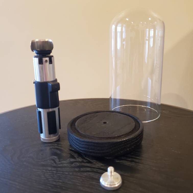

Wicked job!! Came out great! Love the display case
Thank you very much, Halliwax! It was a really fun project for sure!

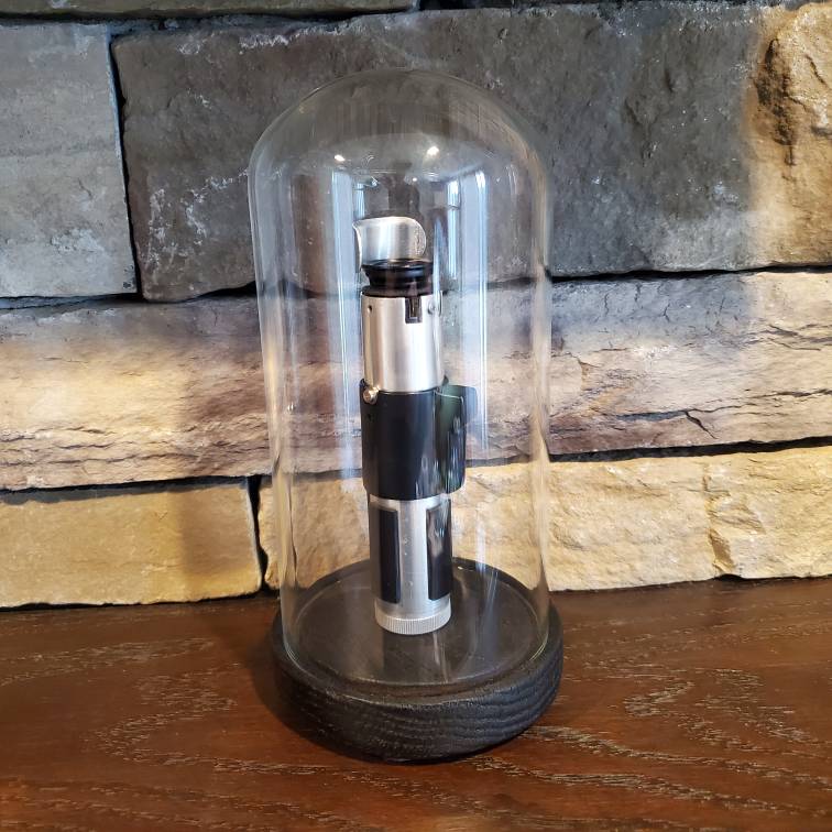

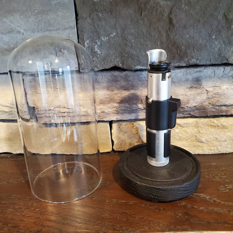

As for the display case, the glsss top was acquired from Hobby Lobby. I originally purchased a base from there too but I ended up opting for my own version using a 1" thick oak board from my shop. After drilling, routing and a quick sanding, I used a handheld torch to burn/char the wood, aka "Shou Sugi Ban" I believe. Although not technically required, I then applied a couple of coats of tung oil to seal the ash. The threaded knob piece that I used to secure the lightsaber to the base was originally from a Kalart flash. Perhaps one day I'll convert it to a rotating base, but it'll do for now. =)

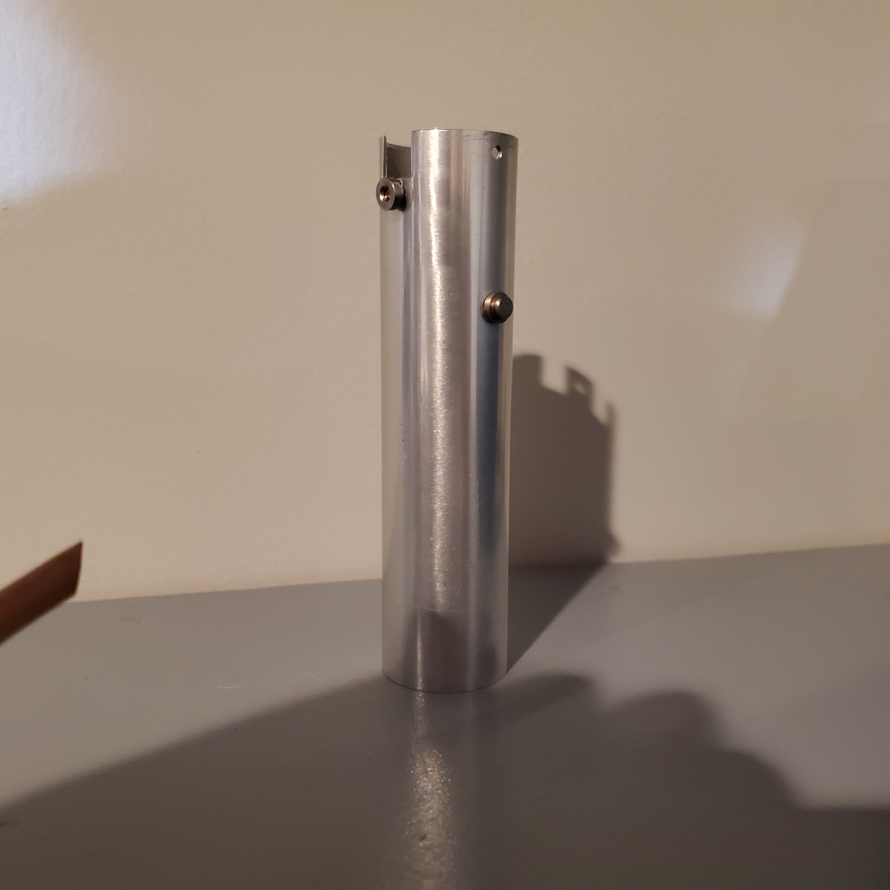

This is awesome! I recently made a left handed one out of a bolsey (i approximated the oil pan but it looks like I'm not too far off!) and made my own lambo wheel from drawings I found around, and was working on making a praco version using aluminum tube.
I have a question though.. There's mention of a "reflector nut" What is this? where is it on the Bolsey?
Unfortunately, it is not included on the Bolsey. It is a slotted brass nut that was provided from factory on the Praco, but must be acquired from another source (either from a different flash of the same era or can be made). You can see it in pictures above just where the reflector attaches to the flash body.
