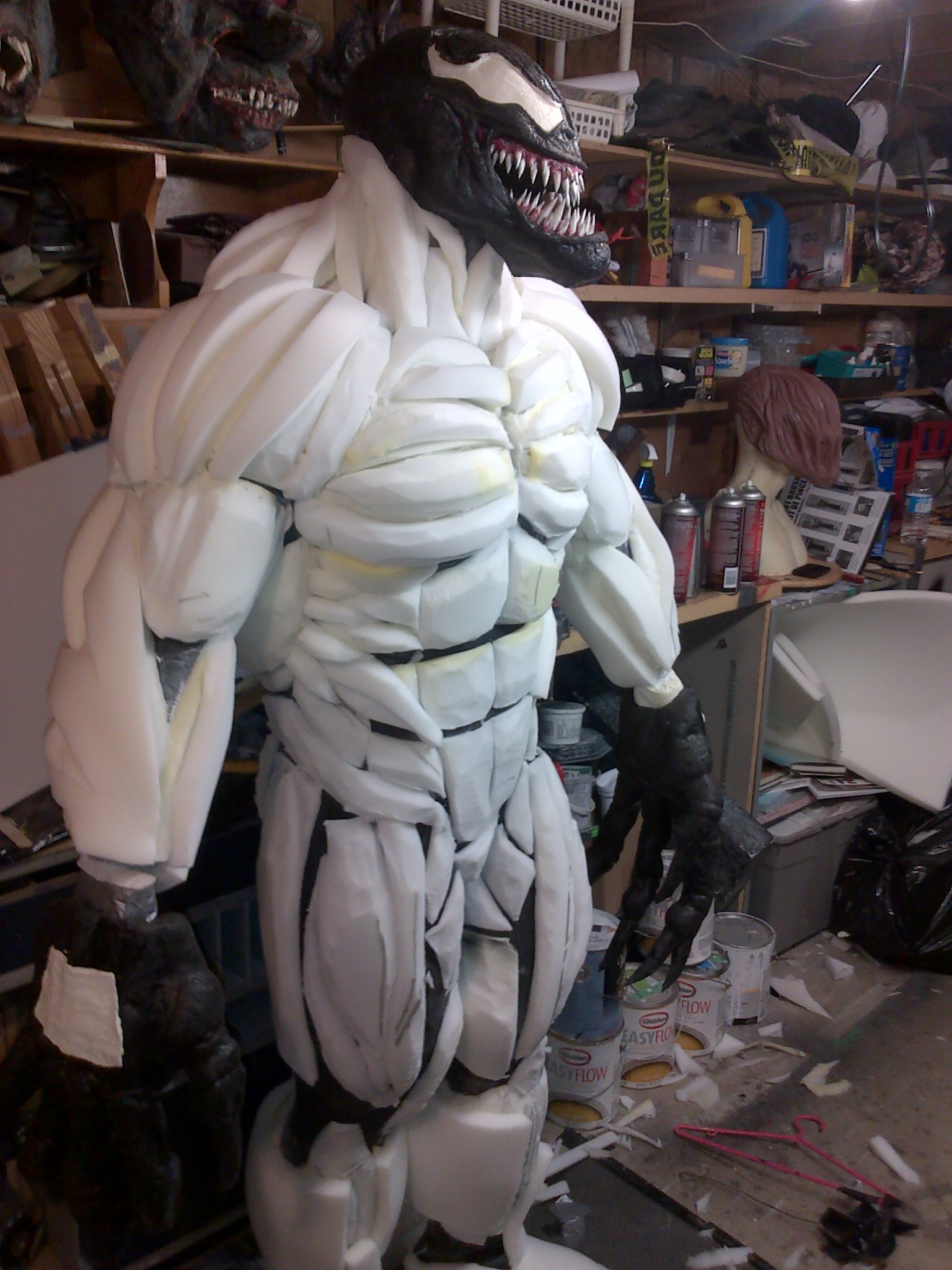

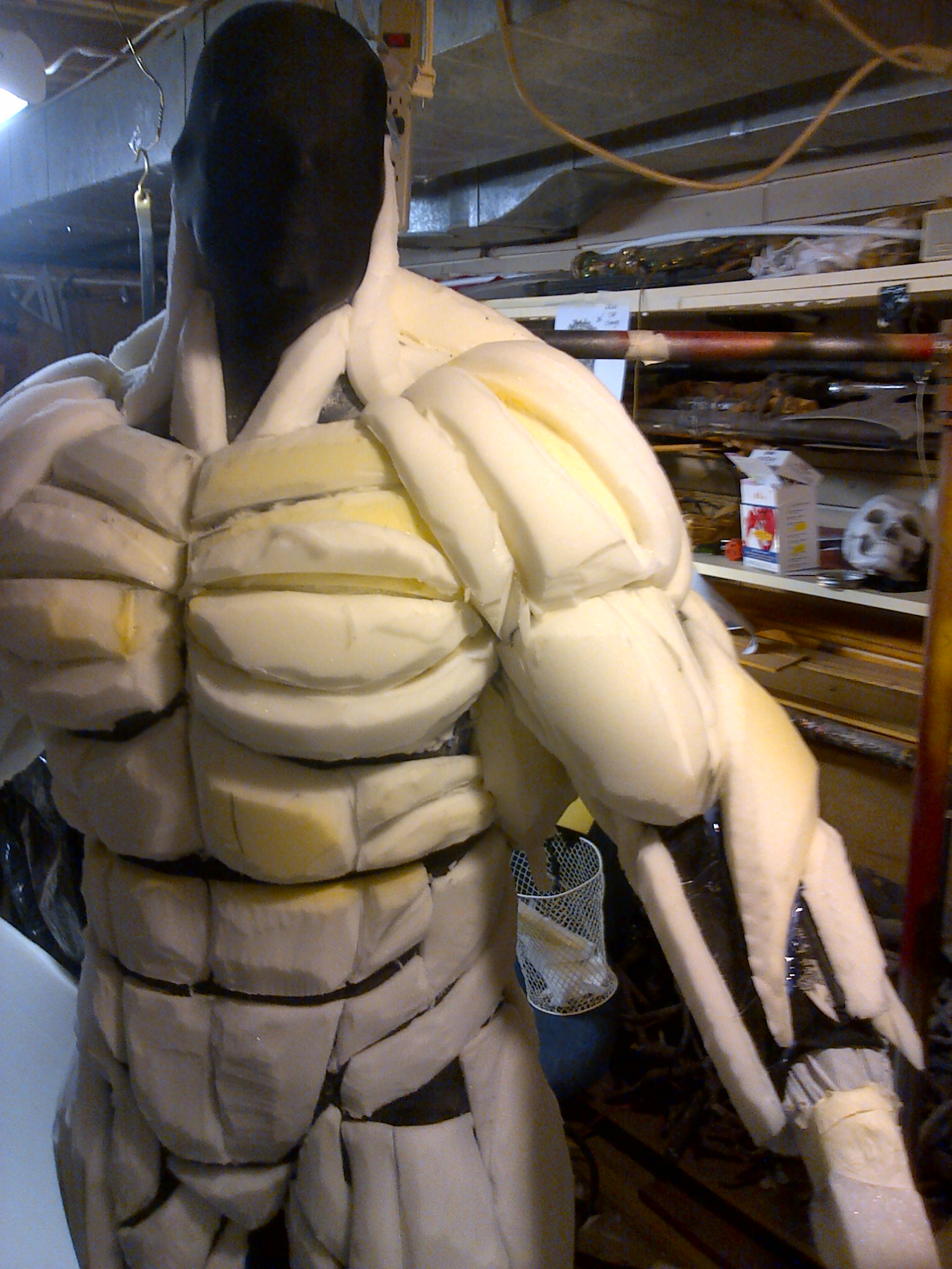

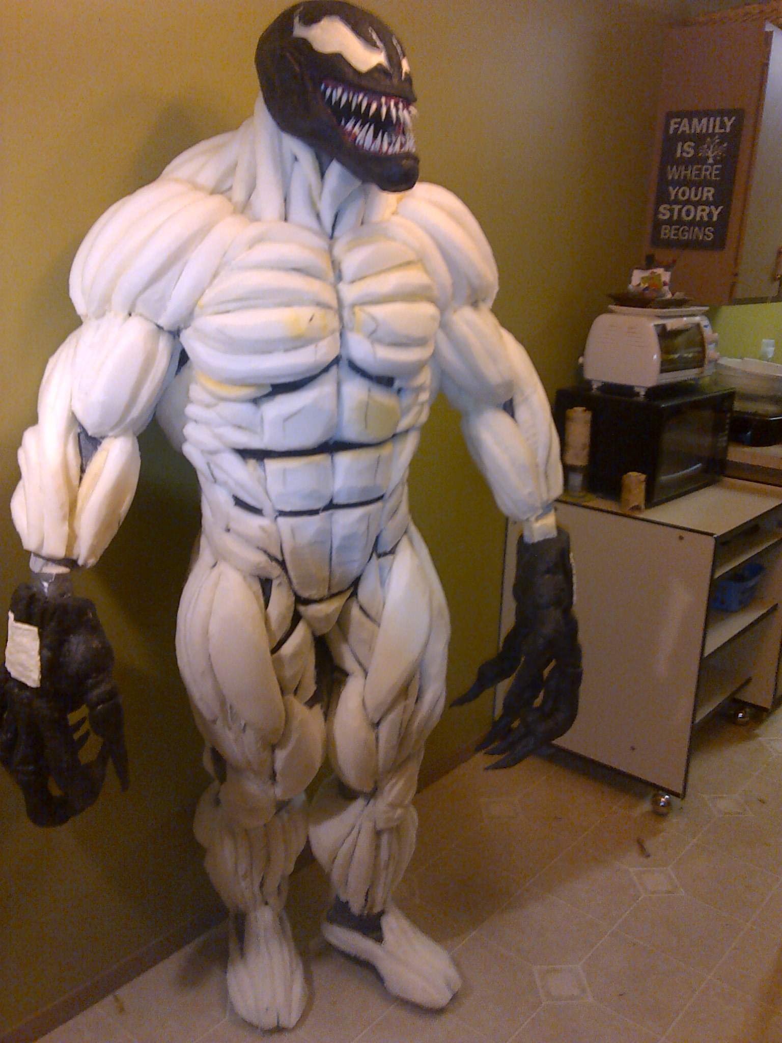

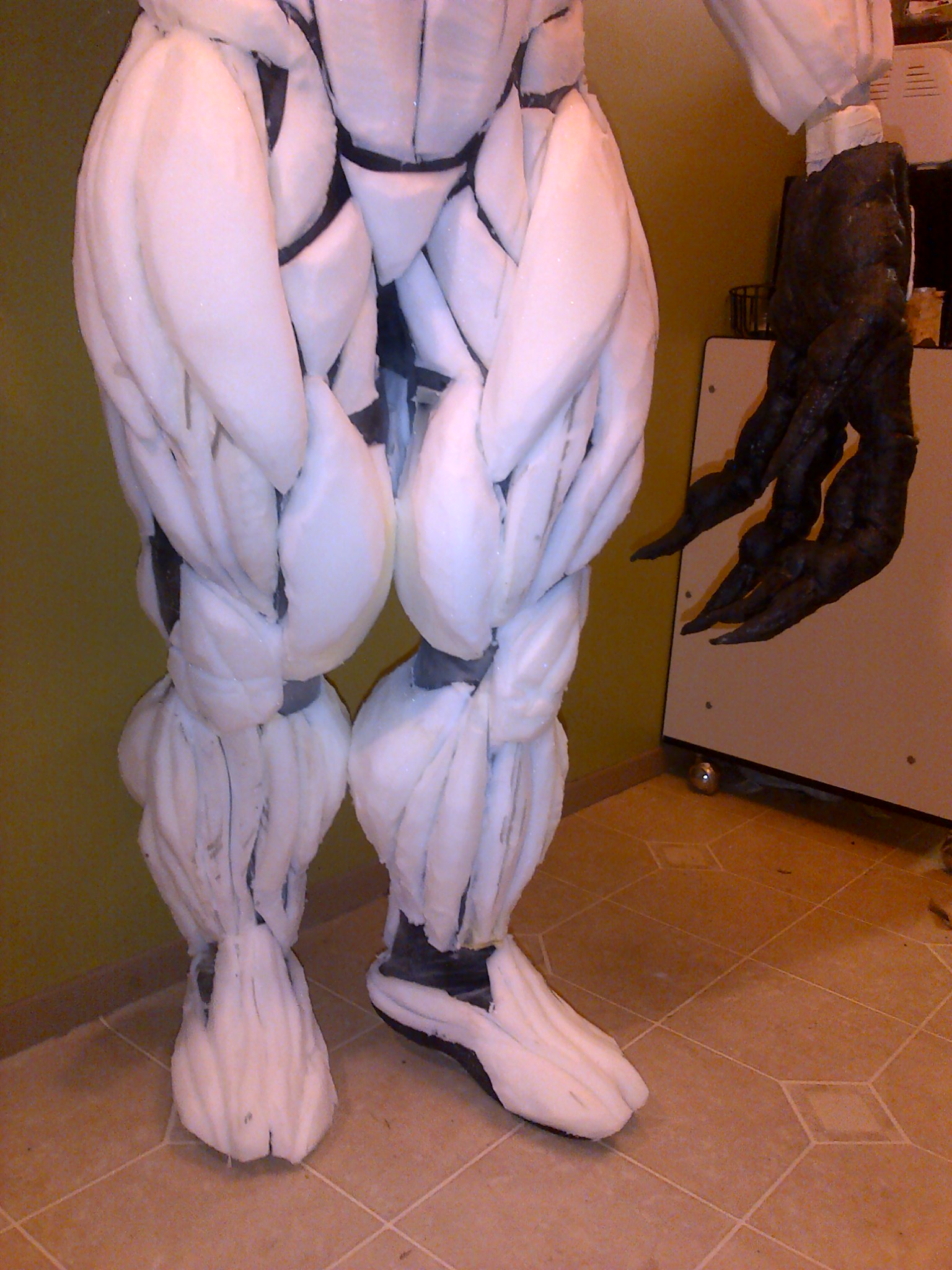

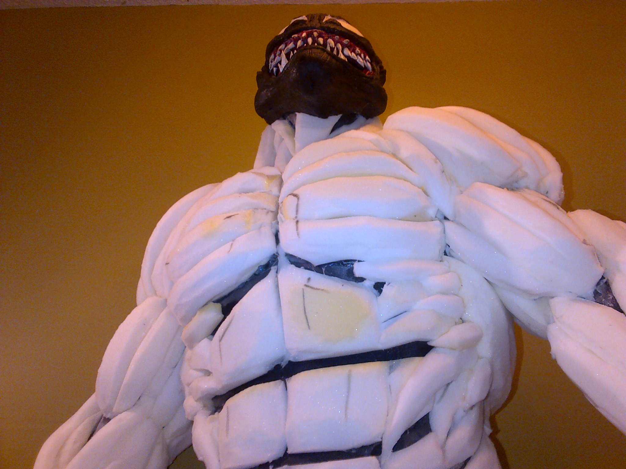

essentially the body suit is sculpted from regular cushion foam i got from fabric-land here in Canada spray glued to a lycra suit . i build up foam in laminated layers 1-2 inch foam then sculpt back details.
the mask is sculpted in clay and cast in smooth-on flexfoam III then all painted with latex tinted with latex tint and paint. both carnage and this venom will be built the same.

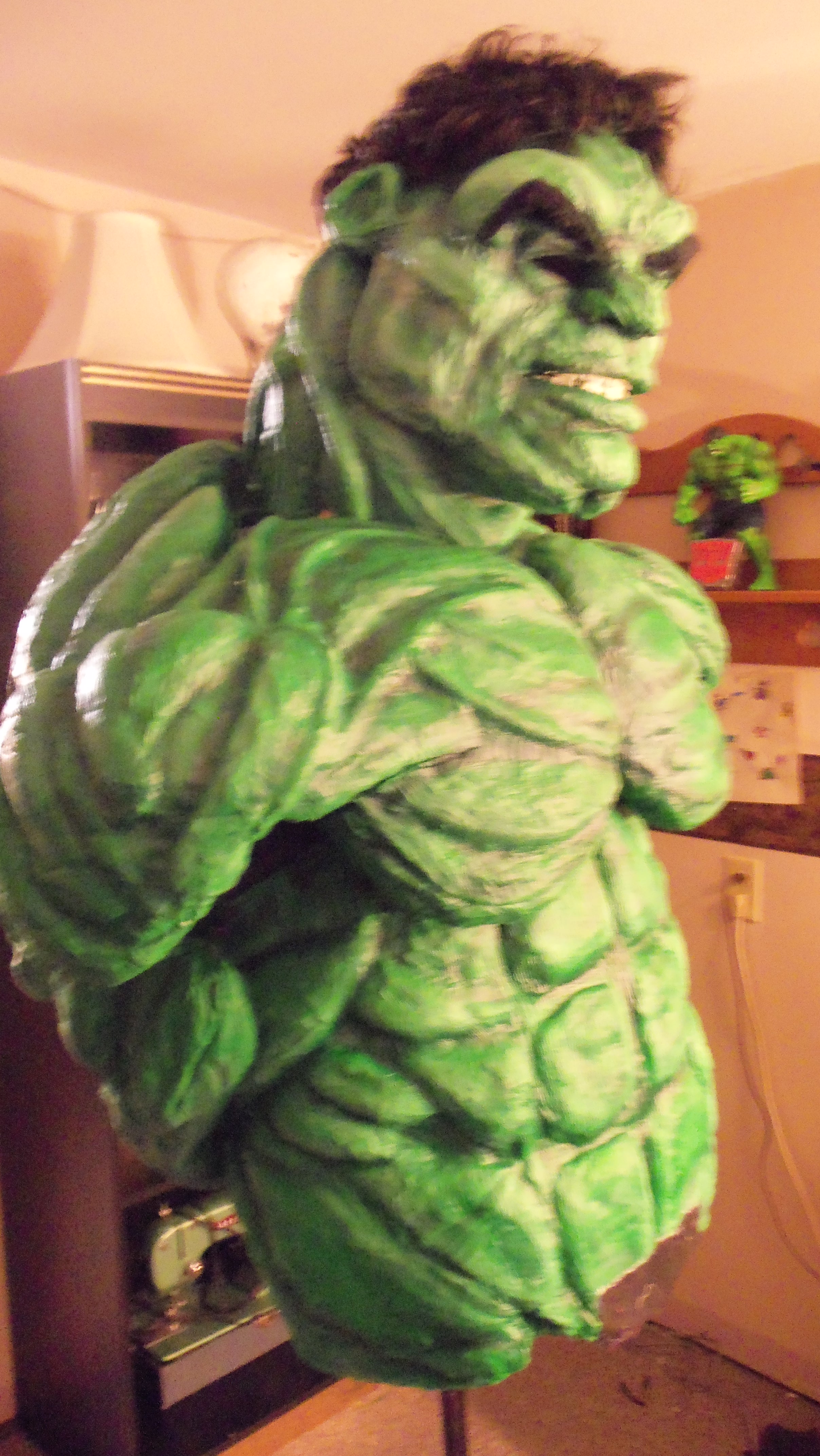

both venom and carnage i tinted latex with acylic paint, and latex tint(great stuff and concentrated for 10.00 / 4oz. ) makes tough skin that wont peel. i brushed the main colors and detail but ill airbrush acrylics last for fine detail. did that with hulk and worked out great . the hulk is a few years old but the paint is still going strong. but i strongly advice you use latex till you get to that point(last highlights etc) you can airbrush latex but i havent tried it yet for fear of jamming up my gear but there is a way.
here is a piece of hulk that t brushed three shades of green (rule of 3,lol) the airbrushed detail. my pics suck but you get the idea

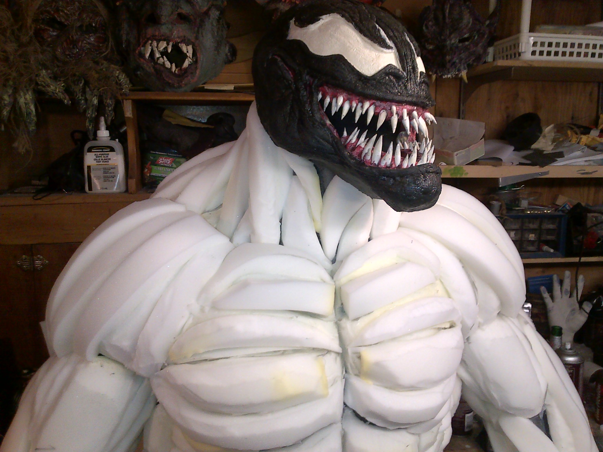

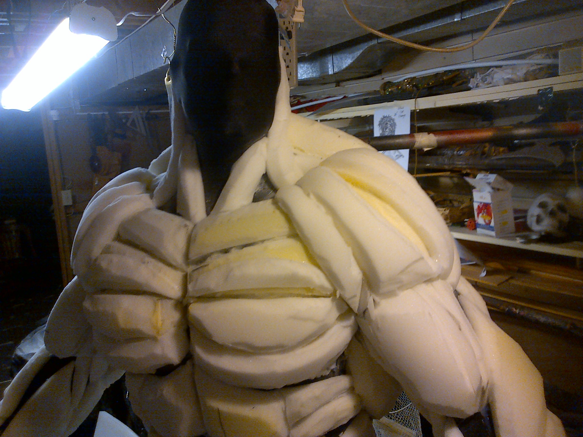

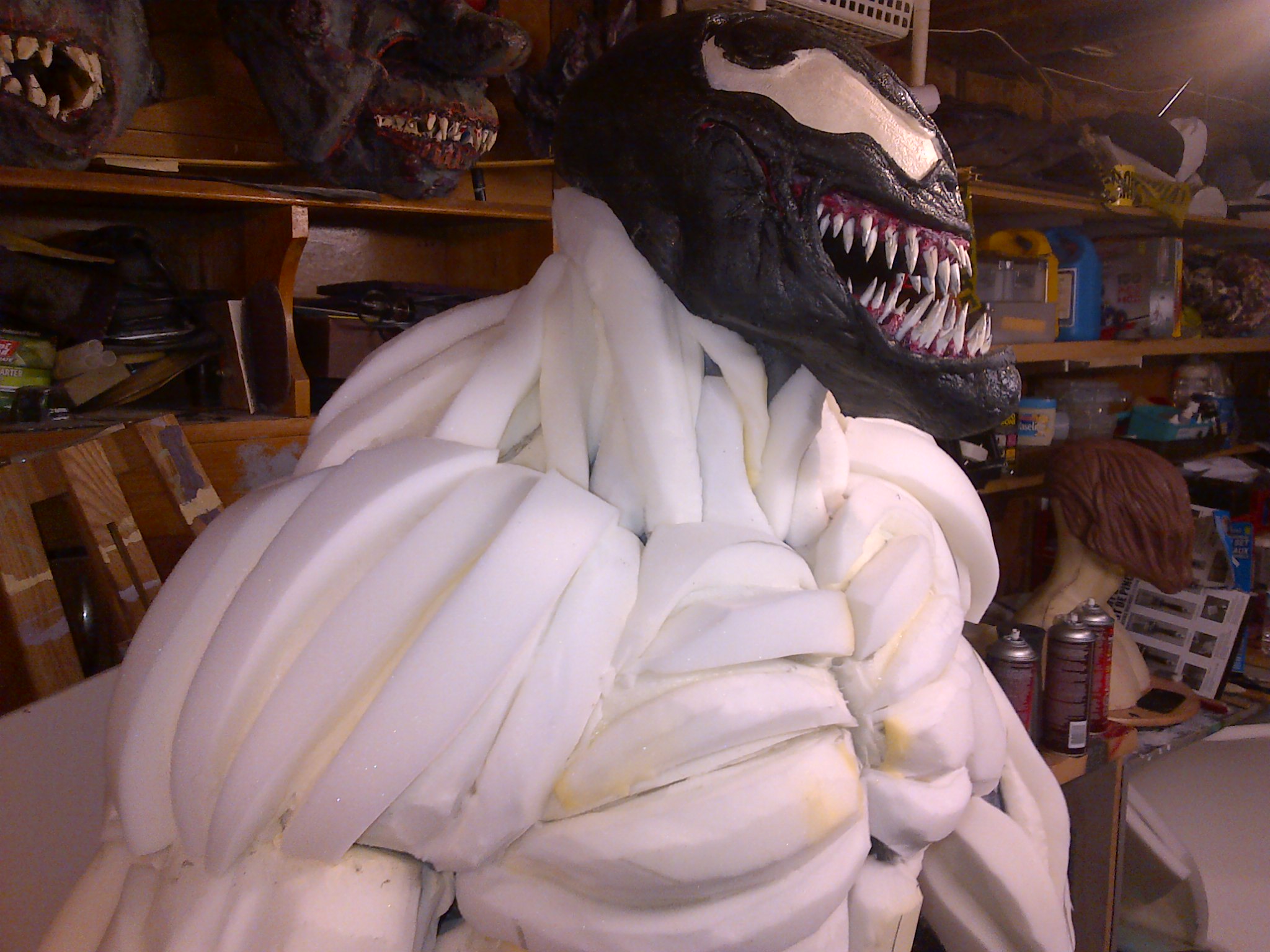

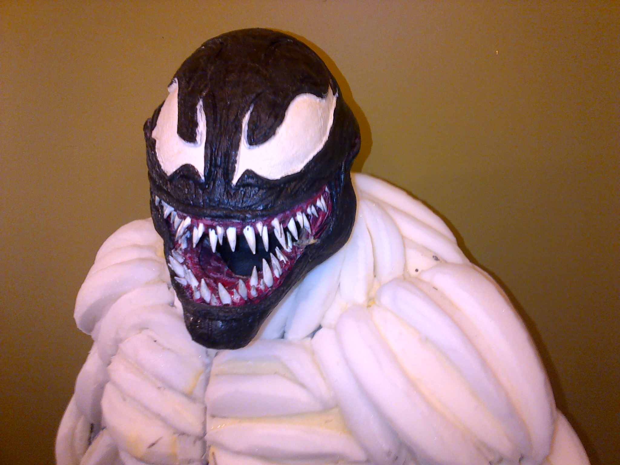

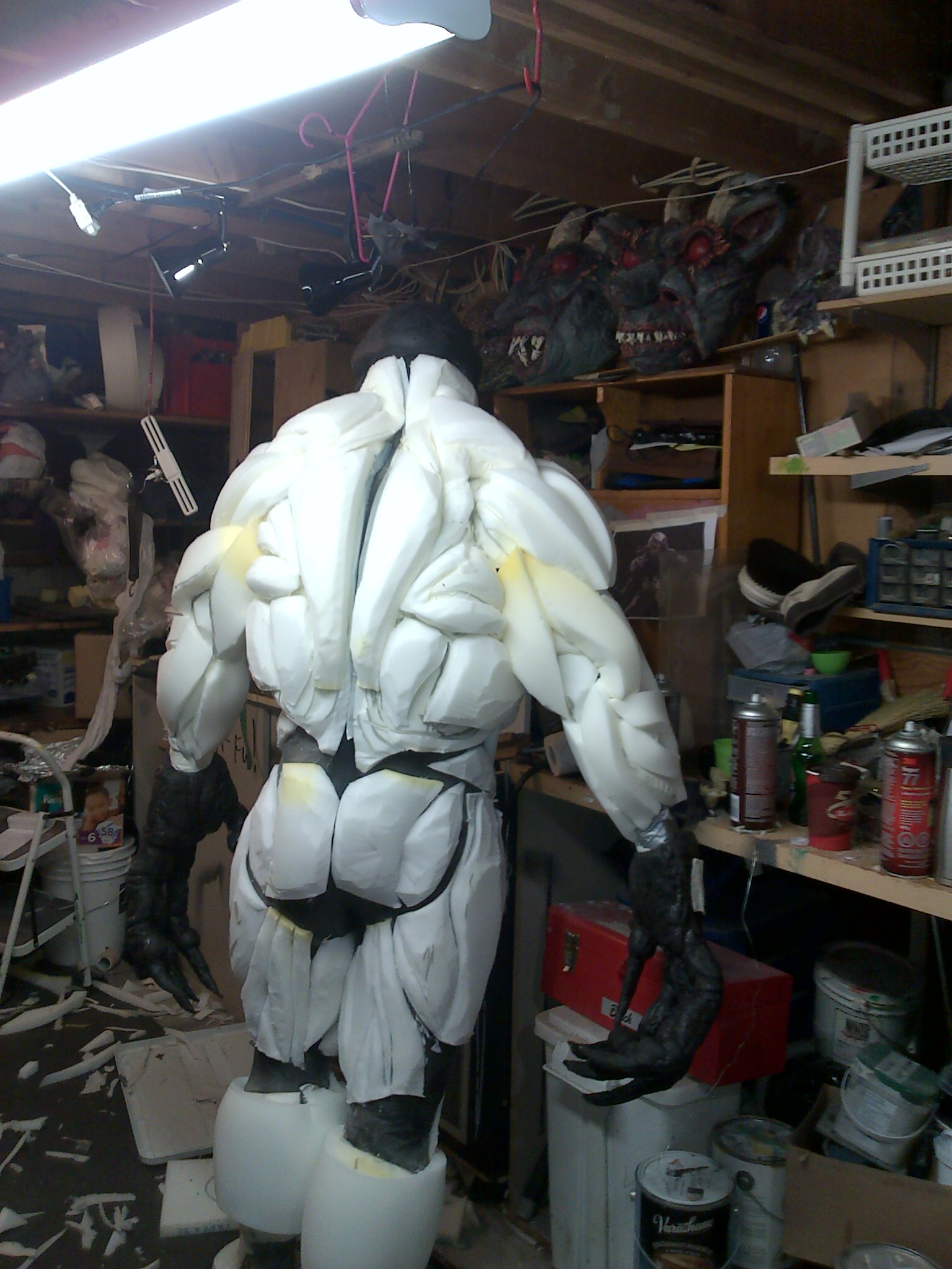

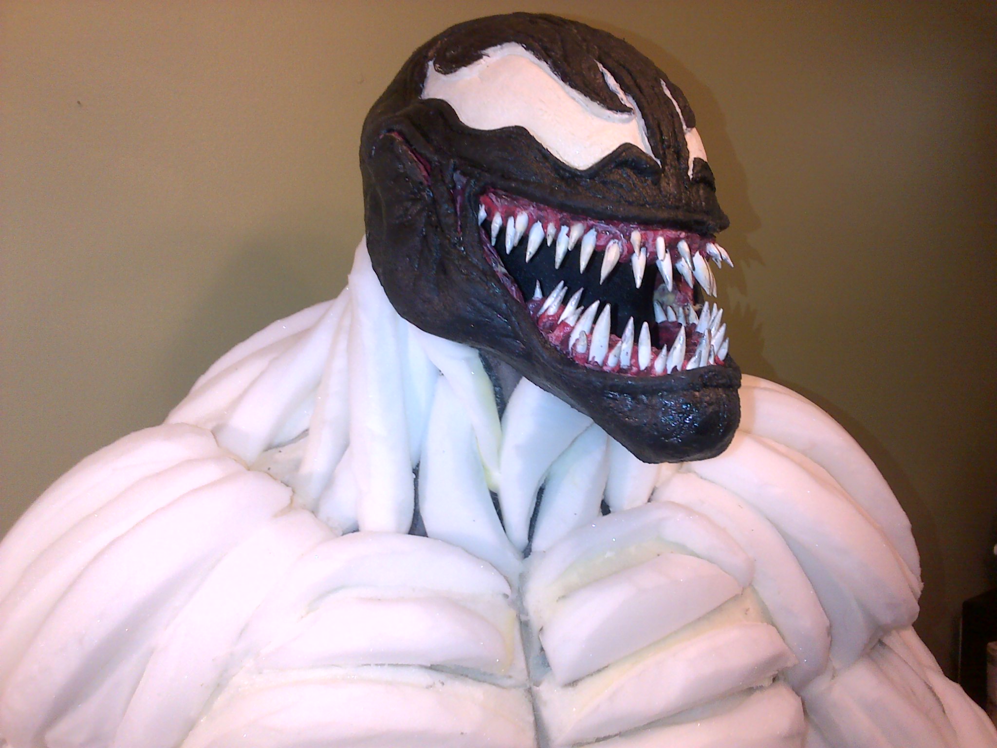

been a while got sidetracked with carnage symbiote mask, but thats done now and im 75 % done body suit sculpt for venom
heres Eddie.......
ill have vids soon of motion test and the suit assembled before skin and paint.
Stratford-20140331-00660.jpgStratford-20140331-00663.jpgStratford-20140331-00665.jpgStratford-20140331-00668.jpgStratford-20140331-00670.jpgStratford-20140331-00671.jpgStratford-20140331-00672.jpgStratford-20140331-00673.jpgStratford-20140331-00676.jpgStratford-20140331-00677.jpgStratford-20140331-00680.jpgStratford-20140331-00681.jpgStratford-20140331-00682.jpgStratford-20140331-00683.jpg

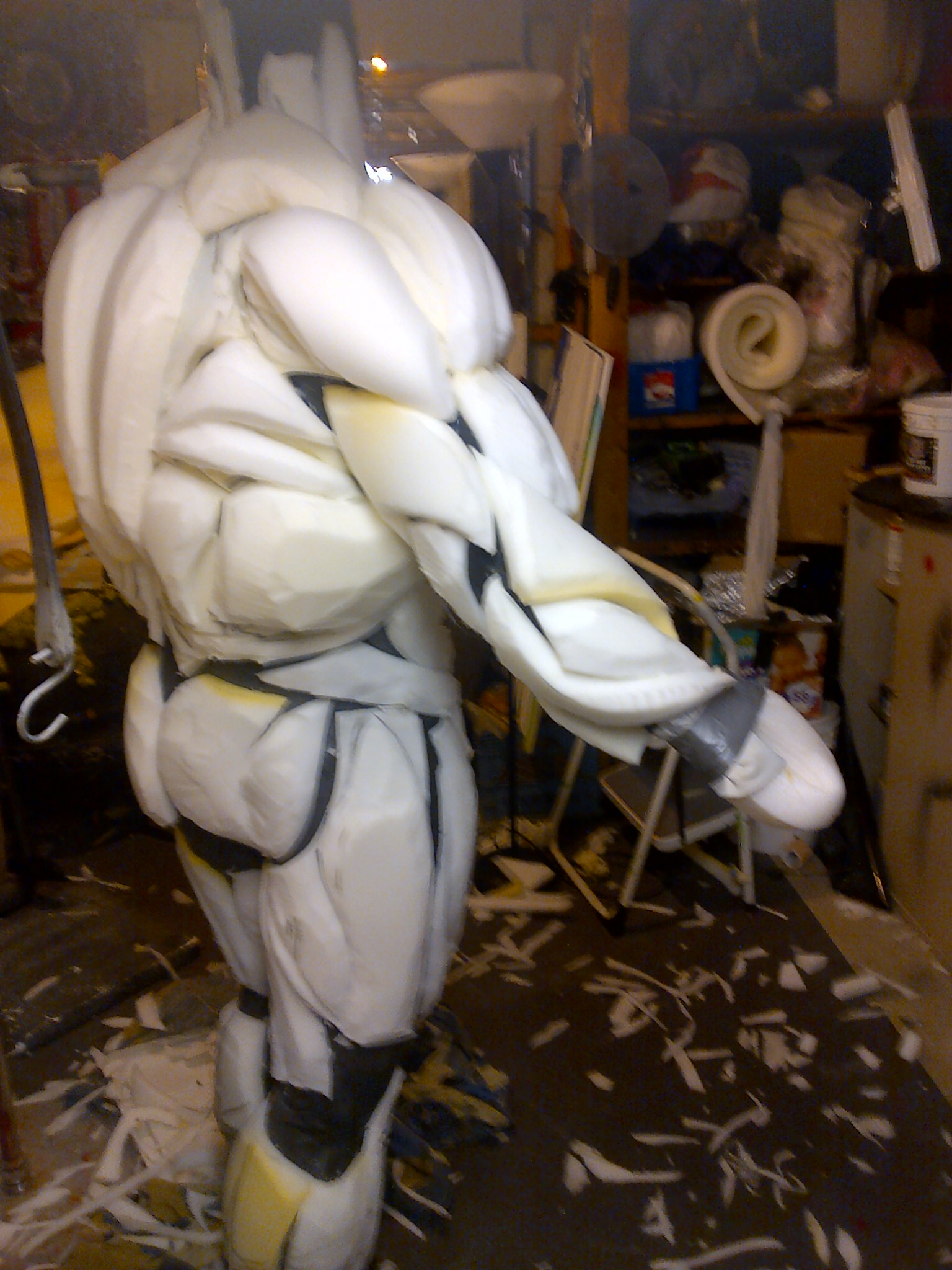

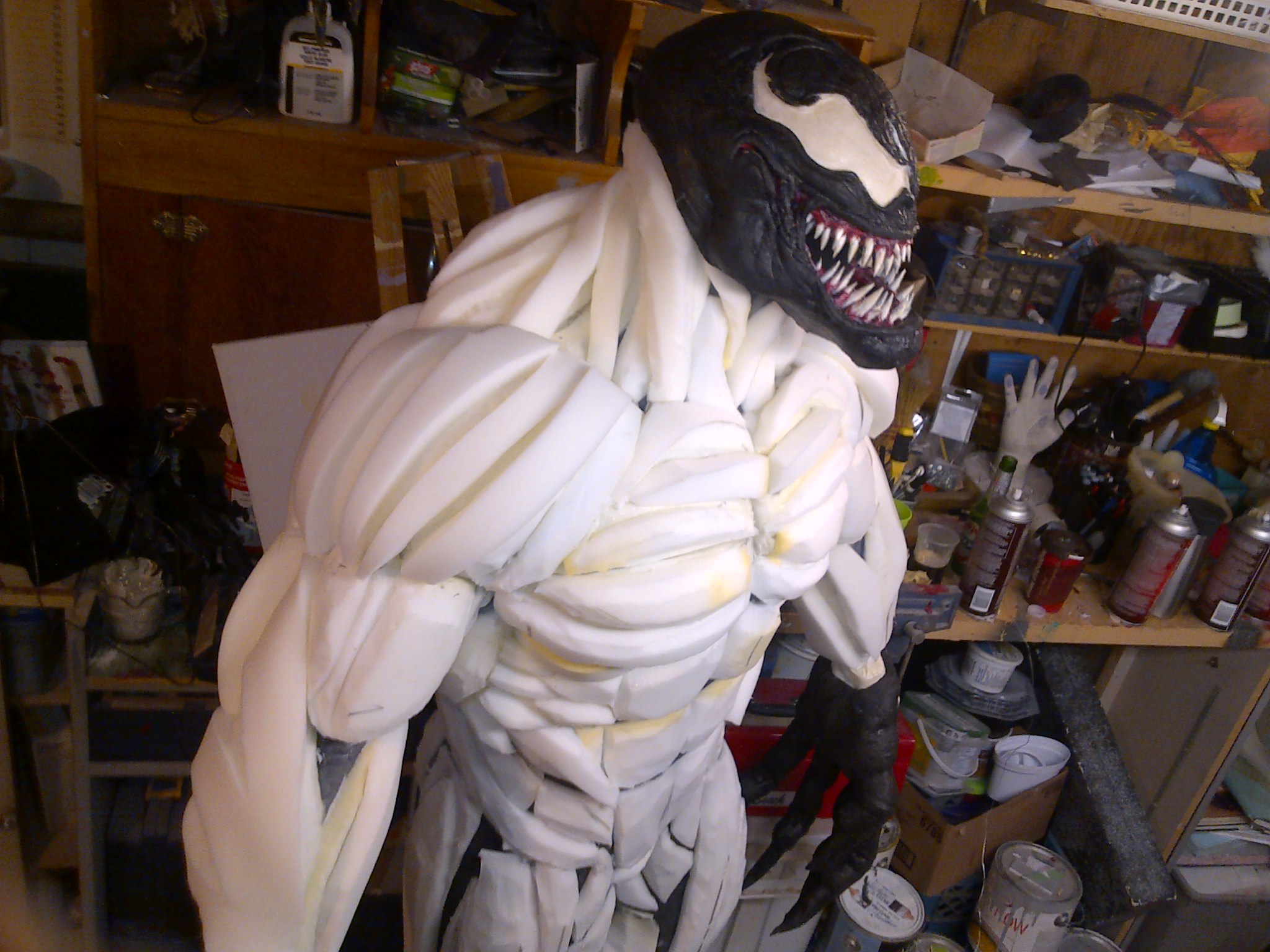

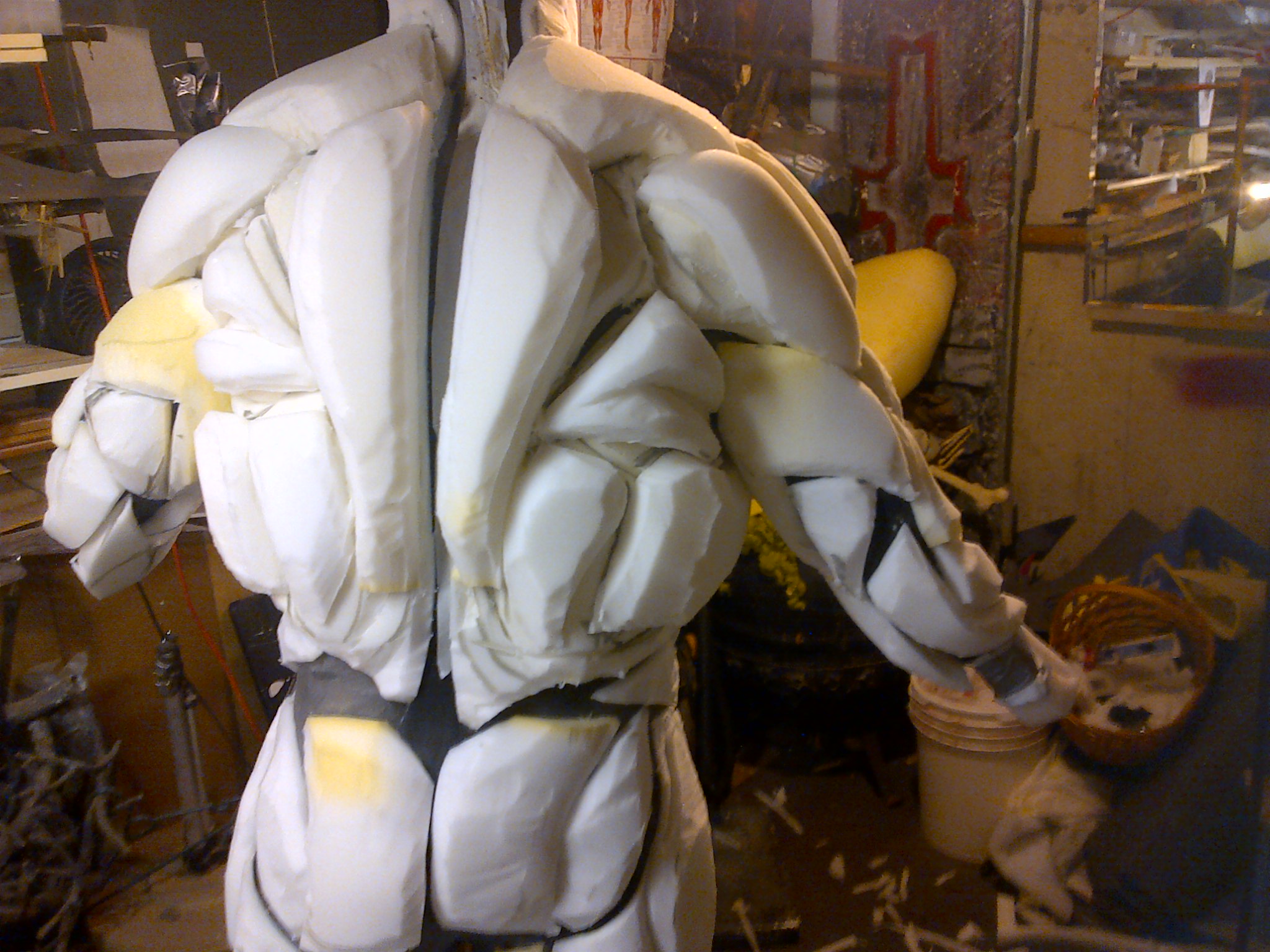

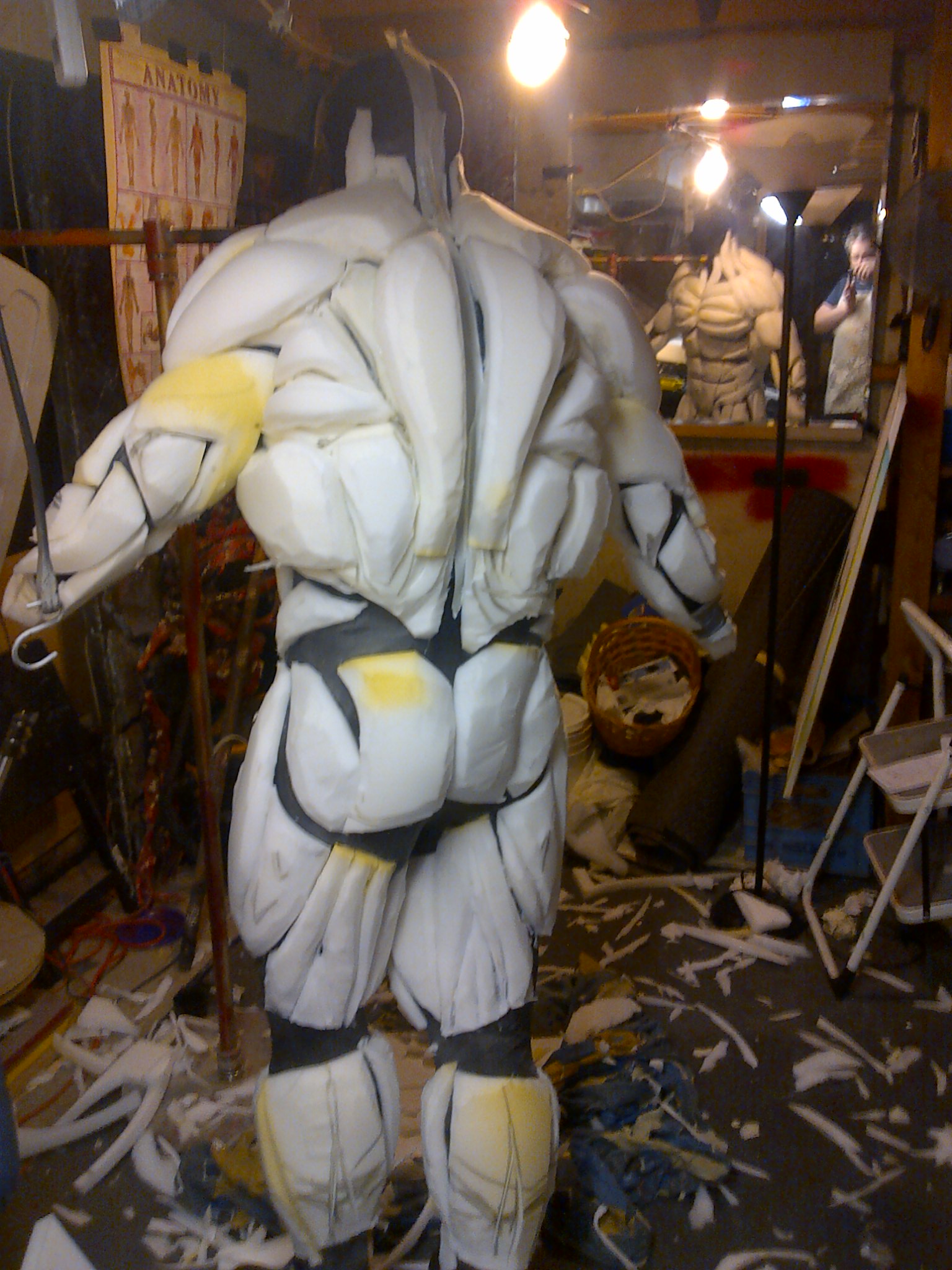

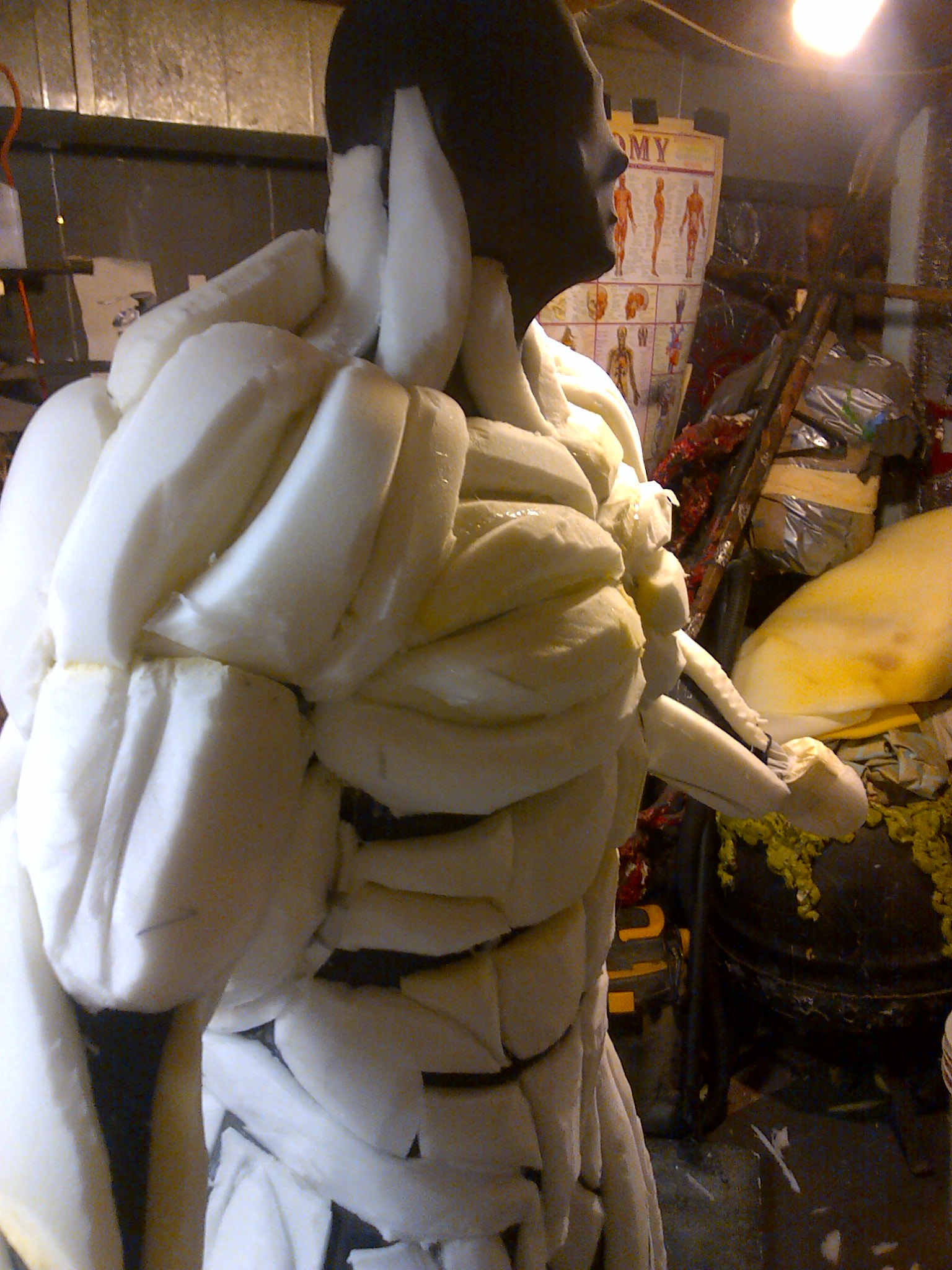

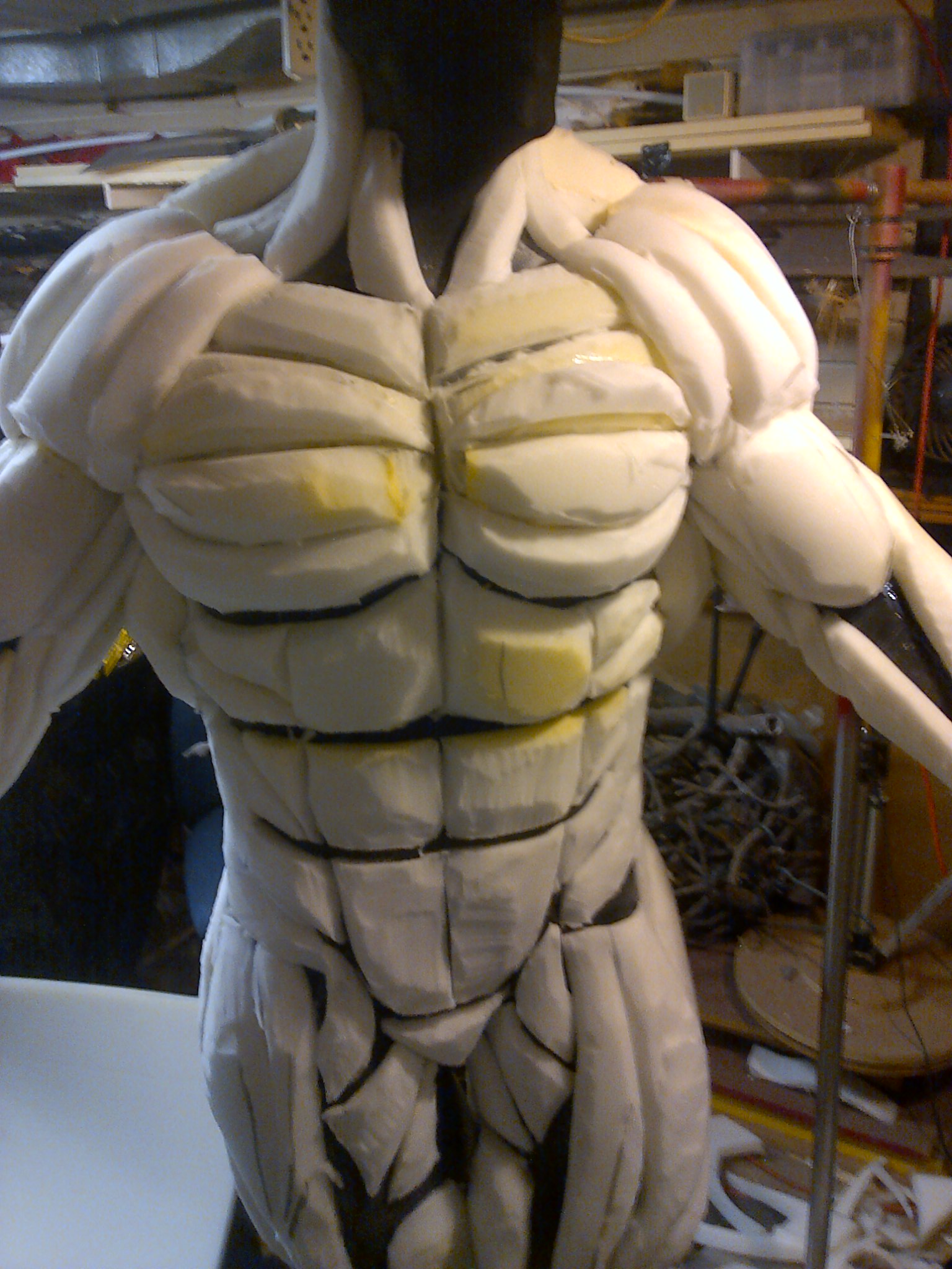

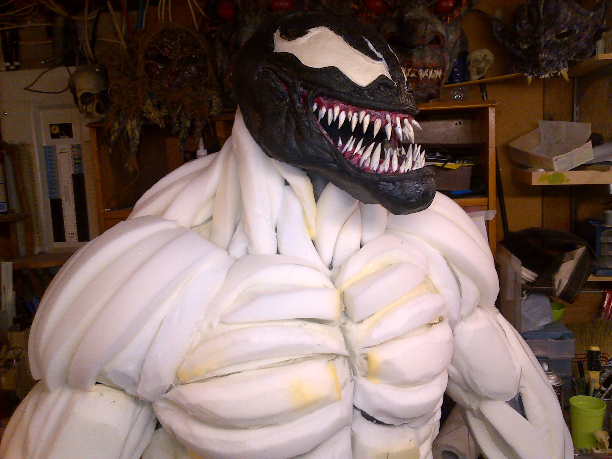

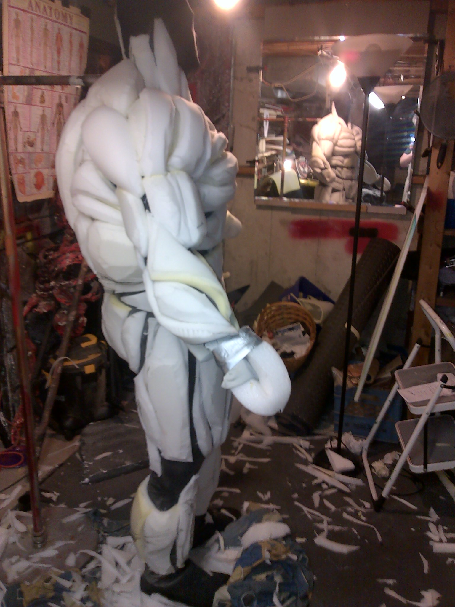

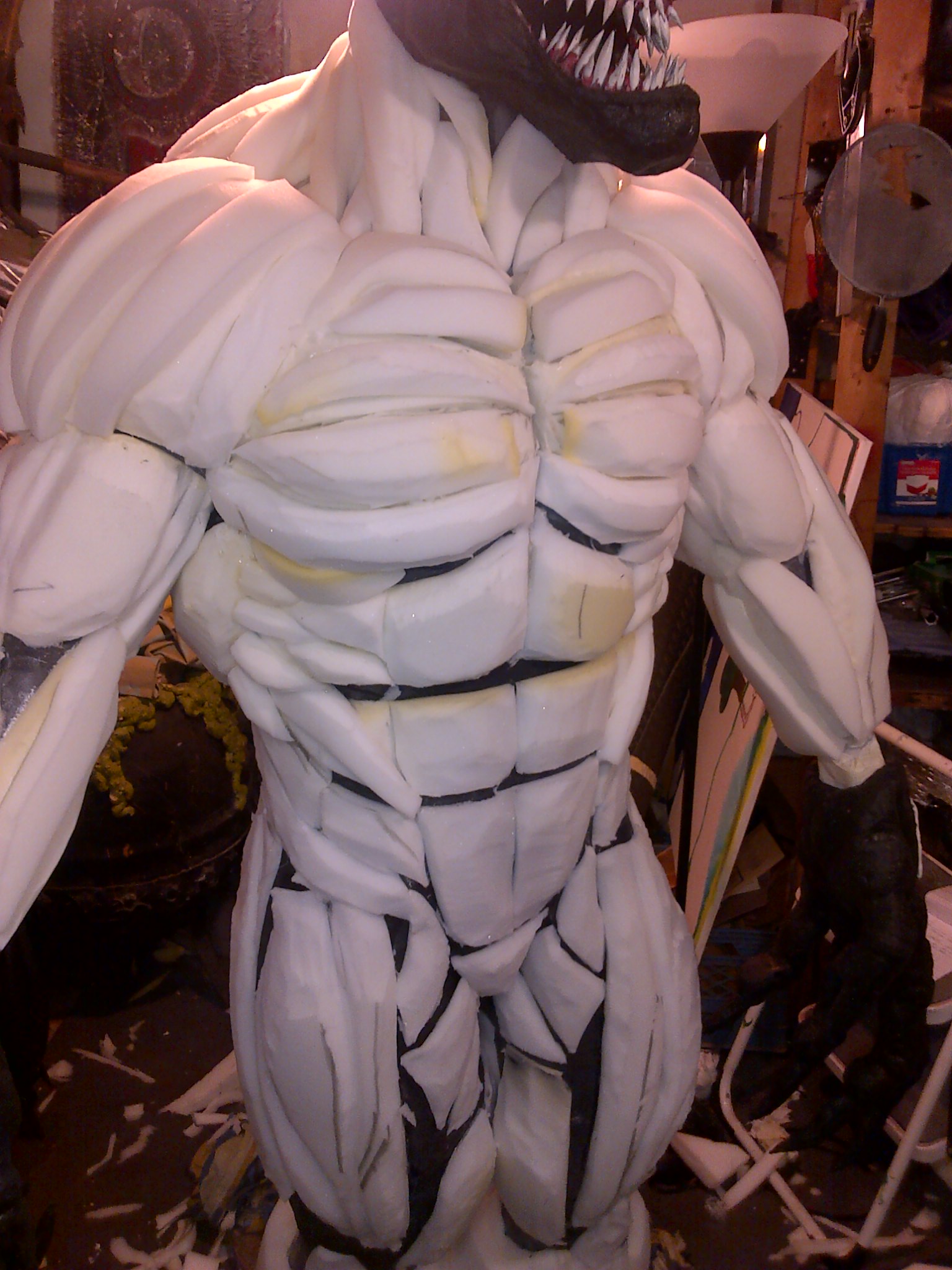

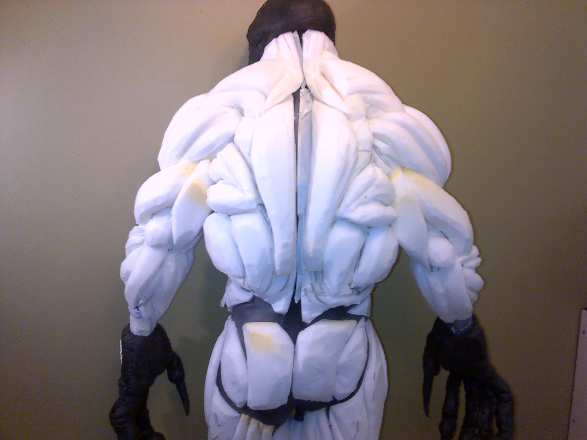

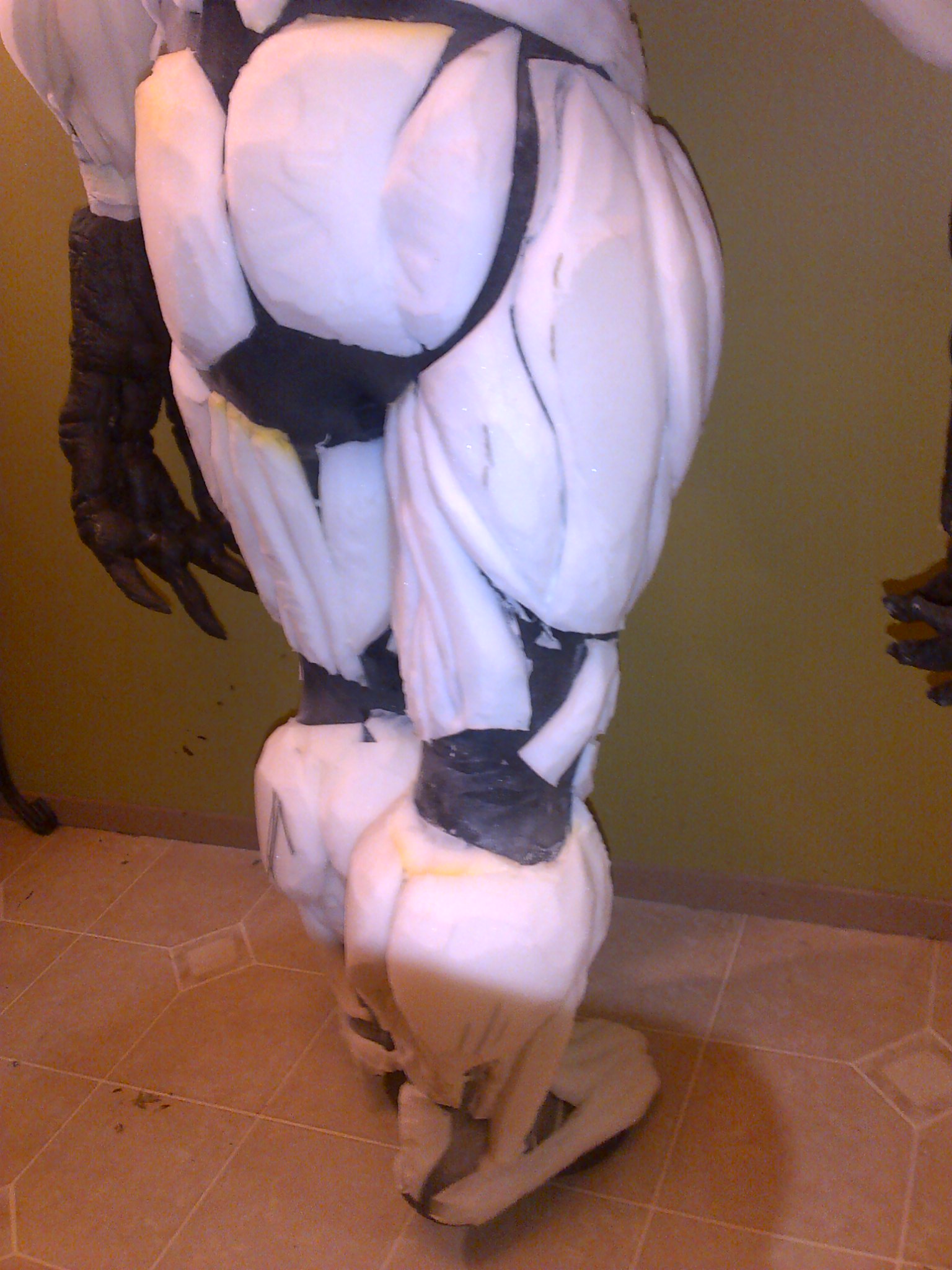

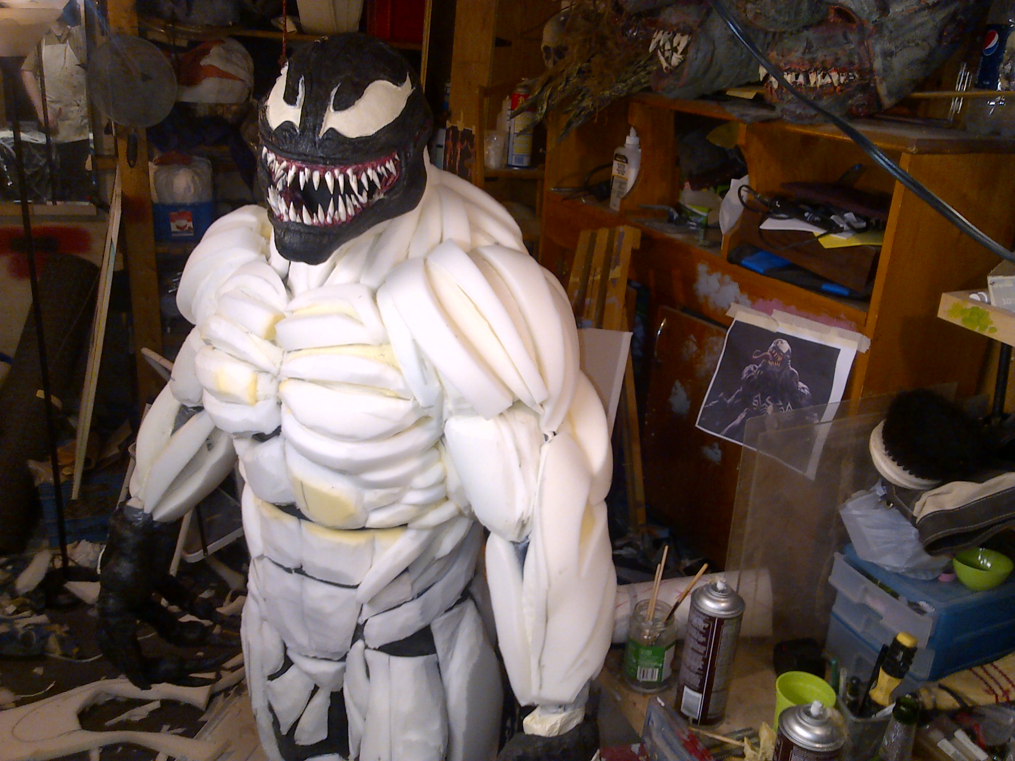

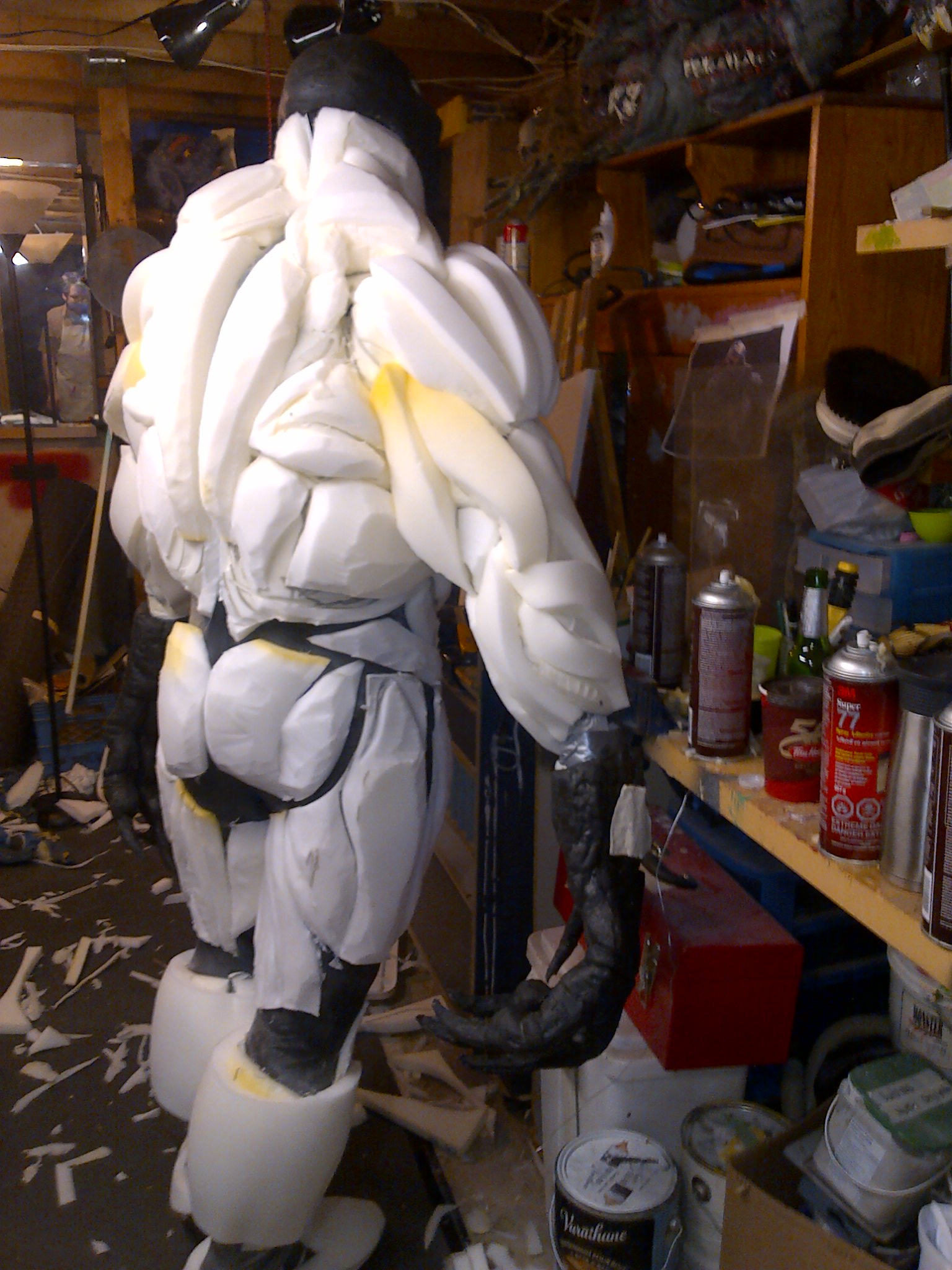

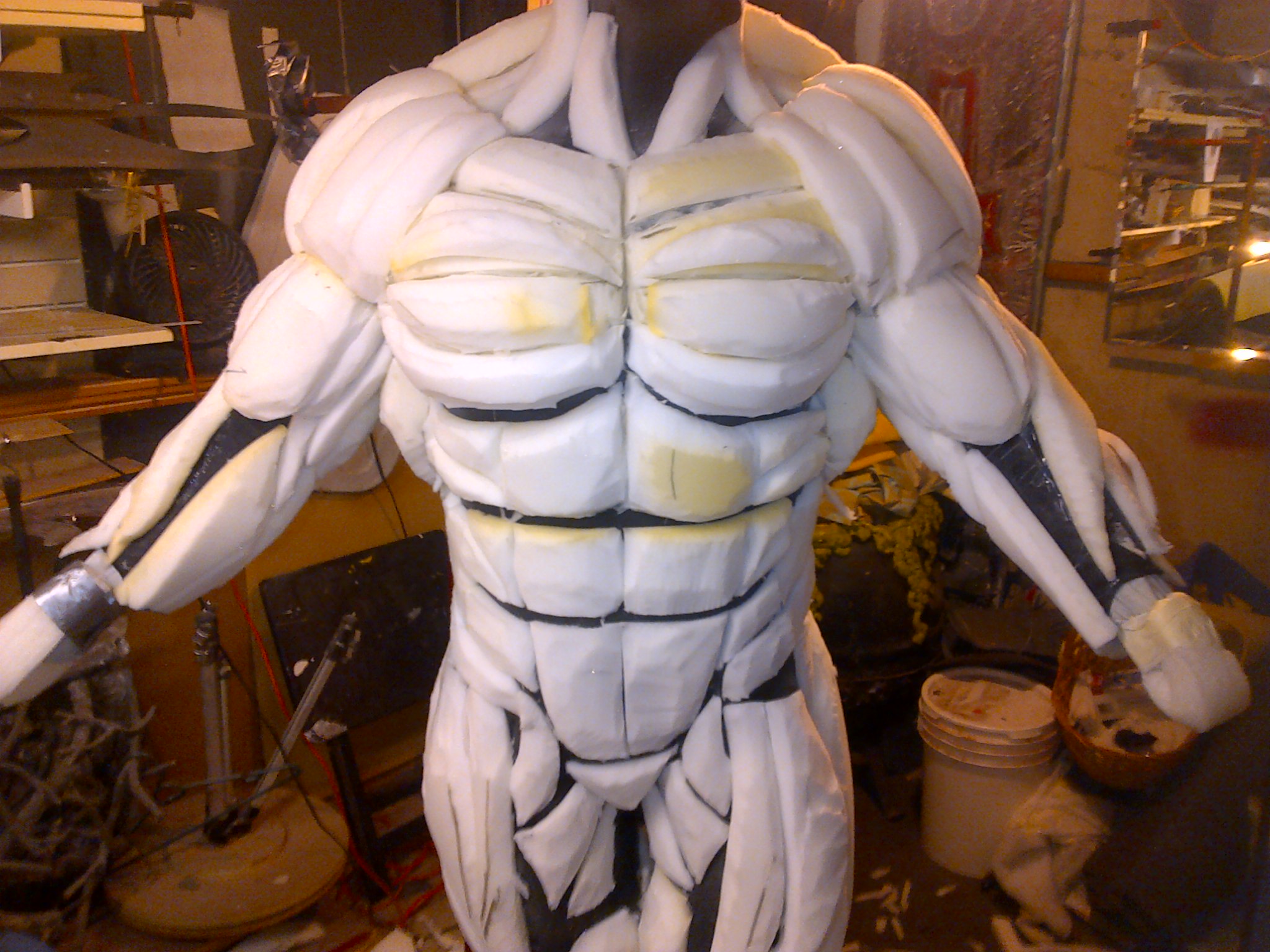

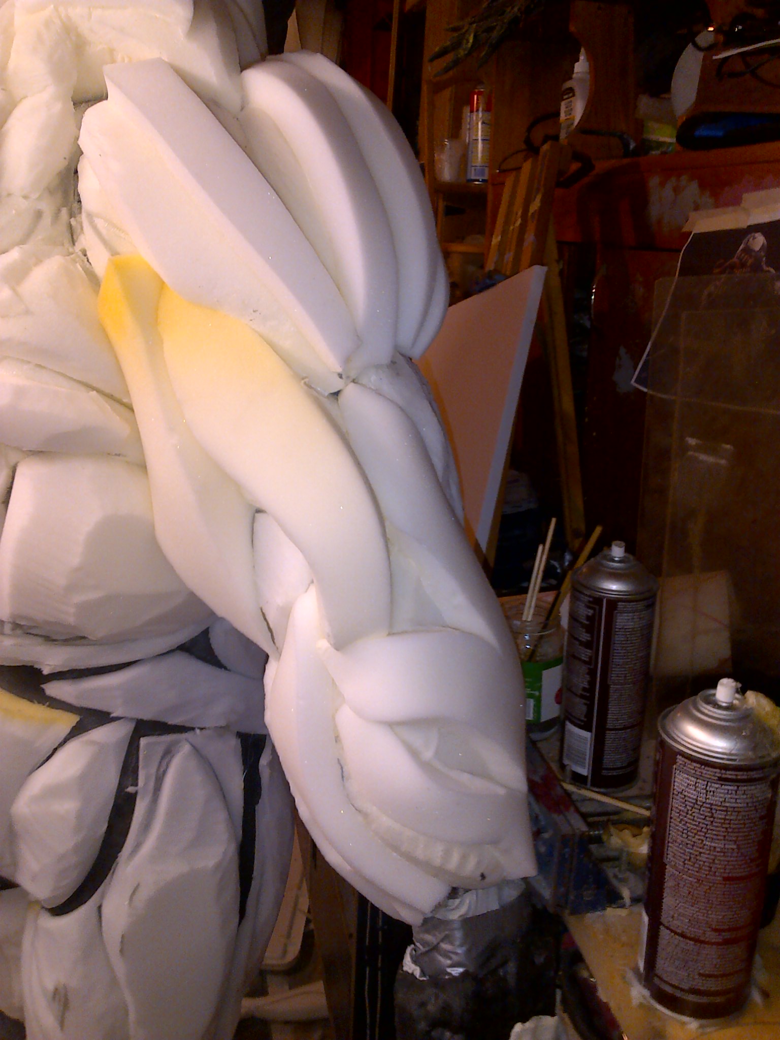

well here he is at 90%
added some more bulk around neck shoulders and arms. still have final sculpt for detail and smooth out areas as well as finish feet ...skin on tomorrow...done by friday...i hope..lol
IMG-20140402-00696.jpgIMG-20140402-00697.jpgIMG-20140402-00699.jpgIMG-20140402-00700.jpgIMG-20140402-00703.jpgIMG-20140402-00705.jpgIMG-20140402-00706.jpgIMG-20140402-00709.jpgIMG-20140402-00711.jpgIMG-20140402-00712.jpgIMG-20140402-00713.jpgIMG-20140402-00701.jpg
View attachment 305954View attachment 305955View attachment 305956View attachment 305957View attachment 305962View attachment 305963View attachment 305964View attachment 305965View attachment 305967View attachment 305969View attachment 305971View attachment 305959

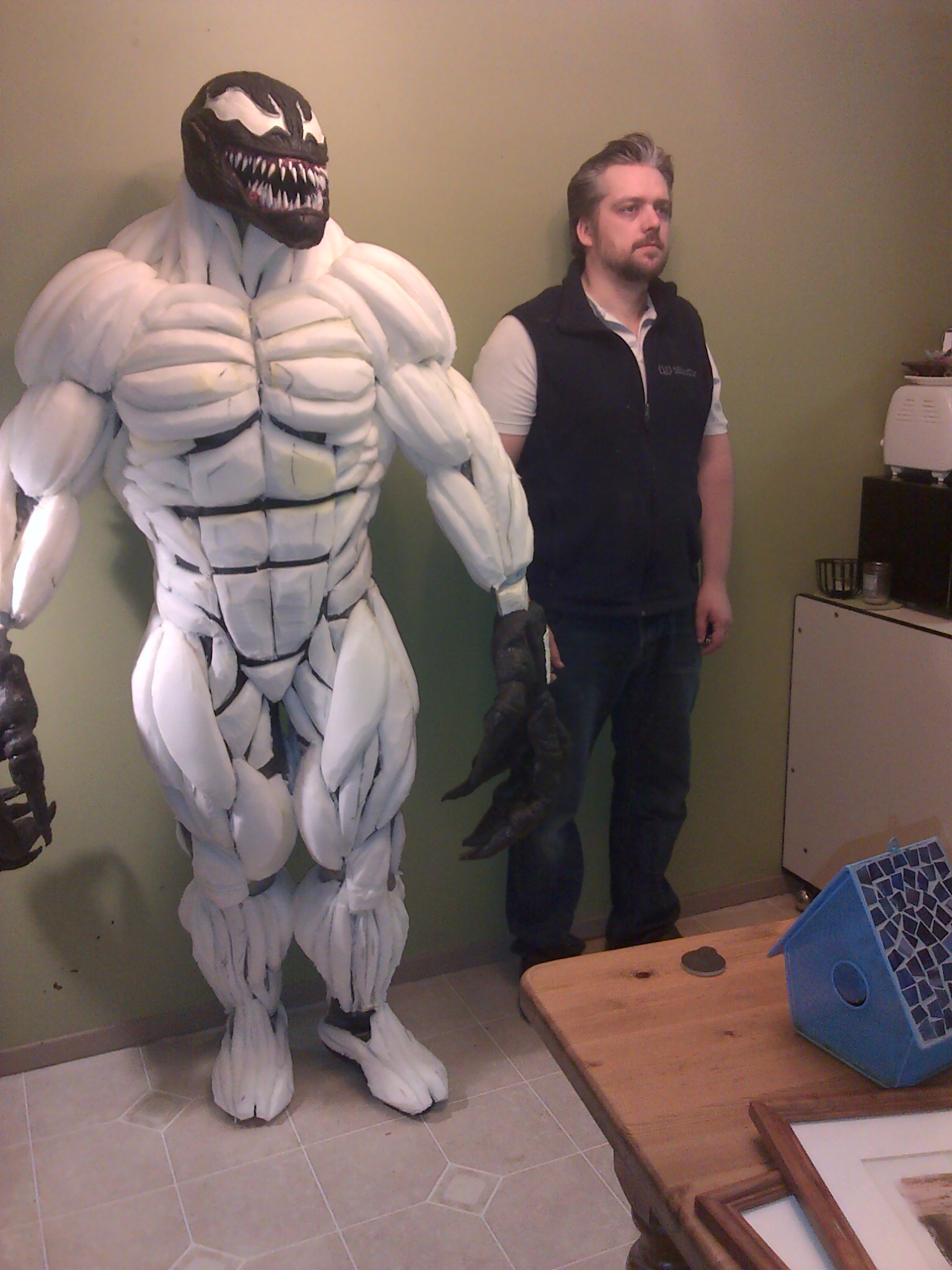

thanks man appreciate it. im really enjoying it and venom is a favorite character of mine so i was glad to be commissioned for it . the client is letting me do my thing ...so
i would love to see yous guys in the same pic. im trying to make him as mobile as possible in a latex foam suit. my venom's new host is taking him on to comic cons and the first is in Calgary expo . the guy who bought my carnage( here: http://www.therpf.com/f78/carnage-costume-wip-muscle-suit-pics-vids-199293/ ) are pals and will be there together. i wish i could be there for that its at the end of april.
venom is huge ill post scale pic and video soon.

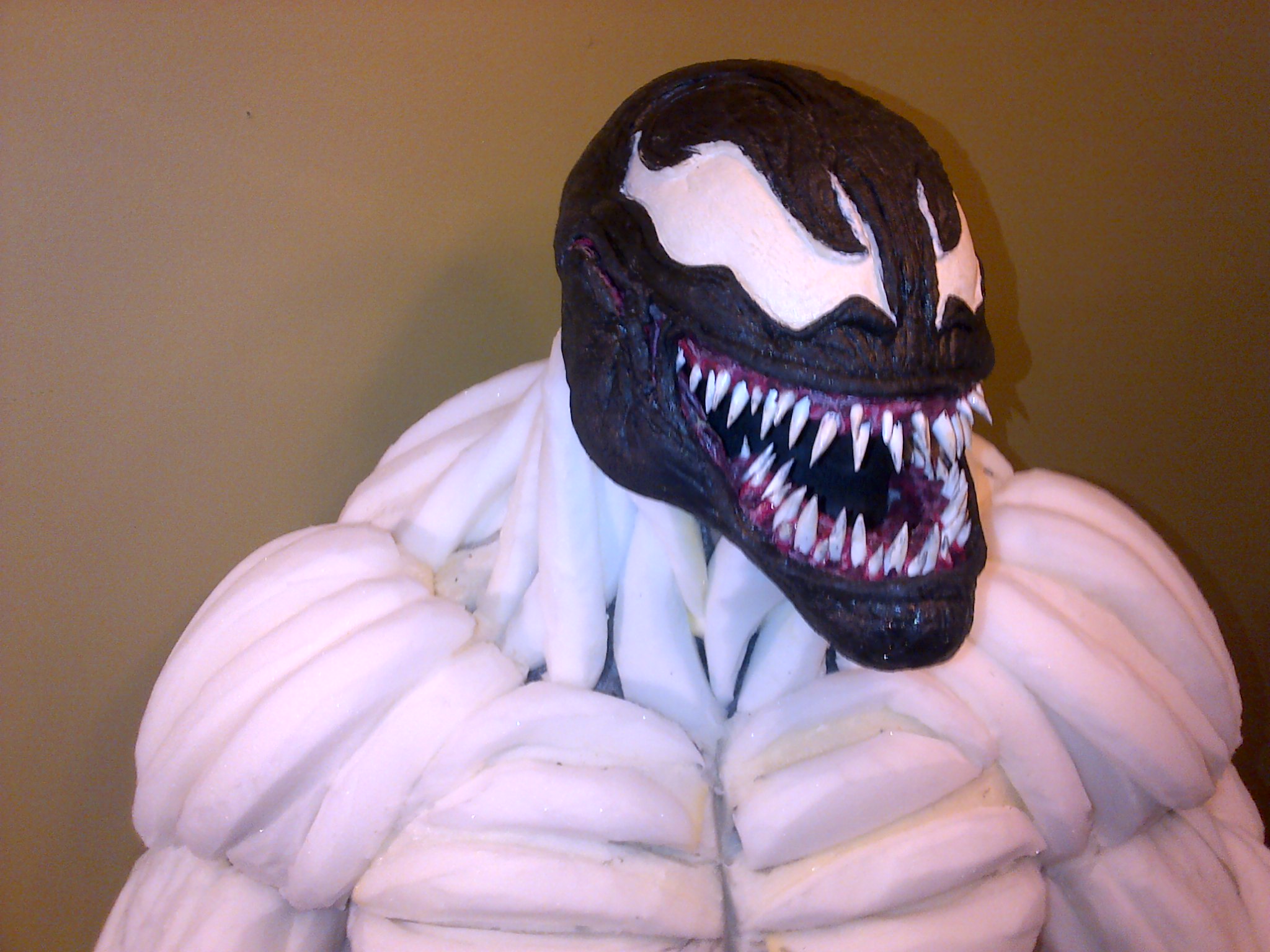

Do you use varying densities of foam?
Sent from my SAMSUNG-SGH-I537 using Tapatalk
yes , the claws are higher density foam, the head is cast in soft but stretchy flexfoam III from smooth-on. the body is all same foam ..smae stuff use in apolostry , 1 inch and 2 inch sheets.

just finishing up last of it now will have skin and paint on very soon. I see your from Calgary .both Venom and the Carnage suit ( http://www.therpf.com/f78/carnage-costume-wip-muscle-suit-pics-vids-199293/ ) will be in Calgary at end of April for the big comic expo .

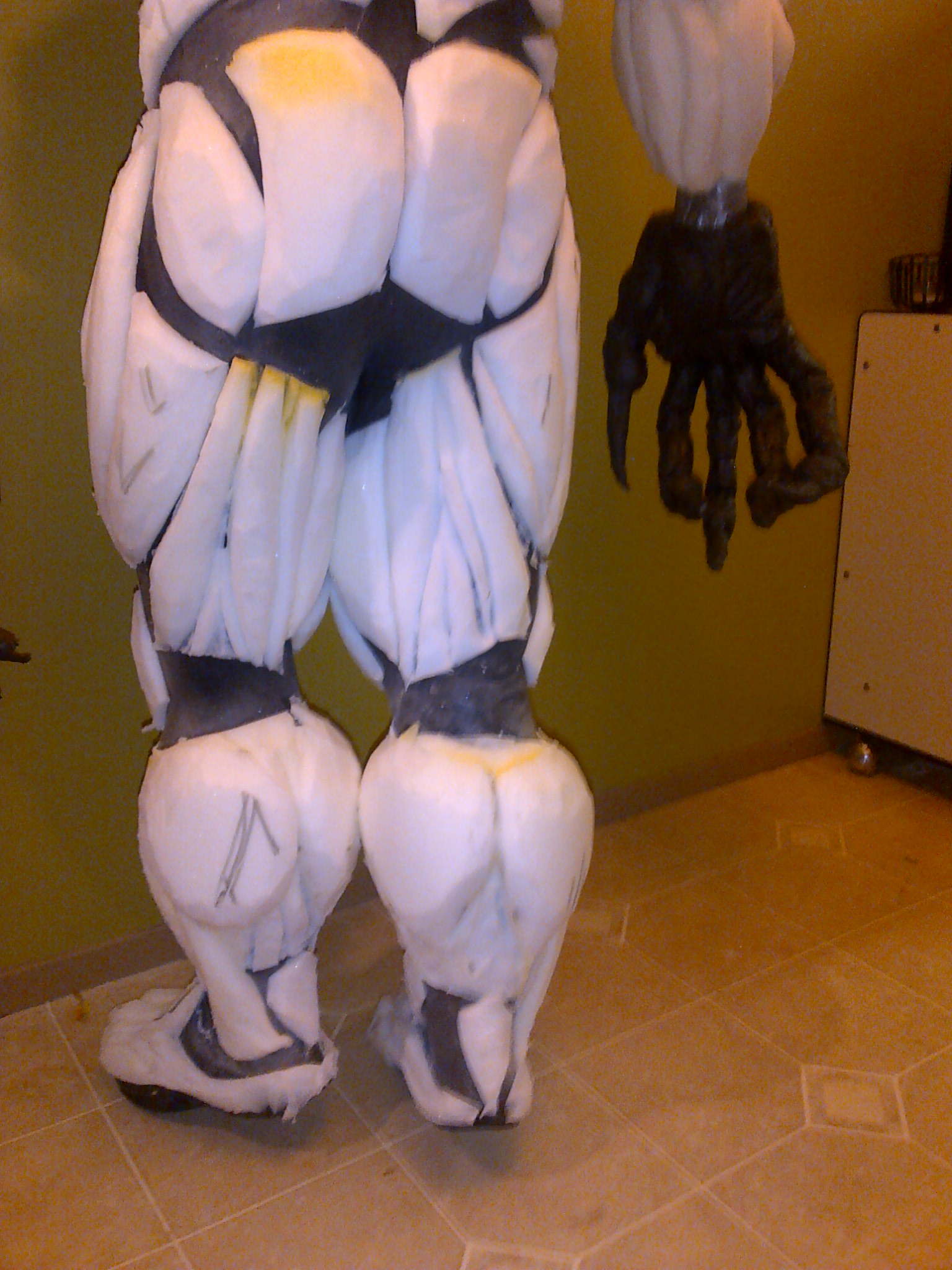

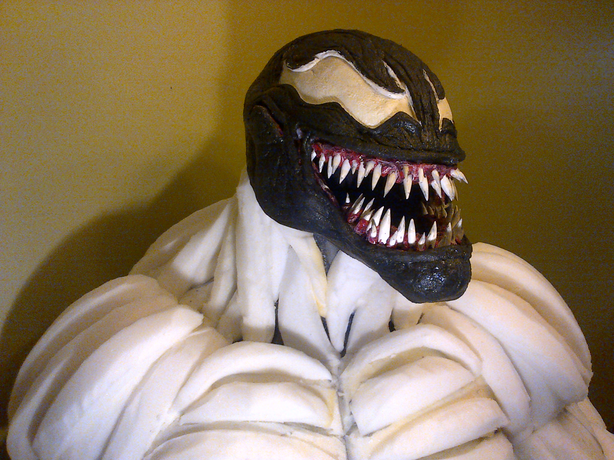

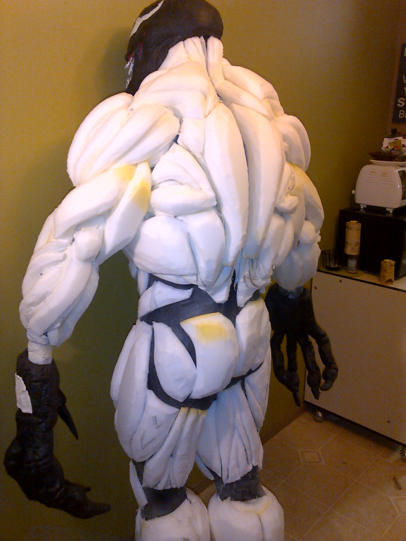

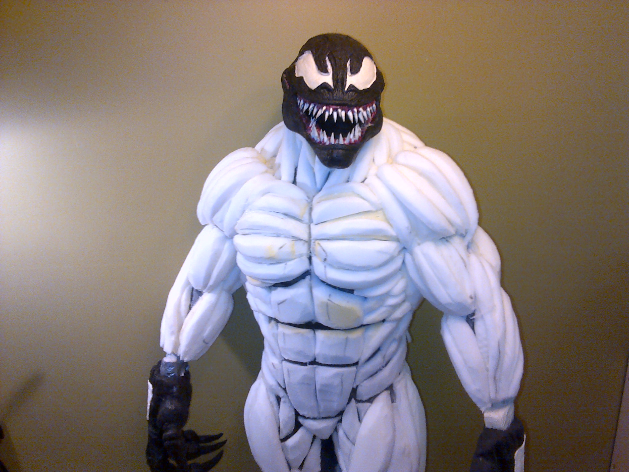

venom suit is now completed fabrication and on to skin/paint..will be done this weekend and off to client....
Stratford-20140403-00716.jpgStratford-20140403-00718.jpgStratford-20140403-00720.jpgStratford-20140403-00722.jpgStratford-20140403-00725.jpgStratford-20140403-00726.jpgStratford-20140403-00729.jpgStratford-20140403-00731.jpgStratford-20140403-00732.jpgStratford-20140403-00734.jpgStratford-20140403-00735.jpgStratford-20140403-00740.jpgStratford-20140403-00741.jpgStratford-20140403-00742.jpgStratford-20140403-00744.jpgStratford-20140403-00745.jpg
