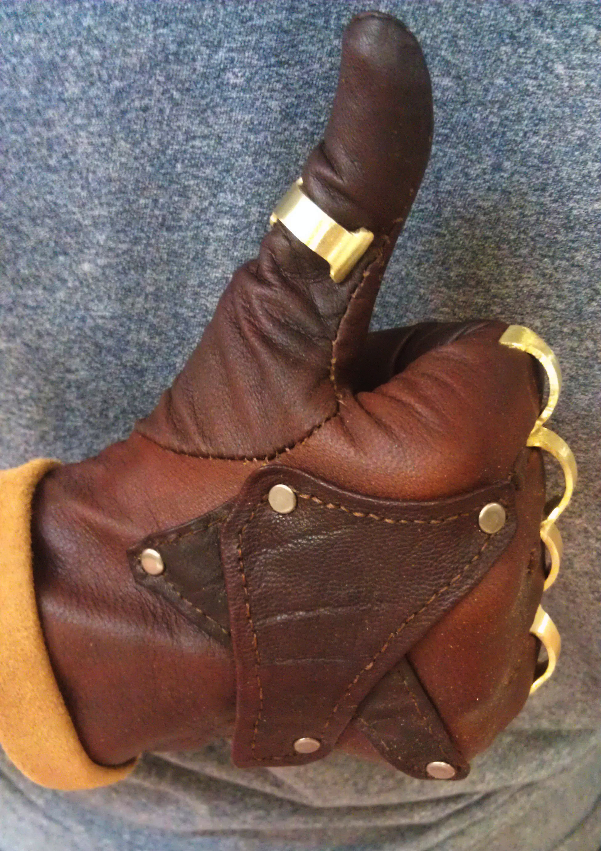

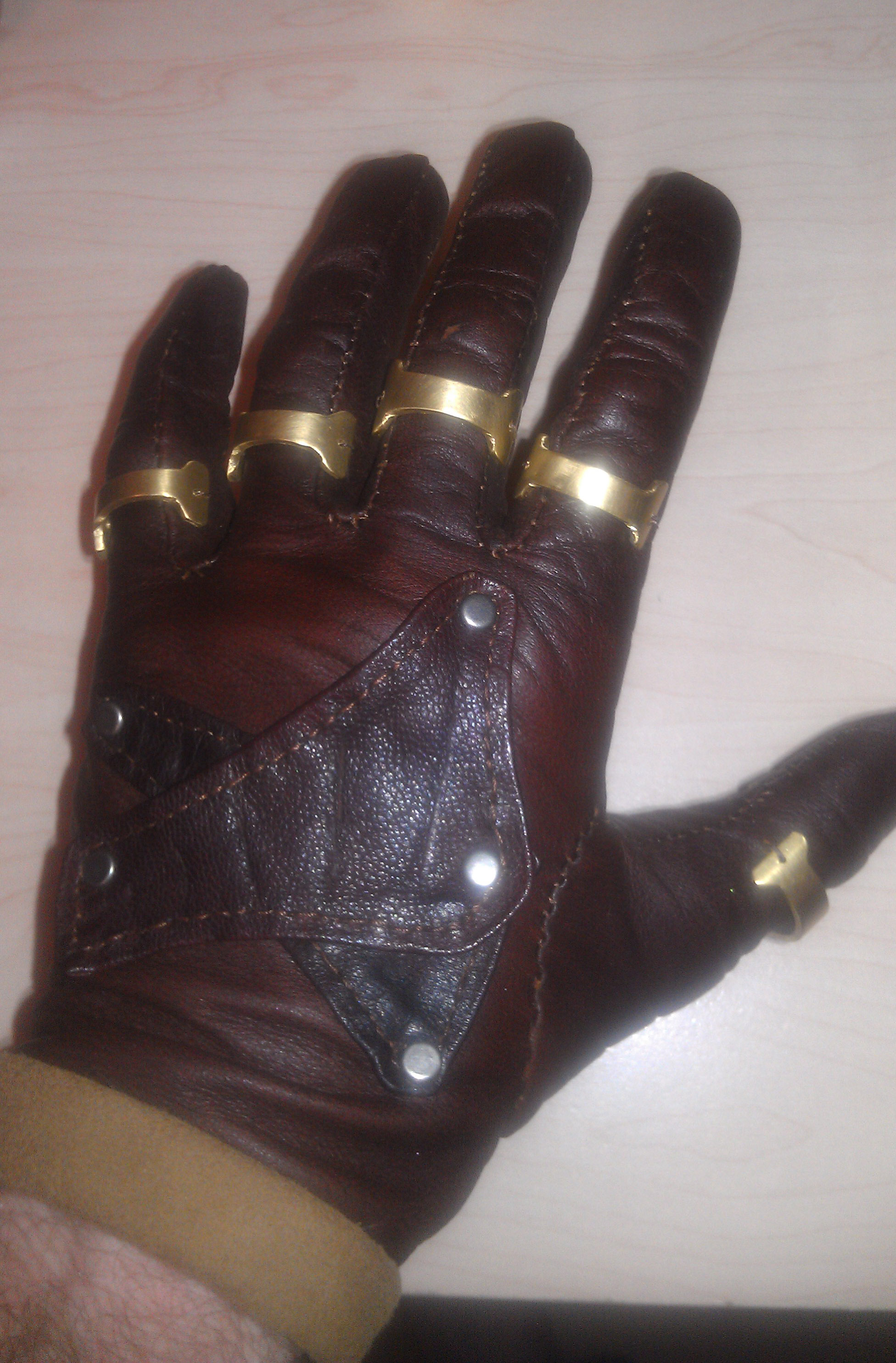

Another quick update, finished the gloves.

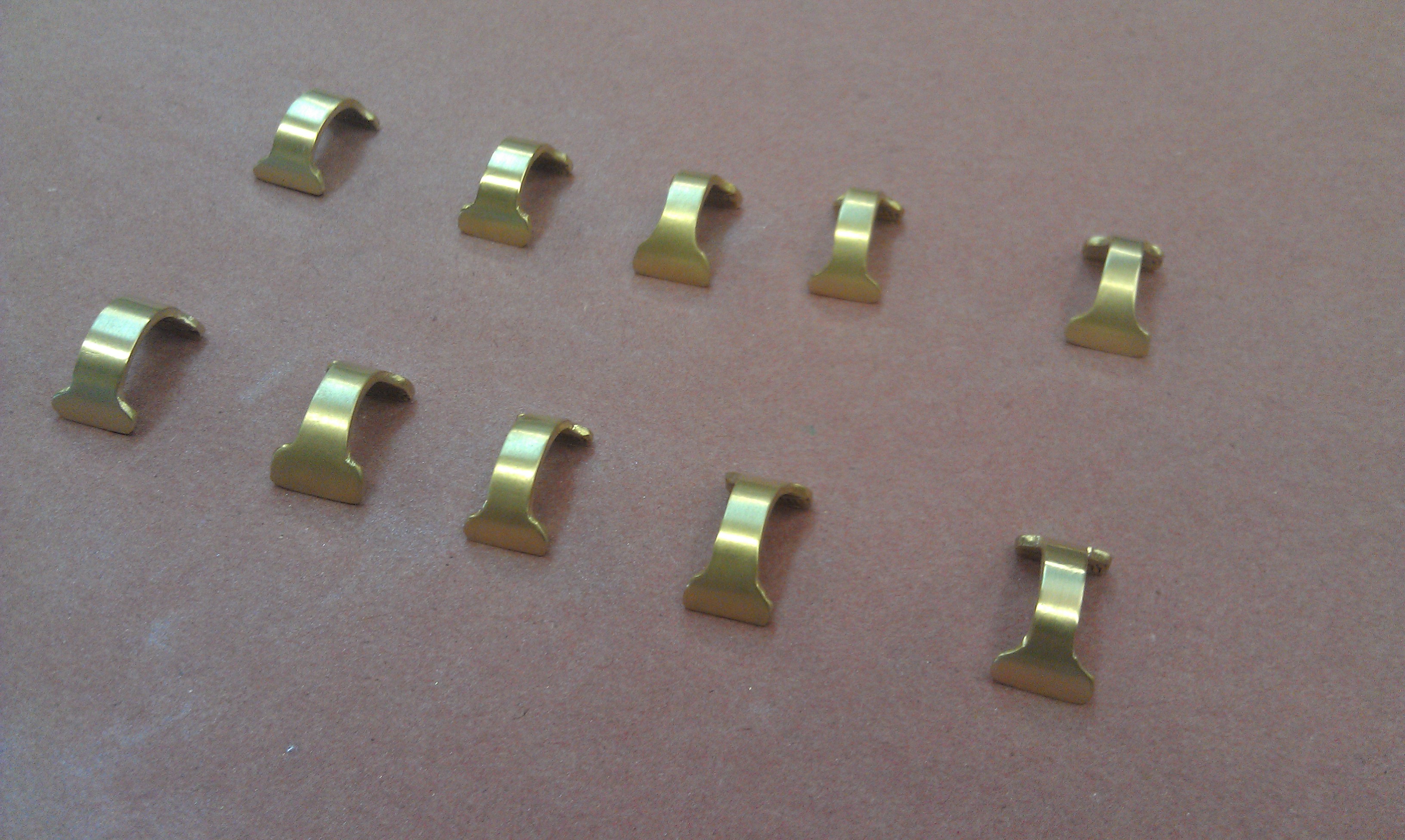

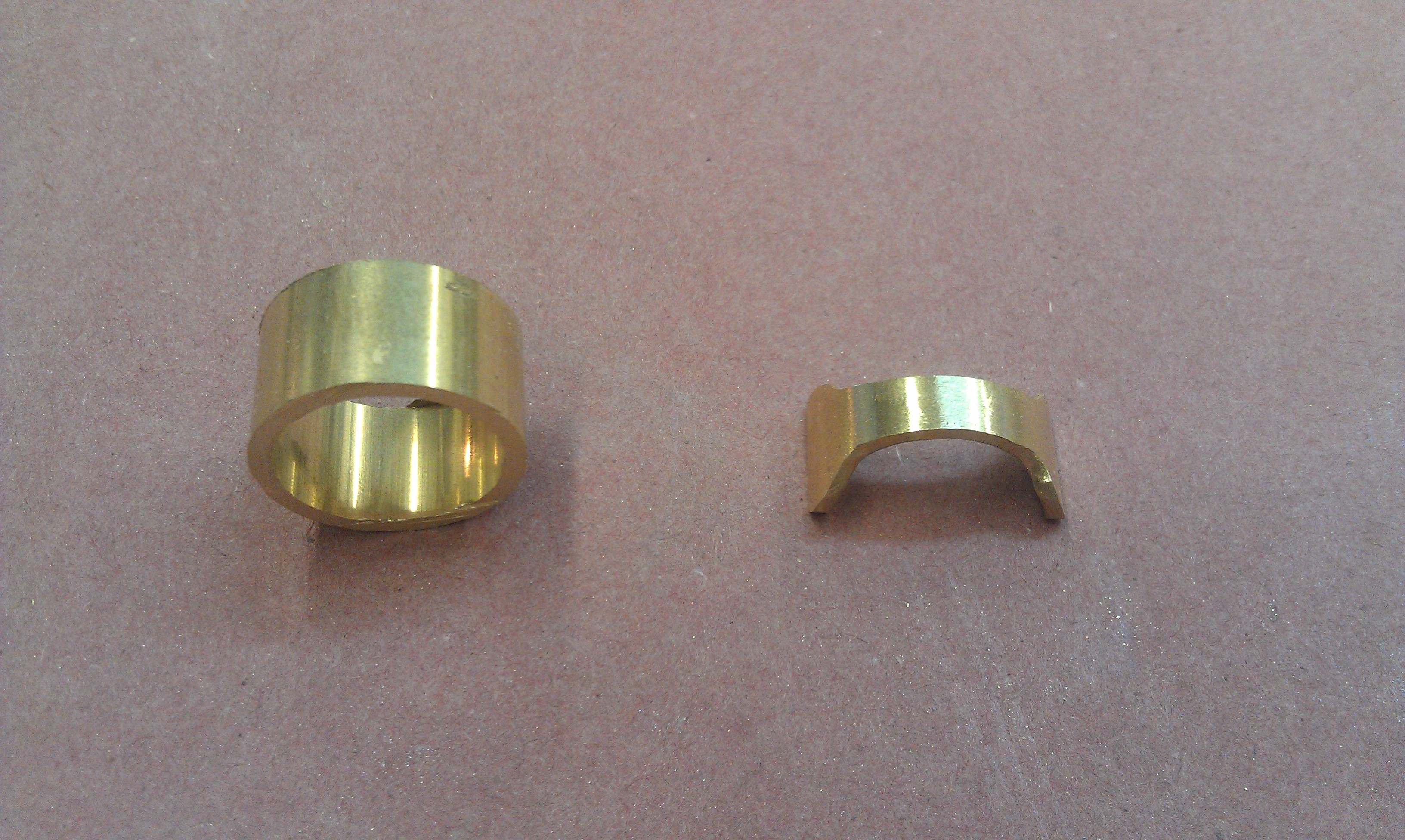

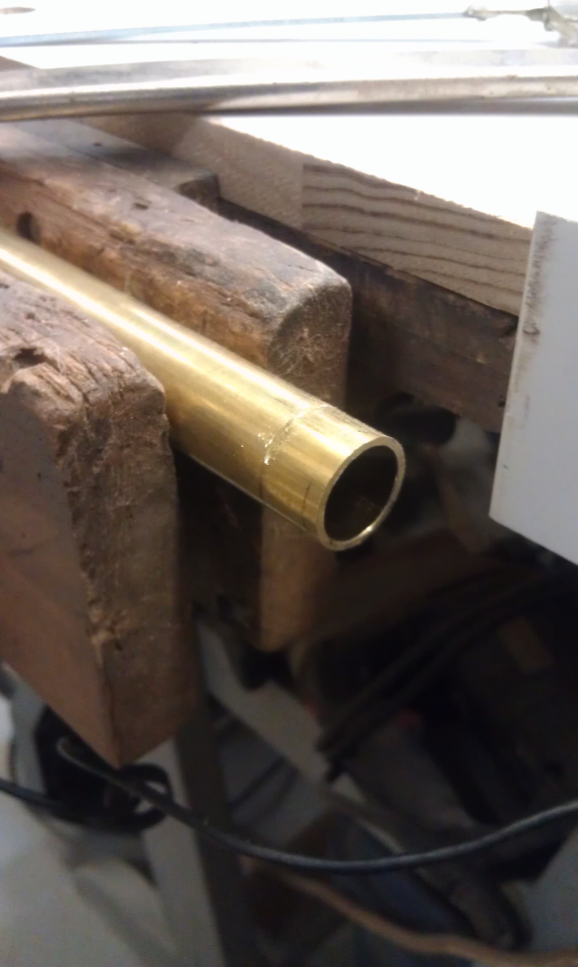

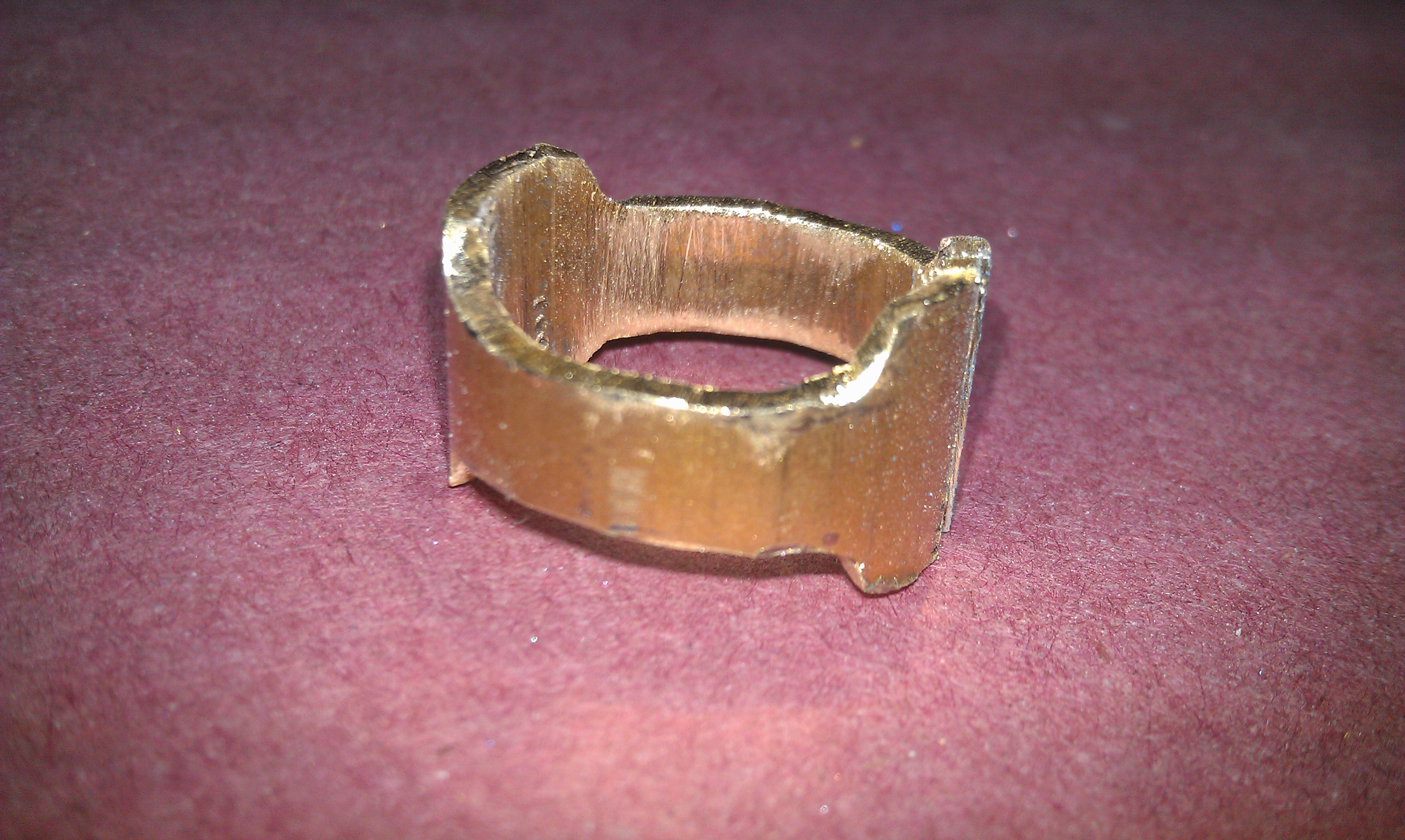

The rings were cut from a solid piece of ~2mm wall-thickness brass tubing. Interestingly enough, cutting by hand with a hacksaw was WAY cleaner and easier than with a dremel tool and cutoff bits. A quick trip to the bench grinder, and voila! Two rings from one slice:
Cut in half and repeat four more times, and after cleaning up with a LOT of hand-filing and 2000-grit sanding pad, they were shinier than the stock tubing.
So shiny that I have the inexplicable urge to bite them.
Tiny holes drilled for attaching to the gloves, and voila! The blingin'est fingers you ever did see.

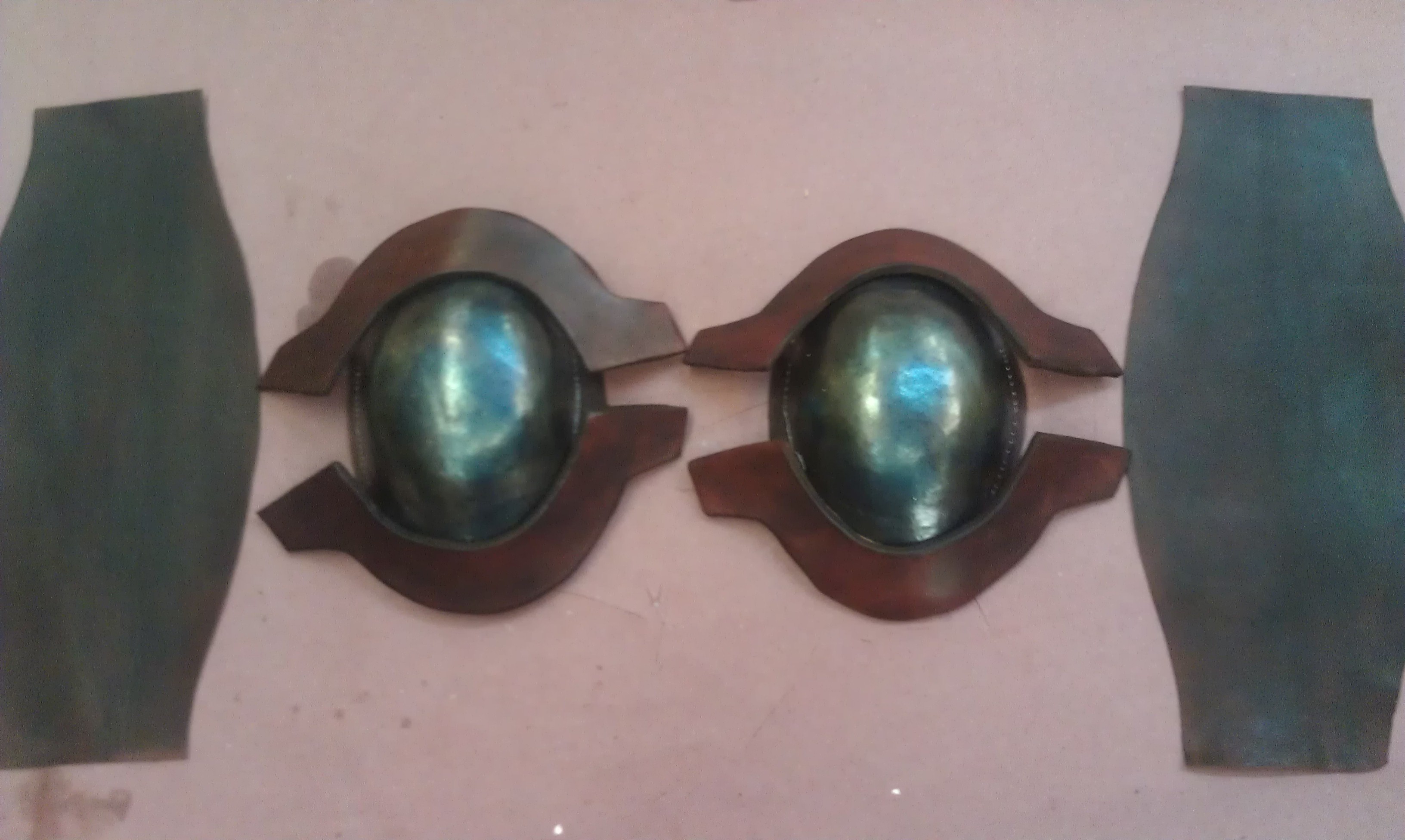

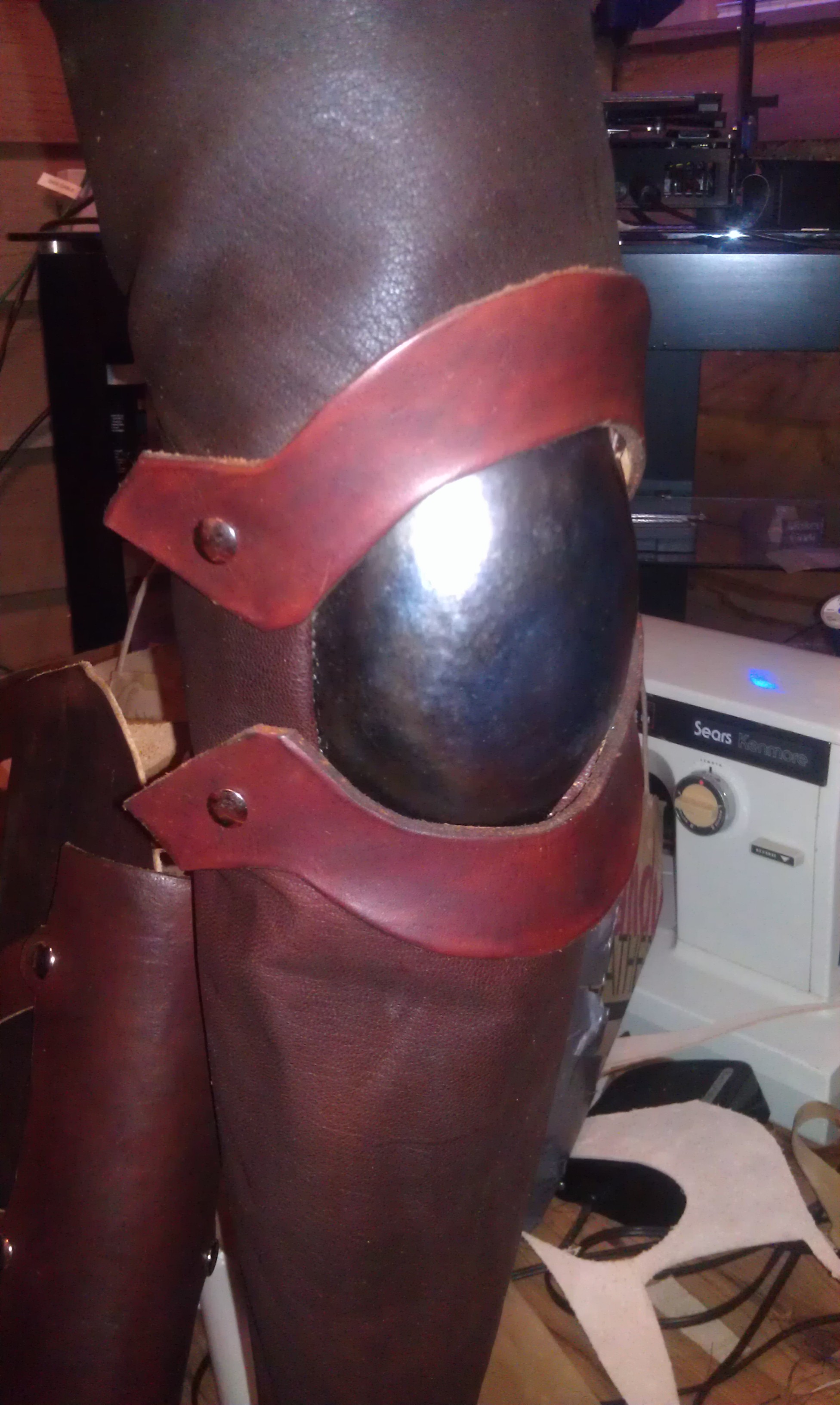

Remember those kneepads?
I trimmed them up and made a pattern for the funky 3-layer design
Here's the flexiest part:

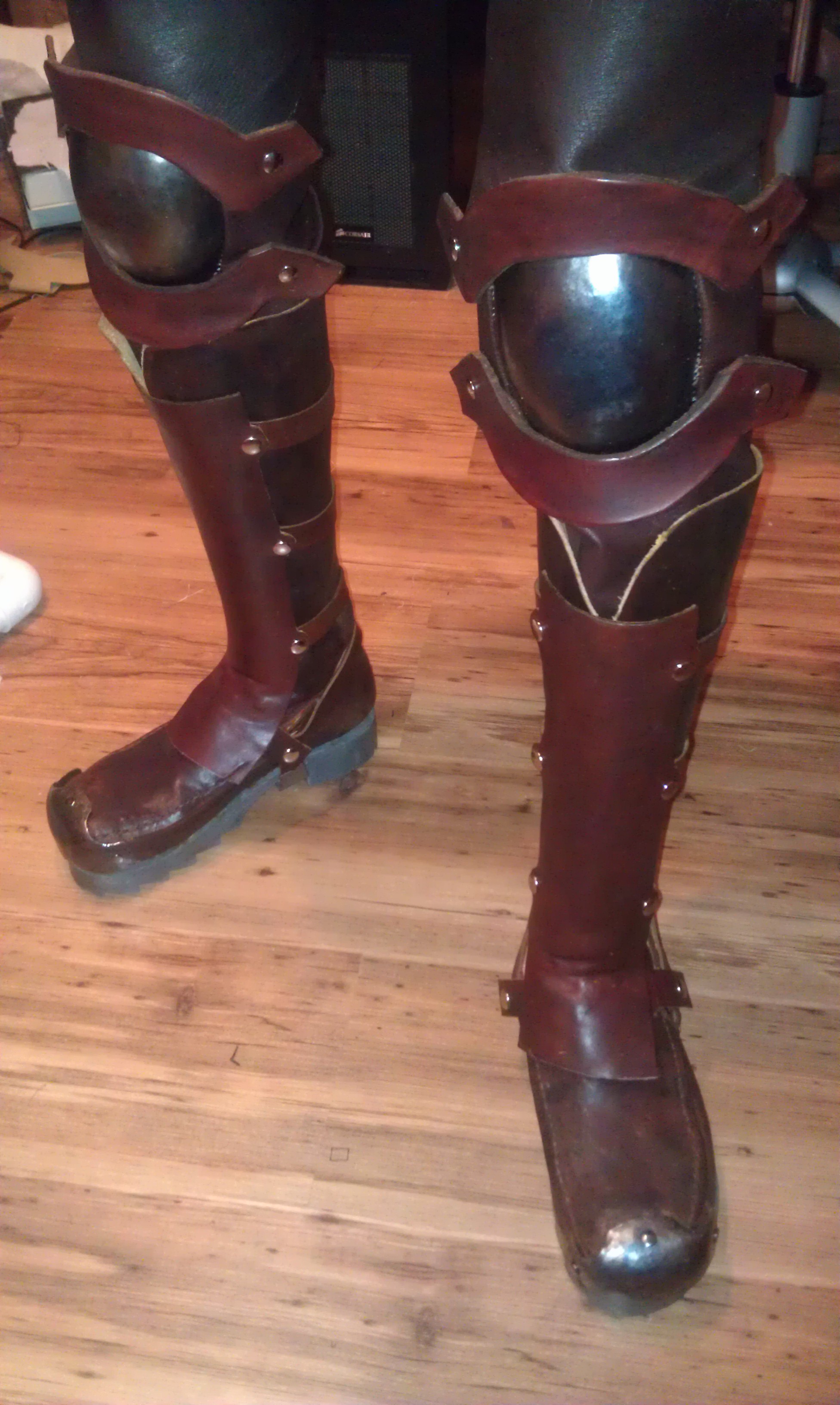

Basically the only way to attach the plates to the leather is to sew them together, so I killed three drill bits making some needle-sized holes, then sewed everything by hand over the course of two days.
The upper and lower leg parts are sewn on using the same method, and then the two thick leather arches were riveted through both layers.
The tension created by the leg actually holds them in position, and they flex with the knee, exactly as shown in the concept art!
Overall, they fit and look great. They'll darken further with more oil, and shape-wise, they're perfect.

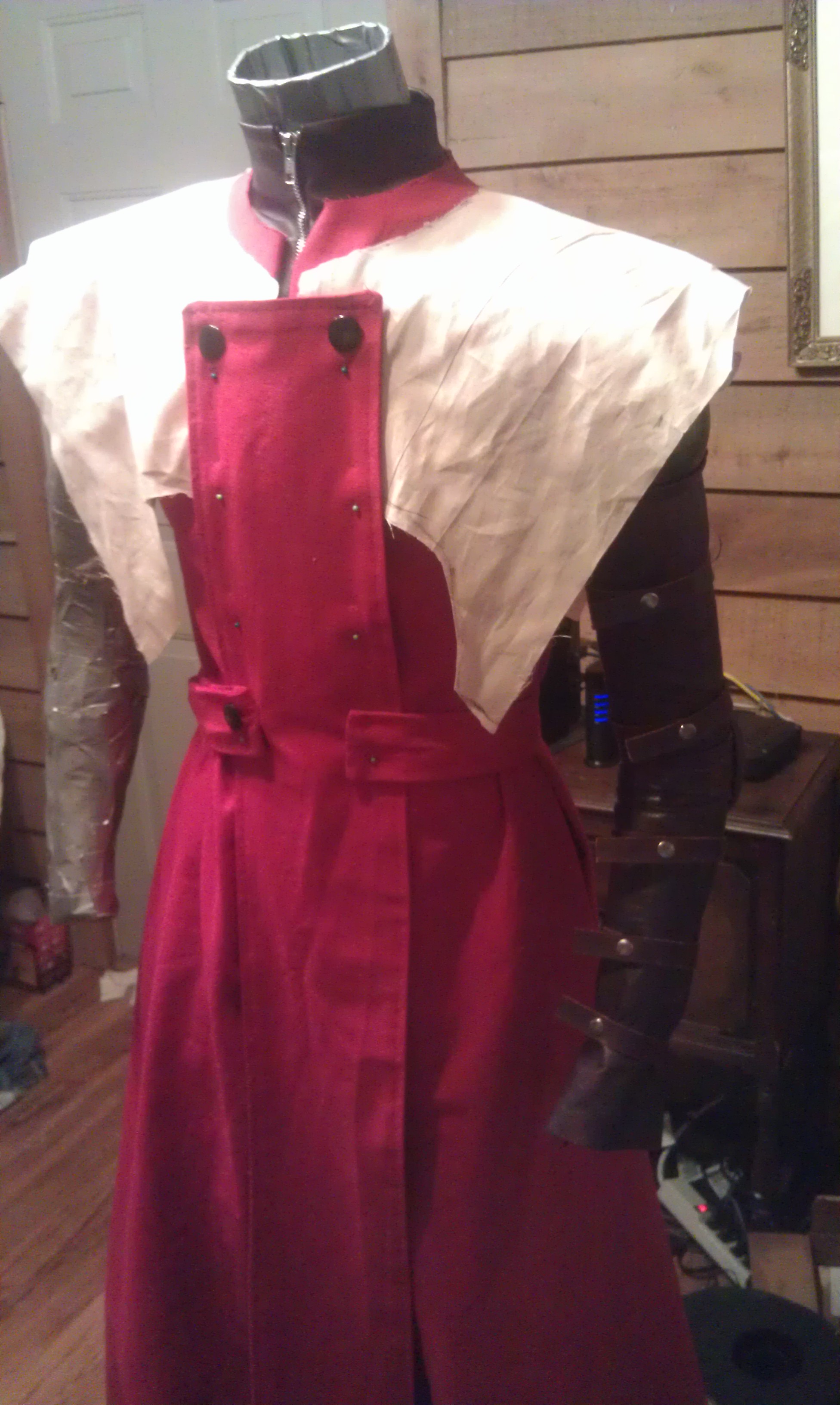

After a day or so of patterning and several hours of fighting with my sewing machine to adjust it to sew this thick cloth, it's about 1/3 done:
The shoulder piece - being one solid part with no seams - proved to be the most difficult part to pattern, but I've just about got it down, and I should have juuust enough material to finish everything. The, er.. sleeve-and-a-half.. will be done last, since the arms both attach to the shoulder piece at the tip of the shoulder pads, and that ends up being a really wonky shape that needs to be freehanded to work correctly.
The buttons (just sort of hanging there now) will be attached to eight snaps on one side of the front button piece, because everyone wants a coat that can be removed stripper-style, right?

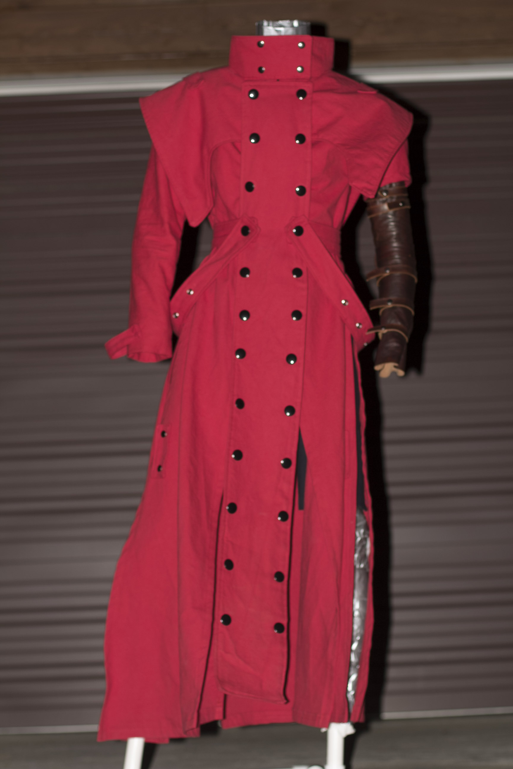

Ok, aside from weathering, the duster is finished:
It looks so shiny and new! Dare I say.. too shiny and new?
Over the next few days I'm going to subject it to the vigors of several wash/dry cycles, buckets of sand/dirt/gravel, and several days of direct sunlight. I also plan on looking very strange by rubbing up against lots of concrete walls.
(I've left the small buttons off the epaulets and wrist to give them some individual weathering attention before they go on)
