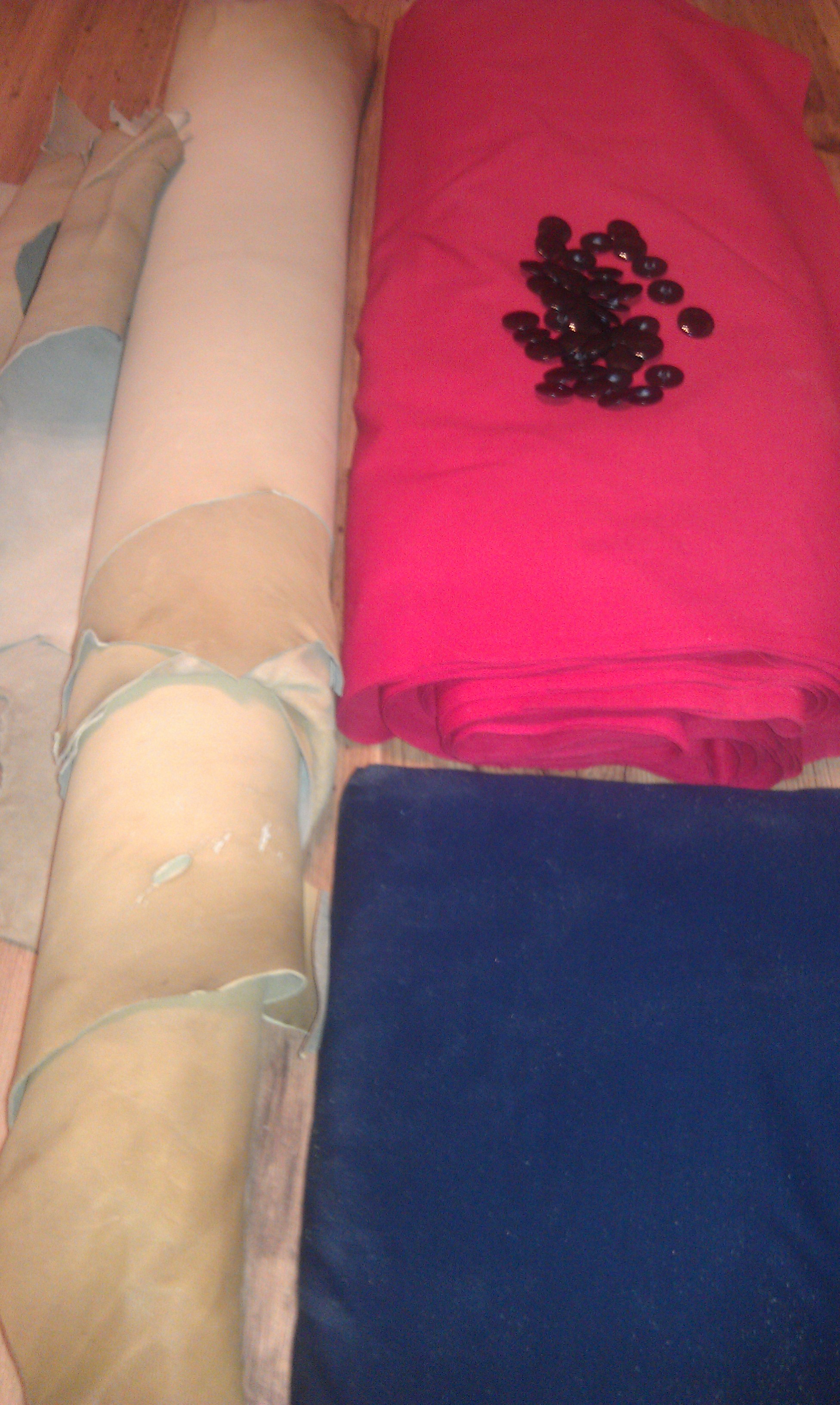

Alright, I got some new materials, so here's the whole happy little group:
Four full goat hides, six yards of heavy cotton (with special thanks to the ridiculously cute fabric store girl who got me a 92% discount!), 48 correctly sized shank buttons, and enough spandex to make two whole bodysuits, just in case.
The spandex has sort of a luster that gives it really cool color properties. I haven't taken any good daylight photos yet, but the color seems to be just about perfect on camera from what I can tell.
If anything ends up being too dark or saturated, I'm toying with the idea of letting it sit outside for a day or two to give it that nice sunbleached, worn-in-the-desert-for-100-years look, but that comes later.

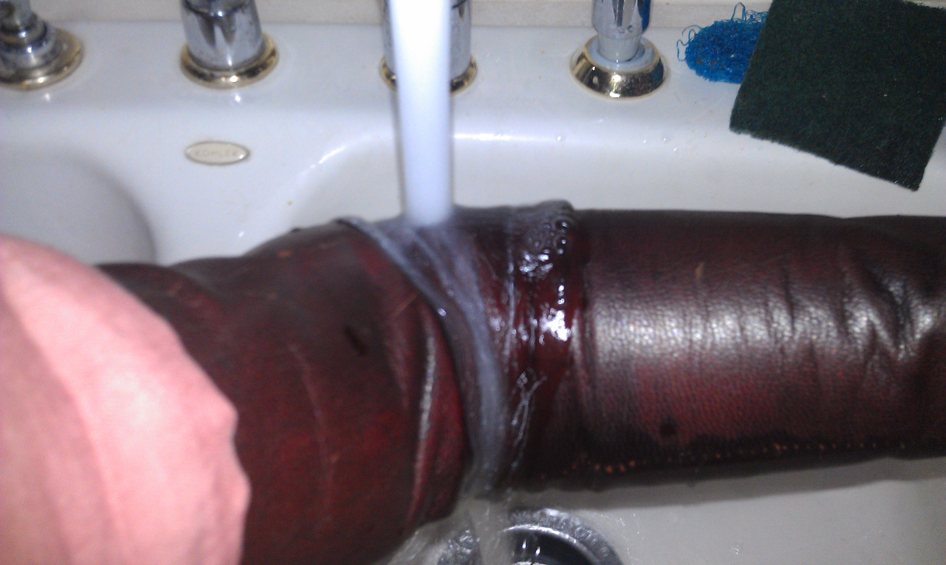

I got more work done on the arm. I sewed the seam, and although it fit pretty well, it was a little restrictive, so I wet-formed it to my arm:
After a couple hours of stretching, flexing, and asking passersby if they'd seen my beachball, it stretched enough to fit like a glove. A really long glove. Without hand-parts.

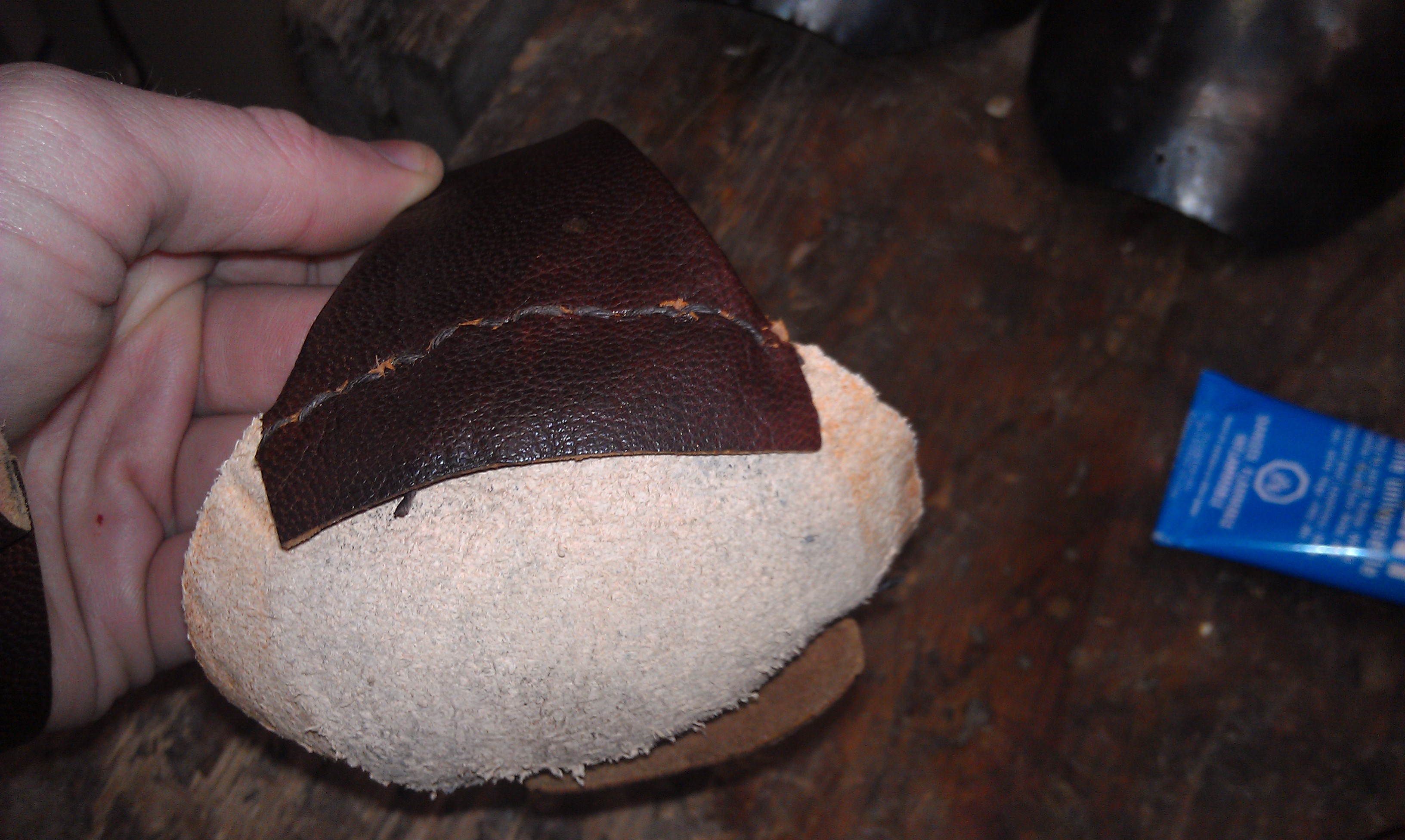

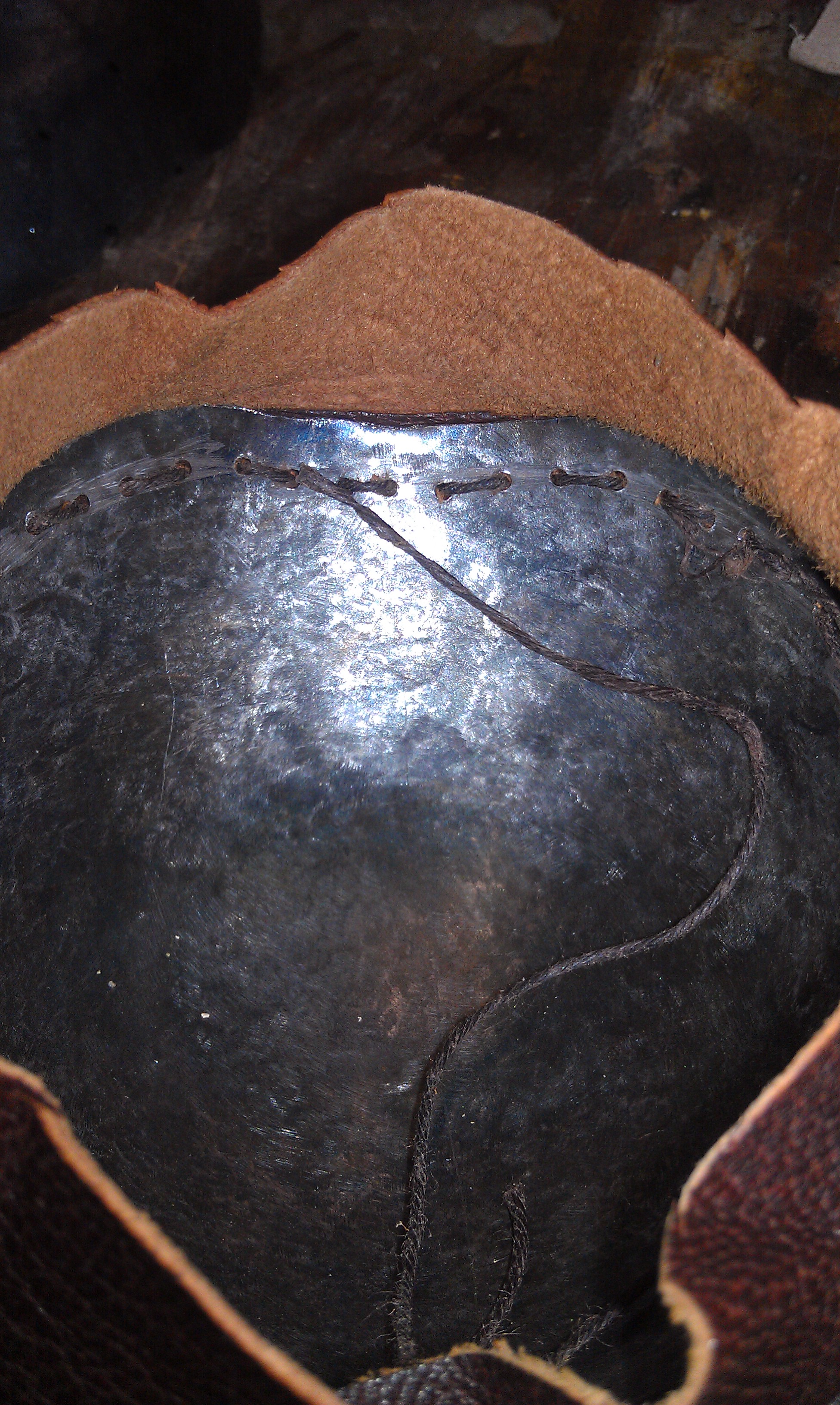

For the elbow and shoulder plates, I drilled tiny holes about 1/4" from the outside rim of the plate and sewed the goatskin liner straight through the steel. I folded the leather over and glued it to the inside of each plate to make a super-sexy hidden seam.
Not sure if I used enough clamps.

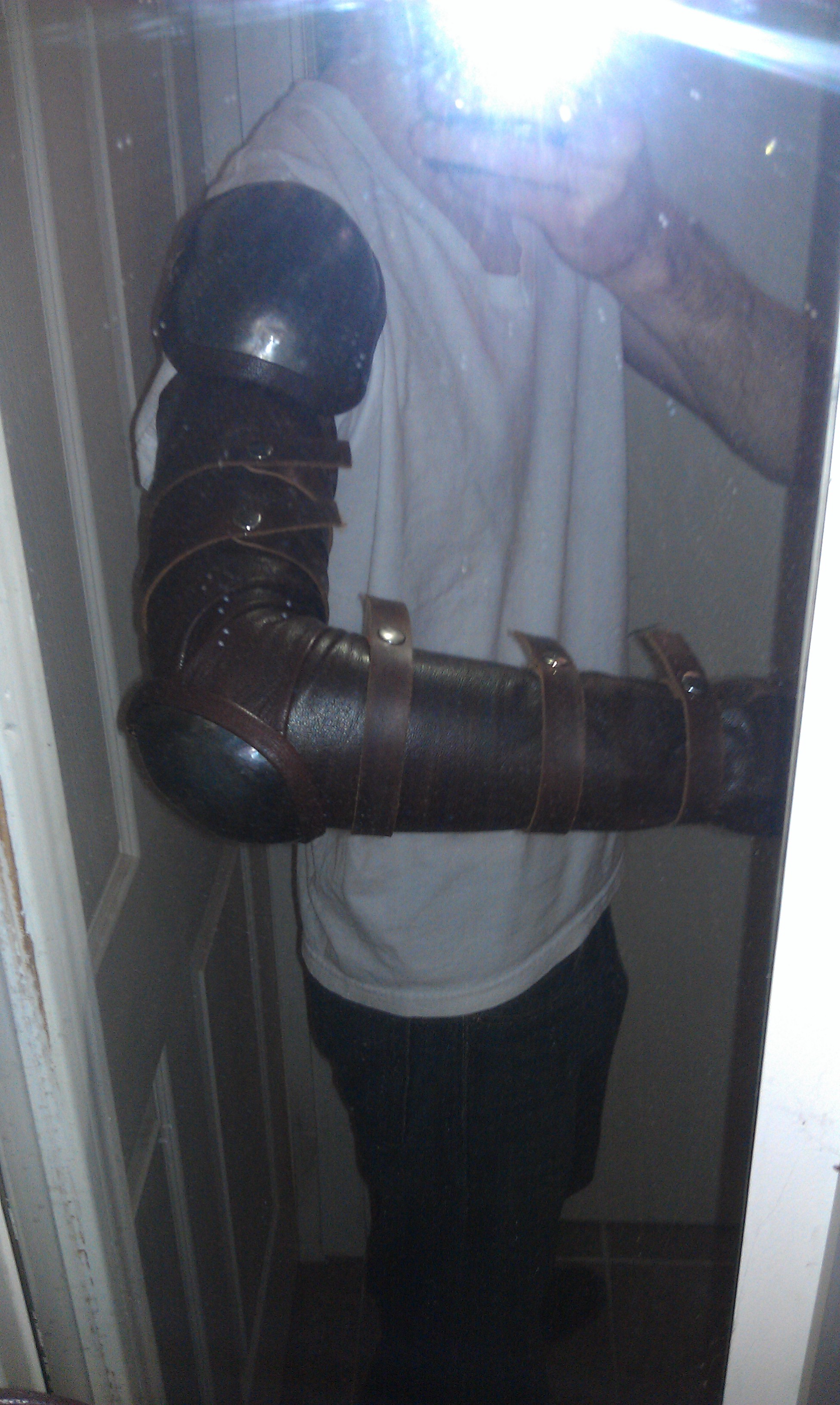

Now, the elbow pad is pretty much permanently attached to the elbow, but the method is different than you might think. The strap isn't sewn down; instead, it's pressure-fit to the elbow so it simply can't slide around at all. I made the tight-fitting strap and sewed it to a piece of thick leather, which I then formed and glued into the inside of the metal plate to act both as an anchor and as some cushy padding for my elbow:
View attachment 279924View attachment 279925

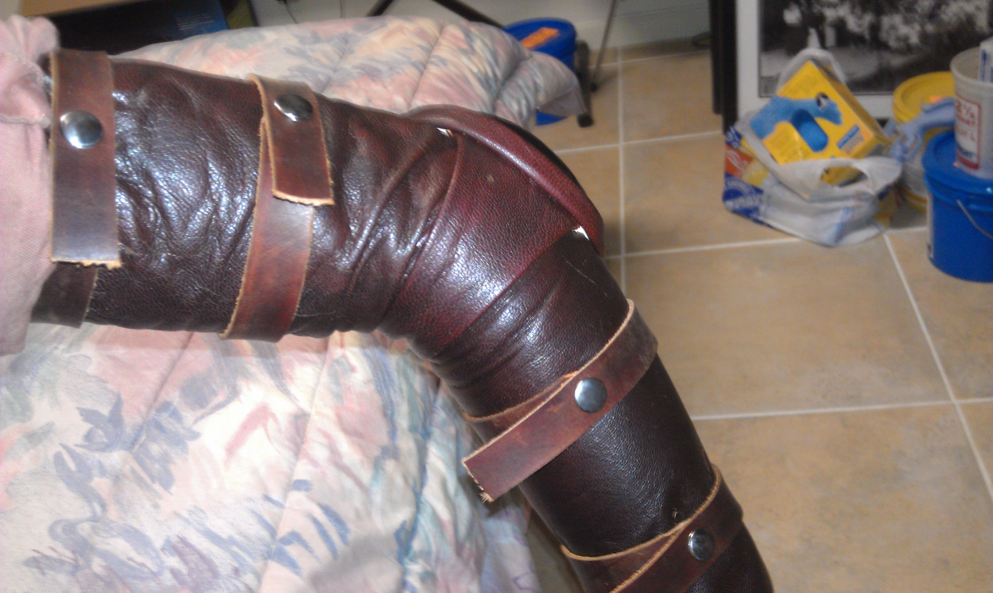

The result is absolutely PERFECT. It fits great, it doesn't slide around, it pivots precisely with my elbow, and my arm still fits to take off and put on the sleeve! Those concept artists really knew what they were doing!
Awkward-angle elbow shot:
The straps are secured to themselves with line 20 snaps. I still need to stamp them with a concentric circle design and add triangular strap ends.
View attachment 279930View attachment 279929
I attached the pauldron to the top end to keep good tension on the upper arm. This keeps it in position no matter how I move my arm, and it will improve even further when I add the chest strap that attaches to it. It even looks natural under clothing!
Here's some funky lighting to show the color range of the dye/oil mix I used. To the eye, it matches the color range in the show and artbook pretty dead-on. With one or two more coats of neatsfoot oil, it'll match in most camera situations too, and the oil will give it more depth for closeup shots.
I left the upper arm a little looser than the rest, since I plan on doing some serious upper body exercises over the next three months to make the undersuit fit properly.

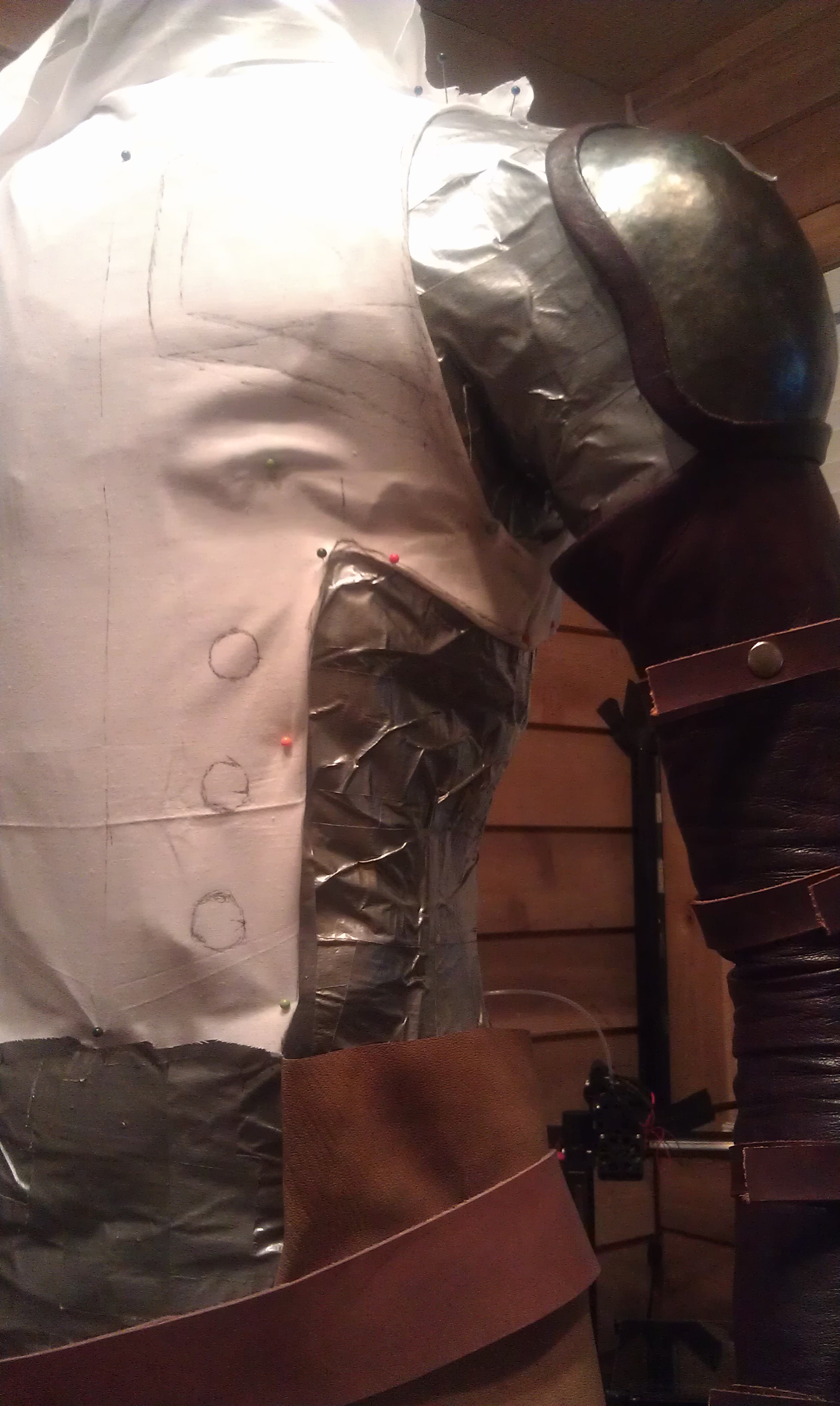

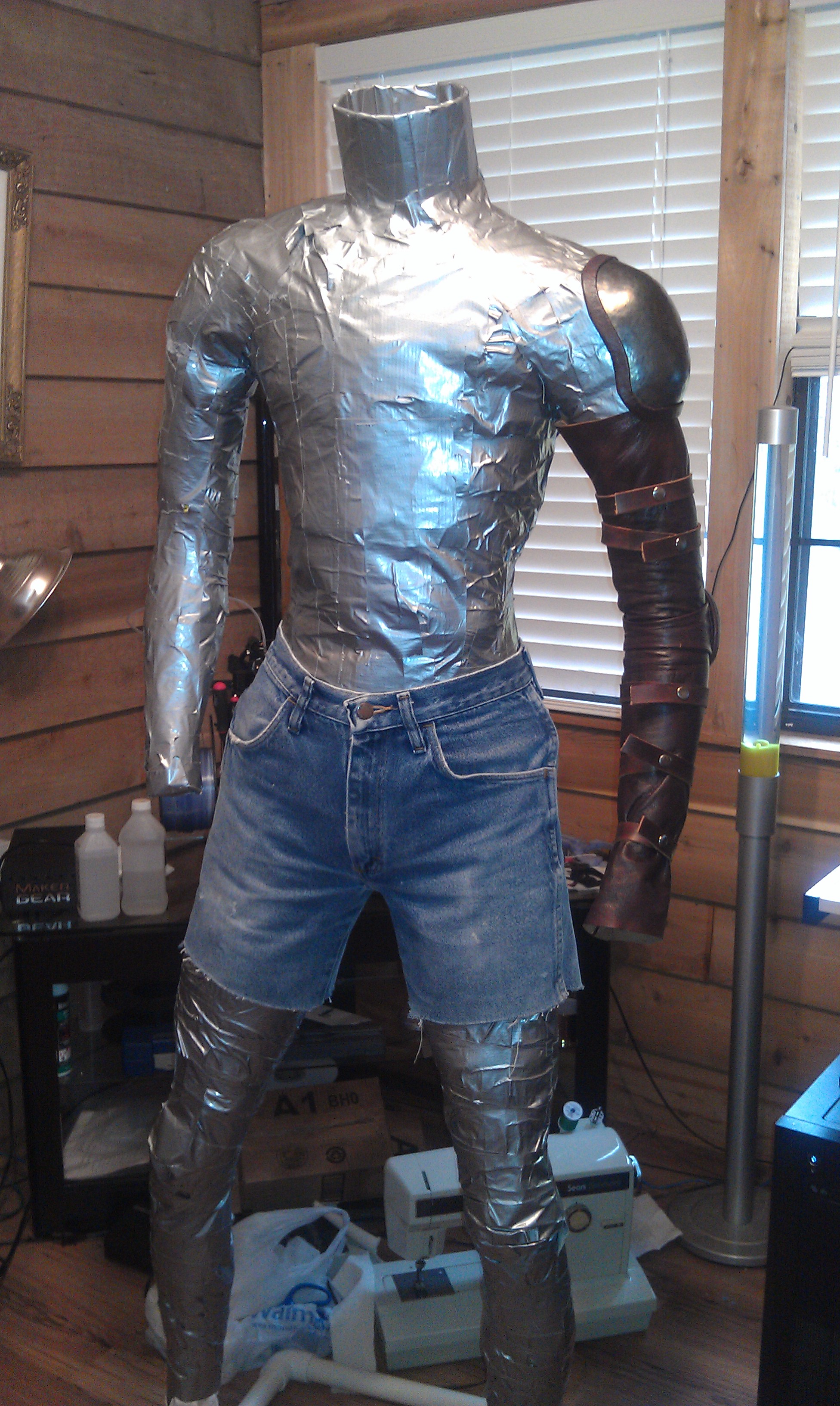

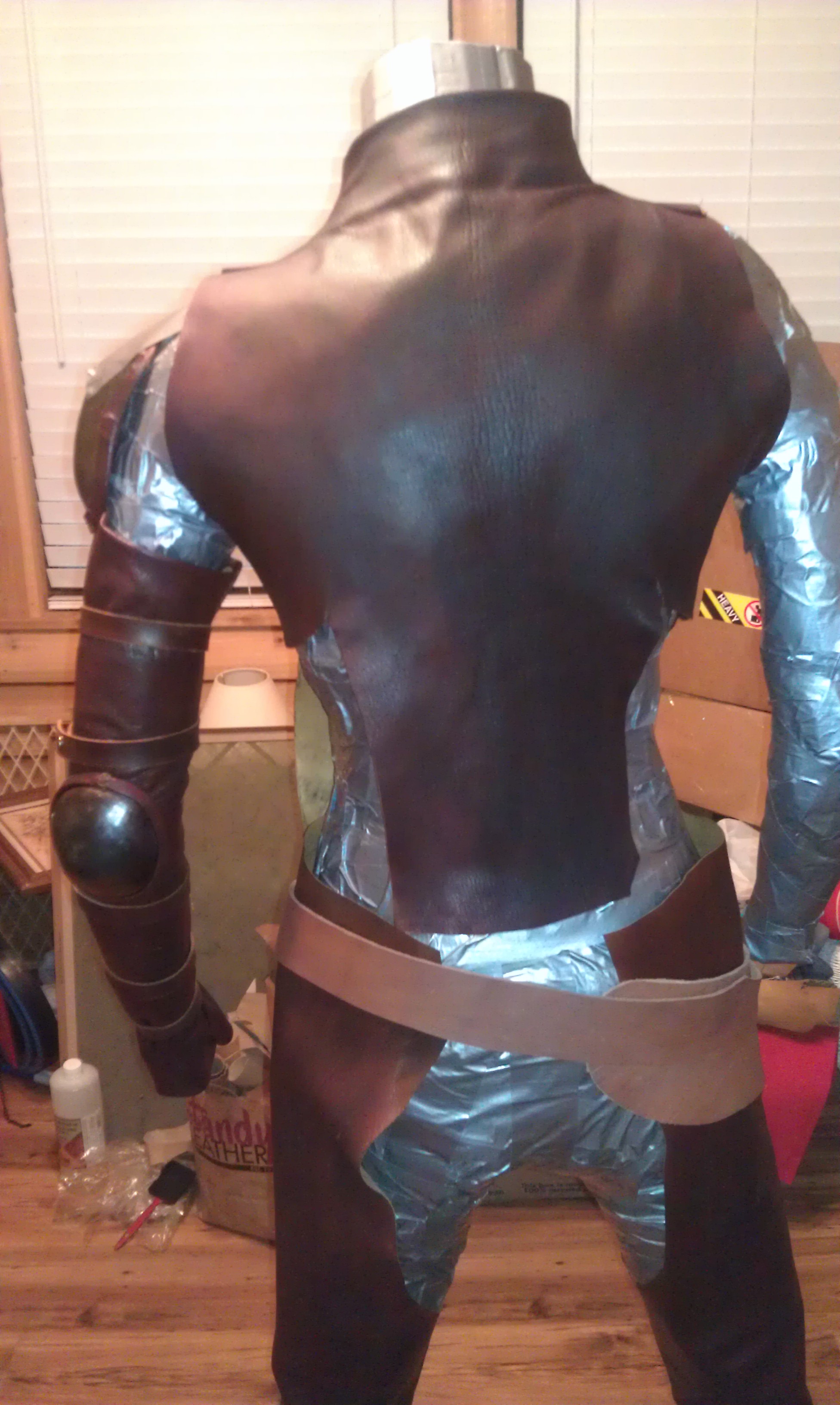

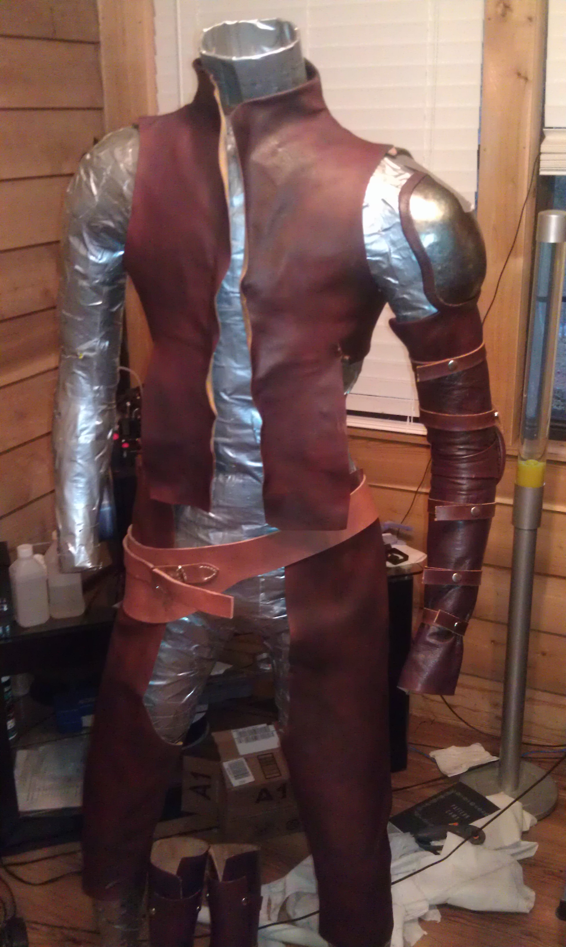

I started the undersuit this week, so it's time to bust out my custom-made Stand-O-Tron 5000:
(It apparently suffers a rare psychological affliction. There are dozens of them. Dozens!)

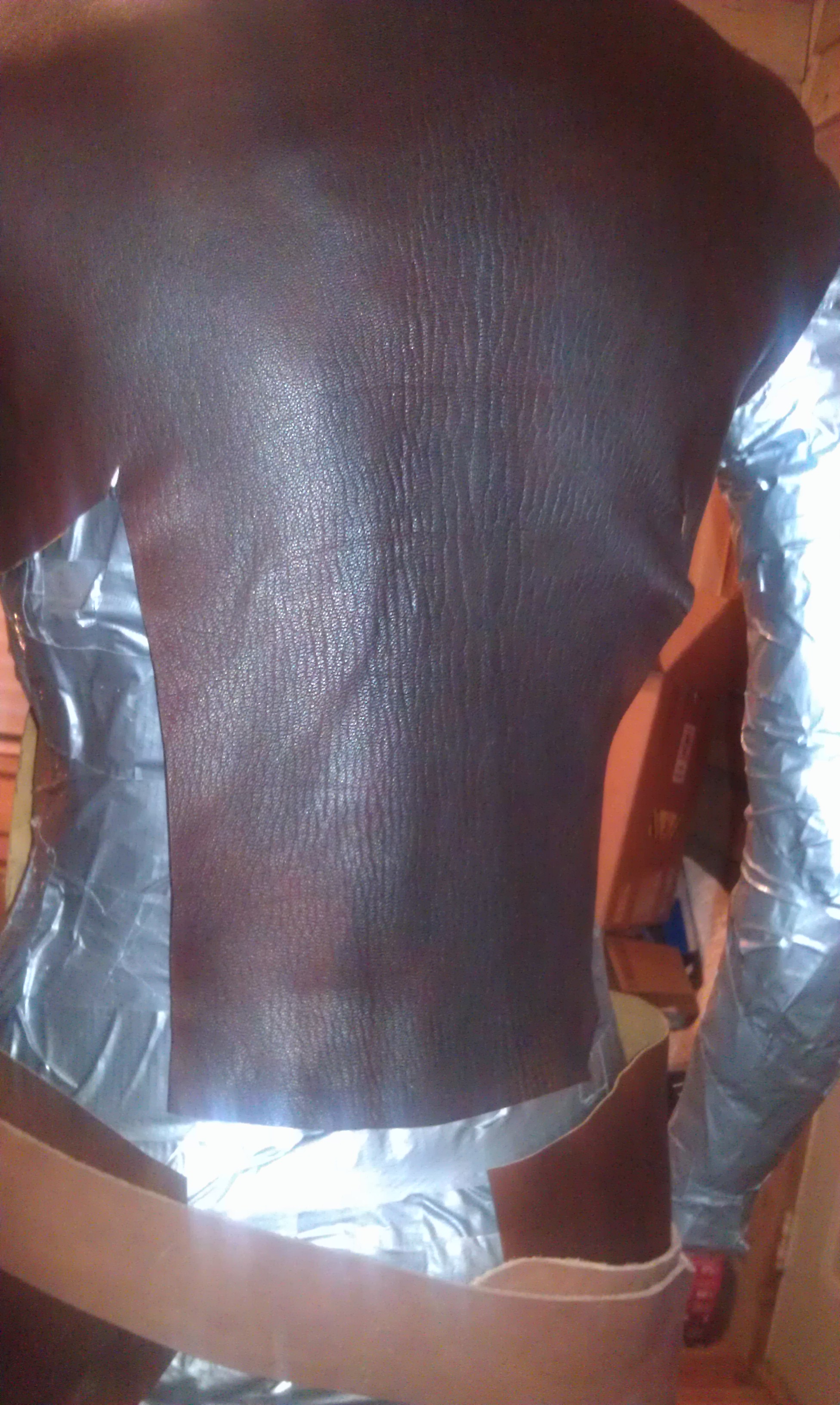

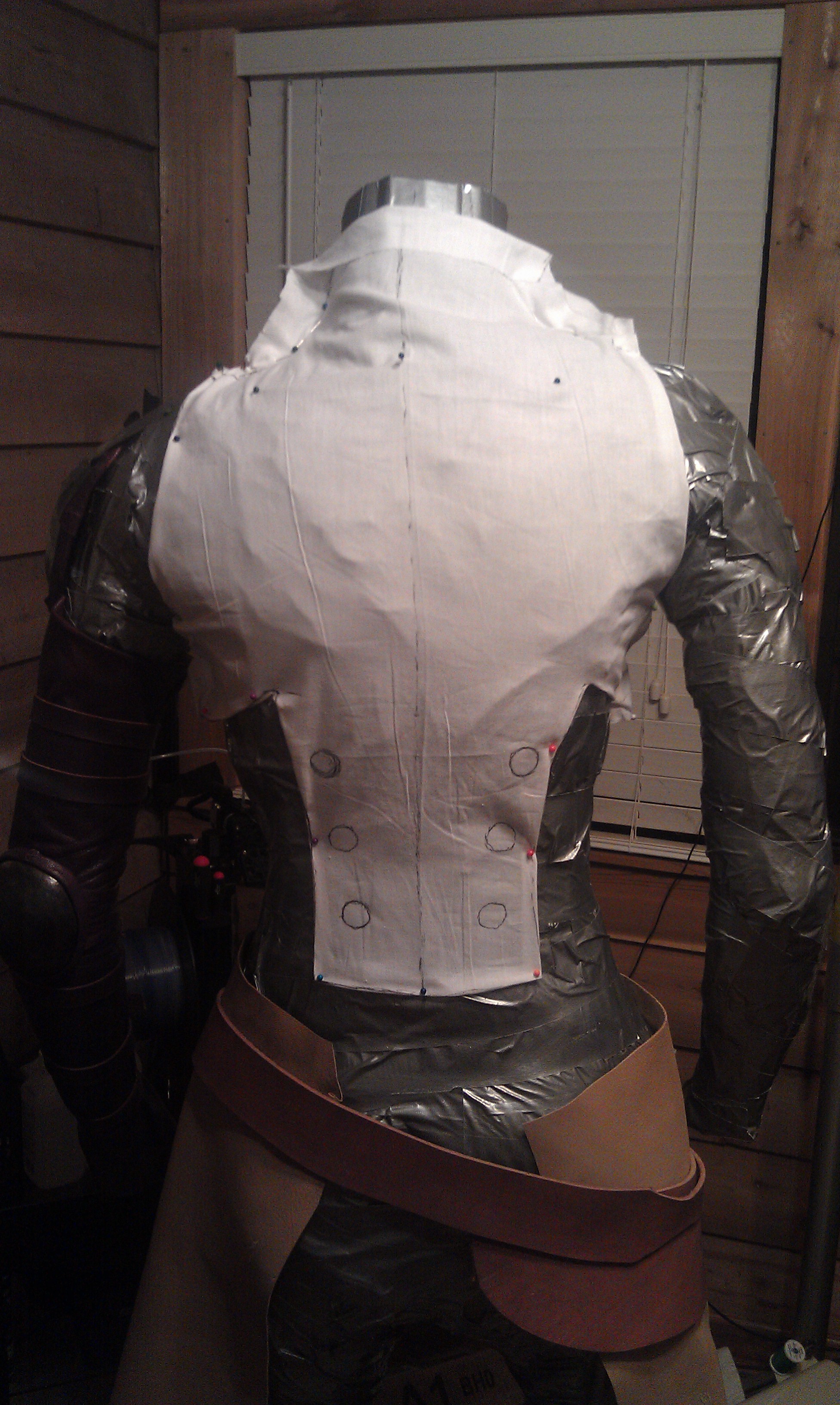

I decided to cut out the leather sections first to use them as a base form for the spandex. It's going to be interesting getting everything sewn together, but hopefully not too tedious.
To be honest, this is only the second time I've even used this mannequin for pattern making, and it turned out WAY better than I expected.
I bought the cheapest whitish muslin I could find, and after a day or so of checking proportional measurements with the concept art, I ended up with a useable pattern that's perfectly proportional to little ol' 6-foot-tall me (since Vash is over 7'10" tall).
(by the time I got to taking photos, I had already done the legs)

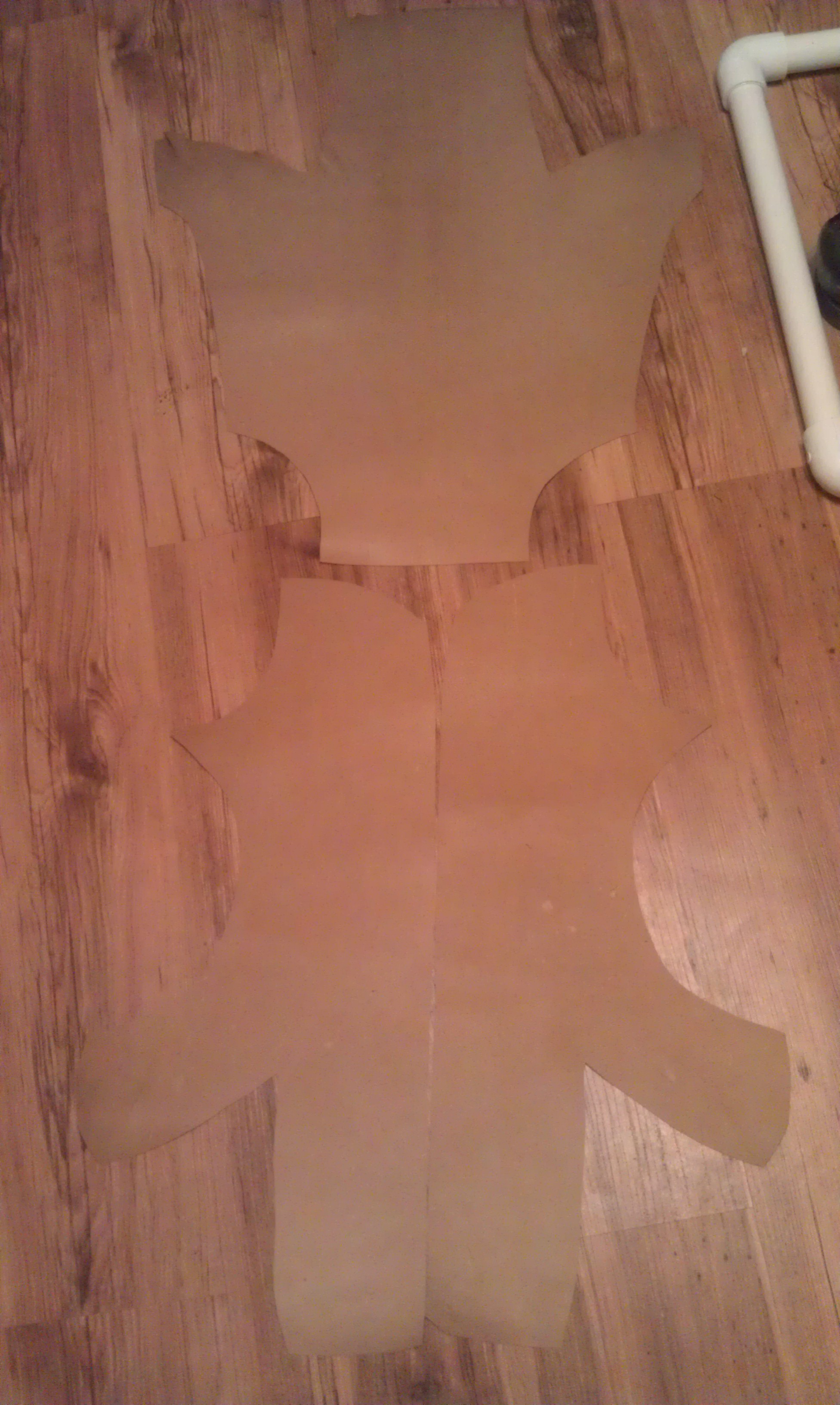

I cut out all the upper leather pieces and managed to get by with only using two goat hides for the entire undersuit! Yay geometry!
I dyed all five pieces using the same process as with the arm sleeve and sewed everything together with ultra-heavy-duty thread.
At this point, the legs fit fine, but the upper half was just a little too tight. Now, garment-weight goatskin gets very stretchy when wet, so I did what any sensible man would do and stood in the shower wearing my new ultra-tight sexy leather vest (sorry ladies, no photos).
After a few minutes of asking even more passersby if they'd seen my beach ball, the leather was perfectly formed to my body, and I stretched it out over my mannequin to dry in shape:
So that's the undersuit so far. I left a 3/4" allowance along each edge, since the edges are folded around and sewn in on themselves.

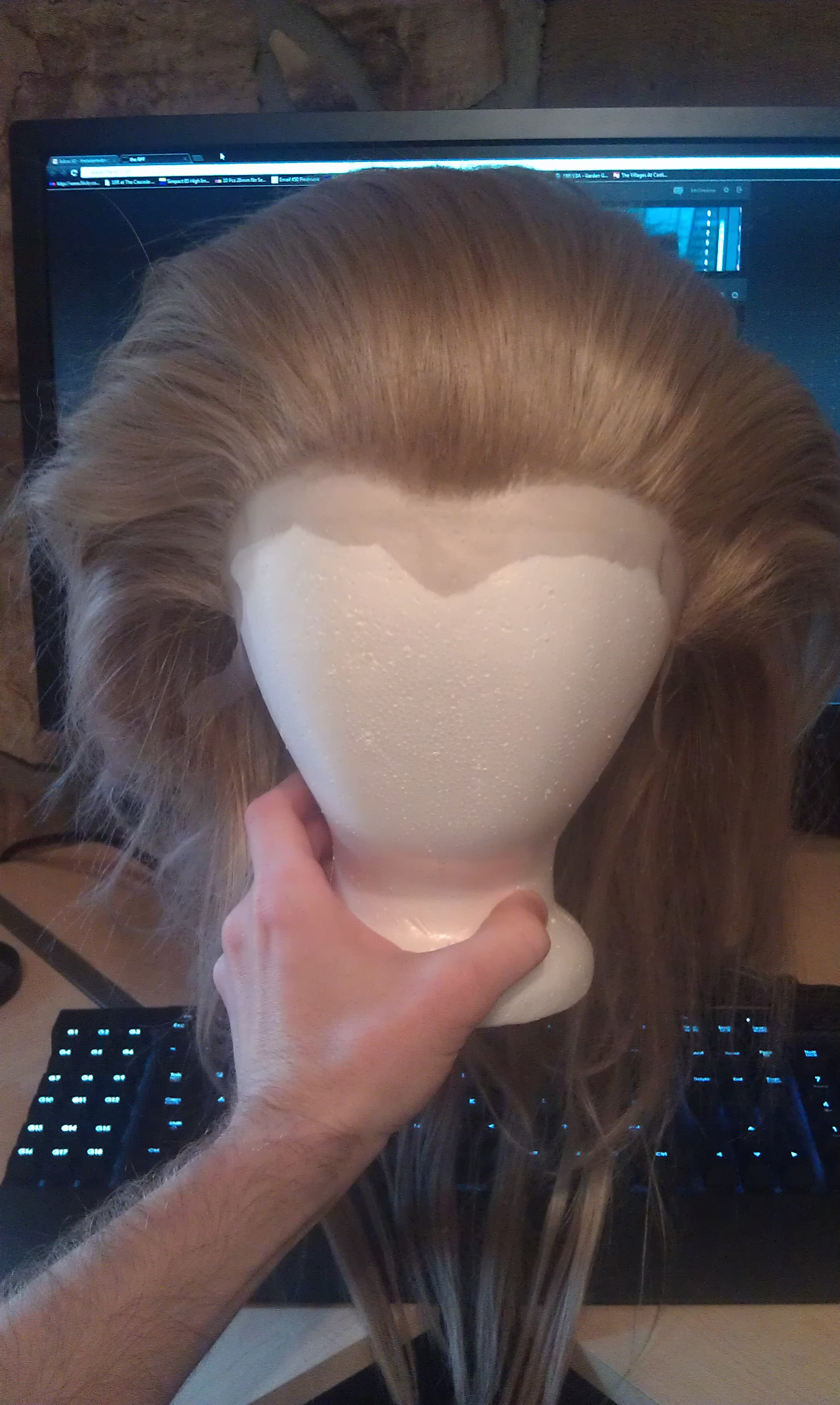

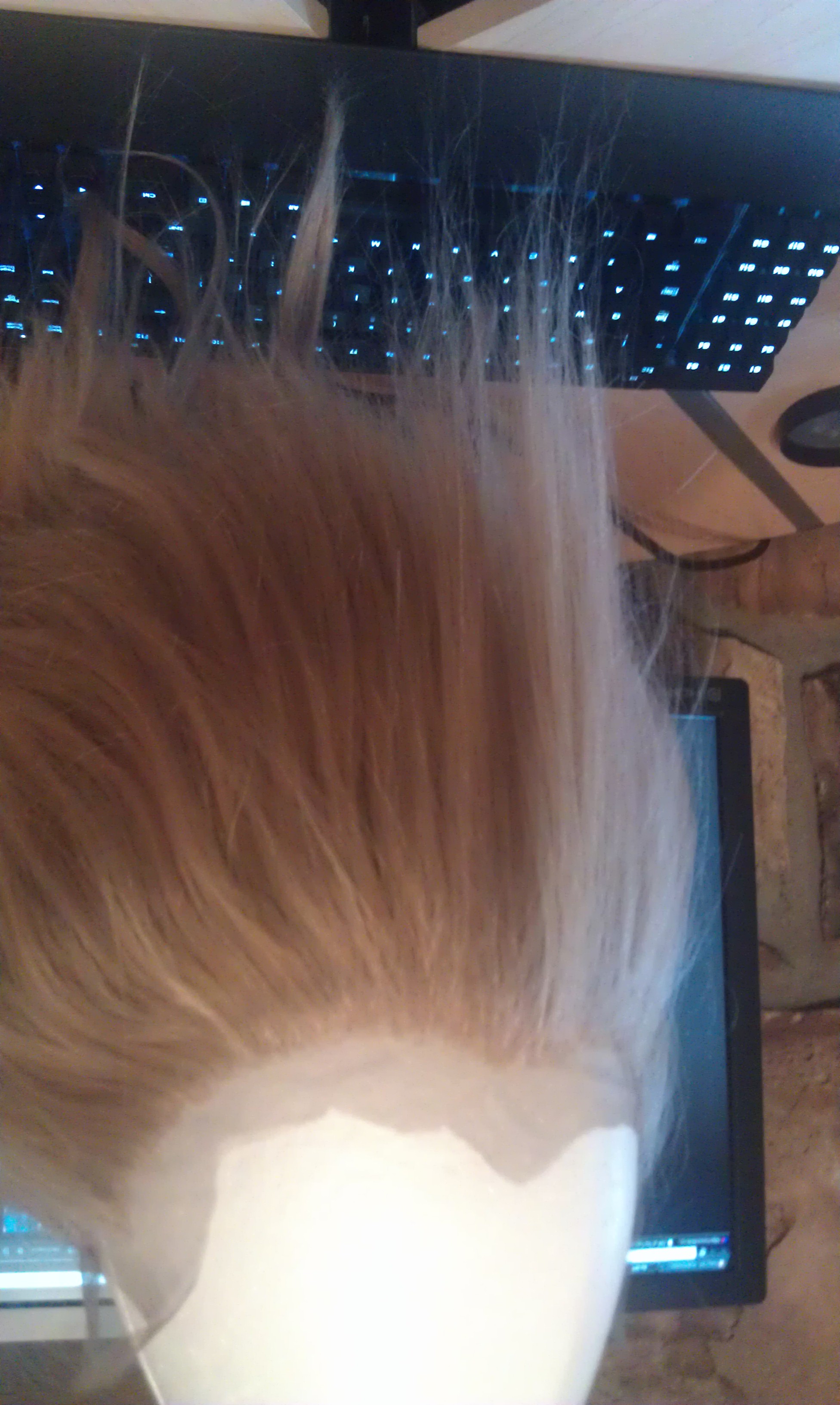

Now, the Morpheus, being a lace-front wig, is designed to have hair added to it in a custom hairline along the front, which for most styles looks fine:
The default wig does, however, come with a super-lame flat hairline, and Vash's hair is spiked up all around, not just along the front.
Solution: turn the lace-front wig into a completely lace-edged wig. No big deal, all I had to do was carefully cut the seams of all the edge-wefts and rip apart my crazy-expensive new wig.
And so, with a single manly tear, I took a razor to it, ripped off all the edges, and rebuilt it better than it was before by sewing in the extra lace that was cut off the front edge. The edge wefts were then sewn back on facing upwards like the rest of the wefts so they can be perma-spiked.

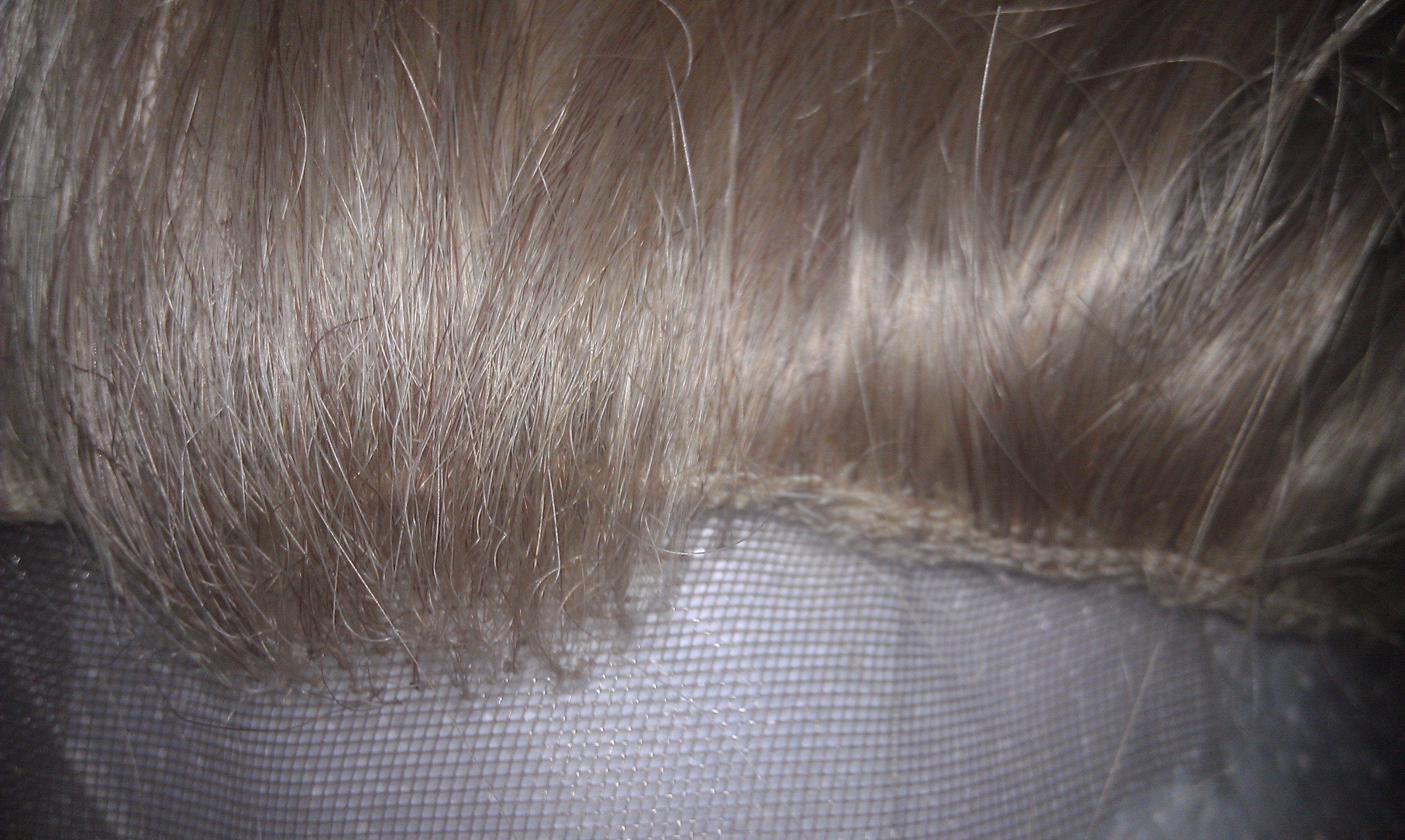

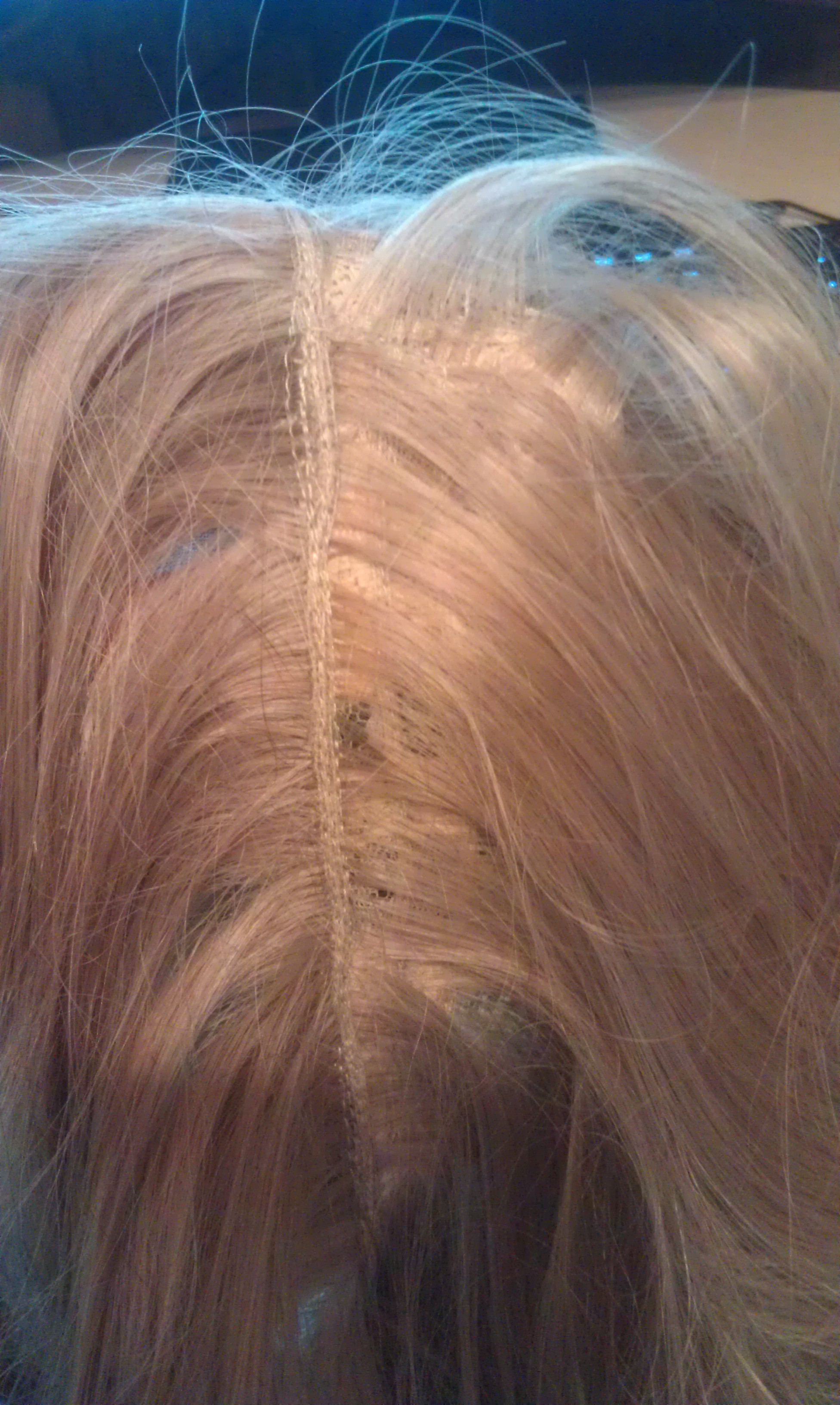

Here you can see how thick the hair is with the doubled-up wefts:
Basically, the process is pretty simple: start at the innermost edge of the lace, tie in a couple hairs, move down one or two fibers of lace, repeat as necessary until you can no longer see the sewn edge of the weft. Here's an example from the back:
..yeah, it takes a long time. For example: the square inch in the above photo took about an hour.
I spent a couple of days working on the front hairline to make it match the concept art. It's much better now than it was out of the box, but it's still got a LOT of work to go before it's ready for cutting and styling.
The extra lace you see is just to be safe and will all be cut off once the hairline is finished.
After that, I'll sew in the rest of the extra wefts I bought to add more volume to the back, which is still a bit lacking.

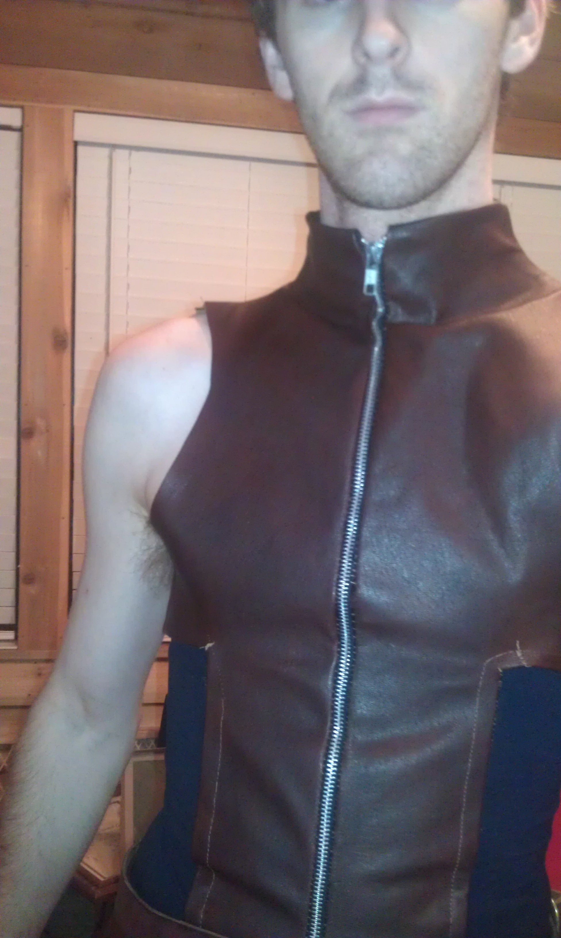

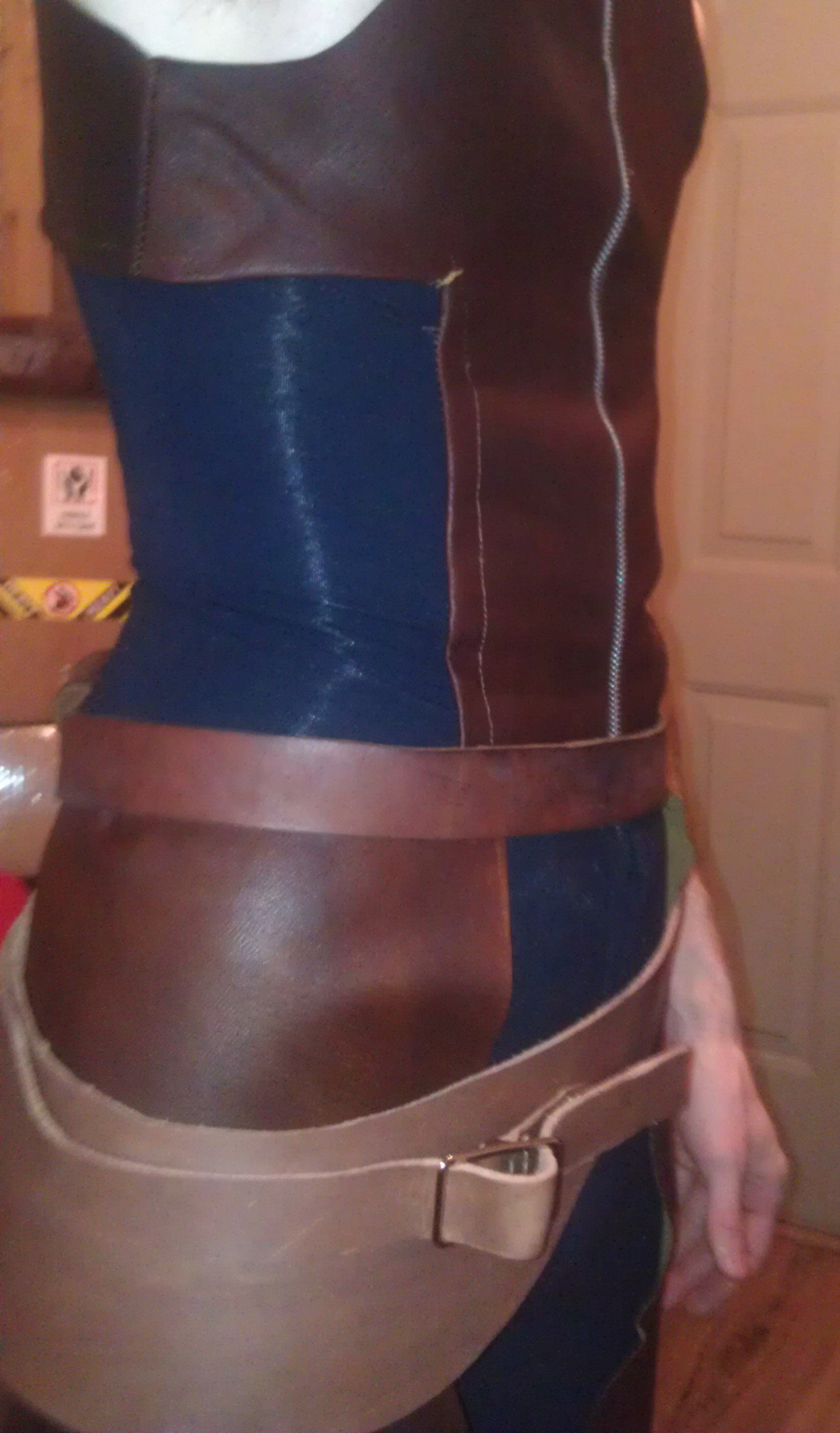

Quick update: undersuit test fit success! At this point, it's about 3/4 done.
Taking selfies with no mirror and poor lighting is hard. Also, I really need to shave.
Spandex is surprisingly forgiving and easy to sew without a serger, as long as you use a good stretch stitch. I learned that the pants are designed after buckskin riding breeches, and as such they don't have an inseam.
I still need to sew on the leggings, chest/back pads, and straps/belt before cleaning up the seams. Then I'll do a full-body fit test and start the kneepads and lower-leggings.

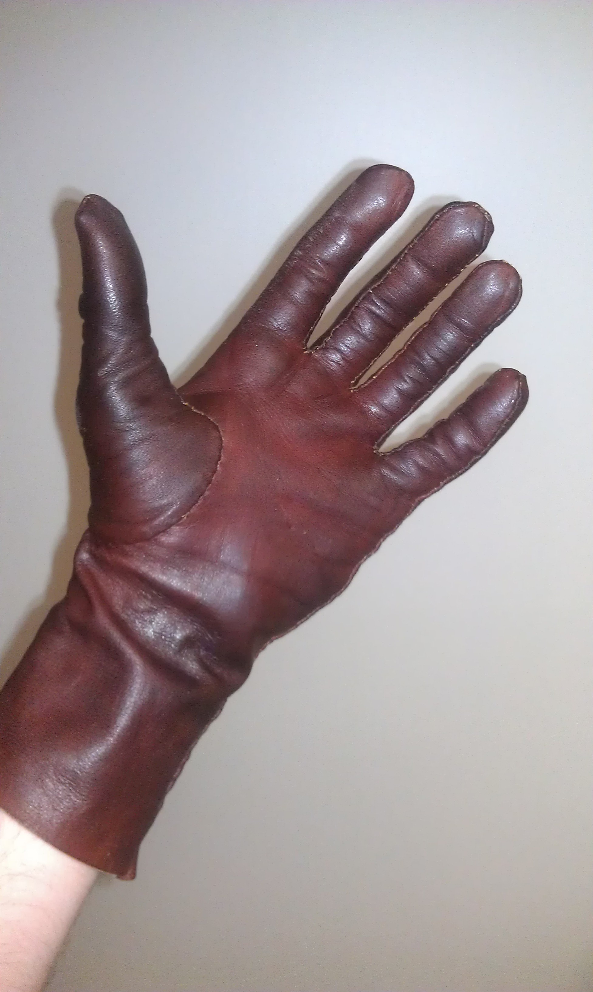

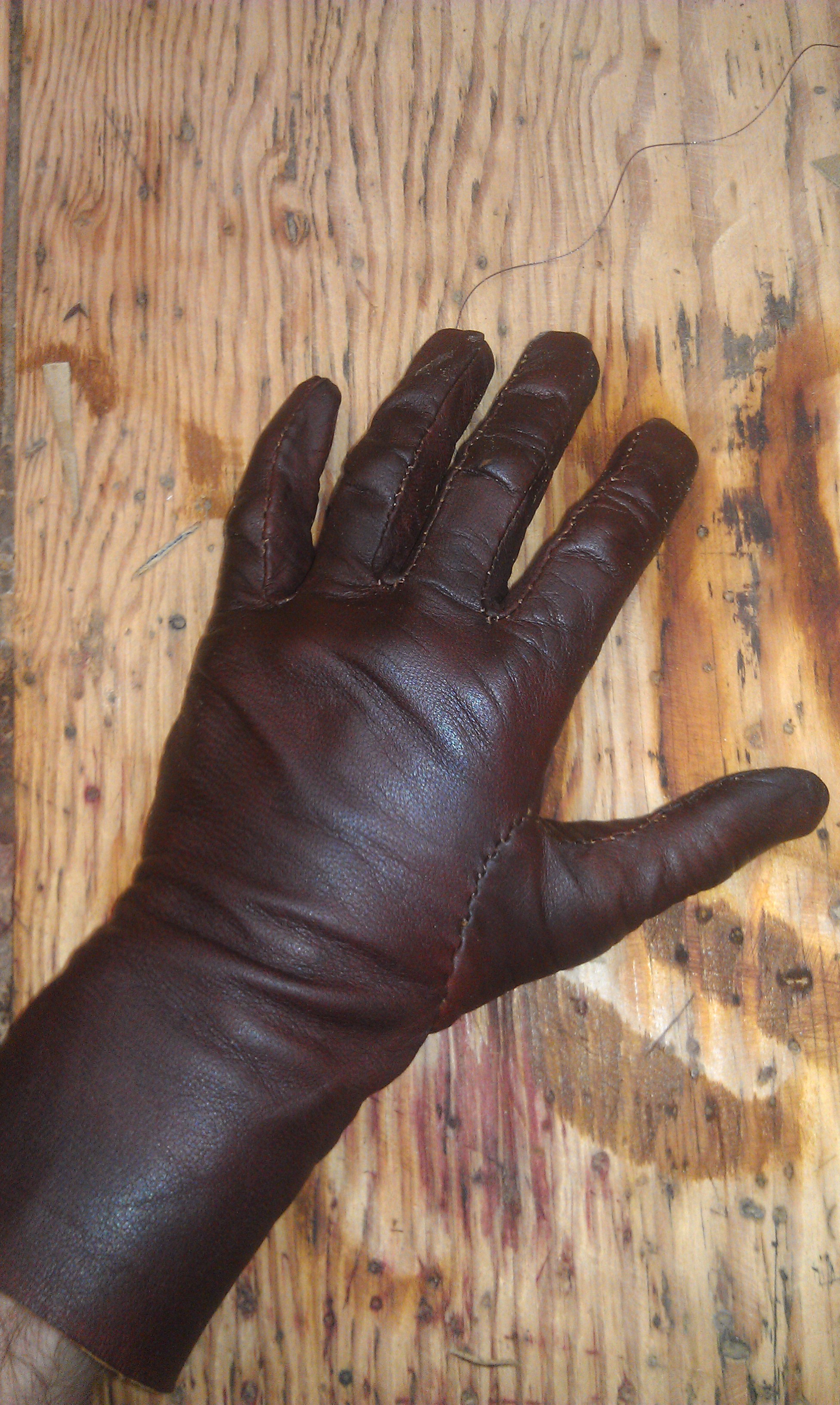

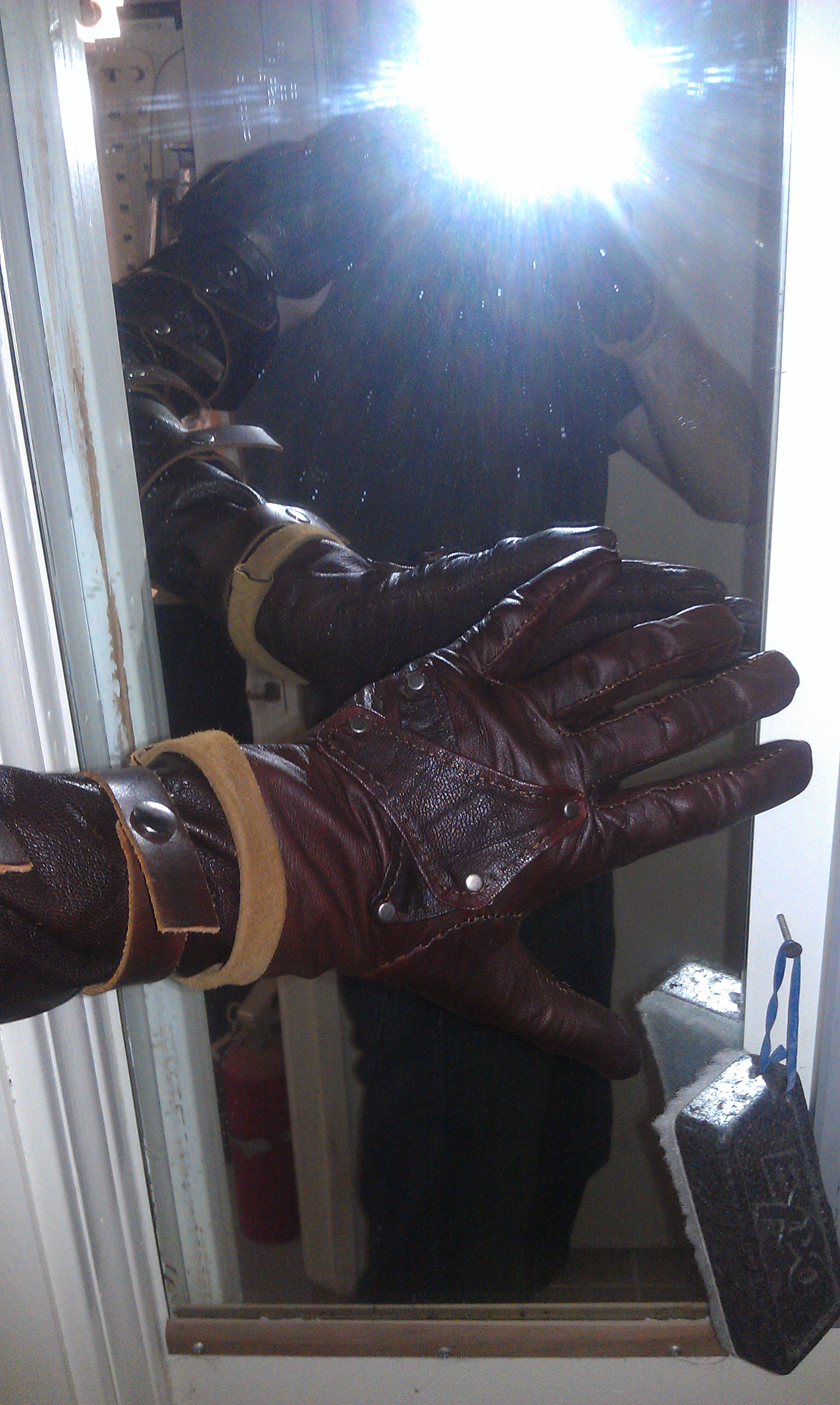

How about some gloves?

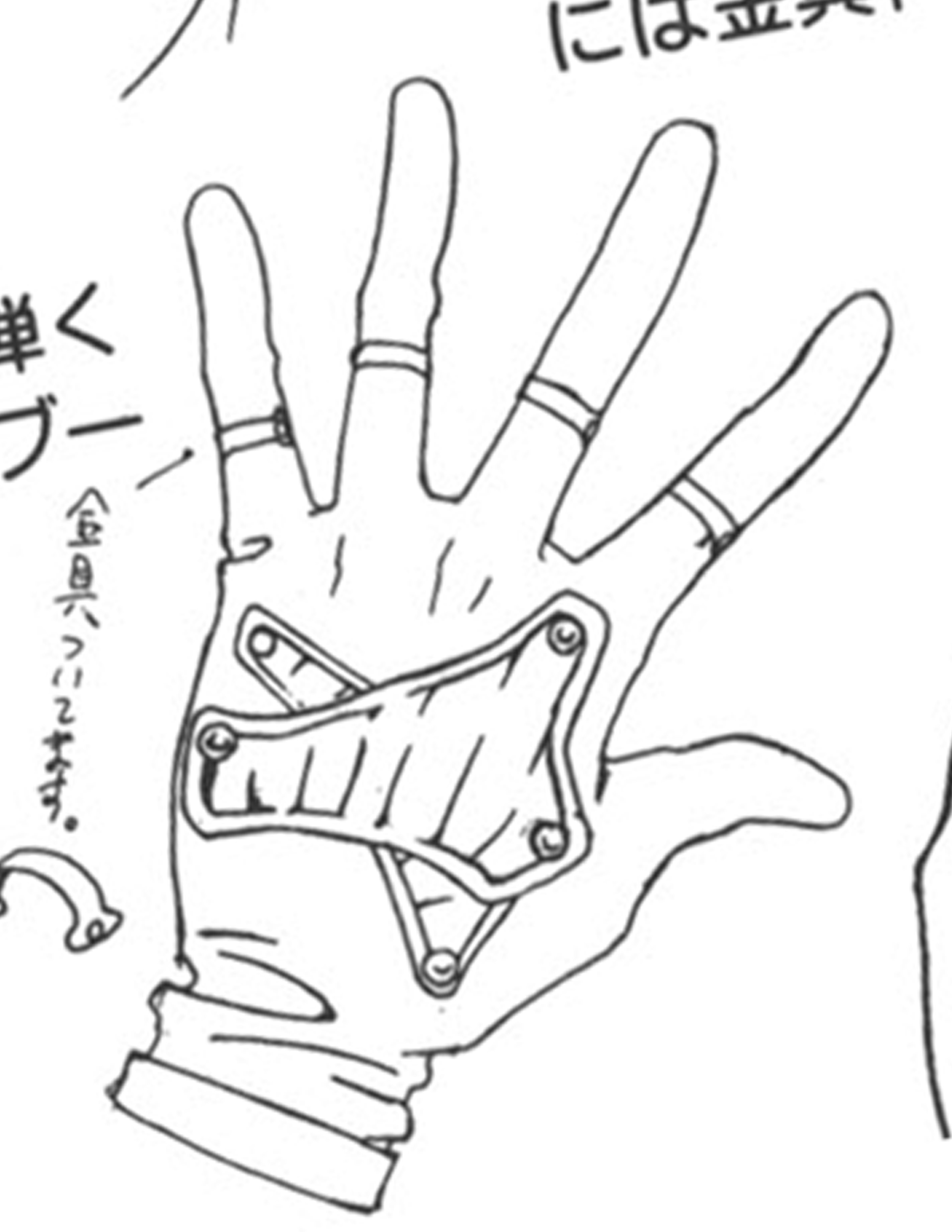

It really bothered me that I've never seen anyone do the gloves right. I went straight from the concept art for these by scaling the detailed closeup to my hand:

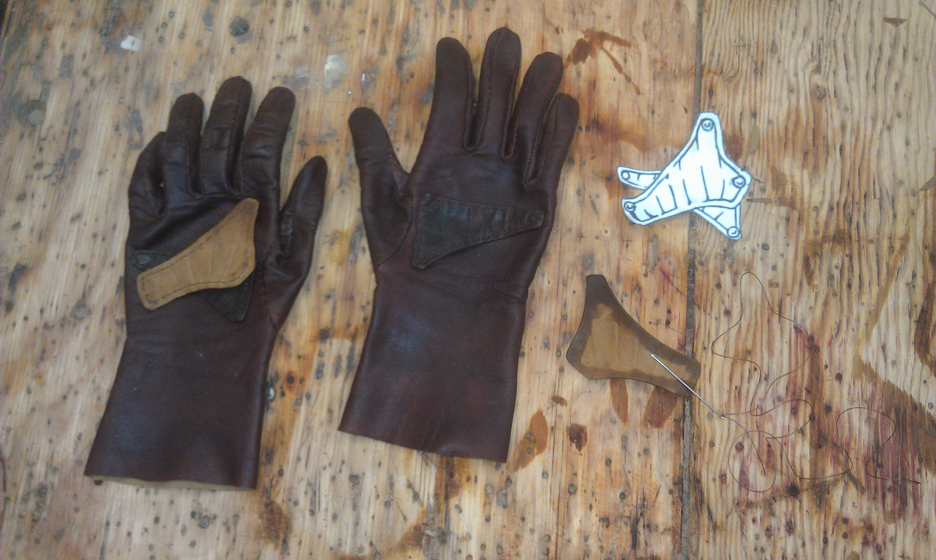

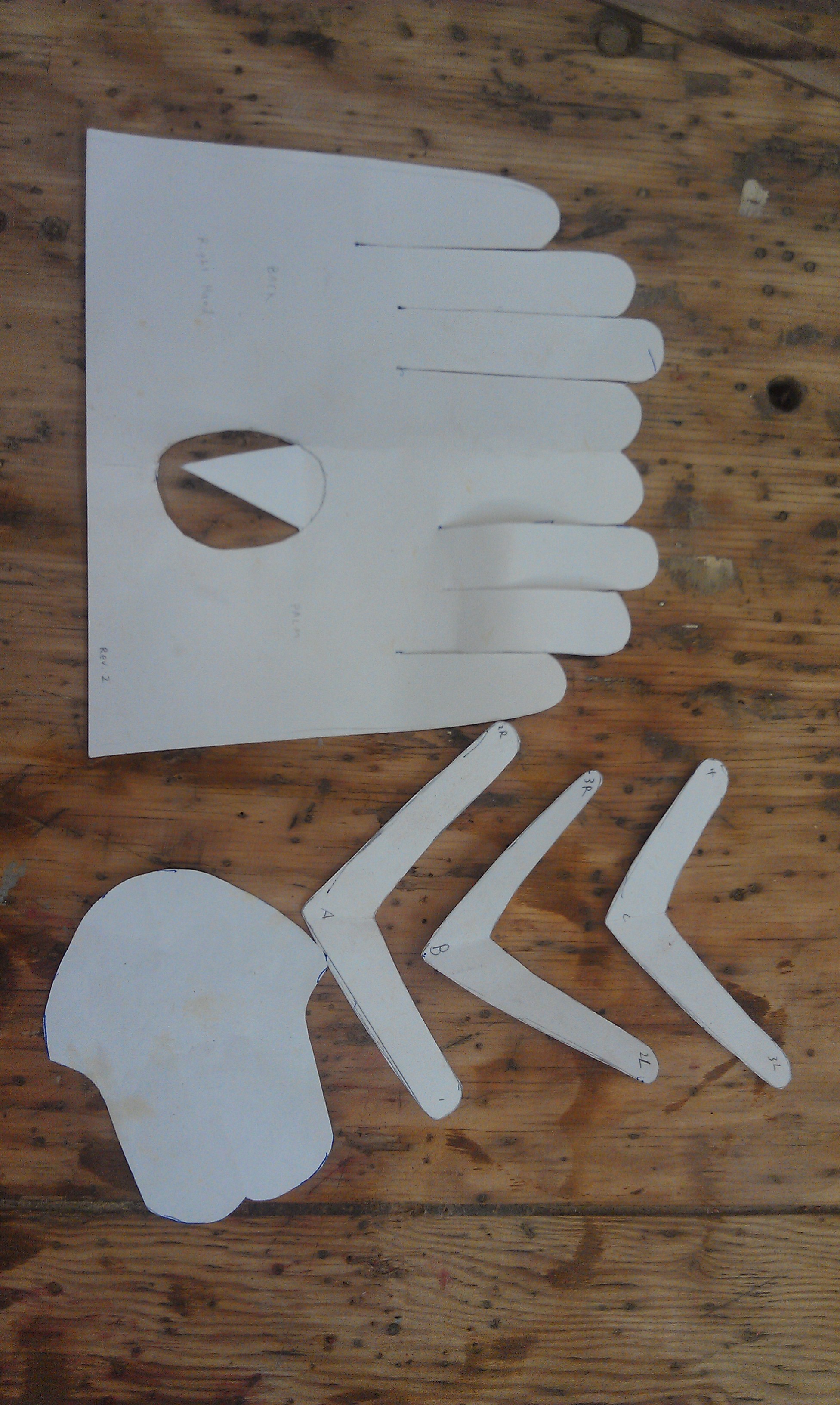

I spent a little time learning how to make tight-fitting glove patterns, and after three revisions and a fabric test-glove, I ended up with the final patterns:

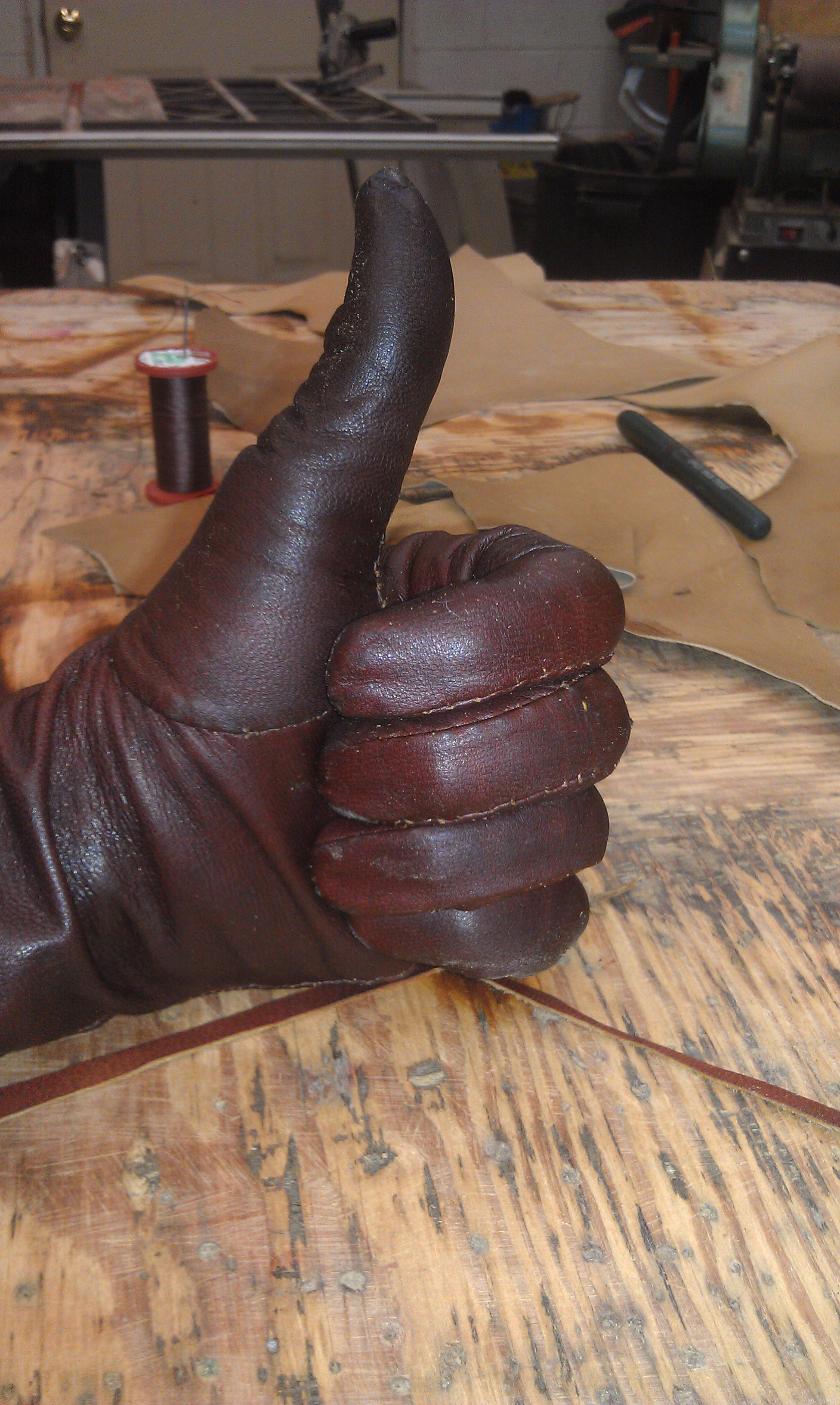

The trick to making gloves is to use the thinnest leather possible, and it has to have some stretch to it. Before cutting out the pieces, I wetted and pre-stretched the goatskin to keep the stretch constant.
After that, it was just a matter of sewing together the thumbs, fingers, fourchettes, and sides, then flipping everything inside out and adding some neatsfoot oil (oh, the neatsfoot oil!)
Fits like a... well, glove.
I left the gloves a little long, since the cuffs appear to be rolled up. This actually adds tension to keep them tight below the wrist.

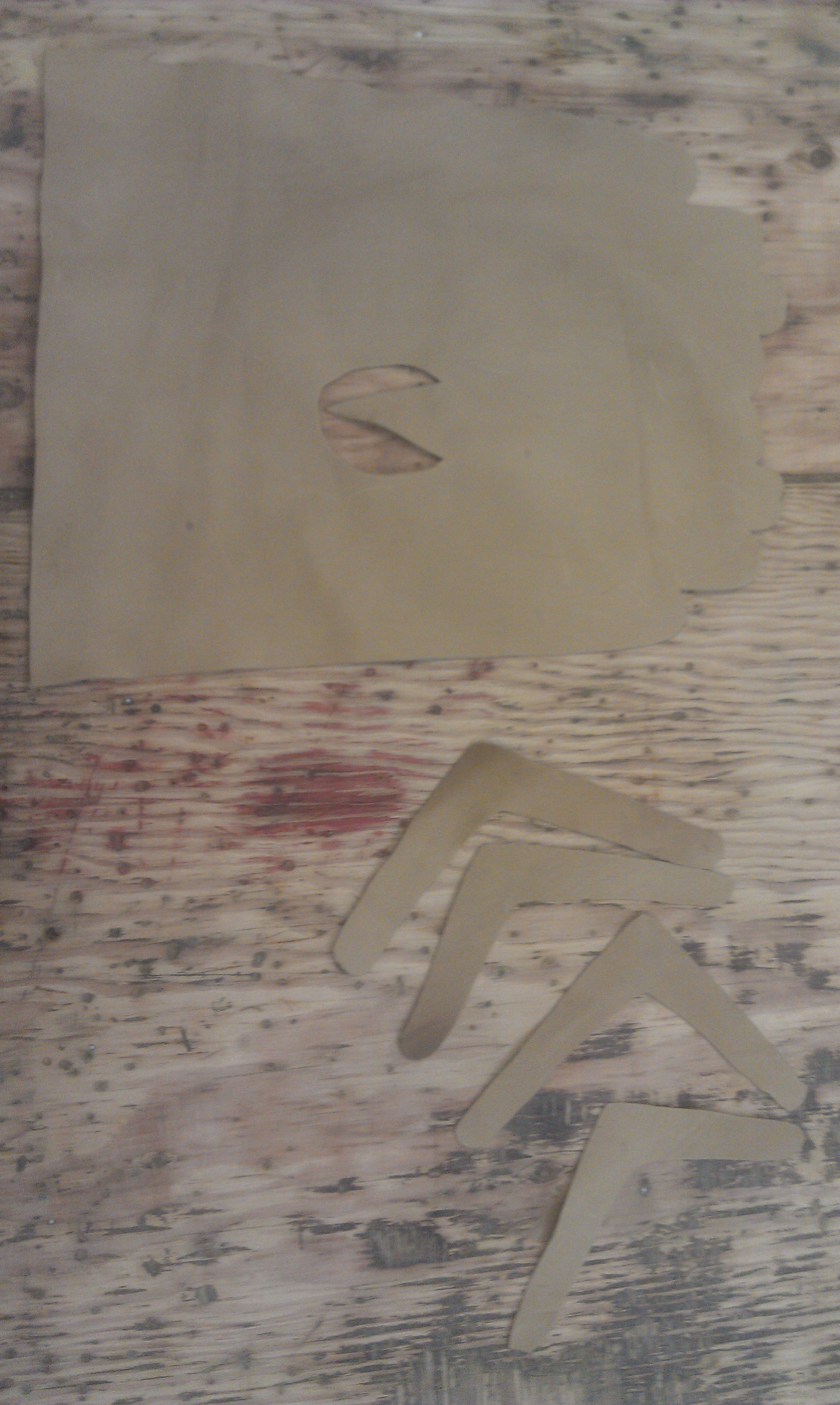

For the patches on the back (which are there to cover some awesome scars), I used the scaled art as a pattern.
I cut the patch pieces out of a different hide that had a rougher texture for contrast. I also added the lines by folding them wet and giving them a couple solid whacks with a hammer. Sew the edges, rivet them on, and voila!
(yes, both gloves are there, but photos...)
Like so many other parts, they're at about 90%. I'm waiting on some brass tubing to arrive so I can cut out the finger rings, and I'm debating whether to dye the inside of the cuffs or to just oil-darken them.
Either way, I really want to wear them everywhere :)
