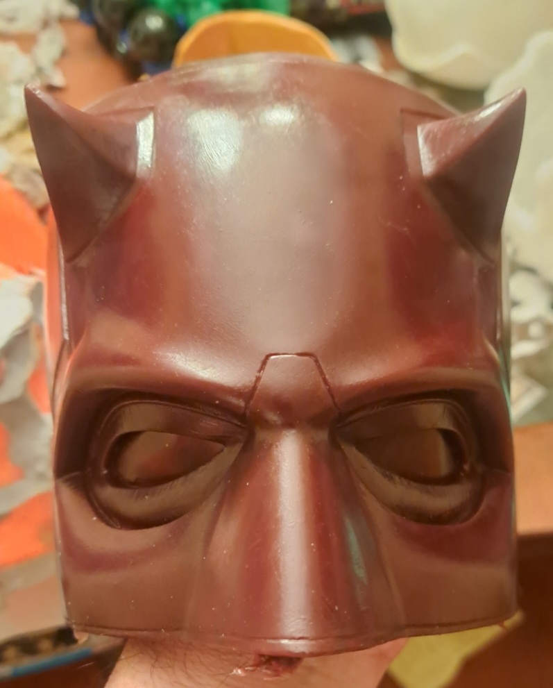

I like using Task 16 urethane rubber for slush casting things that roughly hold their shape, but are also a little flexible.
I just made some Daredevil helmets, and poured 4 oz into the mold and gently swished it around to fill the inside of the mold. Add another 4 oz, and try to spread evenly inside. I think I did four pours, 16 oz.
When you have something that has a larger inside than outside (no, not a TARDIS) I'd recommend Task 16 if the inside is only slightly larger.
If alot larger, Id use Dragonskin or Eco-flex.
