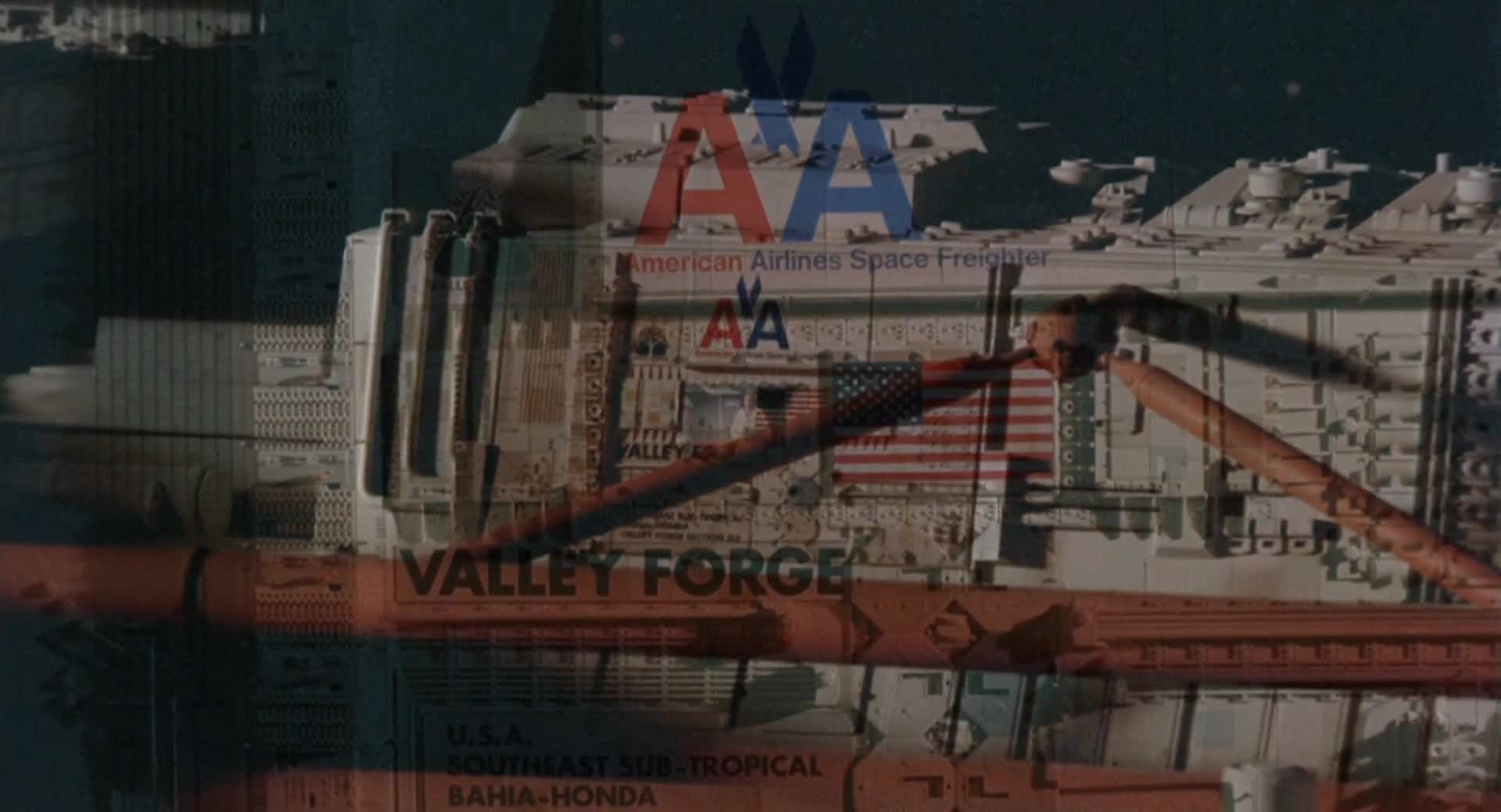

Returning to this for a bit I scaled out the panel as seen on the side of the ship to be about 40.4" by 26.4" Although that's adding a little on the bottom to not cut the octagonal pieces.

Yesterday I added 2 stills from the movie to my montage, scaled it as best I could to one kit part I had a photo of and then printed it out.
It'll be a big piece but not out of the question.

Hi Lee,
It was great to meet with you at Wonderfest....missed you in the bar Sunday. Thankx also for the patches.
I have some more data for you on this project. The lettering below the "Southeast Sub tropical '
reads "BAHI - HONDA" and below that "VALLEY FORGE SECTION 343" ...I think its "343"
See pics attached.
Stay in touch...
Tony
