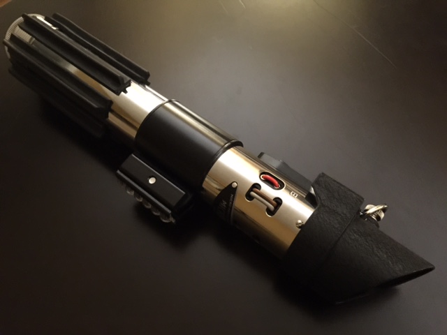

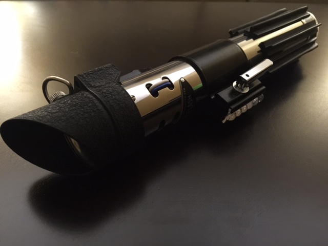

Finally got my shroud from Roy along with some wires that MCM so graciously sent me and I took some pics! Very excited to have this Parks build basically done. I'll be replacing the rubber grips and putting the circuit board under the bubble strip soon but for now, here it is.
http://www.therpf.com/attachment.php?attachmentid=537241&stc=1
http://www.therpf.com/attachment.php?attachmentid=537240&stc=1
http://www.therpf.com/attachment.php?attachmentid=537239&stc=1

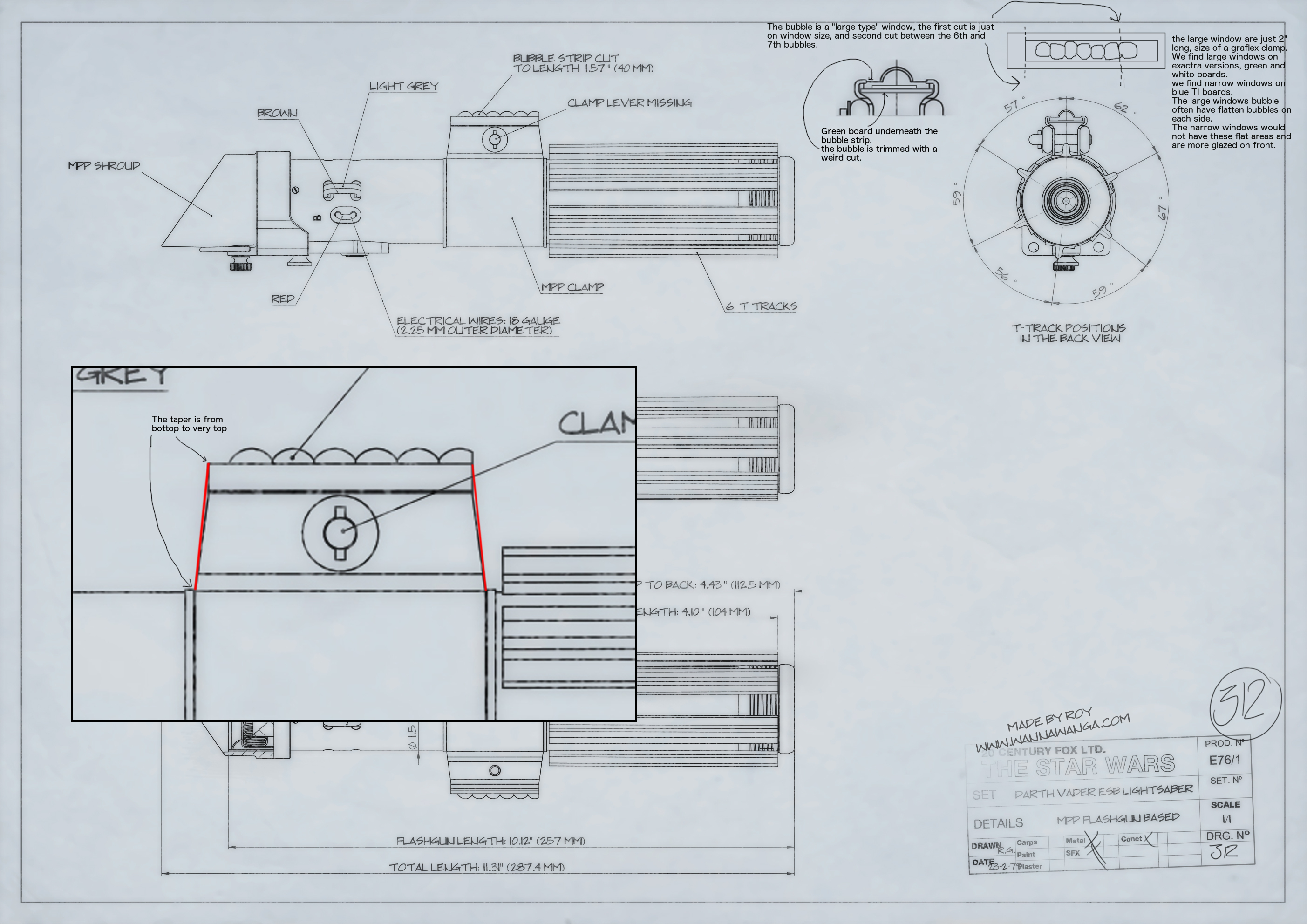

Hi Roy,
Pease take care about it:
-your "B" hole is wrong, too small, the museum saber has a large type "B" hole, even the narrow type existed, it was not used on Vader sabers.
the correct dimensions are 14mm long and 8mm large.
Most of the times the contactors and holes are off-aligned, because the retention bolts are not well placed and the entire bulb holder is to deeply placed in the flash tube.
please notify the real stuff has machine engraved B E ans S holes, probably made with a pantograph machine and a small mill, the numbered versions have similary engraved numbers.
Then, the second main problem is your clamp design, wrong taper on activation box.
The tapering starts on very bottom, and ends on very top, where the bubble goes.
The top lenght is about 4cm and bottom lenght is 4,4cm wothout the plastic sleeve, making a 2mm x 13mm triangle for the slope.

Hi Roy,
Hey Patrice,
There's NOTHING WRONG WITH MY HOLE!! ;) LOL!
Ok, thanks, makes sense. I checked the Hollywood museum images and the hole is wider and longer indeed.
I wasn't aware of this difference. Hard to modify in a Heiland if you want to be accurate.
And about the taper on the clamp: does this mean that the MPP clamp replica from TCSS is incorrect?
How about the clamp bars? I guess they are angled as well then, unline the TCSS replica?

There is actually no existing accurate replica, reason why I told you about pttin one on the market, however the TCSS one is very good.
The lever is near identical to real, the clamp is made from aluminum, and black anodised, just the activator box is a bit large and the slopes are incorrect.
When you check the best views of the hollywood saber it's quite difficult, but you can also see the B hole is off centered to the two pins center.
The narrow B holes are REALLY narrow, no way to mistake, I get both versions in the past...
About the clamp bars, there were several versions:
-tapered from about 4cm to about 4,4cm, quite rectangular profile, black anodised (have one pair)
-straight, one side rough from extrusion, other side machined, with aluminum color, I think this is the ANH version (I had this version but the aluminum was inside, they may have scitched them and aluminum outside)
-probably tapered with different colors on inner and outer side (never seen but it probably exists)
-probably tapered and straight with full aluminum color (chaims has one, after quick photo view I suspect it to be real, but can also be a TCSS replica, not sure, but it's reasonnable to think it can exist)
-probably straight, with rectangular profile and black or aluminum color.
the machined ones are rough from extrusion on other side, and have rounded profile, except the machined area.
