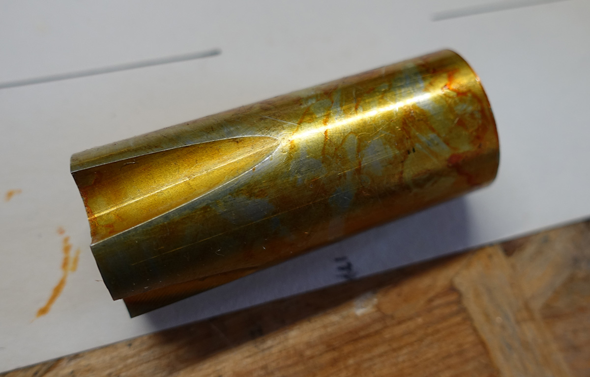

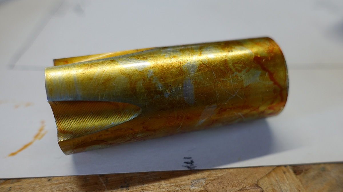

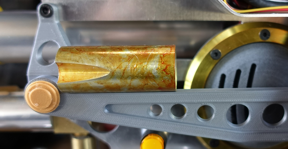

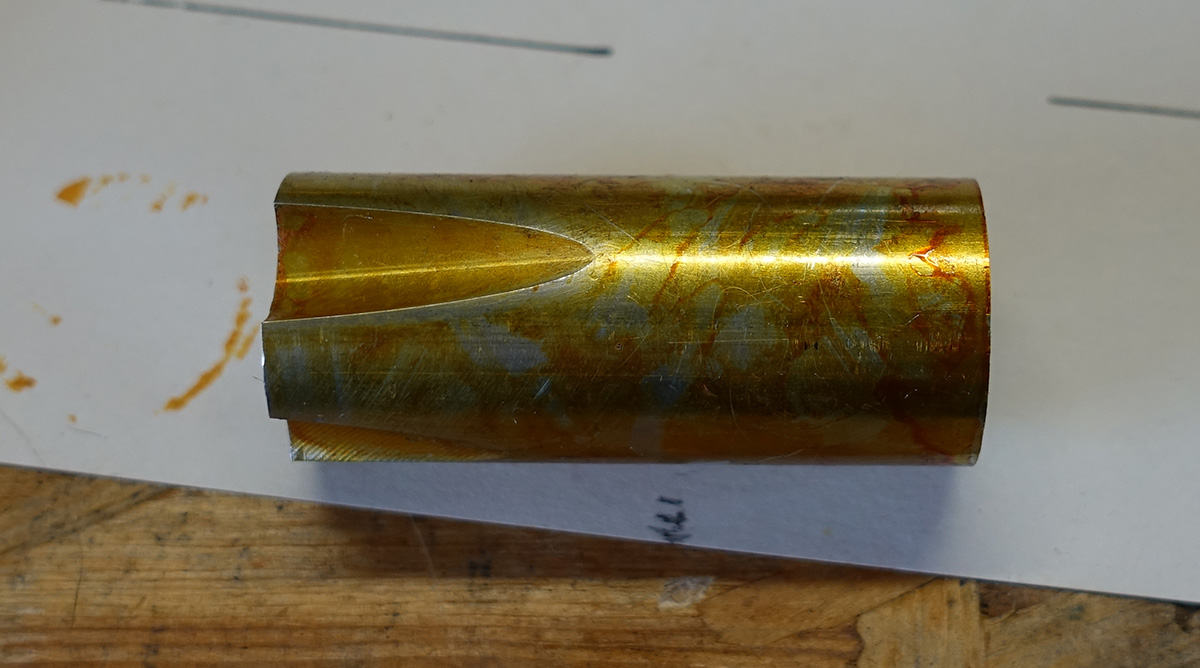

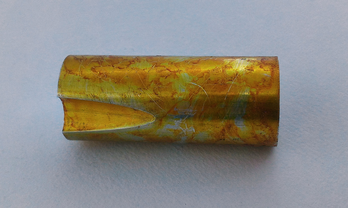

so, I tested the yellow marker on the flame thrower. well, I'm actually pretty pleased with the result and considering using that on my ZF-1. the only thing is that it's not possible to get as red at the base or as much of a gradient. It's easy to do that blotchy finish and it's easy to get some orange, but not uniform red or nice gradients. when you go twice over a surface, the ink tends to go darker in the contour but not in the middle of the shape you are drawing.
so, it's actually very hard to capture the colors with the camera, so I did my best with several cameras and next to the other parts of the ZF-1 to try to show the best I could.
It's very much of an artsy experiment, so everyone will probably get a different result, but it looks promising I think :) just airbrusing a bit of red at the base I think would be nice :)
cheers

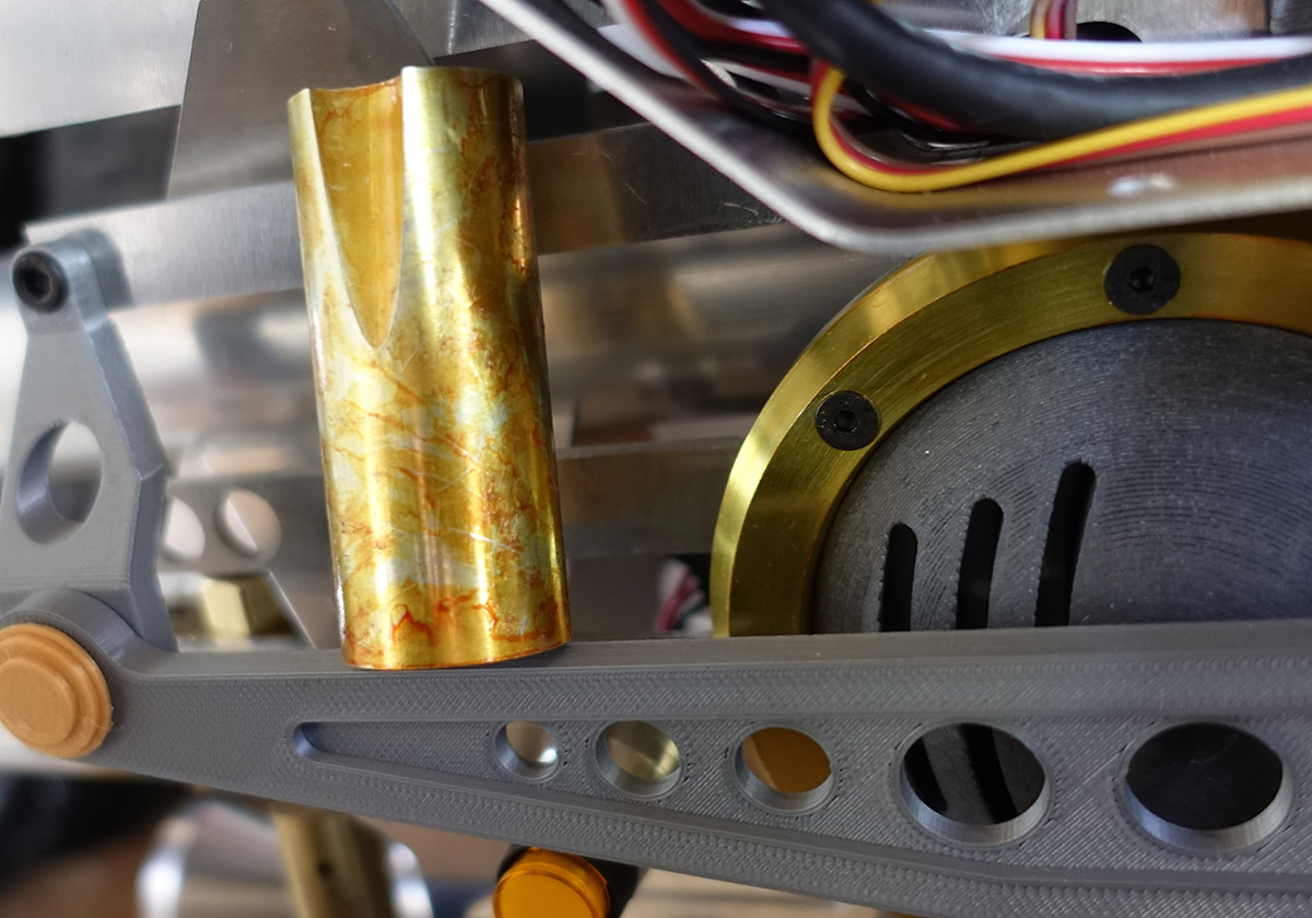

Well, I'm not sure anymore about the yellow marker for the flame thrower as I was a bit focused on that ref while doing it:

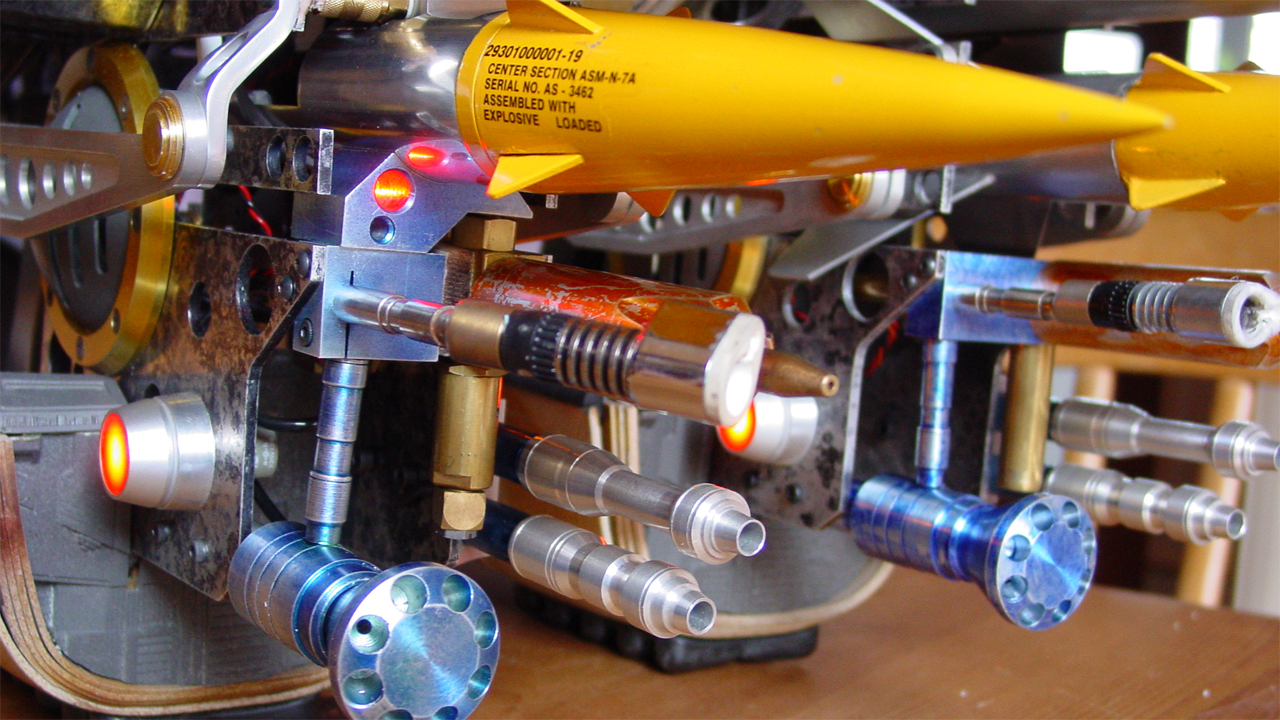

and there are some other refs where it is really orange:
so I guess we really need an orange marker or orange transparent varnish with an airbrush.

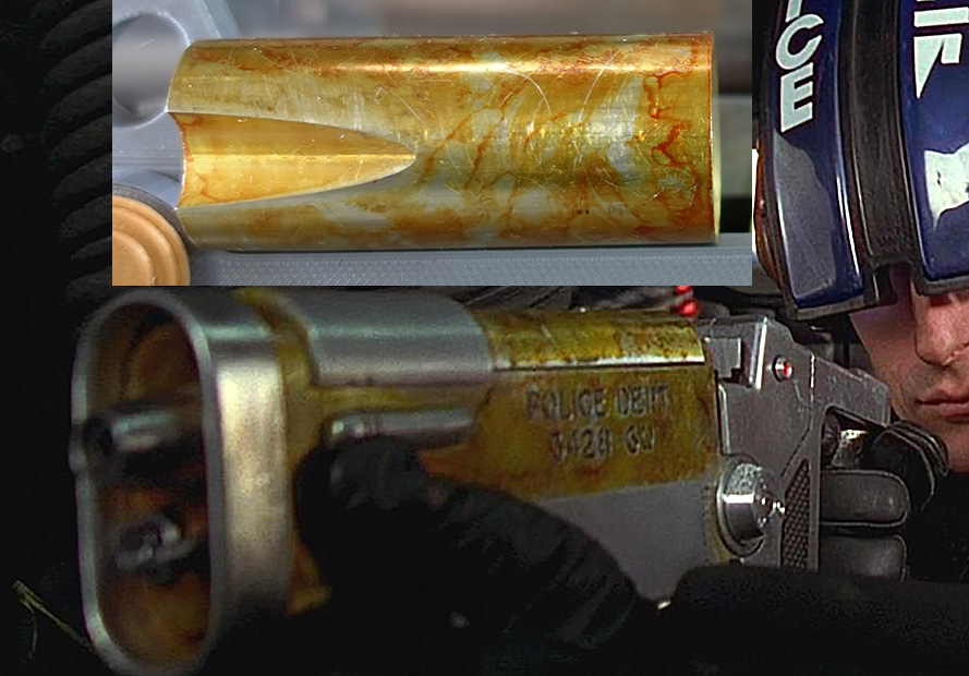

HOWEVER, that is a pretty awesome match to that police gun!!
They had to of used those markers of the at least the refill inks for the props. The color and "texture" of the over paint is just too close.
yeah I don't know, they could have used any marker I guess or any transparent varnish probably as well. but, yes some of the colors and results are pretty close :)

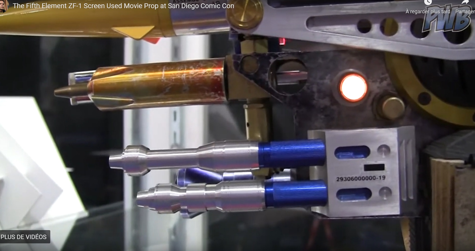

Its just surprising how close that yellow is to both the rings and yellow details on the zf1 and to the yellow police gun, but at the same time, I'm pretty sure they used the dykem for the blue at the time. But I don't know, maybe they used the dykem, yellow markers, an orange varnish... just different technics for different parts I guess :)

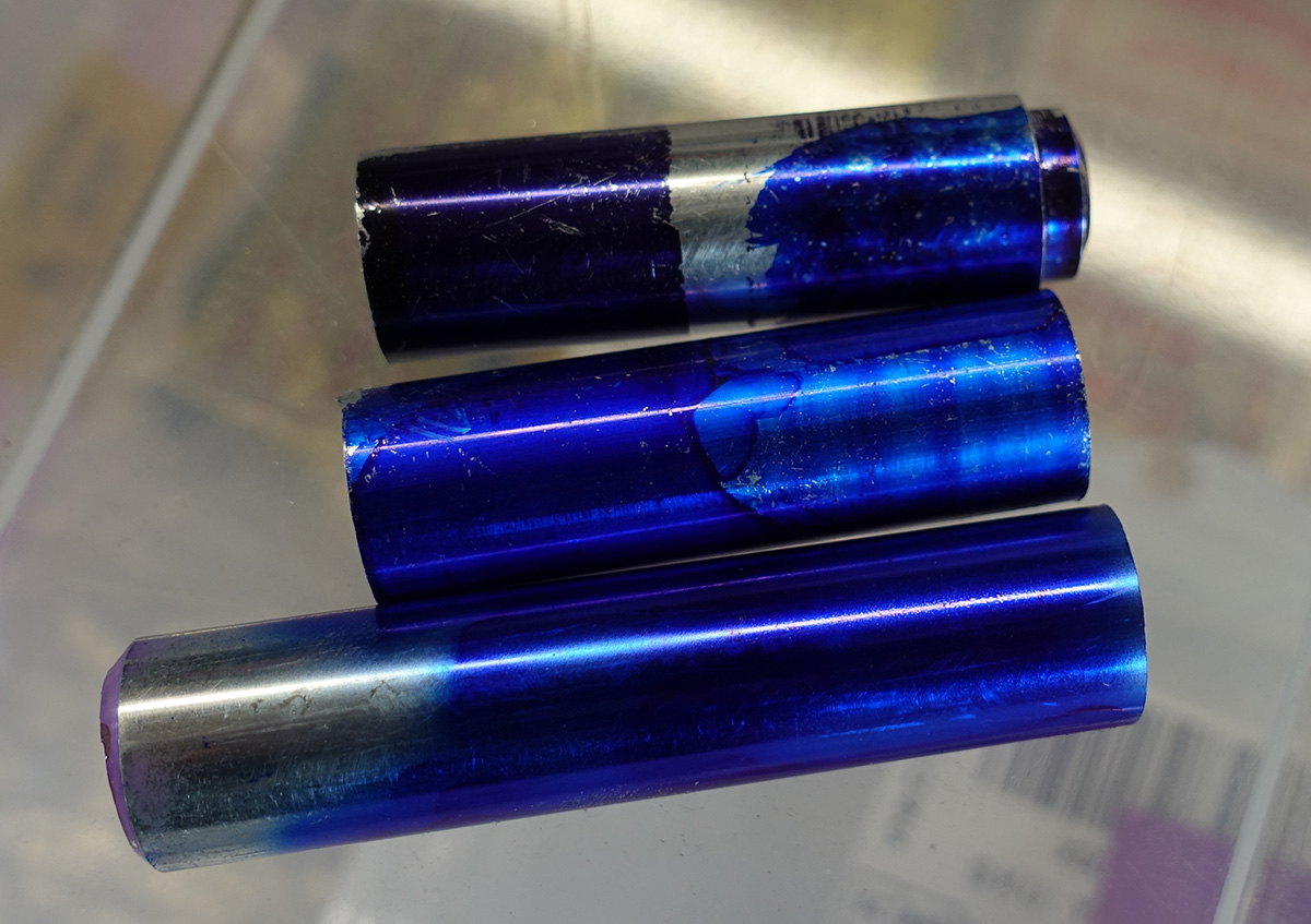

Hey guys,

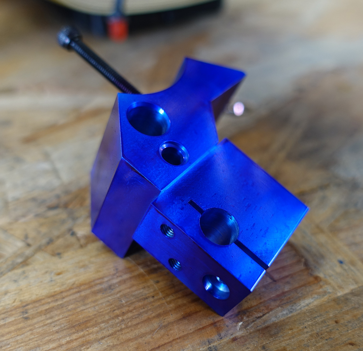

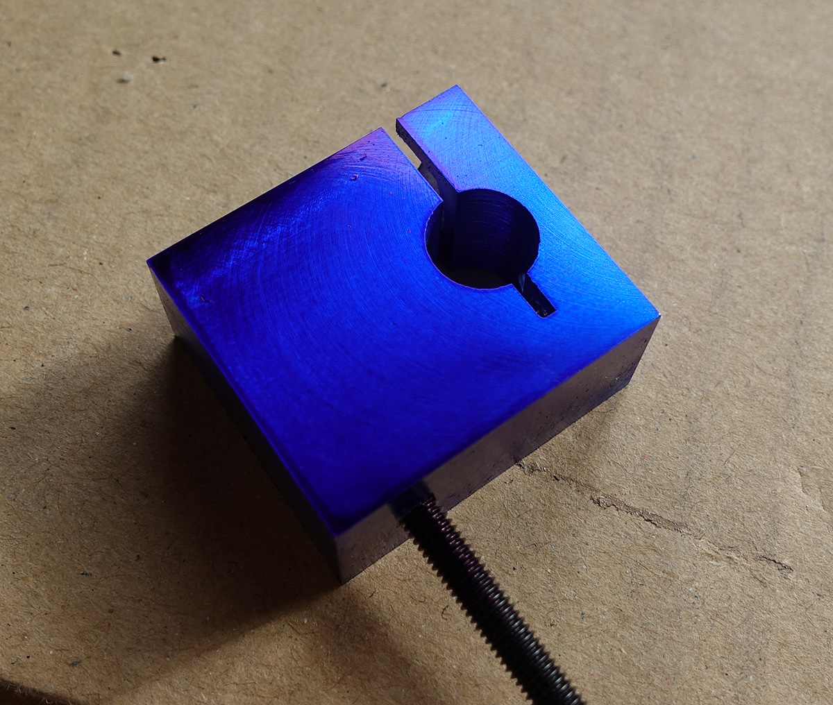

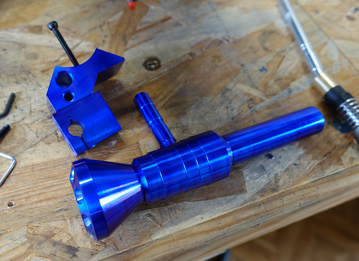

so, here is the last test for the blue, airbrushed Edding refill ink. It's works pretty nicelly, however, this was my very first time with an airbrush and I'm pretty bad with it sadly...
anyways, here are some photos:
bottom, is airbushed:
here, the weird horizontal spots on the square part are spits from the airbrush that I just wiped thinking that the actual coat would make them disapear, but it didn't...
the large part was really hard to do and I have a lot of streaks a bit everywhere
more updates coming in the project run thread soon.
cheers
I think it looks pretty gosh-darn good! And if you're going to weather it a bit, like the actual film ZF1s, it should be spot on.
Now what is this Edding stuff? Can you share a photo? And how durable is it? Meaning is it going to rub-off easily? Does it need a clear coat of some kind?
Awesome work again! :)

to answer your question, it is not durable. it will rub off in the corners extremely quick but is quite resistant on the large surfaces. I think after being weathered, it should pretty much stay as is and if you want it to stay new, you absolutely need to clear coat it.
I'm sure a transparent varnish of a proper color will work perfectly as well :)
or a marker from another brand if you intend to have a weathered finish as it is harder to have a nice surface finish with the markers.

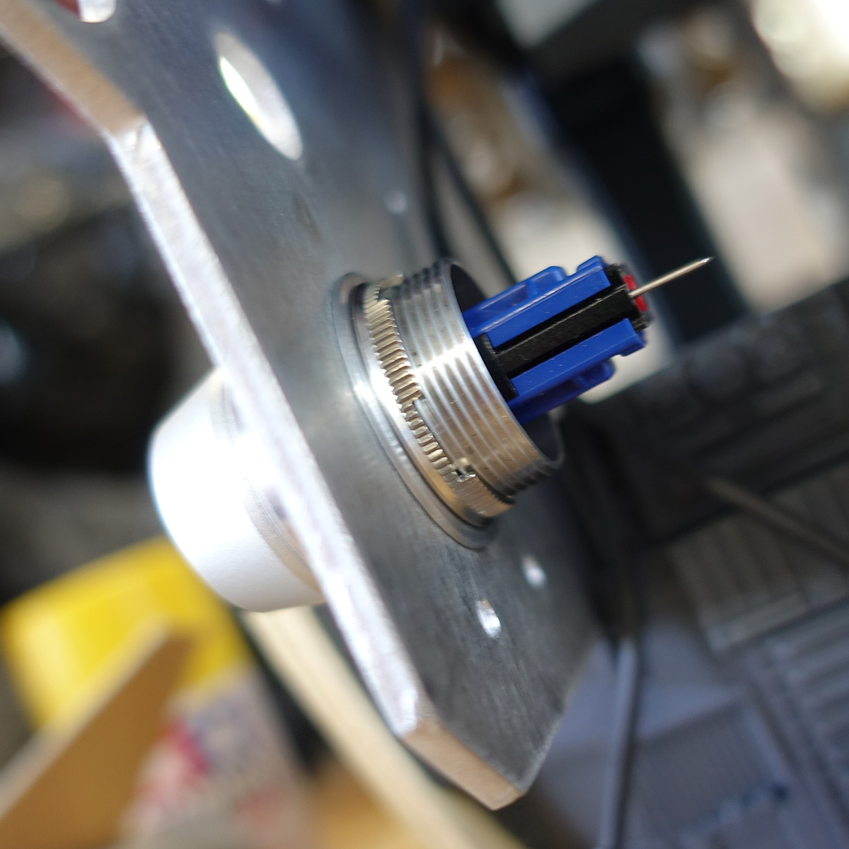

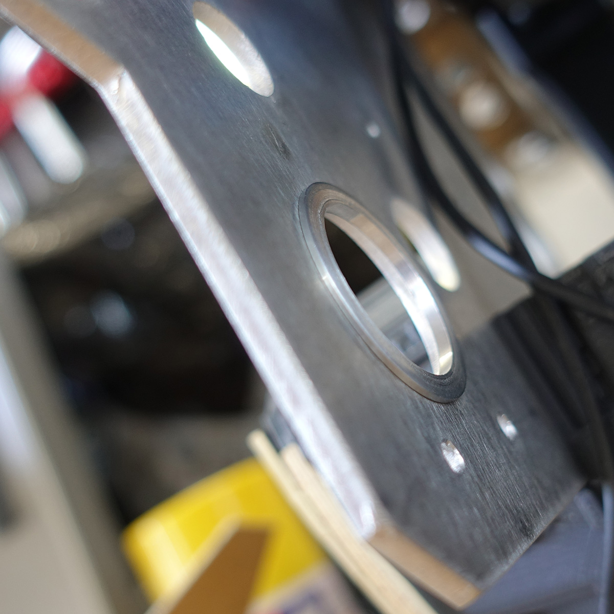

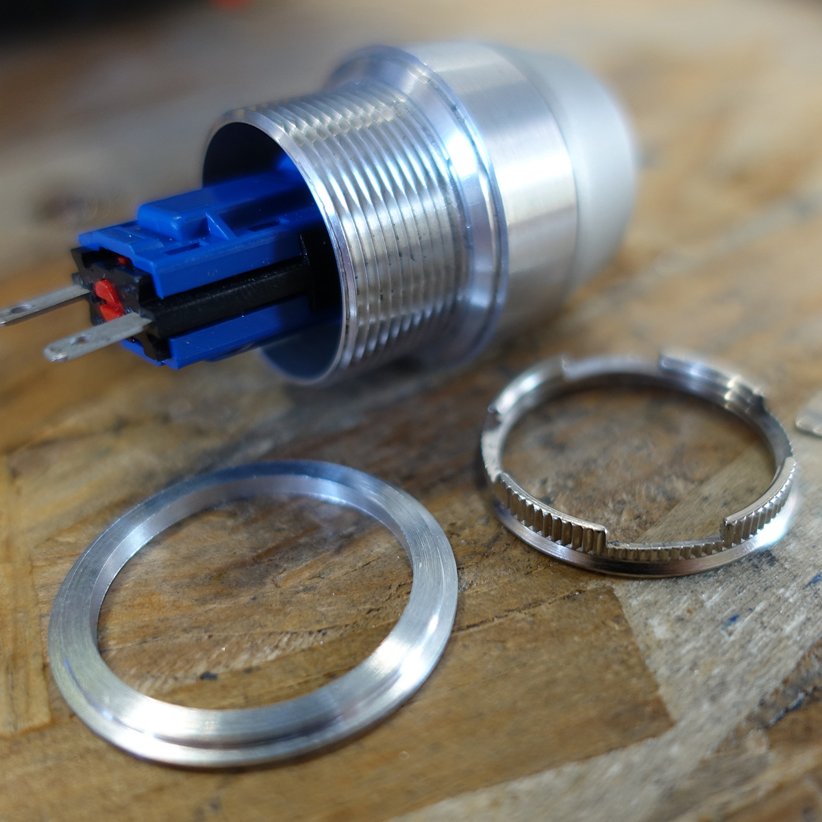

for reference for the people that will buy one of my NOS red button and how they assemble with the parts I created specially for those,

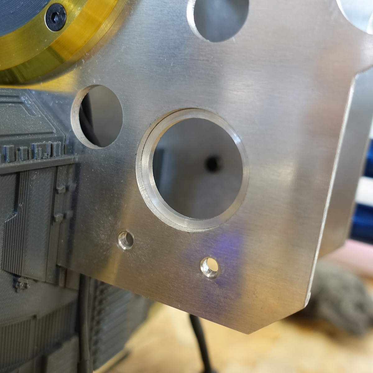

the threaded part on those was too short, so I created special bezels onto which the button threads and that have the same threading at the back, essencialy making the threading of the button, longer. Now, the frame of the ZF-1 has a hole that is too large to use the button nut directly, so I created a really thin washer that goes into the hole of the frame and between the red button and its nut
the washer seen from the inside:
and from the outside, just making the hole smaller:
and here is how the mounted NOS red button looks:
so, in short, those are a tiny bit less accurate on the inside of the ZF-1, however, they are held directly by their nut whereas the correct Saia-Burgess buttons are held on the aluminium bezel and the aluminium bezel has to be glued to the frame.

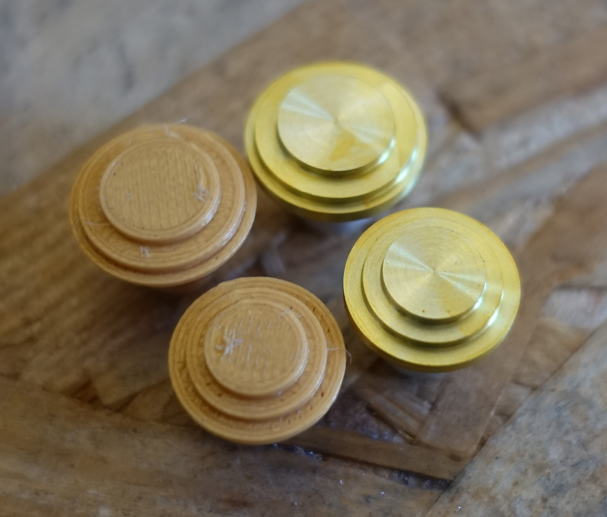

ok, so, while I'm waiting for a couple answers from clients, I worked on a new part and tried to make a few to put on my website at the same time as the kits in case anyone else is interested :)
the 4 small yellow knobs that hold the lateral rails :)
here we go:

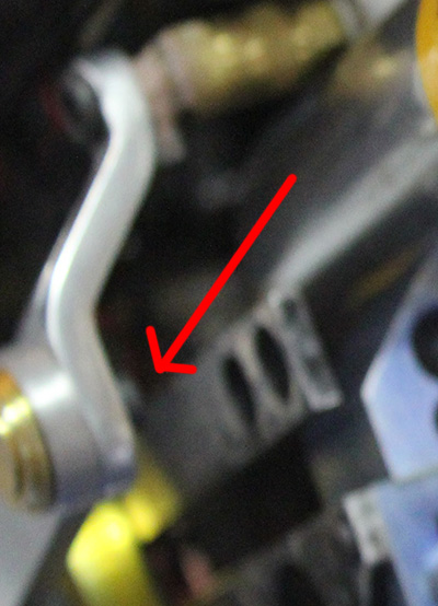

they are held from the back with an M4 screw, that is the same way it's done on the real prop even if we don't see it often, I looked at all the refs i have and barely managed to see that detail in a couple pics.

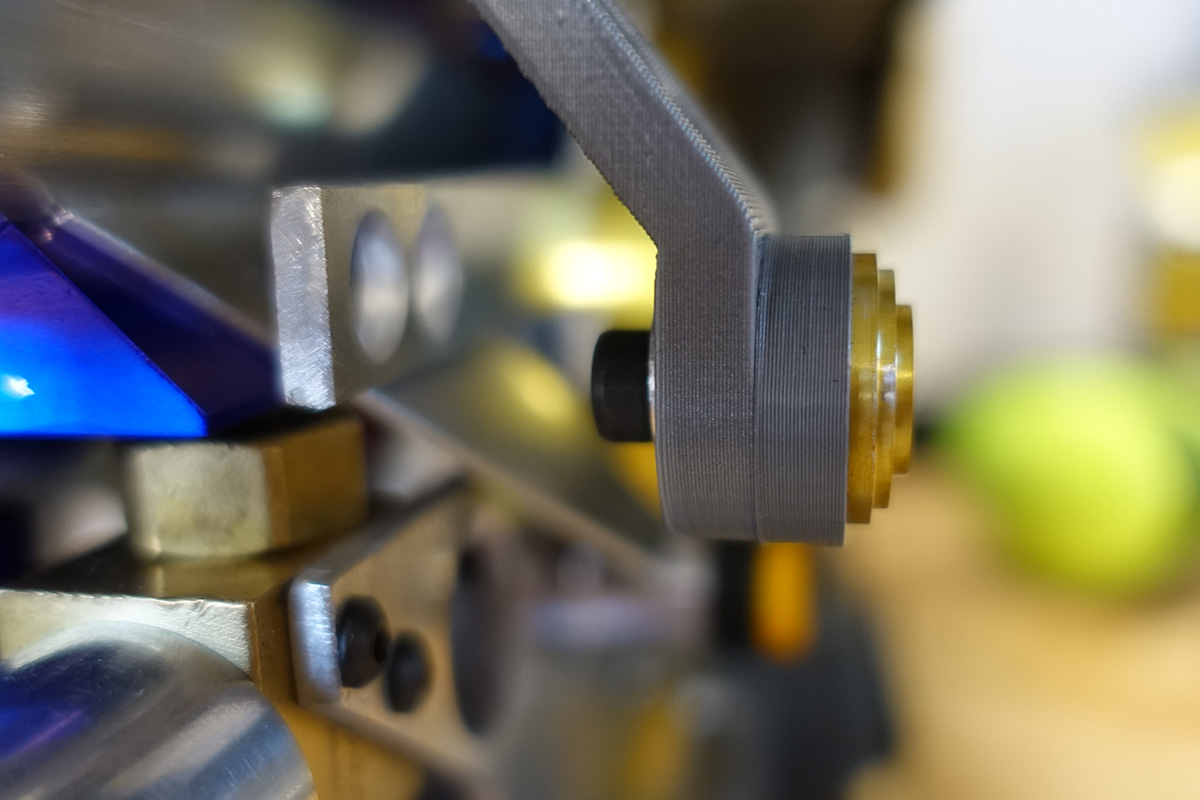

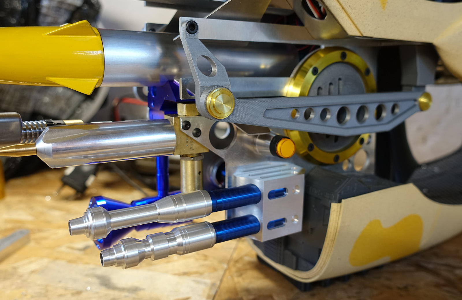

can be seen on the real one here when you know what you are looking for:
here as well on a photo that was given to me by someone here :)
