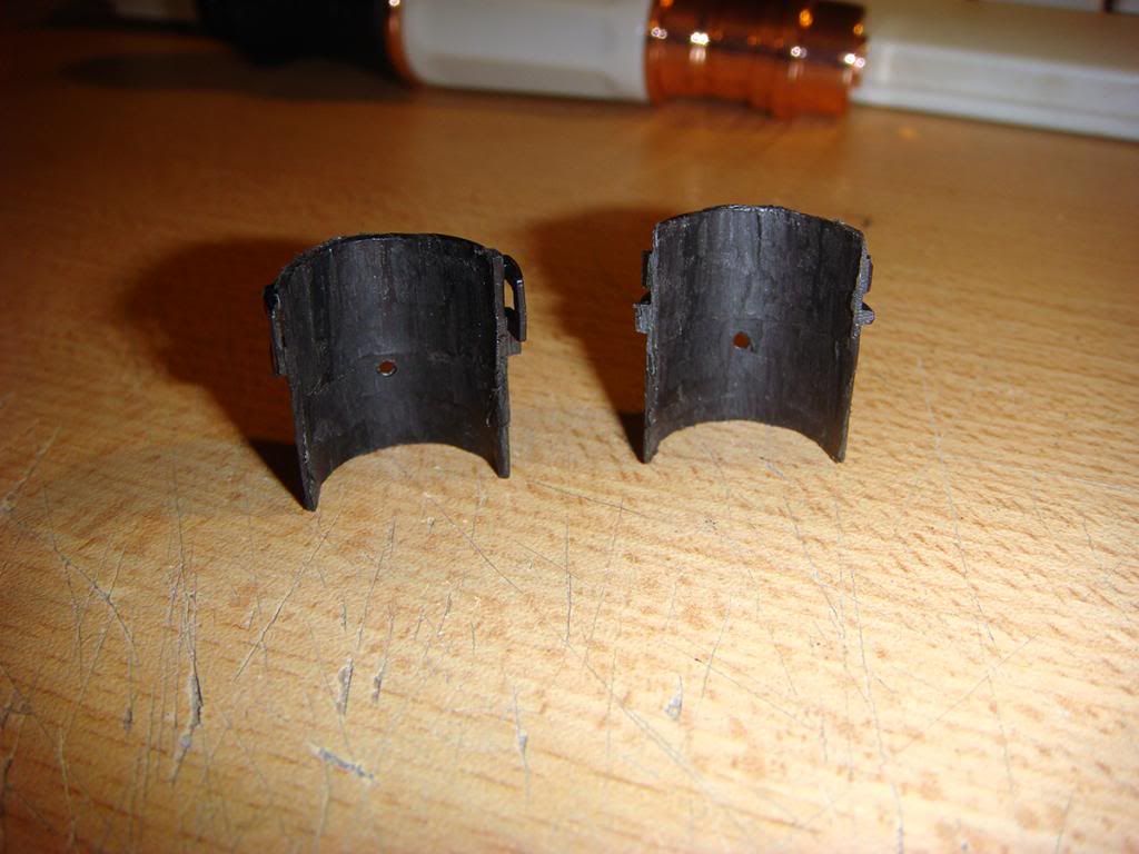

This thing is killing me. After multiple test fittings, I still can't hollow out enough of the inner black casing from the front end to allow the green shaft to slide through unrestricted. On top of that, the process of cutting away the innards has completely removed the screw holes that hold the prop together. One flick and the whole front half flies off. (assuming I can get it thin enough for the green tube. Right now that's the only thing holding it together.) All in all, this has been the most frustrating part of the build. Even more than the spring loaded claws, although I'm sure I'll have more thoughts on those when it comes to lining up the tiny holes for the pins.

And then just glue it in place? That would work, yea. I was referring to the tolerances of the black plastic pieces and the green shaft, though. I can't make it work. I know you did it a different way with separated electronics, but do you have any idea how I might be able to hold those pieces together? I thought about cutting the screws down so that they barely extend through the outside piece, but then the sonic would be held together by a pin or two that only about 1 mm away from working it's way free. I'd also have to send a good 1mm of wall thickness off of the green tube, which would make it pretty darn ugly when the sonic is extended.
Re: Turning a Sonic Screwdriver remote control into a Sonic replica (Round Two with R
I think sanding then polishing the green shaft could work. As far as the shaft sliding, the toy shaft and my resin cast shaft are the same OD. You could probably try sanding the toy shaft down then polishing it with progressively finer grits of sand paper. As far as securing the two halves together, I just used JB weld to secure the black connector piece to the bottom of the copper cage. The twist lock mechanism holds and the two shaved down screws hold the two halves together just fine even with a flicking motion.

Yep. Shaved them down an they hold pretty well.
That kind of blows my mind. Any chance you can post a pic of how long they ended up being and of the twist lock mechanism/area?
I kept the screw at 4mm long which is just a tiny smidge over what it needs to be, that way I can adjust the tightness of the sliding action.
