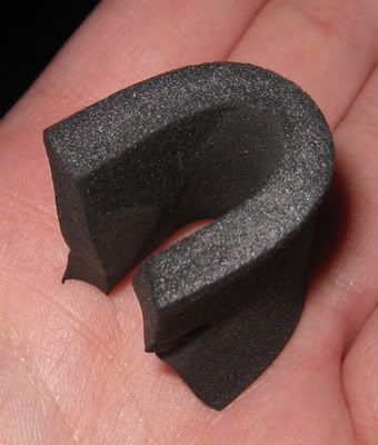

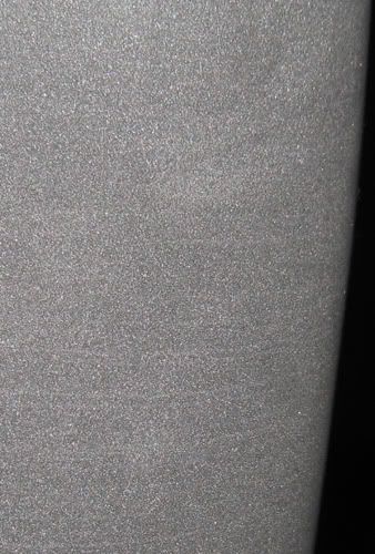

I stopped and bought a sheet of the 1/4" minicel on the way home from work today, and it's pretty awesome stuff. It looks almost identical to craft foam, but feels way nicer and more durable. It cuts easily with scissors and heat shapes great. As for heat sealing it, I was unable to with a heat gun without warping it significantly. Here's some pictures both with and without flash.

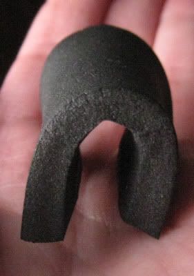

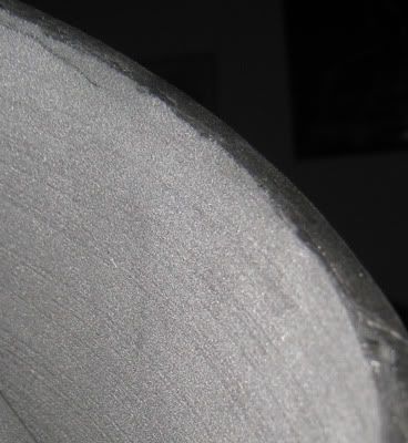

Here's a heat sealed edge. It's quite a bit shinier than the rest of the foam and feels like it has a thin plastic crust on it; almost like it's cauterized. I imagine you'd need a quick source of heat in order to seal this properly, like the friction from the giant band saw they cut this with.

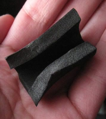

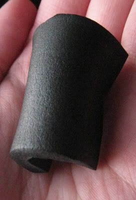

To test how well it would heat shape, I cut out a small square and wrapped it around a screwdriver. It held gentle curves just by shaping it with my hands, but I wanted to test how well it did on more severe curves. It took them quite well

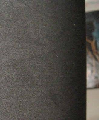

The surface does get a bit of a sheen when you take the heat gun to it, but it's still soft enough that you would need a sealer of some kind before you paint it.
Here's what happened when I tried to heat seal it. It warped and didn't form the crust like the edges had at all. One good thing is that it didn't really shrink at all, so you should be ok if you accidentally overheat it. The dents are from the wire strippers I used to hold it around the screwdriver. I tried denting it with my fingernail as well, and it only left a faint mark.

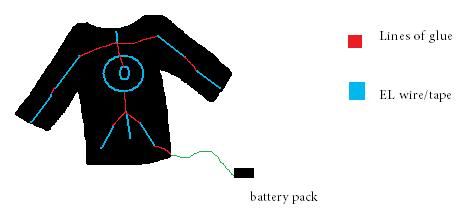

Wire glue...apparently it conducts electricity. My thought is, if I'm not misinterpreting its abilities, could you use EL Wire or EL Tape on a costume or clothing and use lines of this glue to connect seperate pieces, instead of running wire across it?
It's hard to explain, but I hope it makes sense to someone. Here's a quick example of what I'm talking about (with a cheap/effortless/poorly done TRON design lol)
Could it be done, using conductive glue to complete the circuits of segmented wire/EL tape?
Wire Glue, or Conductive Glue, is basically a carbon paste that conducts electricity.. problem is, the glues out there tend to be very weak bonding, brittle and a complete pain to cure. I can basically tell you that the glue will NOT flex without breaking the 'line' you have built with it and acts as a power feed to your ELWire.
I tried using this stuff to bond my leads to the back of ELTape, to avoid the need for clips or soldering, and the paste was worthless. It took nearly 24hours to even create a dry and stable connection and the paste would just snap free of the tape when the slightest pressure was applied to the wires.
Unless I am mistaken, you are trying to 'hide' the connection between the ELWire and still have power running to the strips without multiple leads and seperate areas of ELWire. Since you probably want some areas to flex a bit, an easier and more secure method for your layout might be cutting some thin, black cased speaker wire or the like and setting that as a connection between ELWire sections. It's how I wired my suit, but my wires are all running the rear length of the arms or alng the spine under a coat so they are hidden, except at the back of the elbow where they can be seen from a side glance.

I agree with gams, also I want to add that your idea is not as simple. You would need to have 2 lines for each set of el wire, and, combined with what gams, set the chance for error would be greatly increased.
hmmm...well, it sounded good in my head. Thanks for the input! :)
I am trying to avoid soldering anything (I don't own any of the equipment, and I want to avoid the extra cost of buying it). I might just go the cheap route and use a reflective material (fabric, tape, or a heat transfer film I found online) to get the low-budget glowy effect.
I would imagine that E6000 Glue, stuff is like liquid steel, would do a fine job as a binder/sealer. A heated craft blade will 'slightly' melt the edges of the foam, but I imagine won't stay hot enough to act as a binder. I have tried it with 1/2in EVA Foam, it does not work for anything other than short/long, quick cuts as the foam saps heat quickly.

Sorry, I don't think I explained it well enough. I wasn't talking about using heat to bind edges together I was just using it as an example of what it looks like when properly heat sealed. What I tried to do with the heat gun was to get the front part of the foam sealed the same as the sides so there wouldn't be a need for an additional sealer such as mod podge or something similar before painting it. As for binding it to itself, I've found that simple wood glue forms a very strong and flexible bond on just about any kind of foam, though the E6000 I put on a scrap piece doesn't appear to be melting it so I don't see why that wouldn't work as well.

Do you know if you can sand it at all?
Doesn't look like it. I just tried with my dremel and all it did was melt it a minuscule amount and stink. I don't have a coarse grit on hand to try, but I imagine all that would do is rip it since there's a decent amount of give to it. The only foam I've been able to successfully sand has been the extruded polystyrene insulation stuff. It sands wonderfully, but it's hard and will snap if enough pressure is put on it.
