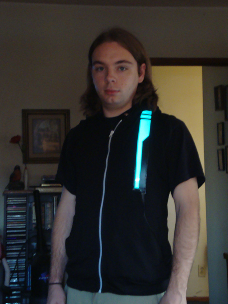

Alright so since everyone is in show off mode, I will be no different. Got my first el strip on the jacket. Going for a more casual program look.
