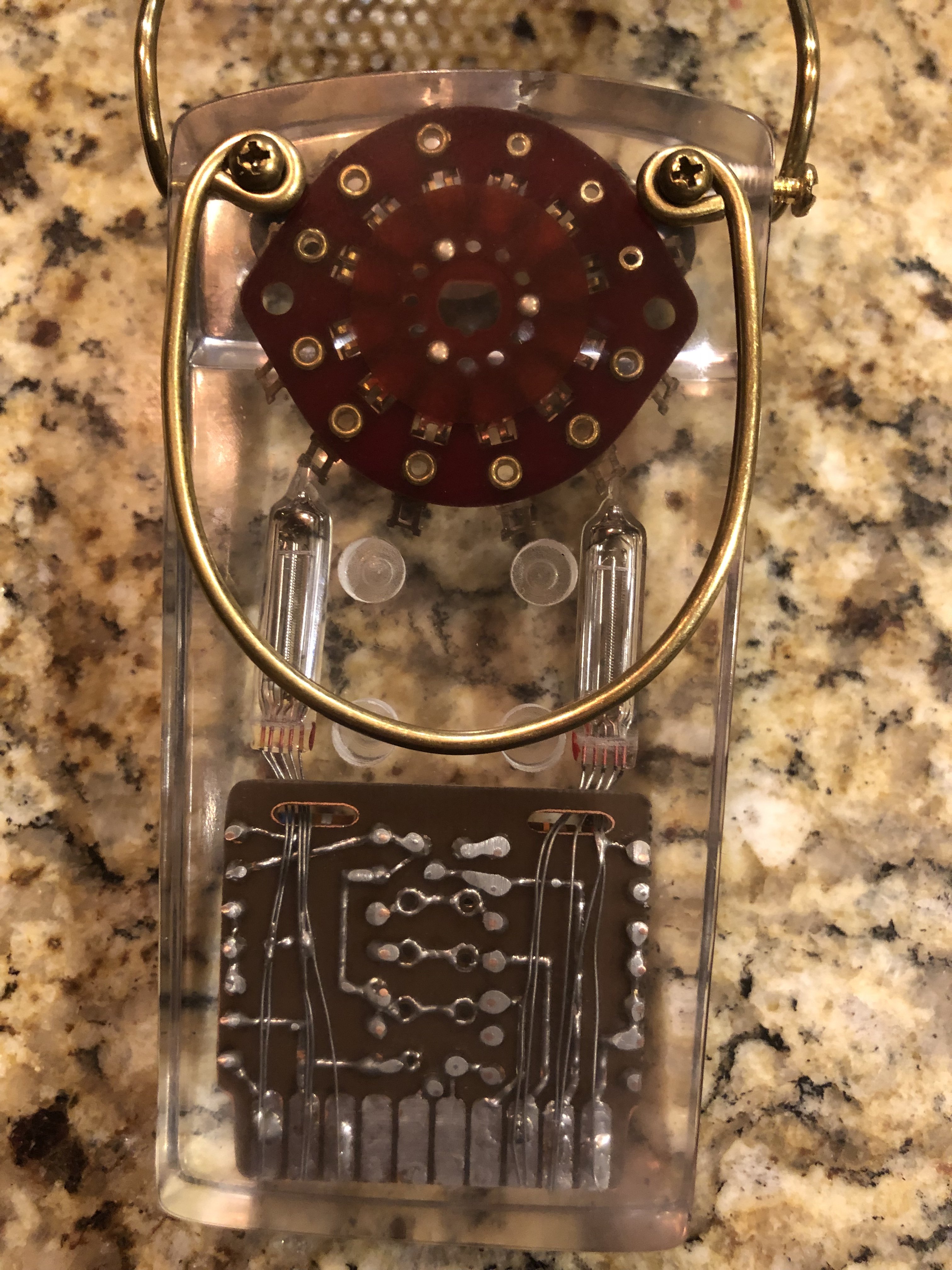

They've been identified as Nixie tubes
They certainly look like neon bulbs to me. They appear to have two long internal electrodes and a pinched glass base with fewer than 11 leads. A side-view 10-digit Nixie tube should have 11 leads (common and numerals 0-9) or more (dummy leads marked "NC" in a pinout), usually coming out from the base of the tube in a circular configuration. However, if the devices in the comm are Nixie tubes, they may be one of the specialized Nixies for displaying symbols or punctuation, which could have fewer electrodes.

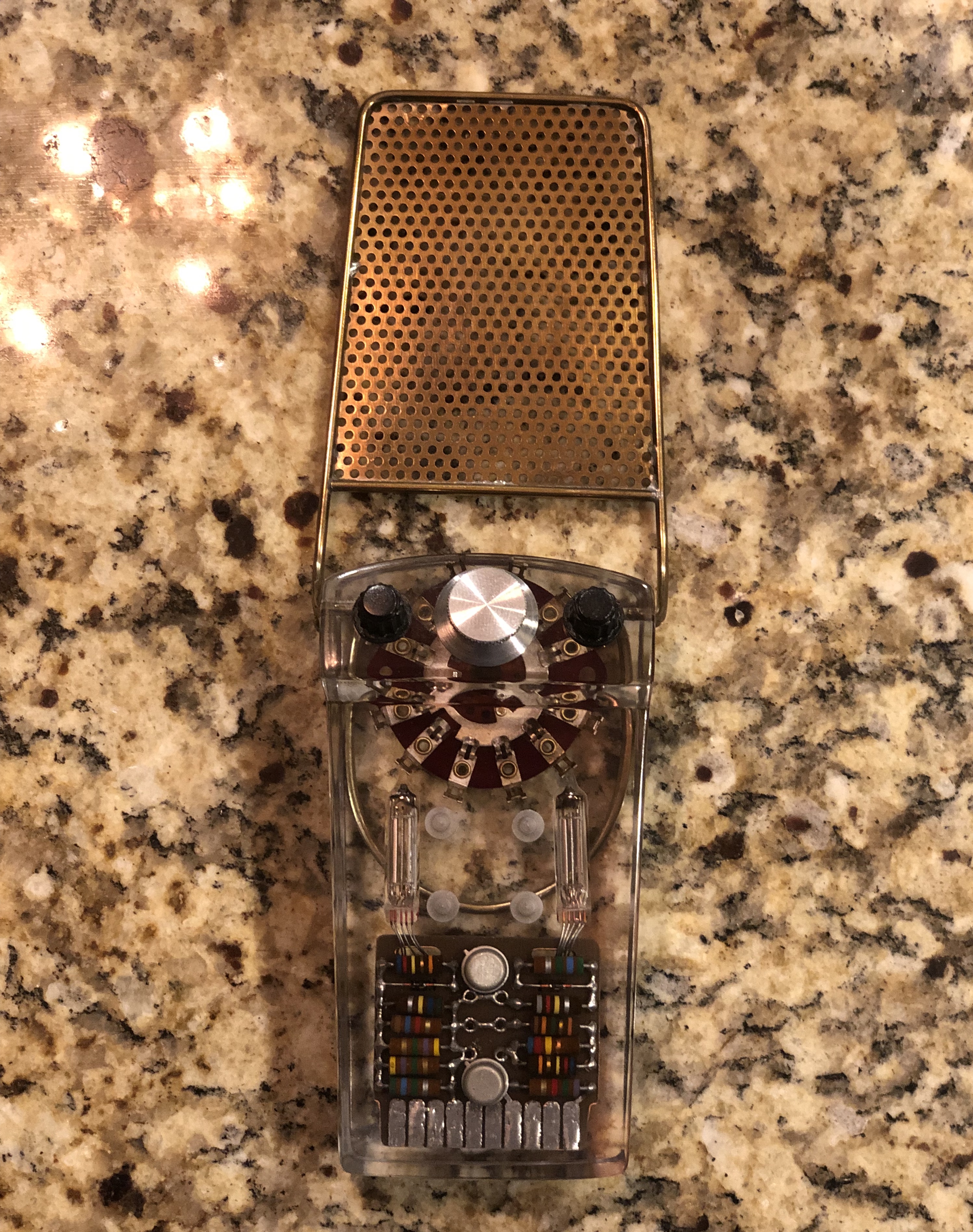

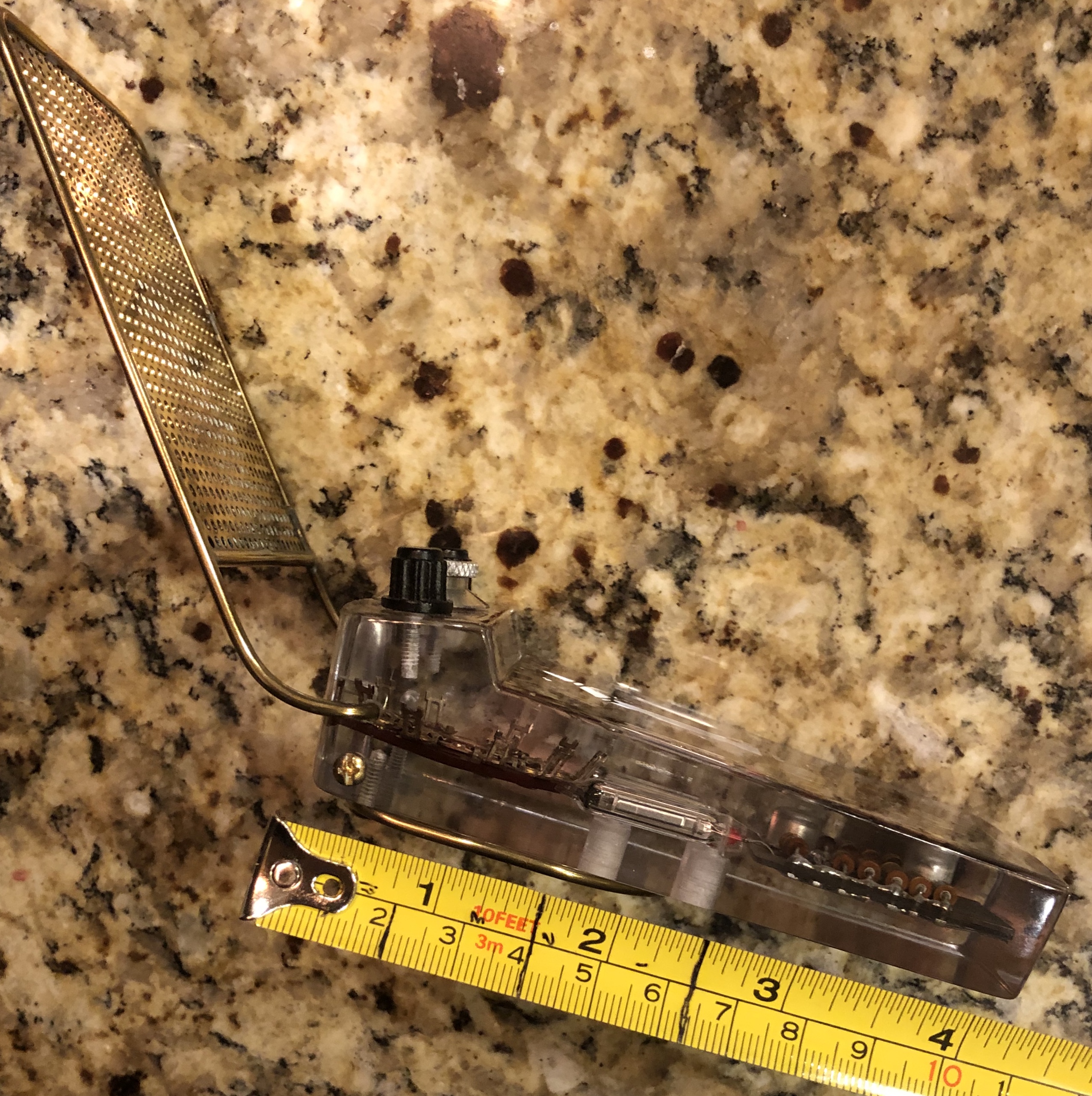

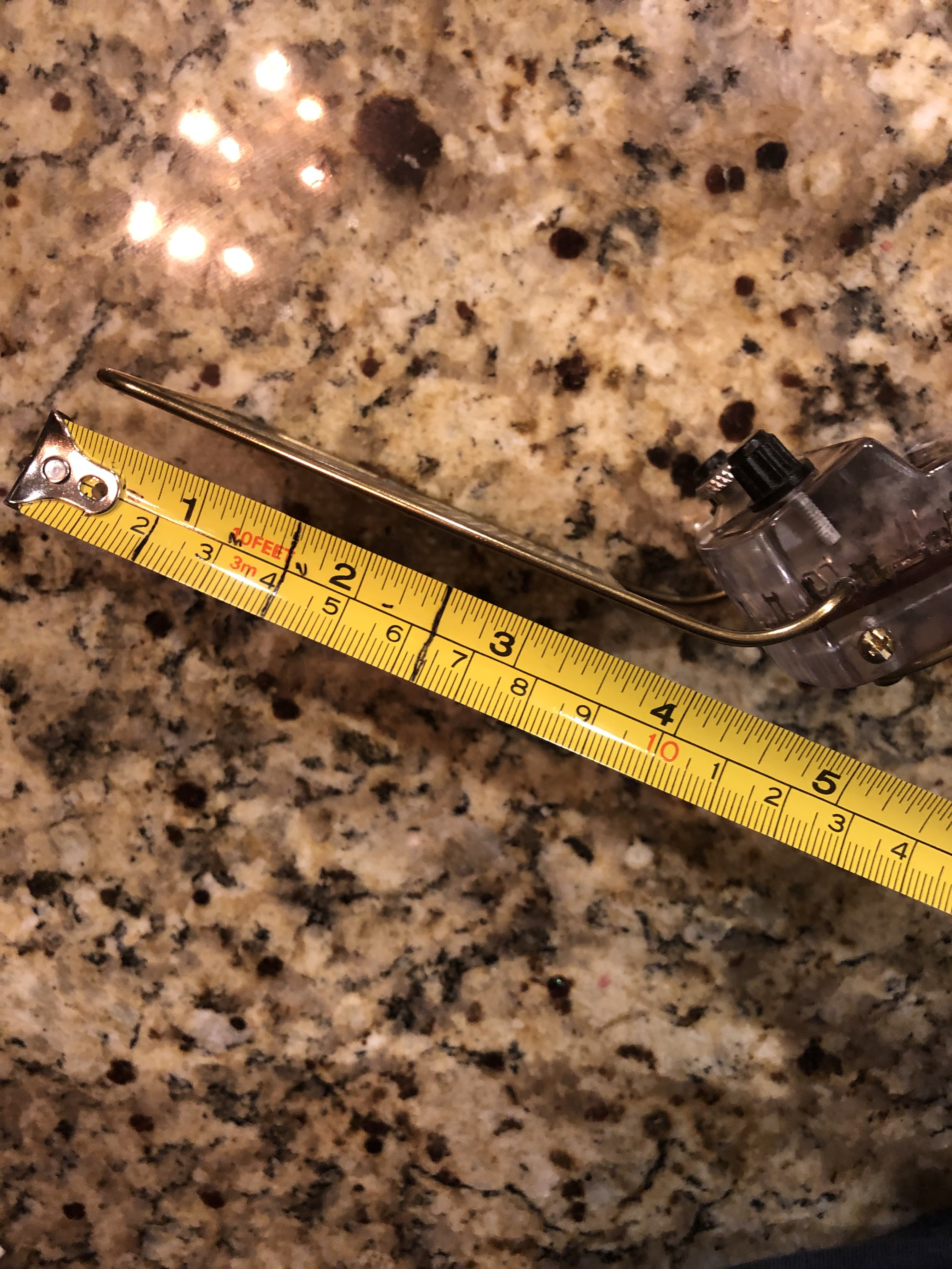

Sorry, I just caught this thread.
I do own an HMS / Rodd.com “Cage Communicator”.

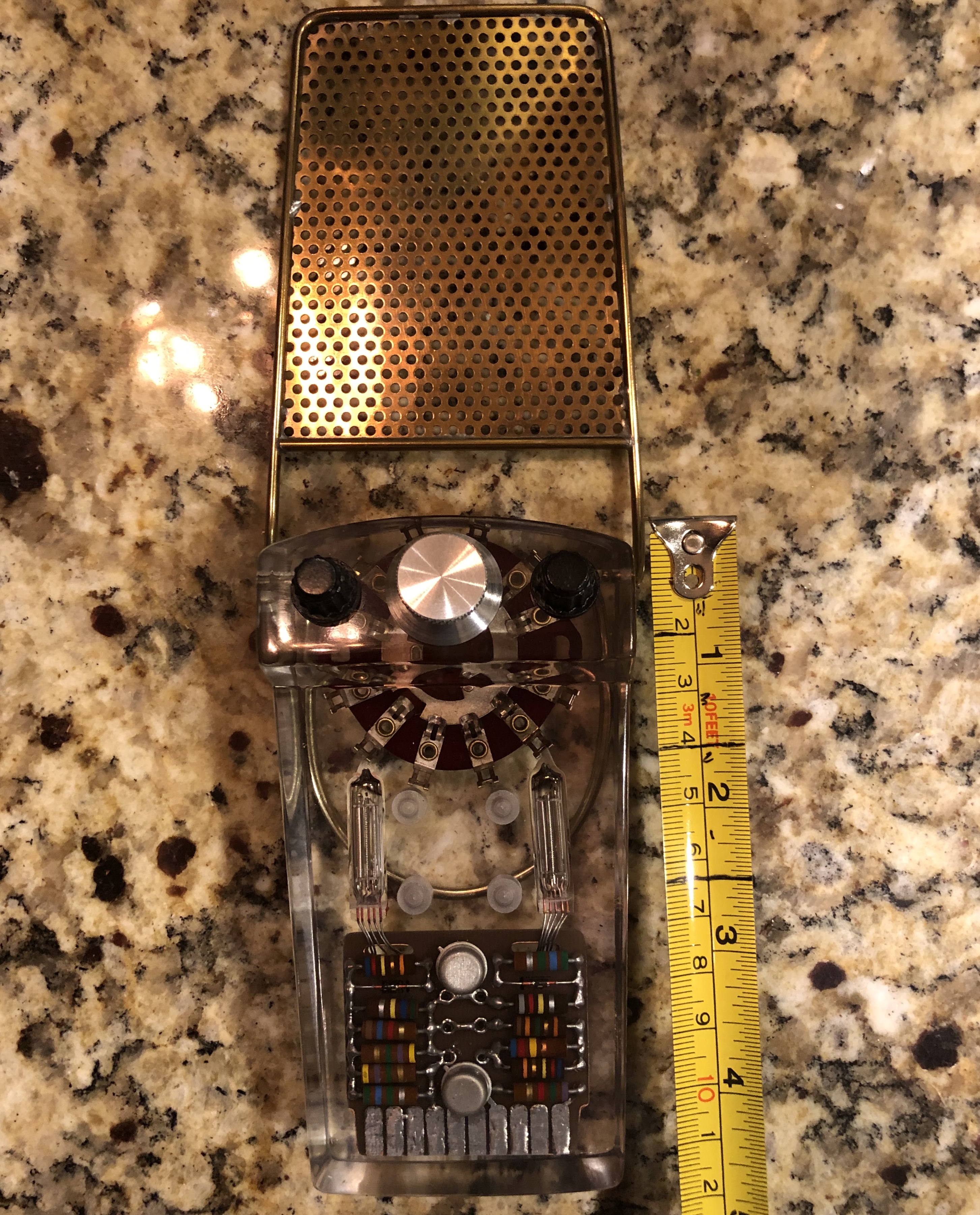

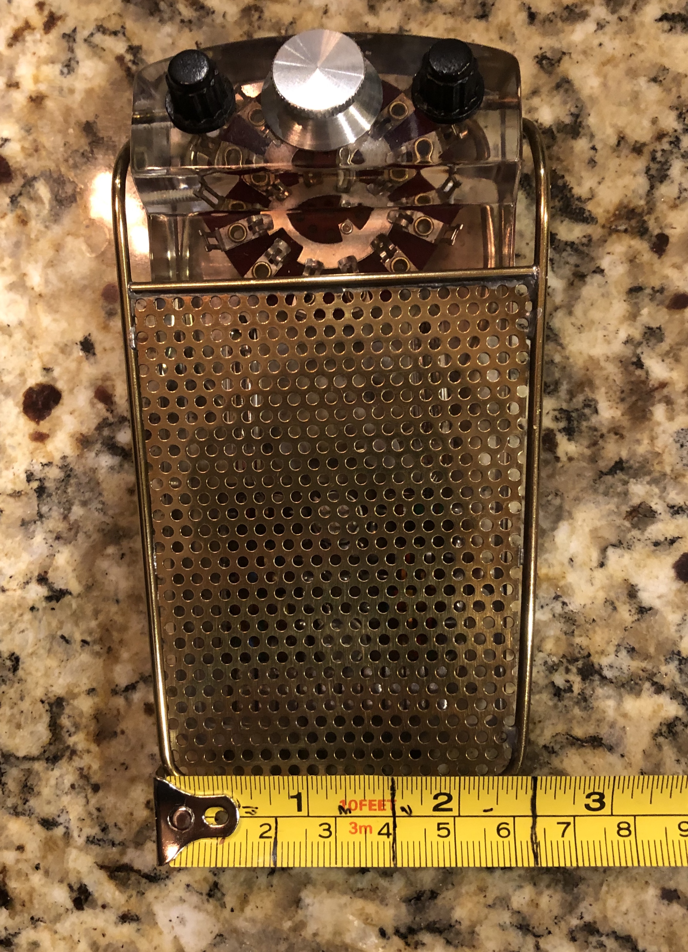

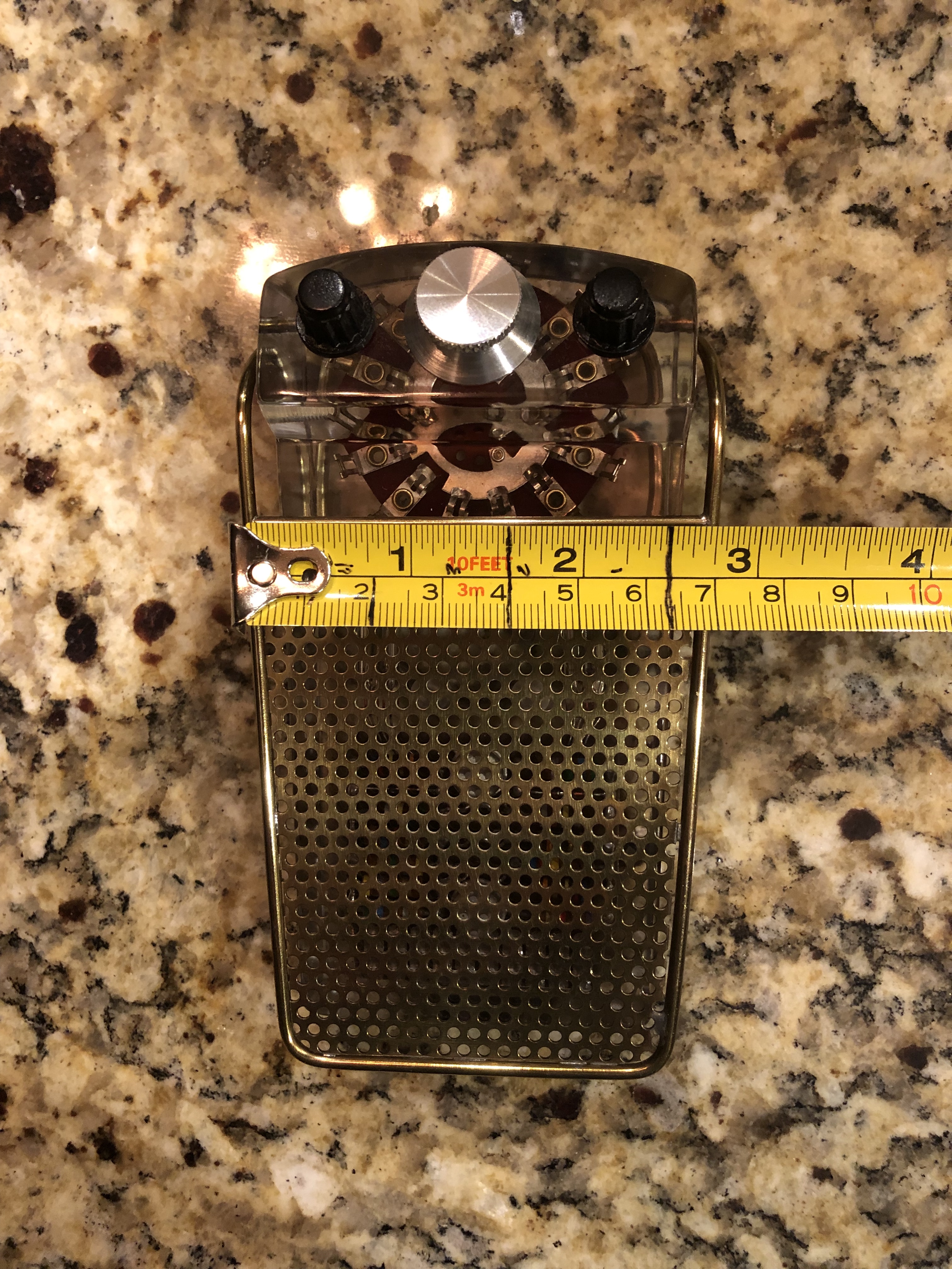

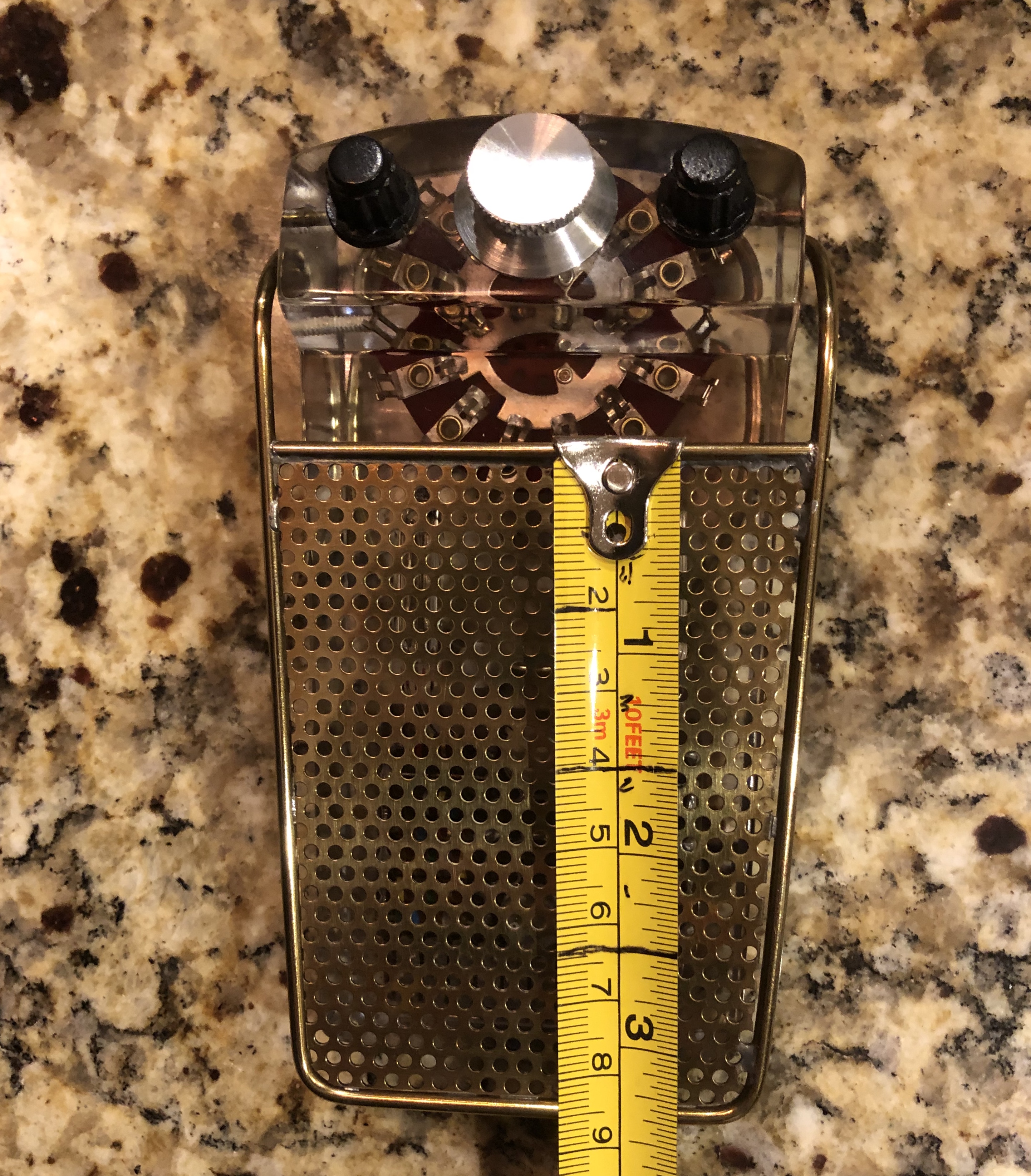

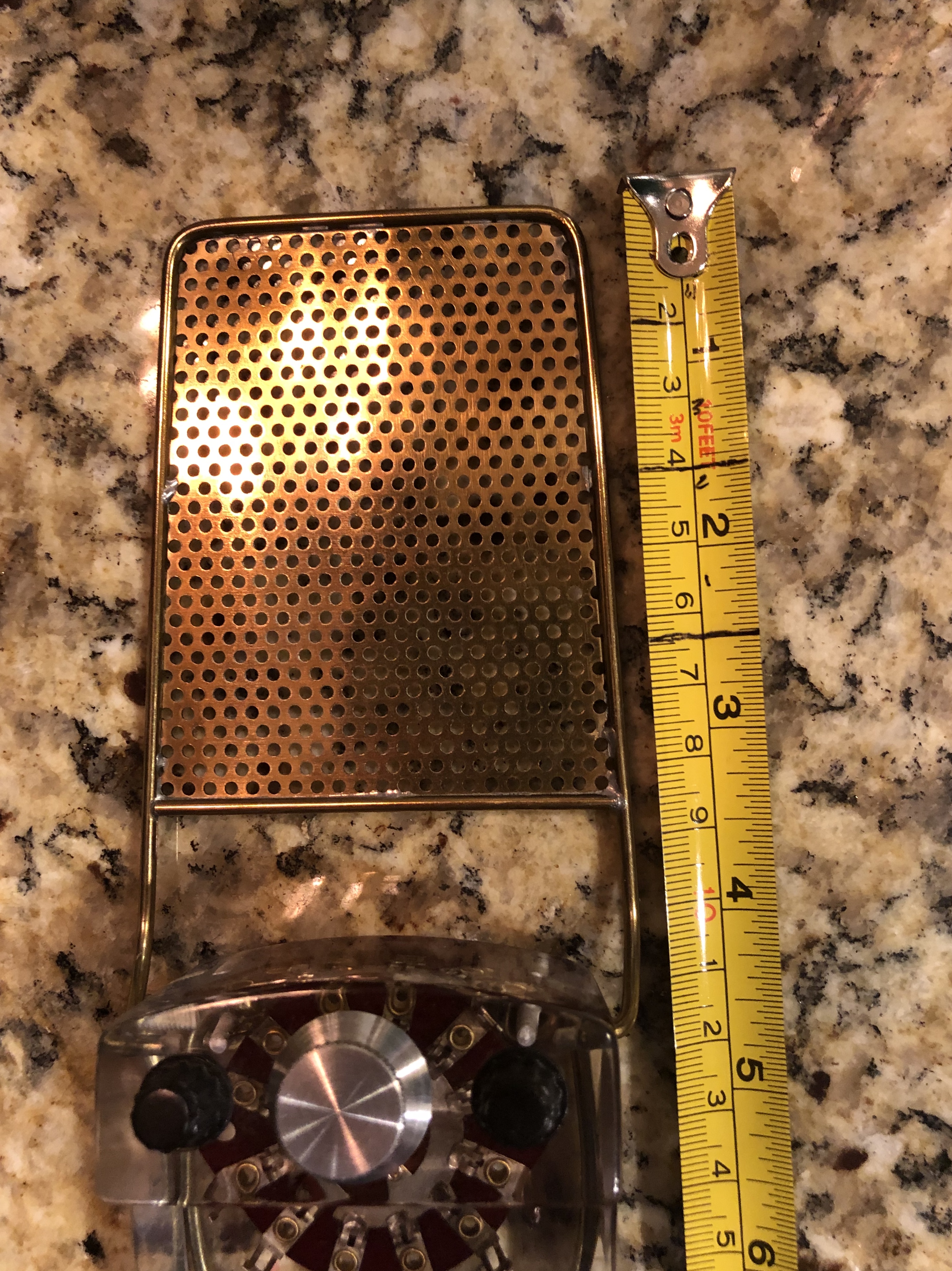

I see there was a request for some measurements of the prop, earlier. Her are some quick and dirty pics.
I hope this helps...
