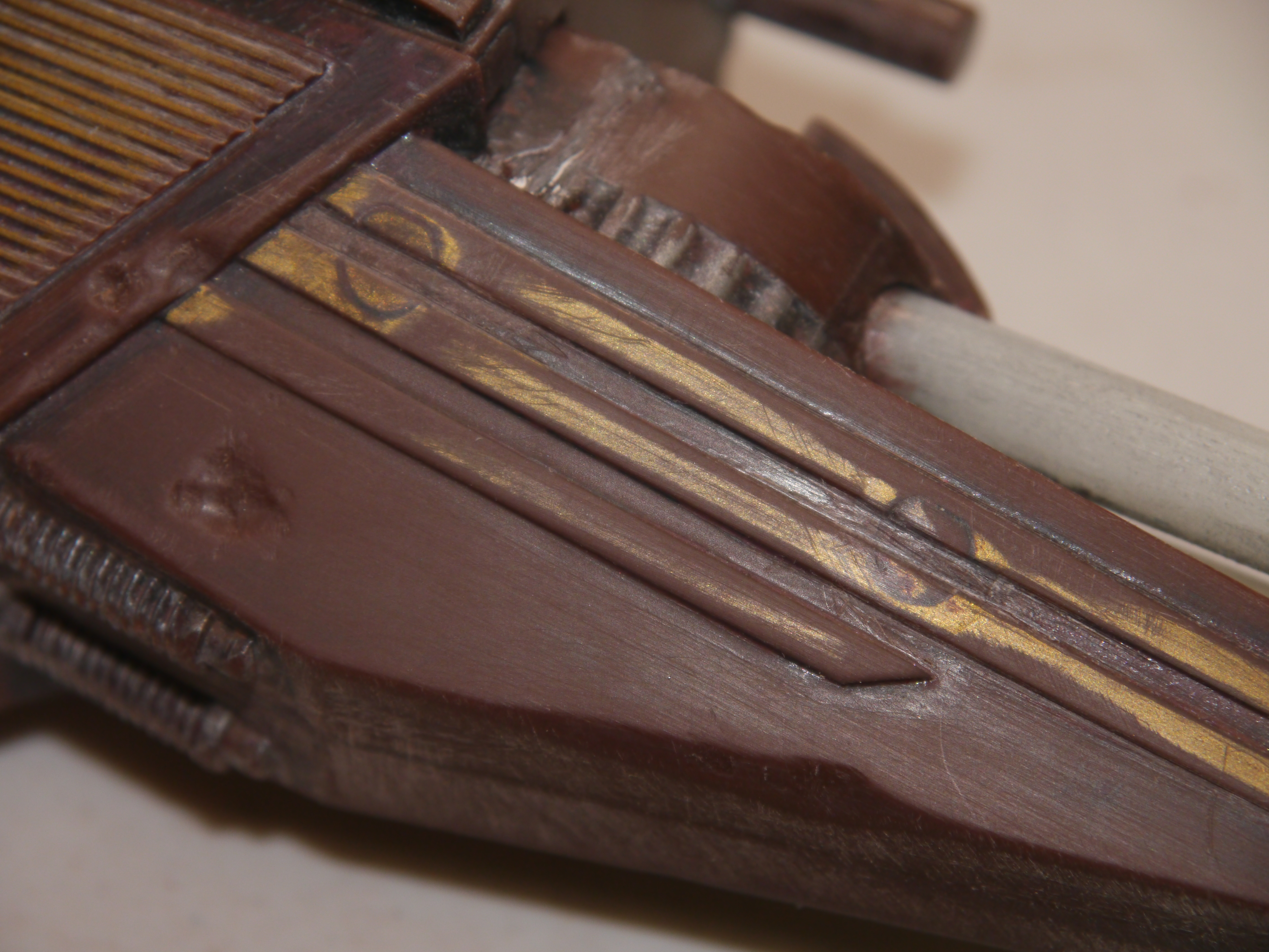

I got a toy disruptor as a gift a few years ago and decided to paint it. I applied the standard weathering techniques (dark paint wash and wipe for added detail, dry-brush silver paint for "scratches" etc). It looked alright but I could still tell that it was a toy. That bothered me but I let it go. Until about a week ago.

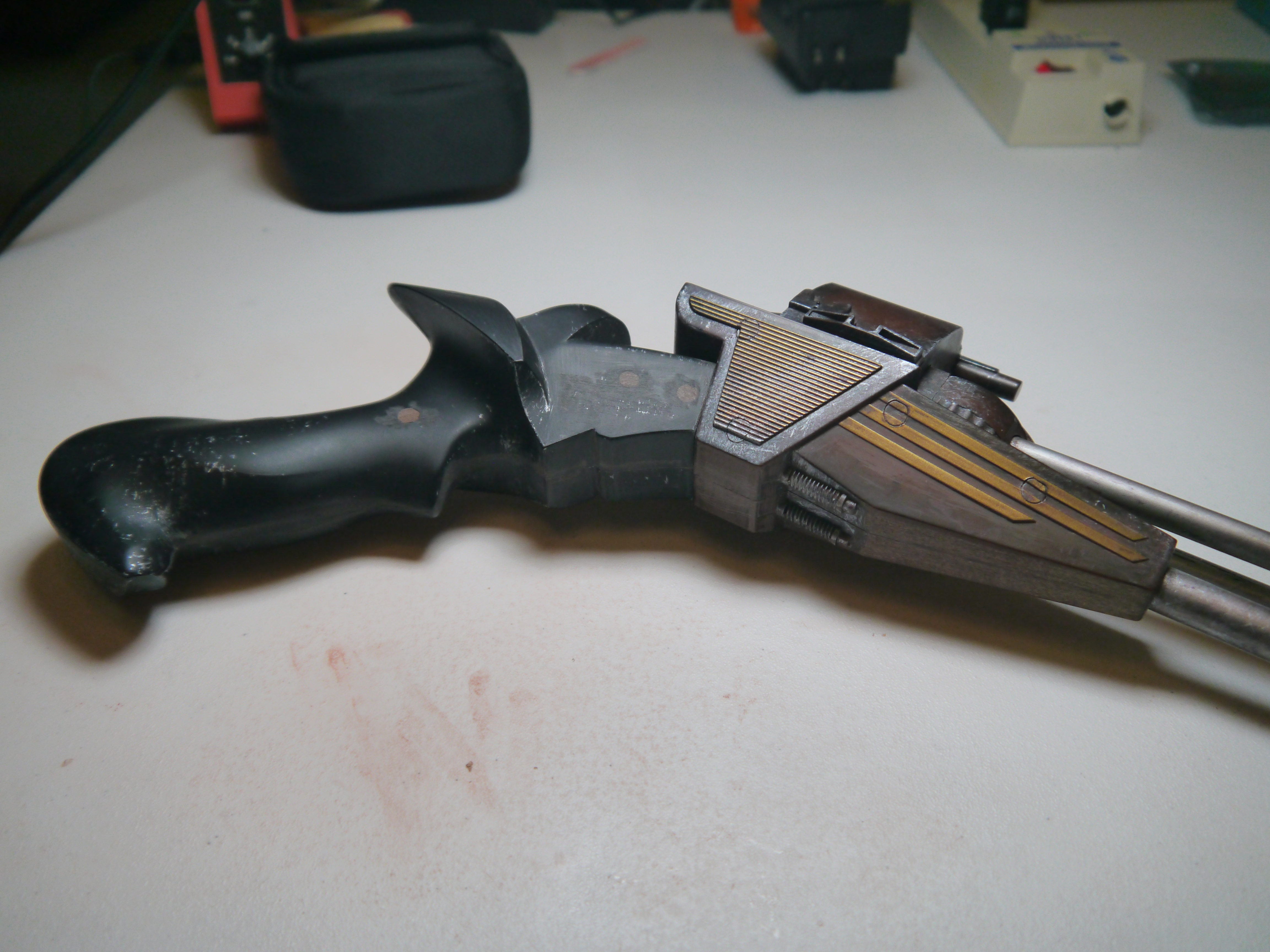

Here is the disruptor. You can see some of the weathering I've done. I'd already started to sand some of it off by the time I took this picture.
Here is the other side.

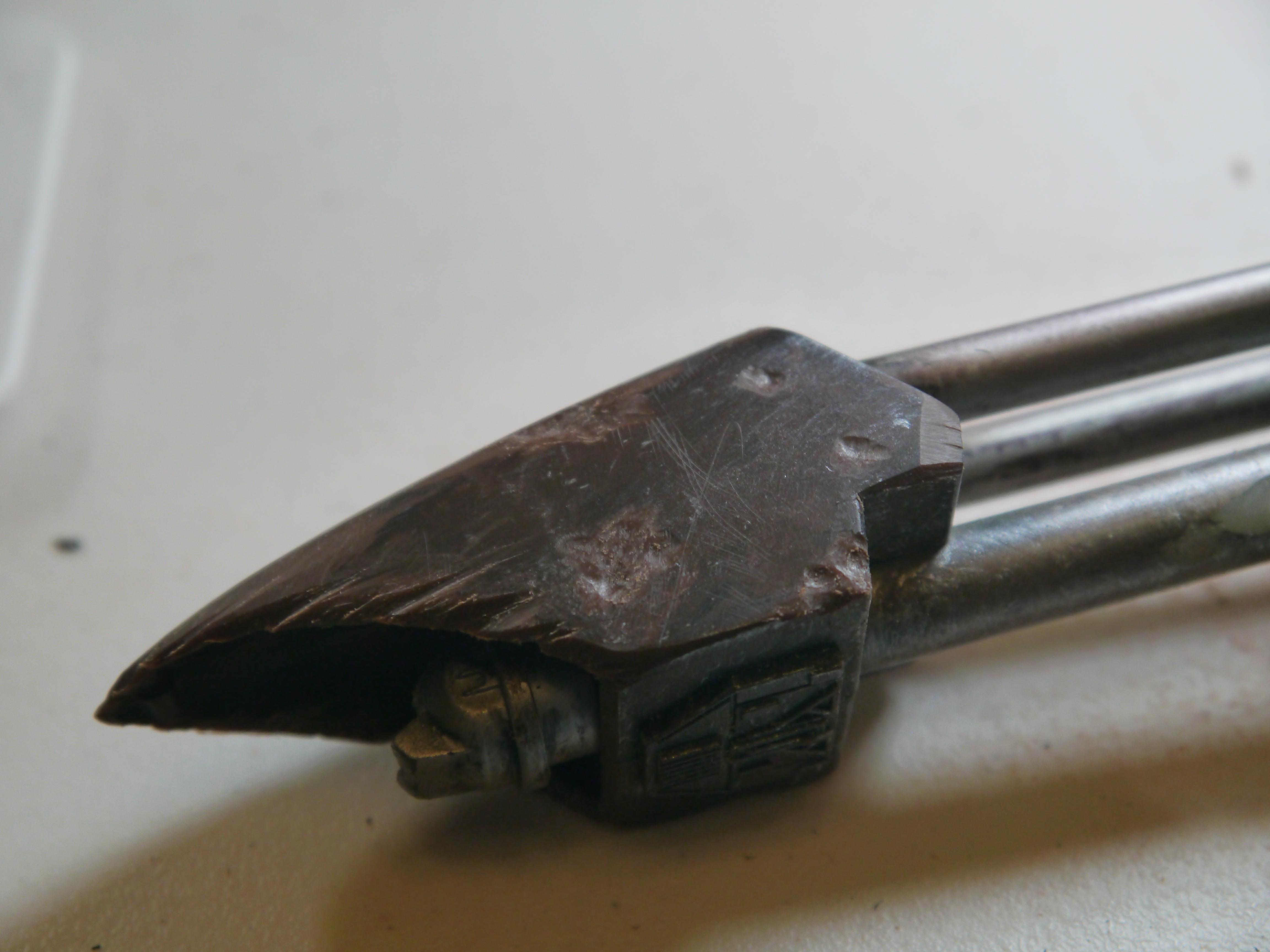

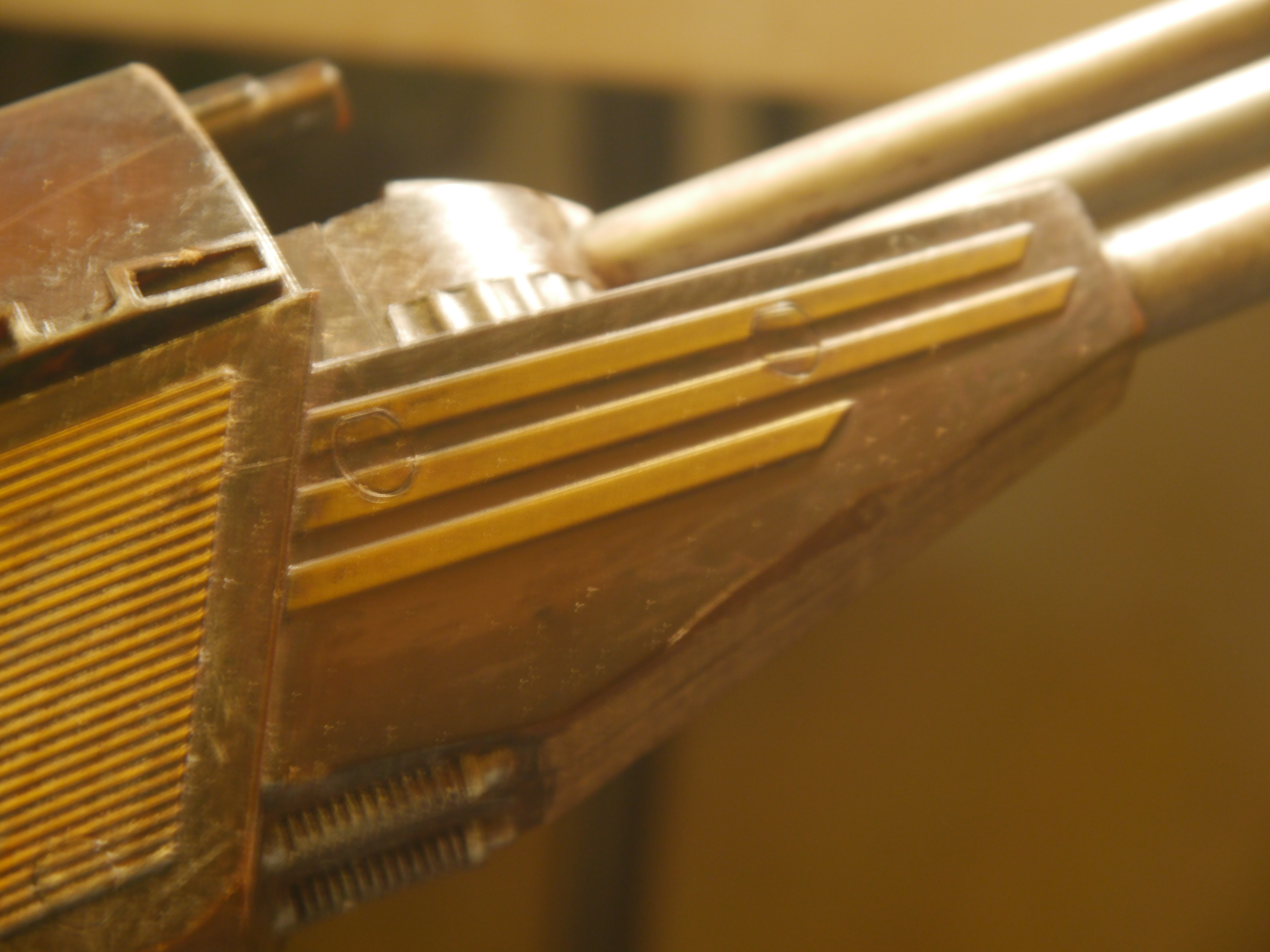

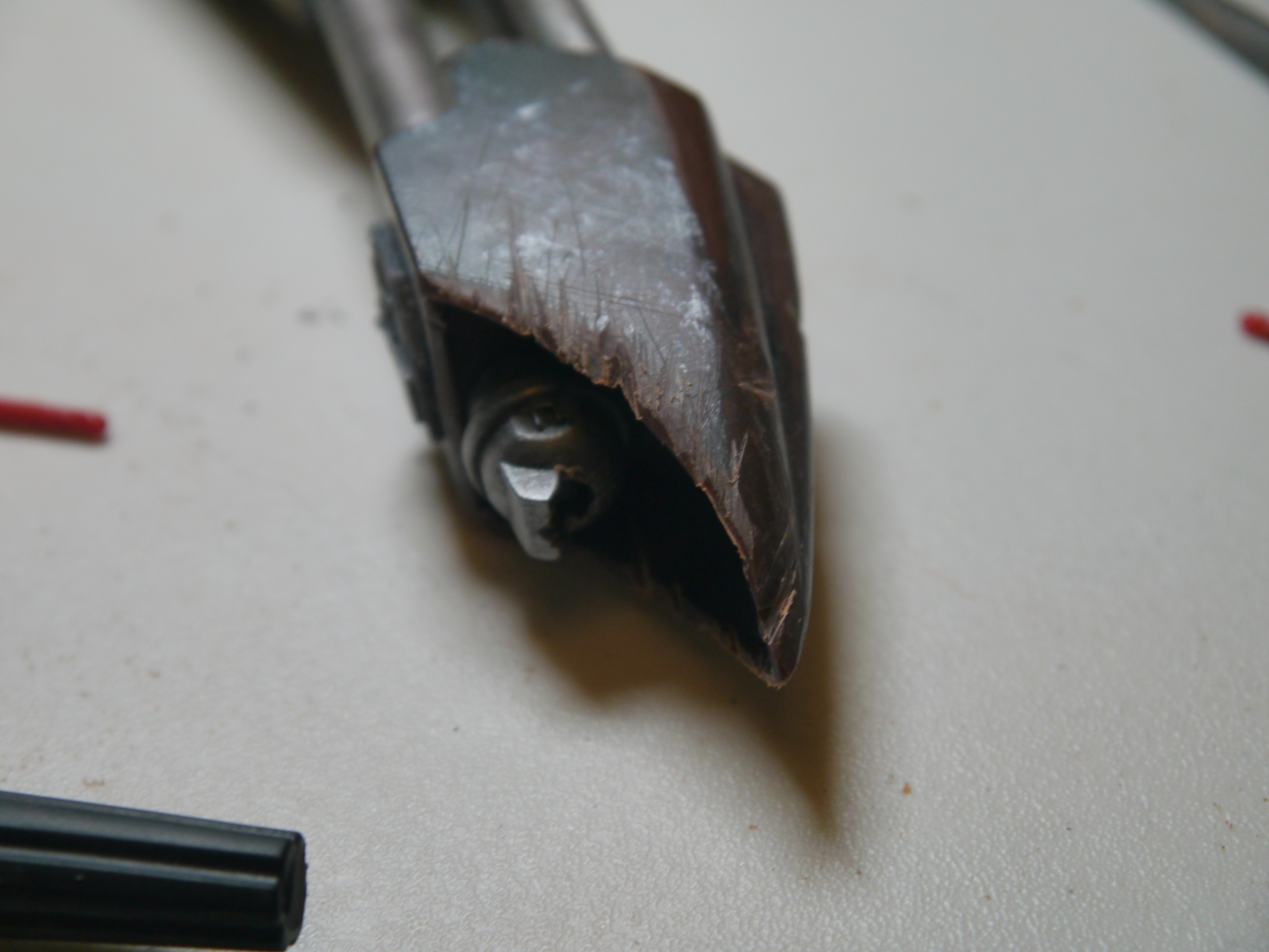

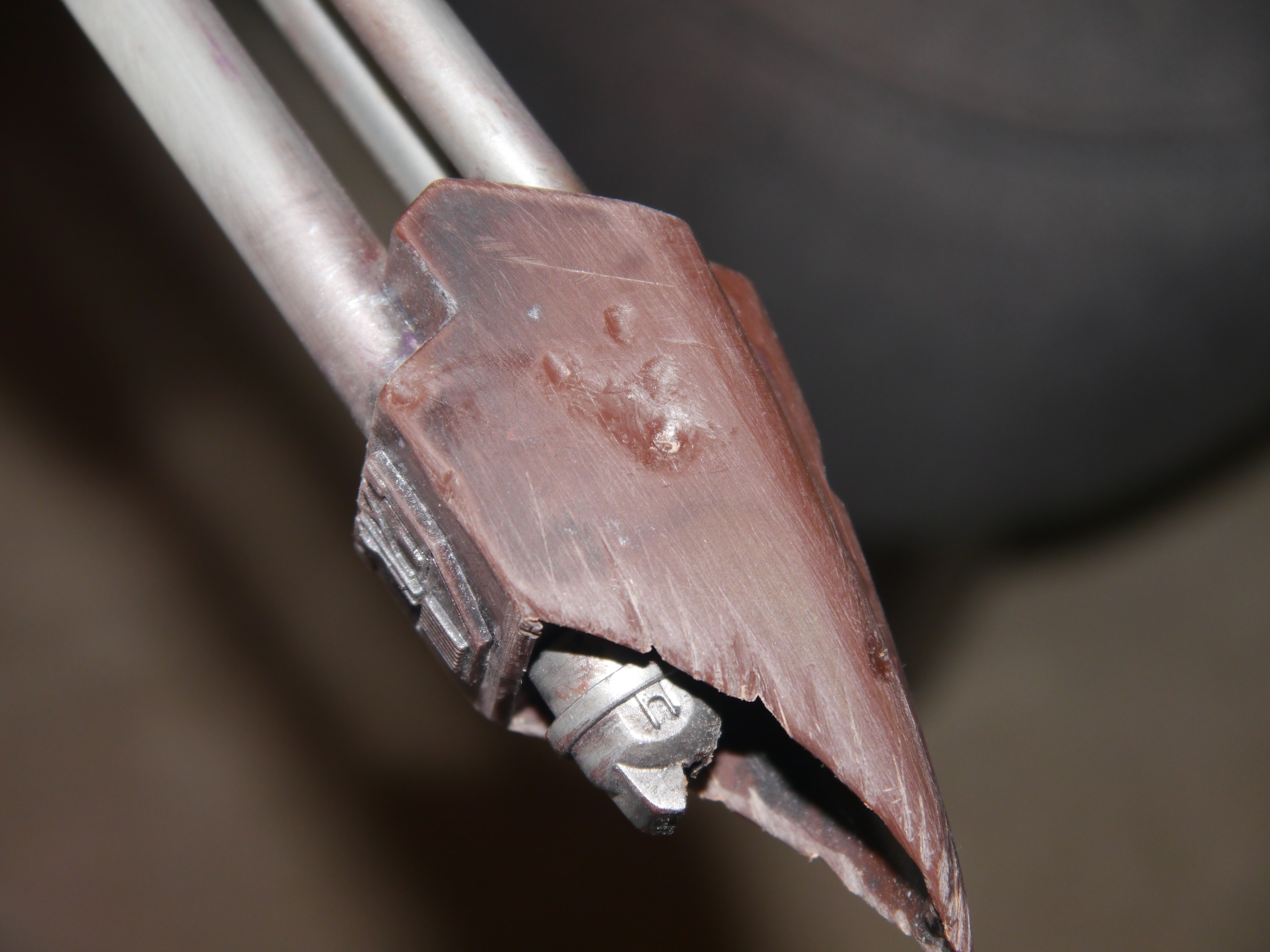

Here you can see I've been working on the tip of the barrel. I'm going for a ground metal look. I imagine the Klingon that owned this wanted to make his disruptor even more deadly. I used a flat file and some needle files.
You can see here how overboard I went on the dry-brushing. Also, you can see how I'm starting to work on sanding down the seams.
More detail on the tip of the barrel. I've added some more scratches with my needle files and I'm still going for that grinded metal look.

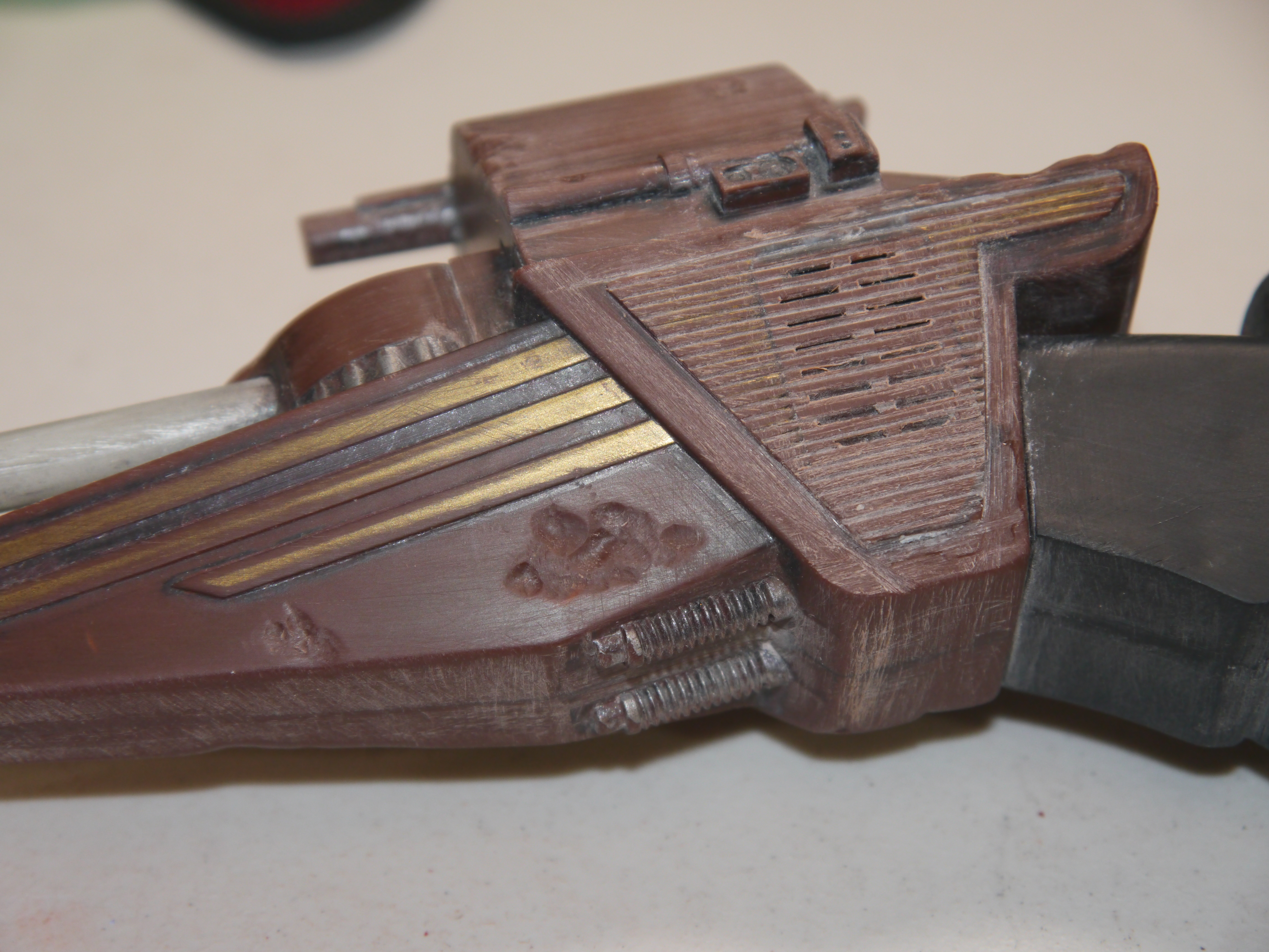

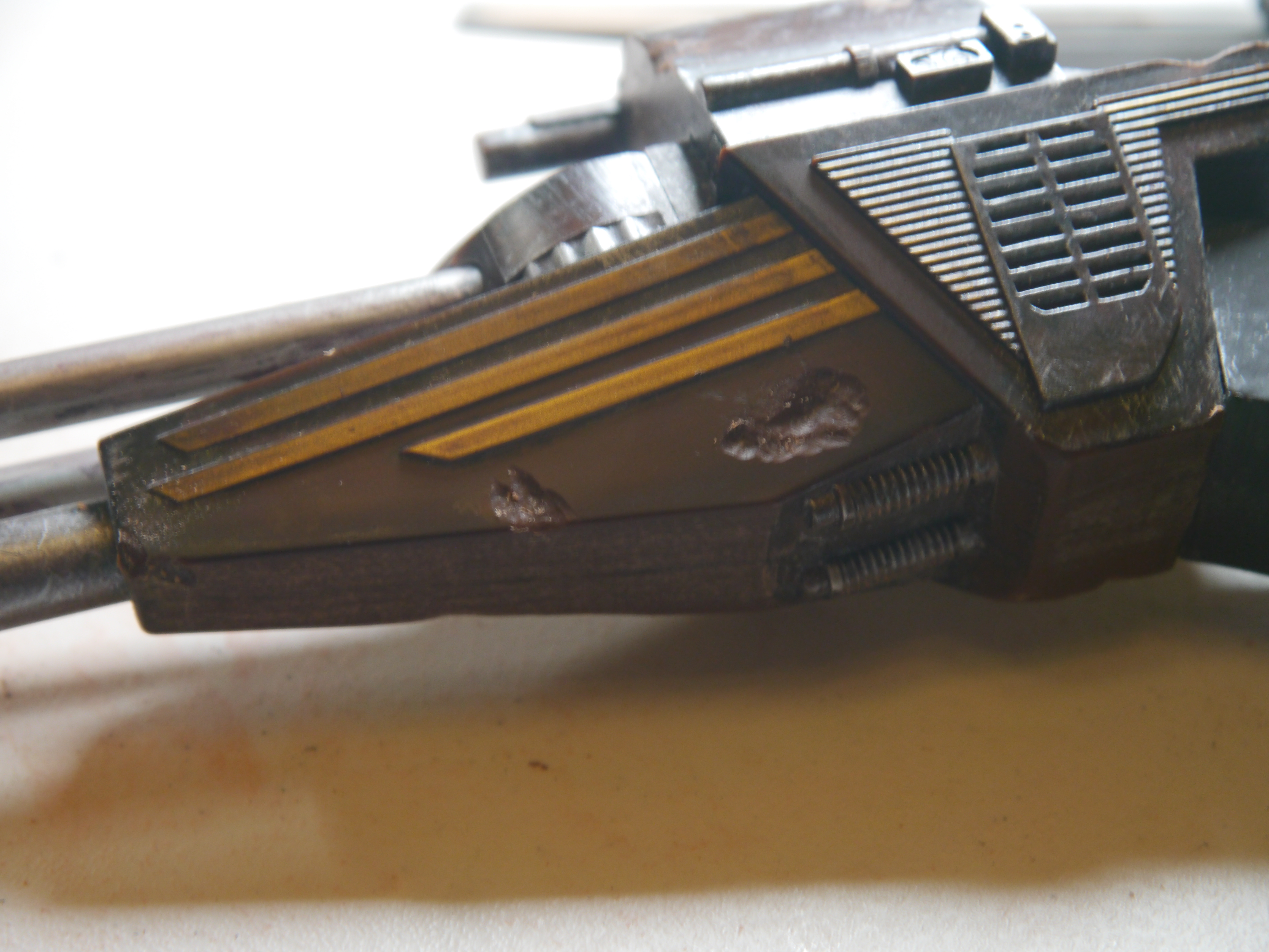

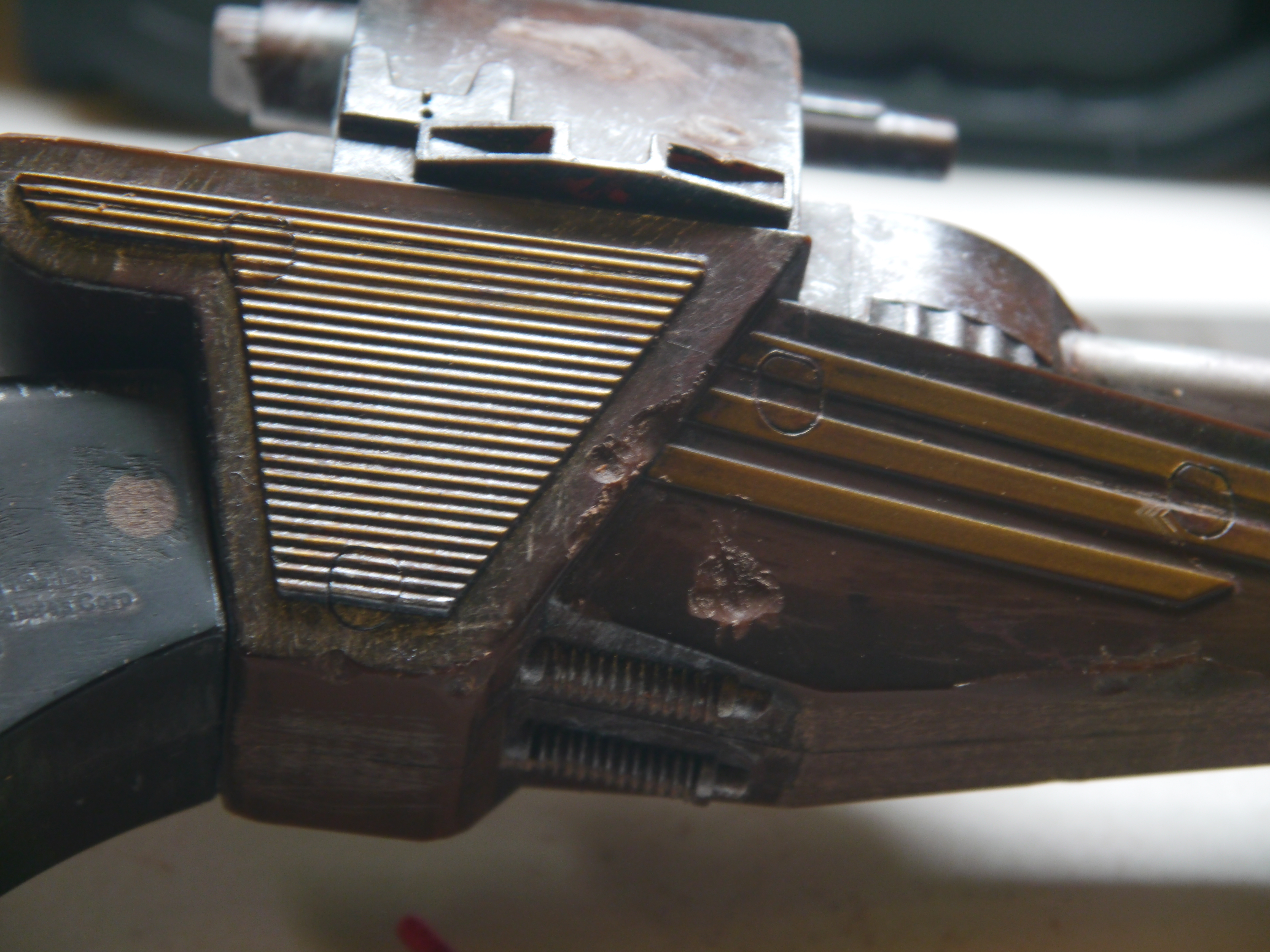

Detail on the body of the disruptor. I'm starting to add dents using a Dremel 8220 and a rounded stone grinding bit.

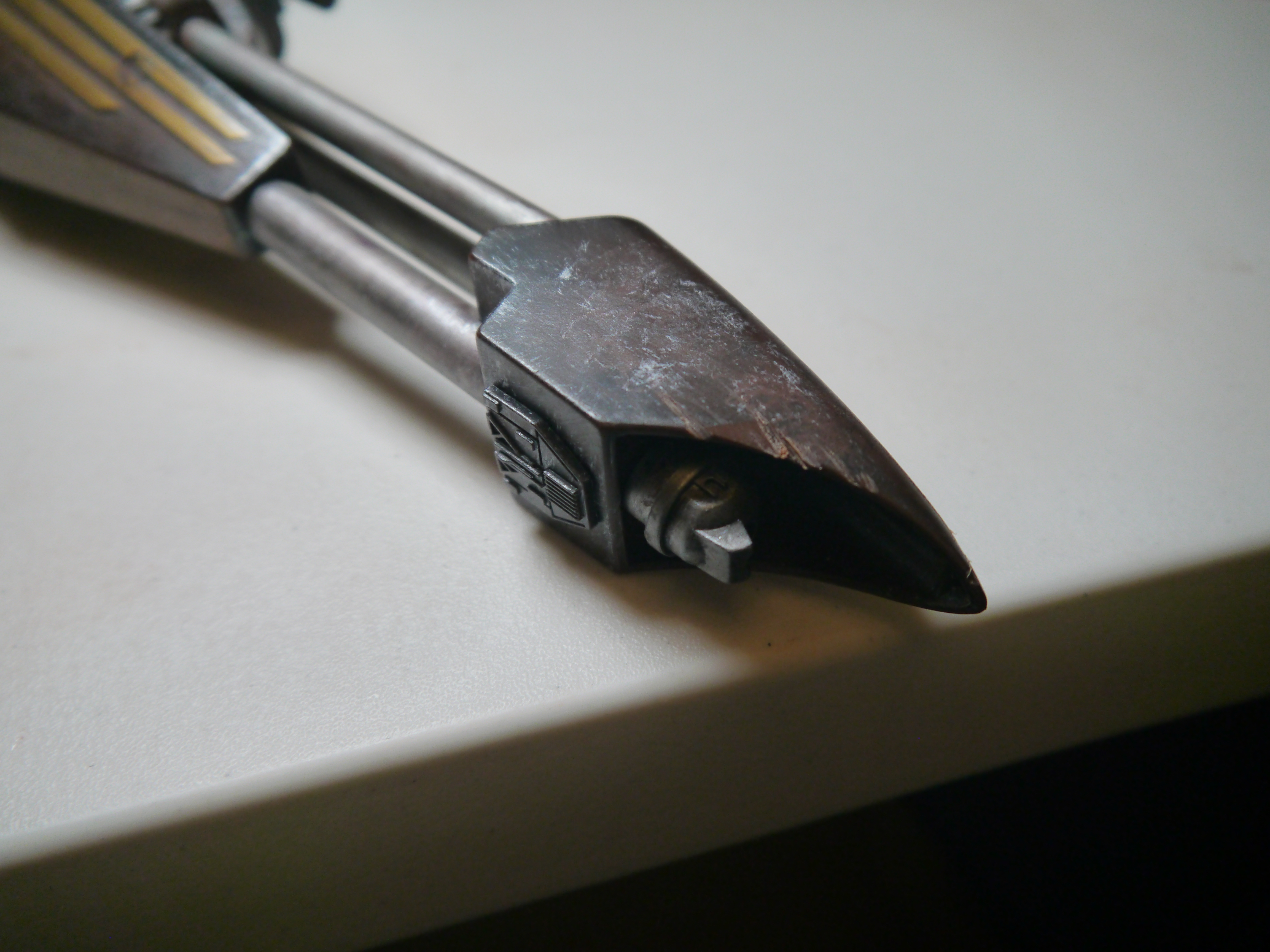

Needle file and round file provided the scratches, grinding marks and dent on this side of the barrel tip.

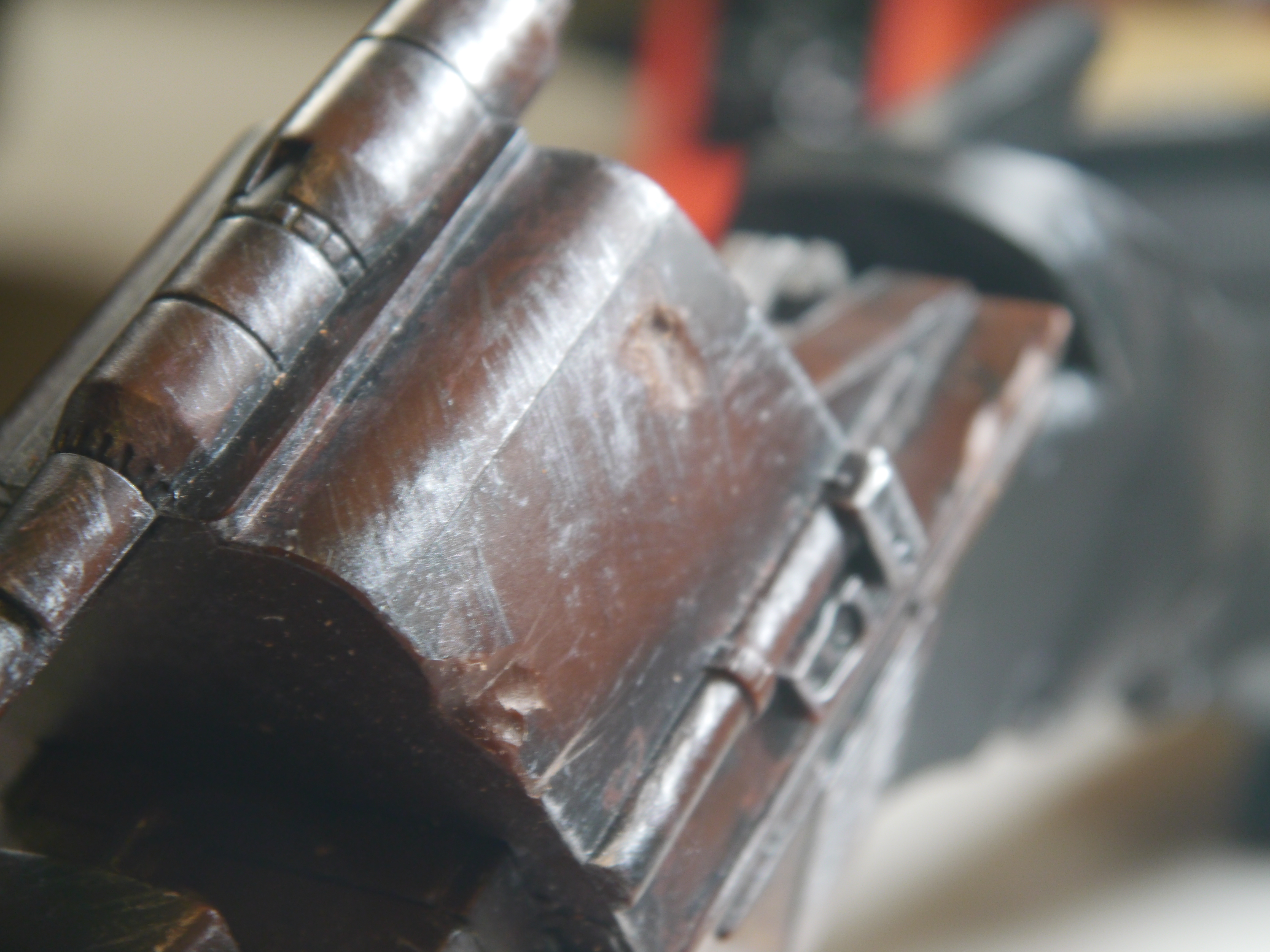

Added some dents with my rounded stone bit. Also, used a flat file to file down some of the corners.

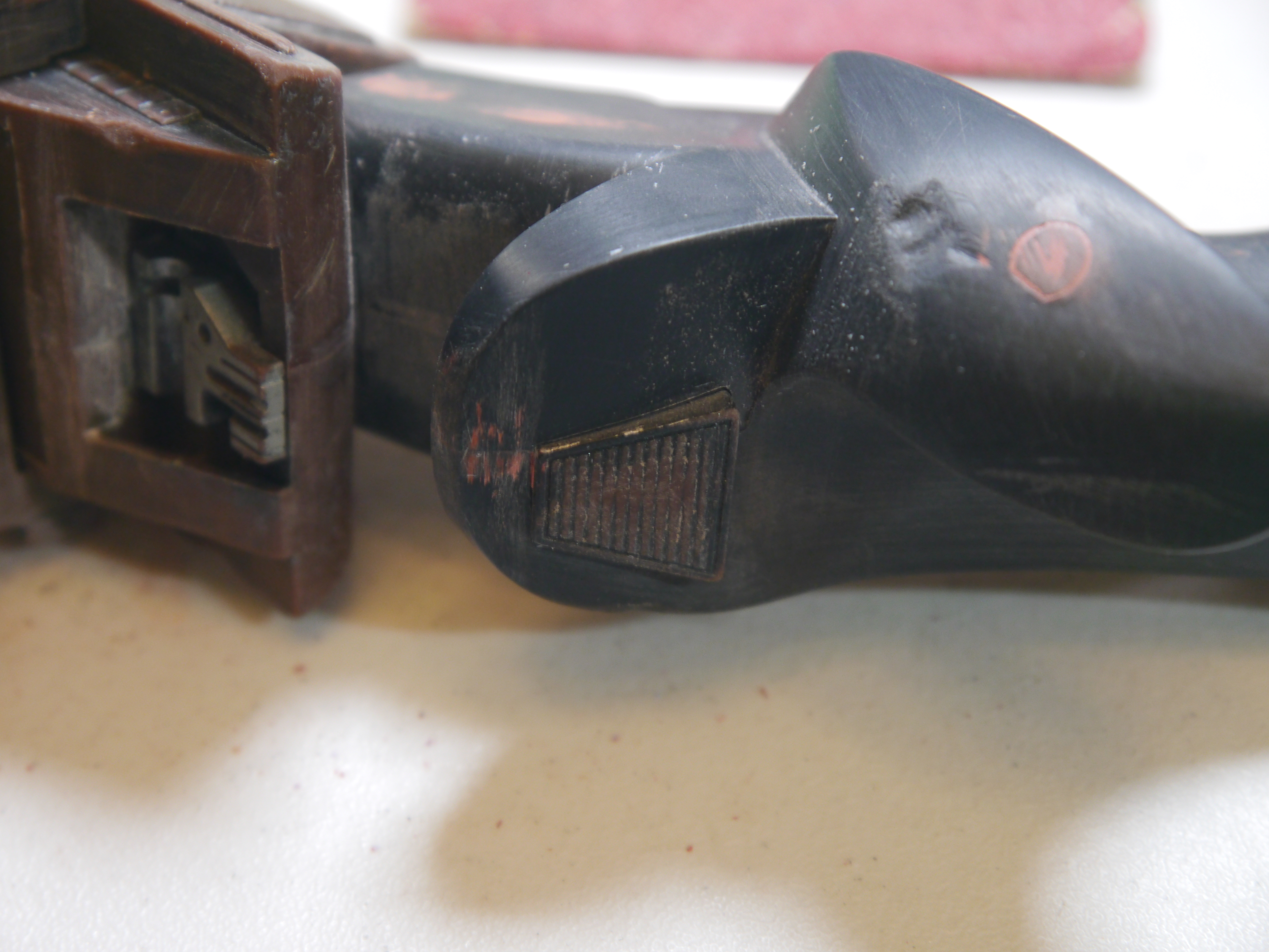

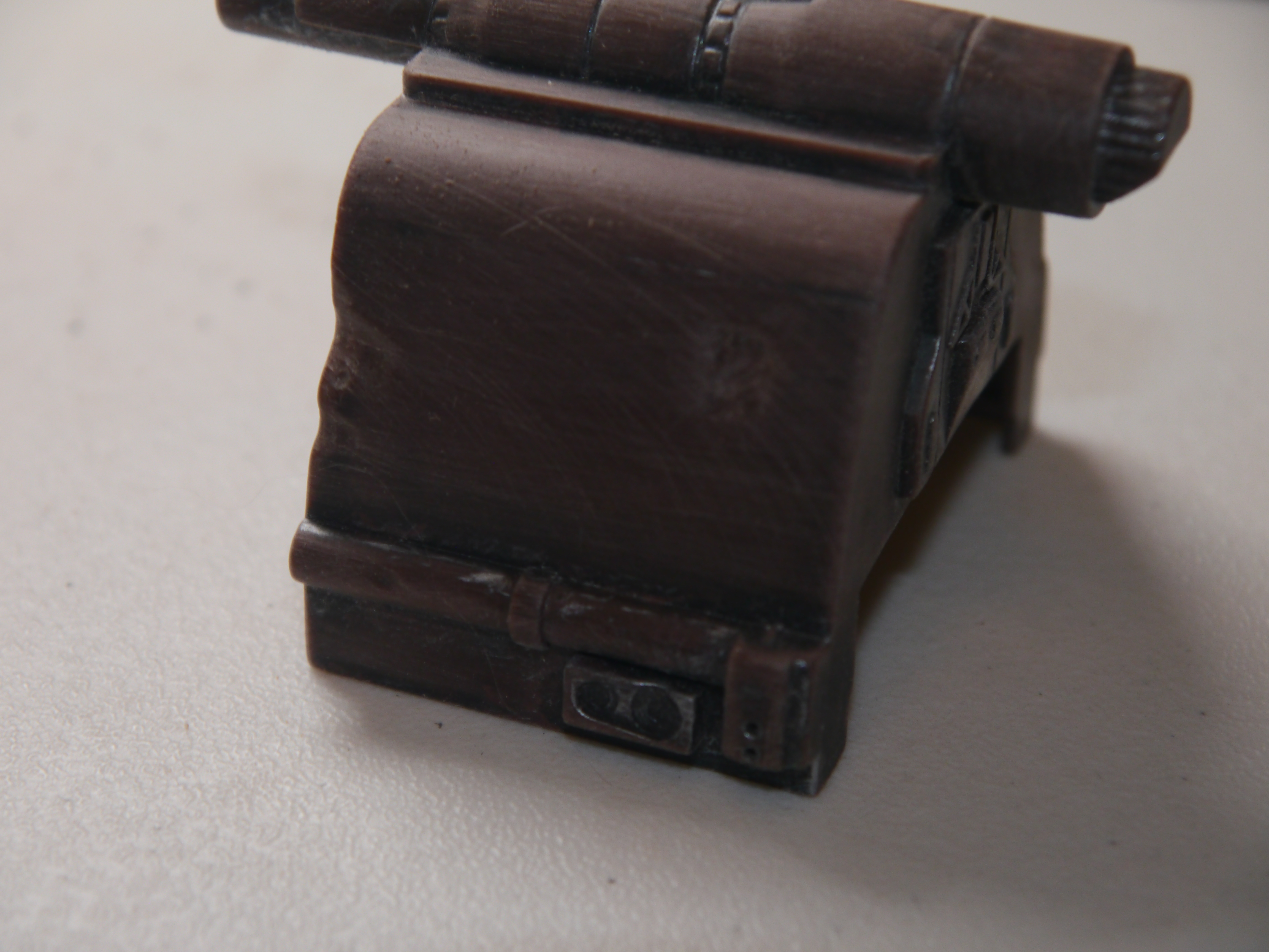

More dents with the rounded stone bit. Good picture of that annoying speaker hole on the side. I will deal with that later.

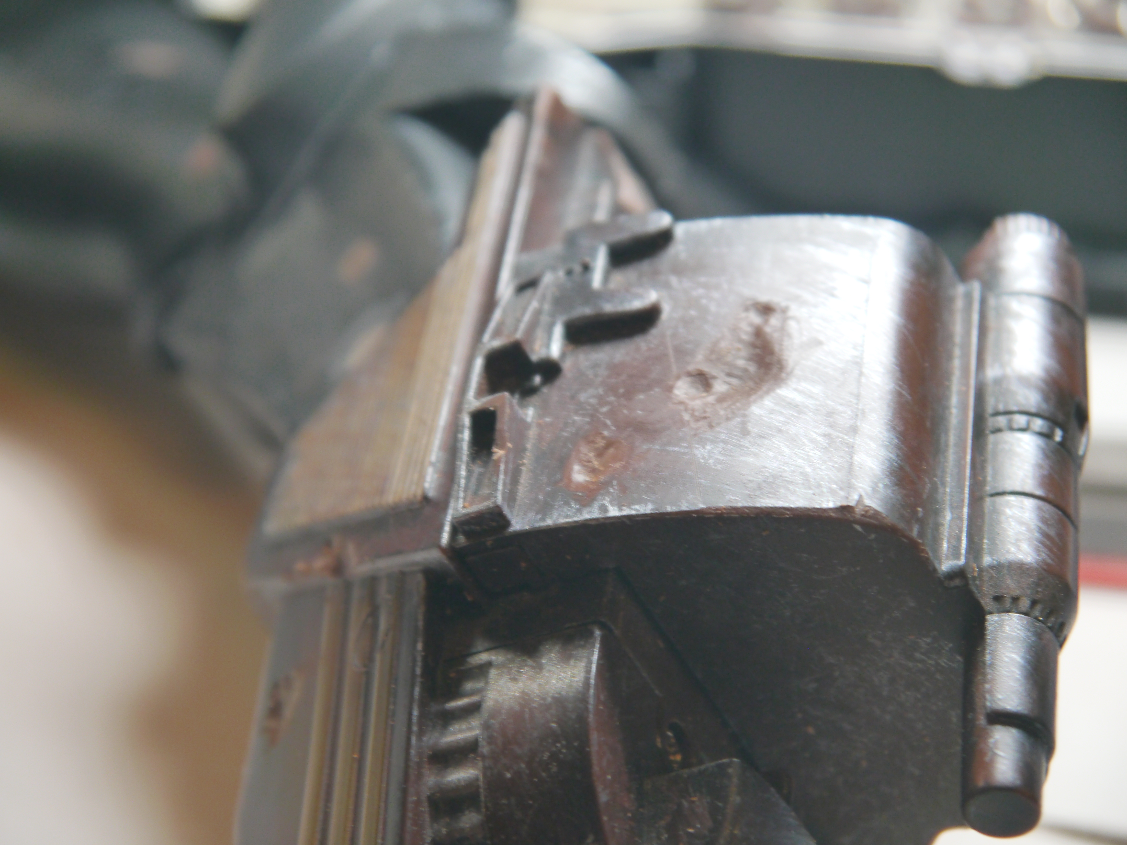

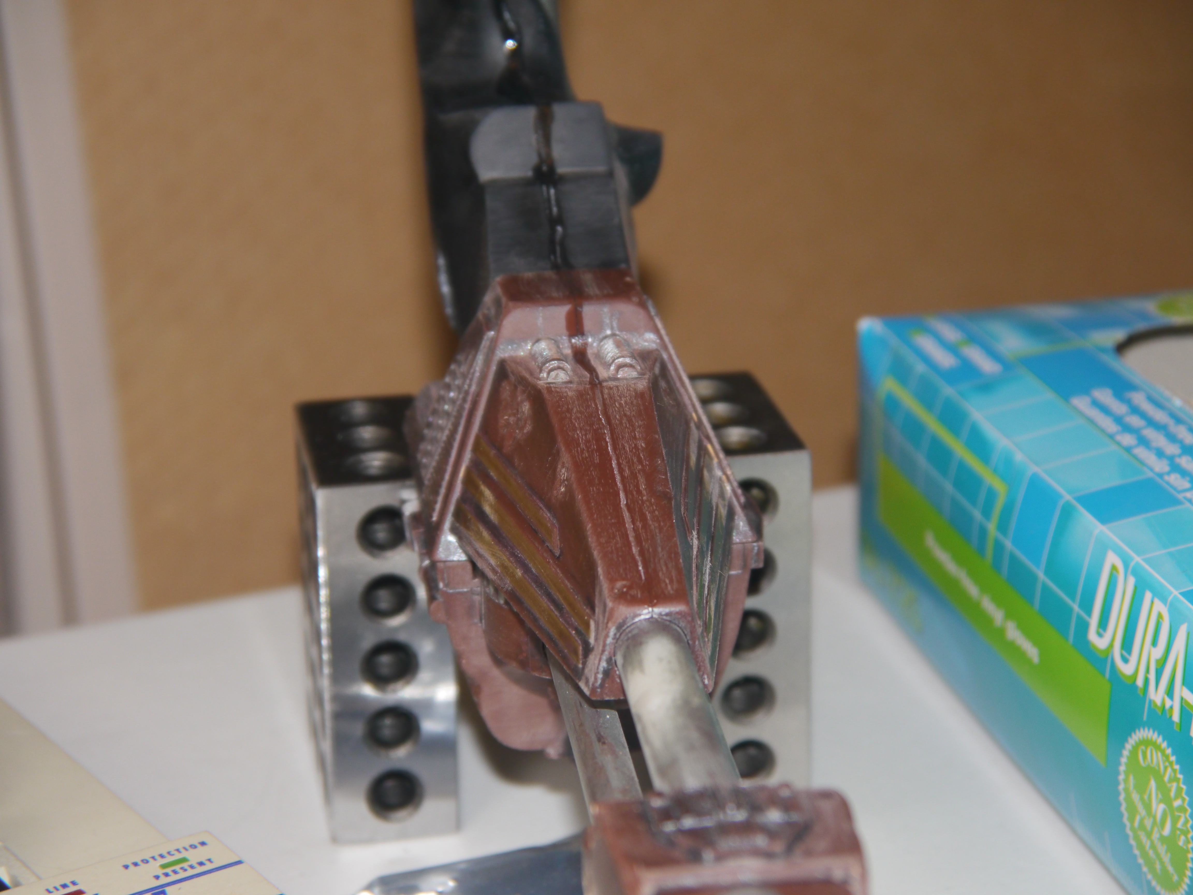

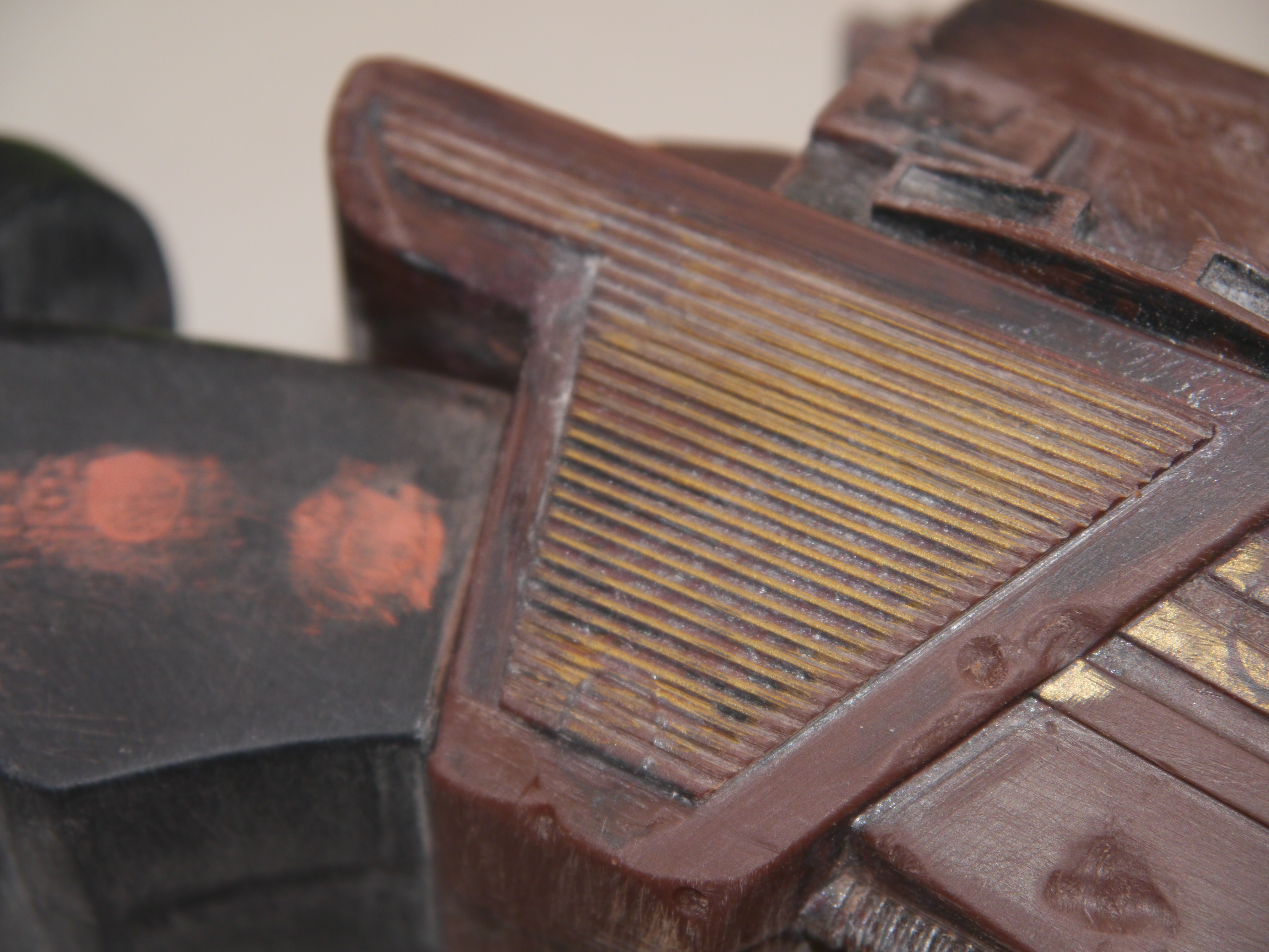

I call this the targeting hump. I've added some denting. You can still see my heavy handed weather from before.
More Target hump dents.

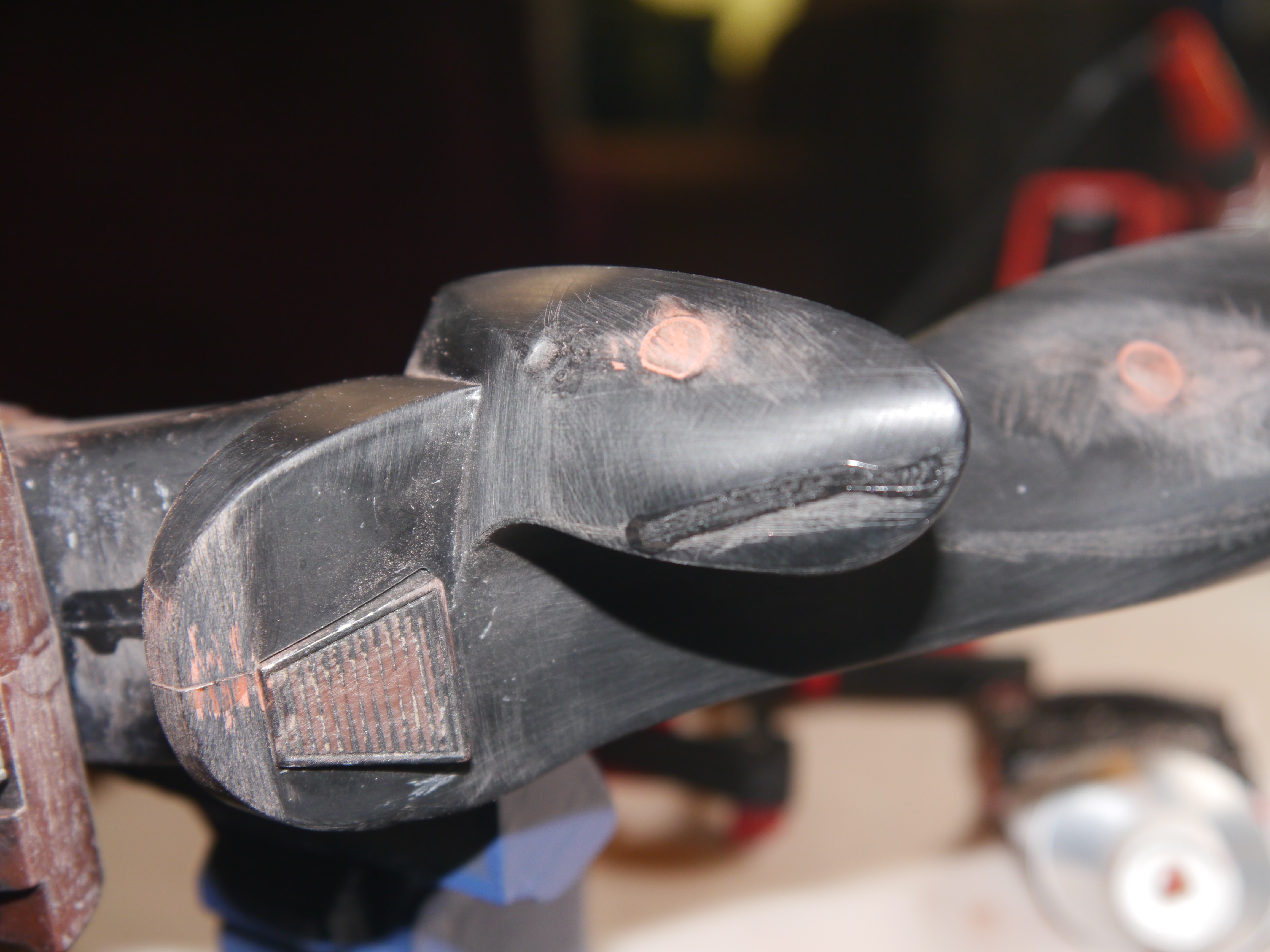

More dents! Those plugs though...

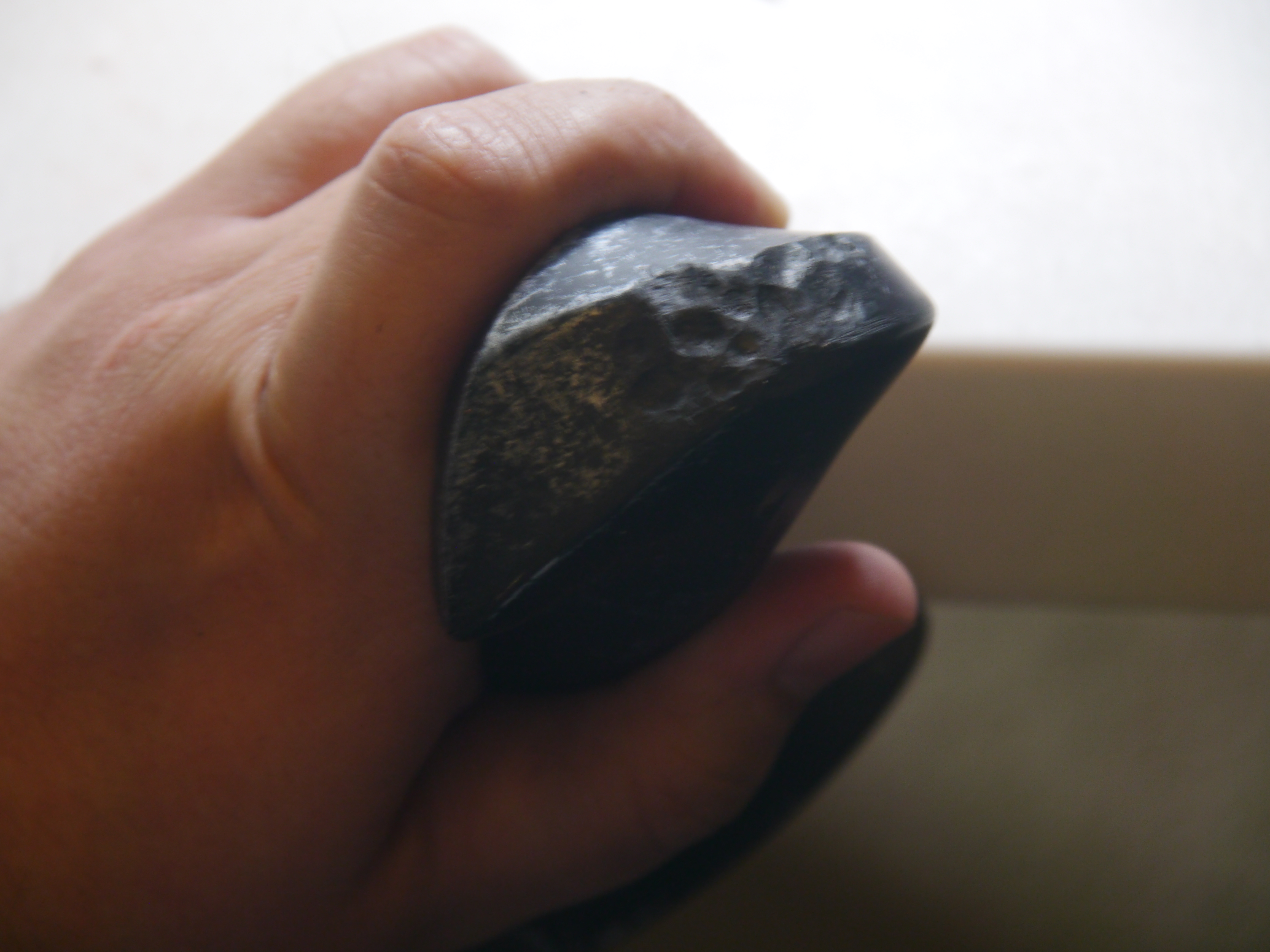

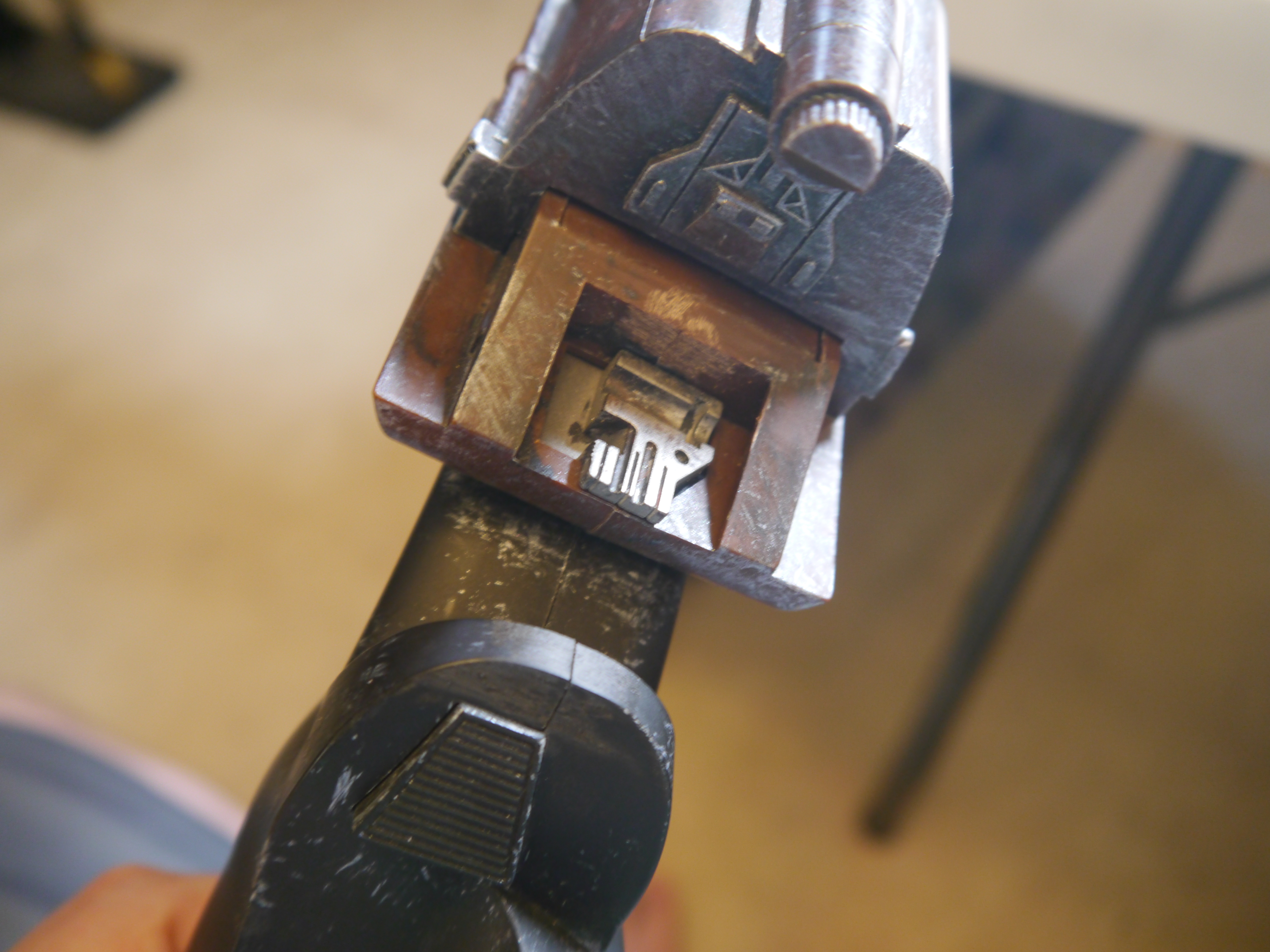

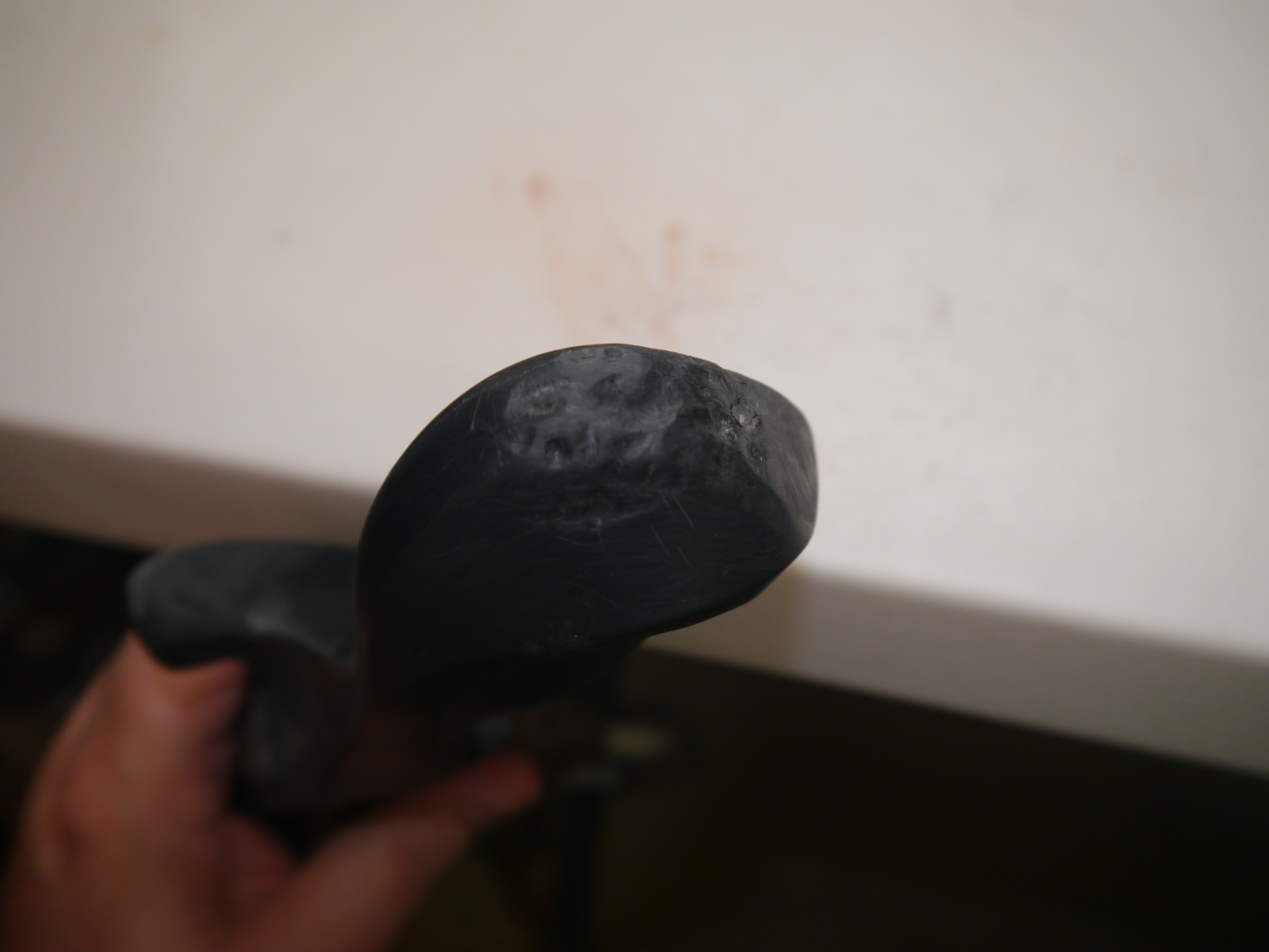

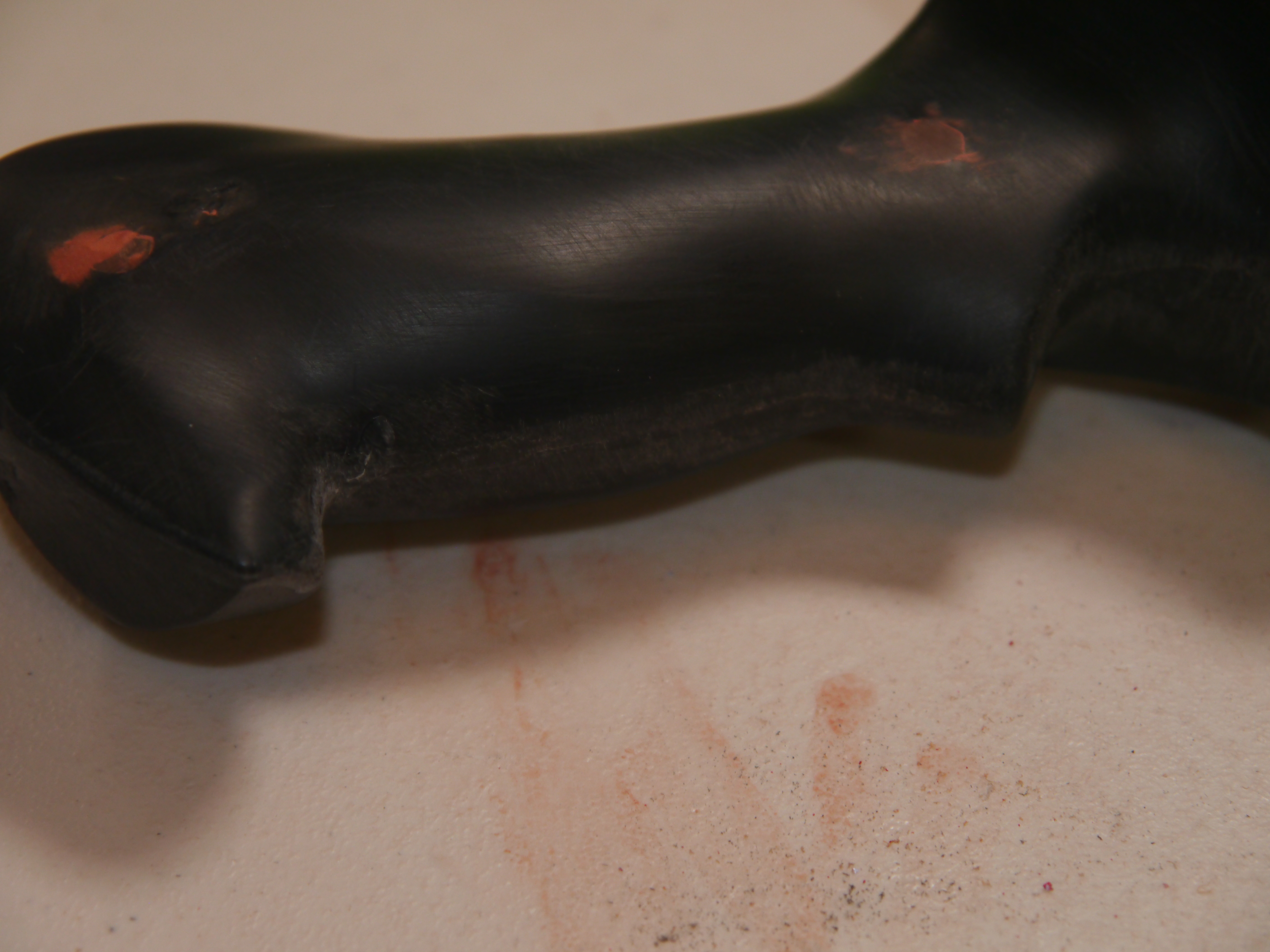

My thought here was that the butt of the disruptor has probably been used more that once to crack some skulls. I used the rounded stone bit.

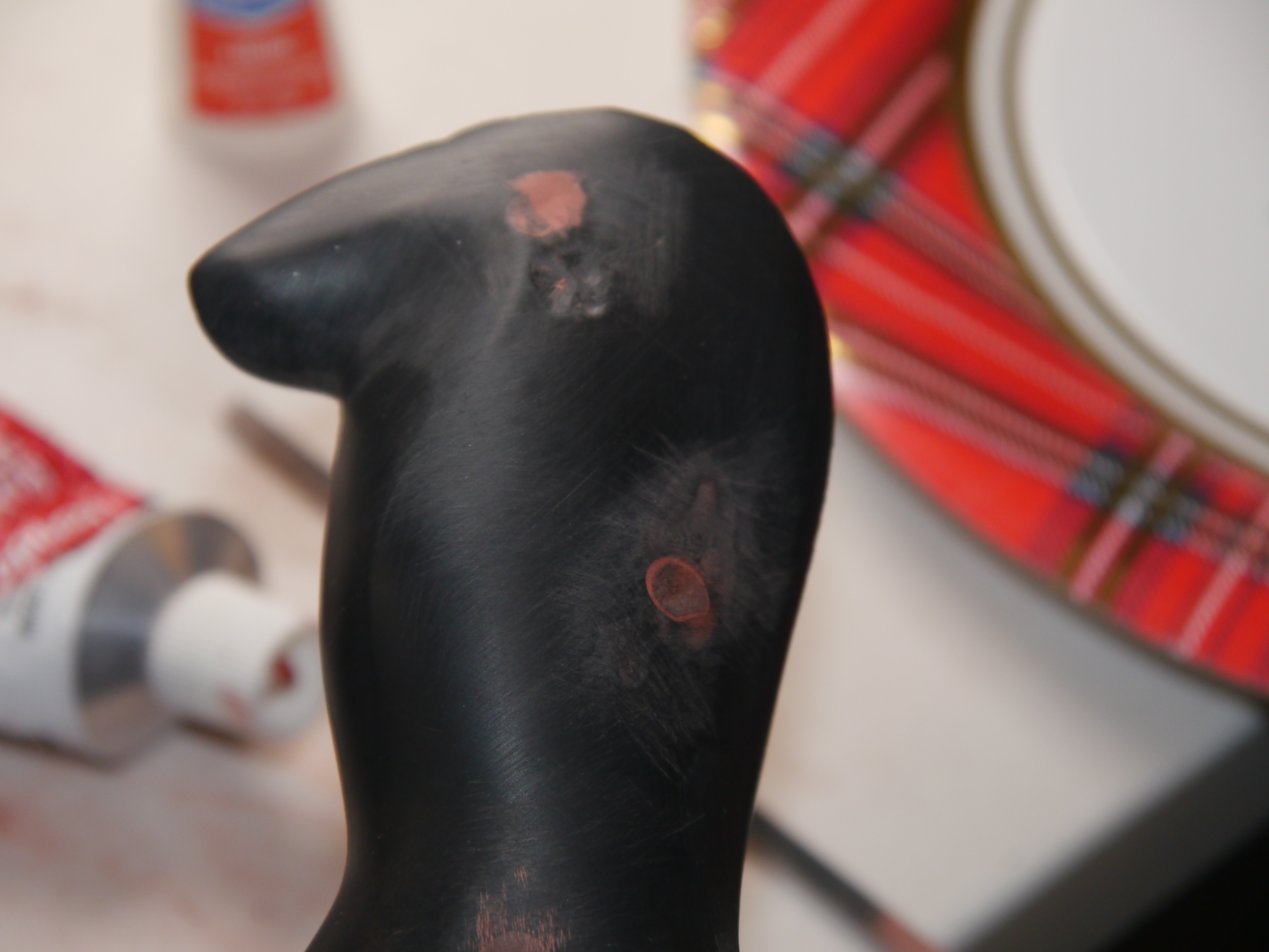

I'm dealing with the plugs! That is super glue in the process of drying. I was out of accelerant at the time. Feels like it took forever to dry.

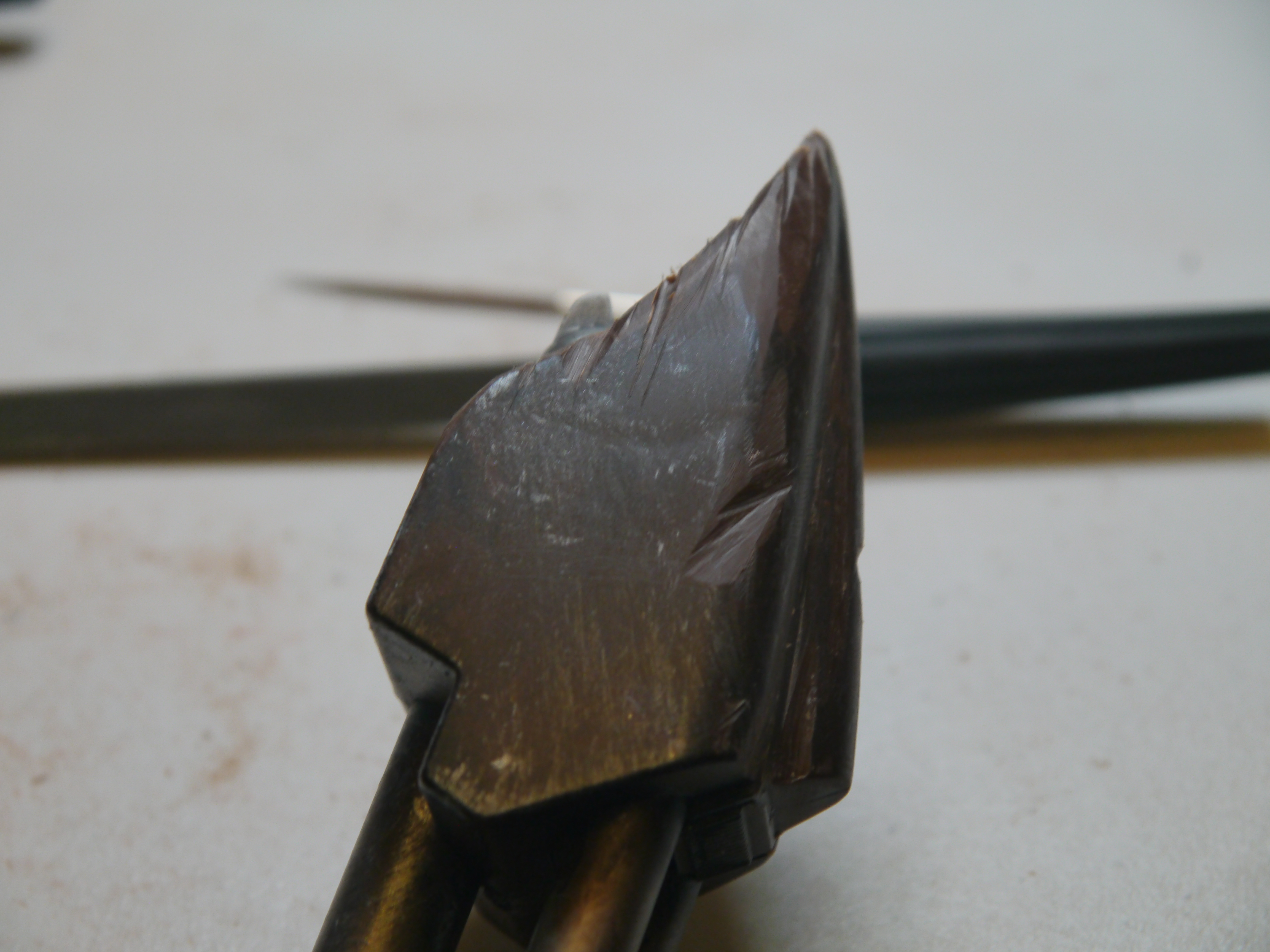

Barrel tip detail. I kept messing with the dents with my rounded stone bit. I added some dents to the corners and deepened the big dent on this side. I also deepened some of the grooves and used a round file to add some different character to the grinding marks.

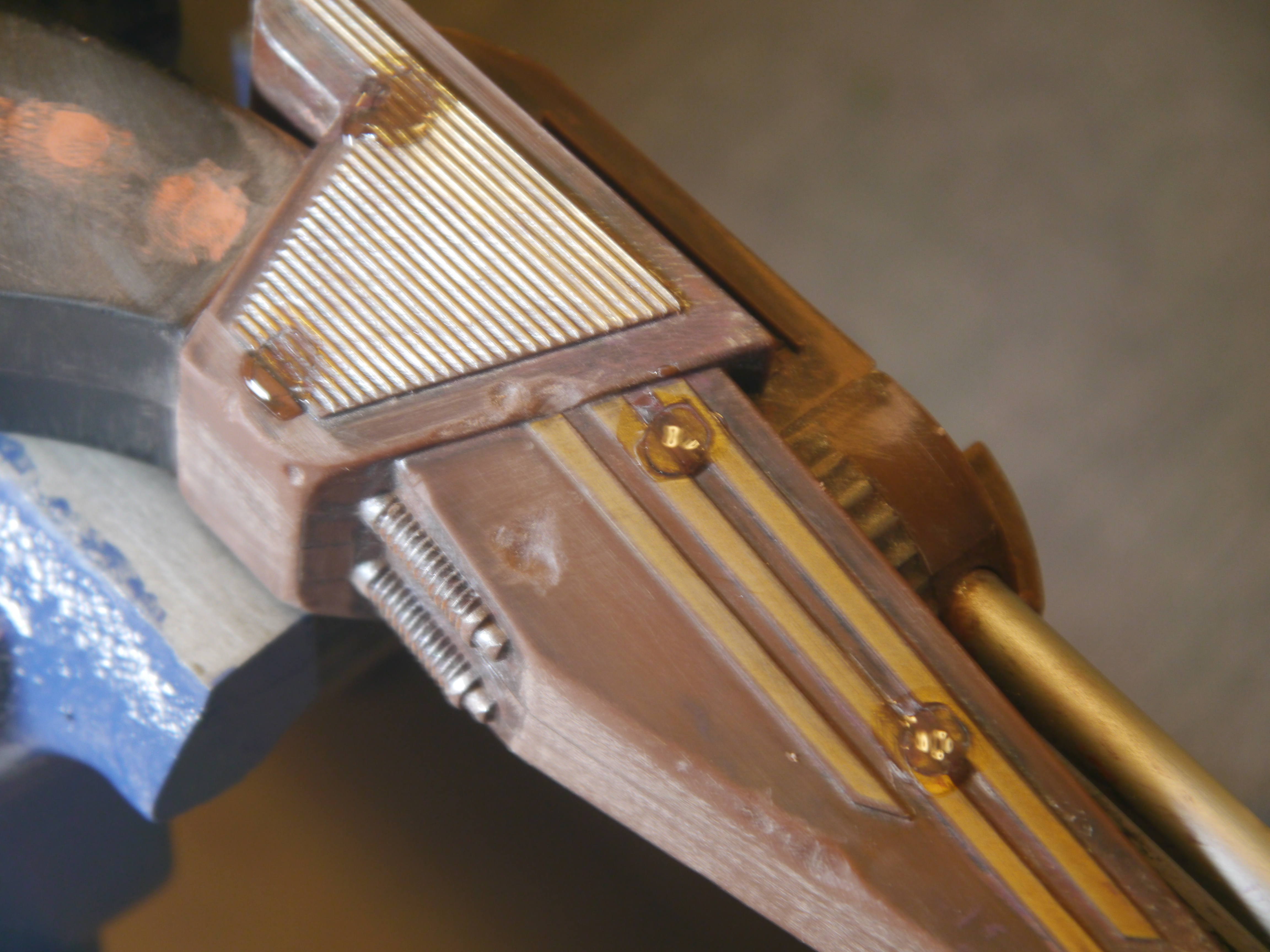

I covered up the plugs on the grip with Bondo filler putty. I then sanded it down flush with the rest of the grip.

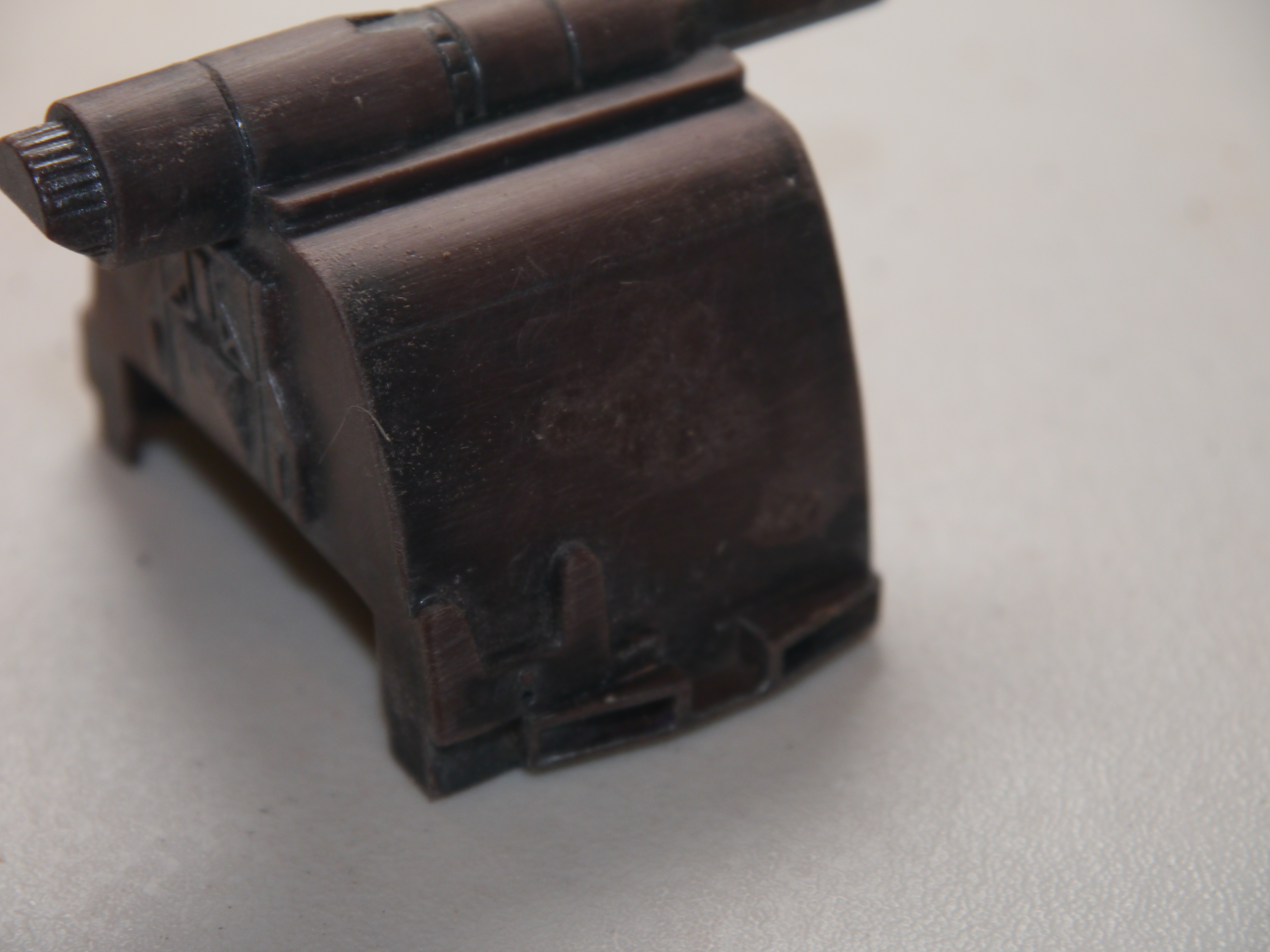

I added more denting to the left side of the target hump. I also sanded off most of the horrible weathering I did.
Right side of the target hump has more dents and less weathering. Yay.

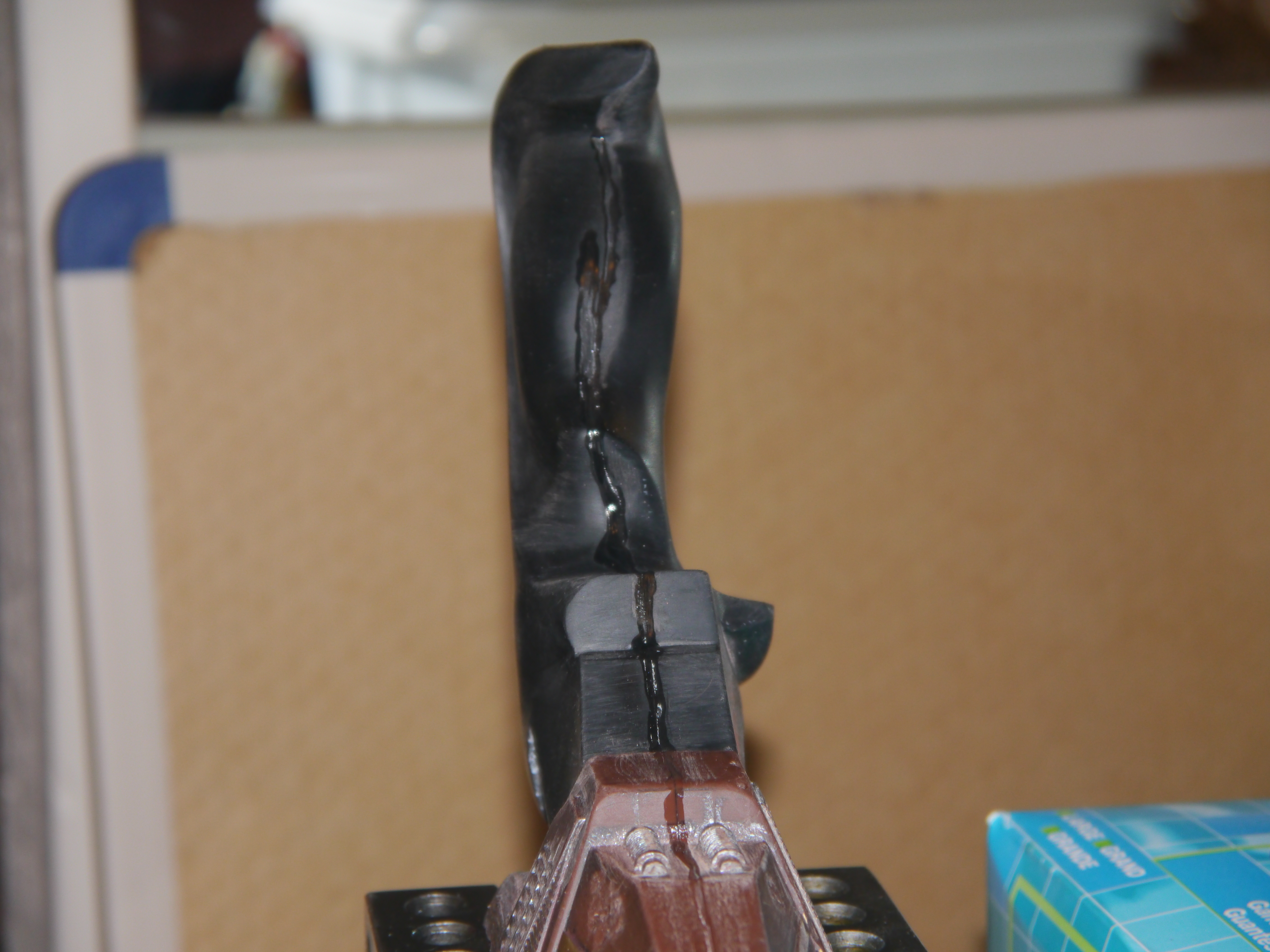

I used superglue to seal the seam on the grip.
More grip. More seam. More superglue.
Again.
Again.

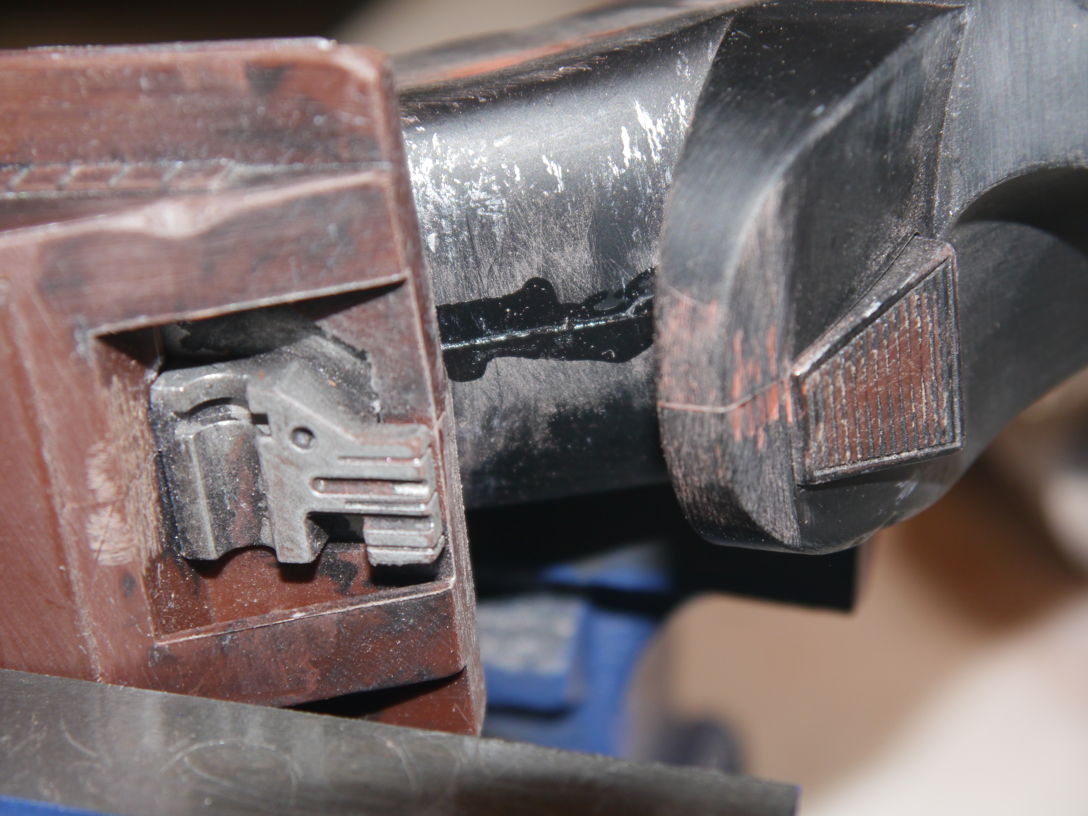

A good detail of the trigger. I decided the Klingon that owned this had used it so much the trigger was worn down. I used my rounded stone bit to provide the wear and tear.
Remember that super glue that was drying earlier? Well it dried and then I sanded it down using my needle files. Once it gets painted you won't even notice.
Same thing here.

I added some more dents to the butt of the grip.

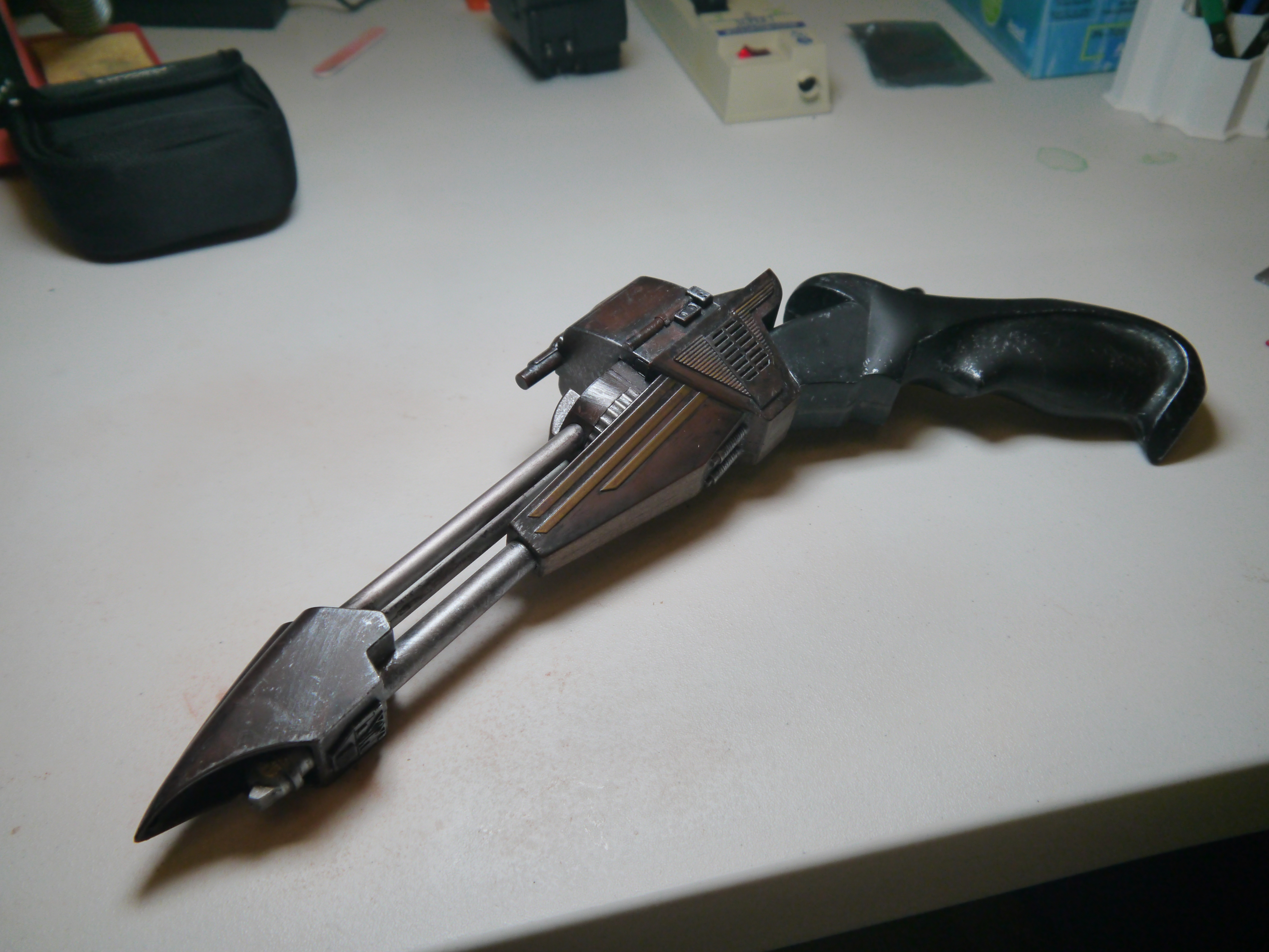

That's it. That's the build so far. Next step is prime and then paint and then weather! Yay!
I had to move this project down the list for awhile but it is back on my work table and I'm getting ready to work on it again. Last thing I did was hit it with a layer of primer so I will get it sanded up and start painting here pretty soon.
