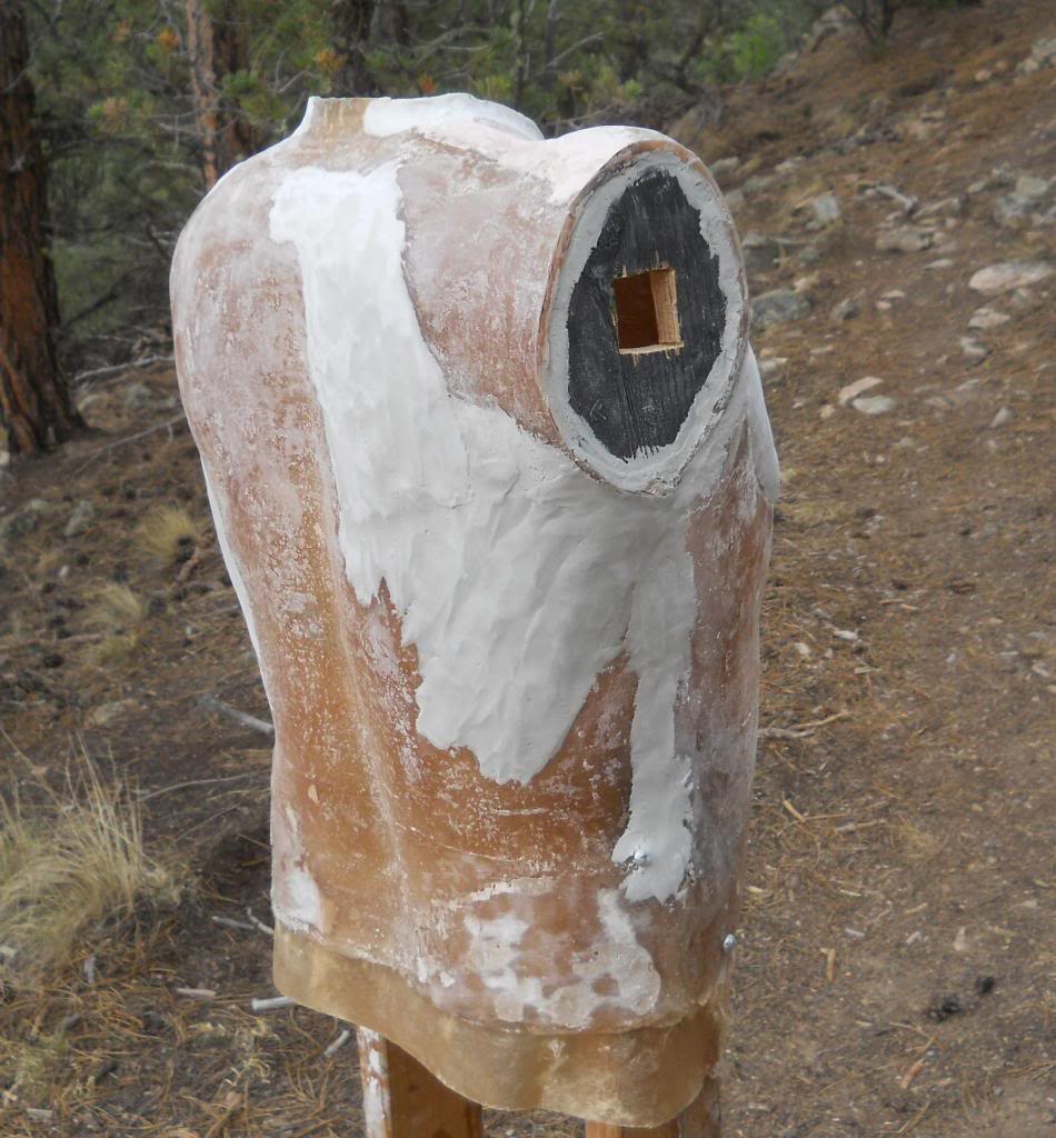

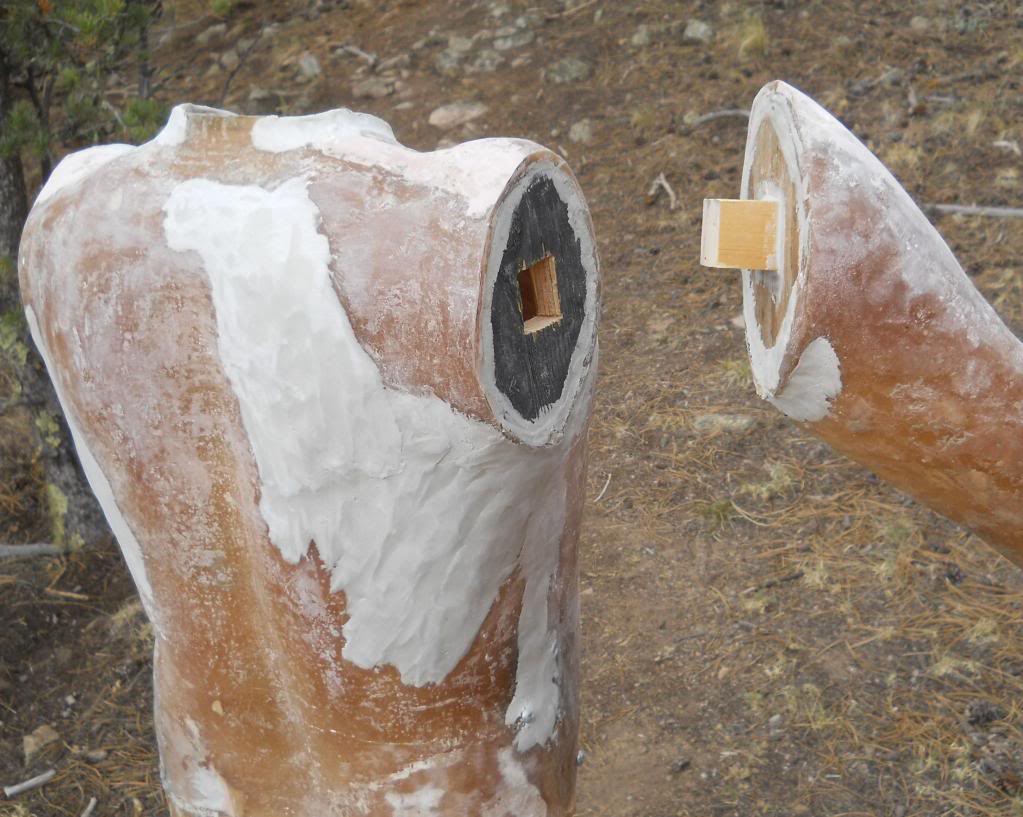

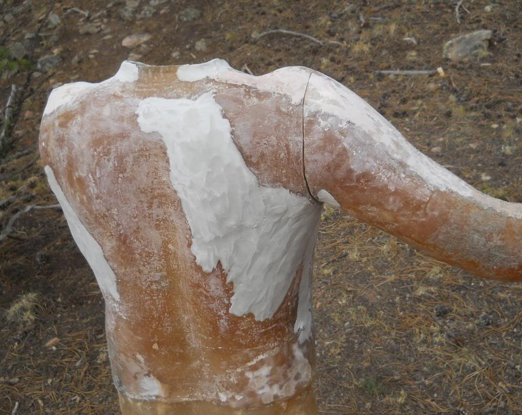

Making these torsos foam filled is a big process. I have been working on exactly how to do it, and i think i have come up with a way that should work out just fine. The first problem was that i needed to get the latex skin back on the torso, and the arms will not allow for this. So the arms had to be cut off. I put some lines on the should joint to make sure i could line it up again, and dremmeled them off. Next i cut 4 pieces of thick plywood the size of the holes left in the torso and inside the arm holes, and mounted them in with epoxy sculpt. Then i found a square board and cut it to lenth and put it through the piece in the arm and epoxied it all together. Then i lined it up with the torso and cut a hole for it to "latch" into. Now the arms where removable and easly re-attached. The next problem was that i have been working out alot since i took this torso mould and there were some deformations in the lifecast, so i had to do some more repair with epoxy sculpt. I think i need to even add a little more to be sure, but im going to try one and see how it works. Im going to flip the torso upside down and spot foam it as i roll it around. So the last problem was that i needed the neck to be tighter so the foam wouldent run out of the neckhole when its upside down, so i built that out with more epoxy and smoothed it up. I am going to test this out today if possible, i will have pictures up soon.

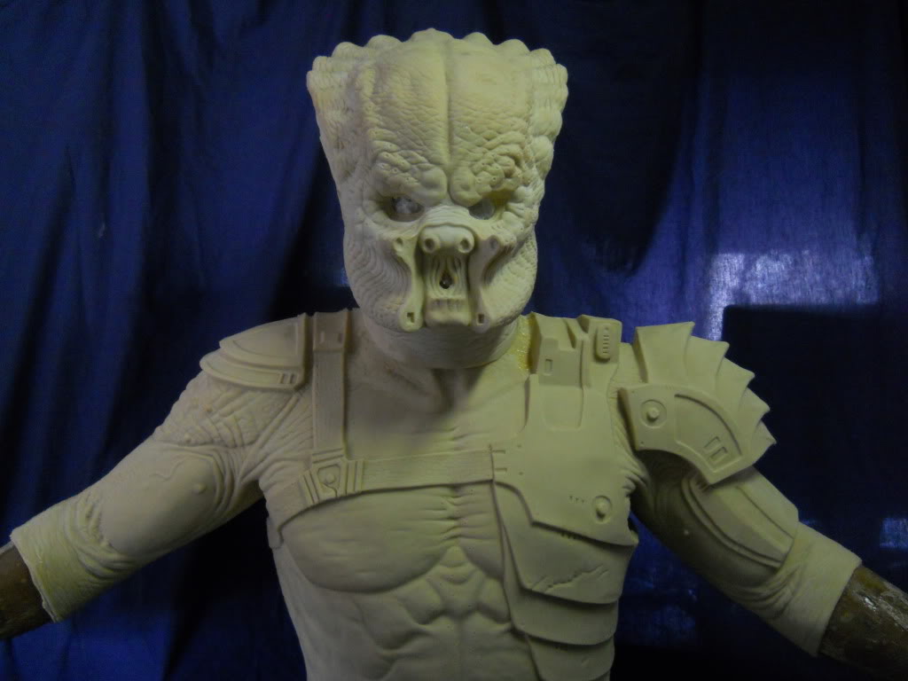

Hey sorry i missed your question, crystal clear is used to seal the clay before moulding. If just makes it easier to peel the clay out once your done. I dont have any pics of my tools at the moment but its a basic sculpting tool set, my favorite tool is just a squared off piece of wire attached to a handle, realy nice for smoothing. I am FINALY about to start a paintup on one of these, so i will have more pics soon. Thank you everyone for your comments!
