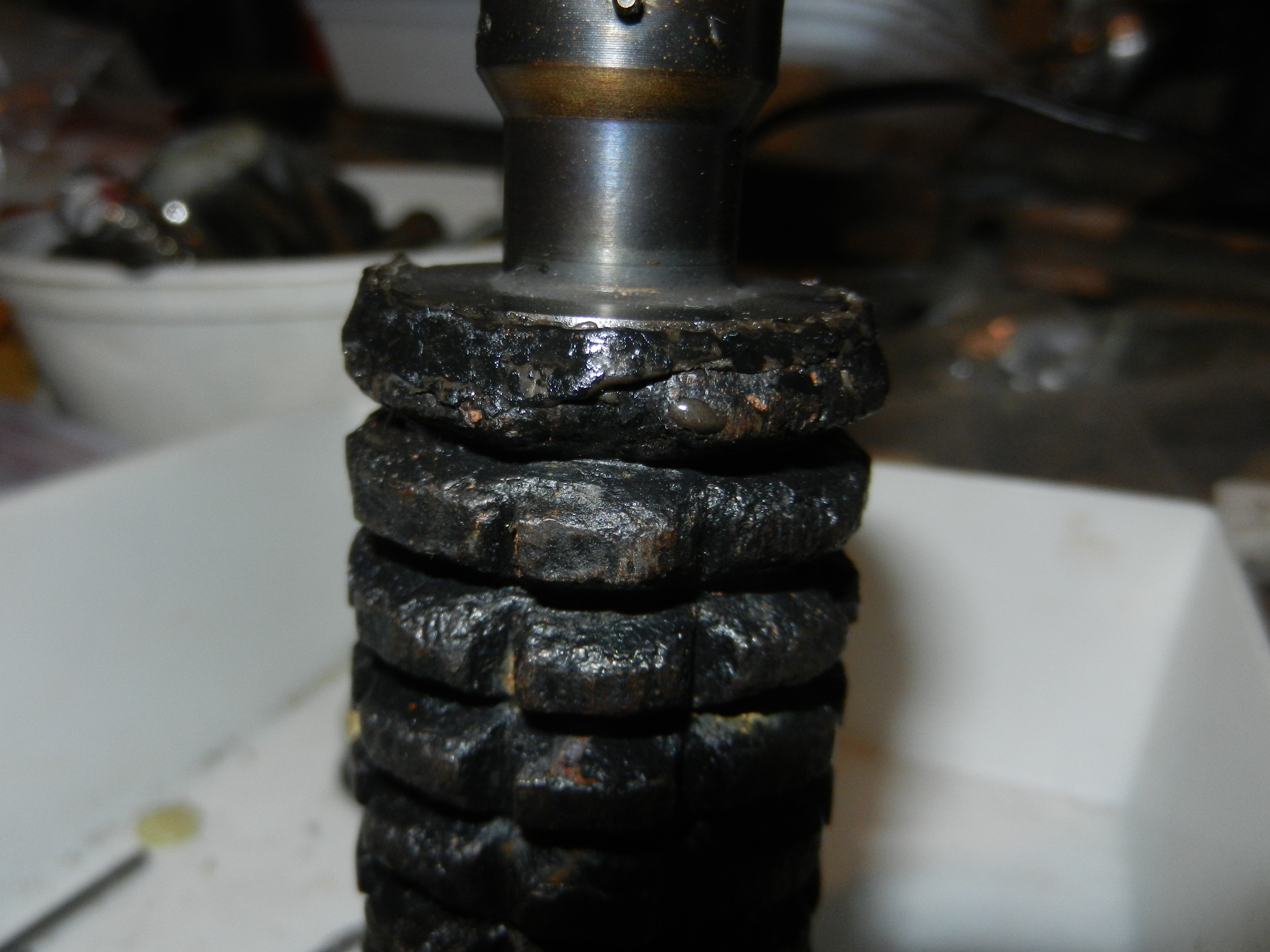

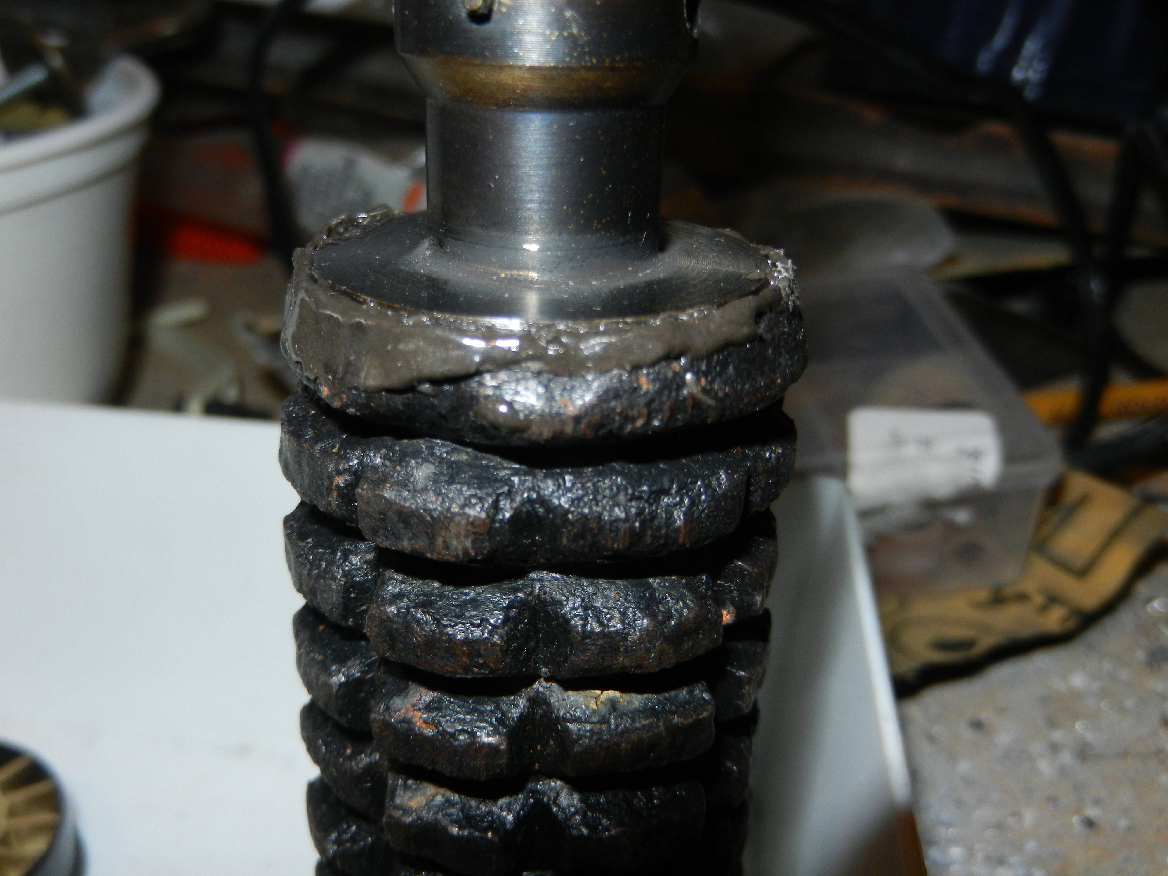

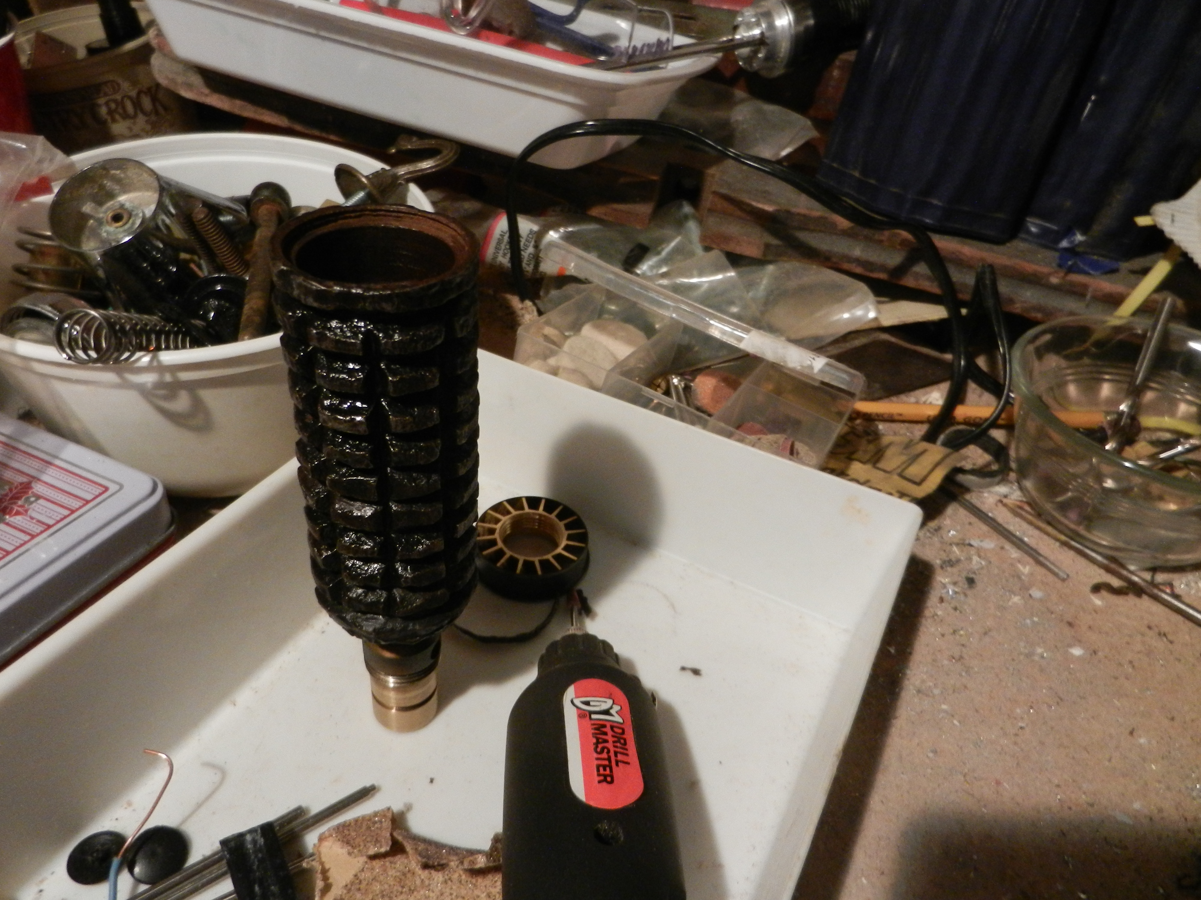

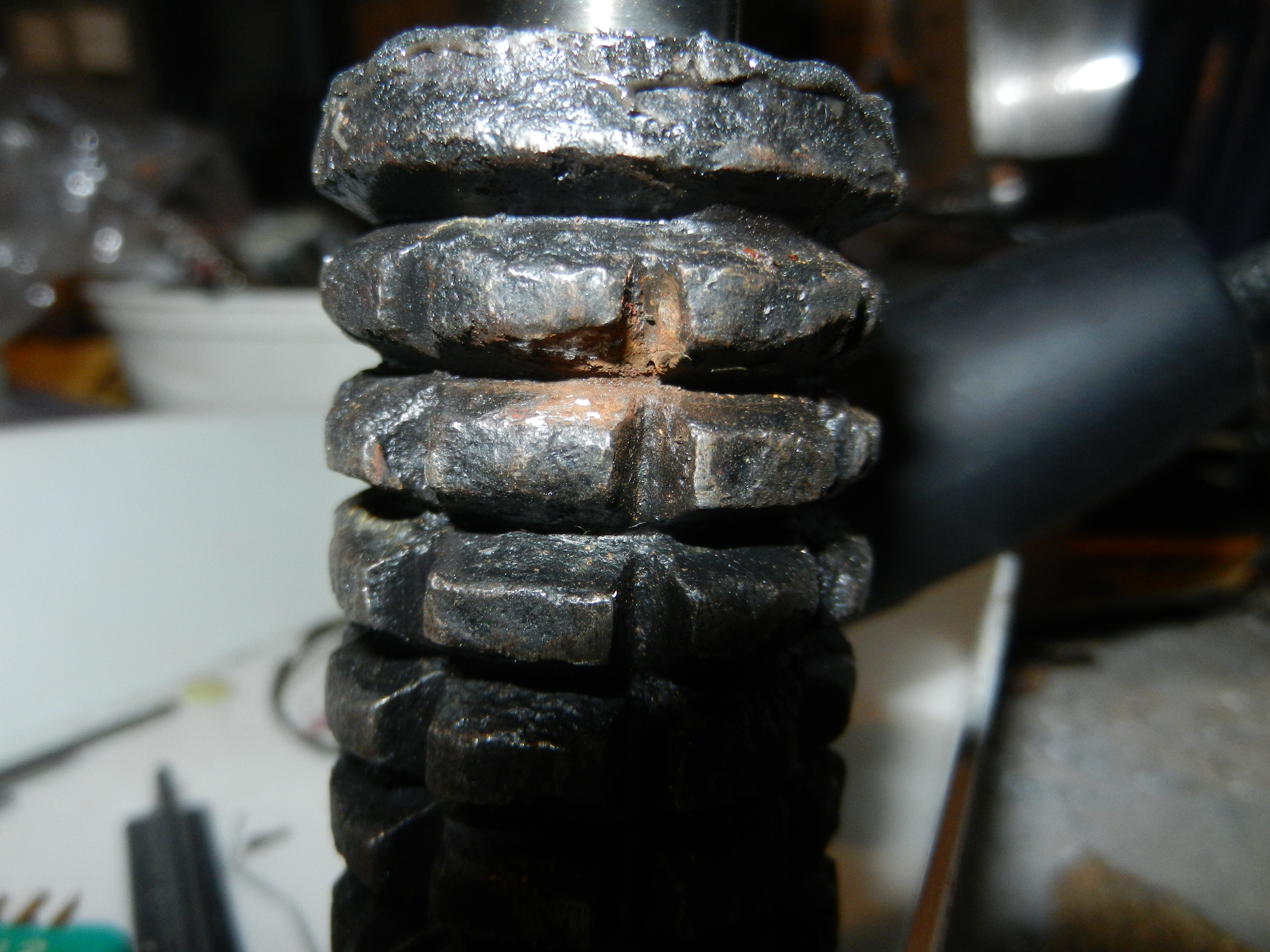

After re-doing the weld I actually welded the neck to the grenade. oops (technically that's not a big deal) but the weld isn't that noticeable. I took newspaper and dabbed some semi-gloss black paint on the grey weld to camouflage it some more. My grenade is very gray and metallic-y (and lumpy) so this seemed to work.
I also took a crappy pink grinding cone and attacked some of the rust. in taking it off, it seemed to spread! I think its just the rotary tool throwing rust - I hit it with a damp paper towel and that seemed to help. I dried the grenade over an open flame on my stove to avoid rust forming....left a tiny bit of rust for 2 reasons: weathering and avoiding bare patches of metal that would still look weird. I then hit it with a liberal amount of clear coat (I got excited)
pics to come!
I got pics of every step but after I stopped removing rust, and then the clear coat drying..

You are a beast, man! Great job on the rebuild. Again, the patch/rebuild is very intimidating.
I did pick up a JB Weld liquid steel putty stick for mine. The fluidity of the one you got scared me (I have learned that I don't handle certain material too well heh heh)..I'll let you know how it goes.
I can only hope the repair I do is in the same ballpark as yours.
Gosh, thanks Andy! yea, I haven't used a stick before and I'm VERY interested in how that pans out. Especially for grenades in good shape, you need a smooth surface if you're going to patch it. I also originally imagined wiping away the excess and just leaving putty in the holes but that's how Apoxie sculpt works. Not JB Weld *sigh*
I'm watching the clear coat dry. Since it's flat (there was only gloss, flat and satin and gloss usually looks cheap) the grenade isn't as shiny but "gun metal-y"Tthe whole thing looks like one solid relic!

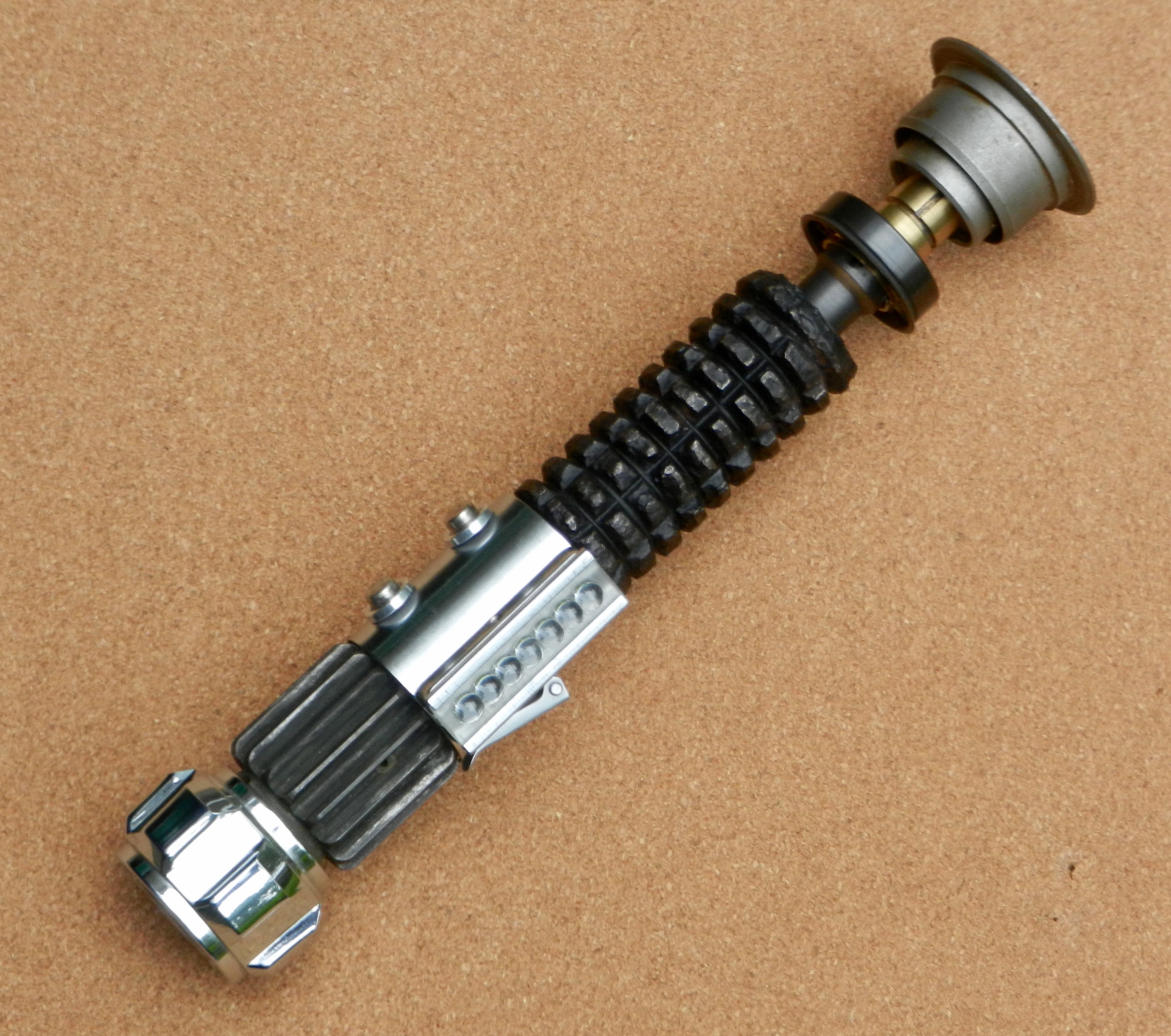

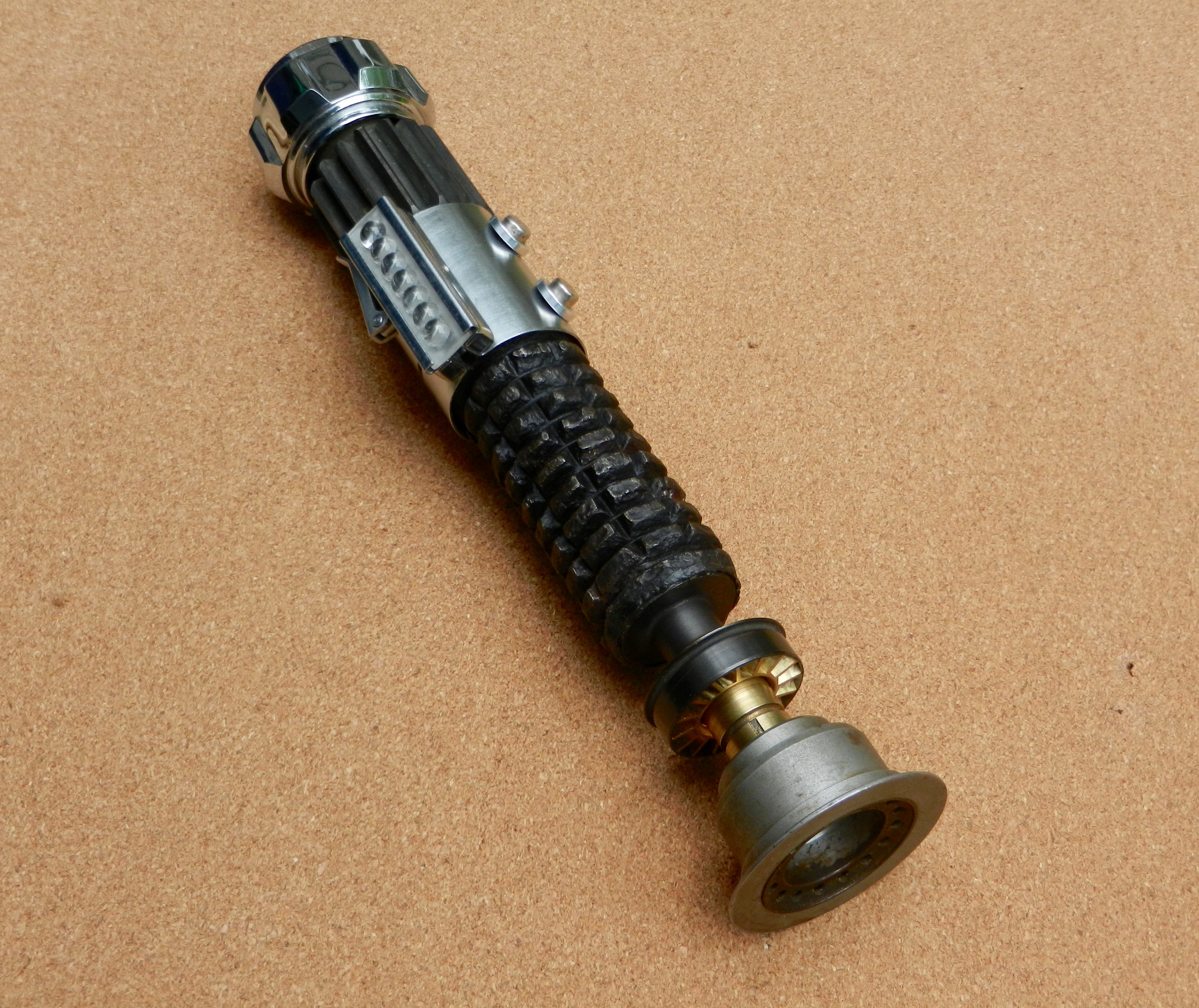

here are some beauty shots with a modern handwheel, @RomansEmpire booster, clamp spacer, transistors and grenade neck, A real Graflex clamp, Exactra 20 bubbles, Motorola M series amplifiers, British Hales frag body and that ol' balance pipe replica!

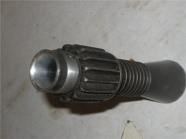

Well, everyone, I now have re-chromed sink knobs and I found a real Browning Flash Hider, booster attached.
I'm not sure if it has a separate bearing or not, still finalizing the transaction, however this means some structural changes.

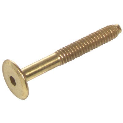

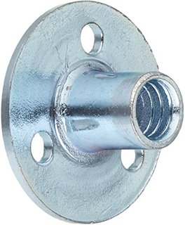

I used a brass "cabinet" allen screw to affix the pommel to the booster. Its head is very flat, something I was looking for in case I add a cap, and there's a T nut and washer bracing it inside, facing it. (opposite the direction of the photo)
Now, the question is how do I bolt the booster, clamp and grenade together easiest and cheapest....
