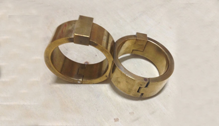

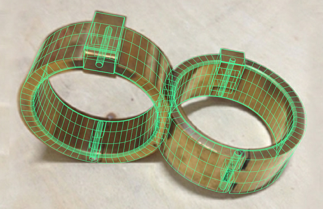

The 3D model and plans
We have blueprints that were sold a Propstore a while back, they don't include measurements and are not 100% faithful to the final objects, but they are a very good indication and something that we don't normally have!
I first modeled a basic version of the handcuffs based on the blueprint, then I added the photo of the handcuffs into the sofware and tried to match the perspective as best as I could, to then refine the 3D model based on the details on the real prop. I also used the other photos that are in the French book for more details.
from this I edited a machining plan :)

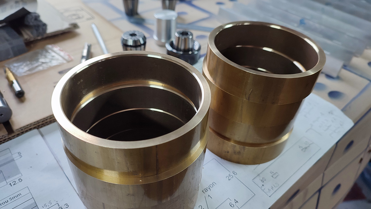

And I lathed the front and back of each ring.
Then, I needed to do that inner bevel on each side of the rings and this is were another issue surfaced that bugged me for a while!
Brass tubes are extruded and this one being pretty big on top of that, well, it's not perfect. Normally, you'll take the material and machine it to final specs, you don't really care if the material is slightly uneven. In this case, I want to keep the material raw and I don't want to remove thickness, and sadly, the material being uneven, I tried every way possible in the lathe but the bevel would always come out very unconsistent. You would get a 2mm radius on a short length and then the bevel would be almost 0 next to it, it was awful!
DAMNIT!
so... well I really tried everything I could on the lathe. chucked the part from the inside or from the ouside, tried to add tape on one side to try to make the rings turn perfectly, but nothing would do.

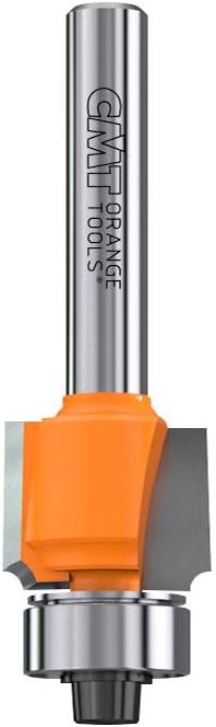

So, I resulted to using my good old guitar making techniques and said to myself, I'll use my wood router for this with a quarter circle bit and ball bearing.
things never go as planned, so I ordered a first one that ended up too big and finally ordered the good size.
this is what I'm talking about:
it has a ball bearing of the exact size of the bottom of the shape, the router will make the bit turn and the ball bearing will follow the shape of the part you are milling and not turn. if that makes sense!
the thing is, the second one I received, well, the ball bearing didn't turn at all... not normal! I ended up managing to disassemble it and it turn out the washer you can see on the photo right on top of the ball bearing, well, it was upside down with the step on top and it was locking the ball bearing! crazy to see slightly expensive factory tool come with a part upside down! it worked perfectly after this was corrected.

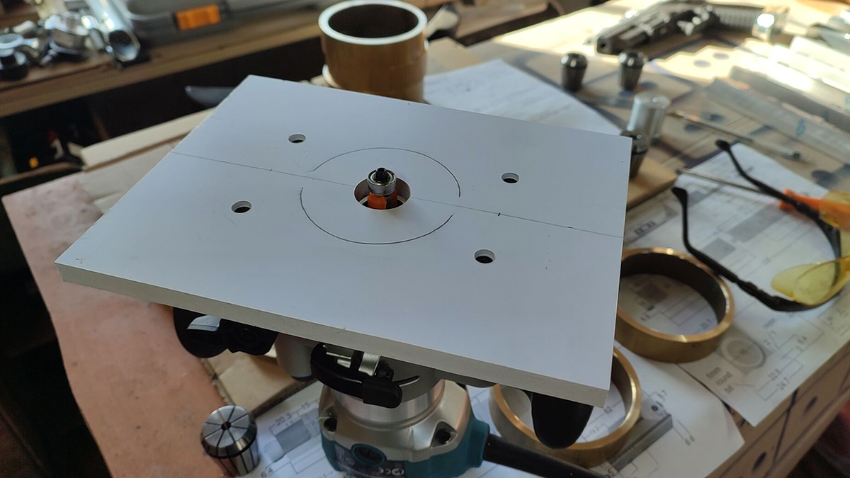

I'm using a small makita router for this, it's a small one but I really love this one! however, I made a first test and it wasn't perfect with the small base of the router, so I made a larger base with a smaller hole in the center so everything would be more stable :)

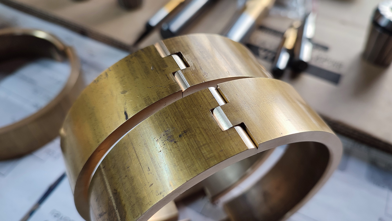

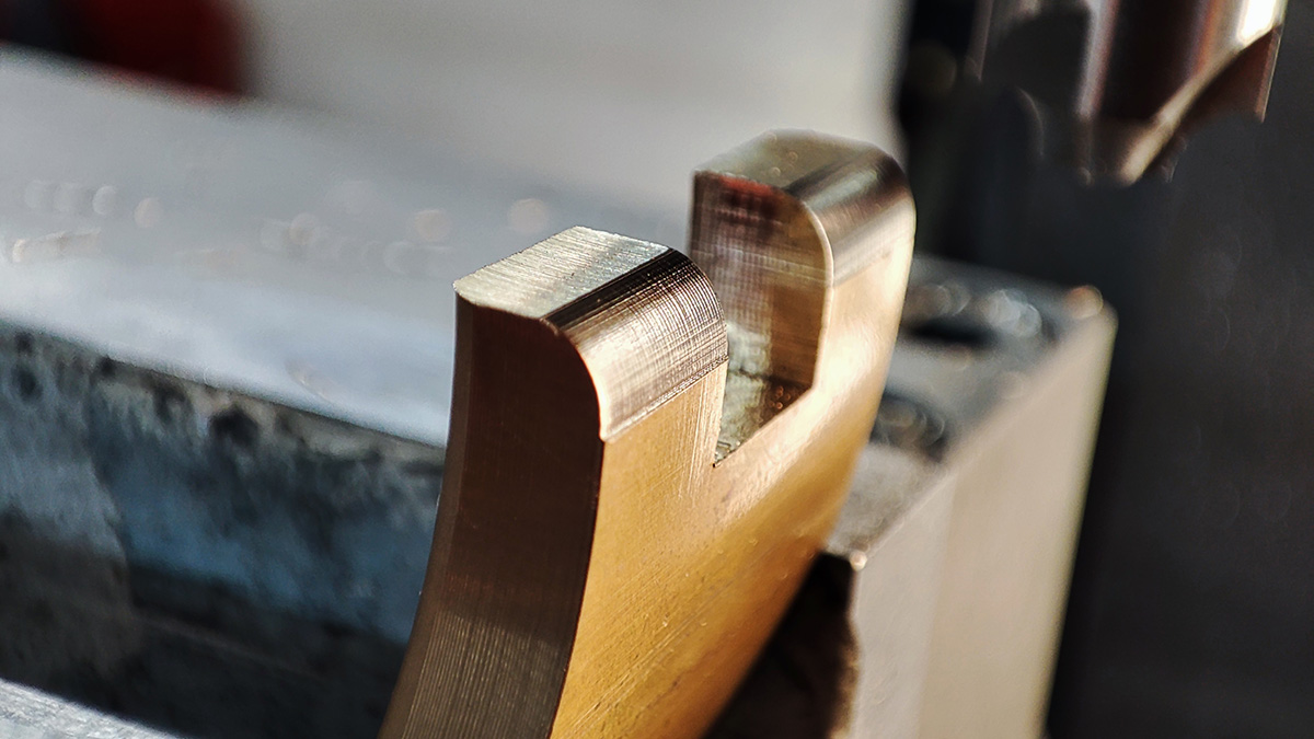

I machined the flat junction spots:
I also did an aluminium prototype clasp part. I don't have brass available for this for the proto, so I'm only doing one out of aluminium to count my time. They will of course be brass for the run.
I'm loosing steam a bit for the end! Struggling a bit with the hinges axis and figuring out if I can use the leftover brass cuts for the Leia size, tough project! Starting to look cool though I think :)
cheers all :)

one difficulty with this project is that there are no refs of how the cuffs are attached together.
I'm thinking of using two brass screws to try to keep things discrete. I don't see any evidence of brazing and it would prove a bit annoying to do as well.
Let me know if you guys think of anything or have anything to say against brass screws.
