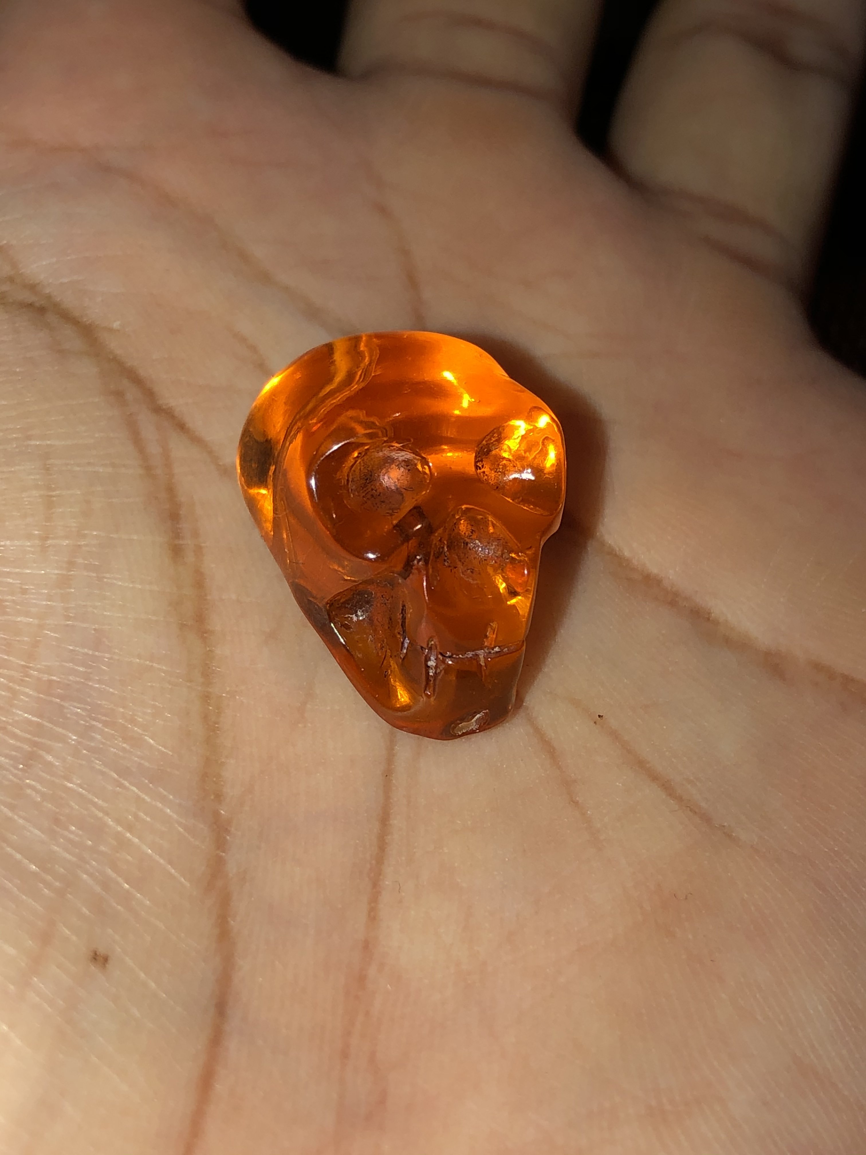

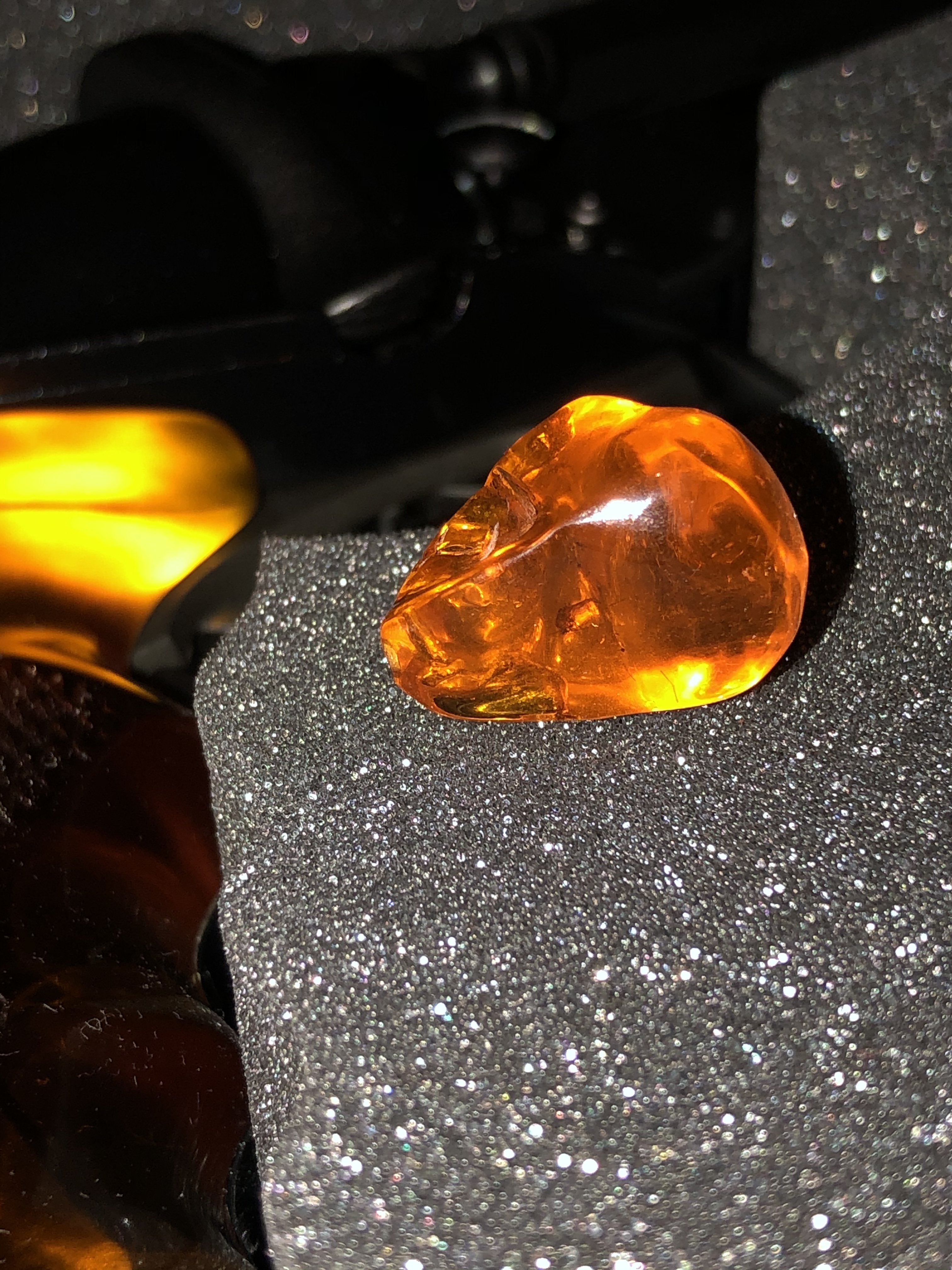

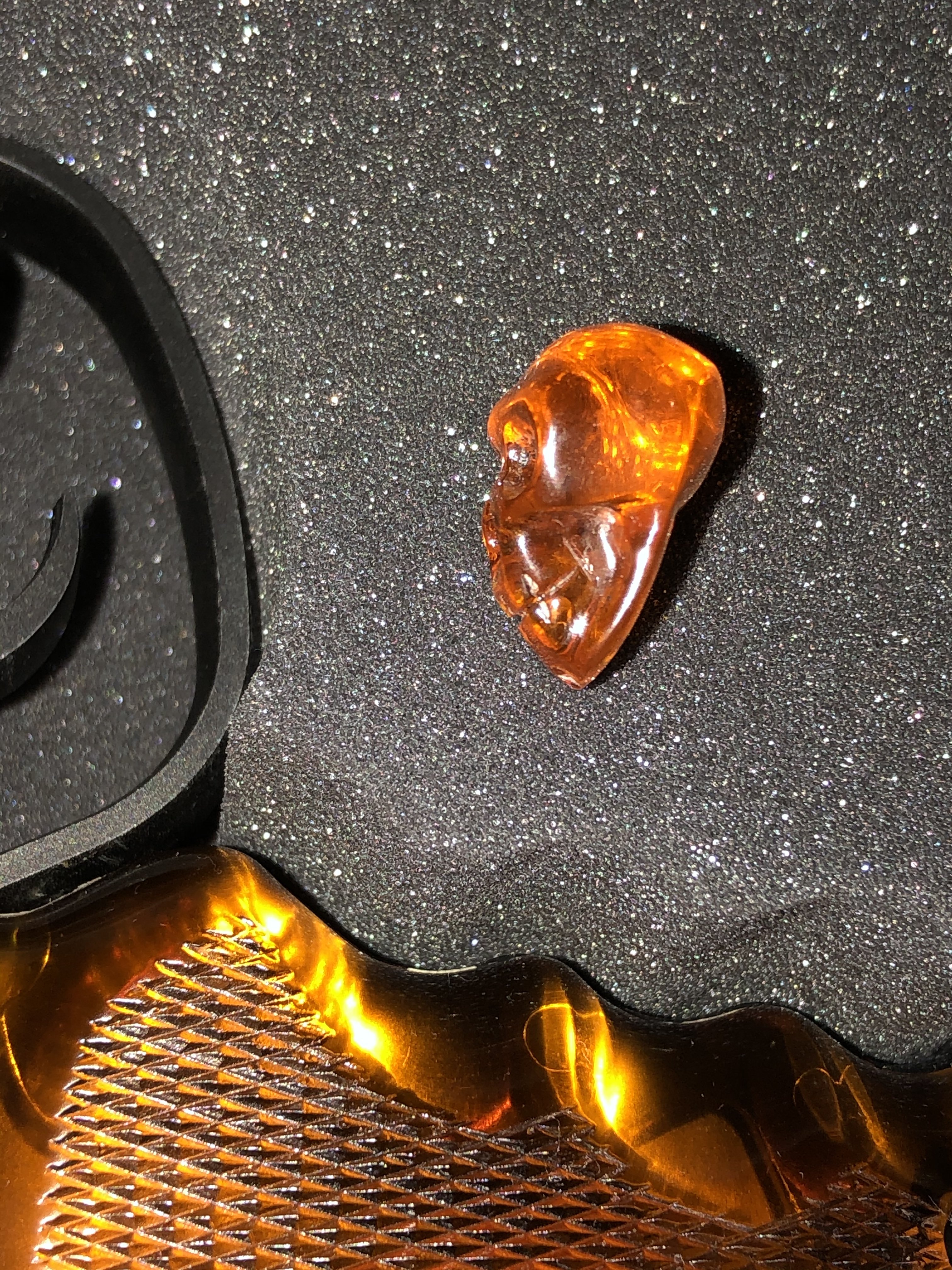

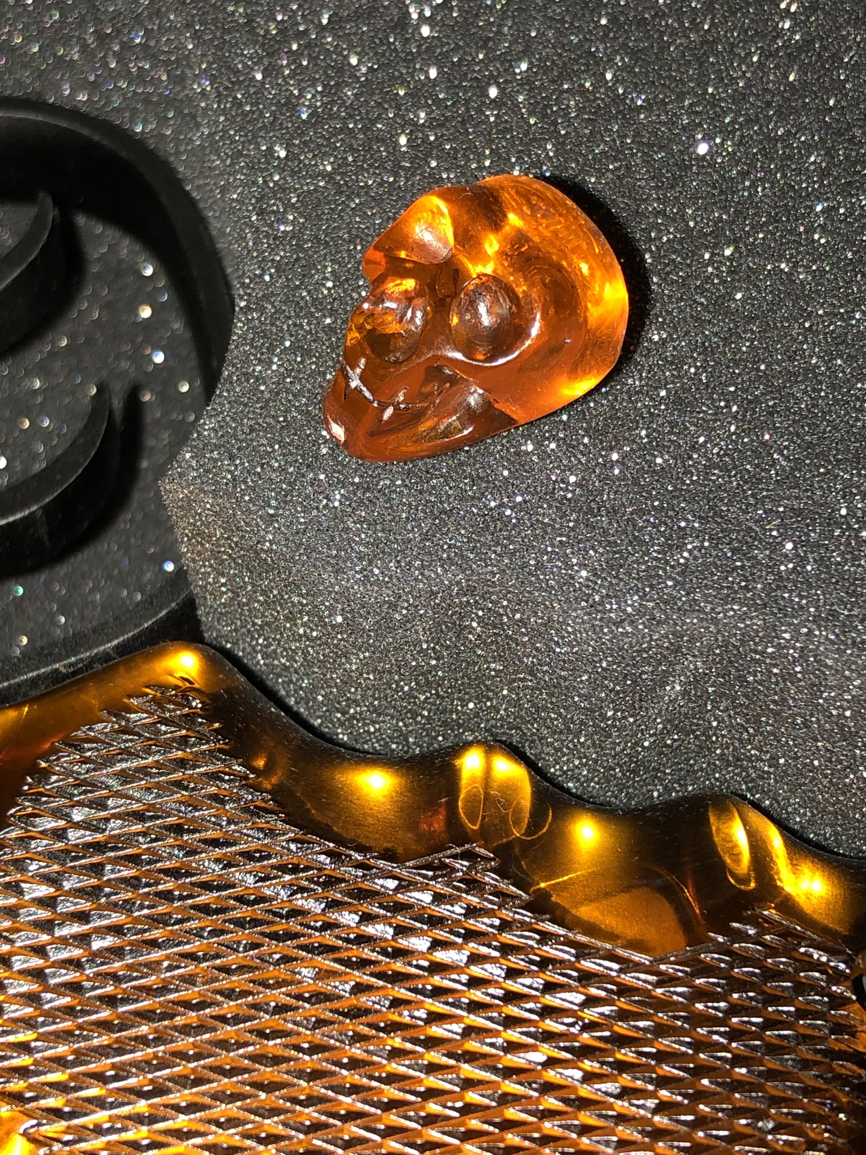

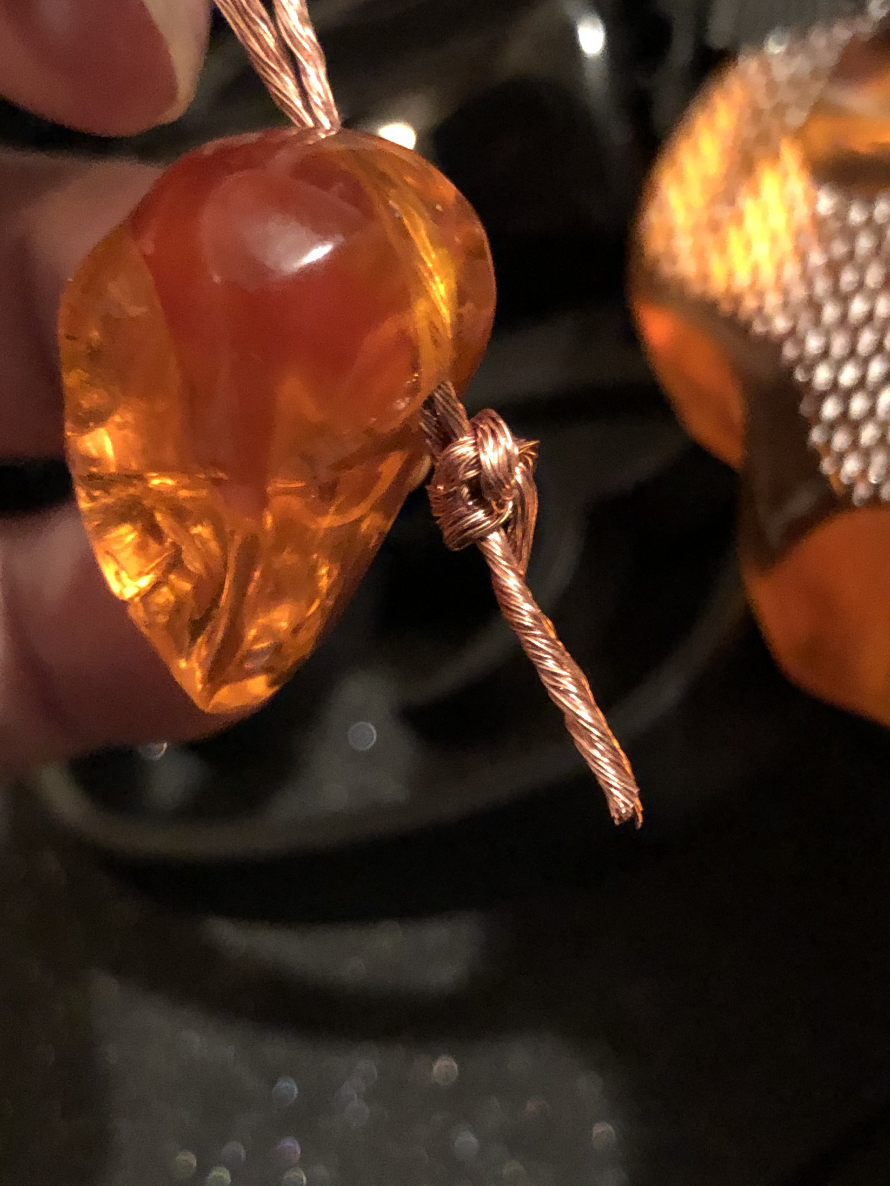

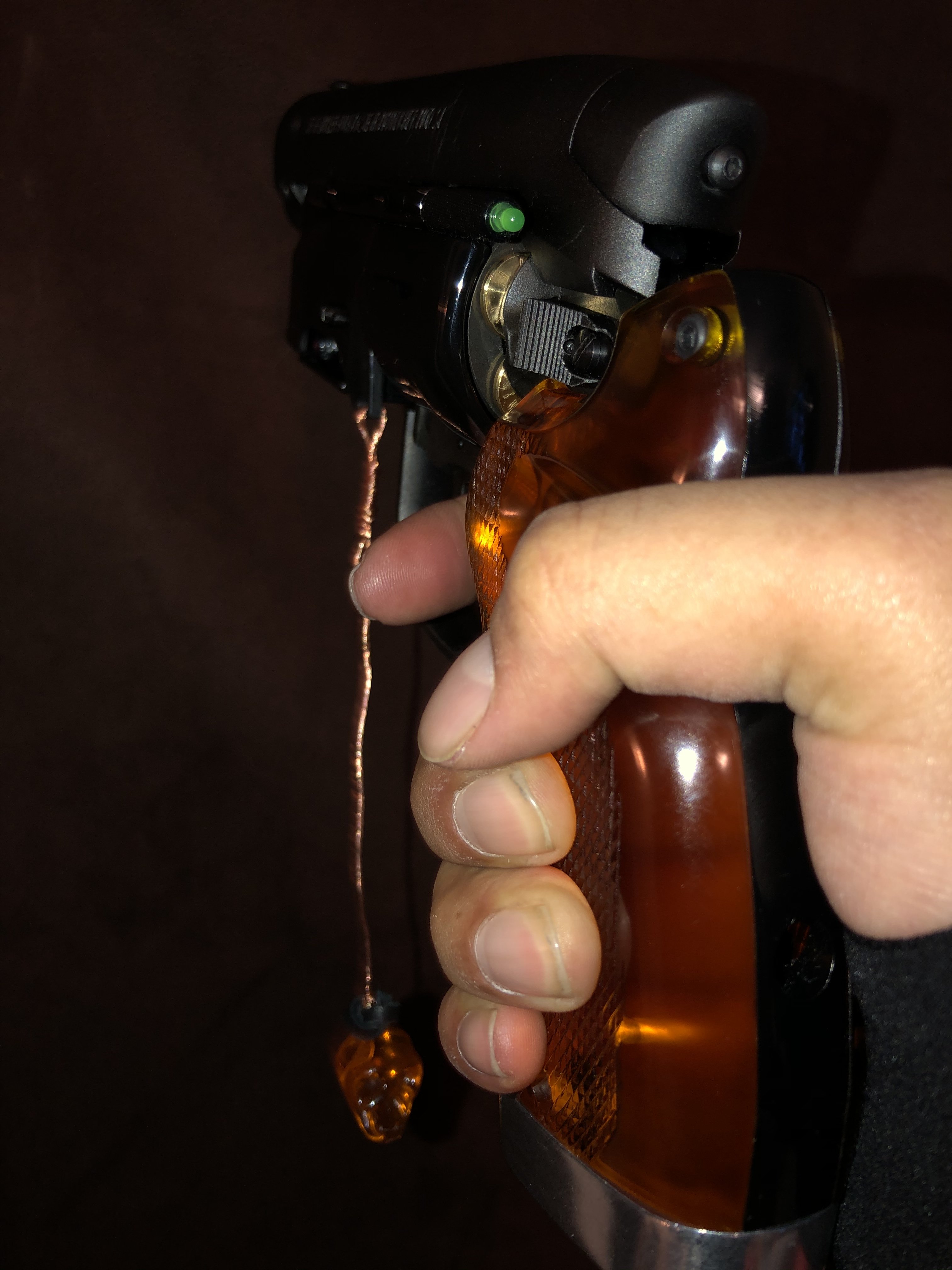

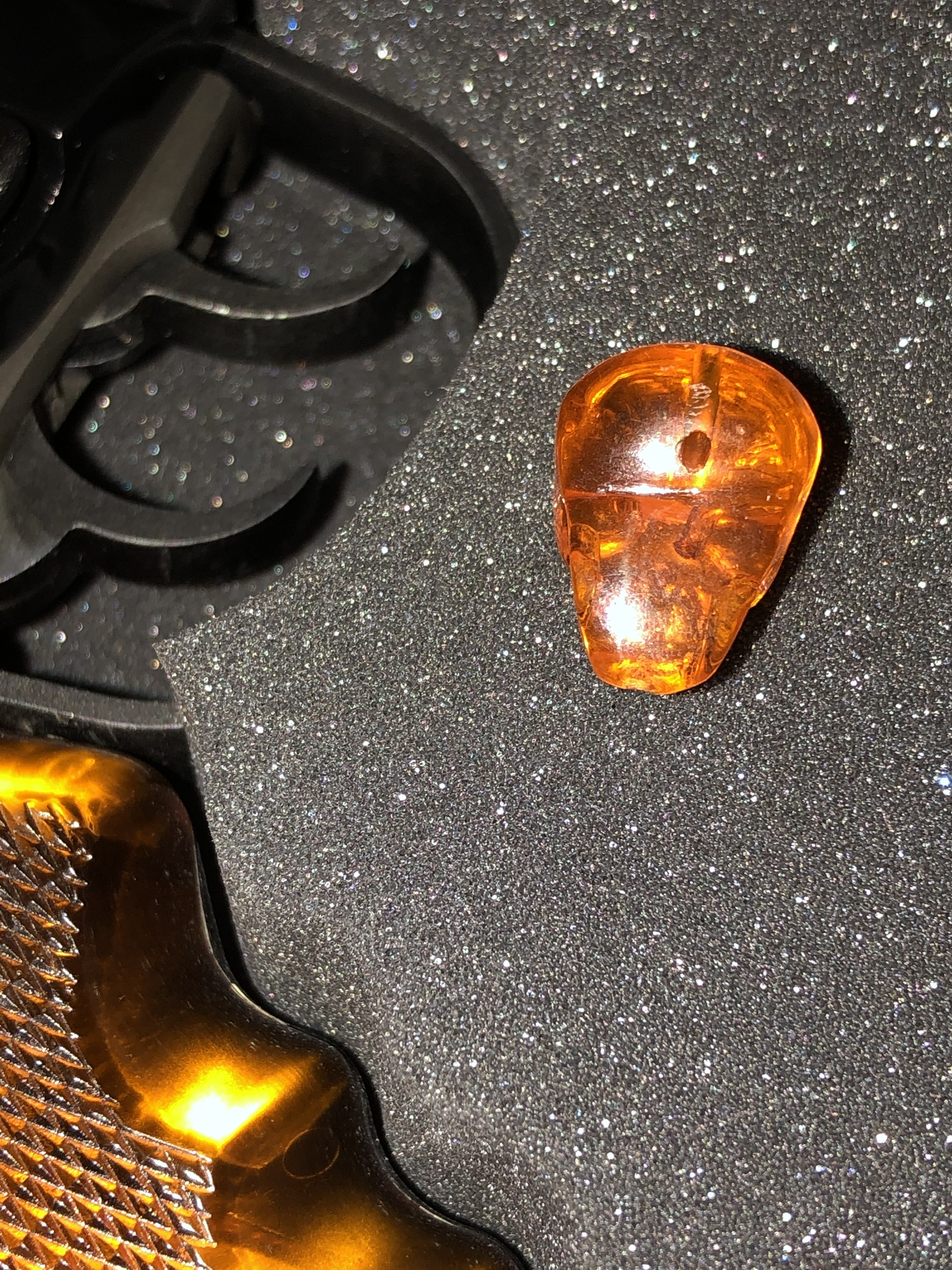

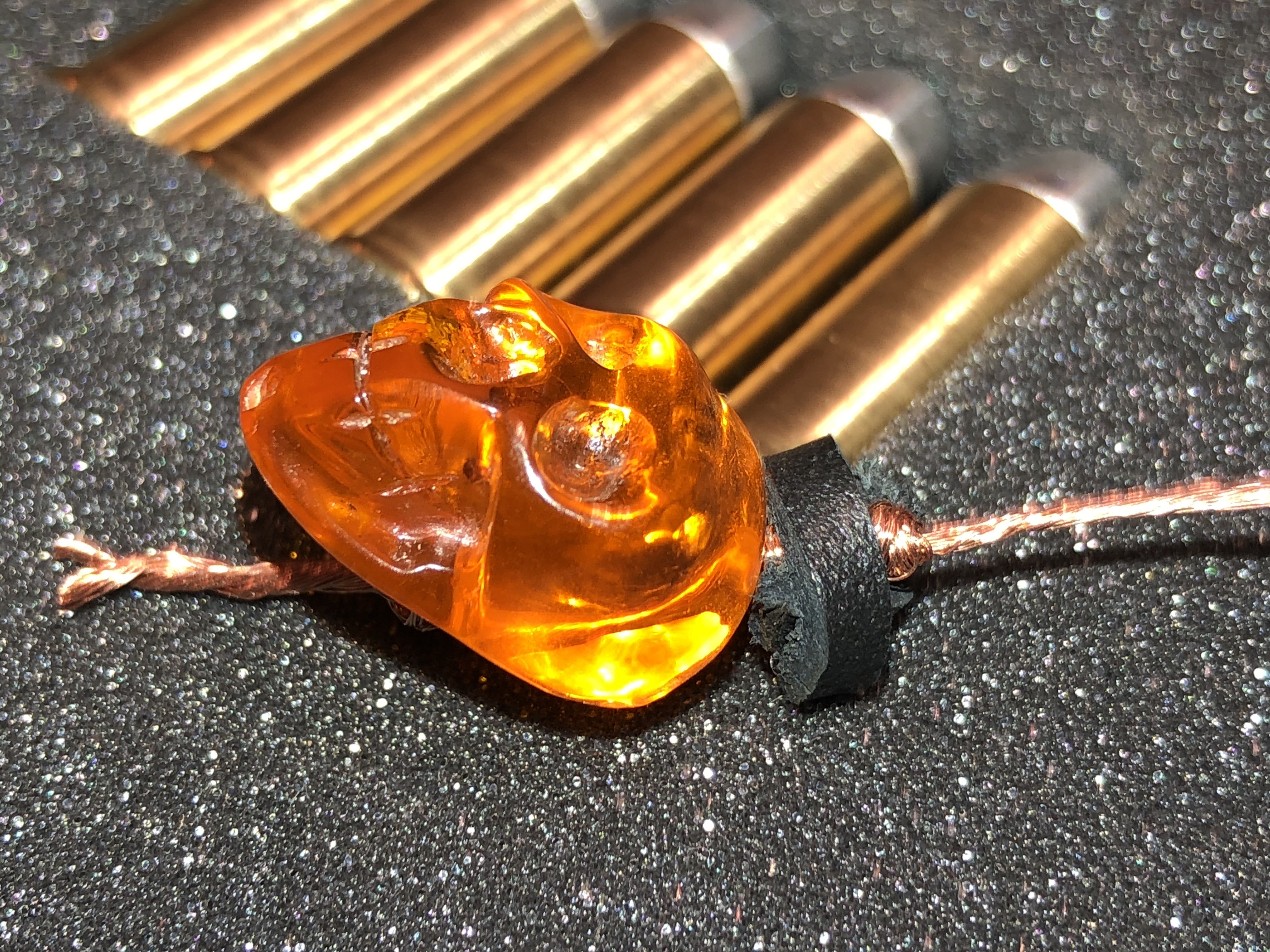

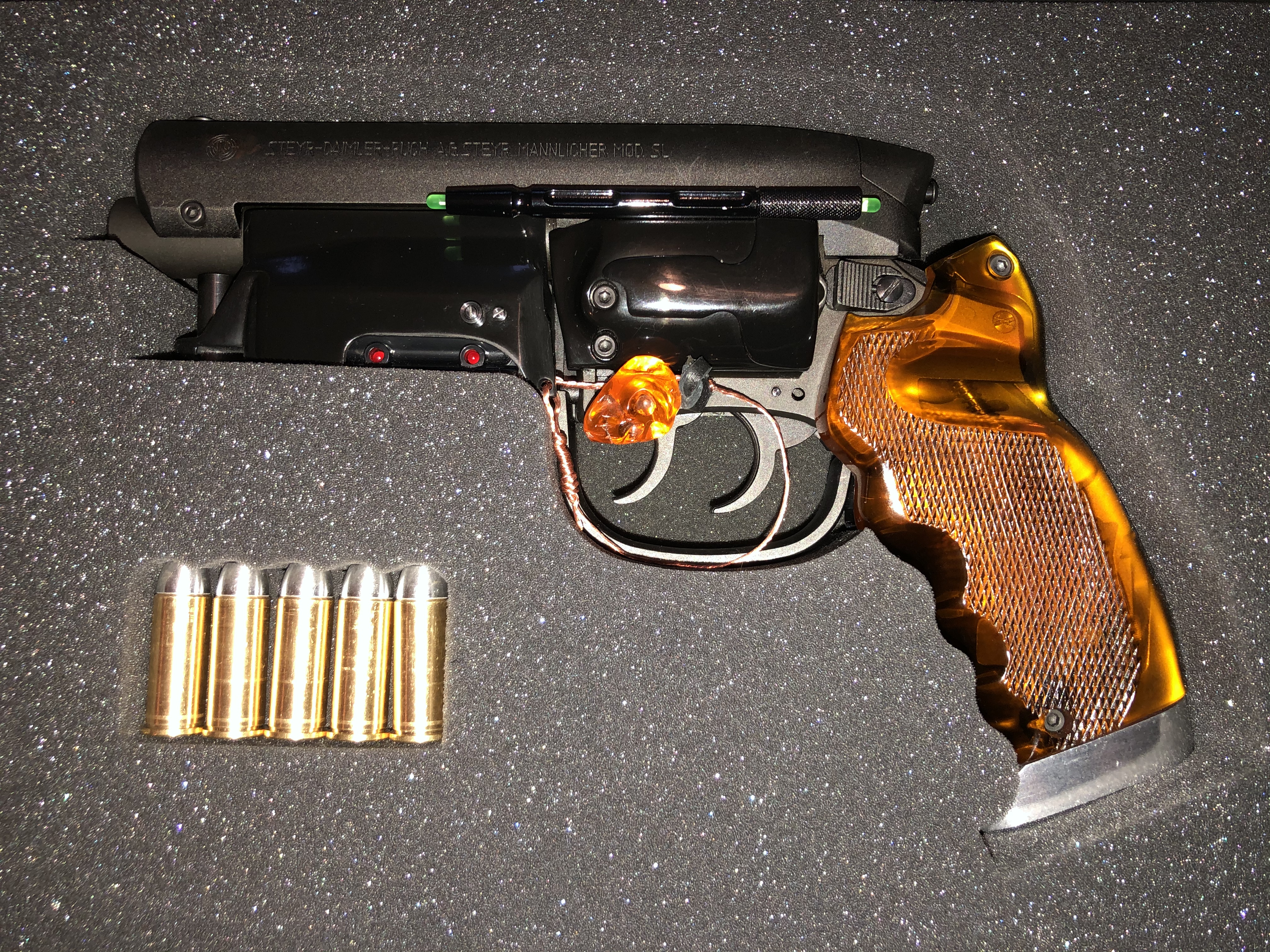

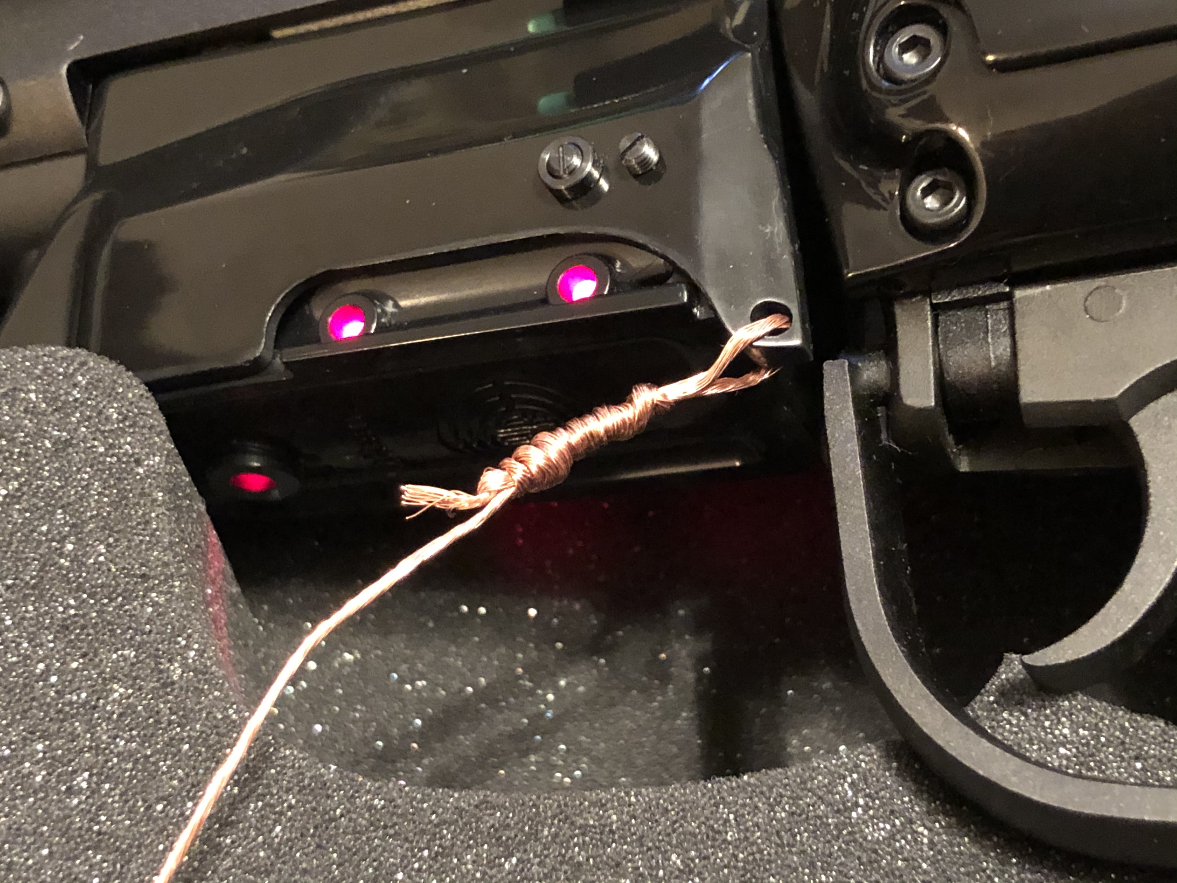

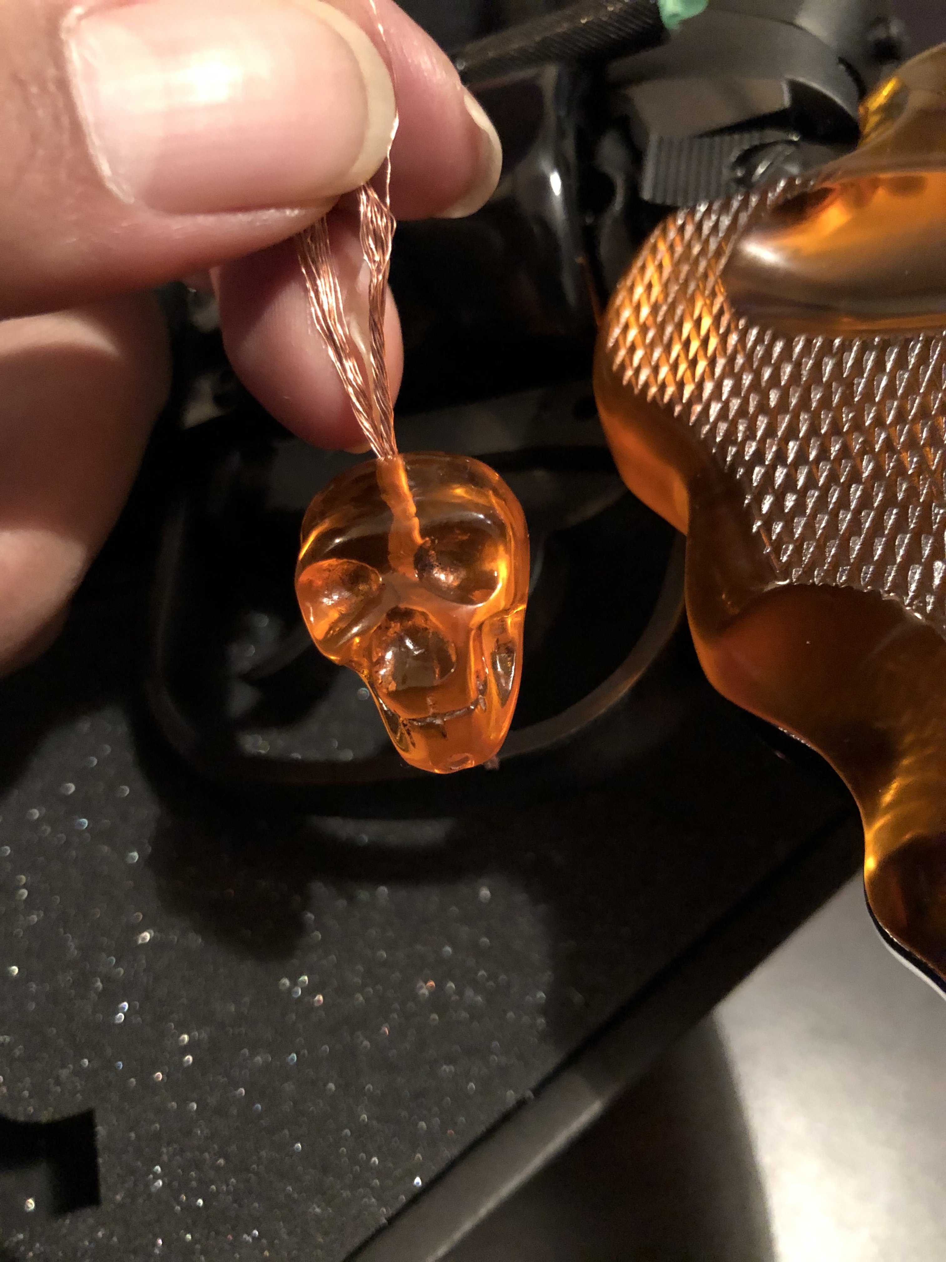

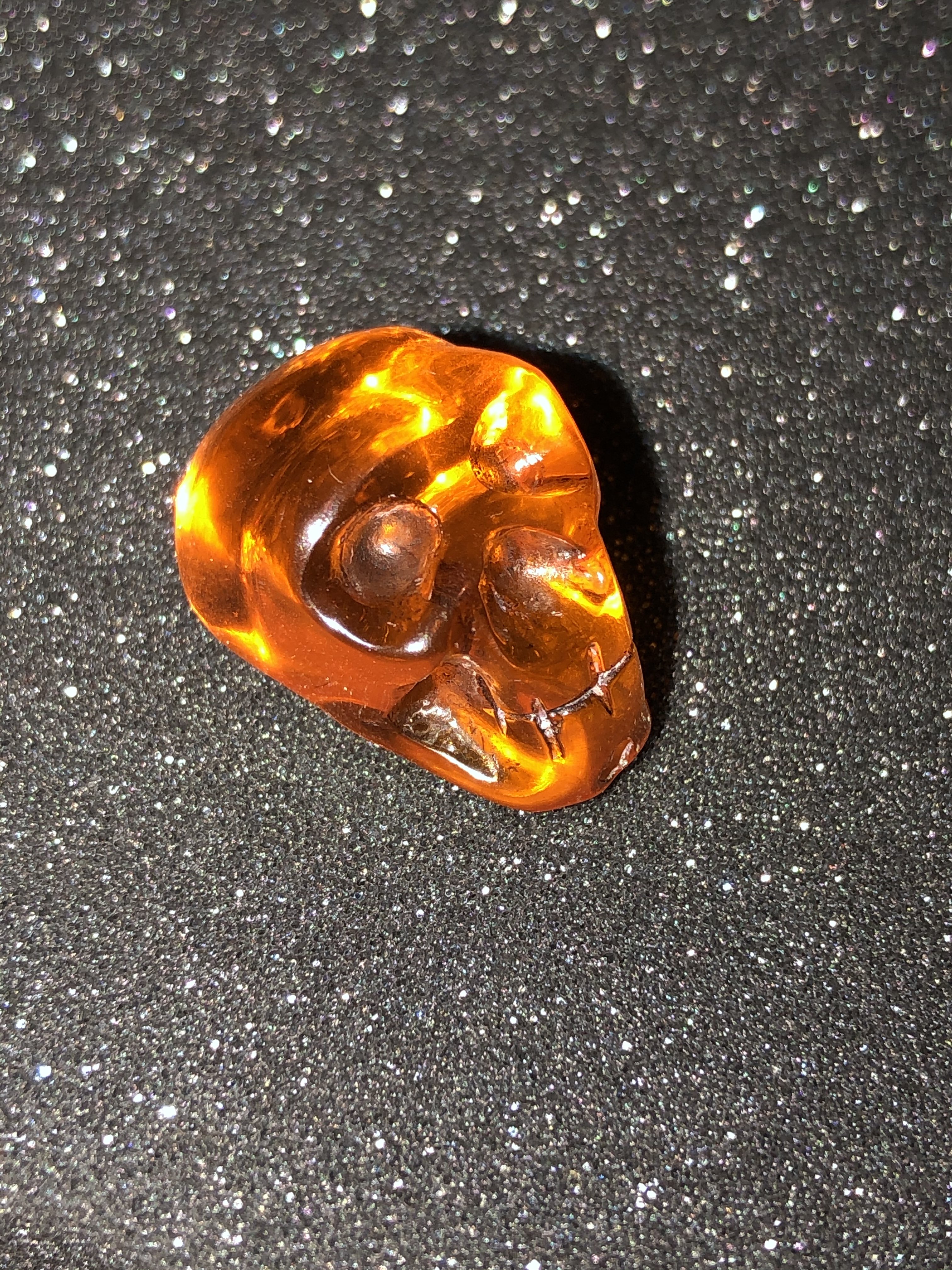

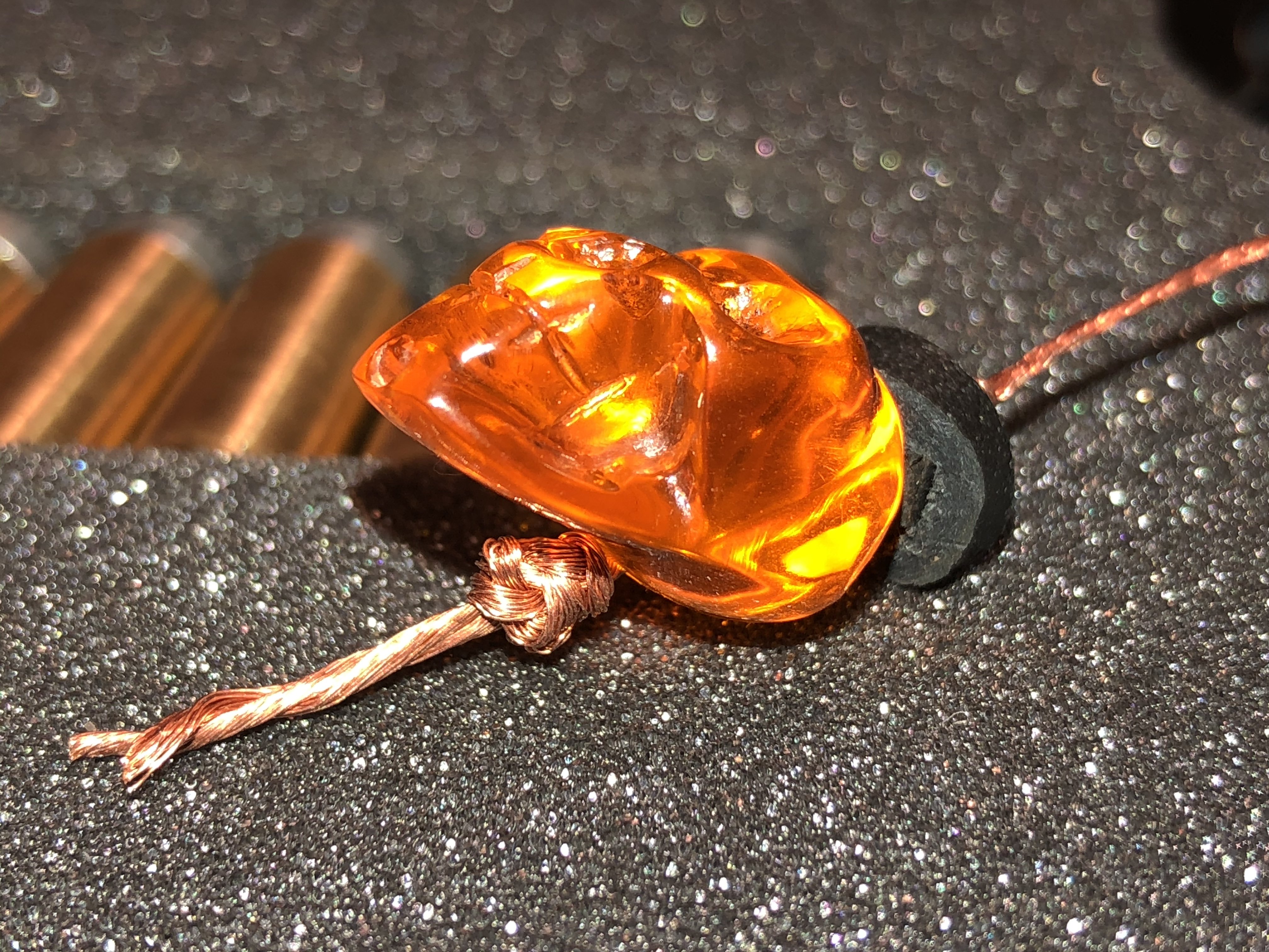

Got me an Amber skull Ojime (bead) from Japan with a mosquito in it. I got it to hang from the Blaster as a an ornament. Although I had to drill through it to make holes, which I wish it was made with because I am no professional with tools, but thank God I got a steady hand. I’m currently destroying my fingers twisting up some copper wire for the Ojime to hang from. Will update when finished but here is some before and after drilling, my small but painful progress with the wire (the knot was the worst, I was trying for a diamond knot but I’m sure I failed lol), and close ups of the ‘Squitor.
Edit: last 2 pics gave the Ojime a quick polish with olive oil before tying it all together

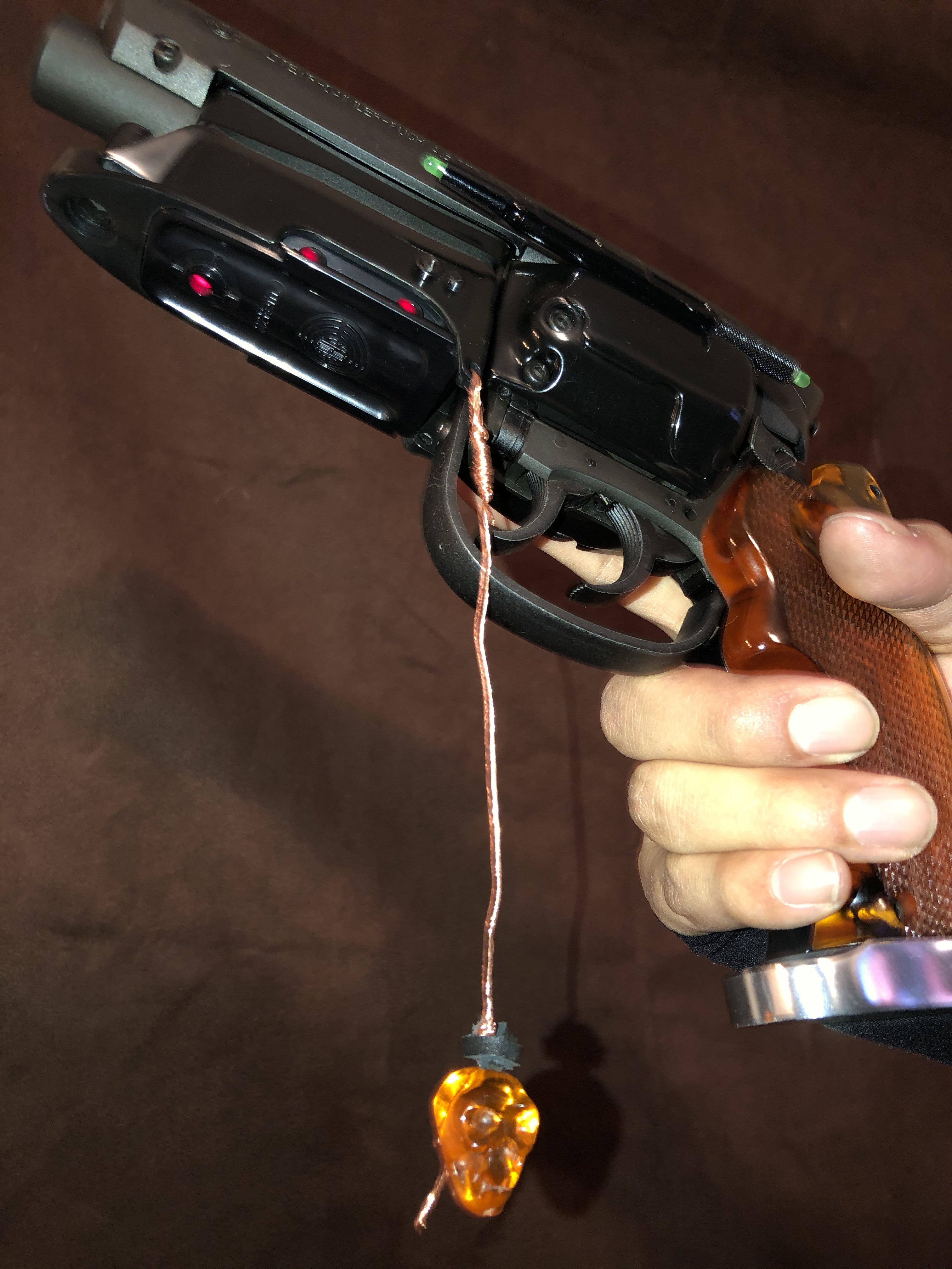

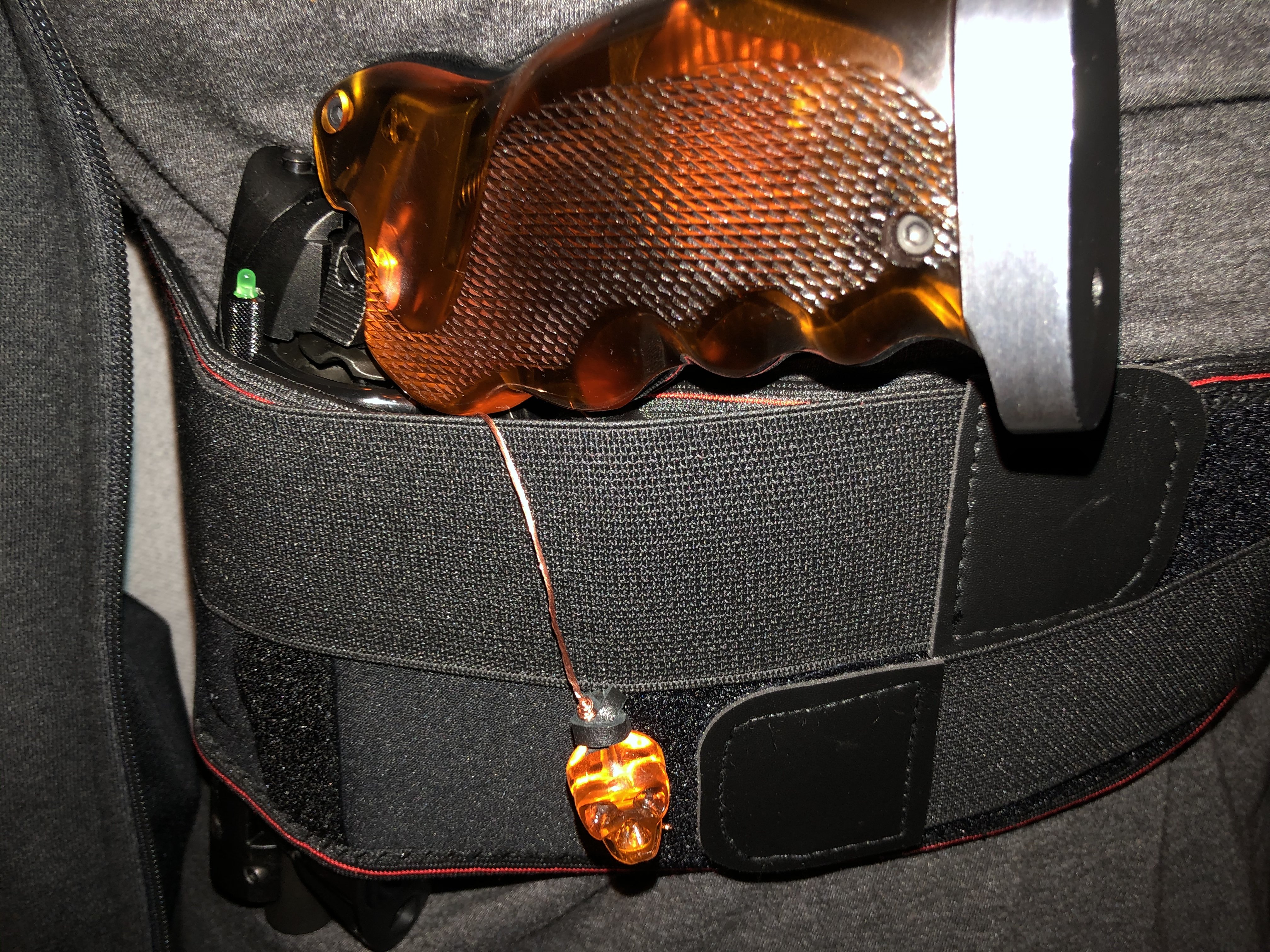

Even works with holster or back brace! I recommend tying it to the same side as your dominant hand so it will holster and hang properly.
Below the skull I tried a diamond knot. Above the skull was an ugly normal knot so I cover it with a strip of leather, normal knot. A hangman’s noose to secure it to the Blaster. And the copper is just from an old wire I stripped, I cut off about a foot and carefully divided the lot of wire in half and twisted the half’s individually and then twisted them together. Most of it turned into to practice and redo material and then I only ended up only using the 2 strands for securing the skull and then I cut off the remainder of 1 strand because it would’ve been too thick and stiff to hang like string.

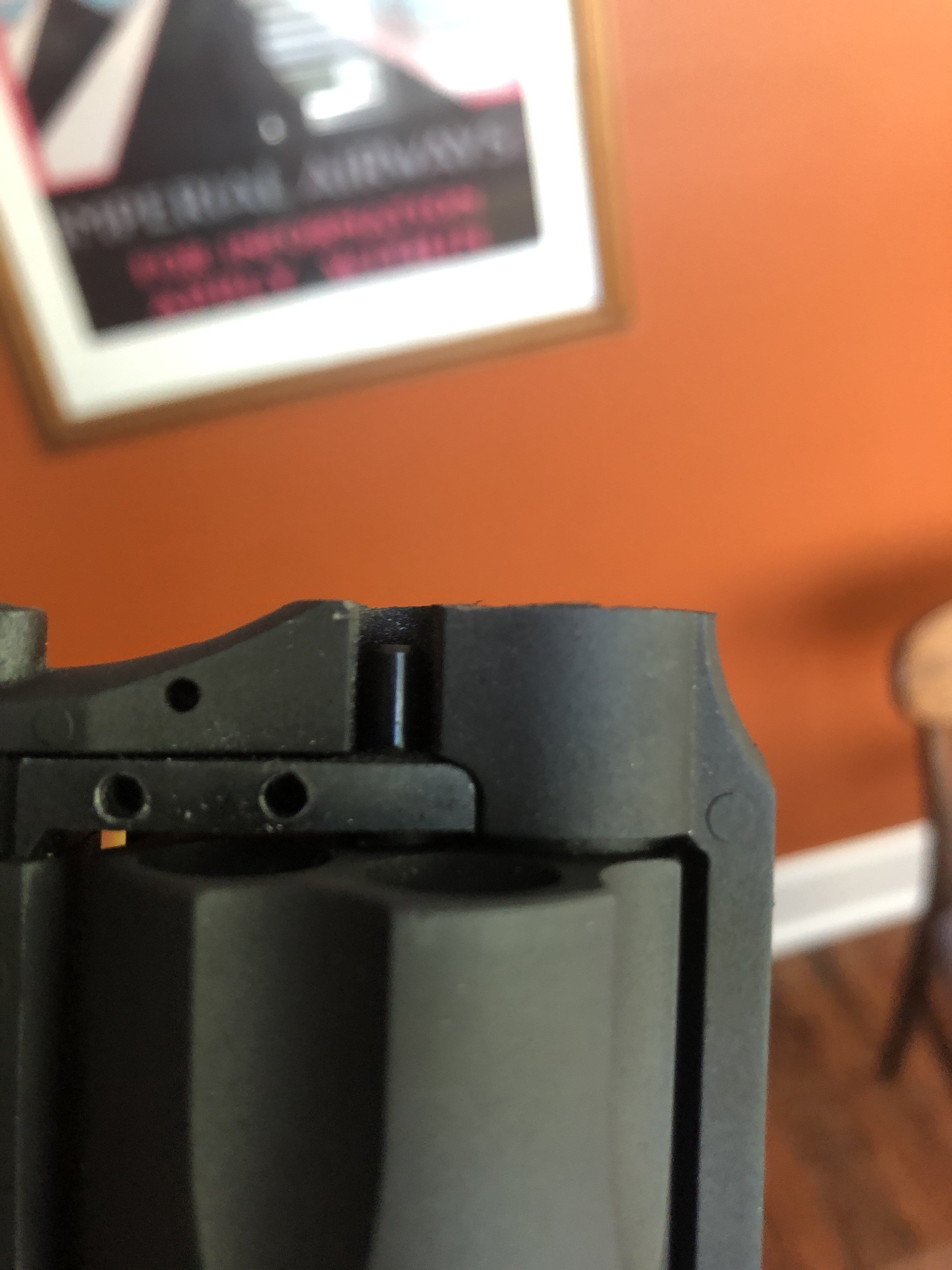

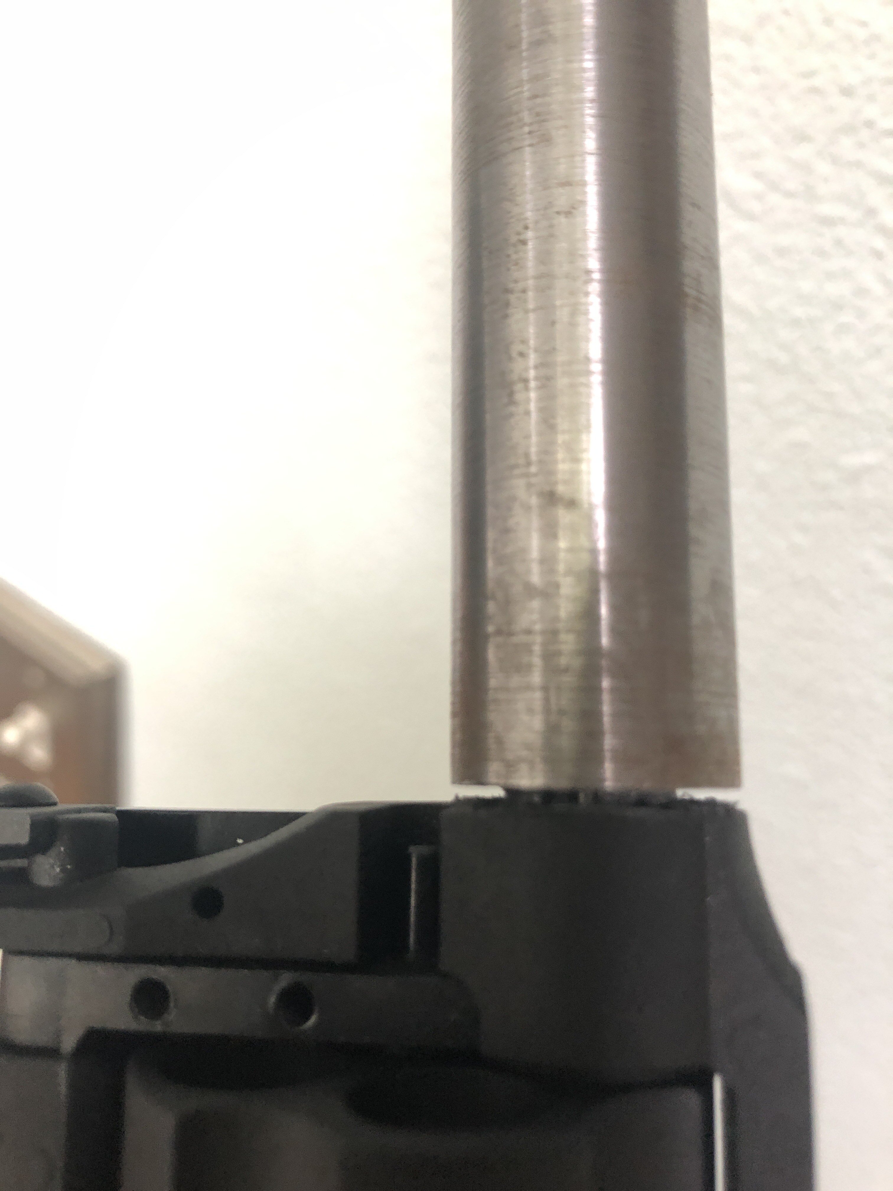

Has anyone had trouble with the replacement steel barrel? I cut and filed down the plastic barrel and metal and there's about a 1-2mm gap between the barrel and the revolver frame. Trying to figure out how to rectify this. Everything else is such a tight fit so it really needs to be snug to work properly.
Mine is flush, maybe you removed too much material from the frame.
A pics would help us to see the problem.
I think there must have been material left in the cavity that I didn't see. The barrel is a really tight fit (so much so that I'm going to need to hit it with wd-40 to attempt to pry it out.) I'm worried I really messed this up somehow.
Maybe there was some kind of deburingg to do on your barrel before installing it.
I manually sanded my barrels to insure everything went smooth.
Maybe plastic is to blame here too, because the edge of the frame is not really clean. You can see some left over shavings.
WD-40 or gun oil could help indeed.
Thanks for the guidance!
I was able to pry the barrel off with some leverage using a screw driver, and cleaned up the edge with a metal file. Can't recommend using one of those highly enough. Seems to have worked pretty well, though it's still a tight fit so I'm going to hit it with wd-40 before fitting the barrel in.
Incidentally, the metal file seems to do a decent job of weathering the plastic, so I may try to mark up the cylinder a bit as a finishing touch.

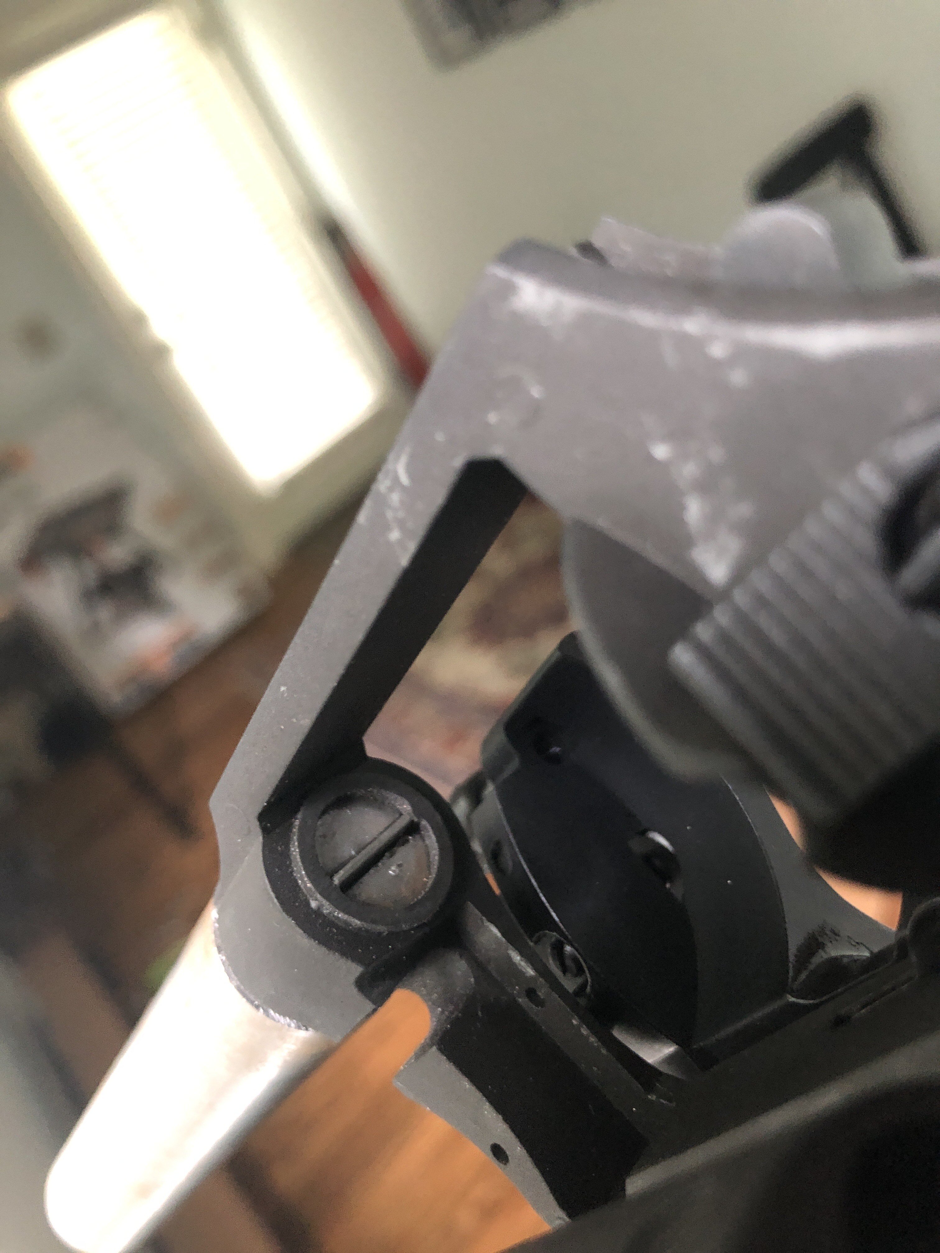

Not sure if this will be helpful for anyone, but I noticed that my cylinder was sticking a bit when I pulled the trigger. I realized that I had tightened the screw that keeps the right panel on a little too tightly. The one just to the right of the trigger, left of the receiver arm. When I loosened it, the trigger pulled easily and cylinder turned smoothly again.
