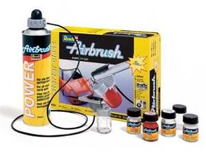

Personally I would spray it as it will be streaky if you brush it. They may sell this in a spray form but if not, use a cheap airbrush kit.
