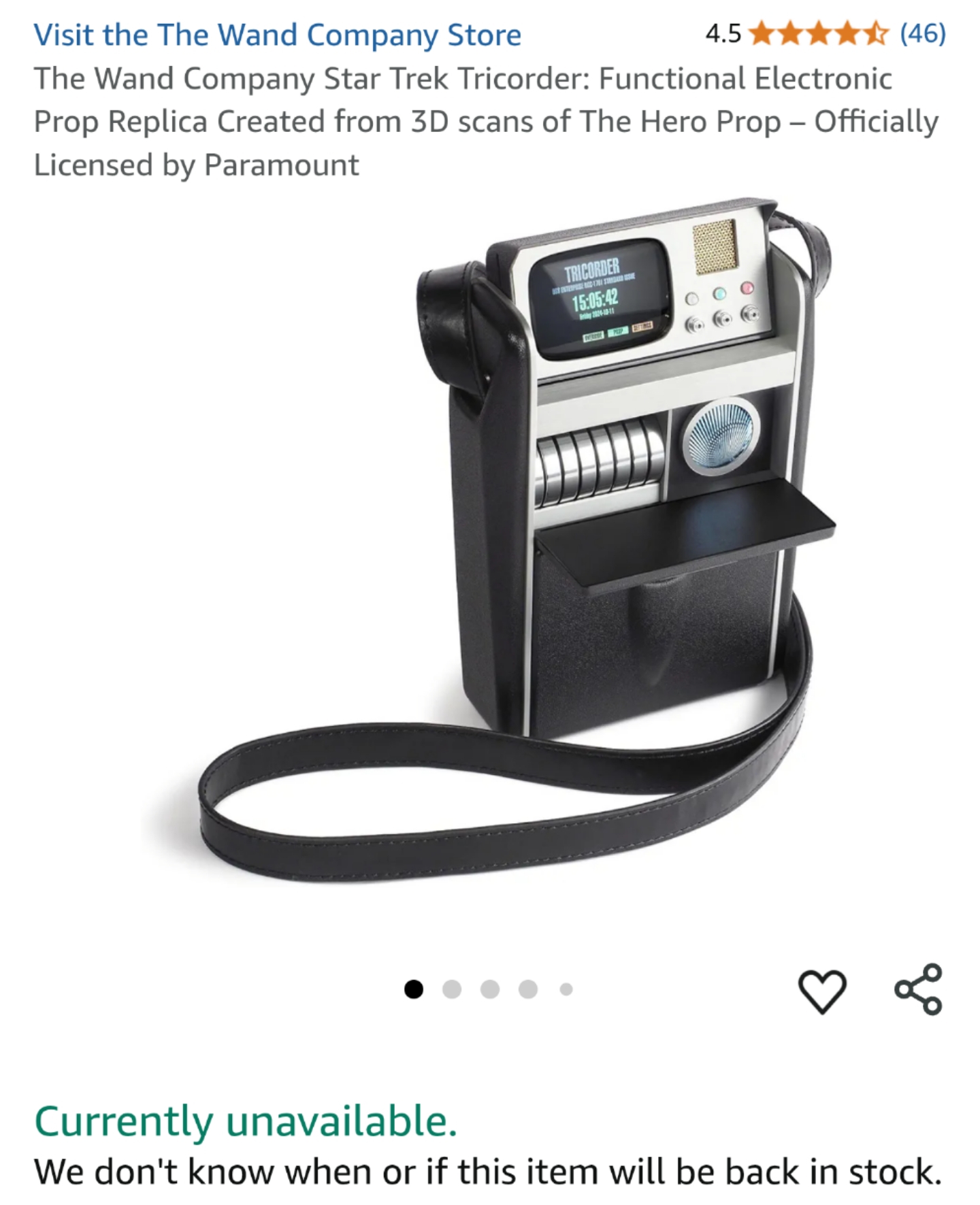

Are any Amazon.de (Germany) buyers actually seeing shipments of their orders? FB members are reporting their U.S. orders getting cancelled and being locked out of Amazon.de.
I just canceled my order because it would not dispatch to my area. It was worth a try though and I am happy to wait for it to come available on Amazon US. Hopefully by the end of the week or next week.
Either it is not ready to be sold even though the link is there or they have already sold out. Also, it does not come up without the link, if you do a search it does not find it.

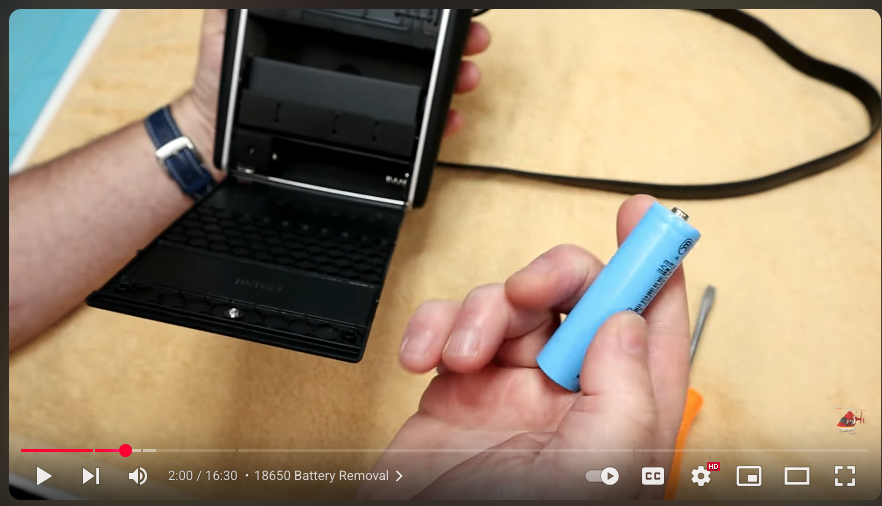

Ok - Trying to source a back up Battery - I know it's a 18650 - But is it button top or Flat? Anybody got a good one on Amazon to get? I wanted to charge it up so when mine finally gets ordered & arrives I won't have to wait 4 hours to charge it.
I think I found my new avatar:
Seems to be a button top:

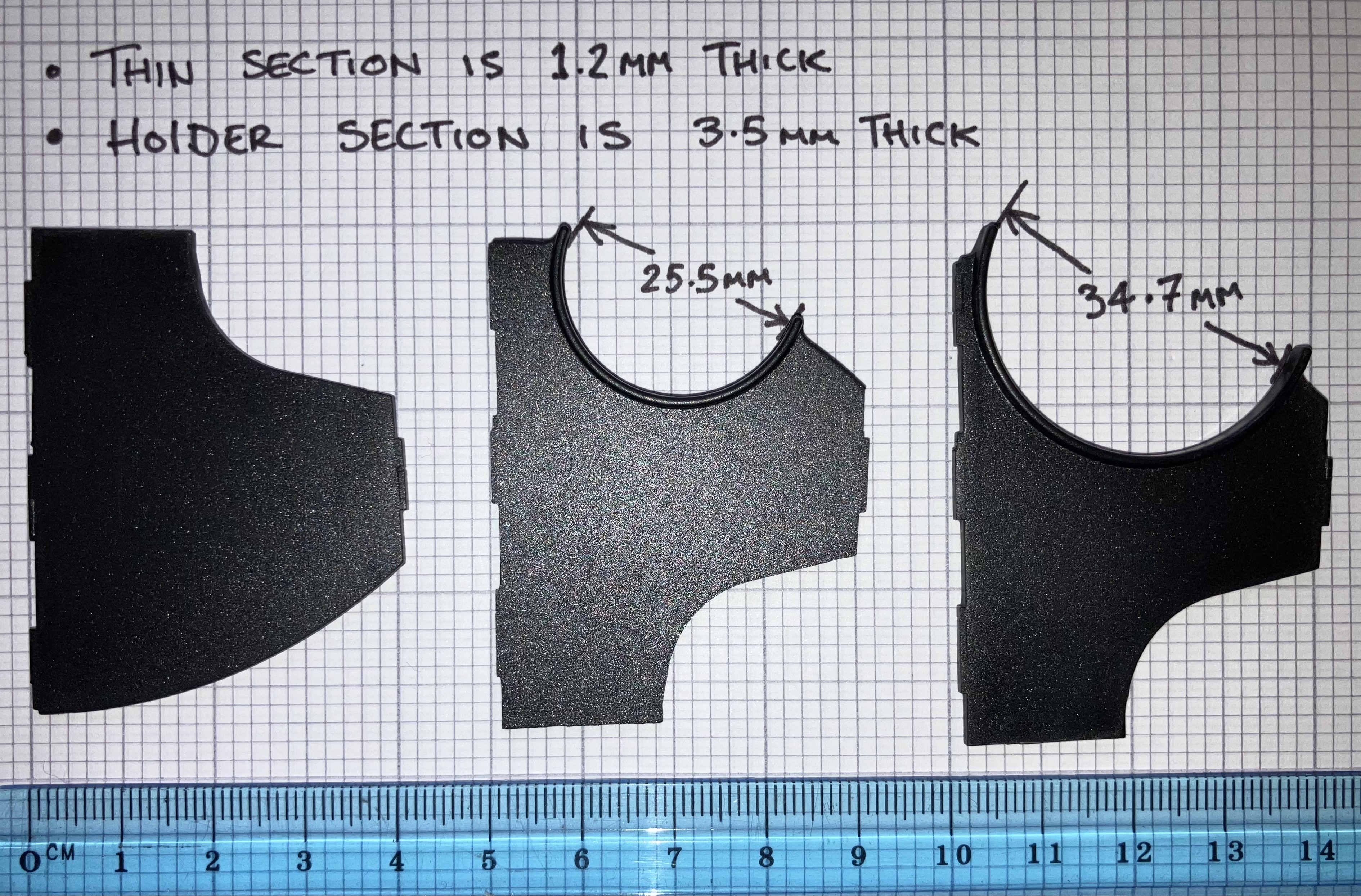

Thought it might be useful to have the dividers in a measurable format in case anyone needs to 3D print some replacements or custom mounts for other things. Apologies for any parallax issues, I tried to keep the camera flat down the 70mm line. No apologies for lack of freedom measurements though
