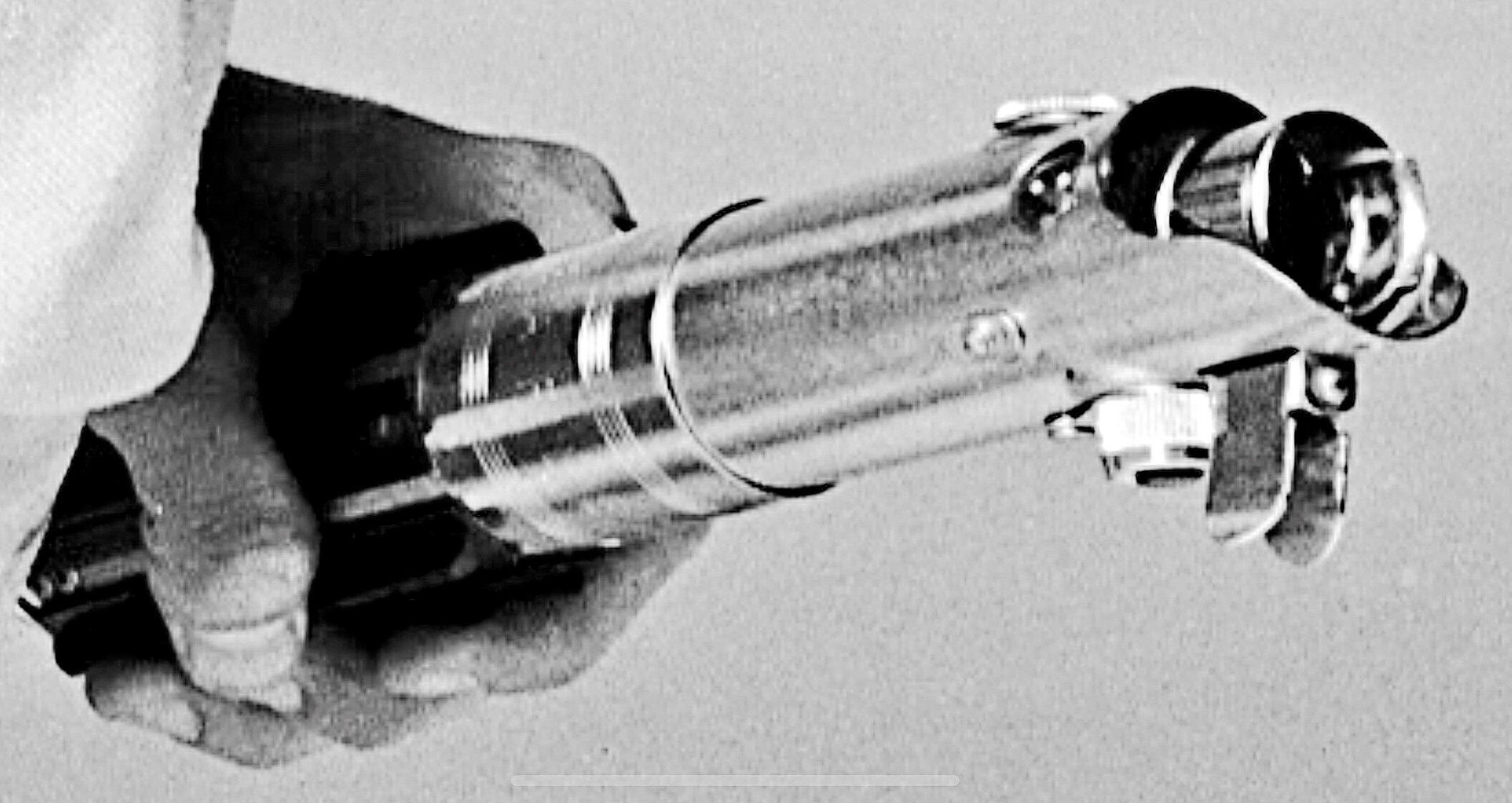

I've also come across a couple of flashes with "folmer" straight pins and "inc" shiny beer tab rivet that I'm sure where like that originally.
So far I've never been able to confirm what kind of beer tab rivet is on the ANH hero, but this shows it pretty clear.
The beer tab rivot has that distinctive "Inc" 4 triangle light bounce.
The dull folmer beer tabs don't do that - but I do have a vintage graflex with shiny finish, original smooth pins and a shiny beer tab so could easily be a random version. View attachment 1424530
Thank for posting this! A friend and I were just looking at this. The beertab rivet is distinctly machined on the inc. top, as opposed to dull on the folmer top. Not to mention in a number of the photos above, you can see a distinct difference in the finishes of the folmer clamp, and Inc. top. That is also an Inc. button on there as well!
I mean look at the difference in this brushed top vs the clamp! It has the exact texture of the Inc. though i can’t tell if the ears are folmer or inc, kind of too hard to see because of the shadowing.

So, the ANH has a duller Inc clamp on a shiny Folmer body? If I'm understanding right?
...because if that's true, then I can get this replica clamp off my Folmer and I'll be very, very happy.
Nope, the other way around actually! I have to say I believe the ANH to be the most mix and match mix of parts of most of the hero hilts. Based on studying the reference photos, I believe it's as follows, but not entirely sure, as some parts are too hard to make out because of the age of the reference photos:
-Inc. Top
-Leaning towards Folmer ears?
-Inc. Button
-Folmer glass eye
-Smooth Folmer (cone shaped, not rounded) pins
-Shiny Folmer/Folmer pat. Clamp
-Folmer/Folmer Pat. Lower
-Shinier Inc. lever with the large machined rivet
as I said none of this is for sure, but just making some observations on the same photos you guys are seeing! For all we know the original photographer/flashgun owner mix and matched these parts, not necessarily the prop masters!

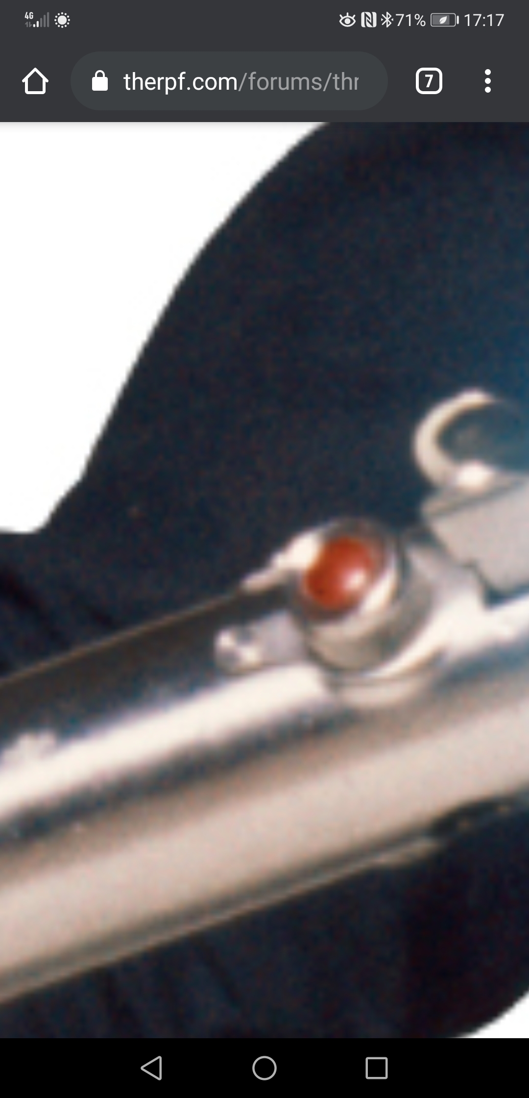

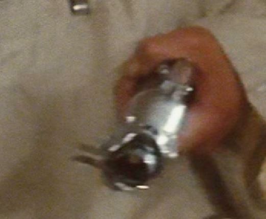

On the promo images the tips of the pins look like brass, but in the movie they look silver silver to me. Here a compared to the brass bulb contact:

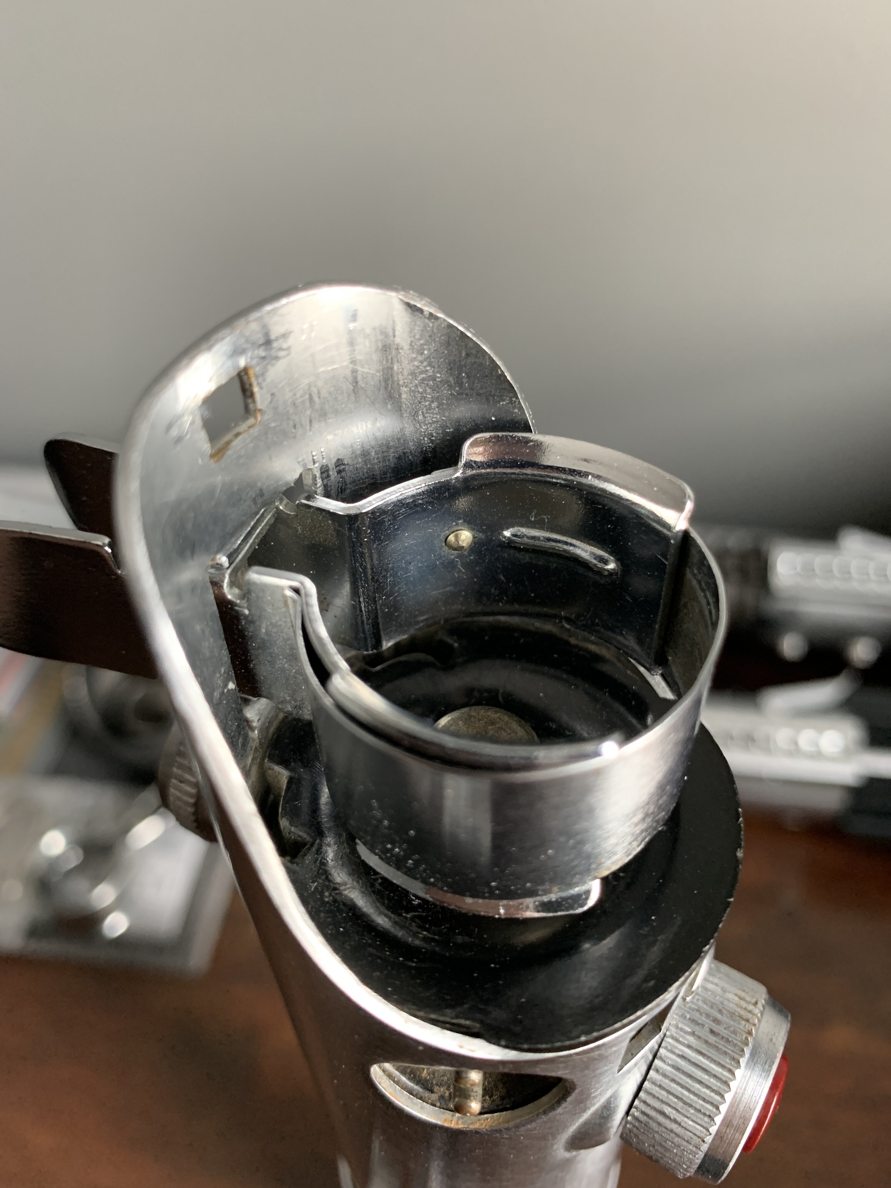

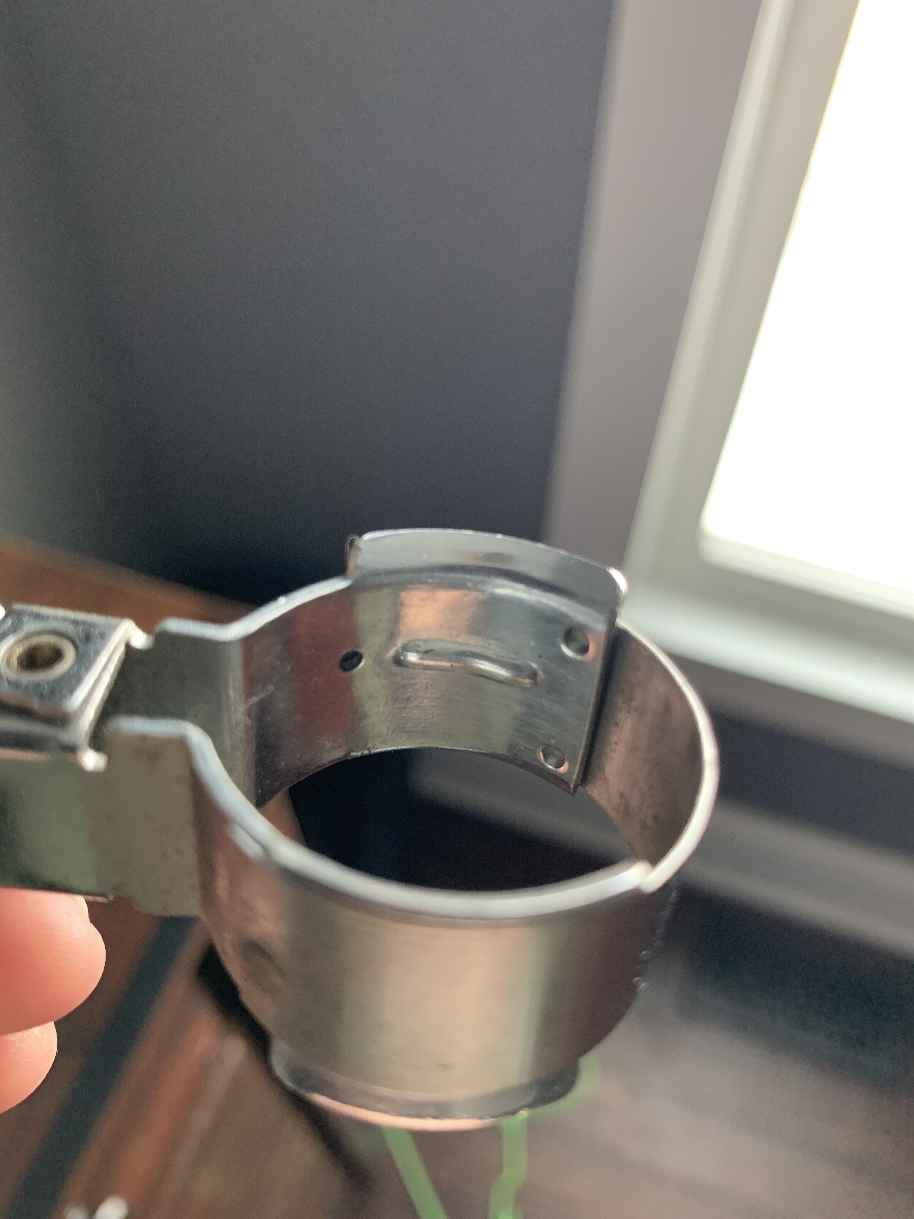

Can somebody point me to some reference on how to distinguish folmer vs inc bunny ears? That's something I must admit never payed much attention
The first one is the folmer, a small rounded brass rivet on the inside, whereas inc ears have inset dimples pressed on the inside in 6 places. External finishes are very similar however.
